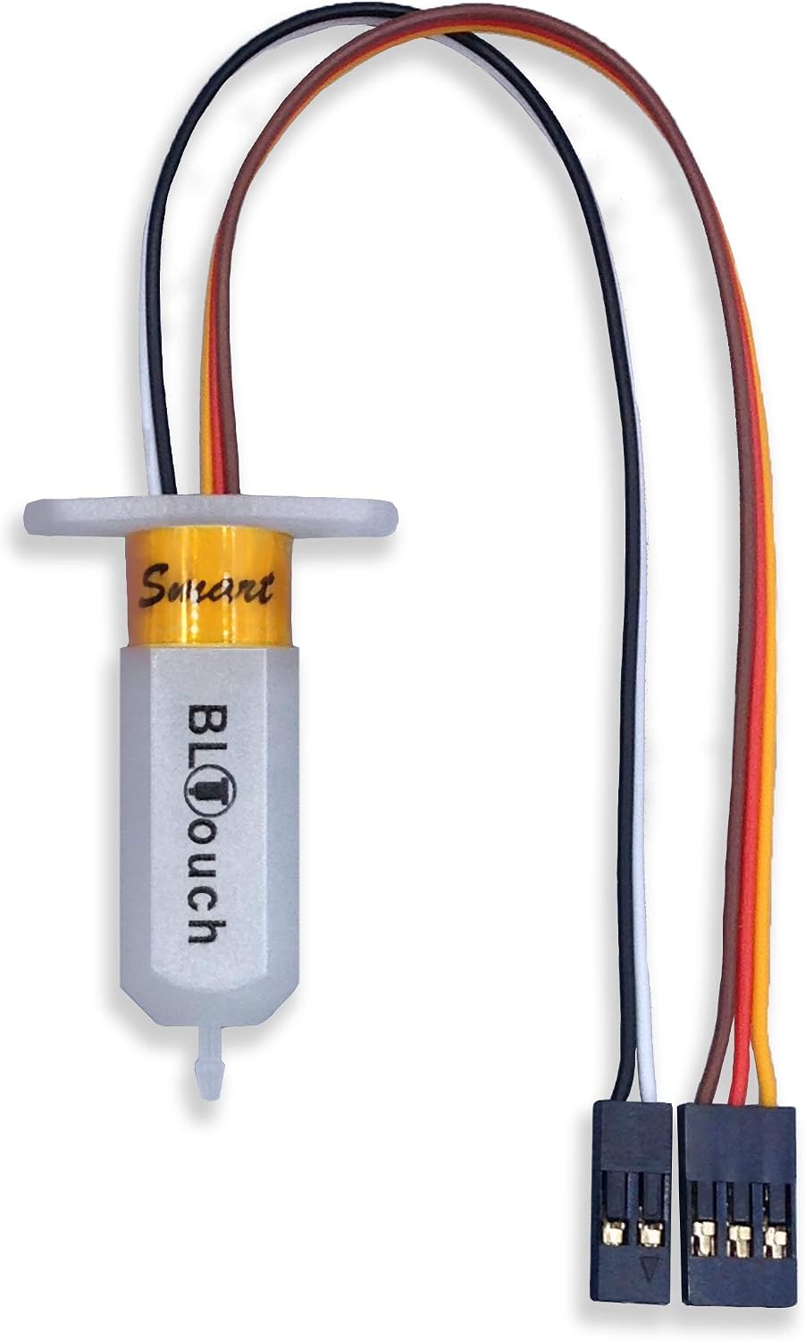

Sobreiro Posté(e) Novembre 12, 2020 Partager Posté(e) Novembre 12, 2020 Hi! I am trying to install a BlTouch on my Alfawise U30. However, I verify that the motherboard version is V8, that is, it does not have the connection for the + 5V (red), ground (green) and servo (yellow) connectors. When looking for how to connect the BlTouch in this version of the motherboard, I verify that I must remove a resistance and solder the + 5V to a component of the board. I was wondering if I can use a 5V power supply to connect the red and green wire instead of soldering the 5V. Removing the resistance is no problem. Lien vers le commentaire Partager sur d’autres sites More sharing options...
Epsylon3 Posté(e) Novembre 13, 2020 Partager Posté(e) Novembre 13, 2020 (modifié) Yes, i guess you can use a step down module to create 5V from your 24V PSU... Like a car USB charger circuit Modifié (le) Novembre 13, 2020 par Epsylon3 Lien vers le commentaire Partager sur d’autres sites More sharing options...
Sobreiro Posté(e) Novembre 13, 2020 Partager Posté(e) Novembre 13, 2020 Il y a 19 heures, Epsylon3 a dit : Yes, i guess you can use a step down module to create 5V from your 24V PSU... Like a car USB charger circuit Let me check the connections: Red = Step Down Module +5V; Greeen = Step Down Module 0V; Yellow (Servo) = Pin2 J26; Black = Pin1 J25; White = Pin2 J25; That's it? Lien vers le commentaire Partager sur d’autres sites More sharing options...
Epsylon3 Posté(e) Novembre 17, 2020 Partager Posté(e) Novembre 17, 2020 Black & white is a contact... Brown GND, Orange 5V... Yellow PWM... Lien vers le commentaire Partager sur d’autres sites More sharing options...
