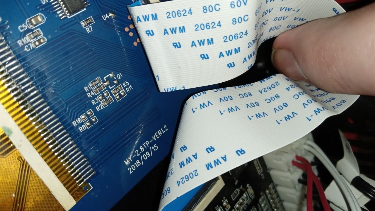

odseg Posté(e) Octobre 12, 2022 Partager Posté(e) Octobre 12, 2022 (modifié) good day , after flashing marlin on my U20 (last github version), i can`t run my touschscreen i`m tried all variant for define i`m only not changing LCD_READ_ID , because i think it not depends from it may be you can help ? Modifié (le) Octobre 12, 2022 par odseg Lien vers le commentaire Partager sur d’autres sites More sharing options...
pommeverte Posté(e) Octobre 12, 2022 Partager Posté(e) Octobre 12, 2022 (modifié) Hello @odseg, You can test this firmware, with english menu:project.bin I used Marlin V2.0.9.5 source code version and these configuration files:Configuration_adv.hConfiguration.hplatformio.ini Modifié (le) Octobre 12, 2022 par pommeverte Lien vers le commentaire Partager sur d’autres sites More sharing options...
odseg Posté(e) Octobre 12, 2022 Partager Posté(e) Octobre 12, 2022 il y a 56 minutes, pommeverte a dit : Hello @odseg, You can test this firmware, with english menu:project.bin I used Marlin V2.0.9.5 source code version and these configuration files:Configuration_adv.hConfiguration.hplatformio.ini thanks a lot for firmware, but it not helped me, may be you can give advise what wrong with my U20 and where i need make changes ? Lien vers le commentaire Partager sur d’autres sites More sharing options...
Epsylon3 Posté(e) Octobre 12, 2022 Partager Posté(e) Octobre 12, 2022 LCD_READ_ID is not related to the touchscreen, its only for the display type. If you can read the display, nothing to change about that. But your model is the standard one (V12) which is the default in github configuration... Lien vers le commentaire Partager sur d’autres sites More sharing options...
odseg Posté(e) Octobre 13, 2022 Partager Posté(e) Octobre 13, 2022 Il y a 23 heures, Epsylon3 a dit : LCD_READ_ID is not related to the touchscreen, its only for the display type. If you can read the display, nothing to change about that. But your model is the standard one (V12) which is the default in github configuration... Standard definition not working for me Lien vers le commentaire Partager sur d’autres sites More sharing options...
AtzePeeng Posté(e) Novembre 8, 2022 Partager Posté(e) Novembre 8, 2022 Salut, j'espère que vous pourrez m'aider. J'ai un U 30 et un marlin 2.0.9.1 installés. un faux BL touch est installé, mais celui-ci ne démarre pas non plus via la pronterface. et je ne peux pas utiliser mon écran tactile. J'ai la carte où le BL Touch est soudé. _Statusscreen.h Configuration.h Configuration_adv.h Lien vers le commentaire Partager sur d’autres sites More sharing options...
pommeverte Posté(e) Novembre 8, 2022 Partager Posté(e) Novembre 8, 2022 Salut @AtzePeeng , Je te conseille d'utiliser les fichiers exemples de la U20BLTouch, cela te permettra de sélectionner ton écran: dans les options de compilation du fichier section [env:STM32F103VE_longer]: build_flags = ${stm32_variant.build_flags} -DMCU_STM32F103VE -DU30 -DTS_V12 ou dans les directives: #define U30 //#define TS_V11 //#define TS_V12 //#define TS_V19 dans ce cas, il faudra supprimer les options de compilation: build_flags = ${stm32_variant.build_flags} -DMCU_STM32F103VE Ce message t'aidera à reconnaitre l'écran de ton imprimante (la V1.2 peut aussi avoir le marquage V1.4) ATTENTION: il faudra ajouter la ligne suivante dans le fichier configuration.h, après #define SDSUPPORT: #define SDIO_SUPPORT // Note from Hobi : Added as was not present in the file... Dans ton fichier Marlin\src\pins\stm32f1\pins_LONGER3D_LK.h, il faut commenter / décommenter les définitions correspondantes à la broche sur laquelle tu as connecté la sortie pour piloter ton BLTouch: #if HAS_Z_SERVO_PROBE #define SERVO0_PIN PD13 // Open drain PWM pin on the V0G (GND or floating 5V) #define SERVO0_PWM_OD // Comment this if using PE5 //#define SERVO0_PIN PE5 // Pulled up PWM pin on the V08 (3.3V or 0) //#undef Z_MAX_PIN // Uncomment if using ZMAX connector (PE5) #endif Si tu décommentes la ligne suivante dans le fichier configuration_adv.h, tu pourras envoyer le Gcode M43 S pour tester ton BLtouch en toute sécurité: //#define PINS_DEBUGGING Pour info, voici les fichiers exemple de la U20Bltouch pour Marlin V2.0.9.3: Configuration_adv.h Configuration.h 1 Lien vers le commentaire Partager sur d’autres sites More sharing options...
