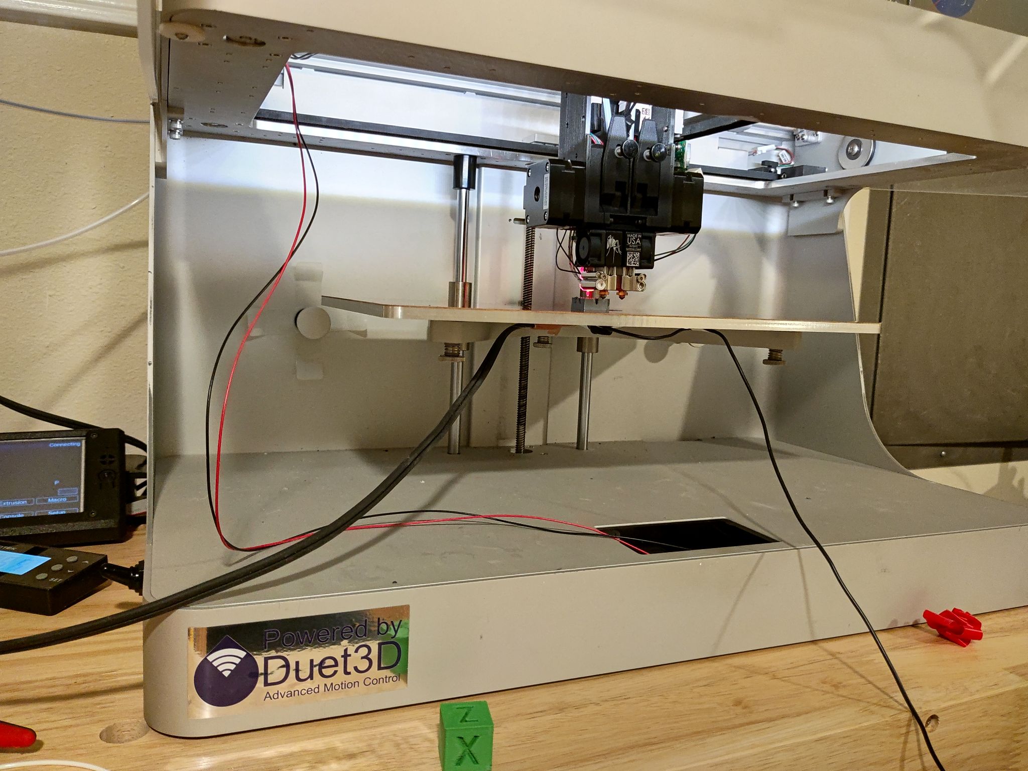

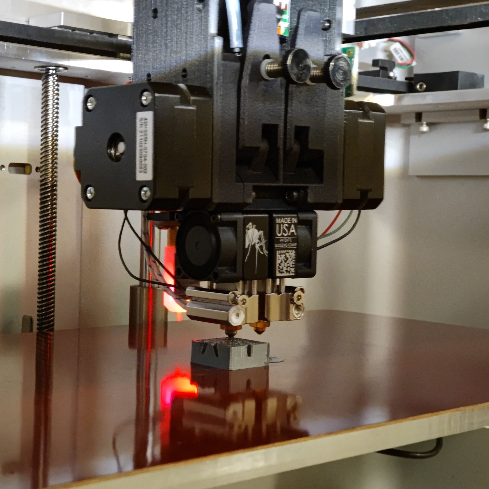

Waffles Posté(e) Octobre 12, 2022 Partager Posté(e) Octobre 12, 2022 I am starting my conversion of my Mark One. I already have a Mark Two so I don't need the fiber capability in the One. I am replacing the brain and extruder/hotend. I am going to make it into a high temp printer hopefully. I want to print PEI, PEKK, ans possibly Peek. Brains: Duet 3 mini 5+ Extruder: Bond tech BMG X2 Hot end: Slice Engineering Mosquito Magnum X 2 We will see if I can make it work. Lien vers le commentaire Partager sur d’autres sites More sharing options...
Waffles Posté(e) Novembre 28, 2022 Partager Posté(e) Novembre 28, 2022 The Duet 3 Mini 5+ can drive Markforged Mark One kinematics just fine with RepRap. Still cleaning up the wiring. Révélation Révélation Le 8/9/2022 at 7:04 AM, thierry.pro a dit : Hi No more conversion questions for now: the MarkOne is working normally again... Yesss! Random question: No Onyx on the MarkOne? Only the famous Nylon EndOfLife from Markforged? A+... You can run Onyx, but it will wear the nozzle out quickly. The plastic extrusion nozzle on the Mark One is brass. The Mark Two is copper with a steel core. They are not interchangeable. Lien vers le commentaire Partager sur d’autres sites More sharing options...
