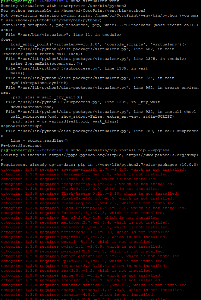

Supoziitoire Posté(e) Avril 16, 2018 Partager Posté(e) Avril 16, 2018 Bonjour j'ai un soucis étape 7 pi@raspberrypi:~ $ sudo apt-get -y install python-pip python-dev python-setuptools python-virtualenv git libyaml-dev build-essential Reading package lists... Done Building dependency tree Reading state information... Done Package python-setuptools is not available, but is referred to by another package. This may mean that the package is missing, has been obsoleted, or is only available from another source Package python-virtualenv is not available, but is referred to by another package. This may mean that the package is missing, has been obsoleted, or is only available from another source Package python-dev is not available, but is referred to by another package. This may mean that the package is missing, has been obsoleted, or is only available from another source However the following packages replace it: python E: Package 'python-dev' has no installation candidate E: Package 'python-setuptools' has no installation candidate E: Package 'python-virtualenv' has no installation candidate E: Unable to locate package git E: Unable to locate package libyaml-dev Lien vers le commentaire Partager sur d’autres sites More sharing options...
Supoziitoire Posté(e) Avril 16, 2018 Partager Posté(e) Avril 16, 2018 Je n'avais pas mise a jour l'heure , maintenant j'ai un autre soucis pi@raspberrypi:~/OctoPrint $ virtualenv venv Running virtualenv with interpreter /usr/bin/python2 New python executable in /home/pi/OctoPrint/venv/bin/python2 Not overwriting existing python script /home/pi/OctoPrint/venv/bin/python (you must use /home/pi/OctoPrint/venv/bin/python2) Installing setuptools, pkg_resources, pip, wheel...done. et pour l’étape suivante sa doit me bloquer je pence Lien vers le commentaire Partager sur d’autres sites More sharing options...

ShagoY Posté(e) Avril 16, 2018 Partager Posté(e) Avril 16, 2018 Ton "git clone --depth 1 https://github.com/foosel/OctoPrint.git" s'est bien déroulé ? Lien vers le commentaire Partager sur d’autres sites More sharing options...
Supoziitoire Posté(e) Avril 16, 2018 Partager Posté(e) Avril 16, 2018 pi@raspberrypi:~ $ pwd /home/pi pi@raspberrypi:~ $ git clone --depth 1 https://github.com/foosel/OctoPrint.git fatal: destination path 'OctoPrint' already exists and is not an empty directory. je c'est pas trop comment je peut contrôlé si sa sai bien passé ou pas Lien vers le commentaire Partager sur d’autres sites More sharing options...

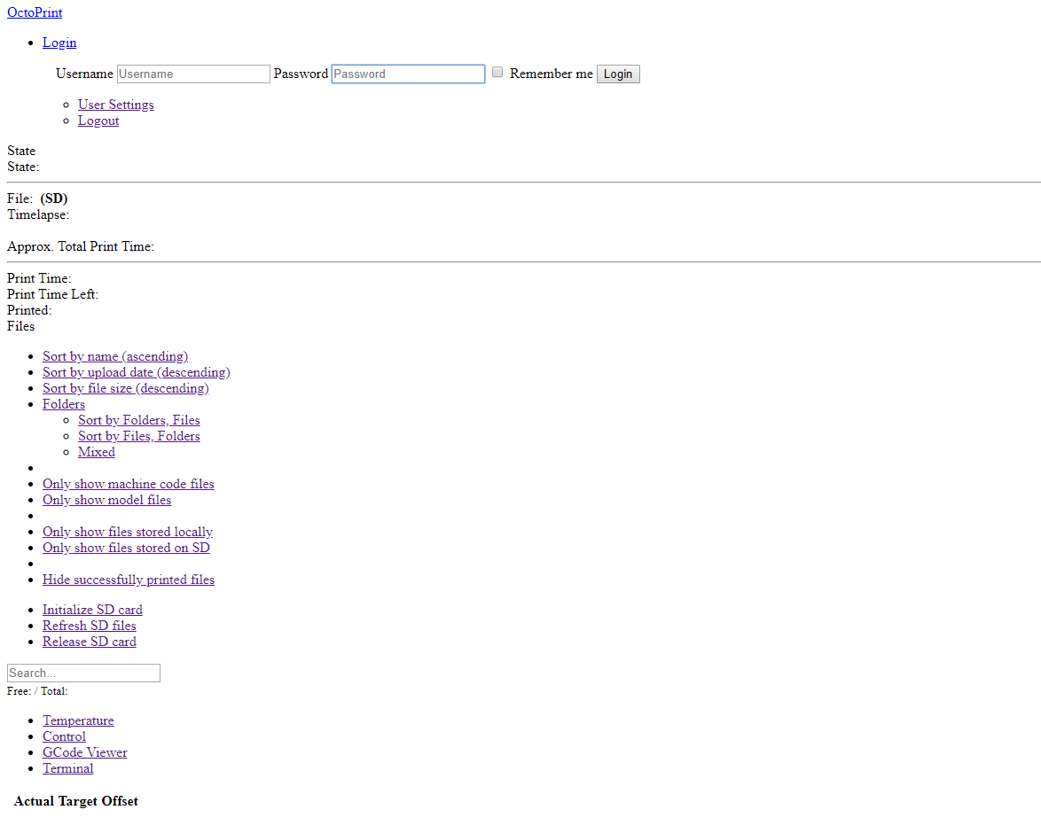

Supoziitoire Posté(e) Avril 19, 2018 Partager Posté(e) Avril 19, 2018 Bonjour , petit soucis a la fin du tuto : arrivé a l'étape : pi@raspberrypi:~ $ nano /home/pi/.octoprint/config.yaml j'ai continuer jusqu'au bout pour voir si cela fonctionnai mais je fini avec un page ou je peut rien faire Lien vers le commentaire Partager sur d’autres sites More sharing options...
Supoziitoire Posté(e) Avril 19, 2018 Partager Posté(e) Avril 19, 2018 Et quand je supprime la partie ou je vais jusqu’à la fin du tuto : webcam: stream: http://<your Raspi's IP>:8080/?action=stream snapshot: http://127.0.0.1:8080/?action=snapshot ffmpeg: /usr/bin/avconv j'ai sa : Lien vers le commentaire Partager sur d’autres sites More sharing options...
ShagoY Posté(e) Avril 19, 2018 Partager Posté(e) Avril 19, 2018 (modifié) Tu as corrigé comment ton problème de Lundi ? Il ne suffit pas de passer à l"étape qui suit et s'attendre que cela fonctionne, surtout lors d'une installation Puis tu fais bien le tuto "étape après étape" ? Car tu parles d'une étape qui porte sur la personnalisation d'Octoprint.. Tu devrais déjà être capable d'afficher correctement l'interface web L'étape "sudo service octoprint start" devrait déjà t'afficher Octoprint sur l'url : http://192.168.1.16:5000/ Le 16/04/2018 at 20:11, Supoziitoire a dit : pi@raspberrypi:~ $ git clone --depth 1 https://github.com/foosel/OctoPrint.git fatal: destination path 'OctoPrint' already exists and is not an empty directory. Le message d'erreur indique que le dossier existe déjà. Ce qui est "normal" vu que tu as déjà fait l'étape.. Suffit de supprimer le dossier (rm -r OctoPrint) ou de le renommer (mv Octoprint Octoprint-old). Concrètement tes derniers problèmes proviennent d'une installation mal effectuée. Edit: Tu devrais plutôt installer Octopi, c'est justement fait pour le gens sans connaissance en linux ! Va voir l'autre tuto Modifié (le) Avril 19, 2018 par ShagoY Lien vers le commentaire Partager sur d’autres sites More sharing options...
