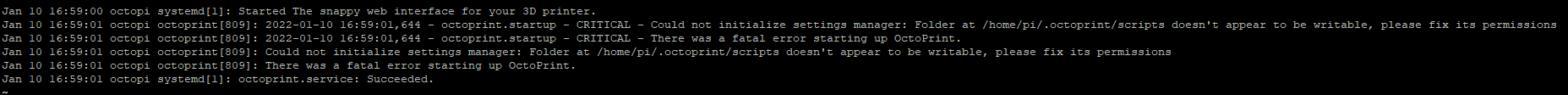

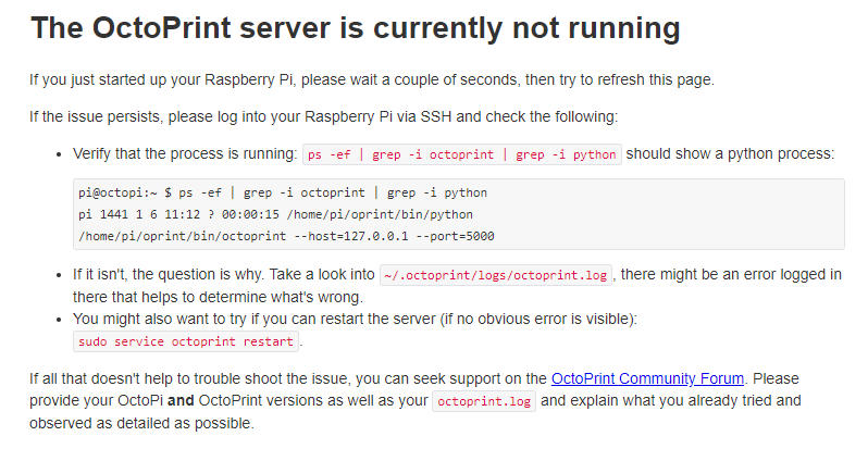

Zipvirus Posté(e) Janvier 12, 2022 Auteur Partager Posté(e) Janvier 12, 2022 (modifié) Ah ! petite nouveauté, branchée au réseau en filaire, voici ce que j'obtiens: A priori connexion SSH possible via Putty. Révélation login as: pi pi@192.168.1.24's password: Linux octopi 5.4.79-v7l+ #1373 SMP Mon Nov 23 13:27:40 GMT 2020 armv7l The programs included with the Debian GNU/Linux system are free software; the exact distribution terms for each program are described in the individual files in /usr/share/doc/*/copyright. Debian GNU/Linux comes with ABSOLUTELY NO WARRANTY, to the extent permitted by applicable law. Last login: Mon Jan 10 16:48:35 2022 from 192.168.1.26 SSH is enabled and the default password for the 'pi' user has not been changed. This is a security risk - please login as the 'pi' user and type 'passwd' to set a new password. ------------------------------------------------------------------------------ Access OctoPrint from a web browser on your network by navigating to any of: http://octopi.local http://192.168.1.24 http://[2a01:cb08:8a7b:f300:15ce:9835:376:9d9d] https is also available, with a self-signed certificate. ------------------------------------------------------------------------------ This image comes without a desktop environment installed because it's not required for running OctoPrint. If you want a desktop environment you can install it via sudo /home/pi/scripts/install-desktop ------------------------------------------------------------------------------ OctoPrint version : 1.7.2 OctoPi version : 0.18.0 ------------------------------------------------------------------------------ pi@octopi:~ $ Zip Modifié (le) Janvier 12, 2022 par Zipvirus is back Ajouts d'infos Lien vers le commentaire Partager sur d’autres sites More sharing options...
fran6p Posté(e) Janvier 12, 2022 Partager Posté(e) Janvier 12, 2022 La connexion ssh indique qu'au moins le système RaspiOS est «fonctionnel» (le mdp par défaut (raspberry) n'a pas été modifié , j'espère que ton RPi n'est pas ouvert sur l'extérieur). L'autre message indique que le service octoprint n'est pas démarré (pour quelle raison, là c'est mystère ). En ssh, vérifie son statut : service octoprint status Sinon essaie de le démarrer / redémarrer : sudo service octoprint restart S'il ne veut / peut redémarrer, reboot le système : sudo shutdown -r now Une fois le RPi redémarré, tente de t'y connecter comme à l'accoutumée. Lien vers le commentaire Partager sur d’autres sites More sharing options...
PPAC Posté(e) Janvier 12, 2022 Partager Posté(e) Janvier 12, 2022 Peut etre aussi vérifier l'espace libre sur la racine "/" df -h (car comme tu n'a pas modifié le mot de passe, je me demande si tu n'a pas omis la procédure pour redimensionner la taille de partition racine pour utiliser lespace disponible sur la carte SD ...) Lien vers le commentaire Partager sur d’autres sites More sharing options...
Zipvirus Posté(e) Janvier 12, 2022 Auteur Partager Posté(e) Janvier 12, 2022 (modifié) il y a une heure, fran6p a dit : (le mdp par défaut (raspberry) n'a pas été modifié , j'espère que ton RPi n'est pas ouvert sur l'extérieur) Quand j'ai essayé de changer le mdp voici ce qu'il s'est passé, j'ai pas compris du coup je suis passé outre. Révélation pi@octopi:~ $ passwd Changing password for pi. Current password: New password: Retype new password: passwd: Authentication token manipulation error passwd: password unchanged pi@octopi:~ $ Pour le statut: Révélation pi@octopi:~ $ service octoprint status ● octoprint.service - The snappy web interface for your 3D printer Loaded: loaded (/etc/systemd/system/octoprint.service; enabled; vendor preset: enabled) Active: inactive (dead) since Mon 2022-01-10 16:56:10 GMT; 4min 42s ago Process: 199 ExecStart=/home/pi/oprint/bin/octoprint serve --host=${HOST} --port=${PORT} (code=ex Main PID: 199 (code=exited, status=0/SUCCESS) Jan 10 16:56:07 octopi systemd[1]: Started The snappy web interface for your 3D printer. Jan 10 16:56:10 octopi octoprint[199]: 2022-01-10 16:56:10,497 - octoprint.startup - CRITICAL - Cou Jan 10 16:56:10 octopi octoprint[199]: 2022-01-10 16:56:10,497 - octoprint.startup - CRITICAL - The Jan 10 16:56:10 octopi octoprint[199]: Could not initialize settings manager: Folder at /home/pi/.o Jan 10 16:56:10 octopi octoprint[199]: There was a fatal error starting up OctoPrint. Jan 10 16:56:10 octopi systemd[1]: octoprint.service: Succeeded. lines 1-12/12 (END) ● octoprint.service - The snappy web interface for your 3D printer Loaded: loaded (/etc/systemd/system/octoprint.service; enabled; vendor preset: enabled) Active: inactive (dead) since Mon 2022-01-10 16:56:10 GMT; 4min 42s ago Process: 199 ExecStart=/home/pi/oprint/bin/octoprint serve --host=${HOST} --port=${PORT} (code=exited, status=0/SUCCESS) Main PID: 199 (code=exited, status=0/SUCCESS) Jan 10 16:56:07 octopi systemd[1]: Started The snappy web interface for your 3D printer. Jan 10 16:56:10 octopi octoprint[199]: 2022-01-10 16:56:10,497 - octoprint.startup - CRITICAL - Could not initialize settings manager: F Jan 10 16:56:10 octopi octoprint[199]: 2022-01-10 16:56:10,497 - octoprint.startup - CRITICAL - There was a fatal error starting up Octo Jan 10 16:56:10 octopi octoprint[199]: Could not initialize settings manager: Folder at /home/pi/.octoprint/scripts doesn't appear to be Jan 10 16:56:10 octopi octoprint[199]: There was a fatal error starting up OctoPrint. Jan 10 16:56:10 octopi systemd[1]: octoprint.service: Succeeded. ~ ~ ~ ~ ~ ~ ~ ~ ~ ~ ~ lines 1-12/12 (END)...skipping... ● octoprint.service - The snappy web interface for your 3D printer Loaded: loaded (/etc/systemd/system/octoprint.service; enabled; vendor preset: enabled) Active: inactive (dead) since Mon 2022-01-10 16:56:10 GMT; 4min 42s ago Process: 199 ExecStart=/home/pi/oprint/bin/octoprint serve --host=${HOST} --port=${PORT} (code=exited, status=0/SUCCESS) Main PID: 199 (code=exited, status=0/SUCCESS) Jan 10 16:56:07 octopi systemd[1]: Started The snappy web interface for your 3D printer. Jan 10 16:56:10 octopi octoprint[199]: 2022-01-10 16:56:10,497 - octoprint.startup - CRITICAL - Could not initialize settings manager: F Jan 10 16:56:10 octopi octoprint[199]: 2022-01-10 16:56:10,497 - octoprint.startup - CRITICAL - There was a fatal error starting up Octo Jan 10 16:56:10 octopi octoprint[199]: Could not initialize settings manager: Folder at /home/pi/.octoprint/scripts doesn't appear to be Jan 10 16:56:10 octopi octoprint[199]: There was a fatal error starting up OctoPrint. Jan 10 16:56:10 octopi systemd[1]: octoprint.service: Succeeded. ~ ~ ~ ~ ~ ~ ~ ~ ~ ~ ~ ~ ~ ~ ~ ~ ~ ~ ~ ~ ~ ~ ~ ~ ~ ~ ~ ~ ~ ~ ~ ~ ~ ~ ~ ~ ~ ~ ~ ~ ~ ~ ~ ~ ~ ~ ~ ~ ~ ~ lines 1-12/12 (END) ● octoprint.service - The snappy web interface for your 3D printer Loaded: loaded (/etc/systemd/system/octoprint.service; enabled; vendor preset: enabled) Active: inactive (dead) since Mon 2022-01-10 16:56:10 GMT; 4min 42s ago Process: 199 ExecStart=/home/pi/oprint/bin/octoprint serve --host=${HOST} --port=${PORT} (code=exited, status=0/SUCCESS) Main PID: 199 (code=exited, status=0/SUCCESS) Jan 10 16:56:07 octopi systemd[1]: Started The snappy web interface for your 3D printer. Jan 10 16:56:10 octopi octoprint[199]: 2022-01-10 16:56:10,497 - octoprint.startup - CRITICAL - Could not initialize settings manager: F Jan 10 16:56:10 octopi octoprint[199]: 2022-01-10 16:56:10,497 - octoprint.startup - CRITICAL - There was a fatal error starting up Octo Jan 10 16:56:10 octopi octoprint[199]: Could not initialize settings manager: Folder at /home/pi/.octoprint/scripts doesn't appear to be Jan 10 16:56:10 octopi octoprint[199]: There was a fatal error starting up OctoPrint. Jan 10 16:56:10 octopi systemd[1]: octoprint.service: Succeeded. ~ ~ ~ ~ ~ ~ ~ ~ ~ ~ ~ lines 1-12/12 (END) Je ne sais pas pourquoi tout le code n'apparait pas sur la droite, le voici en image. J'ai l'impression qu'il y a des pistes la non ? Sinon le redémarrage du service, et reboot n'ont rien donné. Pour l'espace dispo comme conseillé par @PPAC: Révélation pi@octopi:~ $ df -h Filesystem Size Used Avail Use% Mounted on /dev/root 29G 29G 0 100% / devtmpfs 1.8G 0 1.8G 0% /dev tmpfs 1.9G 0 1.9G 0% /dev/shm tmpfs 1.9G 17M 1.9G 1% /run tmpfs 5.0M 4.0K 5.0M 1% /run/lock tmpfs 1.9G 0 1.9G 0% /sys/fs/cgroup tmpfs 378M 0 378M 0% /run/user/1000 pi@octopi:~ $ Aussi, pour être complet, voici ce que renvoie le test demandé sur la page web quand je pointe sur le serveur: Révélation pi@octopi:~ $ ps -ef | grep -i octoprint | grep -i python pi@octopi:~ $ Révélation pi@octopi:~ $ ~/.octoprint/logs/octoprint.log -bash: /home/pi/.octoprint/logs/octoprint.log: Permission denied pi@octopi:~ $ Enfin, pour rappel, j'ai une autre carte SD prête, je n'ai juste qu'à relancer l'installation, comme je n'utilise que le plugin TPLink, je peux réinstaller vite fait, aussi je ne suis pas en "détresse" à proprement parler. Mais j'aime bien comprendre, d'où l'investigation et vos réponses intéressantes. D'ailleurs @PPAC cela t'embetterais de développer, car je n'ai (sauf erreur) nullement entendu parler de cela. Un immense merci à vous, Zip Modifié (le) Janvier 12, 2022 par Zipvirus is back Il manquait du code dans le résultat du test du statut Lien vers le commentaire Partager sur d’autres sites More sharing options...
PPAC Posté(e) Janvier 12, 2022 Partager Posté(e) Janvier 12, 2022 (modifié) il y a 20 minutes, Zipvirus a dit : Filesystem Size Used Avail Use% Mounted on /dev/root 29G 29G 0 100% / Donc tu n'a plus d'espace libre sur la racine "/" ... le 0 de "Avail" pour available (disponible) ... et le 100% de "Use% " il y a 20 minutes, Zipvirus a dit : D'ailleurs @PPAC cela t'embetterais de développer, car je n'ai (sauf erreur) nullement entendu parler de cela. Pour redimensionner la partition en fait cela fait longtemps que j'ai pas installé de OctoPi et il semble que se soit fait automatiquement ... (je parlais du truc que j'ai mis en rouge a la fin de la citation avant fait via une histoire d’expansion de la partition racine raspi-config ) Mais pour changer le mot de passe ( le truc en gros ) Citation Log into your Pi via SSH (it is located at octopi.local if your computer supports bonjour or the IP address assigned by your router), default username is pi, default password is raspberry. Run sudo raspi-config. Once that is open: Change the password via “Change User Password” Optionally: Change the configured timezone via “Localization Options” > “Timezone”. Optionally: Change the hostname via “Network Options” > “Hostname”. Your OctoPi instance will then no longer be reachable under octopi.local but rather the hostname you chose postfixed with .local, so keep that in mind. You can navigate in the menus using the arrow keys and Enter. To switch to selecting the buttons at the bottom use Tab. You do not need to expand the filesystem, current versions of OctoPi do this automatically. extrait de https://octoprint.org/download/ Sinon pour faire de la place ... là il faut faire le ménage a coup de "rm" bien ciblé ... je te laisse étudier l'espace utilisé a coup de du -sh * et en changent de répertoire pour affiner ... souvent les log sont a effacer (vérifier l'espace qu'il prenne avec du -sh /var/log Modifié (le) Janvier 12, 2022 par PPAC 1 Lien vers le commentaire Partager sur d’autres sites More sharing options...

Solution PPAC Posté(e) Janvier 13, 2022 Solution Partager Posté(e) Janvier 13, 2022 (modifié) il y a 23 minutes, Zipvirus a dit : Le moindre rm ne passe pas. Les log qui utilisent tout l'espace peut être le symptôme d'un problème (et pas forcement le problème en lui même ... ) Normalement il existe une commande pour vider les log Si tu arrive a remonter t'on système de fichier en écriture il y a des commandes du genre sudo journalctl --vacuum-size=5M pour faire un peux de ménages dans les log cf https://unix.stackexchange.com/questions/139513/how-to-clear-journalctl Mais alors pour remonter la racine en écriture là je ne sais plus ... un truc du genre : (mais tu dois surement avoir un message au démarrage qui te propose une methode) sudo mount -o remount, rw / Modifié (le) Janvier 13, 2022 par PPAC 1 Lien vers le commentaire Partager sur d’autres sites More sharing options...
Zipvirus Posté(e) Janvier 13, 2022 Auteur Partager Posté(e) Janvier 13, 2022 @PPAC J'ai peut être été un peu "brutasse", mais j'ai fait les choses suivantes: sudo mount -o remount, rw / puis je suis allé dans le dossier /var/log sudo rm syslog ensuite un reboot et de nouveau un sudo mount -o remount, rw / puis sudo service octoprint restart de la j'ai retrouvé mon serveur Octoprint, et j'en ai profité pour faire un backup, maintenant je peux bidouiller plus sérieusement pour comprendre d'où viennent ces 27Gb de logs. En tout cas un grand merci PPAC si une procédure de vérification pour comprendre ce syslog de dinge te passe par la tête n'hésites pas, en tout cas, savoure bien ton dîner avec le sentiment d'avoir sauvé mon serveur Zip 1 1 Lien vers le commentaire Partager sur d’autres sites More sharing options...
