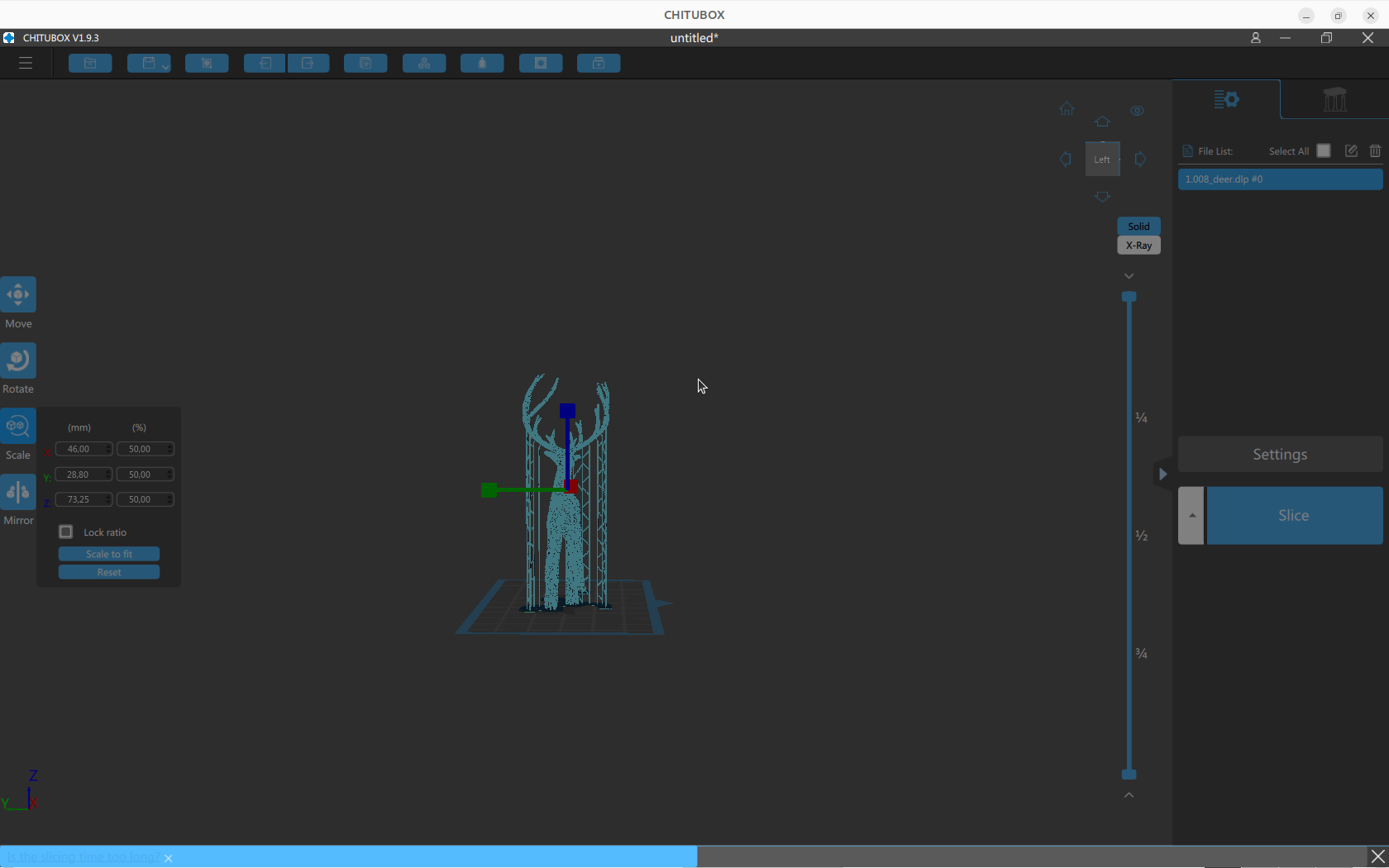

PPAC Posté(e) Mai 24, 2022 Partager Posté(e) Mai 24, 2022 (modifié) https://www.chitubox.com/en/download/chitubox-free https://www.chitubox.com/en/article/whatsnew/chitubox-free/1.9.3 Citation 【New Release】CHITUBOX Basic V1.9.3! 7+ Popular Printers Updated! Since Version CHITUBOX Basic V1.9.2 was released, we are continually collecting feedback from our users in order to be innovative. Now, CHITUBOX Basic V1.9.3 and Elegoo,Phrozen, Anycubic and HITRY joined hands, bring with more excellent printers that extend the printer's list and also optimized printing parameters. Let’s check these printers out together. Firstly, CHITUBOX Basic V1.9.3 optimized Elegoo Saturn2 and Elegoo Jupiter’s printing parameters that has solved some prior printing errors and some abnormal situations, enable the printers with greater performance and improve stability. Secondly, CHITUBOX Basic V1.9.3 added 7 new printers in, which were long-expected by our users. These printers were user-center designed that show us their impressive performance and the exquisite appearance. Now CHITUBOX Basic V1.9.3 is much easier for pre-processing and slicing and offers more printer choices for users. The models can be printed layer by layer with very detailed outlooks. New Added Printers: Added the Phrozen Sonic Mighty 8k machine Added the Anycubic Photon Ultra machine Added the Anycubic Photon M3 machine Added the Anycubic Photon M3 Max machine (Added the Anycubic Photon M3 Plus machine Added the HITRY-Rocket 1 machine Added the HITRY-Rocket 1 Pro machine Are you ready? CHITUBOX Basic V1.9.3 is right here waiting for you! Download now! J'attendez cette version pour avoir le profil de la Photon Ultra ( même si il reste possible d'en créer un depuis une Anycubic Mono SE ou une imprimante générique, d'enregistrer au format Anycubic et de renommer les fichiers obtenus (".pwmx", ... ) en ".dlp", sur la version 1.9.0 que j'utilise ) Malheureusement depuis la version 1.9.1, pour linux il faut GLIBC_2.29 (donc pas possible de la lancer simplement sur un Ubuntu 18.04 mais elle démarre sur une Ubuntu 20.04 ou 22.04 après avoir éventuellement fait la bidouille avec ldconfig pour utiliser les lib QT5 embarquées https://forum.chitubox.com/?thread-800.htm (là pour la version 1.8.1 mais adaptable pour la version 1.9.3 ) Citation ~/Downloads/CHITUBOX V1.8.1$ sudo ldconfig "`pwd`"/lib ./CHITUBOX The solution is above - you either manually add Chitubox lib directory to the linker cache using ldconfig, or you do something like this : ~/Downloads/CHITUBOX V1.8.1$ echo "`pwd`/lib" >> chitubox.conf ~/Downloads/CHITUBOX V1.8.1$ sudo mv chitubox.conf /etc/ld.so.conf.d/ you can verify linker can see the libraries like this : user@user-pc:~/Downloads/CHITUBOX V1.8.1$ ldconfig -p|grep CHITU libicuuc.so.56 (libc6,x86-64) => /home/user/Downloads/CHITUBOX V1.8.1/lib/libicuuc.so.56 libicui18n.so.56 (libc6,x86-64) => /home/user/Downloads/CHITUBOX V1.8.1/lib/libicui18n.so.56 libicudata.so.56 (libc6,x86-64) => /home/user/Downloads/CHITUBOX V1.8.1/lib/libicudata.so.56 libQt53DRender.so.5 (libc6,x86-64) => /home/user/Downloads/CHITUBOX V1.8.1/lib/libQt53DRender.so.5 libQt53DQuickRender.so.5 (libc6,x86-64) => /home/user/Downloads/CHITUBOX V1.8.1/lib/libQt53DQuickRender.so.5 libQt53DQuickInput.so.5 (libc6,x86-64) => /home/user/Downloads/CHITUBOX V1.8.1/lib/libQt53DQuickInput.so.5 libQt53DQuickExtras.so.5 (libc6,x86-64) => /home/user/Downloads/CHITUBOX V1.8.1/lib/libQt53DQuickExtras.so.5 libQt53DQuick.so.5 (libc6,x86-64) => /home/user/Downloads/CHITUBOX V1.8.1/lib/libQt53DQuick.so.5 ) Cette version 1.9.3 (contrairement à la v1.9.0) semble pouvoir lire les fichiers d'impression ( .dlp / .pwmx / ... mais ça prend beaucoup de temps et rame pas mal chez moi ... ) et recréer un modèle 3D qui pourra ensuite être retranché... (là mauvais exemple car il y a des supports dans le fichier réimporté et donc réduire l'échelle rendra les supports inadaptés et donnera sûrement une impression ratée...) Si vous avez des remarques ou des problèmes avec cette version, merci de poster un commentaire à ce sujet. (J'ai hésité à créer le sujet dans https://www.lesimprimantes3d.fr/forum/12-discussion-sur-les-logiciels-3d/ , je laisse les administrateurs et modérateurs décider si oui ou non ce sujet a sa la place ici ( https://www.lesimprimantes3d.fr/forum/118-les-imprimantes-3d-sla/ ) et donc le déplacer au besoin (Merci d'avance) ) Modifié (le) Mai 24, 2022 par PPAC correction urls Lien vers le commentaire Partager sur d’autres sites More sharing options...

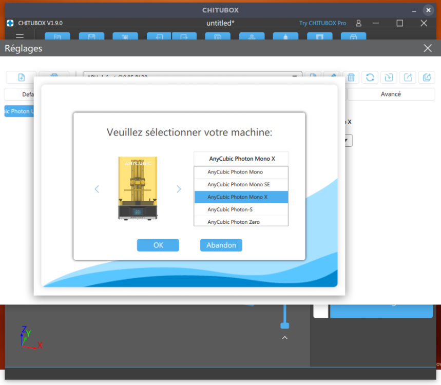

Patjo Posté(e) Mai 26, 2022 Partager Posté(e) Mai 26, 2022 Bonjour. Perso, avec la version 1.9.0, je n'arrive pas à retrouver la anycubic photon mono X. Donc lorsque j'ouvre anycubic, les dimensions du plateaux ne sont pas les bonnes?? Pouvez vous svp me renseigner.? Merci Lien vers le commentaire Partager sur d’autres sites More sharing options...

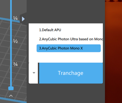

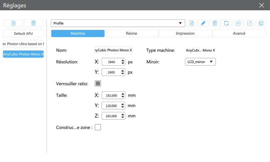

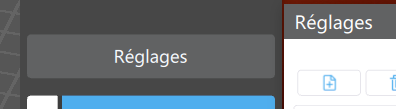

PPAC Posté(e) Mai 26, 2022 Auteur Partager Posté(e) Mai 26, 2022 (modifié) il y a 45 minutes, Patjo a dit : Perso, avec la version 1.9.0, je n'arrive pas à retrouver la anycubic photon mono X. Avec ma version 1.9.0 sous linux j'arrive a ajouter une mono X Via le bouton "Réglage", puis l'icone "+" Je retrouve bien une Anycubic Photon Mono X Avant le Tranchage, vérifie tu bien, que tu a la bonne imprimante de sélectionné ? ( via le bouton avec le petit icone "v" a coté du bouton "Tranchage" ) (Edit : Sinon, si tu n'a qu'une imprimante, efface le profil "Default" et ne garde que le profil de l'imprimante que tu utilise) Modifié (le) Mai 26, 2022 par PPAC Lien vers le commentaire Partager sur d’autres sites More sharing options...

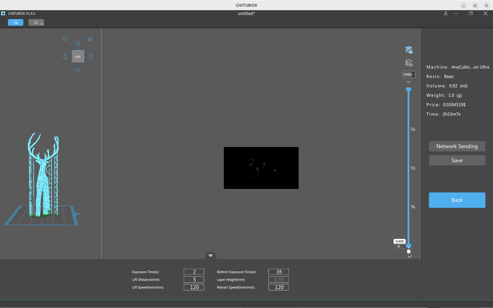

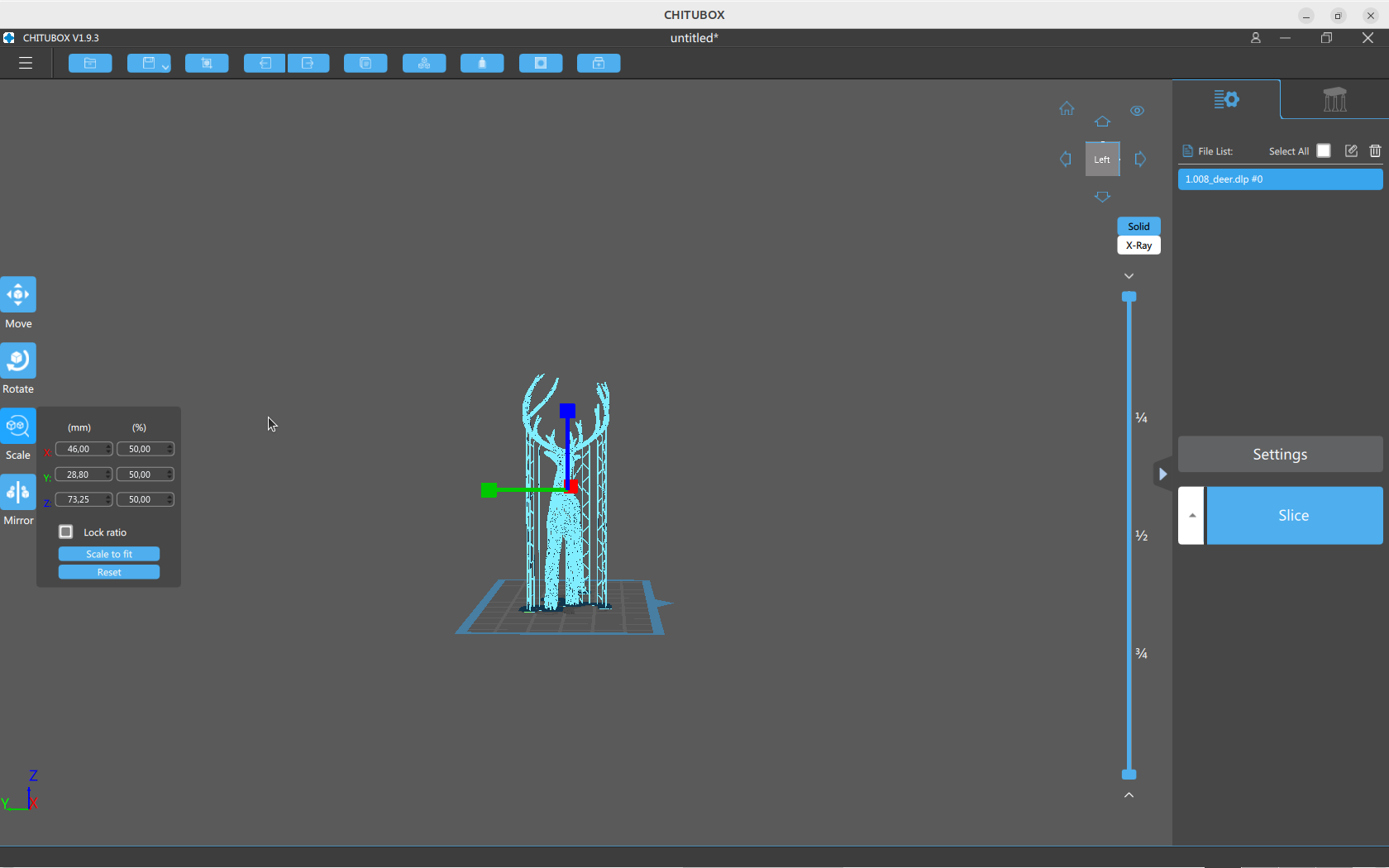

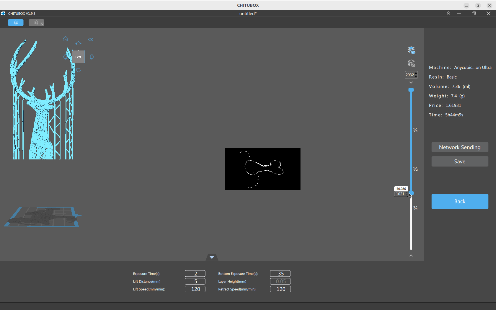

Patjo Posté(e) Mai 27, 2022 Partager Posté(e) Mai 27, 2022 bonjour Pascal j'ai bien reçu ton fichier, merci beaucoup. je vais essayer de l'imprimer et je te dirais; pour le moment quand je l'ouvre, il se présente en sortie chez moi avec photon workshop V2.1.24; je te tiens au courant. encore merci bonne journée patrice cette nuit avec le même système de fichier, j'avais réussi a enregistrer des fichiers avec lychee, j'ai voulu imprimer et il n'y a que les supports qui apparaissent Lien vers le commentaire Partager sur d’autres sites More sharing options...

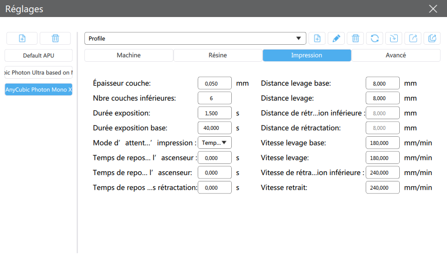

pascal91 Posté(e) Mai 27, 2022 Partager Posté(e) Mai 27, 2022 il y a 58 minutes, Patjo a dit : j'ai voulu imprimer et il n'y a que les supports qui apparaissent c'est un problème de réglage des supports dans chitubox........ normal que tu tâtonnes au début le fichier envoyé n'est pas optimisé , j'ai fait ça vite fait Lien vers le commentaire Partager sur d’autres sites More sharing options...
