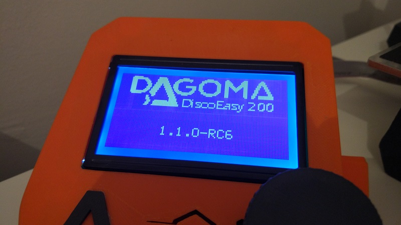

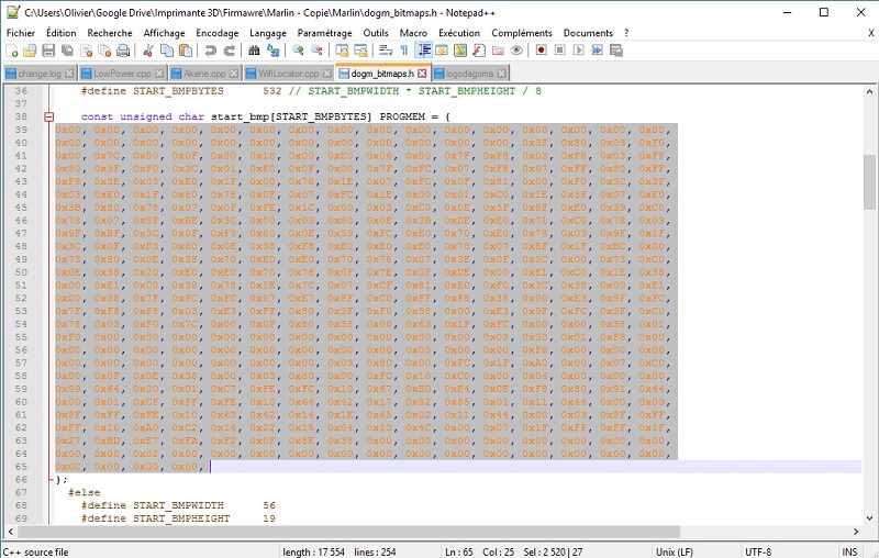

Narayan1986 Posté(e) Mars 9, 2017 Partager Posté(e) Mars 9, 2017 (modifié) Salut à tous ! Voici comment modifier le code source de votre discoeasy200 afin de modifier le logo de démarrage pour avoir ce rendu: Il faudra ouvrir le fichier "dogm_bitmaps.h" et venir coller les valeurs hexa (ci-dessous) à la place de celles existantes entre les "{ }" au niveau de la ligne 38 (start_bmp[START_BMPBYTES] PROGMEM) voici les lignes de code hexa : 0x00, 0x00, 0x00, 0x00, 0x00, 0x00, 0x00, 0x00, 0x00, 0x00, 0x00, 0x00, 0x00, 0x00, 0x00, 0x00, 0x00, 0x00, 0x00, 0x00, 0x00, 0x00, 0x00, 0x00, 0x00, 0x00, 0x00, 0x00, 0x3F, 0x80, 0x03, 0xF0, 0x00, 0x7C, 0x00, 0x0F, 0x80, 0x18, 0x00, 0xE0, 0x06, 0x00, 0x7F, 0xF8, 0x03, 0xF8, 0x03, 0xFF, 0x80, 0x3F, 0xF0, 0x3C, 0x01, 0xE0, 0x0F, 0x00, 0x7F, 0xFC, 0x07, 0xF8, 0x07, 0xFF, 0x80, 0xFF, 0xF8, 0x3E, 0x03, 0xE0, 0x1F, 0x00, 0x78, 0x1E, 0x07, 0xFC, 0x0F, 0x81, 0x00, 0xF0, 0x3C, 0x3F, 0x03, 0xE0, 0x1F, 0x80, 0x78, 0x0F, 0x07, 0xFC, 0x1E, 0x00, 0x01, 0xC0, 0x1E, 0x3F, 0x07, 0xE0, 0x3B, 0x80, 0x78, 0x07, 0x0F, 0xFE, 0x1C, 0x00, 0x03, 0xC0, 0x0E, 0x3F, 0x8F, 0xE0, 0x39, 0xC0, 0x78, 0x07, 0x8F, 0xBE, 0x3C, 0x00, 0x03, 0x80, 0x0E, 0x3B, 0xDE, 0xE0, 0x71, 0xC0, 0x78, 0x03, 0x9F, 0xBF, 0x3C, 0x0F, 0xF3, 0x80, 0x0E, 0x39, 0xFC, 0xE0, 0x70, 0xE0, 0x78, 0x03, 0x9F, 0x1F, 0x3C, 0x0F, 0xF3, 0x80, 0x0E, 0x38, 0xF8, 0xE0, 0xE0, 0xE0, 0x78, 0x07, 0xBF, 0x1F, 0xBC, 0x00, 0x73, 0x80, 0x0E, 0x38, 0x70, 0xE0, 0xE0, 0x70, 0x78, 0x07, 0x3E, 0x0F, 0x9C, 0x00, 0x73, 0xC0, 0x0E, 0x38, 0x20, 0xE0, 0xE0, 0x70, 0x78, 0x0F, 0x7E, 0x0F, 0xDE, 0x00, 0xE1, 0xC0, 0x1E, 0x38, 0x00, 0xE1, 0xC0, 0x38, 0x78, 0x1E, 0x7C, 0x07, 0xCF, 0x81, 0xE0, 0xF0, 0x3C, 0x38, 0x00, 0xE1, 0xC0, 0x38, 0x7F, 0xFC, 0xFC, 0x07, 0xE7, 0xFF, 0xC0, 0xFF, 0xF8, 0x38, 0x00, 0xE3, 0x9F, 0xFC, 0x7F, 0xF8, 0xF8, 0x03, 0xE3, 0xFF, 0x80, 0x3F, 0xF0, 0x38, 0x00, 0xE3, 0x9F, 0xFC, 0x3F, 0xC0, 0x78, 0x03, 0xF0, 0x7C, 0x00, 0x0F, 0x80, 0x38, 0x00, 0x63, 0x1F, 0xFC, 0x00, 0x00, 0x38, 0x01, 0xF0, 0x00, 0x00, 0x00, 0x00, 0x00, 0x00, 0x00, 0x00, 0x00, 0x00, 0x03, 0x30, 0x01, 0xF8, 0x00, 0x00, 0x00, 0x00, 0x00, 0x00, 0x00, 0x00, 0x00, 0x00, 0x03, 0x00, 0x00, 0xF8, 0x00, 0x00, 0x00, 0x00, 0x00, 0x00, 0x00, 0x00, 0x00, 0x00, 0x03, 0x80, 0x00, 0xFC, 0x1F, 0xA0, 0x00, 0x07, 0xC0, 0x00, 0x0F, 0x0E, 0x38, 0x00, 0x03, 0x80, 0x00, 0xFC, 0x10, 0xC0, 0x00, 0x04, 0x00, 0x00, 0x00, 0x99, 0x64, 0x00, 0x01, 0xC7, 0xFE, 0xFC, 0x10, 0x67, 0xBD, 0xE4, 0x0E, 0xF8, 0x80, 0x91, 0x44, 0x00, 0x01, 0xCF, 0xFF, 0xFE, 0x10, 0x64, 0x42, 0x17, 0x82, 0x85, 0x01, 0x11, 0x44, 0x00, 0x03, 0x8F, 0xFF, 0xFE, 0x10, 0x63, 0x42, 0x14, 0x1E, 0x65, 0x02, 0x11, 0x44, 0x00, 0x03, 0x8F, 0xFF, 0xFF, 0x10, 0xA0, 0xC2, 0x14, 0x22, 0x15, 0x04, 0x13, 0x4C, 0x00, 0x07, 0x1F, 0xFF, 0xFF, 0x1F, 0x27, 0xBD, 0xE7, 0xFA, 0xF2, 0x0F, 0x8E, 0x38, 0x00, 0x00, 0x00, 0x00, 0x00, 0x00, 0x00, 0x00, 0x00, 0x00, 0x02, 0x00, 0x00, 0x00, 0x00, 0x00, 0x00, 0x00, 0x00, 0x00, 0x00, 0x00, 0x00, 0x00, 0x0C, 0x00, 0x00, 0x00, Il suffira ensuite de flasher le firmware avec l'IDE arduino Modifié (le) Mars 9, 2017 par Narayan1986 1 Lien vers le commentaire Partager sur d’autres sites More sharing options...
