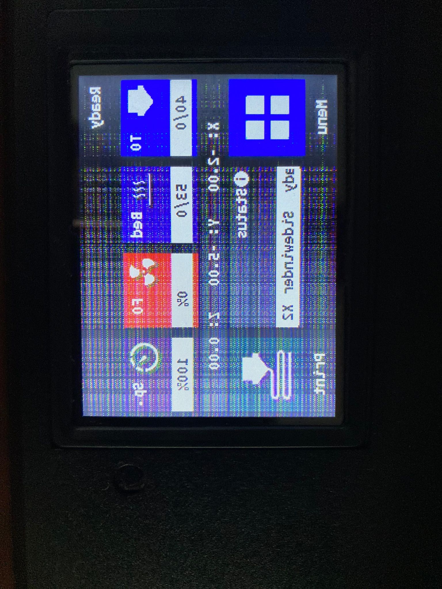

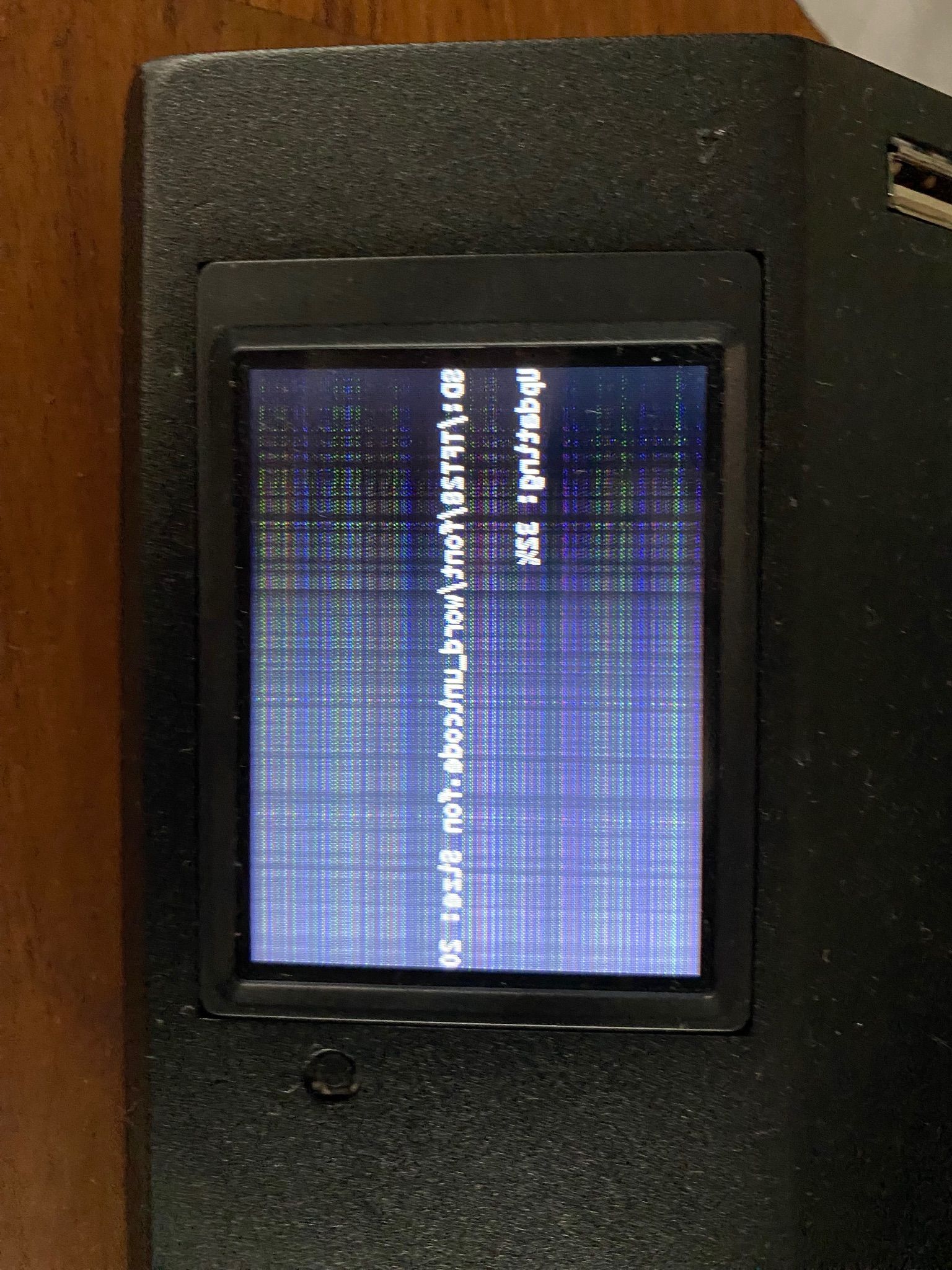

  4. Still the same, damaged, mirrored and upsidedown @MrMagounet any ideas ? I also flashed your marlin firmware to check it but nothing changed

  7. Installed and have something like this its upsidedown and mirrored, and looks like something wrong

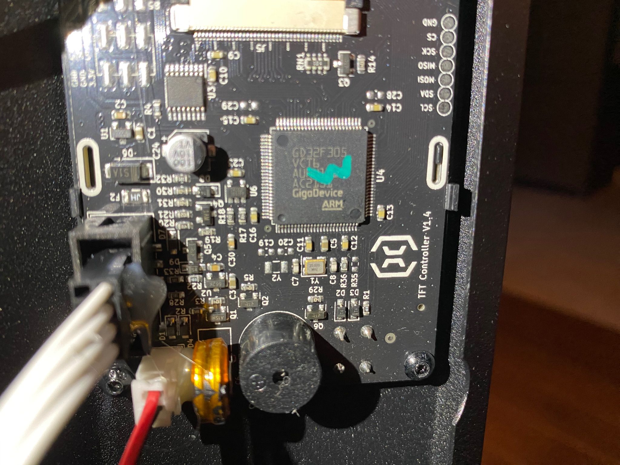

  8. @MrMagounet I made some pictures for you looks like GD32F305
  9. How can i check it ? I mean Marlin baudrate? MCU i have 3.0.5v
