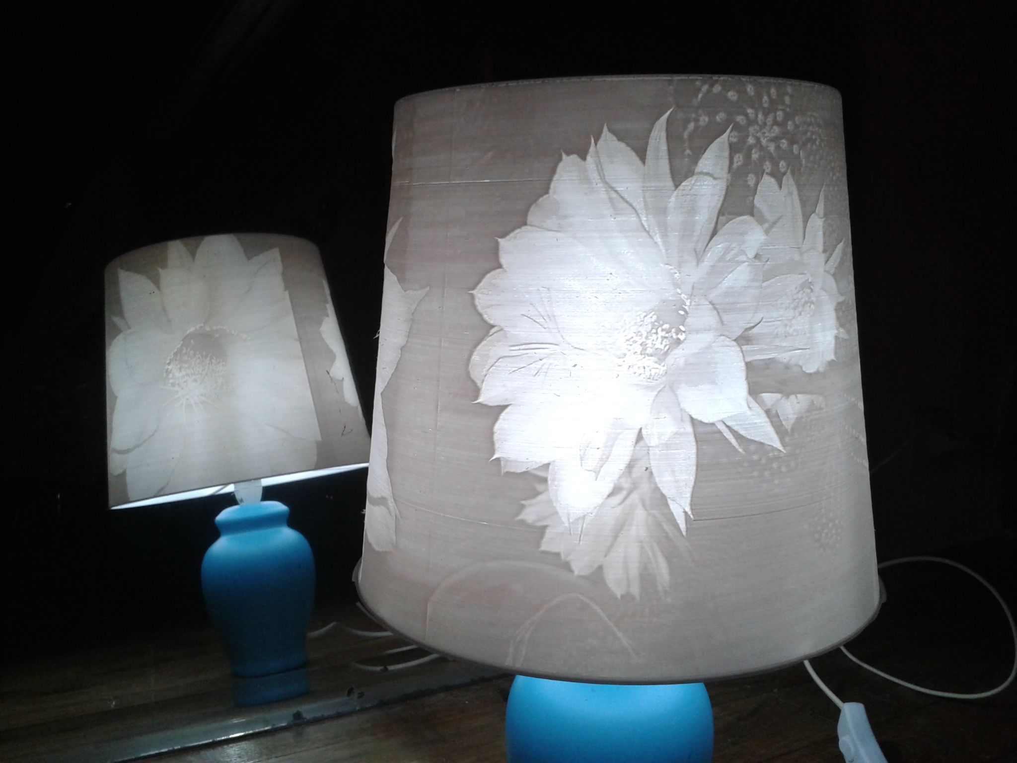

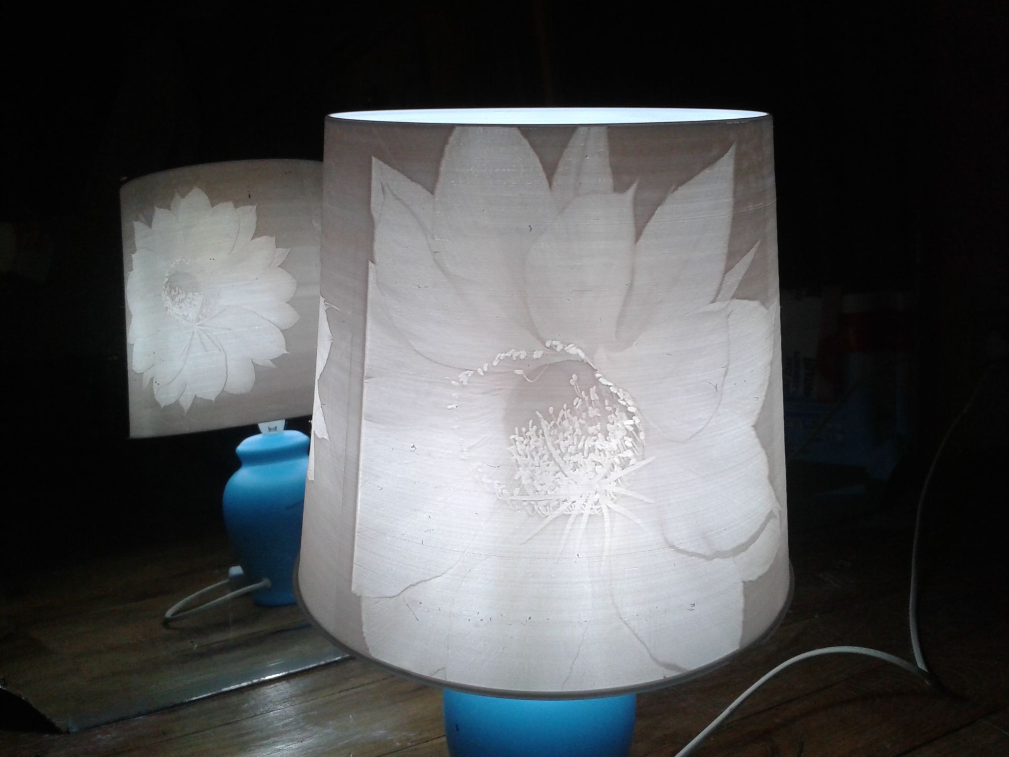

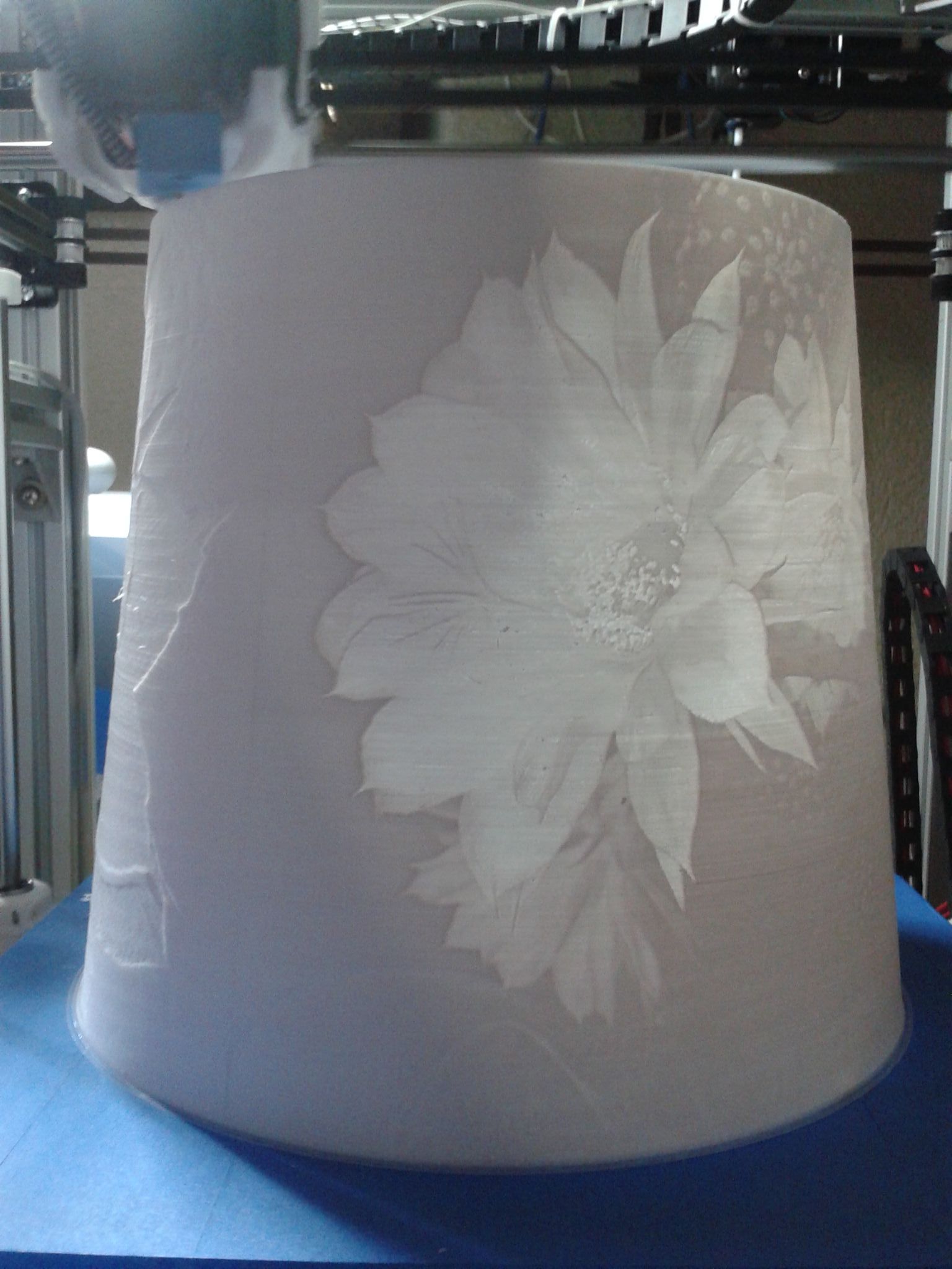

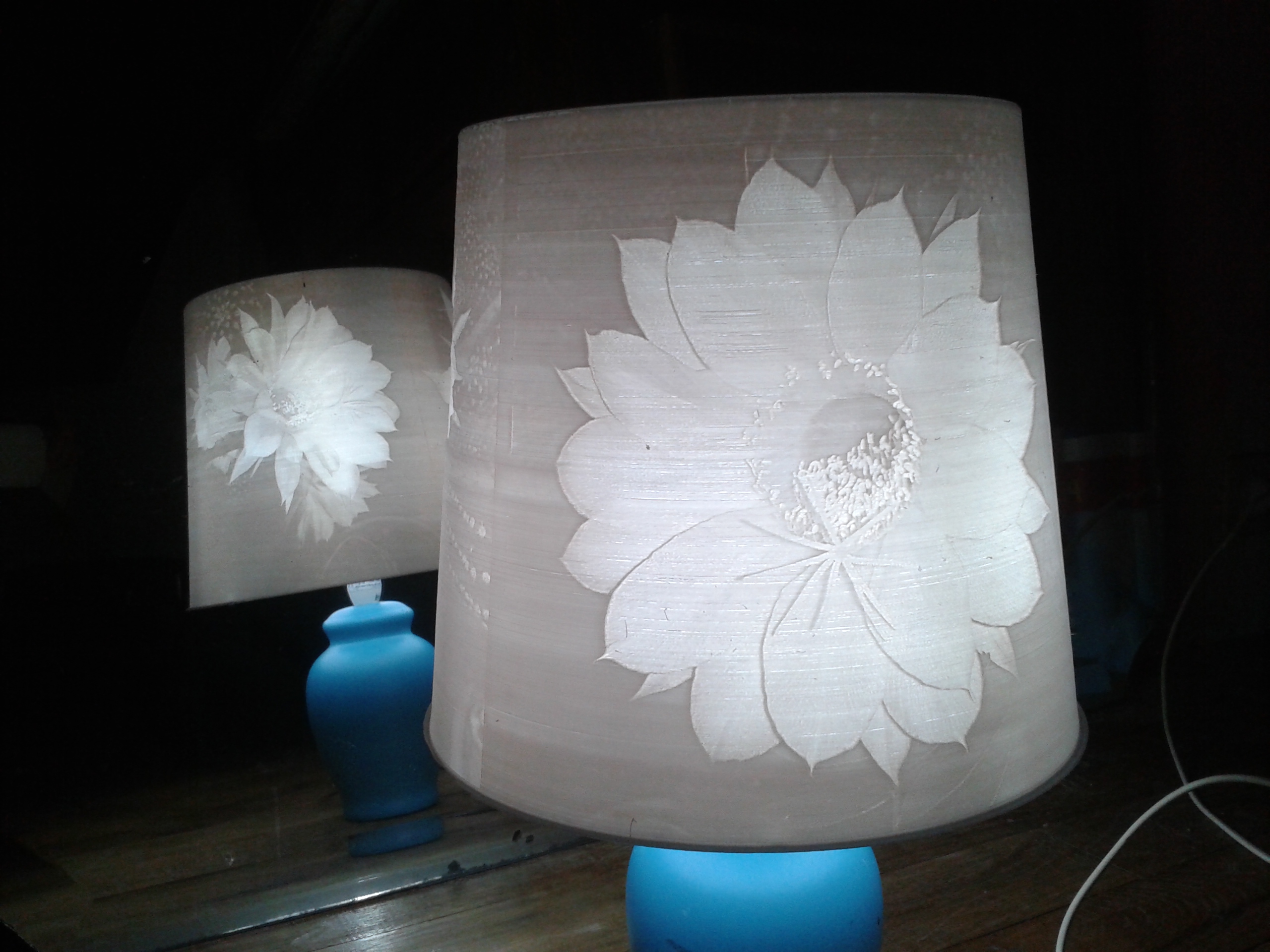

Abat-jour généré via https://lithophanemaker.com/Lamp Lithophane.html
Paramètres
Citation
Pictures: 20180712_075858.jpg,20180714_124030.jpg,20180713_083606.jpg,,
Height Control: Crop Photos Equally
Lithophane Resolution: 0.25
Top Diameter: 200
Bottom Diameter: 250
Number of Half-Waves: 0
Size of Waves: -10
Height: 225
Base Width and Height: 2
Overhang Angle: 45
Maximum Thickness: 2.4
Minimum Thickness: 0.3
Spacing Between Pictures: 10
Spacing Brightness: 0
Frame Options: Ledge Interface
Ledge Diameter: 27.6
Ledge Height: 25
Cylinder Diameter: 33.4
Cylinder and Ledge Thickness: 2.5
Spoke Thickness: 5.1 Semble très fragile !
Spoke Depth: 5 Semble très fragile !

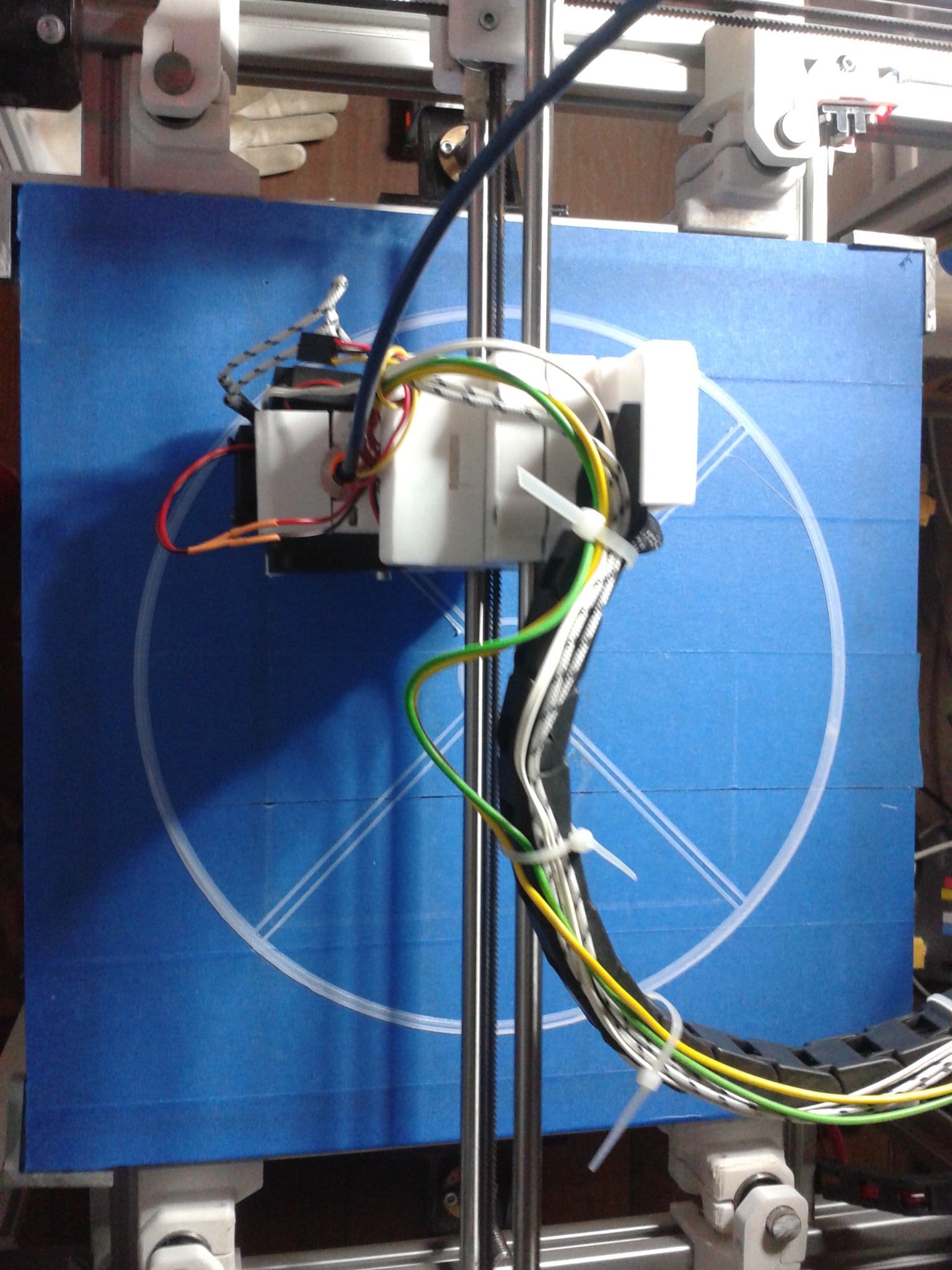

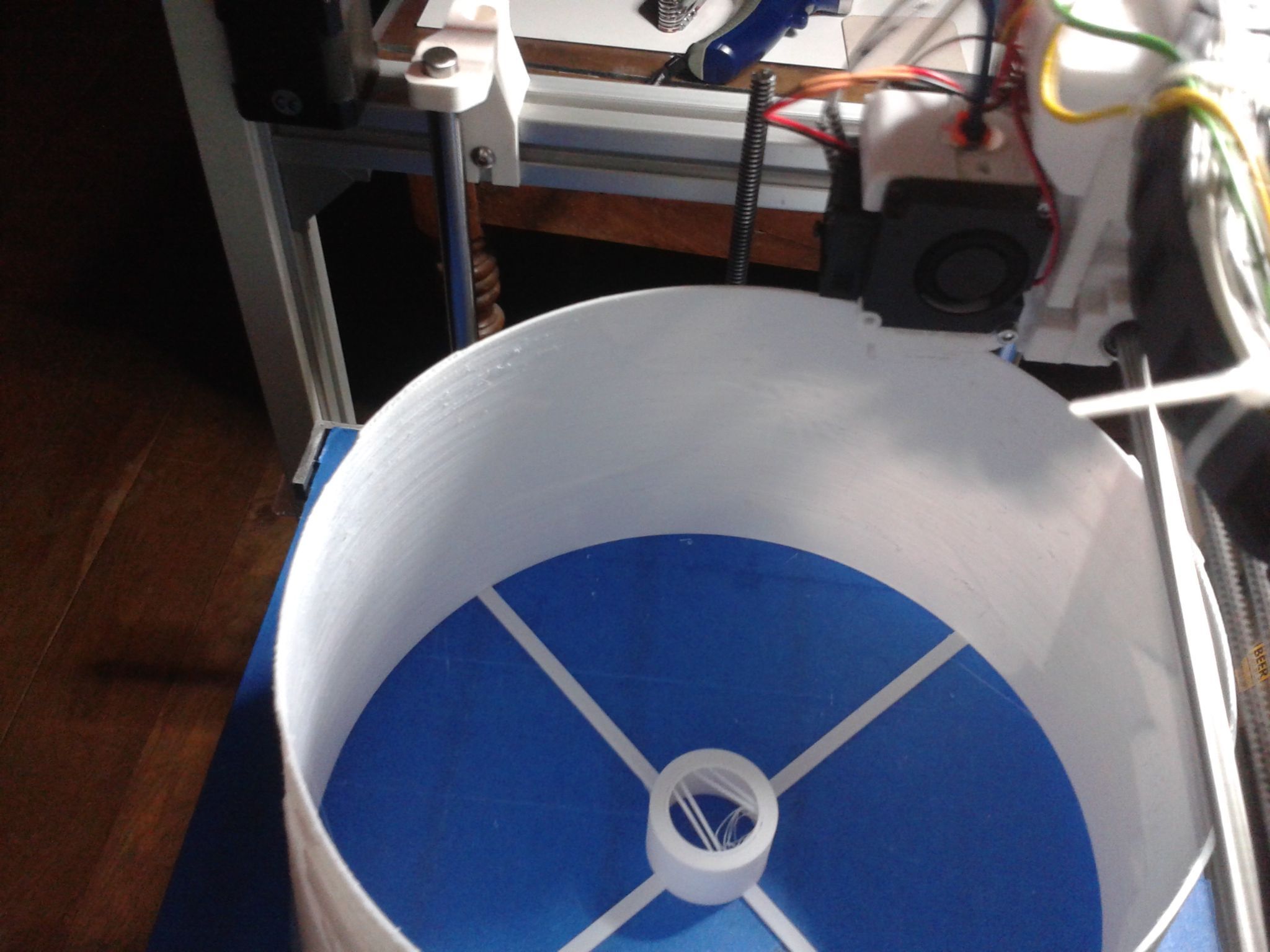

Imprimante : HyperCube Evo by @Pepone ( https://www.lesimprimantes3d.fr/forum/topic/42265-vendu-hypercube-300x300x300-et-fournitures/ ) Buse de 0.3mm
Trancheur : Ultimaker Cura 4.9.1, Hauteur de couches : 0.24 mm, 192°C (plateau 60°C couche initial puis 0°C) Vitesse d’impression 80mm/s
Estimation : Filament 103.63m ~322g Durée : ~25h43min / Réalisé : ~26h57min
Filament : GEEETECH PLA 1.75 mm Blanc
