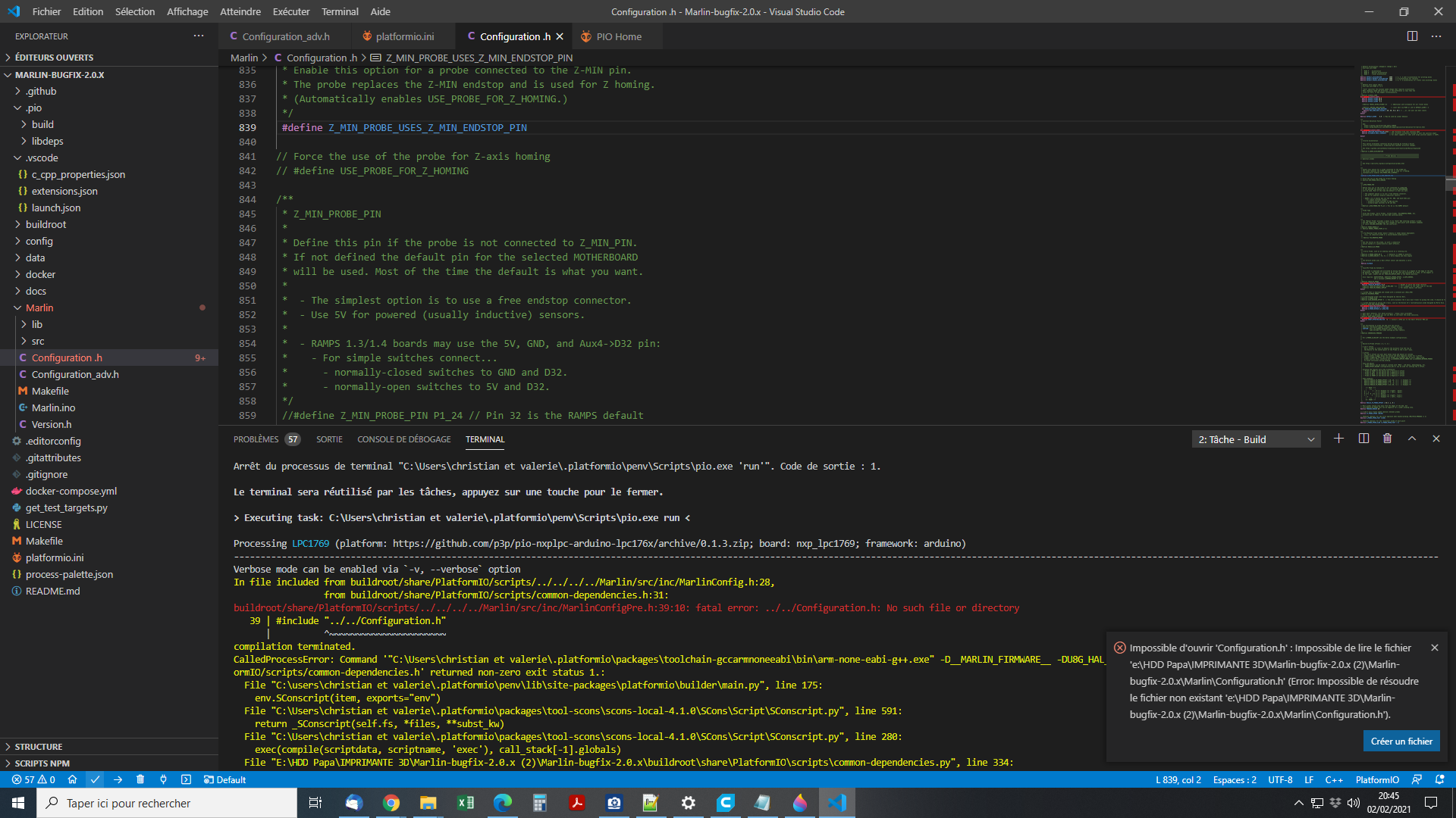

{ "resource": "/e:/HDD Papa/IMPRIMANTE 3D/Marlin-bugfix-2.0.x/Marlin/src/inc/SanityCheck.h", "owner": "cpp", "severity": 8, "message": "#error \"Z_SAFE_HOMING is recommended when homing with a probe. Enable it or comment out this line to continue.\"", "startLineNumber": 1404, "startColumn": 6, "endLineNumber": 1404, "endColumn": 6 } In file included from Marlin\src\HAL\LPC1768\../../inc/MarlinConfig.h:49, from Marlin\src\HAL\LPC1768\HAL.cpp:24: Marlin\src\HAL\LPC1768\../../inc/SanityCheck.h:1404:6: error: #error "Z_SAFE_HOMING is recommended when homing with a probe. Enable it or comment out this line to continue." 1404 | #error "Z_SAFE_HOMING is recommended when homing with a probe. Enable it or comment out this line to continue." | ^~~~~ In file included from Marlin\src\HAL\LPC1768\../../inc/MarlinConfig.h:49, from Marlin\src\HAL\LPC1768\HAL_SPI.cpp:51: Marlin\src\HAL\LPC1768\../../inc/SanityCheck.h:1404:6: error: #error "Z_SAFE_HOMING is recommended when homing with a probe. Enable it or comment out this line to continue." 1404 | #error "Z_SAFE_HOMING is recommended when homing with a probe. Enable it or comment out this line to continue." | ^~~~~ In file included from Marlin\src\HAL\LPC1768\../../core/../inc/MarlinConfig.h:49, from Marlin\src\HAL\LPC1768\../../core/serial.h:24, from Marlin\src\HAL\LPC1768\DebugMonitor.cpp:25: Marlin\src\HAL\LPC1768\../../core/../inc/SanityCheck.h:1404:6: error: #error "Z_SAFE_HOMING is recommended when homing with a probe. Enable it or comment out this line to continue." 1404 | #error "Z_SAFE_HOMING is recommended when homing with a probe. Enable it or comment out this line to continue." | ^~~~~ Compiling .pio\build\LPC1769\src\src\HAL\LPC1768\include\digipot_mcp4451_I2C_routines.c.o In file included from Marlin\src\HAL\LPC1768\../../inc/MarlinConfig.h:49, from Marlin\src\HAL\LPC1768\eeprom_flash.cpp:39: Marlin\src\HAL\LPC1768\../../inc/SanityCheck.h:1404:6: error: #error "Z_SAFE_HOMING is recommended when homing with a probe. Enable it or comment out this line to continue." 1404 | #error "Z_SAFE_HOMING is recommended when homing with a probe. Enable it or comment out this line to continue." | ^~~~~ In file included from Marlin\src\HAL\LPC1768\../../inc/MarlinConfig.h:49, from Marlin\src\HAL\LPC1768\eeprom_sdcard.cpp:25: Marlin\src\HAL\LPC1768\../../inc/SanityCheck.h:1404:6: error: #error "Z_SAFE_HOMING is recommended when homing with a probe. Enable it or comment out this line to continue." 1404 | #error "Z_SAFE_HOMING is recommended when homing with a probe. Enable it or comment out this line to continue." | ^~~~~ In file included from Marlin\src\HAL\LPC1768\../../inc/MarlinConfig.h:49, from Marlin\src\HAL\LPC1768\eeprom_wired.cpp:24: Marlin\src\HAL\LPC1768\../../inc/SanityCheck.h:1404:6: error: #error "Z_SAFE_HOMING is recommended when homing with a probe. Enable it or comment out this line to continue." 1404 | #error "Z_SAFE_HOMING is recommended when homing with a probe. Enable it or comment out this line to continue." | ^~~~~ Compiling .pio\build\LPC1769\src\src\HAL\LPC1768\include\i2c_util.c.o Compiling .pio\build\LPC1769\src\src\HAL\LPC1768\main.cpp.o *** [.pio\build\LPC1769\src\src\HAL\LPC1768\HAL.cpp.o] Error 1 *** [.pio\build\LPC1769\src\src\HAL\LPC1768\HAL_SPI.cpp.o] Error 1 *** [.pio\build\LPC1769\src\src\HAL\LPC1768\DebugMonitor.cpp.o] Error 1 *** [.pio\build\LPC1769\src\src\HAL\LPC1768\eeprom_flash.cpp.o] Error 1 *** [.pio\build\LPC1769\src\src\HAL\LPC1768\eeprom_sdcard.cpp.o] Error 1 *** [.pio\build\LPC1769\src\src\HAL\LPC1768\eeprom_wired.cpp.o] Error 1 In file included from Marlin\src\HAL\LPC1768\../../inc/MarlinConfig.h:49, from Marlin\src\HAL\LPC1768\main.cpp:34: Marlin\src\HAL\LPC1768\../../inc/SanityCheck.h:1404:6: error: #error "Z_SAFE_HOMING is recommended when homing with a probe. Enable it or comment out this line to continue." 1404 | #error "Z_SAFE_HOMING is recommended when homing with a probe. Enable it or comment out this line to continue." | ^~~~~ *** [.pio\build\LPC1769\src\src\HAL\LPC1768\main.cpp.o] Error 1 =================================================================================================== [FAILED] Took 6.17 seconds =================================================================================================== Environment Status Duration ------------- -------- ------------ LPC1769 FAILED 00:00:06.172 ============================================================================================== 1 failed, 0 succeeded in 00:00:06.172 ==============================================================================================Arrêt du processus de terminal "C:\Users\christian et valerie\.platformio\penv\Scripts\pio.exe 'run'". Code de sortie : 1. Le terminal sera réutilisé par les tâches, appuyez sur une touche pour le fermer. > Executing task: C:\Users\christian et valerie\.platformio\penv\Scripts\pio.exe run < Processing LPC1769 (platform: https://github.com/p3p/pio-nxplpc-arduino-lpc176x/archive/0.1.3.zip; board: nxp_lpc1769; framework: arduino) -----------------------------------------------------------------------------------------------------------------------------------------------------------------------------------------------------------------------------------Verbose mode can be enabled via `-v, --verbose` option CONFIGURATION: https://docs.platformio.org/page/boards/nxplpc-arduino-lpc176x/nxp_lpc1769.html PLATFORM: NXP Arduino LPC176x (0.1.3) > NXP LPC1769 HARDWARE: LPC1769 120MHz, 31.97KB RAM, 464KB Flash DEBUG: Current (cmsis-dap) On-board (cmsis-dap) External (blackmagic, jlink) PACKAGES: - framework-arduino-lpc176x 0.2.6 - toolchain-gccarmnoneeabi 1.90301.200702 (9.3.1) Converting Marlin.ino LDF: Library Dependency Finder -> http://bit.ly/configure-pio-ldf LDF Modes: Finder ~ off, Compatibility ~ strict Found 3 compatible libraries Scanning dependencies... Dependency Graph |-- <Servo> 1.0.0 |-- <TMCStepper> 0.7.1 |-- <U8glib-HAL> 0.4.3 Building in release mode error:Command 'cmd /C dir H:\' returned non-zero exit status 1. error:Command 'cmd /C dir I:\' returned non-zero exit status 1. error:Command 'cmd /C dir J:\' returned non-zero exit status 1. error:Command 'cmd /C dir K:\' returned non-zero exit status 1. error:Command 'cmd /C dir L:\' returned non-zero exit status 1. Unable to find destination disk (Autodetect Error) Please select it in platformio.ini using the upload_port keyword (https://docs.platformio.org/en/latest/projectconf/section_env_upload.html) or copy the firmware (.pio/build/LPC1769/firmware.bin) manually to the appropriate disk Compiling .pio\build\LPC1769\src\src\HAL\LPC1768\DebugMonitor.cpp.o Compiling .pio\build\LPC1769\src\src\HAL\LPC1768\HAL.cpp.o Compiling .pio\build\LPC1769\src\src\HAL\LPC1768\HAL_SPI.cpp.o Compiling .pio\build\LPC1769\src\src\HAL\LPC1768\eeprom_flash.cpp.o Compiling .pio\build\LPC1769\src\src\HAL\LPC1768\eeprom_sdcard.cpp.o Compiling .pio\build\LPC1769\src\src\HAL\LPC1768\eeprom_wired.cpp.o Compiling .pio\build\LPC1769\src\src\HAL\LPC1768\main.cpp.o Compiling .pio\build\LPC1769\src\src\HAL\LPC1768\tft\tft_spi.cpp.o In file included from Marlin\src\HAL\LPC1768\../../core/../inc/MarlinConfig.h:49, from Marlin\src\HAL\LPC1768\../../core/serial.h:24, from Marlin\src\HAL\LPC1768\DebugMonitor.cpp:25: Marlin\src\HAL\LPC1768\../../core/../inc/SanityCheck.h:1404:6: error: #error "Z_SAFE_HOMING is recommended when homing with a probe. Enable it or comment out this line to continue." 1404 | #error "Z_SAFE_HOMING is recommended when homing with a probe. Enable it or comment out this line to continue." | ^~~~~ In file included from Marlin\src\HAL\LPC1768\../../inc/MarlinConfig.h:49, from Marlin\src\HAL\LPC1768\HAL_SPI.cpp:51: Marlin\src\HAL\LPC1768\../../inc/SanityCheck.h:1404:6: error: #error "Z_SAFE_HOMING is recommended when homing with a probe. Enable it or comment out this line to continue." 1404 | #error "Z_SAFE_HOMING is recommended when homing with a probe. Enable it or comment out this line to continue." | ^~~~~ In file included from Marlin\src\HAL\LPC1768\../../inc/MarlinConfig.h:49, from Marlin\src\HAL\LPC1768\HAL.cpp:24: Marlin\src\HAL\LPC1768\../../inc/SanityCheck.h:1404:6: error: #error "Z_SAFE_HOMING is recommended when homing with a probe. Enable it or comment out this line to continue." 1404 | #error "Z_SAFE_HOMING is recommended when homing with a probe. Enable it or comment out this line to continue." | ^~~~~ In file included from Marlin\src\HAL\LPC1768\../../inc/MarlinConfig.h:49, from Marlin\src\HAL\LPC1768\eeprom_flash.cpp:39: Marlin\src\HAL\LPC1768\../../inc/SanityCheck.h:1404:6: error: #error "Z_SAFE_HOMING is recommended when homing with a probe. Enable it or comment out this line to continue." 1404 | #error "Z_SAFE_HOMING is recommended when homing with a probe. Enable it or comment out this line to continue." | ^~~~~ In file included from Marlin\src\HAL\LPC1768\../../inc/MarlinConfig.h:49, from Marlin\src\HAL\LPC1768\eeprom_sdcard.cpp:25: Marlin\src\HAL\LPC1768\../../inc/SanityCheck.h:1404:6: error: #error "Z_SAFE_HOMING is recommended when homing with a probe. Enable it or comment out this line to continue." 1404 | #error "Z_SAFE_HOMING is recommended when homing with a probe. Enable it or comment out this line to continue." | ^~~~~ In file included from Marlin\src\HAL\LPC1768\../../inc/MarlinConfig.h:49, from Marlin\src\HAL\LPC1768\main.cpp:34: Marlin\src\HAL\LPC1768\../../inc/SanityCheck.h:1404:6: error: #error "Z_SAFE_HOMING is recommended when homing with a probe. Enable it or comment out this line to continue." 1404 | #error "Z_SAFE_HOMING is recommended when homing with a probe. Enable it or comment out this line to continue." | ^~~~~ In file included from Marlin\src\HAL\LPC1768\../../inc/MarlinConfig.h:49, from Marlin\src\HAL\LPC1768\eeprom_wired.cpp:24: Marlin\src\HAL\LPC1768\../../inc/SanityCheck.h:1404:6: error: #error "Z_SAFE_HOMING is recommended when homing with a probe. Enable it or comment out this line to continue." 1404 | #error "Z_SAFE_HOMING is recommended when homing with a probe. Enable it or comment out this line to continue." | ^~~~~ In file included from Marlin\src\HAL\LPC1768\tft\../../../inc/MarlinConfig.h:49, from Marlin\src\HAL\LPC1768\tft\tft_spi.cpp:23: Marlin\src\HAL\LPC1768\tft\../../../inc/SanityCheck.h:1404:6: error: #error "Z_SAFE_HOMING is recommended when homing with a probe. Enable it or comment out this line to continue." 1404 | #error "Z_SAFE_HOMING is recommended when homing with a probe. Enable it or comment out this line to continue." | ^~~~~ *** [.pio\build\LPC1769\src\src\HAL\LPC1768\DebugMonitor.cpp.o] Error 1 *** [.pio\build\LPC1769\src\src\HAL\LPC1768\HAL_SPI.cpp.o] Error 1 *** [.pio\build\LPC1769\src\src\HAL\LPC1768\eeprom_flash.cpp.o] Error 1 *** [.pio\build\LPC1769\src\src\HAL\LPC1768\HAL.cpp.o] Error 1 *** [.pio\build\LPC1769\src\src\HAL\LPC1768\main.cpp.o] Error 1 *** [.pio\build\LPC1769\src\src\HAL\LPC1768\eeprom_sdcard.cpp.o] Error 1 *** [.pio\build\LPC1769\src\src\HAL\LPC1768\eeprom_wired.cpp.o] Error 1 *** [.pio\build\LPC1769\src\src\HAL\LPC1768\tft\tft_spi.cpp.o] Error 1 =================================================================================================== [FAILED] Took 5.40 seco -

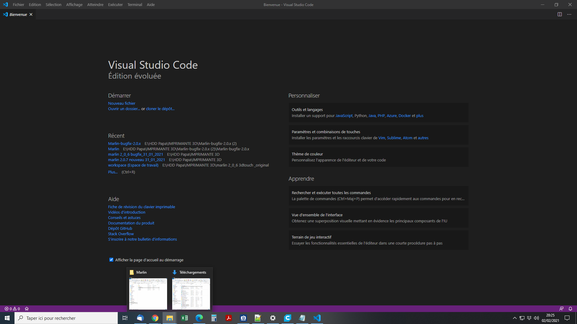

je n'ai meme pas le martien de pio je suis vraiment un boulet avec ce logiciel vola ce que j'ai quand j'ouvre VS alors ensuite je galere pour trouver PIO -

Bonsoir, je n'ai pas eu le temps de m'occuper de mon imprimante avant j'ai bien reçu vos fichiers de configurations (merci) mais j'ai encore un soucis si je valide cette ligne # define Z_MIN_PROBE_USE_Z_MIN_ENDSTOP_PIN quelque soit les autres lignes validées ou non j'ai forcement une erreur de débogage -
