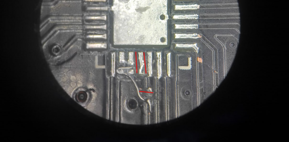

  3. Hi! Thanks! I did it! Mostly because of your schematics! Spoiler, you can flash bootloader with build-in UART! Just doing some soldering (3.3v to BOOT0). Also 2208 is working... all was correct, i just short something acidently By the way! Where did you get schematics? Longer support refuse to share it. But they shared bootloader! bootloader for LKx.zip

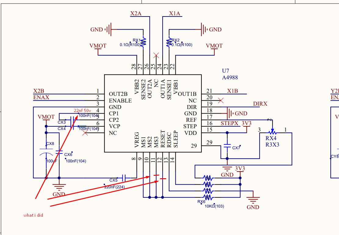

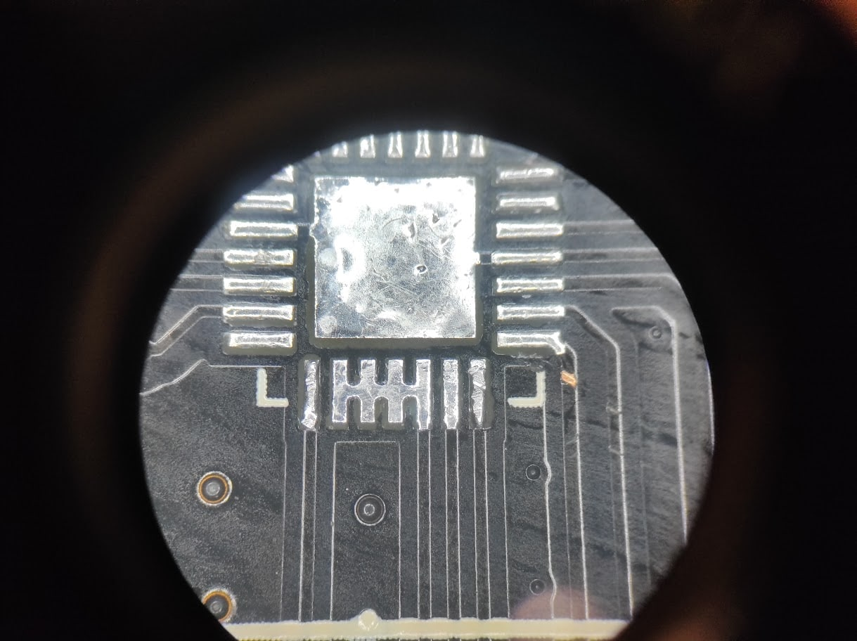

  5. Hi Hobi! Sorry for my english here I did try to replace drive X with 2208 by cutting 11 and 12 legs and replacing 100nF capacitor with 22nF 50v. But it died with agony What else should i do? Or i shouldn't replace only one driver? I see your board is for 2 drivers. ______________________________ Update! I was wrong. Looks like i just short something during my first attempt. Second attepmt was fine... So it was easy.. but i better test all legs together on shots before connecting it to power. But now its working always backwards I think STM32F103VET6 is damaged. Guys, is it possible that after replacing 4988 with 2208 - it works allways in one dir... so marlin has to be changed? (don't think so)
  6. Can you share your thoughts about it? I've read that 2208 comparing to 4988 don't need lags 11 and 12 to be connected and capacitor should be changed to 22uf (https://www.reddit.com/r/3Dprinting/comments/bgrg63/reworking_creality_ender_3_v113_board_with/) So thats what i did. What do you think else should be done?

  8. Hi Hobi! Sorry for my english here I did try to replace drive X with 2208 by cutting 11 and 12 legs and replacing 100nF capacitor with 22nF 50v. But it died with agony What else should i do? Or i shouldn't replace only one driver? I see your board is for 2 drivers.
