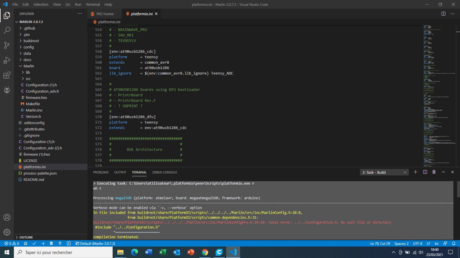

  13. Benoitj39
    I3 Pro W 3D Touch
    " > Executing task: C:\Users\utilisateur\.platformio\penv\Scripts\platformio.exe run < Processing mega2560 (platform: atmelavr; board: megaatmega2560; framework: arduino) -----------------------------------------------------------------------------------------------------------------------------------------------------------------------------------Verbose mode can be enabled via `-v, --verbose` option In file included from buildroot/share/PlatformIO/scripts/../../../../Marlin/src/inc/MarlinConfig.h:28:0, from buildroot/share/PlatformIO/scripts/common-dependencies.h:31: buildroot/share/PlatformIO/scripts/../../../../Marlin/src/inc/MarlinConfigPre.h:39:10: fatal error: ../../Configuration.h: No such file or directory #include "../../Configuration.h" ^~~~~~~~~~~~~~~~~~~~~~~ compilation terminated. CalledProcessError: Command 'avr-g++.exe -D__MARLIN_FIRMWARE__ -D__MARLIN_DEPS__ -w -dM -E -x c++ buildroot/share/PlatformIO/scripts/common-dependencies.h' returned non-zero exit status 1.: File "C:\Users\utilisateur\.platformio\penv\Lib\site-packages\platformio\builder\main.py", line 175: env.SConscript(item, exports="env") File "C:\Users\utilisateur\.platformio\packages\tool-scons\scons-local-4.1.0\SCons\Script\SConscript.py", line 591: return _SConscript(self.fs, *files, **subst_kw) File "C:\Users\utilisateur\.platformio\packages\tool-scons\scons-local-4.1.0\SCons\Script\SConscript.py", line 280: exec(compile(scriptdata, scriptname, 'exec'), call_stack[-1].globals) File "C:\Users\utilisateur\Desktop\marlin 220321\Marlin-2.0.7.2\buildroot\share\PlatformIO\scripts\common-dependencies.py", line 286: apply_features_config() File "C:\Users\utilisateur\Desktop\marlin 220321\Marlin-2.0.7.2\buildroot\share\PlatformIO\scripts\common-dependencies.py", line 118: if not env.MarlinFeatureIsEnabled(feature): File "C:\Users\utilisateur\.platformio\packages\tool-scons\scons-local-4.1.0\SCons\Util.py", line 658: return self.method(*nargs, **kwargs) File "C:\Users\utilisateur\Desktop\marlin 220321\Marlin-2.0.7.2\buildroot\share\PlatformIO\scripts\common-dependencies.py", line 262: load_marlin_features() File "C:\Users\utilisateur\Desktop\marlin 220321\Marlin-2.0.7.2\buildroot\share\PlatformIO\scripts\common-dependencies.py", line 250: define_list = subprocess.check_output(cmd, shell=True).splitlines() File "C:\Users\utilisateur\.platformio\python3\lib\subprocess.py", line 424: return run(*popenargs, stdout=PIPE, timeout=timeout, check=True, File "C:\Users\utilisateur\.platformio\python3\lib\subprocess.py", line 528: raise CalledProcessError(retcode, process.args, =========================================================================== [FAILED] Took 1.34 seconds =========================================================================== Environment Status Duration ------------- -------- ------------ mega2560 FAILED 00:00:01.337 ====================================================================== 1 failed, 0 succeeded in 00:00:01.337 ======================================================================The terminal process "C:\Users\utilisateur\.platformio\penv\Scripts\platformio.exe 'run'" terminated with exit code: 1. Terminal will be reused by tasks, press any key to close it.

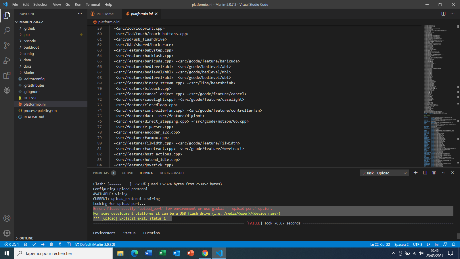

  14. Benoitj39
    I3 Pro W 3D Touch
    remibora,,ca me met failed a la fin, pourtant j'ai suivi ton tuto a la lettre
  15. Benoitj39
    I3 Pro W 3D Touch
    merci , mais comment je fait pour ouvrir configuration.h , avec arduino il ne veut pas l'ouvrir car il se termine pas par ino ou pde!!; car je le fait depuis un ordi,
