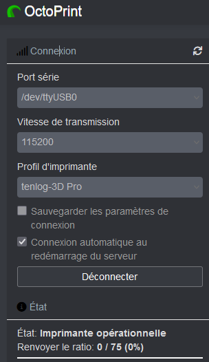

  6. Bonsoir et merci pour votre réponse. Si dessous les informations demandées : ================================== Versions actuelles ------------------------------ OctoPrint: 1.10.2 Canal de diffusion : Installée: 1.10.2 Disponible: 1.10.2 Notes de versions: https://github.com/OctoPrint/OctoPrint/releases/tag/1.10.2 Cost Estimation: 3.5.0 Canal de diffusion : Installée: 3.5.0 Disponible: V3.5.0 Notes de versions: https://github.com/OllisGit/OctoPrint-CostEstimation/releases/tag/3.5.0 Dashboard Plugin: 1.19.11 Canal de diffusion : Installée: 1.19.11 Disponible: 1.19.11 Notes de versions: https://github.com/j7126/OctoPrint-Dashboard/releases/tag/1.19.11 File Check Plugin: 2024.3.27 Canal de diffusion : Installée: 2024.3.27 Disponible: 2024.3.27 Notes de versions: https://github.com/OctoPrint/OctoPrint-FileCheck/releases/tag/2024.3.27 Firmware Check Plugin: 2021.10.11 Canal de diffusion : Installée: 2021.10.11 Disponible: 2021.10.11 Notes de versions: https://github.com/OctoPrint/OctoPrint-FirmwareCheck/releases/tag/2021.10.11 Pi Support Plugin: 2023.10.10 Canal de diffusion : Installée: 2023.10.10 Disponible: 2023.10.10 Notes de versions: https://github.com/OctoPrint/OctoPrint-PiSupport/releases/tag/2023.10.10 Themeify: 1.2.2 Installée: 1.2.2 Disponible: v1.2.2 Notes de versions: https://github.com/Birkbjo/OctoPrint-Themeify/releases/tag/v1.2.2 ================================== Extensions installées ------------------------------ Achievements Plugin Gina Häußge Achievements & stats about your OctoPrint instance AGPLv3 Python >=3.7,<4 | | Action Command Notification Support Gina Häußge Allows your printer to trigger notifications via action commands on the connection AGPLv3 Python >=3.7,<4 | | Action Command Prompt Support Gina Häußge Allows your printer to trigger prompts via action commands on the connection AGPLv3 Python >=3.7,<4 | | Announcement Plugin Gina Häußge Announcements all around OctoPrint AGPLv3 Python >=3.7,<4 | | Anonymous Usage Tracking Page d'accueil Gina Häußge Anonymous version and usage tracking, see homepage for details on what gets tracked AGPLv3 Python >=3.7,<4 | | Application Keys Plugin Gina Häußge, Aldo Hoeben Implements a workflow for third party clients to obtain API keys AGPLv3 Python >=3.7,<4 | | Backup & Restore Gina Häußge Backup & restore your OctoPrint settings and data AGPLv3 Python >=3.7,<4 | | Classic Webcam Christian Würthner Provides a simple webcam viewer in OctoPrint's UI, images provided by an MJPEG webcam. AGPLv3 Python >=3.7,<4 | | Core Wizard Gina Häußge Provides wizard dialogs for core components and functionality AGPLv3 Python >=3.7,<4 | | Cost Estimation (3.5.0) Page d'accueil Sven Lohrmann, Olli Displays the estimated print cost for the loaded model AGPLv3 Python >=2.7,<4 | | Dashboard (1.19.11) Page d'accueil j7126 A dashboard tab for Octoprint that displays the most relevant info regarding the state of the printer and any on-going print jobs. AGPLv3 Python >=2.7,<4 | | Discovery Page d'accueil Gina Häußge Makes the OctoPrint instance discoverable via Bonjour/Avahi/Zeroconf and uPnP AGPLv3 Python >=3.7,<4 | | Error Tracking Gina Häußge AGPLv3 Python >=3.7,<4 | | Event Manager jneilliii Plugin to configure event subscriptions available in config.yaml. AGPLv3 Python >=3.7,<4 | | File Check (2024.3.27) Page d'accueil Gina Häußge Checks for common issues in uploaded files AGPLv3 Python >3.7,<4 | | Firmware Check (2021.10.11) Page d'accueil Gina Häußge Checks for unsafe or broken printer firmwares AGPLv3 Python >=2.7,<4 | | GCode Viewer Gina Häußge Provides a GCODE viewer in OctoPrint's UI. AGPLv3 Python >=3.7,<4 | | Logging Shawn Bruce, based on work by Gina Häußge and Marc Hannappel Provides access to OctoPrint's logs and logging configuration. AGPLv3 Python >=3.7,<4 | | Pi Support Plugin (2023.10.10) Page d'accueil Gina Häußge Provides additional information about your Pi in the UI. AGPLv3 Python >=2.7,<4
  7. Bonjour les marker, J'ai utilisé pendant des années une CR10s et un Octoprint. Maintenant, je suis sur Tenlog 3d pro et j'ai conservé l'Octoprint, l'envoi de gcode fonctionne très bien et sont bien exécutés sur l'imprimante. Au détail près, que par Octoprint, je n'ai aucune indication sur la progression du Print, contrairement à une utilisation depuis la SD. Et surtout, la perte de la possibilité de mettre le print en pause et changer la vitesse. Y a-t-il une possibilité de retrouver ces fonctions.
