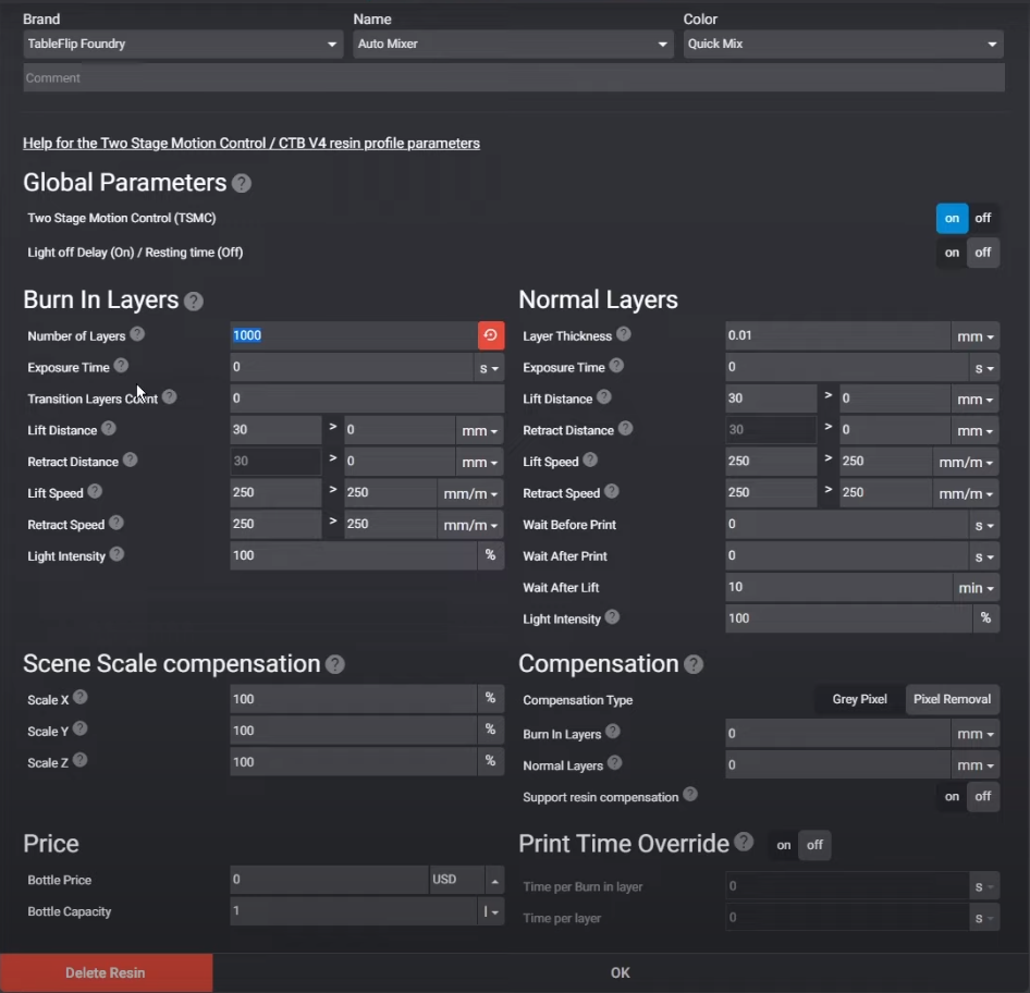

Salutation !
Faire un vrai fichier d'impression, pour faire une fausse impression ( aucune expositions UV mais un home et des déplacements du plateau ) afin de mélanger la résine dans le VAT ...
Qui a un avis ?
Perso je me dis, pourquoi pas.
Mais aussi que cela peut vite devenir un bon moyen de bien abîmer un FEP ou un écran de masquage (et de retrouver de la résine partout) si l'on a un morceau de résine durcie qui traîne dans le VAT ou sur le plateau.
Donc au final, a chacun de décider si c'est un bon outil ou non 🙂

TableFlip Foundry Auto Mixer code for Resin 3D Printing.
10-30-60 Infinite-Mix-TableFlip-Foundry files are to be used for infinite long term mixing. The numbers correspond with the wait time in minustes between mixing cycles.
QuickMix-TableFlip-Foundry profile is meant to be used if you let resin sit in your vat for a few days and you dont want to mix by hand. You just give the FEP a little quick stir with a silicone spatula, then run the QuickMix. 10-15 minutes should suffice. Long enough for you to prepare a file and get a drink.
MixNPrint-TableFlip-Foundry profile will give your resin a 3 mixing cycle run and then automatically load a print afterwards. The print file must be named print.ctb for it to work. This isn't meant to be used as a full mixing cycle. This profile is just to give you a little extra insurance before printing that you've got a fairly good mix before a print starts.
WARNINGS:
Although all of these files use very simple gcode commands to run and have been tested on my own machines extensively, TableFlip Foundry does not accept any liability or responsibility for any negative results that occur as a result of using these files.
You use the files included with this document at your own risk.
PLEASE VERIFY YOUR BUILD PLATE AND VAT ARE CLEAR OF PRINTED BITS BEFORE RUNNING ANY OF THESE FILES. If you do not, you will have a bad day.
You cannot rename the files, or they will cease to work.

Pour les profiles ... une capture d'un des profil créé dans la vidéo mentionné.
