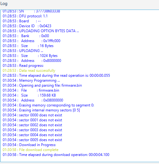

djscholas Posté(e) Juillet 26, 2023 Auteur Partager Posté(e) Juillet 26, 2023 (modifié) Still the same, damaged, mirrored and upsidedown @MrMagounet any ideas ? I also flashed your marlin firmware to check it but nothing changed Modifié (le) Juillet 26, 2023 par djscholas Lien vers le commentaire Partager sur d’autres sites More sharing options...
MrMagounet Posté(e) Juillet 26, 2023 Partager Posté(e) Juillet 26, 2023 Il y a 1 heure, djscholas a dit : Still the same, damaged, mirrored and upsidedown @MrMagounet any ideas ? I also flashed your marlin firmware to check it but nothing changed it's mirrored but not trun to 180° now, but it's the first time i see this on an Artillery Hooo i have see your tft board is in version 1.4 , when have you buy your X2 ? I have see tft board in v1.0 with STM32F107, and V1.2 & v1.3 with GD32F305, but it's the first time i see a Version 1.4 i think artillery have made a new version of TFT board with some incompatibility with BTT firmware . I have see this issue on BTT tft screen when the firmware is not really compatible with board version. Lien vers le commentaire Partager sur d’autres sites More sharing options...
djscholas Posté(e) Juillet 26, 2023 Auteur Partager Posté(e) Juillet 26, 2023 Il y a 3 heures, MrMagounet a dit : it's mirrored but not trun to 180° now, but it's the first time i see this on an Artillery Hooo i have see your tft board is in version 1.4 , when have you buy your X2 ? I have see tft board in v1.0 with STM32F107, and V1.2 & v1.3 with GD32F305, but it's the first time i see a Version 1.4 i think artillery have made a new version of TFT board with some incompatibility with BTT firmware . I have see this issue on BTT tft screen when the firmware is not really compatible with board version. I bought it few weeks ago. Also saw that on your firmware printer doesnt work - nothing works when i put whatever on tft (axis movement, temp. Up/down etc). That firmware works well https://blog.freakydu.de/posts/2022-09-30-flash_marlin_sidewinderx2/ . So I should wait I think ? Lien vers le commentaire Partager sur d’autres sites More sharing options...
MrMagounet Posté(e) Juillet 26, 2023 Partager Posté(e) Juillet 26, 2023 il y a 35 minutes, djscholas a dit : I bought it few weeks ago. Also saw that on your firmware printer doesnt work - nothing works when i put whatever on tft (axis movement, temp. Up/down etc). That firmware works well https://blog.freakydu.de/posts/2022-09-30-flash_marlin_sidewinderx2/ . So I should wait I think ? My firmware marlin is set up with baud transfert at 250.000, in this case le tft firmware must be put on 250.000 bauds too. but yes i think the firmware of freakydu work fine, it's just a news version of tft board not compatible with BTT TFT firmware , artillery don't want to sen us nformation regarding the real modiciation, it's very difficult de support a printer with 4 différent tft board on the same printer model. Currently if you want to use the BTT firmware it was necessary to replace the tft board by a board v1, v1.2 or v1.3. Sorry i haven't other solution now Lien vers le commentaire Partager sur d’autres sites More sharing options...

MrMagounet Posté(e) Septembre 5, 2023 Partager Posté(e) Septembre 5, 2023 il y a 26 minutes, djscholas a dit : Marlin firmware 2.1, now i have TFT firmware from Artillery www site and printer works well. But before that i tried install an firmware from your tutorial on this forum, dedicated to GD tft chipset i think Gioto or cioto GitHub - something like that If you have a TFT with MCU GD32F305 & bootloader 3.0.5 is necessary to install Ciotto TFT firmware, and if it's my marlin 2.1.2 you must put je TFT baudrate to 250.000. If you must use Artillery TFT firmware it's possible to adjust Baud to 250.000 on the config.txt before install the tft firmware. N.B : Apparently Artillery send now some new TFT card version using a new bootloader, and incompatible with Btt firmware. Lien vers le commentaire Partager sur d’autres sites More sharing options...
Schalonsus Posté(e) Janvier 23 Partager Posté(e) Janvier 23 Hello, i stumbled across this thread in research of my problem... I found the solution, you have to compile with a different LCD driver, Artillery used some other LCD displays at some point https://github.com/bigtreetech/BIGTREETECH-TouchScreenFirmware/issues/2391#issuecomment-1905893052 Lien vers le commentaire Partager sur d’autres sites More sharing options...
