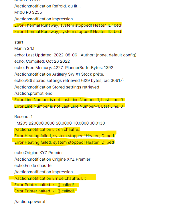

Dannyloic Posté(e) Décembre 8, 2023 Auteur Posté(e) Décembre 8, 2023 voila le résultat de pronterface l'impression a bien démarrer et s'arrête . je s tresse un peu. Loading file: E:\petit crochets mural_0.16mm_PLA_X1_13m.gcode Loaded E:\petit crochets mural_0.16mm_PLA_X1_13m.gcode, 13057 lines 52.87cm of filament used in this print The print goes: - from 10.00 mm to 164.54 mm in X and is 154.54 mm wide - from 0.20 mm to 169.45 mm in Y and is 169.25 mm deep - from 0.00 mm to 17.00 mm in Z and is 17.00 mm high Estimated duration: 107 layers, 0:11:46 Connecting... start Printer is now online. Marlin 2.1.1 echo: Last Updated: 2022-08-06 | Author: (none, default config) echo: Compiled: Oct 26 2022 echo: Free Memory: 4227 PlannerBufferBytes: 1392 //action:notification Artillery SW X1 Stock prête. echo:V86 stored settings retrieved (629 bytes; crc 30617) //action:notification Stored settings retrieved //action:prompt_end Setting hotend temperature to 200 degrees Celsius. //action:notification E1 en chauffe... Setting bed temperature to 60 degrees Celsius. //action:notification Refroid. du lit... //action:notification Artillery SW X1 Stock prête. Print started at: 10:05:06 M205 B20000.0000 S0.0000 T0.0000 J0.0130 //action:notification Lit en chauffe... //action:notification Impression //action:notification E1 en chauffe... //action:notification Impression //action:notification Impression //action:notification Lit en chauffe... //action:notification Impression echo:Unknown command: "@BEDLEVELVISUALIZER" //action:notification Mesure point 1/9 //action:notification Mesure point 2/9 //action:notification Mesure point 3/9 //action:notification Mesure point 4/9 //action:notification Mesure point 5/9 //action:notification Mesure point 6/9 //action:notification Mesure point 7/9 //action:notification Mesure point 8/9 //action:notification Mesure point 9/9 //action:notification Impression Bilinear Leveling Grid: 0 1 2 0 +0.820 +0.040 -0.552 1 +0.885 +0.073 -0.445 2 +0.595 -0.017 -0.360 echo:Bed Leveling ON echo:Fade Height 3.00 M106 P0 S0 M106 P0 S127 //action:notification Refroid. du lit... M106 P0 S255 //action:notification Impression Error:Thermal Runaway, system stopped! Heater_ID: bed Error:Thermal Runaway, system stopped! Heater_ID: bed start Marlin 2.1.1 echo: Last Updated: 2022-08-06 | Author: (none, default config) echo: Compiled: Oct 26 2022 echo: Free Memory: 4227 PlannerBufferBytes: 1392 //action:notification Artillery SW X1 Stock prête. echo:V86 stored settings retrieved (629 bytes; crc 30617) //action:notification Stored settings retrieved //action:prompt_end Error:Line Number is not Last Line Number+1, Last Line: 0 Error:Line Number is not Last Line Number+1, Last Line: 0 Resend: 1 M205 B20000.0000 S0.0000 T0.0000 J0.0130 //action:notification Lit en chauffe... Error:Heating failed, system stopped! Heater_ID: bed Error:Heating failed, system stopped! Heater_ID: bed echo:Origine XYZ Premier //action:notification Origine XYZ Premier echo:Err de chauffe //action:notification Impression //action:notification Err de chauffe: Lit Error:Printer halted. kill() called! Error:Printer halted. kill() called! //action:poweroff
pascal_lb Posté(e) Décembre 8, 2023 Posté(e) Décembre 8, 2023 il y a 3 minutes, Dannyloic a dit : Error:Heating failed, system stopped! Heater_ID: bed Error:Heating failed, system stopped! Heater_ID: bed Je pense que là tu as ta réponse, c'est un problème de chauffe sur ton lit
Dannyloic Posté(e) Décembre 8, 2023 Auteur Posté(e) Décembre 8, 2023 bizarre je n'avais pas ce soucis avant de changer de firm et passé sous Molise . que doit je faire ? 2eme test avec interface impression qui n'a pas bloquer je ne comprend plus rien Loading file: E:\petit crochets mural_0.16mm_PLA_X1_13m.gcode Loaded E:\petit crochets mural_0.16mm_PLA_X1_13m.gcode, 13057 lines 52.87cm of filament used in this print The print goes: - from 10.00 mm to 164.54 mm in X and is 154.54 mm wide - from 0.20 mm to 169.45 mm in Y and is 169.25 mm deep - from 0.00 mm to 17.00 mm in Z and is 17.00 mm high Estimated duration: 107 layers, 0:11:46 Connecting... start Printer is now online. Marlin 2.1.1 echo: Last Updated: 2022-08-06 | Author: (none, default config) echo: Compiled: Oct 26 2022 echo: Free Memory: 4227 PlannerBufferBytes: 1392 //action:notification Artillery SW X1 Stock prête. echo:V86 stored settings retrieved (629 bytes; crc 11550) //action:notification Stored settings retrieved //action:prompt_end Print started at: 13:23:51 M205 B20000.0000 S0.0000 T0.0000 J0.0130 //action:notification Lit en chauffe... //action:notification Impression //action:notification E1 en chauffe... //action:notification E1 en chauffe... //action:notification Impression //action:notification Lit en chauffe... //action:notification Impression echo:Unknown command: "@BEDLEVELVISUALIZER" //action:notification Mesure point 1/9 //action:notification Mesure point 2/9 //action:notification Mesure point 3/9 //action:notification Mesure point 4/9 //action:notification Mesure point 5/9 //action:notification Mesure point 6/9 //action:notification Mesure point 7/9 //action:notification Mesure point 8/9 //action:notification Mesure point 9/9 //action:notification Impression Bilinear Leveling Grid: 0 1 2 0 -0.230 -0.362 -0.225 1 -0.235 -0.322 -0.132 2 -0.505 -0.412 +0.018 echo:Bed Leveling ON echo:Fade Height 3.00 M106 P0 S0 M106 P0 S127 //action:notification Refroid. du lit... M106 P0 S255 //action:notification Impression M106 P0 S0 M106 P0 S0 //action:notification Refroid. du lit... //action:notification Artillery SW X1 Stock prête. //action:notification Artillery SW X1 Stock prête. Print ended at: 13:43:59 and took 0:20:07
MrMagounet Posté(e) Décembre 8, 2023 Posté(e) Décembre 8, 2023 Sur l'action tu haut comme dis par pascal tu as des thermal runaway qui serve a protéger la machine de soucis d'emballement thermique. Du coup cela passe la machine en arrêt d'urgence A noter l'a notification que tu avais signaler @bedvizualizer unknow command, regarde dans ton start Gcode de ton slicer et commente la ligne qui contient @bedvizualizer Ton soucis me fait très fortement pensé au cable du bed endommager dans la gaine, qui a soit un soucis avec l'un des 2 fils de l'alim du pad chauffant, soit de la sonde thermique sur plateau, si avec les mouvements plateau le fils dans la gain bouge cela explique la panne aléatoire. Exemple si le cable de la sonde thermique en bougant ne permet plus de remonter l'infos de la sonde tu as avoir pour Marlin un retour de température relevé de -15°c des que marlin a un relevé a -15°c pour lui c'est qu'il y a une panne et met en sécurité la machine.
Dannyloic Posté(e) Décembre 8, 2023 Auteur Posté(e) Décembre 8, 2023 merci donc que doit je faire changer le cable de la sonde? et qu'entend tu par "commente la ligne qui contient @bedvizualizer " ? je supprime @bedvizualizer de mon gcode de démarrage ? désolé pour toutes les questions quand ont débute c'est pas evident merci encore
MrMagounet Posté(e) Décembre 8, 2023 Posté(e) Décembre 8, 2023 il y a 5 minutes, Dannyloic a dit : merci donc que doit je faire changer le cable de la sonde? et qu'entend tu par "commente la ligne qui contient @bedvizualizer " ? je supprime @bedvizualizer de mon gcode de démarrage ? désolé pour toutes les questions quand ont débute c'est pas evident merci encore Soit tu supprimer la ligne avec le bedvisualizer soit tu place un ; en début de ligne pour commenté la ligne Pour le cable cela peu provenir de cable de la sonde mais aussi de la paire qui controle la chauffe du pad thermique, sur une X1 soit tu change tom pad thermique en entier car il inclus la résistance chauffante mais aussi la sonde thermique et le câble qui permet la connexion a la carte mère. Soit tu entaille la gain pour la retirer et contrôler l'état des câbles et remplacer ce qui est abimé la je ne pourrais pas t'aidé plus car a partir de la faut avoir la machine sous les oeil pour la dépanner

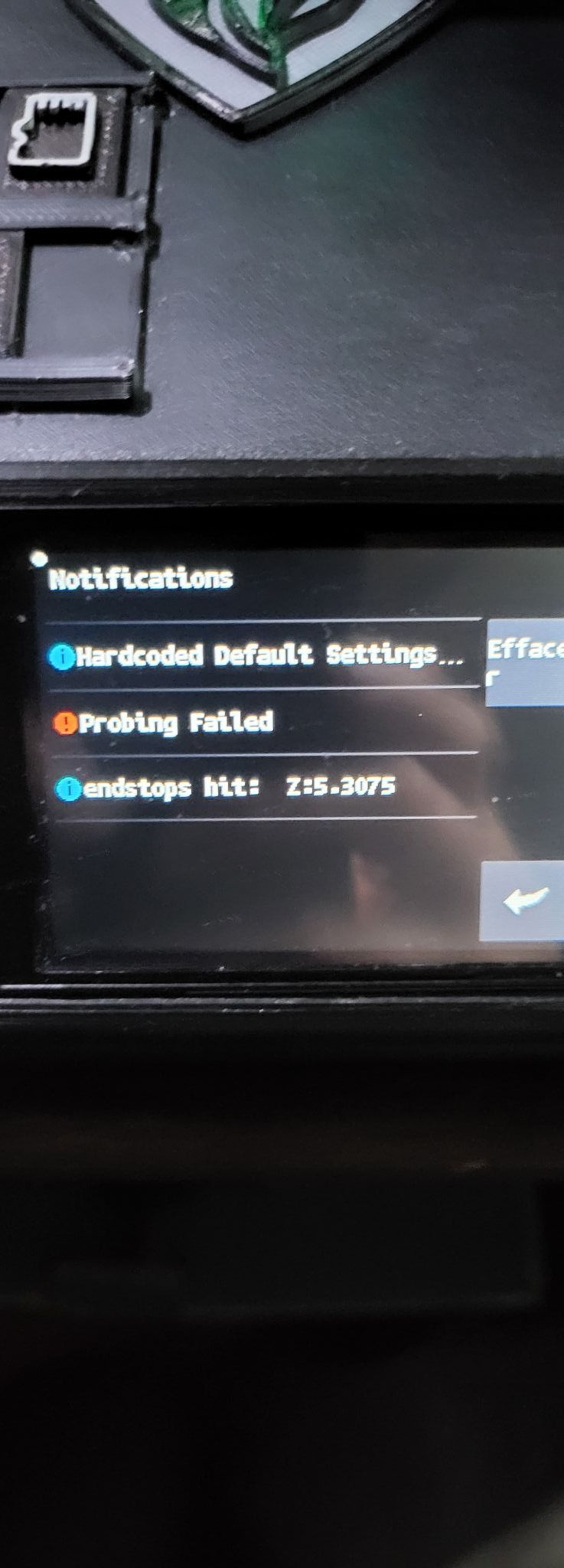

Dannyloic Posté(e) Décembre 22, 2023 Auteur Posté(e) Décembre 22, 2023 bonjour je reviens vers vous pour donner des nouvelles de ma sidewinder x1 . après avoir reçu et monter mon nouveau bed j'en ai profiter pour changer mon hotend ( corp, buse et sonde ). une fois le tout installer j'ai remis le tft et le firm marlin 2.07 touchmi . premier test de calibrage et palpation plateau pas de soucis , je lance une impression et la comme au debut la tête s'arrête et bloque l'imprimante, donc redémarrage .je relance une seconde impression et la re blocage . je n'en peut plus depuis ce soucis j'ai changer le moteur de la tête d'impression , les nappes , les trois circuit imprimés de nappe , le plateau chauffant et rien ne va il me reste a changer la carte mere et les drivers et la machine sera neuve . mais est ce bien ca ou un problème de firmware je ne sais plus quoi faire
