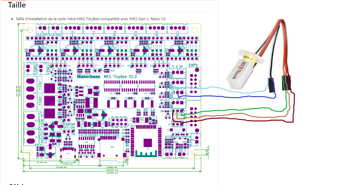

bonjour je viens d installer une carte MKS tinybee avec écran tactile 2.4pouces l'écran s'allume je peux naviguer dans les différents menu mais l'imprimante ne réagie pas ci-joint les fichiers config et le message d'erreur quand je décommente la ligne 2649 #define MKS_ROBIN_TFT24 from Marlin/src/HAL/ESP32/../../inc/MarlinConfig.h:28, from Marlin/src/HAL/ESP32/HAL.cpp:24: Marlin/src/HAL/ESP32/../../inc/../HAL/ESP32/inc/Conditionals_LCD.h:25:4: error: #error "Sorry! TFT displays are not available for HAL/ESP32." #error "Sorry! TFT displays are not available for HAL/ESP32." ^ In file included from Marlin/src/HAL/ESP32/../../inc/MarlinConfigPre.h:52:0, from Marlin/src/HAL/ESP32/../../inc/MarlinConfig.h:28, from Marlin/src/HAL/ESP32/HAL_SPI.cpp:25: Marlin/src/HAL/ESP32/../../inc/../HAL/ESP32/inc/Conditionals_LCD.h:25:4: error: #error "Sorry! TFT displays are not available for HAL/ESP32." #error "Sorry! TFT displays are not available for HAL/ESP32." ^ In file included from Marlin/src/HAL/ESP32/../../inc/MarlinConfigPre.h:52:0, from Marlin/src/HAL/ESP32/../../inc/MarlinConfig.h:28, from Marlin/src/HAL/ESP32/Servo.cpp:24: Marlin/src/HAL/ESP32/../../inc/../HAL/ESP32/inc/Conditionals_LCD.h:25:4: error: #error "Sorry! TFT displays are not available for HAL/ESP32." #error "Sorry! TFT displays are not available for HAL/ESP32." ^ In file included from Marlin/src/HAL/ESP32/../../core/../inc/MarlinConfigPre.h:37:0, from Marlin/src/HAL/ESP32/../../core/serial_base.h:24, from Marlin/src/HAL/ESP32/../../core/serial_hook.h:24, from Marlin/src/HAL/ESP32/FlushableHardwareSerial.h:27, from Marlin/src/HAL/ESP32/FlushableHardwareSerial.cpp:25: Marlin/src/HAL/ESP32/../../core/../inc/../core/macros.h:64:0: warning: "FORCE_INLINE" redefined #define FORCE_INLINE __attribute__((always_inline)) inline ^ In file included from Marlin/src/HAL/ESP32/FlushableHardwareSerial.h:26:0, from Marlin/src/HAL/ESP32/FlushableHardwareSerial.cpp:25: Marlin/src/HAL/ESP32/../shared/Marduino.h:86:0: note: this is the location of the previous definition #define FORCE_INLINE inline __attribute__((always_inline)) ^ In file included from Marlin/src/HAL/ESP32/../../core/../inc/MarlinConfigPre.h:52:0, from Marlin/src/HAL/ESP32/../../core/serial_base.h:24, from Marlin/src/HAL/ESP32/../../core/serial_hook.h:24, from Marlin/src/HAL/ESP32/FlushableHardwareSerial.h:27, from Marlin/src/HAL/ESP32/FlushableHardwareSerial.cpp:25: Marlin/src/HAL/ESP32/../../core/../inc/../HAL/ESP32/inc/Conditionals_LCD.h:25:4: error: #error "Sorry! TFT displays are not available for HAL/ESP32." #error "Sorry! TFT displays are not available for HAL/ESP32." ^ cc1plus.exe: warning: unrecognized command line option '-Wno-register' *** [.pio\build\mks_tinybee\src\src\HAL\ESP32\FlushableHardwareSerial.cpp.o] Error 1 In file included from Marlin/src/HAL/ESP32/../../inc/MarlinConfig.h:49:0, from Marlin/src/HAL/ESP32/HAL.cpp:24: Marlin/src/HAL/ESP32/../../inc/SanityCheck.h:2725:6: error: #error "TFT_COLOR_UI, TFT_CLASSIC_UI, TFT_LVGL_UI is required for your TFT. Please enable one." #error "TFT_COLOR_UI, TFT_CLASSIC_UI, TFT_LVGL_UI is required for your TFT. Please enable one." ^ In file included from Marlin/src/HAL/ESP32/../../inc/MarlinConfig.h:49:0, from Marlin/src/HAL/ESP32/Servo.cpp:24: Marlin/src/HAL/ESP32/../../inc/SanityCheck.h:2725:6: error: #error "TFT_COLOR_UI, TFT_CLASSIC_UI, TFT_LVGL_UI is required for your TFT. Please enable one." #error "TFT_COLOR_UI, TFT_CLASSIC_UI, TFT_LVGL_UI is required for your TFT. Please enable one." ^ In file included from Marlin/src/HAL/ESP32/../../inc/MarlinConfig.h:49:0, from Marlin/src/HAL/ESP32/HAL_SPI.cpp:25: Marlin/src/HAL/ESP32/../../inc/SanityCheck.h:2725:6: error: #error "TFT_COLOR_UI, TFT_CLASSIC_UI, TFT_LVGL_UI is required for your TFT. Please enable one." #error "TFT_COLOR_UI, TFT_CLASSIC_UI, TFT_LVGL_UI is required for your TFT. Please enable one." ^ cc1plus.exe: warning: unrecognized command line option '-Wno-register' *** [.pio\build\mks_tinybee\src\src\HAL\ESP32\HAL.cpp.o] Error 1 cc1plus.exe: warning: unrecognized command line option '-Wno-register' *** [.pio\build\mks_tinybee\src\src\HAL\ESP32\Servo.cpp.o] Error 1 cc1plus.exe: warning: unrecognized command line option '-Wno-register' *** [.pio\build\mks_tinybee\src\src\HAL\ESP32\HAL_SPI.cpp.o] Error 1 ========================================================================================= [FAILED] Took 15.70 seconds ========================================================================================= Environment Status Duration ------------- -------- ------------ mks_tinybee FAILED 00:00:15.697 ==================================================================================== 1 failed, 0 succeeded in 00:00:15.697 ==================================================================================== Configuration.h Configuration_adv.h -

c'était un câble qui était défectueux ,ca fonctionne maintenant grand merci -

ca fonctionne les paramètre sont bien enregistrer mais toujours pas le 3dtouch je vérifier mon câblage encore 1 fois j'ai bien câblé je comprends pas? -

merci pour ta réponse ca fonctionne pas ,le 3dtouch ne réagie pas quand je pousse avec le doigt j'ai un message d'erreur quand je décommente //#define PINS_DEBUGGING quand je téléverse le firmware sur la carte en wifi ou en usb les modifications ne sont pas prise en compte ? je voudrai essayer de téléversé avec l'Arduino ide, quelle type de carte il faut sélectionné? -

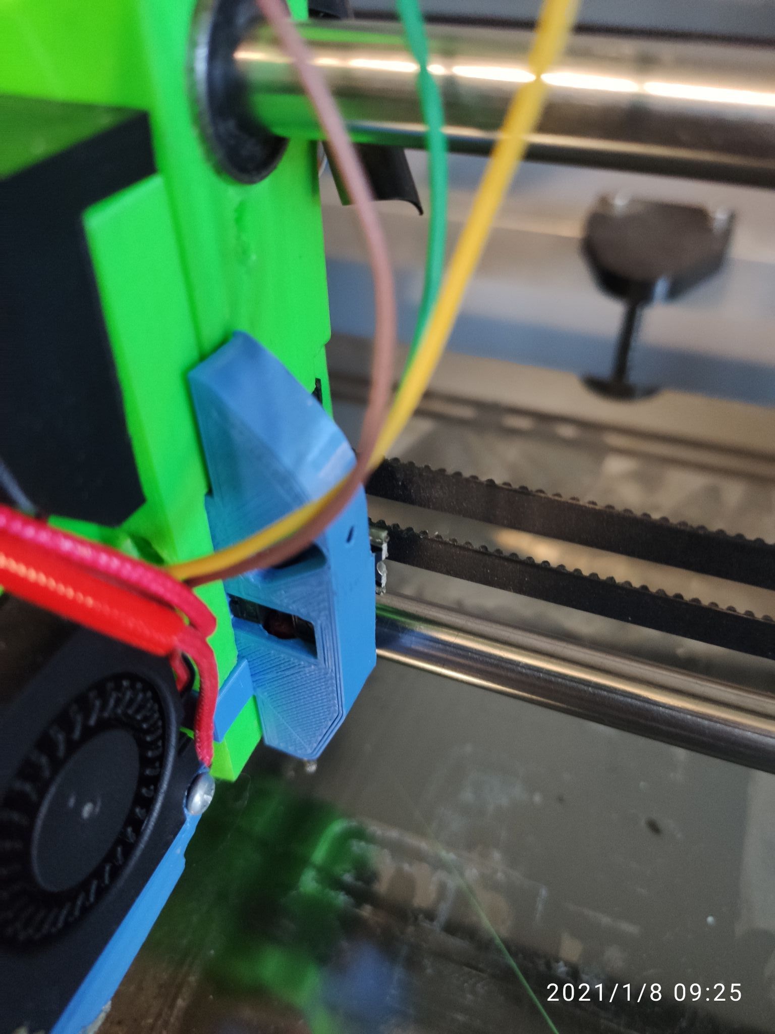

bonjour j'ai installer un 3dtouch sur ma hypercube Ngen nouvelle carte MKS tinybee ,écran TFT24 avant ramps 1.4 nouveau 3 dtouch avant touchmi fait maison dernier marlin 2.0.9.2 tous fonctionne sauf le 3dtouch il s allume mais ne réagie pas, la buse vient percuté le plateau j'ai remarqué aussi que quand je téléverse le firmware sur la carte, sur (ESP3D) les modifications( les réglages es pas en Z) ne sont pas prise en compte ,sauf si je les modifie sur ESP3D si je le fais en wifi les modif elle ne sont pas non plus prise en compte. je comprend pas? merci Configuration.txt.h Configuration_adv.txt.h

bonjour j ai suivi le tuto https://3dwork.io/configurar-marlin-2-0-x-desde-cero pour installer un 3d touch sur mon hypercube avec marlin-bugfix-2.0.x avec une ramps 1.4 le home du z se passe bien et aprés message d erreur ? Configuration_adv.h Configuration.h
