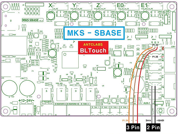

Zarrt Posté(e) Avril 28, 2018 Partager Posté(e) Avril 28, 2018 Bonjour à tous. quelqu’un a t il déjà connecté un BLTouch sur une MKS SBase (smoothiware) ? je m'arrache les cheveux depuis hier et rien n'y fait, j' ai suivi plusieurs tuto trouvé sur le net mais aucun ne semble fonctionner. mon X et mon Y ce déplacent correctement le Z monte et descend correctement mais lorsque je fais un home, X et Y ça va mais le Z viens "s’écraser" sur le plateau car le bltouch ne se déploie pas. j'ai connecté comme ceci : et mis cela dans le config.txt : ## Endstops # See http://smoothieware.org/endstops endstops_enable true # The endstop module is enabled by default and can be disabled here #corexy_homing false # Set to true if homing on a hbot or corexy #alpha_min_endstop 1.24!^ # Pin to read min endstop, add a ! to invert if endstop is NO connected to ground #alpha_max_endstop 1.25^ # Pin to read max endstop, uncomment this and comment the above if using max endstops alpha_homing_direction home_to_min # Or set to home_to_max and set alpha_max and uncomment the alpha_max_endstop alpha_min 0 # This gets loaded as the current position after homing when home_to_min is set alpha_max 200 # This gets loaded as the current position after homing when home_to_max is set beta_min_endstop 1.26^ # Pin to read min endstop, add a ! to invert if endstop is NO connected to ground #beta_max_endstop 1.27^ # Pin to read max endstop, uncomment this and comment the above if using max endstops beta_homing_direction home_to_min # Or set to home_to_max and set alpha_max and uncomment the alpha_max_endstop beta_min 0 # This gets loaded as the current position after homing when home_to_min is set beta_max 200 # This gets loaded as the current position after homing when home_to_max is set gamma_min_endstop nc #1.28!^ # Pin to read min endstop, add a ! to invert if endstop is NO connected to ground #gamma_max_endstop 1.29^ # Pin to read max endstop, uncomment this and comment the above if using max endstops gamma_homing_direction home_to_min # Or set to home_to_max and set alpha_max and uncomment the alpha_max_endstop gamma_min 0 # This gets loaded as the current position after homing when home_to_min is set gamma_max 200 # This gets loaded as the current position after homing when home_to_max is set /////////////////////////////////////////////////////////////// ## Z-probe # See http://smoothieware.org/zprobe zprobe.enable true # Set to true to enable a zprobe zprobe.probe_pin 1.28!^ # Pin probe is attached to, if NC remove the ! zprobe.slow_feedrate 5 # Mm/sec probe feed rate zprobe.debounce_count 100 # Set if noisy zprobe.fast_feedrate 100 # Move feedrate mm/sec zprobe.probe_height 5 # How much above bed to start probe #gamma_min_endstop 1.28!^ # Normally 1.28. Change to nc to prevent conflict, ##BLTouch Servo Settings switch.servo.enable true switch.servo.input_on_command M280 switch.servo.input_off_command M281 switch.servo.output_pin 1.24 switch.servo.output_type hwpwm switch.servo.pwm_period_ms 20 alpha_min_endstop 1.25!^ une idée ???? Lien vers le commentaire Partager sur d’autres sites More sharing options...
Vanvan Posté(e) Avril 28, 2018 Partager Posté(e) Avril 28, 2018 (modifié) Moi j'ai connecté un bl touch, as tu installé le dernier firmware ? Vas regader là : config.txt Modifié (le) Avril 28, 2018 par Vanvan Lien vers le commentaire Partager sur d’autres sites More sharing options...

Zarrt Posté(e) Avril 29, 2018 Auteur Partager Posté(e) Avril 29, 2018 @Vanvan Bonjour, Bien, tout fonctionne correctement grâce à ton aide, 10000 merci le problème venait de la version du firmware après mise à jour nickel. par contre encore un petit soucis pas grave mais "pénible" les moteurs Z (branchés avec un câble en Y) font un bruit étrange quand ils sont en attente genre un "pchhhhhhh" c'est grave docteur ? Lien vers le commentaire Partager sur d’autres sites More sharing options...
