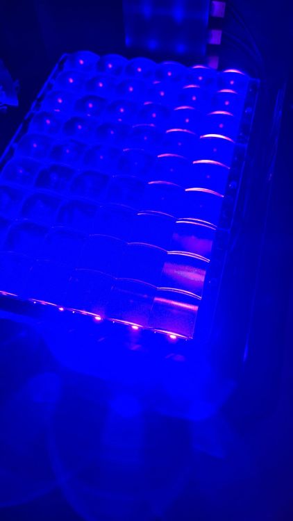

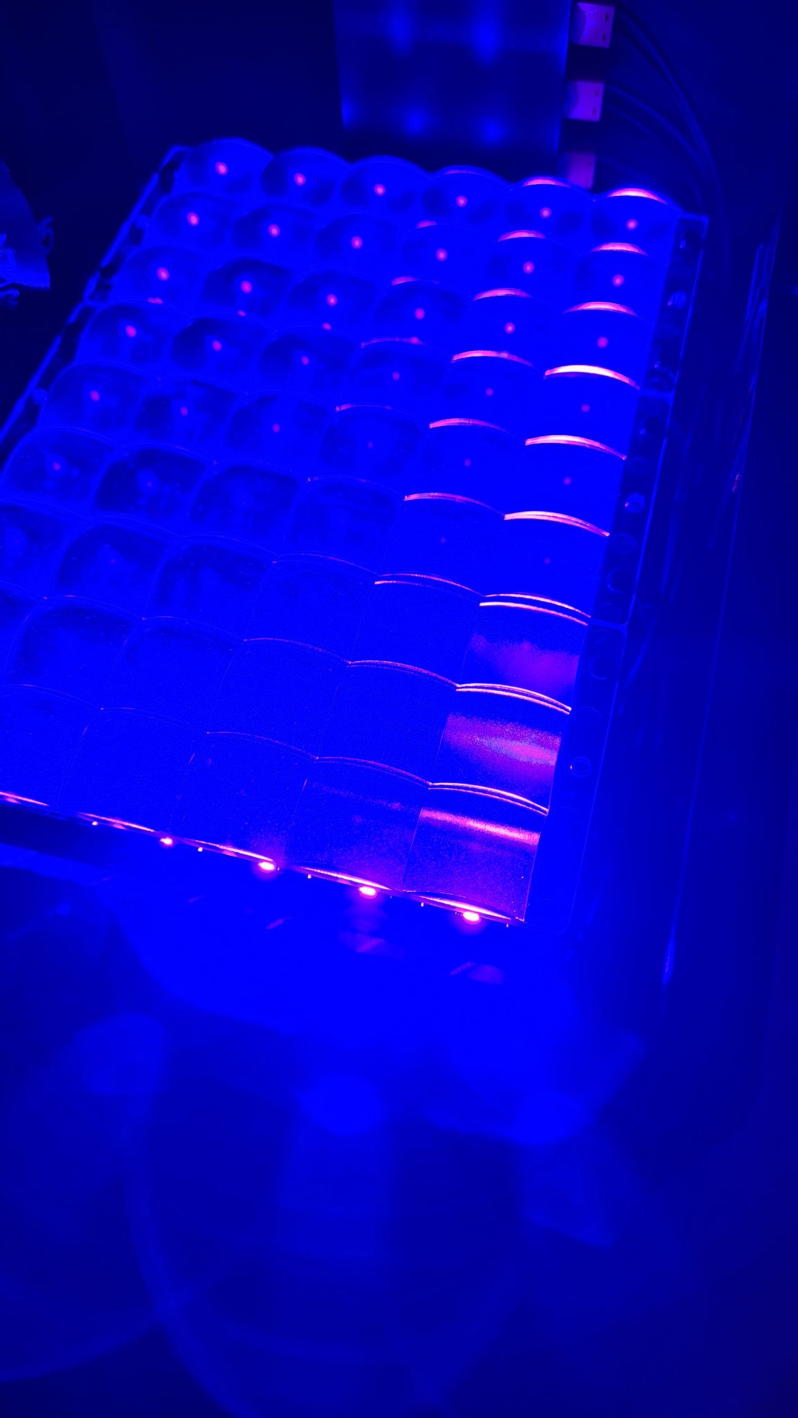

A tu déjà regardé https://blog.honzamrazek.cz/2021/06/fixing-the-backlight-always-on-problem-on-elegoo-saturn/
( lien trouvé sur un groupe Facebook ( il me semble que c'est ELEGOO SATURN JUPITER FRANCE ) Qui explique que cela peut venir d'un Mosfet sur la carte mère et qu'il est possible si tu a les compétences et le fer a souder qui vont bien d'en utiliser un autre (mosfet) qui se trouve sur la carte, mais non utilisé ... )

I was wondering what causes the problems, so I reached out to a few of them if they would be willing to send me the broken motherboard. One of them did (thank you!) and I started to investigate what’s wrong. TLDR: The fix is easy and costs you nothing if you know how to solder.
What’s wrong?
The LEDs are driven via a boost converter that outputs a constant current. This driver is located on a separate board. There are actually three of them – one for each array of LEDs. The turning on and off of the LEDs is not done via pulling an enable pin of the boost convert driver IC but there is a dedicated MOSFET on the mainboard, that switches the power for these boost converters. You can find them on the photo below (it is the left-most transistor). I also attach a schematics of the connection:
The right-most transistor controls the LEDs
Screenshot-from-2021-06-06-08-41-44-1024
The schematics of the switch circuit
After measuring the transistor the problem is clear – the transistor is dead. It is shot-throught and it is always conductive. I have also confirmed this after removing the transistor.
How to fix it? Replace the transistor. Luckily, the manufacturer gave us a spare transitor. The middle transistor is not used for anything, therefore, we can desolder it and solder it instead of the broken transistor. Easy-peasy.
IMG_20210604_142404-1-1024x780.jpg Swapped transistors. Note that I wasn’t carefull and I broke the gate trace. This is why I replaced it with a piece of wire.
After swapping the transistors, the board works again!
Sinon au plus simple, changer la carte mère. (donc demander au SAV de Elegoo https://www.elegoo.com/pages/support si encore sous garantie )
