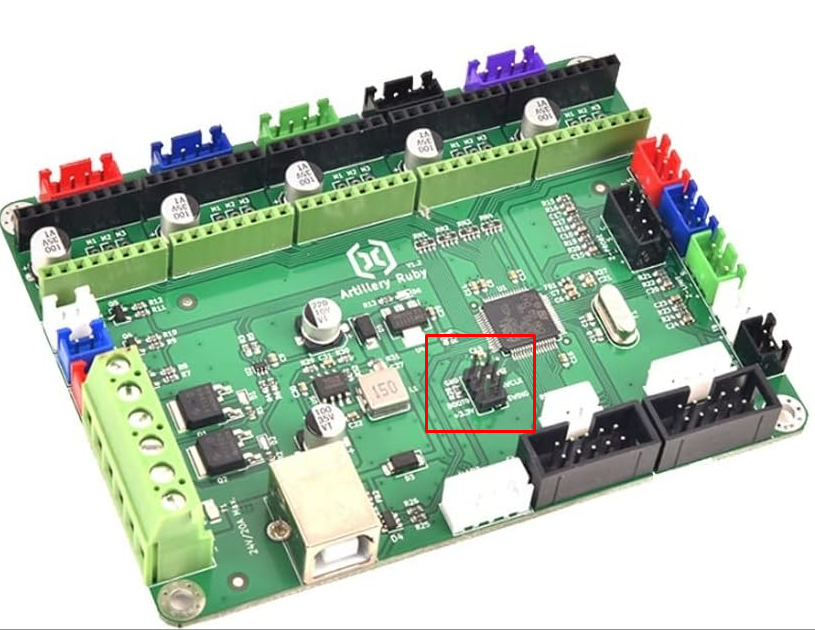

djscholas Posté(e) Juillet 23, 2023 Posté(e) Juillet 23, 2023 Hello, Im here because of the movie with firmware update where i found this link: I need help because during firmware flashing electricity in my house was turned off and i cant do anything with printer :( Just tried to update Marlin firmware from freakydude from GitHub update via pronterface and stm35. After I download firmware via stm32 and install to printe, then reset it, and was great but I didn’t save my Z offset and Extrusion data before… so I tried to go a step back and install old backup firmware again via stm32. So Conner to pronterface, M997, than stm32 and install backup firmware. then reset printer and… I tried to connect with pronterface to reset eprom and… protnerface can’t see printer via usb cable… also any tryouts to axis movement via touch screen on printer asp doesn’t work. Looks like everything failed… how can I put into printer firmware again when pc don’t see it via cable ? @MrMagounet Help me please

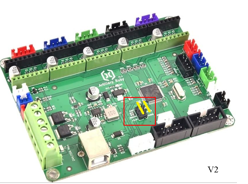

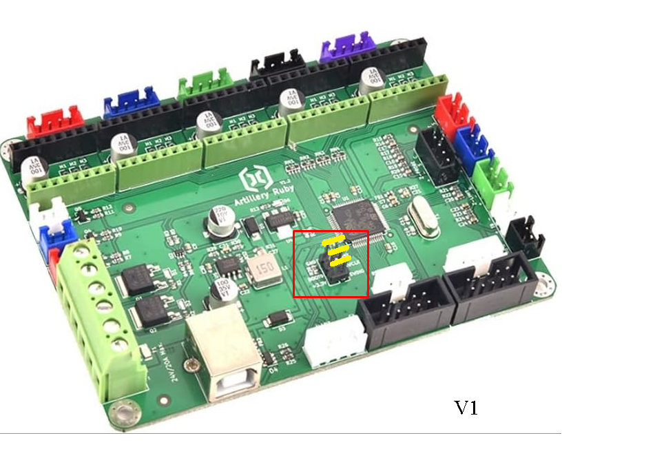

MrMagounet Posté(e) Juillet 23, 2023 Posté(e) Juillet 23, 2023 hi @djscholas if your computer can't see you printer for made a new firmware flash you must put your motherboard in DFU mode Manually. For put you motherboard in DFU manually you must open your printer case and install a bridge on 2 pins 3v & boot see the pictures below for location of pins After that you can plug your computer on the printer and logically see the usb device of your printer on your computer for flash the firmware by STM32 software. 1
djscholas Posté(e) Juillet 23, 2023 Auteur Posté(e) Juillet 23, 2023 Omg. You gave me hope that it will work Thanks a lot. But should I bridge them like this: Or like that: And 2nd question - should i bridge them with some specific kind of cable ? Because i dont have any special item to bridge them. Could you also tell me what you mean "2 pins 3v"| ?
MrMagounet Posté(e) Juillet 23, 2023 Posté(e) Juillet 23, 2023 Le 23/07/2023 at 18:07, djscholas a dit : Omg. You gave me hope that it will work Thanks a lot. But should I bridge them like this: Or like that: And 2nd question - should i bridge them with some specific kind of cable ? Because i dont have any special item to bridge them. Could you also tell me what you mean "2 pins 3v"| ? Dérouler you must only made a bridge between pin 3v and pin boot you must only read on the motherboard , no made bridge between other pins because you risk to damage the motherboard.

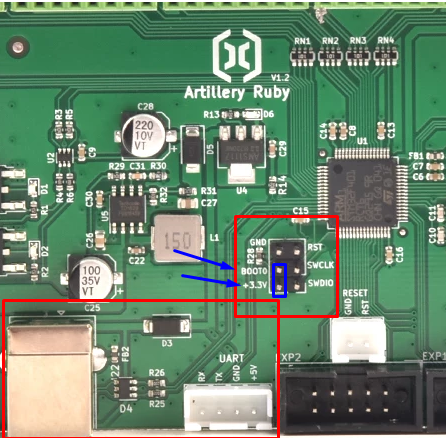

djscholas Posté(e) Juillet 23, 2023 Auteur Posté(e) Juillet 23, 2023 Le 23/07/2023 at 18:13, MrMagounet a dit : you must only made a bridge between pin 3v and pin boot you must only read on the motherboard , no made bridge between other pins because you risk to damage the motherboard. Dérouler Tell me Please If i understood good i should find on motherboard sign “pin 3v” and then put a cable to signed by you place ? need I an extra cable for this or I use only cables that are there already ? sorry for asking like an extra noob, but I don’t want to damage anything
MrMagounet Posté(e) Juillet 23, 2023 Posté(e) Juillet 23, 2023 Le 23/07/2023 at 18:54, djscholas a dit : Tell me Please If i understood good i should find on motherboard sign “pin 3v” and then put a cable to signed by you place ? need I an extra cable for this or I use only cables that are there already ? sorry for asking like an extra noob, but I don’t want to damage anything Dérouler looks this pictures i have put in blue the 2 pins need to maade the bridge pins mark 3.3v & boot0 1
djscholas Posté(e) Juillet 24, 2023 Auteur Posté(e) Juillet 24, 2023 Le 23/07/2023 at 19:35, MrMagounet a dit : looks this pictures i have put in blue the 2 pins need to maade the bridge pins mark 3.3v & boot0 Dérouler Ok. Everything is Clear. Thank you very much. Do you have an PayPal or something where i give you an tip for a beer :)? 1
djscholas Posté(e) Juillet 24, 2023 Auteur Posté(e) Juillet 24, 2023 @MrMagounet ok, that works - i mean I flashed software info printer successfully like in PDF, next I turn off power and turn on and ... pronterface still dont see a printer... also any axis, heating, nothing works when i try to do it via printer display. Do you know what can i do ? i read that i should reset eprom after flashing, but i cant because pronterface dont see printer ehh... hope you can help
MrMagounet Posté(e) Juillet 24, 2023 Posté(e) Juillet 24, 2023 Le 24/07/2023 at 08:26, djscholas a dit : @MrMagounet ok, that works - i mean I flashed software info printer successfully like in PDF, next I turn off power and turn on and ... pronterface still dont see a printer... also any axis, heating, nothing works when i try to do it via printer display. Do you know what can i do ? i read that i should reset eprom after flashing, but i cant because pronterface dont see printer ehh... hope you can help Dérouler after flash do you have put off the bridge on the motherboard because if the bridge still on the printer stay in DFU mode not normale mode ?
djscholas Posté(e) Juillet 24, 2023 Auteur Posté(e) Juillet 24, 2023 @MrMagounet yes it works when i put off bridge. OMG thank you. last 2 questions: 1. Because before upgrade 1 time firmware i dont wrote parameters of origin z-0 and extrude ... then i made M502 and M500 Do you have some tutorials how to properly set them now ? 2. Do you have your software for sidewinder in English ? 1
