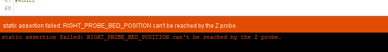

Supoziitoire Posté(e) Avril 18, 2018 Auteur Posté(e) Avril 18, 2018 me voila de nouveau , juste avant la partie 4.4 je voulai compiler et flasher , j'ai fait une verif et j'ai un message d'erreur : Arduino : 1.8.5 (Windows Store 1.8.10.0) (Windows 10), Carte : "Anet V1.0" C:\Program Files\WindowsApps\ArduinoLLC.ArduinoIDE_1.8.10.0_x86__mdqgnx93n4wtt\arduino-builder -dump-prefs -logger=machine -hardware C:\Program Files\WindowsApps\ArduinoLLC.ArduinoIDE_1.8.10.0_x86__mdqgnx93n4wtt\hardware -hardware C:\Users\Flor\Documents\Arduino\hardware -tools C:\Program Files\WindowsApps\ArduinoLLC.ArduinoIDE_1.8.10.0_x86__mdqgnx93n4wtt\tools-builder -tools C:\Program Files\WindowsApps\ArduinoLLC.ArduinoIDE_1.8.10.0_x86__mdqgnx93n4wtt\hardware\tools\avr -built-in-libraries C:\Program Files\WindowsApps\ArduinoLLC.ArduinoIDE_1.8.10.0_x86__mdqgnx93n4wtt\libraries -libraries C:\Users\Flor\Documents\Arduino\libraries -fqbn=anet:avr:anet -ide-version=10805 -build-path C:\Users\Flor\AppData\Local\Temp\arduino_build_846237 -warnings=none -build-cache C:\Users\Flor\AppData\Local\Temp\arduino_cache_680417 -prefs=build.warn_data_percentage=75 -prefs=runtime.tools.avrdude.path=C:\Program Files\WindowsApps\ArduinoLLC.ArduinoIDE_1.8.10.0_x86__mdqgnx93n4wtt\hardware\tools\avr -prefs=runtime.tools.arduinoOTA.path=C:\Program Files\WindowsApps\ArduinoLLC.ArduinoIDE_1.8.10.0_x86__mdqgnx93n4wtt\hardware\tools\avr -prefs=runtime.tools.avr-gcc.path=C:\Program Files\WindowsApps\ArduinoLLC.ArduinoIDE_1.8.10.0_x86__mdqgnx93n4wtt\hardware\tools\avr -verbose C:\Users\Flor\Desktop\Marlin-1.1.x\Marlin\Marlin.ino C:\Program Files\WindowsApps\ArduinoLLC.ArduinoIDE_1.8.10.0_x86__mdqgnx93n4wtt\arduino-builder -compile -logger=machine -hardware C:\Program Files\WindowsApps\ArduinoLLC.ArduinoIDE_1.8.10.0_x86__mdqgnx93n4wtt\hardware -hardware C:\Users\Flor\Documents\Arduino\hardware -tools C:\Program Files\WindowsApps\ArduinoLLC.ArduinoIDE_1.8.10.0_x86__mdqgnx93n4wtt\tools-builder -tools C:\Program Files\WindowsApps\ArduinoLLC.ArduinoIDE_1.8.10.0_x86__mdqgnx93n4wtt\hardware\tools\avr -built-in-libraries C:\Program Files\WindowsApps\ArduinoLLC.ArduinoIDE_1.8.10.0_x86__mdqgnx93n4wtt\libraries -libraries C:\Users\Flor\Documents\Arduino\libraries -fqbn=anet:avr:anet -ide-version=10805 -build-path C:\Users\Flor\AppData\Local\Temp\arduino_build_846237 -warnings=none -build-cache C:\Users\Flor\AppData\Local\Temp\arduino_cache_680417 -prefs=build.warn_data_percentage=75 -prefs=runtime.tools.avrdude.path=C:\Program Files\WindowsApps\ArduinoLLC.ArduinoIDE_1.8.10.0_x86__mdqgnx93n4wtt\hardware\tools\avr -prefs=runtime.tools.arduinoOTA.path=C:\Program Files\WindowsApps\ArduinoLLC.ArduinoIDE_1.8.10.0_x86__mdqgnx93n4wtt\hardware\tools\avr -prefs=runtime.tools.avr-gcc.path=C:\Program Files\WindowsApps\ArduinoLLC.ArduinoIDE_1.8.10.0_x86__mdqgnx93n4wtt\hardware\tools\avr -verbose C:\Users\Flor\Desktop\Marlin-1.1.x\Marlin\Marlin.ino Using board 'anet' from platform in folder: C:\Users\Flor\Documents\Arduino\hardware\anet\avr Using core 'arduino' from platform in folder: C:\Program Files\WindowsApps\ArduinoLLC.ArduinoIDE_1.8.10.0_x86__mdqgnx93n4wtt\hardware\arduino\avr Detecting libraries used... "C:\Program Files\WindowsApps\ArduinoLLC.ArduinoIDE_1.8.10.0_x86__mdqgnx93n4wtt\hardware\tools\avr/bin/avr-g++" -c -g -Os -w -std=gnu++11 -fpermissive -fno-exceptions -ffunction-sections -fdata-sections -fno-threadsafe-statics -flto -w -x c++ -E -CC -mmcu=atmega1284p -DF_CPU=16000000L -DARDUINO=10805 -DARDUINO_AVR_SANGUINO -DARDUINO_ARCH_AVR "-IC:\Program Files\WindowsApps\ArduinoLLC.ArduinoIDE_1.8.10.0_x86__mdqgnx93n4wtt\hardware\arduino\avr\cores\arduino" "-IC:\Users\Flor\Documents\Arduino\hardware\anet\avr\variants\sanguino" "C:\Users\Flor\AppData\Local\Temp\arduino_build_846237\sketch\Marlin.ino.cpp" -o "nul" "C:\Program Files\WindowsApps\ArduinoLLC.ArduinoIDE_1.8.10.0_x86__mdqgnx93n4wtt\hardware\tools\avr/bin/avr-g++" -c -g -Os -w -std=gnu++11 -fpermissive -fno-exceptions -ffunction-sections -fdata-sections -fno-threadsafe-statics -flto -w -x c++ -E -CC -mmcu=atmega1284p -DF_CPU=16000000L -DARDUINO=10805 -DARDUINO_AVR_SANGUINO -DARDUINO_ARCH_AVR "-IC:\Program Files\WindowsApps\ArduinoLLC.ArduinoIDE_1.8.10.0_x86__mdqgnx93n4wtt\hardware\arduino\avr\cores\arduino" "-IC:\Users\Flor\Documents\Arduino\hardware\anet\avr\variants\sanguino" "-IC:\Program Files\WindowsApps\ArduinoLLC.ArduinoIDE_1.8.10.0_x86__mdqgnx93n4wtt\libraries\LiquidCrystal\src" "C:\Users\Flor\AppData\Local\Temp\arduino_build_846237\sketch\Marlin.ino.cpp" -o "nul" "C:\Program Files\WindowsApps\ArduinoLLC.ArduinoIDE_1.8.10.0_x86__mdqgnx93n4wtt\hardware\tools\avr/bin/avr-g++" -c -g -Os -w -std=gnu++11 -fpermissive -fno-exceptions -ffunction-sections -fdata-sections -fno-threadsafe-statics -flto -w -x c++ -E -CC -mmcu=atmega1284p -DF_CPU=16000000L -DARDUINO=10805 -DARDUINO_AVR_SANGUINO -DARDUINO_ARCH_AVR "-IC:\Program Files\WindowsApps\ArduinoLLC.ArduinoIDE_1.8.10.0_x86__mdqgnx93n4wtt\hardware\arduino\avr\cores\arduino" "-IC:\Users\Flor\Documents\Arduino\hardware\anet\avr\variants\sanguino" "-IC:\Program Files\WindowsApps\ArduinoLLC.ArduinoIDE_1.8.10.0_x86__mdqgnx93n4wtt\libraries\LiquidCrystal\src" "C:\Users\Flor\AppData\Local\Temp\arduino_build_846237\sketch\G26_Mesh_Validation_Tool.cpp" -o "nul" "C:\Program Files\WindowsApps\ArduinoLLC.ArduinoIDE_1.8.10.0_x86__mdqgnx93n4wtt\hardware\tools\avr/bin/avr-g++" -c -g -Os -w -std=gnu++11 -fpermissive -fno-exceptions -ffunction-sections -fdata-sections -fno-threadsafe-statics -flto -w -x c++ -E -CC -mmcu=atmega1284p -DF_CPU=16000000L -DARDUINO=10805 -DARDUINO_AVR_SANGUINO -DARDUINO_ARCH_AVR "-IC:\Program Files\WindowsApps\ArduinoLLC.ArduinoIDE_1.8.10.0_x86__mdqgnx93n4wtt\hardware\arduino\avr\cores\arduino" "-IC:\Users\Flor\Documents\Arduino\hardware\anet\avr\variants\sanguino" "-IC:\Program Files\WindowsApps\ArduinoLLC.ArduinoIDE_1.8.10.0_x86__mdqgnx93n4wtt\libraries\LiquidCrystal\src" "C:\Users\Flor\AppData\Local\Temp\arduino_build_846237\sketch\I2CPositionEncoder.cpp" -o "nul" "C:\Program Files\WindowsApps\ArduinoLLC.ArduinoIDE_1.8.10.0_x86__mdqgnx93n4wtt\hardware\tools\avr/bin/avr-g++" -c -g -Os -w -std=gnu++11 -fpermissive -fno-exceptions -ffunction-sections -fdata-sections -fno-threadsafe-statics -flto -w -x c++ -E -CC -mmcu=atmega1284p -DF_CPU=16000000L -DARDUINO=10805 -DARDUINO_AVR_SANGUINO -DARDUINO_ARCH_AVR "-IC:\Program Files\WindowsApps\ArduinoLLC.ArduinoIDE_1.8.10.0_x86__mdqgnx93n4wtt\hardware\arduino\avr\cores\arduino" "-IC:\Users\Flor\Documents\Arduino\hardware\anet\avr\variants\sanguino" "-IC:\Program Files\WindowsApps\ArduinoLLC.ArduinoIDE_1.8.10.0_x86__mdqgnx93n4wtt\libraries\LiquidCrystal\src" "C:\Users\Flor\AppData\Local\Temp\arduino_build_846237\sketch\M100_Free_Mem_Chk.cpp" -o "nul" "C:\Program Files\WindowsApps\ArduinoLLC.ArduinoIDE_1.8.10.0_x86__mdqgnx93n4wtt\hardware\tools\avr/bin/avr-g++" -c -g -Os -w -std=gnu++11 -fpermissive -fno-exceptions -ffunction-sections -fdata-sections -fno-threadsafe-statics -flto -w -x c++ -E -CC -mmcu=atmega1284p -DF_CPU=16000000L -DARDUINO=10805 -DARDUINO_AVR_SANGUINO -DARDUINO_ARCH_AVR "-IC:\Program Files\WindowsApps\ArduinoLLC.ArduinoIDE_1.8.10.0_x86__mdqgnx93n4wtt\hardware\arduino\avr\cores\arduino" "-IC:\Users\Flor\Documents\Arduino\hardware\anet\avr\variants\sanguino" "-IC:\Program Files\WindowsApps\ArduinoLLC.ArduinoIDE_1.8.10.0_x86__mdqgnx93n4wtt\libraries\LiquidCrystal\src" "C:\Users\Flor\AppData\Local\Temp\arduino_build_846237\sketch\MarlinSerial.cpp" -o "nul" "C:\Program Files\WindowsApps\ArduinoLLC.ArduinoIDE_1.8.10.0_x86__mdqgnx93n4wtt\hardware\tools\avr/bin/avr-g++" -c -g -Os -w -std=gnu++11 -fpermissive -fno-exceptions -ffunction-sections -fdata-sections -fno-threadsafe-statics -flto -w -x c++ -E -CC -mmcu=atmega1284p -DF_CPU=16000000L -DARDUINO=10805 -DARDUINO_AVR_SANGUINO -DARDUINO_ARCH_AVR "-IC:\Program Files\WindowsApps\ArduinoLLC.ArduinoIDE_1.8.10.0_x86__mdqgnx93n4wtt\hardware\arduino\avr\cores\arduino" "-IC:\Users\Flor\Documents\Arduino\hardware\anet\avr\variants\sanguino" "-IC:\Program Files\WindowsApps\ArduinoLLC.ArduinoIDE_1.8.10.0_x86__mdqgnx93n4wtt\libraries\LiquidCrystal\src" "C:\Users\Flor\AppData\Local\Temp\arduino_build_846237\sketch\Marlin_main.cpp" -o "nul" "C:\Program Files\WindowsApps\ArduinoLLC.ArduinoIDE_1.8.10.0_x86__mdqgnx93n4wtt\hardware\tools\avr/bin/avr-g++" -c -g -Os -w -std=gnu++11 -fpermissive -fno-exceptions -ffunction-sections -fdata-sections -fno-threadsafe-statics -flto -w -x c++ -E -CC -mmcu=atmega1284p -DF_CPU=16000000L -DARDUINO=10805 -DARDUINO_AVR_SANGUINO -DARDUINO_ARCH_AVR "-IC:\Program Files\WindowsApps\ArduinoLLC.ArduinoIDE_1.8.10.0_x86__mdqgnx93n4wtt\hardware\arduino\avr\cores\arduino" "-IC:\Users\Flor\Documents\Arduino\hardware\anet\avr\variants\sanguino" "-IC:\Program Files\WindowsApps\ArduinoLLC.ArduinoIDE_1.8.10.0_x86__mdqgnx93n4wtt\libraries\LiquidCrystal\src" "C:\Users\Flor\AppData\Local\Temp\arduino_build_846237\sketch\Max7219_Debug_LEDs.cpp" -o "nul" "C:\Program Files\WindowsApps\ArduinoLLC.ArduinoIDE_1.8.10.0_x86__mdqgnx93n4wtt\hardware\tools\avr/bin/avr-g++" -c -g -Os -w -std=gnu++11 -fpermissive -fno-exceptions -ffunction-sections -fdata-sections -fno-threadsafe-statics -flto -w -x c++ -E -CC -mmcu=atmega1284p -DF_CPU=16000000L -DARDUINO=10805 -DARDUINO_AVR_SANGUINO -DARDUINO_ARCH_AVR "-IC:\Program Files\WindowsApps\ArduinoLLC.ArduinoIDE_1.8.10.0_x86__mdqgnx93n4wtt\hardware\arduino\avr\cores\arduino" "-IC:\Users\Flor\Documents\Arduino\hardware\anet\avr\variants\sanguino" "-IC:\Program Files\WindowsApps\ArduinoLLC.ArduinoIDE_1.8.10.0_x86__mdqgnx93n4wtt\libraries\LiquidCrystal\src" "C:\Users\Flor\AppData\Local\Temp\arduino_build_846237\sketch\Sd2Card.cpp" -o "nul" "C:\Program Files\WindowsApps\ArduinoLLC.ArduinoIDE_1.8.10.0_x86__mdqgnx93n4wtt\hardware\tools\avr/bin/avr-g++" -c -g -Os -w -std=gnu++11 -fpermissive -fno-exceptions -ffunction-sections -fdata-sections -fno-threadsafe-statics -flto -w -x c++ -E -CC -mmcu=atmega1284p -DF_CPU=16000000L -DARDUINO=10805 -DARDUINO_AVR_SANGUINO -DARDUINO_ARCH_AVR "-IC:\Program Files\WindowsApps\ArduinoLLC.ArduinoIDE_1.8.10.0_x86__mdqgnx93n4wtt\hardware\arduino\avr\cores\arduino" "-IC:\Users\Flor\Documents\Arduino\hardware\anet\avr\variants\sanguino" "-IC:\Program Files\WindowsApps\ArduinoLLC.ArduinoIDE_1.8.10.0_x86__mdqgnx93n4wtt\libraries\LiquidCrystal\src" "C:\Users\Flor\AppData\Local\Temp\arduino_build_846237\sketch\SdBaseFile.cpp" -o "nul" "C:\Program Files\WindowsApps\ArduinoLLC.ArduinoIDE_1.8.10.0_x86__mdqgnx93n4wtt\hardware\tools\avr/bin/avr-g++" -c -g -Os -w -std=gnu++11 -fpermissive -fno-exceptions -ffunction-sections -fdata-sections -fno-threadsafe-statics -flto -w -x c++ -E -CC -mmcu=atmega1284p -DF_CPU=16000000L -DARDUINO=10805 -DARDUINO_AVR_SANGUINO -DARDUINO_ARCH_AVR "-IC:\Program Files\WindowsApps\ArduinoLLC.ArduinoIDE_1.8.10.0_x86__mdqgnx93n4wtt\hardware\arduino\avr\cores\arduino" "-IC:\Users\Flor\Documents\Arduino\hardware\anet\avr\variants\sanguino" "-IC:\Program Files\WindowsApps\ArduinoLLC.ArduinoIDE_1.8.10.0_x86__mdqgnx93n4wtt\libraries\LiquidCrystal\src" "C:\Users\Flor\AppData\Local\Temp\arduino_build_846237\sketch\SdFatUtil.cpp" -o "nul" "C:\Program Files\WindowsApps\ArduinoLLC.ArduinoIDE_1.8.10.0_x86__mdqgnx93n4wtt\hardware\tools\avr/bin/avr-g++" -c -g -Os -w -std=gnu++11 -fpermissive -fno-exceptions -ffunction-sections -fdata-sections -fno-threadsafe-statics -flto -w -x c++ -E -CC -mmcu=atmega1284p -DF_CPU=16000000L -DARDUINO=10805 -DARDUINO_AVR_SANGUINO -DARDUINO_ARCH_AVR "-IC:\Program Files\WindowsApps\ArduinoLLC.ArduinoIDE_1.8.10.0_x86__mdqgnx93n4wtt\hardware\arduino\avr\cores\arduino" "-IC:\Users\Flor\Documents\Arduino\hardware\anet\avr\variants\sanguino" "-IC:\Program Files\WindowsApps\ArduinoLLC.ArduinoIDE_1.8.10.0_x86__mdqgnx93n4wtt\libraries\LiquidCrystal\src" "C:\Users\Flor\AppData\Local\Temp\arduino_build_846237\sketch\SdFile.cpp" -o "nul" "C:\Program Files\WindowsApps\ArduinoLLC.ArduinoIDE_1.8.10.0_x86__mdqgnx93n4wtt\hardware\tools\avr/bin/avr-g++" -c -g -Os -w -std=gnu++11 -fpermissive -fno-exceptions -ffunction-sections -fdata-sections -fno-threadsafe-statics -flto -w -x c++ -E -CC -mmcu=atmega1284p -DF_CPU=16000000L -DARDUINO=10805 -DARDUINO_AVR_SANGUINO -DARDUINO_ARCH_AVR "-IC:\Program Files\WindowsApps\ArduinoLLC.ArduinoIDE_1.8.10.0_x86__mdqgnx93n4wtt\hardware\arduino\avr\cores\arduino" "-IC:\Users\Flor\Documents\Arduino\hardware\anet\avr\variants\sanguino" "-IC:\Program Files\WindowsApps\ArduinoLLC.ArduinoIDE_1.8.10.0_x86__mdqgnx93n4wtt\libraries\LiquidCrystal\src" "C:\Users\Flor\AppData\Local\Temp\arduino_build_846237\sketch\SdVolume.cpp" -o "nul" "C:\Program Files\WindowsApps\ArduinoLLC.ArduinoIDE_1.8.10.0_x86__mdqgnx93n4wtt\hardware\tools\avr/bin/avr-g++" -c -g -Os -w -std=gnu++11 -fpermissive -fno-exceptions -ffunction-sections -fdata-sections -fno-threadsafe-statics -flto -w -x c++ -E -CC -mmcu=atmega1284p -DF_CPU=16000000L -DARDUINO=10805 -DARDUINO_AVR_SANGUINO -DARDUINO_ARCH_AVR "-IC:\Program Files\WindowsApps\ArduinoLLC.ArduinoIDE_1.8.10.0_x86__mdqgnx93n4wtt\hardware\arduino\avr\cores\arduino" "-IC:\Users\Flor\Documents\Arduino\hardware\anet\avr\variants\sanguino" "-IC:\Program Files\WindowsApps\ArduinoLLC.ArduinoIDE_1.8.10.0_x86__mdqgnx93n4wtt\libraries\LiquidCrystal\src" "C:\Users\Flor\AppData\Local\Temp\arduino_build_846237\sketch\blinkm.cpp" -o "nul" "C:\Program Files\WindowsApps\ArduinoLLC.ArduinoIDE_1.8.10.0_x86__mdqgnx93n4wtt\hardware\tools\avr/bin/avr-g++" -c -g -Os -w -std=gnu++11 -fpermissive -fno-exceptions -ffunction-sections -fdata-sections -fno-threadsafe-statics -flto -w -x c++ -E -CC -mmcu=atmega1284p -DF_CPU=16000000L -DARDUINO=10805 -DARDUINO_AVR_SANGUINO -DARDUINO_ARCH_AVR "-IC:\Program Files\WindowsApps\ArduinoLLC.ArduinoIDE_1.8.10.0_x86__mdqgnx93n4wtt\hardware\arduino\avr\cores\arduino" "-IC:\Users\Flor\Documents\Arduino\hardware\anet\avr\variants\sanguino" "-IC:\Program Files\WindowsApps\ArduinoLLC.ArduinoIDE_1.8.10.0_x86__mdqgnx93n4wtt\libraries\LiquidCrystal\src" "C:\Users\Flor\AppData\Local\Temp\arduino_build_846237\sketch\cardreader.cpp" -o "nul" "C:\Program Files\WindowsApps\ArduinoLLC.ArduinoIDE_1.8.10.0_x86__mdqgnx93n4wtt\hardware\tools\avr/bin/avr-g++" -c -g -Os -w -std=gnu++11 -fpermissive -fno-exceptions -ffunction-sections -fdata-sections -fno-threadsafe-statics -flto -w -x c++ -E -CC -mmcu=atmega1284p -DF_CPU=16000000L -DARDUINO=10805 -DARDUINO_AVR_SANGUINO -DARDUINO_ARCH_AVR "-IC:\Program Files\WindowsApps\ArduinoLLC.ArduinoIDE_1.8.10.0_x86__mdqgnx93n4wtt\hardware\arduino\avr\cores\arduino" "-IC:\Users\Flor\Documents\Arduino\hardware\anet\avr\variants\sanguino" "-IC:\Program Files\WindowsApps\ArduinoLLC.ArduinoIDE_1.8.10.0_x86__mdqgnx93n4wtt\libraries\LiquidCrystal\src" "C:\Users\Flor\AppData\Local\Temp\arduino_build_846237\sketch\configuration_store.cpp" -o "nul" "C:\Program Files\WindowsApps\ArduinoLLC.ArduinoIDE_1.8.10.0_x86__mdqgnx93n4wtt\hardware\tools\avr/bin/avr-g++" -c -g -Os -w -std=gnu++11 -fpermissive -fno-exceptions -ffunction-sections -fdata-sections -fno-threadsafe-statics -flto -w -x c++ -E -CC -mmcu=atmega1284p -DF_CPU=16000000L -DARDUINO=10805 -DARDUINO_AVR_SANGUINO -DARDUINO_ARCH_AVR "-IC:\Program Files\WindowsApps\ArduinoLLC.ArduinoIDE_1.8.10.0_x86__mdqgnx93n4wtt\hardware\arduino\avr\cores\arduino" "-IC:\Users\Flor\Documents\Arduino\hardware\anet\avr\variants\sanguino" "-IC:\Program Files\WindowsApps\ArduinoLLC.ArduinoIDE_1.8.10.0_x86__mdqgnx93n4wtt\libraries\LiquidCrystal\src" "C:\Users\Flor\AppData\Local\Temp\arduino_build_846237\sketch\dac_mcp4728.cpp" -o "nul" "C:\Program Files\WindowsApps\ArduinoLLC.ArduinoIDE_1.8.10.0_x86__mdqgnx93n4wtt\hardware\tools\avr/bin/avr-g++" -c -g -Os -w -std=gnu++11 -fpermissive -fno-exceptions -ffunction-sections -fdata-sections -fno-threadsafe-statics -flto -w -x c++ -E -CC -mmcu=atmega1284p -DF_CPU=16000000L -DARDUINO=10805 -DARDUINO_AVR_SANGUINO -DARDUINO_ARCH_AVR "-IC:\Program Files\WindowsApps\ArduinoLLC.ArduinoIDE_1.8.10.0_x86__mdqgnx93n4wtt\hardware\arduino\avr\cores\arduino" "-IC:\Users\Flor\Documents\Arduino\hardware\anet\avr\variants\sanguino" "-IC:\Program Files\WindowsApps\ArduinoLLC.ArduinoIDE_1.8.10.0_x86__mdqgnx93n4wtt\libraries\LiquidCrystal\src" "C:\Users\Flor\AppData\Local\Temp\arduino_build_846237\sketch\digipot_mcp4018.cpp" -o "nul" "C:\Program Files\WindowsApps\ArduinoLLC.ArduinoIDE_1.8.10.0_x86__mdqgnx93n4wtt\hardware\tools\avr/bin/avr-g++" -c -g -Os -w -std=gnu++11 -fpermissive -fno-exceptions -ffunction-sections -fdata-sections -fno-threadsafe-statics -flto -w -x c++ -E -CC -mmcu=atmega1284p -DF_CPU=16000000L -DARDUINO=10805 -DARDUINO_AVR_SANGUINO -DARDUINO_ARCH_AVR "-IC:\Program Files\WindowsApps\ArduinoLLC.ArduinoIDE_1.8.10.0_x86__mdqgnx93n4wtt\hardware\arduino\avr\cores\arduino" "-IC:\Users\Flor\Documents\Arduino\hardware\anet\avr\variants\sanguino" "-IC:\Program Files\WindowsApps\ArduinoLLC.ArduinoIDE_1.8.10.0_x86__mdqgnx93n4wtt\libraries\LiquidCrystal\src" "C:\Users\Flor\AppData\Local\Temp\arduino_build_846237\sketch\digipot_mcp4451.cpp" -o "nul" "C:\Program Files\WindowsApps\ArduinoLLC.ArduinoIDE_1.8.10.0_x86__mdqgnx93n4wtt\hardware\tools\avr/bin/avr-g++" -c -g -Os -w -std=gnu++11 -fpermissive -fno-exceptions -ffunction-sections -fdata-sections -fno-threadsafe-statics -flto -w -x c++ -E -CC -mmcu=atmega1284p -DF_CPU=16000000L -DARDUINO=10805 -DARDUINO_AVR_SANGUINO -DARDUINO_ARCH_AVR "-IC:\Program Files\WindowsApps\ArduinoLLC.ArduinoIDE_1.8.10.0_x86__mdqgnx93n4wtt\hardware\arduino\avr\cores\arduino" "-IC:\Users\Flor\Documents\Arduino\hardware\anet\avr\variants\sanguino" "-IC:\Program Files\WindowsApps\ArduinoLLC.ArduinoIDE_1.8.10.0_x86__mdqgnx93n4wtt\libraries\LiquidCrystal\src" "C:\Users\Flor\AppData\Local\Temp\arduino_build_846237\sketch\endstops.cpp" -o "nul" "C:\Program Files\WindowsApps\ArduinoLLC.ArduinoIDE_1.8.10.0_x86__mdqgnx93n4wtt\hardware\tools\avr/bin/avr-g++" -c -g -Os -w -std=gnu++11 -fpermissive -fno-exceptions -ffunction-sections -fdata-sections -fno-threadsafe-statics -flto -w -x c++ -E -CC -mmcu=atmega1284p -DF_CPU=16000000L -DARDUINO=10805 -DARDUINO_AVR_SANGUINO -DARDUINO_ARCH_AVR "-IC:\Program Files\WindowsApps\ArduinoLLC.ArduinoIDE_1.8.10.0_x86__mdqgnx93n4wtt\hardware\arduino\avr\cores\arduino" "-IC:\Users\Flor\Documents\Arduino\hardware\anet\avr\variants\sanguino" "-IC:\Program Files\WindowsApps\ArduinoLLC.ArduinoIDE_1.8.10.0_x86__mdqgnx93n4wtt\libraries\LiquidCrystal\src" "C:\Users\Flor\AppData\Local\Temp\arduino_build_846237\sketch\gcode.cpp" -o "nul" "C:\Program Files\WindowsApps\ArduinoLLC.ArduinoIDE_1.8.10.0_x86__mdqgnx93n4wtt\hardware\tools\avr/bin/avr-g++" -c -g -Os -w -std=gnu++11 -fpermissive -fno-exceptions -ffunction-sections -fdata-sections -fno-threadsafe-statics -flto -w -x c++ -E -CC -mmcu=atmega1284p -DF_CPU=16000000L -DARDUINO=10805 -DARDUINO_AVR_SANGUINO -DARDUINO_ARCH_AVR "-IC:\Program Files\WindowsApps\ArduinoLLC.ArduinoIDE_1.8.10.0_x86__mdqgnx93n4wtt\hardware\arduino\avr\cores\arduino" "-IC:\Users\Flor\Documents\Arduino\hardware\anet\avr\variants\sanguino" "-IC:\Program Files\WindowsApps\ArduinoLLC.ArduinoIDE_1.8.10.0_x86__mdqgnx93n4wtt\libraries\LiquidCrystal\src" "C:\Users\Flor\AppData\Local\Temp\arduino_build_846237\sketch\hex_print_routines.cpp" -o "nul" "C:\Program Files\WindowsApps\ArduinoLLC.ArduinoIDE_1.8.10.0_x86__mdqgnx93n4wtt\hardware\tools\avr/bin/avr-g++" -c -g -Os -w -std=gnu++11 -fpermissive -fno-exceptions -ffunction-sections -fdata-sections -fno-threadsafe-statics -flto -w -x c++ -E -CC -mmcu=atmega1284p -DF_CPU=16000000L -DARDUINO=10805 -DARDUINO_AVR_SANGUINO -DARDUINO_ARCH_AVR "-IC:\Program Files\WindowsApps\ArduinoLLC.ArduinoIDE_1.8.10.0_x86__mdqgnx93n4wtt\hardware\arduino\avr\cores\arduino" "-IC:\Users\Flor\Documents\Arduino\hardware\anet\avr\variants\sanguino" "-IC:\Program Files\WindowsApps\ArduinoLLC.ArduinoIDE_1.8.10.0_x86__mdqgnx93n4wtt\libraries\LiquidCrystal\src" "C:\Users\Flor\AppData\Local\Temp\arduino_build_846237\sketch\least_squares_fit.cpp" -o "nul" "C:\Program Files\WindowsApps\ArduinoLLC.ArduinoIDE_1.8.10.0_x86__mdqgnx93n4wtt\hardware\tools\avr/bin/avr-g++" -c -g -Os -w -std=gnu++11 -fpermissive -fno-exceptions -ffunction-sections -fdata-sections -fno-threadsafe-statics -flto -w -x c++ -E -CC -mmcu=atmega1284p -DF_CPU=16000000L -DARDUINO=10805 -DARDUINO_AVR_SANGUINO -DARDUINO_ARCH_AVR "-IC:\Program Files\WindowsApps\ArduinoLLC.ArduinoIDE_1.8.10.0_x86__mdqgnx93n4wtt\hardware\arduino\avr\cores\arduino" "-IC:\Users\Flor\Documents\Arduino\hardware\anet\avr\variants\sanguino" "-IC:\Program Files\WindowsApps\ArduinoLLC.ArduinoIDE_1.8.10.0_x86__mdqgnx93n4wtt\libraries\LiquidCrystal\src" "C:\Users\Flor\AppData\Local\Temp\arduino_build_846237\sketch\leds.cpp" -o "nul" "C:\Program Files\WindowsApps\ArduinoLLC.ArduinoIDE_1.8.10.0_x86__mdqgnx93n4wtt\hardware\tools\avr/bin/avr-g++" -c -g -Os -w -std=gnu++11 -fpermissive -fno-exceptions -ffunction-sections -fdata-sections -fno-threadsafe-statics -flto -w -x c++ -E -CC -mmcu=atmega1284p -DF_CPU=16000000L -DARDUINO=10805 -DARDUINO_AVR_SANGUINO -DARDUINO_ARCH_AVR "-IC:\Program Files\WindowsApps\ArduinoLLC.ArduinoIDE_1.8.10.0_x86__mdqgnx93n4wtt\hardware\arduino\avr\cores\arduino" "-IC:\Users\Flor\Documents\Arduino\hardware\anet\avr\variants\sanguino" "-IC:\Program Files\WindowsApps\ArduinoLLC.ArduinoIDE_1.8.10.0_x86__mdqgnx93n4wtt\libraries\LiquidCrystal\src" "C:\Users\Flor\AppData\Local\Temp\arduino_build_846237\sketch\mesh_bed_leveling.cpp" -o "nul" "C:\Program Files\WindowsApps\ArduinoLLC.ArduinoIDE_1.8.10.0_x86__mdqgnx93n4wtt\hardware\tools\avr/bin/avr-g++" -c -g -Os -w -std=gnu++11 -fpermissive -fno-exceptions -ffunction-sections -fdata-sections -fno-threadsafe-statics -flto -w -x c++ -E -CC -mmcu=atmega1284p -DF_CPU=16000000L -DARDUINO=10805 -DARDUINO_AVR_SANGUINO -DARDUINO_ARCH_AVR "-IC:\Program Files\WindowsApps\ArduinoLLC.ArduinoIDE_1.8.10.0_x86__mdqgnx93n4wtt\hardware\arduino\avr\cores\arduino" "-IC:\Users\Flor\Documents\Arduino\hardware\anet\avr\variants\sanguino" "-IC:\Program Files\WindowsApps\ArduinoLLC.ArduinoIDE_1.8.10.0_x86__mdqgnx93n4wtt\libraries\LiquidCrystal\src" "C:\Users\Flor\AppData\Local\Temp\arduino_build_846237\sketch\neopixel.cpp" -o "nul" "C:\Program Files\WindowsApps\ArduinoLLC.ArduinoIDE_1.8.10.0_x86__mdqgnx93n4wtt\hardware\tools\avr/bin/avr-g++" -c -g -Os -w -std=gnu++11 -fpermissive -fno-exceptions -ffunction-sections -fdata-sections -fno-threadsafe-statics -flto -w -x c++ -E -CC -mmcu=atmega1284p -DF_CPU=16000000L -DARDUINO=10805 -DARDUINO_AVR_SANGUINO -DARDUINO_ARCH_AVR "-IC:\Program Files\WindowsApps\ArduinoLLC.ArduinoIDE_1.8.10.0_x86__mdqgnx93n4wtt\hardware\arduino\avr\cores\arduino" "-IC:\Users\Flor\Documents\Arduino\hardware\anet\avr\variants\sanguino" "-IC:\Program Files\WindowsApps\ArduinoLLC.ArduinoIDE_1.8.10.0_x86__mdqgnx93n4wtt\libraries\LiquidCrystal\src" "C:\Users\Flor\AppData\Local\Temp\arduino_build_846237\sketch\nozzle.cpp" -o "nul" "C:\Program Files\WindowsApps\ArduinoLLC.ArduinoIDE_1.8.10.0_x86__mdqgnx93n4wtt\hardware\tools\avr/bin/avr-g++" -c -g -Os -w -std=gnu++11 -fpermissive -fno-exceptions -ffunction-sections -fdata-sections -fno-threadsafe-statics -flto -w -x c++ -E -CC -mmcu=atmega1284p -DF_CPU=16000000L -DARDUINO=10805 -DARDUINO_AVR_SANGUINO -DARDUINO_ARCH_AVR "-IC:\Program Files\WindowsApps\ArduinoLLC.ArduinoIDE_1.8.10.0_x86__mdqgnx93n4wtt\hardware\arduino\avr\cores\arduino" "-IC:\Users\Flor\Documents\Arduino\hardware\anet\avr\variants\sanguino" "-IC:\Program Files\WindowsApps\ArduinoLLC.ArduinoIDE_1.8.10.0_x86__mdqgnx93n4wtt\libraries\LiquidCrystal\src" "C:\Users\Flor\AppData\Local\Temp\arduino_build_846237\sketch\pca9632.cpp" -o "nul" "C:\Program Files\WindowsApps\ArduinoLLC.ArduinoIDE_1.8.10.0_x86__mdqgnx93n4wtt\hardware\tools\avr/bin/avr-g++" -c -g -Os -w -std=gnu++11 -fpermissive -fno-exceptions -ffunction-sections -fdata-sections -fno-threadsafe-statics -flto -w -x c++ -E -CC -mmcu=atmega1284p -DF_CPU=16000000L -DARDUINO=10805 -DARDUINO_AVR_SANGUINO -DARDUINO_ARCH_AVR "-IC:\Program Files\WindowsApps\ArduinoLLC.ArduinoIDE_1.8.10.0_x86__mdqgnx93n4wtt\hardware\arduino\avr\cores\arduino" "-IC:\Users\Flor\Documents\Arduino\hardware\anet\avr\variants\sanguino" "-IC:\Program Files\WindowsApps\ArduinoLLC.ArduinoIDE_1.8.10.0_x86__mdqgnx93n4wtt\libraries\LiquidCrystal\src" "C:\Users\Flor\AppData\Local\Temp\arduino_build_846237\sketch\planner.cpp" -o "nul" "C:\Program Files\WindowsApps\ArduinoLLC.ArduinoIDE_1.8.10.0_x86__mdqgnx93n4wtt\hardware\tools\avr/bin/avr-g++" -c -g -Os -w -std=gnu++11 -fpermissive -fno-exceptions -ffunction-sections -fdata-sections -fno-threadsafe-statics -flto -w -x c++ -E -CC -mmcu=atmega1284p -DF_CPU=16000000L -DARDUINO=10805 -DARDUINO_AVR_SANGUINO -DARDUINO_ARCH_AVR "-IC:\Program Files\WindowsApps\ArduinoLLC.ArduinoIDE_1.8.10.0_x86__mdqgnx93n4wtt\hardware\arduino\avr\cores\arduino" "-IC:\Users\Flor\Documents\Arduino\hardware\anet\avr\variants\sanguino" "-IC:\Program Files\WindowsApps\ArduinoLLC.ArduinoIDE_1.8.10.0_x86__mdqgnx93n4wtt\libraries\LiquidCrystal\src" "C:\Users\Flor\AppData\Local\Temp\arduino_build_846237\sketch\planner_bezier.cpp" -o "nul" "C:\Program Files\WindowsApps\ArduinoLLC.ArduinoIDE_1.8.10.0_x86__mdqgnx93n4wtt\hardware\tools\avr/bin/avr-g++" -c -g -Os -w -std=gnu++11 -fpermissive -fno-exceptions -ffunction-sections -fdata-sections -fno-threadsafe-statics -flto -w -x c++ -E -CC -mmcu=atmega1284p -DF_CPU=16000000L -DARDUINO=10805 -DARDUINO_AVR_SANGUINO -DARDUINO_ARCH_AVR "-IC:\Program Files\WindowsApps\ArduinoLLC.ArduinoIDE_1.8.10.0_x86__mdqgnx93n4wtt\hardware\arduino\avr\cores\arduino" "-IC:\Users\Flor\Documents\Arduino\hardware\anet\avr\variants\sanguino" "-IC:\Program Files\WindowsApps\ArduinoLLC.ArduinoIDE_1.8.10.0_x86__mdqgnx93n4wtt\libraries\LiquidCrystal\src" "C:\Users\Flor\AppData\Local\Temp\arduino_build_846237\sketch\printcounter.cpp" -o "nul" "C:\Program Files\WindowsApps\ArduinoLLC.ArduinoIDE_1.8.10.0_x86__mdqgnx93n4wtt\hardware\tools\avr/bin/avr-g++" -c -g -Os -w -std=gnu++11 -fpermissive -fno-exceptions -ffunction-sections -fdata-sections -fno-threadsafe-statics -flto -w -x c++ -E -CC -mmcu=atmega1284p -DF_CPU=16000000L -DARDUINO=10805 -DARDUINO_AVR_SANGUINO -DARDUINO_ARCH_AVR "-IC:\Program Files\WindowsApps\ArduinoLLC.ArduinoIDE_1.8.10.0_x86__mdqgnx93n4wtt\hardware\arduino\avr\cores\arduino" "-IC:\Users\Flor\Documents\Arduino\hardware\anet\avr\variants\sanguino" "-IC:\Program Files\WindowsApps\ArduinoLLC.ArduinoIDE_1.8.10.0_x86__mdqgnx93n4wtt\libraries\LiquidCrystal\src" "C:\Users\Flor\AppData\Local\Temp\arduino_build_846237\sketch\serial.cpp" -o "nul" "C:\Program Files\WindowsApps\ArduinoLLC.ArduinoIDE_1.8.10.0_x86__mdqgnx93n4wtt\hardware\tools\avr/bin/avr-g++" -c -g -Os -w -std=gnu++11 -fpermissive -fno-exceptions -ffunction-sections -fdata-sections -fno-threadsafe-statics -flto -w -x c++ -E -CC -mmcu=atmega1284p -DF_CPU=16000000L -DARDUINO=10805 -DARDUINO_AVR_SANGUINO -DARDUINO_ARCH_AVR "-IC:\Program Files\WindowsApps\ArduinoLLC.ArduinoIDE_1.8.10.0_x86__mdqgnx93n4wtt\hardware\arduino\avr\cores\arduino" "-IC:\Users\Flor\Documents\Arduino\hardware\anet\avr\variants\sanguino" "-IC:\Program Files\WindowsApps\ArduinoLLC.ArduinoIDE_1.8.10.0_x86__mdqgnx93n4wtt\libraries\LiquidCrystal\src" "C:\Users\Flor\AppData\Local\Temp\arduino_build_846237\sketch\servo.cpp" -o "nul" "C:\Program Files\WindowsApps\ArduinoLLC.ArduinoIDE_1.8.10.0_x86__mdqgnx93n4wtt\hardware\tools\avr/bin/avr-g++" -c -g -Os -w -std=gnu++11 -fpermissive -fno-exceptions -ffunction-sections -fdata-sections -fno-threadsafe-statics -flto -w -x c++ -E -CC -mmcu=atmega1284p -DF_CPU=16000000L -DARDUINO=10805 -DARDUINO_AVR_SANGUINO -DARDUINO_ARCH_AVR "-IC:\Program Files\WindowsApps\ArduinoLLC.ArduinoIDE_1.8.10.0_x86__mdqgnx93n4wtt\hardware\arduino\avr\cores\arduino" "-IC:\Users\Flor\Documents\Arduino\hardware\anet\avr\variants\sanguino" "-IC:\Program Files\WindowsApps\ArduinoLLC.ArduinoIDE_1.8.10.0_x86__mdqgnx93n4wtt\libraries\LiquidCrystal\src" "C:\Users\Flor\AppData\Local\Temp\arduino_build_846237\sketch\stepper.cpp" -o "nul" "C:\Program Files\WindowsApps\ArduinoLLC.ArduinoIDE_1.8.10.0_x86__mdqgnx93n4wtt\hardware\tools\avr/bin/avr-g++" -c -g -Os -w -std=gnu++11 -fpermissive -fno-exceptions -ffunction-sections -fdata-sections -fno-threadsafe-statics -flto -w -x c++ -E -CC -mmcu=atmega1284p -DF_CPU=16000000L -DARDUINO=10805 -DARDUINO_AVR_SANGUINO -DARDUINO_ARCH_AVR "-IC:\Program Files\WindowsApps\ArduinoLLC.ArduinoIDE_1.8.10.0_x86__mdqgnx93n4wtt\hardware\arduino\avr\cores\arduino" "-IC:\Users\Flor\Documents\Arduino\hardware\anet\avr\variants\sanguino" "-IC:\Program Files\WindowsApps\ArduinoLLC.ArduinoIDE_1.8.10.0_x86__mdqgnx93n4wtt\libraries\LiquidCrystal\src" "C:\Users\Flor\AppData\Local\Temp\arduino_build_846237\sketch\stepper_dac.cpp" -o "nul" "C:\Program Files\WindowsApps\ArduinoLLC.ArduinoIDE_1.8.10.0_x86__mdqgnx93n4wtt\hardware\tools\avr/bin/avr-g++" -c -g -Os -w -std=gnu++11 -fpermissive -fno-exceptions -ffunction-sections -fdata-sections -fno-threadsafe-statics -flto -w -x c++ -E -CC -mmcu=atmega1284p -DF_CPU=16000000L -DARDUINO=10805 -DARDUINO_AVR_SANGUINO -DARDUINO_ARCH_AVR "-IC:\Program Files\WindowsApps\ArduinoLLC.ArduinoIDE_1.8.10.0_x86__mdqgnx93n4wtt\hardware\arduino\avr\cores\arduino" "-IC:\Users\Flor\Documents\Arduino\hardware\anet\avr\variants\sanguino" "-IC:\Program Files\WindowsApps\ArduinoLLC.ArduinoIDE_1.8.10.0_x86__mdqgnx93n4wtt\libraries\LiquidCrystal\src" "C:\Users\Flor\AppData\Local\Temp\arduino_build_846237\sketch\stepper_indirection.cpp" -o "nul" "C:\Program Files\WindowsApps\ArduinoLLC.ArduinoIDE_1.8.10.0_x86__mdqgnx93n4wtt\hardware\tools\avr/bin/avr-g++" -c -g -Os -w -std=gnu++11 -fpermissive -fno-exceptions -ffunction-sections -fdata-sections -fno-threadsafe-statics -flto -w -x c++ -E -CC -mmcu=atmega1284p -DF_CPU=16000000L -DARDUINO=10805 -DARDUINO_AVR_SANGUINO -DARDUINO_ARCH_AVR "-IC:\Program Files\WindowsApps\ArduinoLLC.ArduinoIDE_1.8.10.0_x86__mdqgnx93n4wtt\hardware\arduino\avr\cores\arduino" "-IC:\Users\Flor\Documents\Arduino\hardware\anet\avr\variants\sanguino" "-IC:\Program Files\WindowsApps\ArduinoLLC.ArduinoIDE_1.8.10.0_x86__mdqgnx93n4wtt\libraries\LiquidCrystal\src" "C:\Users\Flor\AppData\Local\Temp\arduino_build_846237\sketch\stopwatch.cpp" -o "nul" "C:\Program Files\WindowsApps\ArduinoLLC.ArduinoIDE_1.8.10.0_x86__mdqgnx93n4wtt\hardware\tools\avr/bin/avr-g++" -c -g -Os -w -std=gnu++11 -fpermissive -fno-exceptions -ffunction-sections -fdata-sections -fno-threadsafe-statics -flto -w -x c++ -E -CC -mmcu=atmega1284p -DF_CPU=16000000L -DARDUINO=10805 -DARDUINO_AVR_SANGUINO -DARDUINO_ARCH_AVR "-IC:\Program Files\WindowsApps\ArduinoLLC.ArduinoIDE_1.8.10.0_x86__mdqgnx93n4wtt\hardware\arduino\avr\cores\arduino" "-IC:\Users\Flor\Documents\Arduino\hardware\anet\avr\variants\sanguino" "-IC:\Program Files\WindowsApps\ArduinoLLC.ArduinoIDE_1.8.10.0_x86__mdqgnx93n4wtt\libraries\LiquidCrystal\src" "C:\Users\Flor\AppData\Local\Temp\arduino_build_846237\sketch\temperature.cpp" -o "nul" "C:\Program Files\WindowsApps\ArduinoLLC.ArduinoIDE_1.8.10.0_x86__mdqgnx93n4wtt\hardware\tools\avr/bin/avr-g++" -c -g -Os -w -std=gnu++11 -fpermissive -fno-exceptions -ffunction-sections -fdata-sections -fno-threadsafe-statics -flto -w -x c++ -E -CC -mmcu=atmega1284p -DF_CPU=16000000L -DARDUINO=10805 -DARDUINO_AVR_SANGUINO -DARDUINO_ARCH_AVR "-IC:\Program Files\WindowsApps\ArduinoLLC.ArduinoIDE_1.8.10.0_x86__mdqgnx93n4wtt\hardware\arduino\avr\cores\arduino" "-IC:\Users\Flor\Documents\Arduino\hardware\anet\avr\variants\sanguino" "-IC:\Program Files\WindowsApps\ArduinoLLC.ArduinoIDE_1.8.10.0_x86__mdqgnx93n4wtt\libraries\LiquidCrystal\src" "C:\Users\Flor\AppData\Local\Temp\arduino_build_846237\sketch\twibus.cpp" -o "nul" "C:\Program Files\WindowsApps\ArduinoLLC.ArduinoIDE_1.8.10.0_x86__mdqgnx93n4wtt\hardware\tools\avr/bin/avr-g++" -c -g -Os -w -std=gnu++11 -fpermissive -fno-exceptions -ffunction-sections -fdata-sections -fno-threadsafe-statics -flto -w -x c++ -E -CC -mmcu=atmega1284p -DF_CPU=16000000L -DARDUINO=10805 -DARDUINO_AVR_SANGUINO -DARDUINO_ARCH_AVR "-IC:\Program Files\WindowsApps\ArduinoLLC.ArduinoIDE_1.8.10.0_x86__mdqgnx93n4wtt\hardware\arduino\avr\cores\arduino" "-IC:\Users\Flor\Documents\Arduino\hardware\anet\avr\variants\sanguino" "-IC:\Program Files\WindowsApps\ArduinoLLC.ArduinoIDE_1.8.10.0_x86__mdqgnx93n4wtt\libraries\LiquidCrystal\src" "C:\Users\Flor\AppData\Local\Temp\arduino_build_846237\sketch\ubl.cpp" -o "nul" "C:\Program Files\WindowsApps\ArduinoLLC.ArduinoIDE_1.8.10.0_x86__mdqgnx93n4wtt\hardware\tools\avr/bin/avr-g++" -c -g -Os -w -std=gnu++11 -fpermissive -fno-exceptions -ffunction-sections -fdata-sections -fno-threadsafe-statics -flto -w -x c++ -E -CC -mmcu=atmega1284p -DF_CPU=16000000L -DARDUINO=10805 -DARDUINO_AVR_SANGUINO -DARDUINO_ARCH_AVR "-IC:\Program Files\WindowsApps\ArduinoLLC.ArduinoIDE_1.8.10.0_x86__mdqgnx93n4wtt\hardware\arduino\avr\cores\arduino" "-IC:\Users\Flor\Documents\Arduino\hardware\anet\avr\variants\sanguino" "-IC:\Program Files\WindowsApps\ArduinoLLC.ArduinoIDE_1.8.10.0_x86__mdqgnx93n4wtt\libraries\LiquidCrystal\src" "C:\Users\Flor\AppData\Local\Temp\arduino_build_846237\sketch\ubl_G29.cpp" -o "nul" "C:\Program Files\WindowsApps\ArduinoLLC.ArduinoIDE_1.8.10.0_x86__mdqgnx93n4wtt\hardware\tools\avr/bin/avr-g++" -c -g -Os -w -std=gnu++11 -fpermissive -fno-exceptions -ffunction-sections -fdata-sections -fno-threadsafe-statics -flto -w -x c++ -E -CC -mmcu=atmega1284p -DF_CPU=16000000L -DARDUINO=10805 -DARDUINO_AVR_SANGUINO -DARDUINO_ARCH_AVR "-IC:\Program Files\WindowsApps\ArduinoLLC.ArduinoIDE_1.8.10.0_x86__mdqgnx93n4wtt\hardware\arduino\avr\cores\arduino" "-IC:\Users\Flor\Documents\Arduino\hardware\anet\avr\variants\sanguino" "-IC:\Program Files\WindowsApps\ArduinoLLC.ArduinoIDE_1.8.10.0_x86__mdqgnx93n4wtt\libraries\LiquidCrystal\src" "C:\Users\Flor\AppData\Local\Temp\arduino_build_846237\sketch\ubl_motion.cpp" -o "nul" "C:\Program Files\WindowsApps\ArduinoLLC.ArduinoIDE_1.8.10.0_x86__mdqgnx93n4wtt\hardware\tools\avr/bin/avr-g++" -c -g -Os -w -std=gnu++11 -fpermissive -fno-exceptions -ffunction-sections -fdata-sections -fno-threadsafe-statics -flto -w -x c++ -E -CC -mmcu=atmega1284p -DF_CPU=16000000L -DARDUINO=10805 -DARDUINO_AVR_SANGUINO -DARDUINO_ARCH_AVR "-IC:\Program Files\WindowsApps\ArduinoLLC.ArduinoIDE_1.8.10.0_x86__mdqgnx93n4wtt\hardware\arduino\avr\cores\arduino" "-IC:\Users\Flor\Documents\Arduino\hardware\anet\avr\variants\sanguino" "-IC:\Program Files\WindowsApps\ArduinoLLC.ArduinoIDE_1.8.10.0_x86__mdqgnx93n4wtt\libraries\LiquidCrystal\src" "C:\Users\Flor\AppData\Local\Temp\arduino_build_846237\sketch\ultralcd.cpp" -o "nul" "C:\Program Files\WindowsApps\ArduinoLLC.ArduinoIDE_1.8.10.0_x86__mdqgnx93n4wtt\hardware\tools\avr/bin/avr-g++" -c -g -Os -w -std=gnu++11 -fpermissive -fno-exceptions -ffunction-sections -fdata-sections -fno-threadsafe-statics -flto -w -x c++ -E -CC -mmcu=atmega1284p -DF_CPU=16000000L -DARDUINO=10805 -DARDUINO_AVR_SANGUINO -DARDUINO_ARCH_AVR "-IC:\Program Files\WindowsApps\ArduinoLLC.ArduinoIDE_1.8.10.0_x86__mdqgnx93n4wtt\hardware\arduino\avr\cores\arduino" "-IC:\Users\Flor\Documents\Arduino\hardware\anet\avr\variants\sanguino" "-IC:\Program Files\WindowsApps\ArduinoLLC.ArduinoIDE_1.8.10.0_x86__mdqgnx93n4wtt\libraries\LiquidCrystal\src" "C:\Users\Flor\AppData\Local\Temp\arduino_build_846237\sketch\utility.cpp" -o "nul" "C:\Program Files\WindowsApps\ArduinoLLC.ArduinoIDE_1.8.10.0_x86__mdqgnx93n4wtt\hardware\tools\avr/bin/avr-g++" -c -g -Os -w -std=gnu++11 -fpermissive -fno-exceptions -ffunction-sections -fdata-sections -fno-threadsafe-statics -flto -w -x c++ -E -CC -mmcu=atmega1284p -DF_CPU=16000000L -DARDUINO=10805 -DARDUINO_AVR_SANGUINO -DARDUINO_ARCH_AVR "-IC:\Program Files\WindowsApps\ArduinoLLC.ArduinoIDE_1.8.10.0_x86__mdqgnx93n4wtt\hardware\arduino\avr\cores\arduino" "-IC:\Users\Flor\Documents\Arduino\hardware\anet\avr\variants\sanguino" "-IC:\Program Files\WindowsApps\ArduinoLLC.ArduinoIDE_1.8.10.0_x86__mdqgnx93n4wtt\libraries\LiquidCrystal\src" "C:\Users\Flor\AppData\Local\Temp\arduino_build_846237\sketch\vector_3.cpp" -o "nul" "C:\Program Files\WindowsApps\ArduinoLLC.ArduinoIDE_1.8.10.0_x86__mdqgnx93n4wtt\hardware\tools\avr/bin/avr-g++" -c -g -Os -w -std=gnu++11 -fpermissive -fno-exceptions -ffunction-sections -fdata-sections -fno-threadsafe-statics -flto -w -x c++ -E -CC -mmcu=atmega1284p -DF_CPU=16000000L -DARDUINO=10805 -DARDUINO_AVR_SANGUINO -DARDUINO_ARCH_AVR "-IC:\Program Files\WindowsApps\ArduinoLLC.ArduinoIDE_1.8.10.0_x86__mdqgnx93n4wtt\hardware\arduino\avr\cores\arduino" "-IC:\Users\Flor\Documents\Arduino\hardware\anet\avr\variants\sanguino" "-IC:\Program Files\WindowsApps\ArduinoLLC.ArduinoIDE_1.8.10.0_x86__mdqgnx93n4wtt\libraries\LiquidCrystal\src" "C:\Users\Flor\AppData\Local\Temp\arduino_build_846237\sketch\watchdog.cpp" -o "nul" Using cached library dependencies for file: C:\Program Files\WindowsApps\ArduinoLLC.ArduinoIDE_1.8.10.0_x86__mdqgnx93n4wtt\libraries\LiquidCrystal\src\LiquidCrystal.cpp Generating function prototypes... "C:\Program Files\WindowsApps\ArduinoLLC.ArduinoIDE_1.8.10.0_x86__mdqgnx93n4wtt\hardware\tools\avr/bin/avr-g++" -c -g -Os -w -std=gnu++11 -fpermissive -fno-exceptions -ffunction-sections -fdata-sections -fno-threadsafe-statics -flto -w -x c++ -E -CC -mmcu=atmega1284p -DF_CPU=16000000L -DARDUINO=10805 -DARDUINO_AVR_SANGUINO -DARDUINO_ARCH_AVR "-IC:\Program Files\WindowsApps\ArduinoLLC.ArduinoIDE_1.8.10.0_x86__mdqgnx93n4wtt\hardware\arduino\avr\cores\arduino" "-IC:\Users\Flor\Documents\Arduino\hardware\anet\avr\variants\sanguino" "-IC:\Program Files\WindowsApps\ArduinoLLC.ArduinoIDE_1.8.10.0_x86__mdqgnx93n4wtt\libraries\LiquidCrystal\src" "C:\Users\Flor\AppData\Local\Temp\arduino_build_846237\sketch\Marlin.ino.cpp" -o "C:\Users\Flor\AppData\Local\Temp\arduino_build_846237\preproc\ctags_target_for_gcc_minus_e.cpp" "C:\Program Files\WindowsApps\ArduinoLLC.ArduinoIDE_1.8.10.0_x86__mdqgnx93n4wtt\tools-builder\ctags\5.8-arduino11/ctags" -u --language-force=c++ -f - --c++-kinds=svpf --fields=KSTtzns --line-directives "C:\Users\Flor\AppData\Local\Temp\arduino_build_846237\preproc\ctags_target_for_gcc_minus_e.cpp" Compilation du croquis... "C:\Program Files\WindowsApps\ArduinoLLC.ArduinoIDE_1.8.10.0_x86__mdqgnx93n4wtt\hardware\tools\avr/bin/avr-g++" -c -g -Os -w -std=gnu++11 -fpermissive -fno-exceptions -ffunction-sections -fdata-sections -fno-threadsafe-statics -MMD -flto -mmcu=atmega1284p -DF_CPU=16000000L -DARDUINO=10805 -DARDUINO_AVR_SANGUINO -DARDUINO_ARCH_AVR "-IC:\Program Files\WindowsApps\ArduinoLLC.ArduinoIDE_1.8.10.0_x86__mdqgnx93n4wtt\hardware\arduino\avr\cores\arduino" "-IC:\Users\Flor\Documents\Arduino\hardware\anet\avr\variants\sanguino" "-IC:\Program Files\WindowsApps\ArduinoLLC.ArduinoIDE_1.8.10.0_x86__mdqgnx93n4wtt\libraries\LiquidCrystal\src" "C:\Users\Flor\AppData\Local\Temp\arduino_build_846237\sketch\G26_Mesh_Validation_Tool.cpp" -o "C:\Users\Flor\AppData\Local\Temp\arduino_build_846237\sketch\G26_Mesh_Validation_Tool.cpp.o" In file included from C:\Users\Flor\AppData\Local\Temp\arduino_build_846237\sketch\MarlinConfig.h:40:0, from C:\Users\Flor\AppData\Local\Temp\arduino_build_846237\sketch\G26_Mesh_Validation_Tool.cpp:27: SanityCheck.h:828: error: static assertion failed: RIGHT_PROBE_BED_POSITION can't be reached by the Z probe. static_assert(RIGHT_PROBE_BED_POSITION <= MAX_PROBE_X, "RIGHT_PROBE_BED_POSITION can't be reached by the Z probe."); ^ Utilisation de la bibliothèque LiquidCrystal version 1.0.7 dans le dossier: C:\Program Files\WindowsApps\ArduinoLLC.ArduinoIDE_1.8.10.0_x86__mdqgnx93n4wtt\libraries\LiquidCrystal exit status 1 static assertion failed: RIGHT_PROBE_BED_POSITION can't be reached by the Z probe. 1

Maeke Posté(e) Avril 18, 2018 Posté(e) Avril 18, 2018 ça veut simplement dire qu'il y a une erreur dans les offsets. Tu envois le capteur trop à gauche pour le test (tu le fais tester dans le vide).
billedeclown01 Posté(e) Avril 18, 2018 Posté(e) Avril 18, 2018 salut, tu as téléchargé l'app windows arduino IDE et non le logiciel arduino ide c'est pour cela que tu ne trouve pas de fichier d'installation.
