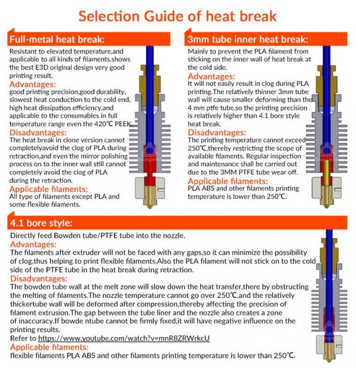

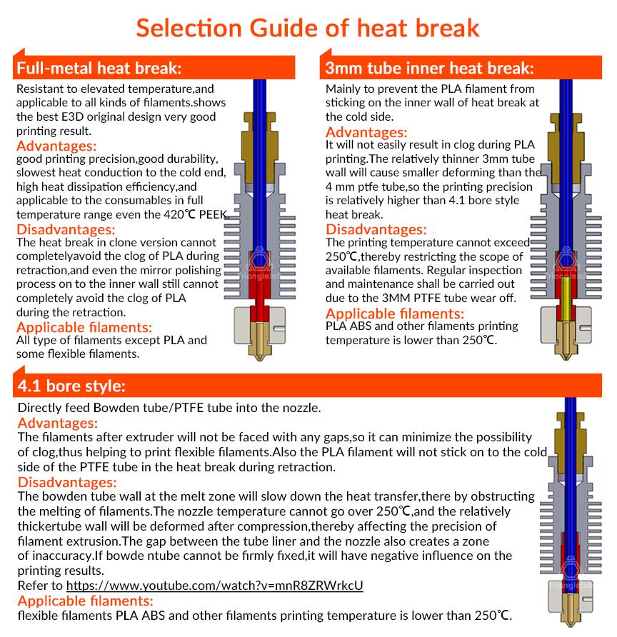

lion02 Posté(e) Avril 6, 2019 Posté(e) Avril 6, 2019 Bonsoir, Je te conseille le vendeur ci-dessous, attention a la configuration https://fr.aliexpress.com/item/Trianglelab-Highall-m-tal-v6-hotend-12-V-24-V-distance-Bowen-impression-J-t-te/32844028127.html?spm=a2g0w.10010108.100007.4.29906b73Io8gGN&pvid=a82a1e14-9020-415a-8d5c-f8d2aba99f18&gps-id=pcDetailLeftTopSell&scm=1007.13482.95643.0&scm-url=1007.13482.95643.0&scm_id=1007.13482.95643.0
