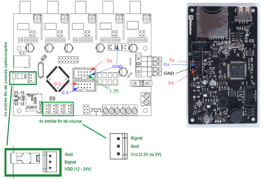

Rlv Posté(e) Novembre 20, 2020 Partager Posté(e) Novembre 20, 2020 Hello, The UART mode use a RX and a TX line (and probably a Reset line ) : it's bascially a serial port. The 12864 use a parallel mode. (you can find the datasheet with google). I'll be hard to find out what's wrong without a scheme . How do you connect the screen with the main board ? Lien vers le commentaire Partager sur d’autres sites More sharing options...

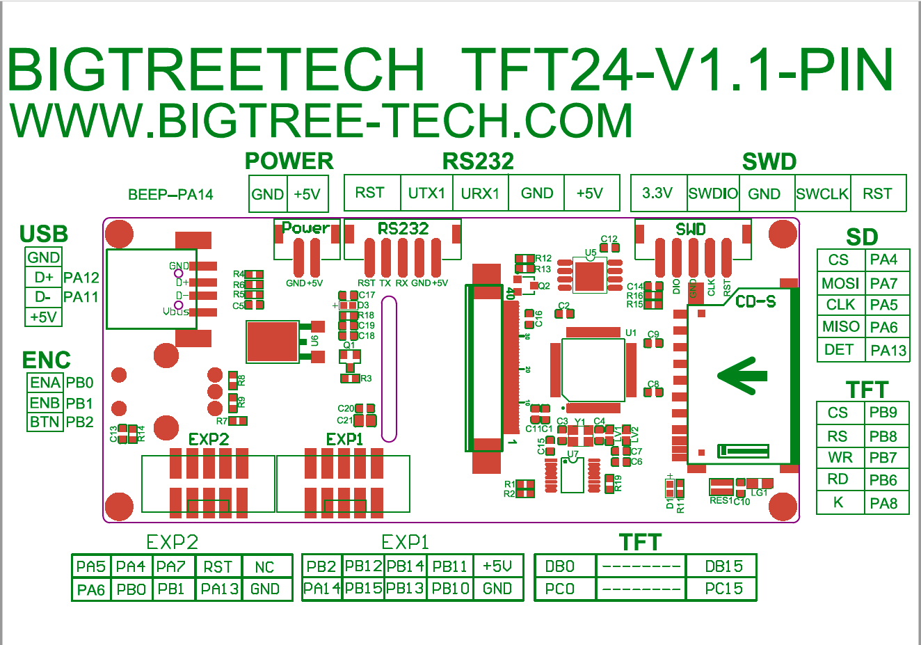

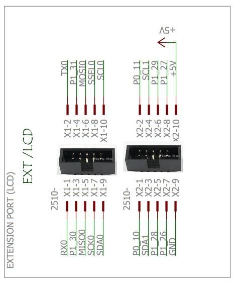

nikolas Posté(e) Novembre 20, 2020 Auteur Partager Posté(e) Novembre 20, 2020 I have connect with uart mode, based on a scheme I found here on another post. I connected the cables except the reset, but the screen dont open. I prefer to use this screen as 12864 mode, but have difficult time to figure out the right cables. When I connect with parallel mode, the screen works on uart mode, but there is no communication with the printer. When I change to 12864 mode, the screen is black. I am attaching the pins for the new screen and the pins of the motherboard, if anyone could help me, I will appreciate that. Thank you Lien vers le commentaire Partager sur d’autres sites More sharing options...

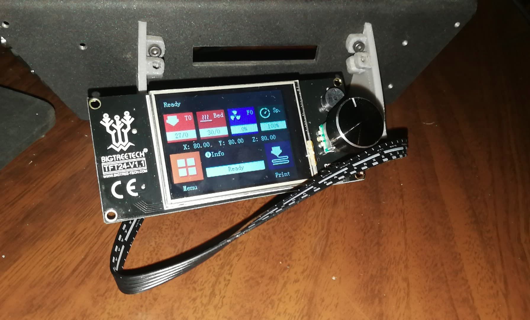

nikolas Posté(e) Novembre 21, 2020 Auteur Partager Posté(e) Novembre 21, 2020 Hi, with the help of a friend, we managed to make the btt tft24 screen to work, with uart connection and touch mode. I am able to perform homing, to set temperatures for the nozzle and the bed, and to start/stop fans. There is a problem now with the calibration probe. I cannot perform levelling using the probe. Have you any idea what is happening and how to overcome this problem? Thank you in advance Lien vers le commentaire Partager sur d’autres sites More sharing options...
