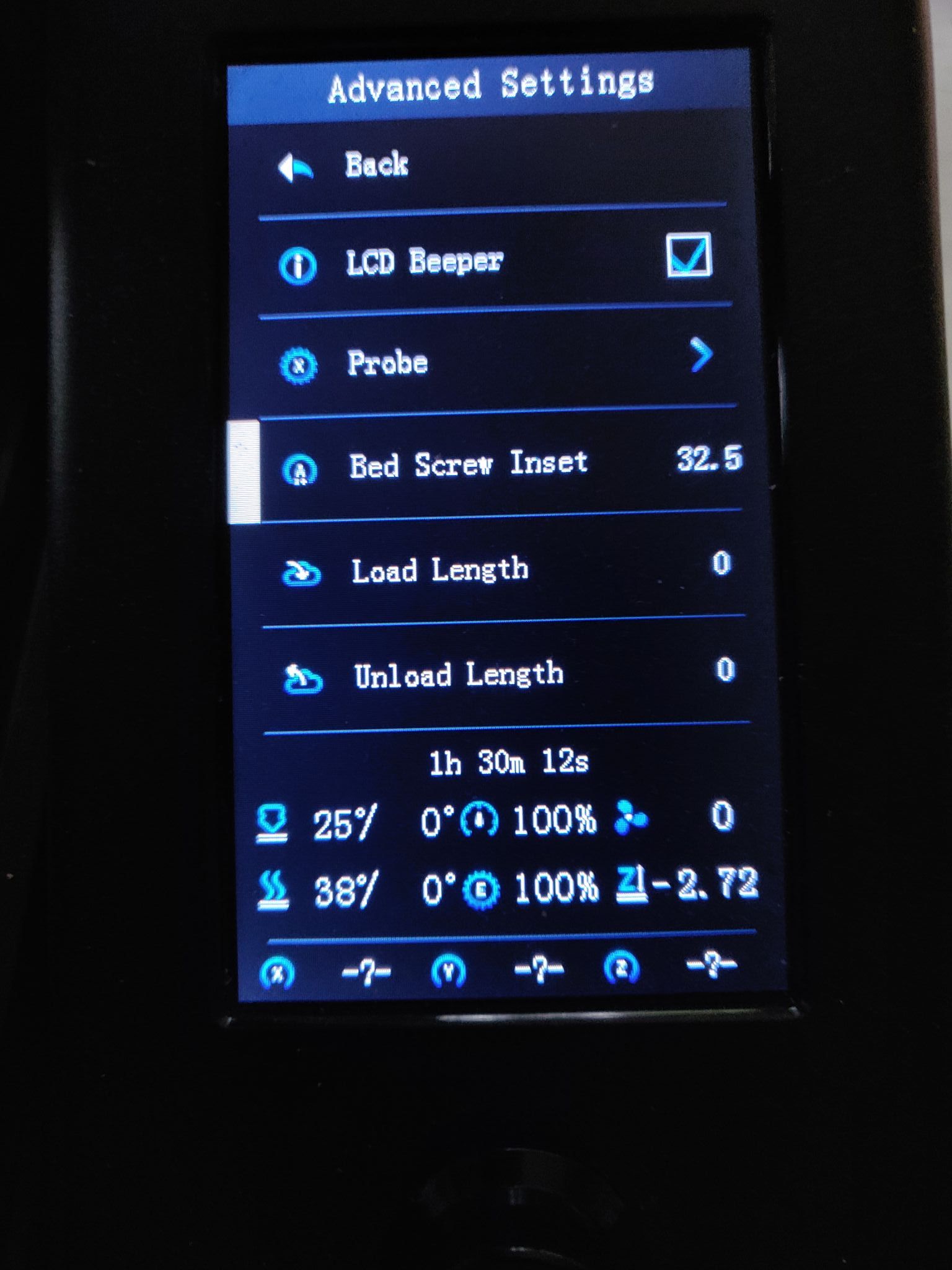

Après mise à jour de Marlin Jyers sur Ender3 v2  ce jour, est apparu dans le menu advanced setting (Control) l'option paramétrable Bed screw inset.
Y-a-t 'il d'autres  modèles, marques, machines sous Marlin qui ont cette option ?
C'est quoi ? !!! unité mm? (32.5) valeur mise par défaut dans le firmware marlin (Jyers 1.3.5).
Merci🙂
Ça doit probablement être utilisé par la section «probing margins» de configuration_adv.h :
Citation
 * Probing Margins
 * Override PROBING_MARGIN for each side of the build plate
 * Useful to get probe points to exact positions on targets or
 * to allow leveling to avoid plate clamps on only specific
 * sides of the bed. With NOZZLE_AS_PROBE negative values are
 * allowed, to permit probing outside the bed.
 * If you are replacing the prior *_PROBE_BED_POSITION options,
 * LEFT and FRONT values in most cases will map directly over
 * RIGHT and REAR would be the inverse such as
 * (X/Y_BED_SIZE - RIGHT/BACK_PROBE_BED_POSITION)
 * This will allow all positions to match at compilation, however
 * should the probe position be modified with M851XY then the
 * probe points will follow. This prevents any change from causing
 * the probe to be unable to reach any points.
#if PROBE_SELECTED && !IS_KINEMATIC
  //#define PROBING_MARGIN_LEFT PROBING_MARGIN
  //#define PROBING_MARGIN_RIGHT PROBING_MARGIN
  //#define PROBING_MARGIN_FRONT PROBING_MARGIN
  //#define PROBING_MARGIN_BACK PROBING_MARGIN
#endif
