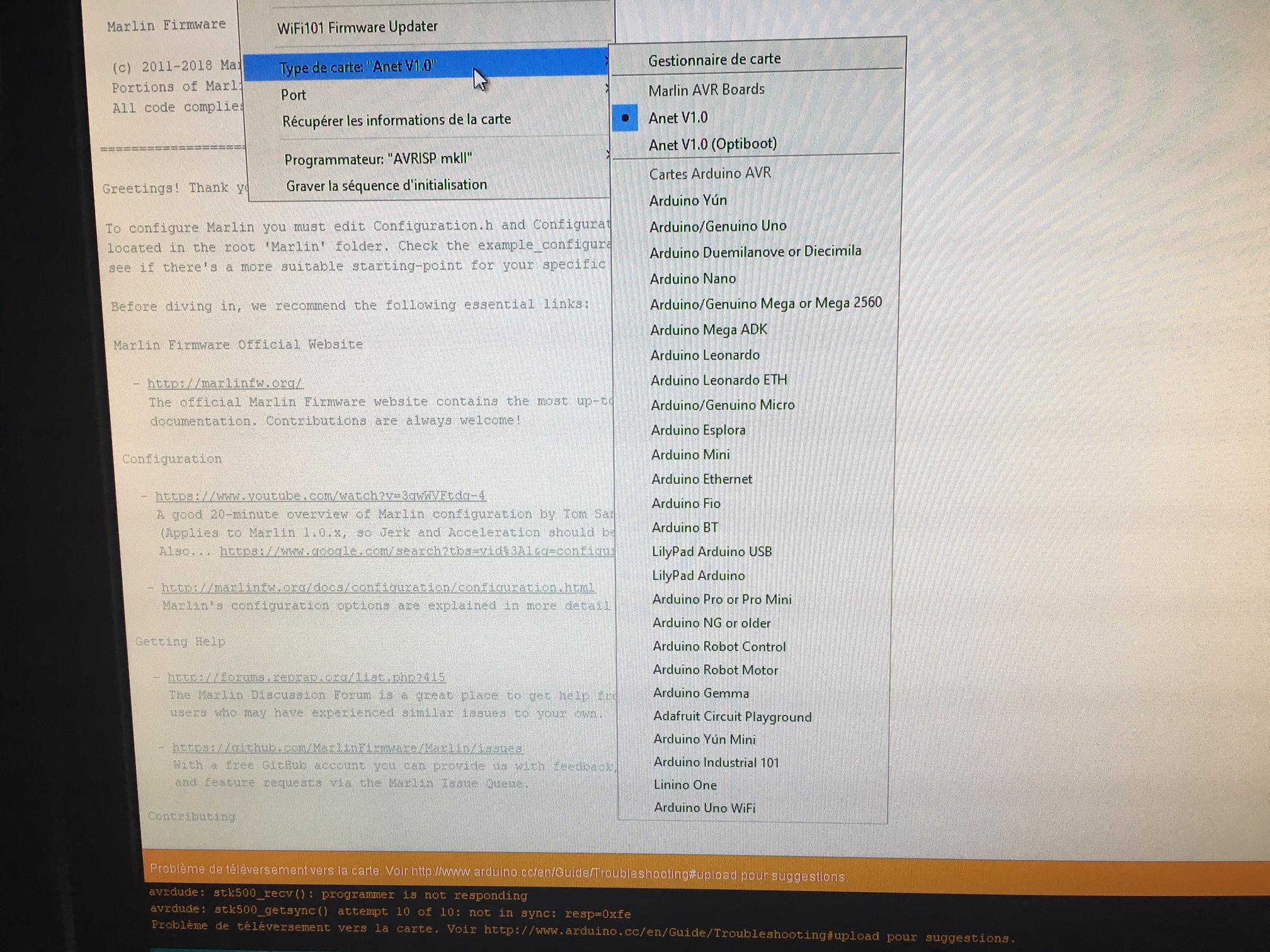

    salut les gars @Maekeet @Schyzo mise à jour du driver CH340 pour windows64 OK Vérification du taux de transfert du port COM de l'imprimante à 1152000 bits par seconde OK Essaie de téléversement avec deux câbles différents KO. J'ai toujours le même message d'erreur. Arduino : 1.8.5 (Windows 10), Carte : "Anet V1.0" In file included from C:\Users\utilisateur\AppData\Local\Arduino15\packages\arduino\hardware\avr\1.6.21\cores\arduino/Arduino.h:257:0, from sketch\HAL.h:36, from sketch\MarlinConfig.h:39, from sketch\G26_Mesh_Validation_Tool.cpp:27: D:\Program Files (x86)\Arduino\hardware\anet\avr\variants\sanguino/pins_arduino.h:43:0: warning: "TIMER2" redefined #define TIMER2 5 ^ In file included from sketch\HAL.h:36:0, from sketch\MarlinConfig.h:39, from sketch\G26_Mesh_Validation_Tool.cpp:27: C:\Users\utilisateur\AppData\Local\Arduino15\packages\arduino\hardware\avr\1.6.21\cores\arduino/Arduino.h:210:0: note: this is the location of the previous definition #define TIMER2 6 ^ In file included from C:\Users\utilisateur\AppData\Local\Arduino15\packages\arduino\hardware\avr\1.6.21\cores\arduino/Arduino.h:257:0, from sketch\HAL.h:36, from sketch\MarlinConfig.h:39, from sketch\G26_Mesh_Validation_Tool.cpp:27: D:\Program Files (x86)\Arduino\hardware\anet\avr\variants\sanguino/pins_arduino.h:44:0: warning: "TIMER2A" redefined #define TIMER2A 6 ^ In file included from sketch\HAL.h:36:0, from sketch\MarlinConfig.h:39, from sketch\G26_Mesh_Validation_Tool.cpp:27: C:\Users\utilisateur\AppData\Local\Arduino15\packages\arduino\hardware\avr\1.6.21\cores\arduino/Arduino.h:211:0: note: this is the location of the previous definition #define TIMER2A 7 ^ In file included from C:\Users\utilisateur\AppData\Local\Arduino15\packages\arduino\hardware\avr\1.6.21\cores\arduino/Arduino.h:257:0, from sketch\HAL.h:36, from sketch\MarlinConfig.h:39, from sketch\G26_Mesh_Validation_Tool.cpp:27: D:\Program Files (x86)\Arduino\hardware\anet\avr\variants\sanguino/pins_arduino.h:45:0: warning: "TIMER2B" redefined #define TIMER2B 7 ^ In file included from sketch\HAL.h:36:0, from sketch\MarlinConfig.h:39, from sketch\G26_Mesh_Validation_Tool.cpp:27: C:\Users\utilisateur\AppData\Local\Arduino15\packages\arduino\hardware\avr\1.6.21\cores\arduino/Arduino.h:212:0: note: this is the location of the previous definition #define TIMER2B 8 ^ In file included from C:\Users\utilisateur\AppData\Local\Arduino15\packages\arduino\hardware\avr\1.6.21\cores\arduino/Arduino.h:257:0, from sketch\HAL.h:36, from sketch\MarlinConfig.h:39, from sketch\G26_Mesh_Validation_Tool.cpp:27: D:\Program Files (x86)\Arduino\hardware\anet\avr\variants\sanguino/pins_arduino.h:47:0: warning: "TIMER3A" redefined #define TIMER3A 8 ^ In file included from sketch\HAL.h:36:0, from sketch\MarlinConfig.h:39, from sketch\G26_Mesh_Validation_Tool.cpp:27: C:\Users\utilisateur\AppData\Local\Arduino15\packages\arduino\hardware\avr\1.6.21\cores\arduino/Arduino.h:214:0: note: this is the location of the previous definition #define TIMER3A 9 ^ In file included from C:\Users\utilisateur\AppData\Local\Arduino15\packages\arduino\hardware\avr\1.6.21\cores\arduino/Arduino.h:257:0, from sketch\HAL.h:36, from sketch\MarlinConfig.h:39, from sketch\G26_Mesh_Validation_Tool.cpp:27: D:\Program Files (x86)\Arduino\hardware\anet\avr\variants\sanguino/pins_arduino.h:48:0: warning: "TIMER3B" redefined #define TIMER3B 9 ^ In file included from sketch\HAL.h:36:0, from sketch\MarlinConfig.h:39, from sketch\G26_Mesh_Validation_Tool.cpp:27: C:\Users\utilisateur\AppData\Local\Arduino15\packages\arduino\hardware\avr\1.6.21\cores\arduino/Arduino.h:215:0: note: this is the location of the previous definition #define TIMER3B 10 ^ In file included from C:\Users\utilisateur\AppData\Local\Arduino15\packages\arduino\hardware\avr\1.6.21\cores\arduino/Arduino.h:257:0, from sketch\HAL.h:36, from sketch\MarlinConfig.h:39, from sketch\G26_Mesh_Validation_Tool.cpp:27: D:\Program Files (x86)\Arduino\hardware\anet\avr\variants\sanguino/pins_arduino.h:49:0: warning: "TIMER3C" redefined #define TIMER3C 10 ^ In file included from sketch\HAL.h:36:0, from sketch\MarlinConfig.h:39, from sketch\G26_Mesh_Validation_Tool.cpp:27: C:\Users\utilisateur\AppData\Local\Arduino15\packages\arduino\hardware\avr\1.6.21\cores\arduino/Arduino.h:216:0: note: this is the location of the previous definition #define TIMER3C 11 ^ In file included from C:\Users\utilisateur\AppData\Local\Arduino15\packages\arduino\hardware\avr\1.6.21\cores\arduino/Arduino.h:257:0, from sketch\HAL.h:36, from sketch\MarlinConfig.h:39, from sketch\G26_Mesh_Validation_Tool.cpp:27: D:\Program Files (x86)\Arduino\hardware\anet\avr\variants\sanguino/pins_arduino.h:50:0: warning: "TIMER4A" redefined #define TIMER4A 11 ^ In file included from sketch\HAL.h:36:0, from sketch\MarlinConfig.h:39, from sketch\G26_Mesh_Validation_Tool.cpp:27: C:\Users\utilisateur\AppData\Local\Arduino15\packages\arduino\hardware\avr\1.6.21\cores\arduino/Arduino.h:217:0: note: this is the location of the previous definition #define TIMER4A 12 ^ In file included from C:\Users\utilisateur\AppData\Local\Arduino15\packages\arduino\hardware\avr\1.6.21\cores\arduino/Arduino.h:257:0, from sketch\HAL.h:36, from sketch\MarlinConfig.h:39, from sketch\G26_Mesh_Validation_Tool.cpp:27: D:\Program Files (x86)\Arduino\hardware\anet\avr\variants\sanguino/pins_arduino.h:51:0: warning: "TIMER4B" redefined #define TIMER4B 12 ^ In file included from sketch\HAL.h:36:0, from sketch\MarlinConfig.h:39, from sketch\G26_Mesh_Validation_Tool.cpp:27: C:\Users\utilisateur\AppData\Local\Arduino15\packages\arduino\hardware\avr\1.6.21\cores\arduino/Arduino.h:218:0: note: this is the location of the previous definition #define TIMER4B 13 ^ In file included from C:\Users\utilisateur\AppData\Local\Arduino15\packages\arduino\hardware\avr\1.6.21\cores\arduino/Arduino.h:257:0, from sketch\HAL.h:36, from sketch\MarlinConfig.h:39, from sketch\G26_Mesh_Validation_Tool.cpp:27: D:\Program Files (x86)\Arduino\hardware\anet\avr\variants\sanguino/pins_arduino.h:52:0: warning: "TIMER4C" redefined #define TIMER4C 13 ^ In file included from sketch\HAL.h:36:0, from sketch\MarlinConfig.h:39, from sketch\G26_Mesh_Validation_Tool.cpp:27: C:\Users\utilisateur\AppData\Local\Arduino15\packages\arduino\hardware\avr\1.6.21\cores\arduino/Arduino.h:219:0: note: this is the location of the previous definition #define TIMER4C 14 ^ In file included from C:\Users\utilisateur\AppData\Local\Arduino15\packages\arduino\hardware\avr\1.6.21\cores\arduino/Arduino.h:257:0, from sketch\HAL.h:36, from sketch\MarlinConfig.h:39, from sketch\G26_Mesh_Validation_Tool.cpp:27: D:\Program Files (x86)\Arduino\hardware\anet\avr\variants\sanguino/pins_arduino.h:53:0: warning: "TIMER5A" redefined #define TIMER5A 14 ^ In file included from sketch\HAL.h:36:0, from sketch\MarlinConfig.h:39, from sketch\G26_Mesh_Validation_Tool.cpp:27: C:\Users\utilisateur\AppData\Local\Arduino15\packages\arduino\hardware\avr\1.6.21\cores\arduino/Arduino.h:221:0: note: this is the location of the previous definition #define TIMER5A 16 ^ In file included from C:\Users\utilisateur\AppData\Local\Arduino15\packages\arduino\hardware\avr\1.6.21\cores\arduino/Arduino.h:257:0, from sketch\HAL.h:36, from sketch\MarlinConfig.h:39, from sketch\G26_Mesh_Validation_Tool.cpp:27: D:\Program Files (x86)\Arduino\hardware\anet\avr\variants\sanguino/pins_arduino.h:54:0: warning: "TIMER5B" redefined #define TIMER5B 15 ^ In file included from sketch\HAL.h:36:0, from sketch\MarlinConfig.h:39, from sketch\G26_Mesh_Validation_Tool.cpp:27: C:\Users\utilisateur\AppData\Local\Arduino15\packages\arduino\hardware\avr\1.6.21\cores\arduino/Arduino.h:222:0: note: this is the location of the previous definition #define TIMER5B 17 ^ In file included from C:\Users\utilisateur\AppData\Local\Arduino15\packages\arduino\hardware\avr\1.6.21\cores\arduino/Arduino.h:257:0, from sketch\HAL.h:36, from sketch\MarlinConfig.h:39, from sketch\G26_Mesh_Validation_Tool.cpp:27: D:\Program Files (x86)\Arduino\hardware\anet\avr\variants\sanguino/pins_arduino.h:55:0: warning: "TIMER5C" redefined #define TIMER5C 16 ^ In file included from sketch\HAL.h:36:0, from sketch\MarlinConfig.h:39, from sketch\G26_Mesh_Validation_Tool.cpp:27: C:\Users\utilisateur\AppData\Local\Arduino15\packages\arduino\hardware\avr\1.6.21\cores\arduino/Arduino.h:223:0: note: this is the location of the previous definition #define TIMER5C 18 ^ In file included from C:\Users\utilisateur\AppData\Local\Arduino15\packages\arduino\hardware\avr\1.6.21\cores\arduino/Arduino.h:257:0, from sketch\HAL.h:36, from sketch\MarlinConfig.h:39, from sketch\I2CPositionEncoder.cpp:31: D:\Program Files (x86)\Arduino\hardware\anet\avr\variants\sanguino/pins_arduino.h:43:0: warning: "TIMER2" redefined #define TIMER2 5 ^ In file included from sketch\HAL.h:36:0, from sketch\MarlinConfig.h:39, from sketch\I2CPositionEncoder.cpp:31: C:\Users\utilisateur\AppData\Local\Arduino15\packages\arduino\hardware\avr\1.6.21\cores\arduino/Arduino.h:210:0: note: this is the location of the previous definition #define TIMER2 6 ^ In file included from C:\Users\utilisateur\AppData\Local\Arduino15\packages\arduino\hardware\avr\1.6.21\cores\arduino/Arduino.h:257:0, from sketch\HAL.h:36, from sketch\MarlinConfig.h:39, from sketch\I2CPositionEncoder.cpp:31: D:\Program Files (x86)\Arduino\hardware\anet\avr\variants\sanguino/pins_arduino.h:44:0: warning: "TIMER2A" redefined #define TIMER2A 6 ^ In file included from sketch\HAL.h:36:0, from sketch\MarlinConfig.h:39, from sketch\I2CPositionEncoder.cpp:31: C:\Users\utilisateur\AppData\Local\Arduino15\packages\arduino\hardware\avr\1.6.21\cores\arduino/Arduino.h:211:0: note: this is the location of the previous definition #define TIMER2A 7 ^ In file included from C:\Users\utilisateur\AppData\Local\Arduino15\packages\arduino\hardware\avr\1.6.21\cores\arduino/Arduino.h:257:0, from sketch\HAL.h:36, from sketch\MarlinConfig.h:39, from sketch\I2CPositionEncoder.cpp:31: D:\Program Files (x86)\Arduino\hardware\anet\avr\variants\sanguino/pins_arduino.h:45:0: warning: "TIMER2B" redefined #define TIMER2B 7 ^ In file included from sketch\HAL.h:36:0, from sketch\MarlinConfig.h:39, from sketch\I2CPositionEncoder.cpp:31: C:\Users\utilisateur\AppData\Local\Arduino15\packages\arduino\hardware\avr\1.6.21\cores\arduino/Arduino.h:212:0: note: this is the location of the previous definition #define TIMER2B 8 ^ In file included from C:\Users\utilisateur\AppData\Local\Arduino15\packages\arduino\hardware\avr\1.6.21\cores\arduino/Arduino.h:257:0, from sketch\HAL.h:36, from sketch\MarlinConfig.h:39, from sketch\I2CPositionEncoder.cpp:31: D:\Program Files (x86)\Arduino\hardware\anet\avr\variants\sanguino/pins_arduino.h:47:0: warning: "TIMER3A" redefined #define TIMER3A 8 ^ In file included from sketch\HAL.h:36:0, from sketch\MarlinConfig.h:39, from sketch\I2CPositionEncoder.cpp:31: C:\Users\utilisateur\AppData\Local\Arduino15\packages\arduino\hardware\avr\1.6.21\cores\arduino/Arduino.h:214:0: note: this is the location of the previous definition #define TIMER3A 9 ^ In file included from C:\Users\utilisateur\AppData\Local\Arduino15\packages\arduino\hardware\avr\1.6.21\cores\arduino/Arduino.h:257:0, from sketch\HAL.h:36, from sketch\MarlinConfig.h:39, from sketch\I2CPositionEncoder.cpp:31: D:\Program Files (x86)\Arduino\hardware\anet\avr\variants\sanguino/pins_arduino.h:48:0: warning: "TIMER3B" redefined #define TIMER3B 9 ^ In file included from sketch\HAL.h:36:0, from sketch\MarlinConfig.h:39, from sketch\I2CPositionEncoder.cpp:31: C:\Users\utilisateur\AppData\Local\Arduino15\packages\arduino\hardware\avr\1.6.21\cores\arduino/Arduino.h:215:0: note: this is the location of the previous definition #define TIMER3B 10 ^ In file included from C:\Users\utilisateur\AppData\Local\Arduino15\packages\arduino\hardware\avr\1.6.21\cores\arduino/Arduino.h:257:0, from sketch\HAL.h:36, from sketch\MarlinConfig.h:39, from sketch\I2CPositionEncoder.cpp:31: D:\Program Files (x86)\Arduino\hardware\anet\avr\variants\sanguino/pins_arduino.h:49:0: warning: "TIMER3C" redefined #define TIMER3C 10 ^ In file included from sketch\HAL.h:36:0, from sketch\MarlinConfig.h:39, from sketch\I2CPositionEncoder.cpp:31: C:\Users\utilisateur\AppData\Local\Arduino15\packages\arduino\hardware\avr\1.6.21\cores\arduino/Arduino.h:216:0: note: this is the location of the previous definition #define TIMER3C 11 ^ In file included from C:\Users\utilisateur\AppData\Local\Arduino15\packages\arduino\hardware\avr\1.6.21\cores\arduino/Arduino.h:257:0, from sketch\HAL.h:36, from sketch\MarlinConfig.h:39, from sketch\I2CPositionEncoder.cpp:31: D:\Program Files (x86)\Arduino\hardware\anet\avr\variants\sanguino/pins_arduino.h:50:0: warning: "TIMER4A" redefined #define TIMER4A 11 ^ In file included from sketch\HAL.h:36:0, from sketch\MarlinConfig.h:39, from sketch\I2CPositionEncoder.cpp:31: C:\Users\utilisateur\AppData\Local\Arduino15\packages\arduino\hardware\avr\1.6.21\cores\arduino/Arduino.h:217:0: note: this is the location of the previous definition #define TIMER4A 12 ^ In file included from C:\Users\utilisateur\AppData\Local\Arduino15\packages\arduino\hardware\avr\1.6.21\cores\arduino/Arduino.h:257:0, from sketch\HAL.h:36, from sketch\MarlinConfig.h:39, from sketch\I2CPositionEncoder.cpp:31: D:\Program Files (x86)\Arduino\hardware\anet\avr\variants\sanguino/pins_arduino.h:51:0: warning: "TIMER4B" redefined #define TIMER4B 12 ^ In file included from sketch\HAL.h:36:0, from sketch\MarlinConfig.h:39, from sketch\I2CPositionEncoder.cpp:31: C:\Users\utilisateur\AppData\Local\Arduino15\packages\arduino\hardware\avr\1.6.21\cores\arduino/Arduino.h:218:0: note: this is the location of the previous definition #define TIMER4B 13 ^ In file included from C:\Users\utilisateur\AppData\Local\Arduino15\packages\arduino\hardware\avr\1.6.21\cores\arduino/Arduino.h:257:0, from sketch\HAL.h:36, from sketch\MarlinConfig.h:39, from sketch\I2CPositionEncoder.cpp:31: D:\Program Files (x86)\Arduino\hardware\anet\avr\variants\sanguino/pins_arduino.h:52:0: warning: "TIMER4C" redefined #define TIMER4C 13 ^ In file included from sketch\HAL.h:36:0, from sketch\MarlinConfig.h:39, from sketch\I2CPositionEncoder.cpp:31: C:\Users\utilisateur\AppData\Local\Arduino15\packages\arduino\hardware\avr\1.6.21\cores\arduino/Arduino.h:219:0: note: this is the location of the previous definition #define TIMER4C 14 ^ In file included from C:\Users\utilisateur\AppData\Local\Arduino15\packages\arduino\hardware\avr\1.6.21\cores\arduino/Arduino.h:257:0, from sketch\HAL.h:36, from sketch\MarlinConfig.h:39, from sketch\I2CPositionEncoder.cpp:31: D:\Program Files (x86)\Arduino\hardware\anet\avr\variants\sanguino/pins_arduino.h:53:0: warning: "TIMER5A" redefined #define TIMER5A 14 ^ In file included from sketch\HAL.h:36:0, from sketch\MarlinConfig.h:39, from sketch\I2CPositionEncoder.cpp:31: C:\Users\utilisateur\AppData\Local\Arduino15\packages\arduino\hardware\avr\1.6.21\cores\arduino/Arduino.h:221:0: note: this is the location of the previous definition #define TIMER5A 16 ^ In file included from C:\Users\utilisateur\AppData\Local\Arduino15\packages\arduino\hardware\avr\1.6.21\cores\arduino/Arduino.h:257:0, from sketch\HAL.h:36, from sketch\MarlinConfig.h:39, from sketch\I2CPositionEncoder.cpp:31: D:\Program Files (x86)\Arduino\hardware\anet\avr\variants\sanguino/pins_arduino.h:54:0: warning: "TIMER5B" redefined #define TIMER5B 15 ^ In file included from sketch\HAL.h:36:0, from sketch\MarlinConfig.h:39, from sketch\I2CPositionEncoder.cpp:31: C:\Users\utilisateur\AppData\Local\Arduino15\packages\arduino\hardware\avr\1.6.21\cores\arduino/Arduino.h:222:0: note: this is the location of the previous definition #define TIMER5B 17 ^ In file included from C:\Users\utilisateur\AppData\Local\Arduino15\packages\arduino\hardware\avr\1.6.21\cores\arduino/Arduino.h:257:0, from sketch\HAL.h:36, from sketch\MarlinConfig.h:39, from sketch\I2CPositionEncoder.cpp:31: D:\Program Files (x86)\Arduino\hardware\anet\avr\variants\sanguino/pins_arduino.h:55:0: warning: "TIMER5C" redefined #define TIMER5C 16 ^ In file included from sketch\HAL.h:36:0, from sketch\MarlinConfig.h:39, from sketch\I2CPositionEncoder.cpp:31: C:\Users\utilisateur\AppData\Local\Arduino15\packages\arduino\hardware\avr\1.6.21\cores\arduino/Arduino.h:223:0: note: this is the location of the previous definition #define TIMER5C 18 ^ In file included from C:\Users\utilisateur\AppData\Local\Arduino15\packages\arduino\hardware\avr\1.6.21\cores\arduino/Arduino.h:257:0, from sketch\HAL.h:36, from sketch\MarlinConfig.h:39, from sketch\M100_Free_Mem_Chk.cpp:49: D:\Program Files (x86)\Arduino\hardware\anet\avr\variants\sanguino/pins_arduino.h:43:0: warning: "TIMER2" redefined #define TIMER2 5 ^ In file included from sketch\HAL.h:36:0, from sketch\MarlinConfig.h:39, from sketch\M100_Free_Mem_Chk.cpp:49: C:\Users\utilisateur\AppData\Local\Arduino15\packages\arduino\hardware\avr\1.6.21\cores\arduino/Arduino.h:210:0: note: this is the location of the previous definition #define TIMER2 6 ^ In file included from C:\Users\utilisateur\AppData\Local\Arduino15\packages\arduino\hardware\avr\1.6.21\cores\arduino/Arduino.h:257:0, from sketch\HAL.h:36, from sketch\MarlinConfig.h:39, from sketch\M100_Free_Mem_Chk.cpp:49: D:\Program Files (x86)\Arduino\hardware\anet\avr\variants\sanguino/pins_arduino.h:44:0: warning: "TIMER2A" redefined #define TIMER2A 6 ^ In file included from sketch\HAL.h:36:0, from sketch\MarlinConfig.h:39, from sketch\M100_Free_Mem_Chk.cpp:49: C:\Users\utilisateur\AppData\Local\Arduino15\packages\arduino\hardware\avr\1.6.21\cores\arduino/Arduino.h:211:0: note: this is the location of the previous definition #define TIMER2A 7 ^ In file included from C:\Users\utilisateur\AppData\Local\Arduino15\packages\arduino\hardware\avr\1.6.21\cores\arduino/Arduino.h:257:0, from sketch\HAL.h:36, from sketch\MarlinConfig.h:39, from sketch\M100_Free_Mem_Chk.cpp:49: D:\Program Files (x86)\Arduino\hardware\anet\avr\variants\sanguino/pins_arduino.h:45:0: warning: "TIMER2B" redefined #define TIMER2B 7 ^ In file included from sketch\HAL.h:36:0, from sketch\MarlinConfig.h:39, from sketch\M100_Free_Mem_Chk.cpp:49: C:\Users\utilisateur\AppData\Local\Arduino15\packages\arduino\hardware\avr\1.6.21\cores\arduino/Arduino.h:212:0: note: this is the location of the previous definition #define TIMER2B 8 ^ In file included from C:\Users\utilisateur\AppData\Local\Arduino15\packages\arduino\hardware\avr\1.6.21\cores\arduino/Arduino.h:257:0, from sketch\HAL.h:36, from sketch\MarlinConfig.h:39, from sketch\M100_Free_Mem_Chk.cpp:49: D:\Program Files (x86)\Arduino\hardware\anet\avr\variants\sanguino/pins_arduino.h:47:0: warning: "TIMER3A" redefined #define TIMER3A 8 ^ In file included from sketch\HAL.h:36:0, from sketch\MarlinConfig.h:39, from sketch\M100_Free_Mem_Chk.cpp:49: C:\Users\utilisateur\AppData\Local\Arduino15\packages\arduino\hardware\avr\1.6.21\cores\arduino/Arduino.h:214:0: note: this is the location of the previous definition #define TIMER3A 9 ^ In file included from C:\Users\utilisateur\AppData\Local\Arduino15\packages\arduino\hardware\avr\1.6.21\cores\arduino/Arduino.h:257:0, from sketch\HAL.h:36, from sketch\MarlinConfig.h:39, from sketch\M100_Free_Mem_Chk.cpp:49: D:\Program Files (x86)\Arduino\hardware\anet\avr\variants\sanguino/pins_arduino.h:48:0: warning: "TIMER3B" redefined #define TIMER3B 9 ^ In file included from sketch\HAL.h:36:0, from sketch\MarlinConfig.h:39, from sketch\M100_Free_Mem_Chk.cpp:49: C:\Users\utilisateur\AppData\Local\Arduino15\packages\arduino\hardware\avr\1.6.21\cores\arduino/Arduino.h:215:0: note: this is the location of the previous definition #define TIMER3B 10 ^ In file included from C:\Users\utilisateur\AppData\Local\Arduino15\packages\arduino\hardware\avr\1.6.21\cores\arduino/Arduino.h:257:0, from sketch\HAL.h:36, from sketch\MarlinConfig.h:39, from sketch\M100_Free_Mem_Chk.cpp:49: D:\Program Files (x86)\Arduino\hardware\anet\avr\variants\sanguino/pins_arduino.h:49:0: warning: "TIMER3C" redefined #define TIMER3C 10 ^ In file included from sketch\HAL.h:36:0, from sketch\MarlinConfig.h:39, from sketch\M100_Free_Mem_Chk.cpp:49: C:\Users\utilisateur\AppData\Local\Arduino15\packages\arduino\hardware\avr\1.6.21\cores\arduino/Arduino.h:216:0: note: this is the location of the previous definition #define TIMER3C 11 ^ In file included from C:\Users\utilisateur\AppData\Local\Arduino15\packages\arduino\hardware\avr\1.6.21\cores\arduino/Arduino.h:257:0, from sketch\HAL.h:36, from sketch\MarlinConfig.h:39, from sketch\M100_Free_Mem_Chk.cpp:49: D:\Program Files (x86)\Arduino\hardware\anet\avr\variants\sanguino/pins_arduino.h:50:0: warning: "TIMER4A" redefined #define TIMER4A 11 ^ In file included from sketch\HAL.h:36:0, from sketch\MarlinConfig.h:39, from sketch\M100_Free_Mem_Chk.cpp:49: C:\Users\utilisateur\AppData\Local\Arduino15\packages\arduino\hardware\avr\1.6.21\cores\arduino/Arduino.h:217:0: note: this is the location of the previous definition #define TIMER4A 12 ^ In file included from C:\Users\utilisateur\AppData\Local\Arduino15\packages\arduino\hardware\avr\1.6.21\cores\arduino/Arduino.h:257:0, from sketch\HAL.h:36, from sketch\MarlinConfig.h:39, from sketch\M100_Free_Mem_Chk.cpp:49: D:\Program Files (x86)\Arduino\hardware\anet\avr\variants\sanguino/pins_arduino.h:51:0: warning: "TIMER4B" redefined #define TIMER4B 12 ^ In file included from sketch\HAL.h:36:0, from sketch\MarlinConfig.h:39, from sketch\M100_Free_Mem_Chk.cpp:49: C:\Users\utilisateur\AppData\Local\Arduino15\packages\arduino\hardware\avr\1.6.21\cores\arduino/Arduino.h:218:0: note: this is the location of the previous definition #define TIMER4B 13 ^ In file included from C:\Users\utilisateur\AppData\Local\Arduino15\packages\arduino\hardware\avr\1.6.21\cores\arduino/Arduino.h:257:0, from sketch\HAL.h:36, from sketch\MarlinConfig.h:39, from sketch\M100_Free_Mem_Chk.cpp:49: D:\Program Files (x86)\Arduino\hardware\anet\avr\variants\sanguino/pins_arduino.h:52:0: warning: "TIMER4C" redefined #define TIMER4C 13 ^ In file included from sketch\HAL.h:36:0, from sketch\MarlinConfig.h:39, from sketch\M100_Free_Mem_Chk.cpp:49: C:\Users\utilisateur\AppData\Local\Arduino15\packages\arduino\hardware\avr\1.6.21\cores\arduino/Arduino.h:219:0: note: this is the location of the previous definition #define TIMER4C 14 ^ In file included from C:\Users\utilisateur\AppData\Local\Arduino15\packages\arduino\hardware\avr\1.6.21\cores\arduino/Arduino.h:257:0, from sketch\HAL.h:36, from sketch\MarlinConfig.h:39, from sketch\M100_Free_Mem_Chk.cpp:49: D:\Program Files (x86)\Arduino\hardware\anet\avr\variants\sanguino/pins_arduino.h:53:0: warning: "TIMER5A" redefined #define TIMER5A 14 ^ In file included from sketch\HAL.h:36:0, from sketch\MarlinConfig.h:39, from sketch\M100_Free_Mem_Chk.cpp:49: C:\Users\utilisateur\AppData\Local\Arduino15\packages\arduino\hardware\avr\1.6.21\cores\arduino/Arduino.h:221:0: note: this is the location of the previous definition #define TIMER5A 16 ^ In file included from C:\Users\utilisateur\AppData\Local\Arduino15\packages\arduino\hardware\avr\1.6.21\cores\arduino/Arduino.h:257:0, from sketch\HAL.h:36, from sketch\MarlinConfig.h:39, from sketch\M100_Free_Mem_Chk.cpp:49: D:\Program Files (x86)\Arduino\hardware\anet\avr\variants\sanguino/pins_arduino.h:54:0: warning: "TIMER5B" redefined #define TIMER5B 15 ^ In file included from sketch\HAL.h:36:0, from sketch\MarlinConfig.h:39, from sketch\M100_Free_Mem_Chk.cpp:49: C:\Users\utilisateur\AppData\Local\Arduino15\packages\arduino\hardware\avr\1.6.21\cores\arduino/Arduino.h:222:0: note: this is the location of the previous definition #define TIMER5B 17 ^ In file included from C:\Users\utilisateur\AppData\Local\Arduino15\packages\arduino\hardware\avr\1.6.21\cores\arduino/Arduino.h:257:0, from sketch\HAL.h:36, from sketch\MarlinConfig.h:39, from sketch\M100_Free_Mem_Chk.cpp:49: D:\Program Files (x86)\Arduino\hardware\anet\avr\variants\sanguino/pins_arduino.h:55:0: warning: "TIMER5C" redefined #define TIMER5C 16 ^ In file included from sketch\HAL.h:36:0, from sketch\MarlinConfig.h:39, from sketch\M100_Free_Mem_Chk.cpp:49: C:\Users\utilisateur\AppData\Local\Arduino15\packages\arduino\hardware\avr\1.6.21\cores\arduino/Arduino.h:223:0: note: this is the location of the previous definition #define TIMER5C 18 ^ In file included from C:\Users\utilisateur\AppData\Local\Arduino15\packages\arduino\hardware\avr\1.6.21\cores\arduino/Arduino.h:257:0, from sketch\Marlin.ino.cpp:1: D:\Program Files (x86)\Arduino\hardware\anet\avr\variants\sanguino/pins_arduino.h:43:0: warning: "TIMER2" redefined #define TIMER2 5 ^ In file included from sketch\Marlin.ino.cpp:1:0: C:\Users\utilisateur\AppData\Local\Arduino15\packages\arduino\hardware\avr\1.6.21\cores\arduino/Arduino.h:210:0: note: this is the location of the previous definition #define TIMER2 6 ^ In file included from C:\Users\utilisateur\AppData\Local\Arduino15\packages\arduino\hardware\avr\1.6.21\cores\arduino/Arduino.h:257:0, from sketch\Marlin.ino.cpp:1: D:\Program Files (x86)\Arduino\hardware\anet\avr\variants\sanguino/pins_arduino.h:44:0: warning: "TIMER2A" redefined #define TIMER2A 6 ^ In file included from sketch\Marlin.ino.cpp:1:0: C:\Users\utilisateur\AppData\Local\Arduino15\packages\arduino\hardware\avr\1.6.21\cores\arduino/Arduino.h:211:0: note: this is the location of the previous definition #define TIMER2A 7 ^ In file included from C:\Users\utilisateur\AppData\Local\Arduino15\packages\arduino\hardware\avr\1.6.21\cores\arduino/Arduino.h:257:0, from sketch\Marlin.ino.cpp:1: D:\Program Files (x86)\Arduino\hardware\anet\avr\variants\sanguino/pins_arduino.h:45:0: warning: "TIMER2B" redefined #define TIMER2B 7 ^ In file included from sketch\Marlin.ino.cpp:1:0: C:\Users\utilisateur\AppData\Local\Arduino15\packages\arduino\hardware\avr\1.6.21\cores\arduino/Arduino.h:212:0: note: this is the location of the previous definition #define TIMER2B 8 ^ In file included from C:\Users\utilisateur\AppData\Local\Arduino15\packages\arduino\hardware\avr\1.6.21\cores\arduino/Arduino.h:257:0, from sketch\Marlin.ino.cpp:1: D:\Program Files (x86)\Arduino\hardware\anet\avr\variants\sanguino/pins_arduino.h:47:0: warning: "TIMER3A" redefined #define TIMER3A 8 ^ In file included from sketch\Marlin.ino.cpp:1:0: C:\Users\utilisateur\AppData\Local\Arduino15\packages\arduino\hardware\avr\1.6.21\cores\arduino/Arduino.h:214:0: note: this is the location of the previous definition #define TIMER3A 9 ^ In file included from C:\Users\utilisateur\AppData\Local\Arduino15\packages\arduino\hardware\avr\1.6.21\cores\arduino/Arduino.h:257:0, from sketch\Marlin.ino.cpp:1: D:\Program Files (x86)\Arduino\hardware\anet\avr\variants\sanguino/pins_arduino.h:48:0: warning: "TIMER3B" redefined #define TIMER3B 9 ^ In file included from sketch\Marlin.ino.cpp:1:0: C:\Users\utilisateur\AppData\Local\Arduino15\packages\arduino\hardware\avr\1.6.21\cores\arduino/Arduino.h:215:0: note: this is the location of the previous definition #define TIMER3B 10 ^ In file included from C:\Users\utilisateur\AppData\Local\Arduino15\packages\arduino\hardware\avr\1.6.21\cores\arduino/Arduino.h:257:0, from sketch\Marlin.ino.cpp:1: D:\Program Files (x86)\Arduino\hardware\anet\avr\variants\sanguino/pins_arduino.h:49:0: warning: "TIMER3C" redefined #define TIMER3C 10 ^ In file included from sketch\Marlin.ino.cpp:1:0: C:\Users\utilisateur\AppData\Local\Arduino15\packages\arduino\hardware\avr\1.6.21\cores\arduino/Arduino.h:216:0: note: this is the location of the previous definition #define TIMER3C 11 ^ In file included from C:\Users\utilisateur\AppData\Local\Arduino15\packages\arduino\hardware\avr\1.6.21\cores\arduino/Arduino.h:257:0, from sketch\Marlin.ino.cpp:1: D:\Program Files (x86)\Arduino\hardware\anet\avr\variants\sanguino/pins_arduino.h:50:0: warning: "TIMER4A" redefined #define TIMER4A 11 ^ In file included from sketch\Marlin.ino.cpp:1:0: C:\Users\utilisateur\AppData\Local\Arduino15\packages\arduino\hardware\avr\1.6.21\cores\arduino/Arduino.h:217:0: note: this is the location of the previous definition #define TIMER4A 12 ^ In file included from C:\Users\utilisateur\AppData\Local\Arduino15\packages\arduino\hardware\avr\1.6.21\cores\arduino/Arduino.h:257:0, from sketch\Marlin.ino.cpp:1: D:\Program Files (x86)\Arduino\hardware\anet\avr\variants\sanguino/pins_arduino.h:51:0: warning: "TIMER4B" redefined #define TIMER4B 12 ^ In file included from sketch\Marlin.ino.cpp:1:0: C:\Users\utilisateur\AppData\Local\Arduino15\packages\arduino\hardware\avr\1.6.21\cores\arduino/Arduino.h:218:0: note: this is the location of the previous definition #define TIMER4B 13 ^ In file included from C:\Users\utilisateur\AppData\Local\Arduino15\packages\arduino\hardware\avr\1.6.21\cores\arduino/Arduino.h:257:0, from sketch\Marlin.ino.cpp:1: D:\Program Files (x86)\Arduino\hardware\anet\avr\variants\sanguino/pins_arduino.h:52:0: warning: "TIMER4C" redefined #define TIMER4C 13 ^ In file included from sketch\Marlin.ino.cpp:1:0: C:\Users\utilisateur\AppData\Local\Arduino15\packages\arduino\hardware\avr\1.6.21\cores\arduino/Arduino.h:219:0: note: this is the location of the previous definition #define TIMER4C 14 ^ In file included from C:\Users\utilisateur\AppData\Local\Arduino15\packages\arduino\hardware\avr\1.6.21\cores\arduino/Arduino.h:257:0, from sketch\Marlin.ino.cpp:1: D:\Program Files (x86)\Arduino\hardware\anet\avr\variants\sanguino/pins_arduino.h:53:0: warning: "TIMER5A" redefined #define TIMER5A 14 ^ In file included from sketch\Marlin.ino.cpp:1:0: C:\Users\utilisateur\AppData\Local\Arduino15\packages\arduino\hardware\avr\1.6.21\cores\arduino/Arduino.h:221:0: note: this is the location of the previous definition #define TIMER5A 16 ^ In file included from C:\Users\utilisateur\AppData\Local\Arduino15\packages\arduino\hardware\avr\1.6.21\cores\arduino/Arduino.h:257:0, from sketch\Marlin.ino.cpp:1: D:\Program Files (x86)\Arduino\hardware\anet\avr\variants\sanguino/pins_arduino.h:54:0: warning: "TIMER5B" redefined #define TIMER5B 15 ^ In file included from sketch\Marlin.ino.cpp:1:0: C:\Users\utilisateur\AppData\Local\Arduino15\packages\arduino\hardware\avr\1.6.21\cores\arduino/Arduino.h:222:0: note: this is the location of the previous definition #define TIMER5B 17 ^ In file included from C:\Users\utilisateur\AppData\Local\Arduino15\packages\arduino\hardware\avr\1.6.21\cores\arduino/Arduino.h:257:0, from sketch\Marlin.ino.cpp:1: D:\Program Files (x86)\Arduino\hardware\anet\avr\variants\sanguino/pins_arduino.h:55:0: warning: "TIMER5C" redefined #define TIMER5C 16 ^ In file included from sketch\Marlin.ino.cpp:1:0: C:\Users\utilisateur\AppData\Local\Arduino15\packages\arduino\hardware\avr\1.6.21\cores\arduino/Arduino.h:223:0: note: this is the location of the previous definition #define TIMER5C 18 ^ In file included from C:\Users\utilisateur\AppData\Local\Arduino15\packages\arduino\hardware\avr\1.6.21\cores\arduino/Arduino.h:257:0, from sketch\HAL.h:36, from sketch\MarlinConfig.h:39, from sketch\MarlinSerial.cpp:36: D:\Program Files (x86)\Arduino\hardware\anet\avr\variants\sanguino/pins_arduino.h:43:0: warning: "TIMER2" redefined #define TIMER2 5 ^ In file included from sketch\HAL.h:36:0, from sketch\MarlinConfig.h:39, from sketch\MarlinSerial.cpp:36: C:\Users\utilisateur\AppData\Local\Arduino15\packages\arduino\hardware\avr\1.6.21\cores\arduino/Arduino.h:210:0: note: this is the location of the previous definition #define TIMER2 6 ^ In file included from C:\Users\utilisateur\AppData\Local\Arduino15\packages\arduino\hardware\avr\1.6.21\cores\arduino/Arduino.h:257:0, from sketch\HAL.h:36, from sketch\MarlinConfig.h:39, from sketch\MarlinSerial.cpp:36: D:\Program Files (x86)\Arduino\hardware\anet\avr\variants\sanguino/pins_arduino.h:44:0: warning: "TIMER2A" redefined #define TIMER2A 6 ^ In file included from sketch\HAL.h:36:0, from sketch\MarlinConfig.h:39, from sketch\MarlinSerial.cpp:36: C:\Users\utilisateur\AppData\Local\Arduino15\packages\arduino\hardware\avr\1.6.21\cores\arduino/Arduino.h:211:0: note: this is the location of the previous definition #define TIMER2A 7 ^ In file included from C:\Users\utilisateur\AppData\Local\Arduino15\packages\arduino\hardware\avr\1.6.21\cores\arduino/Arduino.h:257:0, from sketch\HAL.h:36, from sketch\MarlinConfig.h:39, from sketch\MarlinSerial.cpp:36: D:\Program Files (x86)\Arduino\hardware\anet\avr\variants\sanguino/pins_arduino.h:45:0: warning: "TIMER2B" redefined #define TIMER2B 7 ^ In file included from sketch\HAL.h:36:0, from sketch\MarlinConfig.h:39, from sketch\MarlinSerial.cpp:36: C:\Users\utilisateur\AppData\Local\Arduino15\packages\arduino\hardware\avr\1.6.21\cores\arduino/Arduino.h:212:0: note: this is the location of the previous definition #define TIMER2B 8 ^ In file included from C:\Users\utilisateur\AppData\Local\Arduino15\packages\arduino\hardware\avr\1.6.21\cores\arduino/Arduino.h:257:0, from sketch\HAL.h:36, from sketch\MarlinConfig.h:39, from sketch\MarlinSerial.cpp:36: D:\Program Files (x86)\Arduino\hardware\anet\avr\variants\sanguino/pins_arduino.h:47:0: warning: "TIMER3A" redefined #define TIMER3A 8 ^ In file included from sketch\HAL.h:36:0, from sketch\MarlinConfig.h:39, from sketch\MarlinSerial.cpp:36: C:\Users\utilisateur\AppData\Local\Arduino15\packages\arduino\hardware\avr\1.6.21\cores\arduino/Arduino.h:214:0: note: this is the location of the previous definition #define TIMER3A 9 ^ In file included from C:\Users\utilisateur\AppData\Local\Arduino15\packages\arduino\hardware\avr\1.6.21\cores\arduino/Arduino.h:257:0, from sketch\HAL.h:36, from sketch\MarlinConfig.h:39, from sketch\MarlinSerial.cpp:36: D:\Program Files (x86)\Arduino\hardware\anet\avr\variants\sanguino/pins_arduino.h:48:0: warning: "TIMER3B" redefined #define TIMER3B 9 ^ In file included from sketch\HAL.h:36:0, from sketch\MarlinConfig.h:39, from sketch\MarlinSerial.cpp:36: C:\Users\utilisateur\AppData\Local\Arduino15\packages\arduino\hardware\avr\1.6.21\cores\arduino/Arduino.h:215:0: note: this is the location of the previous definition #define TIMER3B 10 ^ In file included from C:\Users\utilisateur\AppData\Local\Arduino15\packages\arduino\hardware\avr\1.6.21\cores\arduino/Arduino.h:257:0, from sketch\HAL.h:36, from sketch\MarlinConfig.h:39, from sketch\MarlinSerial.cpp:36: D:\Program Files (x86)\Arduino\hardware\anet\avr\variants\sanguino/pins_arduino.h:49:0: warning: "TIMER3C" redefined #define TIMER3C 10 ^ In file included from sketch\HAL.h:36:0, from sketch\MarlinConfig.h:39, from sketch\MarlinSerial.cpp:36: C:\Users\utilisateur\AppData\Local\Arduino15\packages\arduino\hardware\avr\1.6.21\cores\arduino/Arduino.h:216:0: note: this is the location of the previous definition #define TIMER3C 11 ^ In file included from C:\Users\utilisateur\AppData\Local\Arduino15\packages\arduino\hardware\avr\1.6.21\cores\arduino/Arduino.h:257:0, from sketch\HAL.h:36, from sketch\MarlinConfig.h:39, from sketch\MarlinSerial.cpp:36: D:\Program Files (x86)\Arduino\hardware\anet\avr\variants\sanguino/pins_arduino.h:50:0: warning: "TIMER4A" redefined #define TIMER4A 11 ^ In file included from sketch\HAL.h:36:0, from sketch\MarlinConfig.h:39, from sketch\MarlinSerial.cpp:36: C:\Users\utilisateur\AppData\Local\Arduino15\packages\arduino\hardware\avr\1.6.21\cores\arduino/Arduino.h:217:0: note: this is the location of the previous definition #define TIMER4A 12 ^ In file included from C:\Users\utilisateur\AppData\Local\Arduino15\packages\arduino\hardware\avr\1.6.21\cores\arduino/Arduino.h:257:0, from sketch\HAL.h:36, from sketch\MarlinConfig.h:39, from sketch\MarlinSerial.cpp:36: D:\Program Files (x86)\Arduino\hardware\anet\avr\variants\sanguino/pins_arduino.h:51:0: warning: "TIMER4B" redefined #define TIMER4B 12 ^ In file included from sketch\HAL.h:36:0, from sketch\MarlinConfig.h:39, from sketch\MarlinSerial.cpp:36: C:\Users\utilisateur\AppData\Local\Arduino15\packages\arduino\hardware\avr\1.6.21\cores\arduino/Arduino.h:218:0: note: this is the location of the previous definition #define TIMER4B 13 ^ In file included from C:\Users\utilisateur\AppData\Local\Arduino15\packages\arduino\hardware\avr\1.6.21\cores\arduino/Arduino.h:257:0, from sketch\HAL.h:36, from sketch\MarlinConfig.h:39, from sketch\MarlinSerial.cpp:36: D:\Program Files (x86)\Arduino\hardware\anet\avr\variants\sanguino/pins_arduino.h:52:0: warning: "TIMER4C" redefined #define TIMER4C 13 ^ In file included from sketch\HAL.h:36:0, from sketch\MarlinConfig.h:39, from sketch\MarlinSerial.cpp:36: C:\Users\utilisateur\AppData\Local\Arduino15\packages\arduino\hardware\avr\1.6.21\cores\arduino/Arduino.h:219:0: note: this is the location of the previous definition #define TIMER4C 14 ^ In file included from C:\Users\utilisateur\AppData\Local\Arduino15\packages\arduino\hardware\avr\1.6.21\cores\arduino/Arduino.h:257:0, from sketch\HAL.h:36, from sketch\MarlinConfig.h:39, from sketch\MarlinSerial.cpp:36: D:\Program Files (x86)\Arduino\hardware\anet\avr\variants\sanguino/pins_arduino.h:53:0: warning: "TIMER5A" redefined #define TIMER5A 14 ^ In file included from sketch\HAL.h:36:0, from sketch\MarlinConfig.h:39, from sketch\MarlinSerial.cpp:36: C:\Users\utilisateur\AppData\Local\Arduino15\packages\arduino\hardware\avr\1.6.21\cores\arduino/Arduino.h:221:0: note: this is the location of the previous definition #define TIMER5A 16 ^ In file included from C:\Users\utilisateur\AppData\Local\Arduino15\packages\arduino\hardware\avr\1.6.21\cores\arduino/Arduino.h:257:0, from sketch\HAL.h:36, from sketch\MarlinConfig.h:39, from sketch\MarlinSerial.cpp:36: D:\Program Files (x86)\Arduino\hardware\anet\avr\variants\sanguino/pins_arduino.h:54:0: warning: "TIMER5B" redefined #define TIMER5B 15 ^ In file included from sketch\HAL.h:36:0, from sketch\MarlinConfig.h:39, from sketch\MarlinSerial.cpp:36: C:\Users\utilisateur\AppData\Local\Arduino15\packages\arduino\hardware\avr\1.6.21\cores\arduino/Arduino.h:222:0: note: this is the location of the previous definition #define TIMER5B 17 ^ In file included from C:\Users\utilisateur\AppData\Local\Arduino15\packages\arduino\hardware\avr\1.6.21\cores\arduino/Arduino.h:257:0, from sketch\HAL.h:36, from sketch\MarlinConfig.h:39, from sketch\MarlinSerial.cpp:36: D:\Program Files (x86)\Arduino\hardware\anet\avr\variants\sanguino/pins_arduino.h:55:0: warning: "TIMER5C" redefined #define TIMER5C 16 ^ In file included from sketch\HAL.h:36:0, from sketch\MarlinConfig.h:39, from sketch\MarlinSerial.cpp:36: C:\Users\utilisateur\AppData\Local\Arduino15\packages\arduino\hardware\avr\1.6.21\cores\arduino/Arduino.h:223:0: note: this is the location of the previous definition #define TIMER5C 18 ^ In file included from C:\Users\utilisateur\AppData\Local\Arduino15\packages\arduino\hardware\avr\1.6.21\cores\arduino/Arduino.h:257:0, from sketch\HAL.h:36, from sketch\MarlinConfig.h:39, from sketch\Marlin.h:35, from sketch\Marlin_main.cpp:252: D:\Program Files (x86)\Arduino\hardware\anet\avr\variants\sanguino/pins_arduino.h:43:0: warning: "TIMER2" redefined #define TIMER2 5 ^ In file included from sketch\HAL.h:36:0, from sketch\MarlinConfig.h:39, from sketch\Marlin.h:35, from sketch\Marlin_main.cpp:252: C:\Users\utilisateur\AppData\Local\Arduino15\packages\arduino\hardware\avr\1.6.21\cores\arduino/Arduino.h:210:0: note: this is the location of the previous definition #define TIMER2 6 ^ In file included from C:\Users\utilisateur\AppData\Local\Arduino15\packages\arduino\hardware\avr\1.6.21\cores\arduino/Arduino.h:257:0, from sketch\HAL.h:36, from sketch\MarlinConfig.h:39, from sketch\Marlin.h:35, from sketch\Marlin_main.cpp:252: D:\Program Files (x86)\Arduino\hardware\anet\avr\variants\sanguino/pins_arduino.h:44:0: warning: "TIMER2A" redefined #define TIMER2A 6 ^ In file included from sketch\HAL.h:36:0, from sketch\MarlinConfig.h:39, from sketch\Marlin.h:35, from sketch\Marlin_main.cpp:252: C:\Users\utilisateur\AppData\Local\Arduino15\packages\arduino\hardware\avr\1.6.21\cores\arduino/Arduino.h:211:0: note: this is the location of the previous definition #define TIMER2A 7 ^ In file included from C:\Users\utilisateur\AppData\Local\Arduino15\packages\arduino\hardware\avr\1.6.21\cores\arduino/Arduino.h:257:0, from sketch\HAL.h:36, from sketch\MarlinConfig.h:39, from sketch\Marlin.h:35, from sketch\Marlin_main.cpp:252: D:\Program Files (x86)\Arduino\hardware\anet\avr\variants\sanguino/pins_arduino.h:45:0: warning: "TIMER2B" redefined #define TIMER2B 7 ^ In file included from sketch\HAL.h:36:0, from sketch\MarlinConfig.h:39, from sketch\Marlin.h:35, from sketch\Marlin_main.cpp:252: C:\Users\utilisateur\AppData\Local\Arduino15\packages\arduino\hardware\avr\1.6.21\cores\arduino/Arduino.h:212:0: note: this is the location of the previous definition #define TIMER2B 8 ^ In file included from C:\Users\utilisateur\AppData\Local\Arduino15\packages\arduino\hardware\avr\1.6.21\cores\arduino/Arduino.h:257:0, from sketch\HAL.h:36, from sketch\MarlinConfig.h:39, from sketch\Marlin.h:35, from sketch\Marlin_main.cpp:252: D:\Program Files (x86)\Arduino\hardware\anet\avr\variants\sanguino/pins_arduino.h:47:0: warning: "TIMER3A" redefined #define TIMER3A 8 ^ In file included from sketch\HAL.h:36:0, from sketch\MarlinConfig.h:39, from sketch\Marlin.h:35, from sketch\Marlin_main.cpp:252: C:\Users\utilisateur\AppData\Local\Arduino15\packages\arduino\hardware\avr\1.6.21\cores\arduino/Arduino.h:214:0: note: this is the location of the previous definition #define TIMER3A 9 ^ In file included from C:\Users\utilisateur\AppData\Local\Arduino15\packages\arduino\hardware\avr\1.6.21\cores\arduino/Arduino.h:257:0, from sketch\HAL.h:36, from sketch\MarlinConfig.h:39, from sketch\Marlin.h:35, from sketch\Marlin_main.cpp:252: D:\Program Files (x86)\Arduino\hardware\anet\avr\variants\sanguino/pins_arduino.h:48:0: warning: "TIMER3B" redefined #define TIMER3B 9 ^ In file included from sketch\HAL.h:36:0, from sketch\MarlinConfig.h:39, from sketch\Marlin.h:35, from sketch\Marlin_main.cpp:252: C:\Users\utilisateur\AppData\Local\Arduino15\packages\arduino\hardware\avr\1.6.21\cores\arduino/Arduino.h:215:0: note: this is the location of the previous definition #define TIMER3B 10 ^ In file included from C:\Users\utilisateur\AppData\Local\Arduino15\packages\arduino\hardware\avr\1.6.21\cores\arduino/Arduino.h:257:0, from sketch\HAL.h:36, from sketch\MarlinConfig.h:39, from sketch\Marlin.h:35, from sketch\Marlin_main.cpp:252: D:\Program Files (x86)\Arduino\hardware\anet\avr\variants\sanguino/pins_arduino.h:49:0: warning: "TIMER3C" redefined #define TIMER3C 10 ^ In file included from sketch\HAL.h:36:0, from sketch\MarlinConfig.h:39, from sketch\Marlin.h:35, from sketch\Marlin_main.cpp:252: C:\Users\utilisateur\AppData\Local\Arduino15\packages\arduino\hardware\avr\1.6.21\cores\arduino/Arduino.h:216:0: note: this is the location of the previous definition #define TIMER3C 11 ^ In file included from C:\Users\utilisateur\AppData\Local\Arduino15\packages\arduino\hardware\avr\1.6.21\cores\arduino/Arduino.h:257:0, from sketch\HAL.h:36, from sketch\MarlinConfig.h:39, from sketch\Marlin.h:35, from sketch\Marlin_main.cpp:252: D:\Program Files (x86)\Arduino\hardware\anet\avr\variants\sanguino/pins_arduino.h:50:0: warning: "TIMER4A" redefined #define TIMER4A 11 ^ In file included from sketch\HAL.h:36:0, from sketch\MarlinConfig.h:39, from sketch\Marlin.h:35, from sketch\Marlin_main.cpp:252: C:\Users\utilisateur\AppData\Local\Arduino15\packages\arduino\hardware\avr\1.6.21\cores\arduino/Arduino.h:217:0: note: this is the location of the previous definition #define TIMER4A 12 ^ In file included from C:\Users\utilisateur\AppData\Local\Arduino15\packages\arduino\hardware\avr\1.6.21\cores\arduino/Arduino.h:257:0, from sketch\HAL.h:36, from sketch\MarlinConfig.h:39, from sketch\Marlin.h:35, from sketch\Marlin_main.cpp:252: D:\Program Files (x86)\Arduino\hardware\anet\avr\variants\sanguino/pins_arduino.h:51:0: warning: "TIMER4B" redefined #define TIMER4B 12 ^ In file included from sketch\HAL.h:36:0, from sketch\MarlinConfig.h:39, from sketch\Marlin.h:35, from sketch\Marlin_main.cpp:252: C:\Users\utilisateur\AppData\Local\Arduino15\packages\arduino\hardware\avr\1.6.21\cores\arduino/Arduino.h:218:0: note: this is the location of the previous definition #define TIMER4B 13 ^ In file included from C:\Users\utilisateur\AppData\Local\Arduino15\packages\arduino\hardware\avr\1.6.21\cores\arduino/Arduino.h:257:0, from sketch\HAL.h:36, from sketch\MarlinConfig.h:39, from sketch\Marlin.h:35, from sketch\Marlin_main.cpp:252: D:\Program Files (x86)\Arduino\hardware\anet\avr\variants\sanguino/pins_arduino.h:52:0: warning: "TIMER4C" redefined #define TIMER4C 13 ^ In file included from sketch\HAL.h:36:0, from sketch\MarlinConfig.h:39, from sketch\Marlin.h:35, from sketch\Marlin_main.cpp:252: C:\Users\utilisateur\AppData\Local\Arduino15\packages\arduino\hardware\avr\1.6.21\cores\arduino/Arduino.h:219:0: note: this is the location of the previous definition #define TIMER4C 14 ^ In file included from C:\Users\utilisateur\AppData\Local\Arduino15\packages\arduino\hardware\avr\1.6.21\cores\arduino/Arduino.h:257:0, from sketch\HAL.h:36, from sketch\MarlinConfig.h:39, from sketch\Marlin.h:35, from sketch\Marlin_main.cpp:252: D:\Program Files (x86)\Arduino\hardware\anet\avr\variants\sanguino/pins_arduino.h:53:0: warning: "TIMER5A" redefined #define TIMER5A 14 ^ In file included from sketch\HAL.h:36:0, from sketch\MarlinConfig.h:39, from sketch\Marlin.h:35, from sketch\Marlin_main.cpp:252: C:\Users\utilisateur\AppData\Local\Arduino15\packages\arduino\hardware\avr\1.6.21\cores\arduino/Arduino.h:221:0: note: this is the location of the previous definition #define TIMER5A 16 ^ In file included from C:\Users\utilisateur\AppData\Local\Arduino15\packages\arduino\hardware\avr\1.6.21\cores\arduino/Arduino.h:257:0, from sketch\HAL.h:36, from sketch\MarlinConfig.h:39, from sketch\Marlin.h:35, from sketch\Marlin_main.cpp:252: D:\Program Files (x86)\Arduino\hardware\anet\avr\variants\sanguino/pins_arduino.h:54:0: warning: "TIMER5B" redefined #define TIMER5B 15 ^ In file included from sketch\HAL.h:36:0, from sketch\MarlinConfig.h:39, from sketch\Marlin.h:35, from sketch\Marlin_main.cpp:252: C:\Users\utilisateur\AppData\Local\Arduino15\packages\arduino\hardware\avr\1.6.21\cores\arduino/Arduino.h:222:0: note: this is the location of the previous definition #define TIMER5B 17 ^ In file included from C:\Users\utilisateur\AppData\Local\Arduino15\packages\arduino\hardware\avr\1.6.21\cores\arduino/Arduino.h:257:0, from sketch\HAL.h:36, from sketch\MarlinConfig.h:39, from sketch\Marlin.h:35, from sketch\Marlin_main.cpp:252: D:\Program Files (x86)\Arduino\hardware\anet\avr\variants\sanguino/pins_arduino.h:55:0: warning: "TIMER5C" redefined #define TIMER5C 16 ^ In file included from sketch\HAL.h:36:0, from sketch\MarlinConfig.h:39, from sketch\Marlin.h:35, from sketch\Marlin_main.cpp:252: C:\Users\utilisateur\AppData\Local\Arduino15\packages\arduino\hardware\avr\1.6.21\cores\arduino/Arduino.h:223:0: note: this is the location of the previous definition #define TIMER5C 18 ^ In file included from C:\Users\utilisateur\AppData\Local\Arduino15\packages\arduino\hardware\avr\1.6.21\cores\arduino/Arduino.h:257:0, from sketch\HAL.h:36, from sketch\MarlinConfig.h:39, from sketch\Max7219_Debug_LEDs.cpp:38: D:\Program Files (x86)\Arduino\hardware\anet\avr\variants\sanguino/pins_arduino.h:43:0: warning: "TIMER2" redefined #define TIMER2 5 ^ In file included from sketch\HAL.h:36:0, from sketch\MarlinConfig.h:39, from sketch\Max7219_Debug_LEDs.cpp:38: C:\Users\utilisateur\AppData\Local\Arduino15\packages\arduino\hardware\avr\1.6.21\cores\arduino/Arduino.h:210:0: note: this is the location of the previous definition #define TIMER2 6 ^ In file included from C:\Users\utilisateur\AppData\Local\Arduino15\packages\arduino\hardware\avr\1.6.21\cores\arduino/Arduino.h:257:0, from sketch\HAL.h:36, from sketch\MarlinConfig.h:39, from sketch\Max7219_Debug_LEDs.cpp:38: D:\Program Files (x86)\Arduino\hardware\anet\avr\variants\sanguino/pins_arduino.h:44:0: warning: "TIMER2A" redefined #define TIMER2A 6 ^ In file included from sketch\HAL.h:36:0, from sketch\MarlinConfig.h:39, from sketch\Max7219_Debug_LEDs.cpp:38: C:\Users\utilisateur\AppData\Local\Arduino15\packages\arduino\hardware\avr\1.6.21\cores\arduino/Arduino.h:211:0: note: this is the location of the previous definition #define TIMER2A 7 ^ In file included from C:\Users\utilisateur\AppData\Local\Arduino15\packages\arduino\hardware\avr\1.6.21\cores\arduino/Arduino.h:257:0, from sketch\HAL.h:36, from sketch\MarlinConfig.h:39, from sketch\Max7219_Debug_LEDs.cpp:38: D:\Program Files (x86)\Arduino\hardware\anet\avr\variants\sanguino/pins_arduino.h:45:0: warning: "TIMER2B" redefined #define TIMER2B 7 ^ In file included from sketch\HAL.h:36:0, from sketch\MarlinConfig.h:39, from sketch\Max7219_Debug_LEDs.cpp:38: C:\Users\utilisateur\AppData\Local\Arduino15\packages\arduino\hardware\avr\1.6.21\cores\arduino/Arduino.h:212:0: note: this is the location of the previous definition #define TIMER2B 8 ^ In file included from C:\Users\utilisateur\AppData\Local\Arduino15\packages\arduino\hardware\avr\1.6.21\cores\arduino/Arduino.h:257:0, from sketch\HAL.h:36, from sketch\MarlinConfig.h:39, from sketch\Max7219_Debug_LEDs.cpp:38: D:\Program Files (x86)\Arduino\hardware\anet\avr\variants\sanguino/pins_arduino.h:47:0: warning: "TIMER3A" redefined #define TIMER3A 8 ^ In file included from sketch\HAL.h:36:0, from sketch\MarlinConfig.h:39, from sketch\Max7219_Debug_LEDs.cpp:38: C:\Users\utilisateur\AppData\Local\Arduino15\packages\arduino\hardware\avr\1.6.21\cores\arduino/Arduino.h:214:0: note: this is the location of the previous definition #define TIMER3A 9 ^ In file included from C:\Users\utilisateur\AppData\Local\Arduino15\packages\arduino\hardware\avr\1.6.21\cores\arduino/Arduino.h:257:0, from sketch\HAL.h:36, from sketch\MarlinConfig.h:39, from sketch\Max7219_Debug_LEDs.cpp:38: D:\Program Files (x86)\Arduino\hardware\anet\avr\variants\sanguino/pins_arduino.h:48:0: warning: "TIMER3B" redefined #define TIMER3B 9 ^ In file included from sketch\HAL.h:36:0, from sketch\MarlinConfig.h:39, from sketch\Max7219_Debug_LEDs.cpp:38: C:\Users\utilisateur\AppData\Local\Arduino15\packages\arduino\hardware\avr\1.6.21\cores\arduino/Arduino.h:215:0: note: this is the location of the previous definition #define TIMER3B 10 ^ In file included from C:\Users\utilisateur\AppData\Local\Arduino15\packages\arduino\hardware\avr\1.6.21\cores\arduino/Arduino.h:257:0, from sketch\HAL.h:36, from sketch\MarlinConfig.h:39, from sketch\Max7219_Debug_LEDs.cpp:38: D:\Program Files (x86)\Arduino\hardware\anet\avr\variants\sanguino/pins_arduino.h:49:0: warning: "TIMER3C" redefined #define TIMER3C 10 ^ In file included from sketch\HAL.h:36:0, from sketch\MarlinConfig.h:39, from sketch\Max7219_Debug_LEDs.cpp:38: C:\Users\utilisateur\AppData\Local\Arduino15\packages\arduino\hardware\avr\1.6.21\cores\arduino/Arduino.h:216:0: note: this is the location of the previous definition #define TIMER3C 11 ^ In file included from C:\Users\utilisateur\AppData\Local\Arduino15\packages\arduino\hardware\avr\1.6.21\cores\arduino/Arduino.h:257:0, from sketch\HAL.h:36, from sketch\MarlinConfig.h:39, from sketch\Max7219_Debug_LEDs.cpp:38: D:\Program Files (x86)\Arduino\hardware\anet\avr\variants\sanguino/pins_arduino.h:50:0: warning: "TIMER4A" redefined #define TIMER4A 11 ^ In file included from sketch\HAL.h:36:0, from sketch\MarlinConfig.h:39, from sketch\Max7219_Debug_LEDs.cpp:38: C:\Users\utilisateur\AppData\Local\Arduino15\packages\arduino\hardware\avr\1.6.21\cores\arduino/Arduino.h:217:0: note: this is the location of the previous definition #define TIMER4A 12 ^ In file included from C:\Users\utilisateur\AppData\Local\Arduino15\packages\arduino\hardware\avr\1.6.21\cores\arduino/Arduino.h:257:0, from sketch\HAL.h:36, from sketch\MarlinConfig.h:39, from sketch\Max7219_Debug_LEDs.cpp:38: D:\Program Files (x86)\Arduino\hardware\anet\avr\variants\sanguino/pins_arduino.h:51:0: warning: "TIMER4B" redefined #define TIMER4B 12 ^ In file included from sketch\HAL.h:36:0, from sketch\MarlinConfig.h:39, from sketch\Max7219_Debug_LEDs.cpp:38: C:\Users\utilisateur\AppData\Local\Arduino15\packages\arduino\hardware\avr\1.6.21\cores\arduino/Arduino.h:218:0: note: this is the location of the previous definition #define TIMER4B 13 ^ In file included from C:\Users\utilisateur\AppData\Local\Arduino15\packages\arduino\hardware\avr\1.6.21\cores\arduino/Arduino.h:257:0, from sketch\HAL.h:36, from sketch\MarlinConfig.h:39, from sketch\Max7219_Debug_LEDs.cpp:38: D:\Program Files (x86)\Arduino\hardware\anet\avr\variants\sanguino/pins_arduino.h:52:0: warning: "TIMER4C" redefined #define TIMER4C 13 ^ In file included from sketch\HAL.h:36:0, from sketch\MarlinConfig.h:39, from sketch\Max7219_Debug_LEDs.cpp:38: C:\Users\utilisateur\AppData\Local\Arduino15\packages\arduino\hardware\avr\1.6.21\cores\arduino/Arduino.h:219:0: note: this is the location of the previous definition #define TIMER4C 14 ^ In file included from C:\Users\utilisateur\AppData\Local\Arduino15\packages\arduino\hardware\avr\1.6.21\cores\arduino/Arduino.h:257:0, from sketch\HAL.h:36, from sketch\MarlinConfig.h:39, from sketch\Max7219_Debug_LEDs.cpp:38: D:\Program Files (x86)\Arduino\hardware\anet\avr\variants\sanguino/pins_arduino.h:53:0: warning: "TIMER5A" redefined #define TIMER5A 14 ^ In file included from sketch\HAL.h:36:0, from sketch\MarlinConfig.h:39, from sketch\Max7219_Debug_LEDs.cpp:38: C:\Users\utilisateur\AppData\Local\Arduino15\packages\arduino\hardware\avr\1.6.21\cores\arduino/Arduino.h:221:0: note: this is the location of the previous definition #define TIMER5A 16 ^ In file included from C:\Users\utilisateur\AppData\Local\Arduino15\packages\arduino\hardware\avr\1.6.21\cores\arduino/Arduino.h:257:0, from sketch\HAL.h:36, from sketch\MarlinConfig.h:39, from sketch\Max7219_Debug_LEDs.cpp:38: D:\Program Files (x86)\Arduino\hardware\anet\avr\variants\sanguino/pins_arduino.h:54:0: warning: "TIMER5B" redefined #define TIMER5B 15 ^ In file included from sketch\HAL.h:36:0, from sketch\MarlinConfig.h:39, from sketch\Max7219_Debug_LEDs.cpp:38: C:\Users\utilisateur\AppData\Local\Arduino15\packages\arduino\hardware\avr\1.6.21\cores\arduino/Arduino.h:222:0: note: this is the location of the previous definition #define TIMER5B 17 ^ In file included from C:\Users\utilisateur\AppData\Local\Arduino15\packages\arduino\hardware\avr\1.6.21\cores\arduino/Arduino.h:257:0, from sketch\HAL.h:36, from sketch\MarlinConfig.h:39, from sketch\Max7219_Debug_LEDs.cpp:38: D:\Program Files (x86)\Arduino\hardware\anet\avr\variants\sanguino/pins_arduino.h:55:0: warning: "TIMER5C" redefined #define TIMER5C 16 ^ In file included from sketch\HAL.h:36:0, from sketch\MarlinConfig.h:39, from sketch\Max7219_Debug_LEDs.cpp:38: C:\Users\utilisateur\AppData\Local\Arduino15\packages\arduino\hardware\avr\1.6.21\cores\arduino/Arduino.h:223:0: note: this is the location of the previous definition #define TIMER5C 18 ^ In file included from C:\Users\utilisateur\AppData\Local\Arduino15\packages\arduino\hardware\avr\1.6.21\cores\arduino/Arduino.h:257:0, from sketch\HAL.h:36, from sketch\MarlinConfig.h:39, from sketch\Sd2Card.cpp:29: D:\Program Files (x86)\Arduino\hardware\anet\avr\variants\sanguino/pins_arduino.h:43:0: warning: "TIMER2" redefined #define TIMER2 5 ^ In file included from sketch\HAL.h:36:0, from sketch\MarlinConfig.h:39, from sketch\Sd2Card.cpp:29: C:\Users\utilisateur\AppData\Local\Arduino15\packages\arduino\hardware\avr\1.6.21\cores\arduino/Arduino.h:210:0: note: this is the location of the previous definition #define TIMER2 6 ^ In file included from C:\Users\utilisateur\AppData\Local\Arduino15\packages\arduino\hardware\avr\1.6.21\cores\arduino/Arduino.h:257:0, from sketch\HAL.h:36, from sketch\MarlinConfig.h:39, from sketch\Sd2Card.cpp:29: D:\Program Files (x86)\Arduino\hardware\anet\avr\variants\sanguino/pins_arduino.h:44:0: warning: "TIMER2A" redefined #define TIMER2A 6 ^ In file included from sketch\HAL.h:36:0, from sketch\MarlinConfig.h:39, from sketch\Sd2Card.cpp:29: C:\Users\utilisateur\AppData\Local\Arduino15\packages\arduino\hardware\avr\1.6.21\cores\arduino/Arduino.h:211:0: note: this is the location of the previous definition #define TIMER2A 7 ^ In file included from C:\Users\utilisateur\AppData\Local\Arduino15\packages\arduino\hardware\avr\1.6.21\cores\arduino/Arduino.h:257:0, from sketch\HAL.h:36, from sketch\MarlinConfig.h:39, from sketch\Sd2Card.cpp:29: D:\Program Files (x86)\Arduino\hardware\anet\avr\variants\sanguino/pins_arduino.h:45:0: warning: "TIMER2B" redefined #define TIMER2B 7 ^ In file included from sketch\HAL.h:36:0, from sketch\MarlinConfig.h:39, from sketch\Sd2Card.cpp:29: C:\Users\utilisateur\AppData\Local\Arduino15\packages\arduino\hardware\avr\1.6.21\cores\arduino/Arduino.h:212:0: note: this is the location of the previous definition #define TIMER2B 8 ^ In file included from C:\Users\utilisateur\AppData\Local\Arduino15\packages\arduino\hardware\avr\1.6.21\cores\arduino/Arduino.h:257:0, from sketch\HAL.h:36, from sketch\MarlinConfig.h:39, from sketch\Sd2Card.cpp:29: D:\Program Files (x86)\Arduino\hardware\anet\avr\variants\sanguino/pins_arduino.h:47:0: warning: "TIMER3A" redefined #define TIMER3A 8 ^ In file included from sketch\HAL.h:36:0, from sketch\MarlinConfig.h:39, from sketch\Sd2Card.cpp:29: C:\Users\utilisateur\AppData\Local\Arduino15\packages\arduino\hardware\avr\1.6.21\cores\arduino/Arduino.h:214:0: note: this is the location of the previous definition #define TIMER3A 9 ^ In file included from C:\Users\utilisateur\AppData\Local\Arduino15\packages\arduino\hardware\avr\1.6.21\cores\arduino/Arduino.h:257:0, from sketch\HAL.h:36, from sketch\MarlinConfig.h:39, from sketch\Sd2Card.cpp:29: D:\Program Files (x86)\Arduino\hardware\anet\avr\variants\sanguino/pins_arduino.h:48:0: warning: "TIMER3B" redefined #define TIMER3B 9 ^ In file included from sketch\HAL.h:36:0, from sketch\MarlinConfig.h:39, from sketch\Sd2Card.cpp:29: C:\Users\utilisateur\AppData\Local\Arduino15\packages\arduino\hardware\avr\1.6.21\cores\arduino/Arduino.h:215:0: note: this is the location of the previous definition #define TIMER3B 10 ^ In file included from C:\Users\utilisateur\AppData\Local\Arduino15\packages\arduino\hardware\avr\1.6.21\cores\arduino/Arduino.h:257:0, from sketch\HAL.h:36, from sketch\MarlinConfig.h:39, from sketch\Sd2Card.cpp:29: D:\Program Files (x86)\Arduino\hardware\anet\avr\variants\sanguino/pins_arduino.h:49:0: warning: "TIMER3C" redefined #define TIMER3C 10 ^ In file included from sketch\HAL.h:36:0, from sketch\MarlinConfig.h:39, from sketch\Sd2Card.cpp:29: C:\Users\utilisateur\AppData\Local\Arduino15\packages\arduino\hardware\avr\1.6.21\cores\arduino/Arduino.h:216:0: note: this is the location of the previous definition #define TIMER3C 11 ^ In file included from C:\Users\utilisateur\AppData\Local\Arduino15\packages\arduino\hardware\avr\1.6.21\cores\arduino/Arduino.h:257:0, from sketch\HAL.h:36, from sketch\MarlinConfig.h:39, from sketch\Sd2Card.cpp:29: D:\Program Files (x86)\Arduino\hardware\anet\avr\variants\sanguino/pins_arduino.h:50:0: warning: "TIMER4A" redefined #define TIMER4A 11 ^ In file included from sketch\HAL.h:36:0, from sketch\MarlinConfig.h:39, from sketch\Sd2Card.cpp:29: C:\Users\utilisateur\AppData\Local\Arduino15\packages\arduino\hardware\avr\1.6.21\cores\arduino/Arduino.h:217:0: note: this is the location of the previous definition #define TIMER4A 12 ^ In file included from C:\Users\utilisateur\AppData\Local\Arduino15\packages\arduino\hardware\avr\1.6.21\cores\arduino/Arduino.h:257:0, from sketch\HAL.h:36, from sketch\MarlinConfig.h:39, from sketch\Sd2Card.cpp:29: D:\Program Files (x86)\Arduino\hardware\anet\avr\variants\sanguino/pins_arduino.h:51:0: warning: "TIMER4B" redefined #define TIMER4B 12 ^ In file included from sketch\HAL.h:36:0, from sketch\MarlinConfig.h:39, from sketch\Sd2Card.cpp:29: C:\Users\utilisateur\AppData\Local\Arduino15\packages\arduino\hardware\avr\1.6.21\cores\arduino/Arduino.h:218:0: note: this is the location of the previous definition #define TIMER4B 13 ^ In file included from C:\Users\utilisateur\AppData\Local\Arduino15\packages\arduino\hardware\avr\1.6.21\cores\arduino/Arduino.h:257:0, from sketch\HAL.h:36, from sketch\MarlinConfig.h:39, from sketch\Sd2Card.cpp:29: D:\Program Files (x86)\Arduino\hardware\anet\avr\variants\sanguino/pins_arduino.h:52:0: warning: "TIMER4C" redefined #define TIMER4C 13 ^ In file included from sketch\HAL.h:36:0, from sketch\MarlinConfig.h:39, from sketch\Sd2Card.cpp:29: C:\Users\utilisateur\AppData\Local\Arduino15\packages\arduino\hardware\avr\1.6.21\cores\arduino/Arduino.h:219:0: note: this is the location of the previous definition #define TIMER4C 14 ^ In file included from C:\Users\utilisateur\AppData\Local\Arduino15\packages\arduino\hardware\avr\1.6.21\cores\arduino/Arduino.h:257:0, from sketch\HAL.h:36, from sketch\MarlinConfig.h:39, from sketch\Sd2Card.cpp:29: D:\Program Files (x86)\Arduino\hardware\anet\avr\variants\sanguino/pins_arduino.h:53:0: warning: "TIMER5A" redefined #define TIMER5A 14 ^ In file included from sketch\HAL.h:36:0, from sketch\MarlinConfig.h:39, from sketch\Sd2Card.cpp:29: C:\Users\utilisateur\AppData\Local\Arduino15\packages\arduino\hardware\avr\1.6.21\cores\arduino/Arduino.h:221:0: note: this is the location of the previous definition #define TIMER5A 16 ^ In file included from C:\Users\utilisateur\AppData\Local\Arduino15\packages\arduino\hardware\avr\1.6.21\cores\arduino/Arduino.h:257:0, from sketch\HAL.h:36, from sketch\MarlinConfig.h:39, from sketch\Sd2Card.cpp:29: D:\Program Files (x86)\Arduino\hardware\anet\avr\variants\sanguino/pins_arduino.h:54:0: warning: "TIMER5B" redefined #define TIMER5B 15 ^ In file included from sketch\HAL.h:36:0, from sketch\MarlinConfig.h:39, from sketch\Sd2Card.cpp:29: C:\Users\utilisateur\AppData\Local\Arduino15\packages\arduino\hardware\avr\1.6.21\cores\arduino/Arduino.h:222:0: note: this is the location of the previous definition #define TIMER5B 17 ^ In file included from C:\Users\utilisateur\AppData\Local\Arduino15\packages\arduino\hardware\avr\1.6.21\cores\arduino/Arduino.h:257:0, from sketch\HAL.h:36, from sketch\MarlinConfig.h:39, from sketch\Sd2Card.cpp:29: D:\Program Files (x86)\Arduino\hardware\anet\avr\variants\sanguino/pins_arduino.h:55:0: warning: "TIMER5C" redefined #define TIMER5C 16 ^ In file included from sketch\HAL.h:36:0, from sketch\MarlinConfig.h:39, from sketch\Sd2Card.cpp:29: C:\Users\utilisateur\AppData\Local\Arduino15\packages\arduino\hardware\avr\1.6.21\cores\arduino/Arduino.h:223:0: note: this is the location of the previous definition #define TIMER5C 18 ^ In file included from C:\Users\utilisateur\AppData\Local\Arduino15\packages\arduino\hardware\avr\1.6.21\cores\arduino/Arduino.h:257:0, from sketch\HAL.h:36, from sketch\MarlinConfig.h:39, from sketch\SdBaseFile.cpp:30: D:\Program Files (x86)\Arduino\hardware\anet\avr\variants\sanguino/pins_arduino.h:43:0: warning: "TIMER2" redefined #define TIMER2 5 ^ In file included from sketch\HAL.h:36:0, from sketch\MarlinConfig.h:39, from sketch\SdBaseFile.cpp:30: C:\Users\utilisateur\AppData\Local\Arduino15\packages\arduino\hardware\avr\1.6.21\cores\arduino/Arduino.h:210:0: note: this is the location of the previous definition #define TIMER2 6 ^ In file included from C:\Users\utilisateur\AppData\Local\Arduino15\packages\arduino\hardware\avr\1.6.21\cores\arduino/Arduino.h:257:0, from sketch\HAL.h:36, from sketch\MarlinConfig.h:39, from sketch\SdBaseFile.cpp:30: D:\Program Files (x86)\Arduino\hardware\anet\avr\variants\sanguino/pins_arduino.h:44:0: warning: "TIMER2A" redefined #define TIMER2A 6 ^ In file included from sketch\HAL.h:36:0, from sketch\MarlinConfig.h:39, from sketch\SdBaseFile.cpp:30: C:\Users\utilisateur\AppData\Local\Arduino15\packages\arduino\hardware\avr\1.6.21\cores\arduino/Arduino.h:211:0: note: this is the location of the previous definition #define TIMER2A 7 ^ In file included from C:\Users\utilisateur\AppData\Local\Arduino15\packages\arduino\hardware\avr\1.6.21\cores\arduino/Arduino.h:257:0, from sketch\HAL.h:36, from sketch\MarlinConfig.h:39, from sketch\SdBaseFile.cpp:30: D:\Program Files (x86)\Arduino\hardware\anet\avr\variants\sanguino/pins_arduino.h:45:0: warning: "TIMER2B" redefined #define TIMER2B 7 ^ In file included from sketch\HAL.h:36:0, from sketch\MarlinConfig.h:39, from sketch\SdBaseFile.cpp:30: C:\Users\utilisateur\AppData\Local\Arduino15\packages\arduino\hardware\avr\1.6.21\cores\arduino/Arduino.h:212:0: note: this is the location of the previous definition #define TIMER2B 8 ^ In file included from C:\Users\utilisateur\AppData\Local\Arduino15\packages\arduino\hardware\avr\1.6.21\cores\arduino/Arduino.h:257:0, from sketch\HAL.h:36, from sketch\MarlinConfig.h:39, from sketch\SdBaseFile.cpp:30: D:\Program Files (x86)\Arduino\hardware\anet\avr\variants\sanguino/pins_arduino.h:47:0: warning: "TIMER3A" redefined #define TIMER3A 8 ^ In file included from sketch\HAL.h:36:0, from sketch\MarlinConfig.h:39, from sketch\SdBaseFile.cpp:30: C:\Users\utilisateur\AppData\Local\Arduino15\packages\arduino\hardware\avr\1.6.21\cores\arduino/Arduino.h:214:0: note: this is the location of the previous definition #define TIMER3A 9 ^ In file included from C:\Users\utilisateur\AppData\Local\Arduino15\packages\arduino\hardware\avr\1.6.21\cores\arduino/Arduino.h:257:0, from sketch\HAL.h:36, from sketch\MarlinConfig.h:39, from sketch\SdBaseFile.cpp:30: D:\Program Files (x86)\Arduino\hardware\anet\avr\variants\sanguino/pins_arduino.h:48:0: warning: "TIMER3B" redefined #define TIMER3B 9 ^ In file included from sketch\HAL.h:36:0, from sketch\MarlinConfig.h:39, from sketch\SdBaseFile.cpp:30: C:\Users\utilisateur\AppData\Local\Arduino15\packages\arduino\hardware\avr\1.6.21\cores\arduino/Arduino.h:215:0: note: this is the location of the previous definition #define TIMER3B 10 ^ In file included from C:\Users\utilisateur\AppData\Local\Arduino15\packages\arduino\hardware\avr\1.6.21\cores\arduino/Arduino.h:257:0, from sketch\HAL.h:36, from sketch\MarlinConfig.h:39, from sketch\SdBaseFile.cpp:30: D:\Program Files (x86)\Arduino\hardware\anet\avr\variants\sanguino/pins_arduino.h:49:0: warning: "TIMER3C" redefined #define TIMER3C 10 ^ In file included from sketch\HAL.h:36:0, from sketch\MarlinConfig.h:39, from sketch\SdBaseFile.cpp:30: C:\Users\utilisateur\AppData\Local\Arduino15\packages\arduino\hardware\avr\1.6.21\cores\arduino/Arduino.h:216:0: note: this is the location of the previous definition #define TIMER3C 11 ^ In file included from C:\Users\utilisateur\AppData\Local\Arduino15\packages\arduino\hardware\avr\1.6.21\cores\arduino/Arduino.h:257:0, from sketch\HAL.h:36, from sketch\MarlinConfig.h:39, from sketch\SdBaseFile.cpp:30: D:\Program Files (x86)\Arduino\hardware\anet\avr\variants\sanguino/pins_arduino.h:50:0: warning: "TIMER4A" redefined #define TIMER4A 11 ^ In file included from sketch\HAL.h:36:0, from sketch\MarlinConfig.h:39, from sketch\SdBaseFile.cpp:30: C:\Users\utilisateur\AppData\Local\Arduino15\packages\arduino\hardware\avr\1.6.21\cores\arduino/Arduino.h:217:0: note: this is the location of the previous definition #define TIMER4A 12 ^ In file included from C:\Users\utilisateur\AppData\Local\Arduino15\packages\arduino\hardware\avr\1.6.21\cores\arduino/Arduino.h:257:0, from sketch\HAL.h:36, from sketch\MarlinConfig.h:39, from sketch\SdBaseFile.cpp:30: D:\Program Files (x86)\Arduino\hardware\anet\avr\variants\sanguino/pins_arduino.h:51:0: warning: "TIMER4B" redefined #define TIMER4B 12 ^ In file included from sketch\HAL.h:36:0, from sketch\MarlinConfig.h:39, from sketch\SdBaseFile.cpp:30: C:\Users\utilisateur\AppData\Local\Arduino15\packages\arduino\hardware\avr\1.6.21\cores\arduino/Arduino.h:218:0: note: this is the location of the previous definition #define TIMER4B 13 ^ In file included from C:\Users\utilisateur\AppData\Local\Arduino15\packages\arduino\hardware\avr\1.6.21\cores\arduino/Arduino.h:257:0, from sketch\HAL.h:36, from sketch\MarlinConfig.h:39, from sketch\SdBaseFile.cpp:30: D:\Program Files (x86)\Arduino\hardware\anet\avr\variants\sanguino/pins_arduino.h:52:0: warning: "TIMER4C" redefined #define TIMER4C 13 ^ In file included from sketch\HAL.h:36:0, from sketch\MarlinConfig.h:39, from sketch\SdBaseFile.cpp:30: C:\Users\utilisateur\AppData\Local\Arduino15\packages\arduino\hardware\avr\1.6.21\cores\arduino/Arduino.h:219:0: note: this is the location of the previous definition #define TIMER4C 14 ^ In file included from C:\Users\utilisateur\AppData\Local\Arduino15\packages\arduino\hardware\avr\1.6.21\cores\arduino/Arduino.h:257:0, from sketch\HAL.h:36, from sketch\MarlinConfig.h:39, from sketch\SdBaseFile.cpp:30: D:\Program Files (x86)\Arduino\hardware\anet\avr\variants\sanguino/pins_arduino.h:53:0: warning: "TIMER5A" redefined #define TIMER5A 14 ^ In file included from sketch\HAL.h:36:0, from sketch\MarlinConfig.h:39, from sketch\SdBaseFile.cpp:30: C:\Users\utilisateur\AppData\Local\Arduino15\packages\arduino\hardware\avr\1.6.21\cores\arduino/Arduino.h:221:0: note: this is the location of the previous definition #define TIMER5A 16 ^ In file included from C:\Users\utilisateur\AppData\Local\Arduino15\packages\arduino\hardware\avr\1.6.21\cores\arduino/Arduino.h:257:0, from sketch\HAL.h:36, from sketch\MarlinConfig.h:39, from sketch\SdBaseFile.cpp:30: D:\Program Files (x86)\Arduino\hardware\anet\avr\variants\sanguino/pins_arduino.h:54:0: warning: "TIMER5B" redefined #define TIMER5B 15 ^ In file included from sketch\HAL.h:36:0, from sketch\MarlinConfig.h:39, from sketch\SdBaseFile.cpp:30: C:\Users\utilisateur\AppData\Local\Arduino15\packages\arduino\hardware\avr\1.6.21\cores\arduino/Arduino.h:222:0: note: this is the location of the previous definition #define TIMER5B 17 ^ In file included from C:\Users\utilisateur\AppData\Local\Arduino15\packages\arduino\hardware\avr\1.6.21\cores\arduino/Arduino.h:257:0, from sketch\HAL.h:36, from sketch\MarlinConfig.h:39, from sketch\SdBaseFile.cpp:30: D:\Program Files (x86)\Arduino\hardware\anet\avr\variants\sanguino/pins_arduino.h:55:0: warning: "TIMER5C" redefined #define TIMER5C 16 ^ In file included from sketch\HAL.h:36:0, from sketch\MarlinConfig.h:39, from sketch\SdBaseFile.cpp:30: C:\Users\utilisateur\AppData\Local\Arduino15\packages\arduino\hardware\avr\1.6.21\cores\arduino/Arduino.h:223:0: note: this is the location of the previous definition #define TIMER5C 18 ^ In file included from C:\Users\utilisateur\AppData\Local\Arduino15\packages\arduino\hardware\avr\1.6.21\cores\arduino/Arduino.h:257:0, from sketch\HAL.h:36, from sketch\MarlinConfig.h:39, from sketch\SdFatUtil.cpp:29: D:\Program Files (x86)\Arduino\hardware\anet\avr\variants\sanguino/pins_arduino.h:43:0: warning: "TIMER2" redefined #define TIMER2 5 ^ In file included from sketch\HAL.h:36:0, from sketch\MarlinConfig.h:39, from sketch\SdFatUtil.cpp:29: C:\Users\utilisateur\AppData\Local\Arduino15\packages\arduino\hardware\avr\1.6.21\cores\arduino/Arduino.h:210:0: note: this is the location of the previous definition #define TIMER2 6 ^ In file included from C:\Users\utilisateur\AppData\Local\Arduino15\packages\arduino\hardware\avr\1.6.21\cores\arduino/Arduino.h:257:0, from sketch\HAL.h:36, from sketch\MarlinConfig.h:39, from sketch\SdFatUtil.cpp:29: D:\Program Files (x86)\Arduino\hardware\anet\avr\variants\sanguino/pins_arduino.h:44:0: warning: "TIMER2A" redefined #define TIMER2A 6 ^ In file included from sketch\HAL.h:36:0, from sketch\MarlinConfig.h:39, from sketch\SdFatUtil.cpp:29: C:\Users\utilisateur\AppData\Local\Arduino15\packages\arduino\hardware\avr\1.6.21\cores\arduino/Arduino.h:211:0: note: this is the location of the previous definition #define TIMER2A 7 ^ In file included from C:\Users\utilisateur\AppData\Local\Arduino15\packages\arduino\hardware\avr\1.6.21\cores\arduino/Arduino.h:257:0, from sketch\HAL.h:36, from sketch\MarlinConfig.h:39, from sketch\SdFatUtil.cpp:29: D:\Program Files (x86)\Arduino\hardware\anet\avr\variants\sanguino/pins_arduino.h:45:0: warning: "TIMER2B" redefined #define TIMER2B 7 ^ In file included from sketch\HAL.h:36:0, from sketch\MarlinConfig.h:39, from sketch\SdFatUtil.cpp:29: C:\Users\utilisateur\AppData\Local\Arduino15\packages\arduino\hardware\avr\1.6.21\cores\arduino/Arduino.h:212:0: note: this is the location of the previous definition #define TIMER2B 8 ^ In file included from C:\Users\utilisateur\AppData\Local\Arduino15\packages\arduino\hardware\avr\1.6.21\cores\arduino/Arduino.h:257:0, from sketch\HAL.h:36, from sketch\MarlinConfig.h:39, from sketch\SdFatUtil.cpp:29: D:\Program Files (x86)\Arduino\hardware\anet\avr\variants\sanguino/pins_arduino.h:47:0: warning: "TIMER3A" redefined #define TIMER3A 8 ^ In file included from sketch\HAL.h:36:0, from sketch\MarlinConfig.h:39, from sketch\SdFatUtil.cpp:29: C:\Users\utilisateur\AppData\Local\Arduino15\packages\arduino\hardware\avr\1.6.21\cores\arduino/Arduino.h:214:0: note: this is the location of the previous definition #define TIMER3A 9 ^ In file included from C:\Users\utilisateur\AppData\Local\Arduino15\packages\arduino\hardware\avr\1.6.21\cores\arduino/Arduino.h:257:0, from sketch\HAL.h:36, from sketch\MarlinConfig.h:39, from sketch\SdFatUtil.cpp:29: D:\Program Files (x86)\Arduino\hardware\anet\avr\variants\sanguino/pins_arduino.h:48:0: warning: "TIMER3B" redefined #define TIMER3B 9 ^ In file included from sketch\HAL.h:36:0, from sketch\MarlinConfig.h:39, from sketch\SdFatUtil.cpp:29: C:\Users\utilisateur\AppData\Local\Arduino15\packages\arduino\hardware\avr\1.6.21\cores\arduino/Arduino.h:215:0: note: this is the location of the previous definition #define TIMER3B 10 ^ In file included from C:\Users\utilisateur\AppData\Local\Arduino15\packages\arduino\hardware\avr\1.6.21\cores\arduino/Arduino.h:257:0, from sketch\HAL.h:36, from sketch\MarlinConfig.h:39, from sketch\SdFatUtil.cpp:29: D:\Program Files (x86)\Arduino\hardware\anet\avr\variants\sanguino/pins_arduino.h:49:0: warning: "TIMER3C" redefined #define TIMER3C 10 ^ In file included from sketch\HAL.h:36:0, from sketch\MarlinConfig.h:39, from sketch\SdFatUtil.cpp:29: C:\Users\utilisateur\AppData\Local\Arduino15\packages\arduino\hardware\avr\1.6.21\cores\arduino/Arduino.h:216:0: note: this is the location of the previous definition #define TIMER3C 11 ^ In file included from C:\Users\utilisateur\AppData\Local\Arduino15\packages\arduino\hardware\avr\1.6.21\cores\arduino/Arduino.h:257:0, from sketch\HAL.h:36, from sketch\MarlinConfig.h:39, from sketch\SdFatUtil.cpp:29: D:\Program Files (x86)\Arduino\hardware\anet\avr\variants\sanguino/pins_arduino.h:50:0: warning: "TIMER4A" redefined #define TIMER4A 11 ^ In file included from sketch\HAL.h:36:0, from sketch\MarlinConfig.h:39, from sketch\SdFatUtil.cpp:29: C:\Users\utilisateur\AppData\Local\Arduino15\packages\arduino\hardware\avr\1.6.21\cores\arduino/Arduino.h:217:0: note: this is the location of the previous definition #define TIMER4A 12 ^ In file included from C:\Users\utilisateur\AppData\Local\Arduino15\packages\arduino\hardware\avr\1.6.21\cores\arduino/Arduino.h:257:0, from sketch\HAL.h:36, from sketch\MarlinConfig.h:39, from sketch\SdFatUtil.cpp:29: D:\Program Files (x86)\Arduino\hardware\anet\avr\variants\sanguino/pins_arduino.h:51:0: warning: "TIMER4B" redefined #define TIMER4B 12 ^ In file included from sketch\HAL.h:36:0, from sketch\MarlinConfig.h:39, from sketch\SdFatUtil.cpp:29: C:\Users\utilisateur\AppData\Local\Arduino15\packages\arduino\hardware\avr\1.6.21\cores\arduino/Arduino.h:218:0: note: this is the location of the previous definition #define TIMER4B 13 ^ In file included from C:\Users\utilisateur\AppData\Local\Arduino15\packages\arduino\hardware\avr\1.6.21\cores\arduino/Arduino.h:257:0, from sketch\HAL.h:36, from sketch\MarlinConfig.h:39, from sketch\SdFatUtil.cpp:29: D:\Program Files (x86)\Arduino\hardware\anet\avr\variants\sanguino/pins_arduino.h:52:0: warning: "TIMER4C" redefined #define TIMER4C 13 ^ In file included from sketch\HAL.h:36:0, from sketch\MarlinConfig.h:39, from sketch\SdFatUtil.cpp:29: C:\Users\utilisateur\AppData\Local\Arduino15\packages\arduino\hardware\avr\1.6.21\cores\arduino/Arduino.h:219:0: note: this is the location of the previous definition #define TIMER4C 14 ^ In file included from C:\Users\utilisateur\AppData\Local\Arduino15\packages\arduino\hardware\avr\1.6.21\cores\arduino/Arduino.h:257:0, from sketch\HAL.h:36, from sketch\MarlinConfig.h:39, from sketch\SdFatUtil.cpp:29: D:\Program Files (x86)\Arduino\hardware\anet\avr\variants\sanguino/pins_arduino.h:53:0: warning: "TIMER5A" redefined #define TIMER5A 14 ^ In file included from sketch\HAL.h:36:0, from sketch\MarlinConfig.h:39, from sketch\SdFatUtil.cpp:29: C:\Users\utilisateur\AppData\Local\Arduino15\packages\arduino\hardware\avr\1.6.21\cores\arduino/Arduino.h:221:0: note: this is the location of the previous definition #define TIMER5A 16 ^ In file included from C:\Users\utilisateur\AppData\Local\Arduino15\packages\arduino\hardware\avr\1.6.21\cores\arduino/Arduino.h:257:0, from sketch\HAL.h:36, from sketch\MarlinConfig.h:39, from sketch\SdFatUtil.cpp:29: D:\Program Files (x86)\Arduino\hardware\anet\avr\variants\sanguino/pins_arduino.h:54:0: warning: "TIMER5B" redefined #define TIMER5B 15 ^ In file included from sketch\HAL.h:36:0, from sketch\MarlinConfig.h:39, from sketch\SdFatUtil.cpp:29: C:\Users\utilisateur\AppData\Local\Arduino15\packages\arduino\hardware\avr\1.6.21\cores\arduino/Arduino.h:222:0: note: this is the location of the previous definition #define TIMER5B 17 ^ In file included from C:\Users\utilisateur\AppData\Local\Arduino15\packages\arduino\hardware\avr\1.6.21\cores\arduino/Arduino.h:257:0, from sketch\HAL.h:36, from sketch\MarlinConfig.h:39, from sketch\SdFatUtil.cpp:29: D:\Program Files (x86)\Arduino\hardware\anet\avr\variants\sanguino/pins_arduino.h:55:0: warning: "TIMER5C" redefined #define TIMER5C 16 ^ In file included from sketch\HAL.h:36:0, from sketch\MarlinConfig.h:39, from sketch\SdFatUtil.cpp:29: C:\Users\utilisateur\AppData\Local\Arduino15\packages\arduino\hardware\avr\1.6.21\cores\arduino/Arduino.h:223:0: note: this is the location of the previous definition #define TIMER5C 18 ^ In file included from C:\Users\utilisateur\AppData\Local\Arduino15\packages\arduino\hardware\avr\1.6.21\cores\arduino/Arduino.h:257:0, from sketch\HAL.h:36, from sketch\MarlinConfig.h:39, from sketch\SdFile.cpp:29: D:\Program Files (x86)\Arduino\hardware\anet\avr\variants\sanguino/pins_arduino.h:43:0: warning: "TIMER2" redefined #define TIMER2 5 ^ In file included from sketch\HAL.h:36:0, from sketch\MarlinConfig.h:39, from sketch\SdFile.cpp:29: C:\Users\utilisateur\AppData\Local\Arduino15\packages\arduino\hardware\avr\1.6.21\cores\arduino/Arduino.h:210:0: note: this is the location of the previous definition #define TIMER2 6 ^ In file included from C:\Users\utilisateur\AppData\Local\Arduino15\packages\arduino\hardware\avr\1.6.21\cores\arduino/Arduino.h:257:0, from sketch\HAL.h:36, from sketch\MarlinConfig.h:39, from sketch\SdFile.cpp:29: D:\Program Files (x86)\Arduino\hardware\anet\avr\variants\sanguino/pins_arduino.h:44:0: warning: "TIMER2A" redefined #define TIMER2A 6 ^ In file included from sketch\HAL.h:36:0, from sketch\MarlinConfig.h:39, from sketch\SdFile.cpp:29: C:\Users\utilisateur\AppData\Local\Arduino15\packages\arduino\hardware\avr\1.6.21\cores\arduino/Arduino.h:211:0: note: this is the location of the previous definition #define TIMER2A 7 ^ In file included from C:\Users\utilisateur\AppData\Local\Arduino15\packages\arduino\hardware\avr\1.6.21\cores\arduino/Arduino.h:257:0, from sketch\HAL.h:36, from sketch\MarlinConfig.h:39, from sketch\SdFile.cpp:29: D:\Program Files (x86)\Arduino\hardware\anet\avr\variants\sanguino/pins_arduino.h:45:0: warning: "TIMER2B" redefined #define TIMER2B 7 ^ In file included from sketch\HAL.h:36:0, from sketch\MarlinConfig.h:39, from sketch\SdFile.cpp:29: C:\Users\utilisateur\AppData\Local\Arduino15\packages\arduino\hardware\avr\1.6.21\cores\arduino/Arduino.h:212:0: note: this is the location of the previous definition #define TIMER2B 8 ^ In file included from C:\Users\utilisateur\AppData\Local\Arduino15\packages\arduino\hardware\avr\1.6.21\cores\arduino/Arduino.h:257:0, from sketch\HAL.h:36, from sketch\MarlinConfig.h:39, from sketch\SdFile.cpp:29: D:\Program Files (x86)\Arduino\hardware\anet\avr\variants\sanguino/pins_arduino.h:47:0: warning: "TIMER3A" redefined #define TIMER3A 8 ^ In file included from sketch\HAL.h:36:0, from sketch\MarlinConfig.h:39, from sketch\SdFile.cpp:29: C:\Users\utilisateur\AppData\Local\Arduino15\packages\arduino\hardware\avr\1.6.21\cores\arduino/Arduino.h:214:0: note: this is the location of the previous definition #define TIMER3A 9 ^ In file included from C:\Users\utilisateur\AppData\Local\Arduino15\packages\arduino\hardware\avr\1.6.21\cores\arduino/Arduino.h:257:0, from sketch\HAL.h:36, from sketch\MarlinConfig.h:39, from sketch\SdFile.cpp:29: D:\Program Files (x86)\Arduino\hardware\anet\avr\variants\sanguino/pins_arduino.h:48:0: warning: "TIMER3B" redefined #define TIMER3B 9 ^ In file included from sketch\HAL.h:36:0, from sketch\MarlinConfig.h:39, from sketch\SdFile.cpp:29: C:\Users\utilisateur\AppData\Local\Arduino15\packages\arduino\hardware\avr\1.6.21\cores\arduino/Arduino.h:215:0: note: this is the location of the previous definition #define TIMER3B 10 ^ In file included from C:\Users\utilisateur\AppData\Local\Arduino15\packages\arduino\hardware\avr\1.6.21\cores\arduino/Arduino.h:257:0, from sketch\HAL.h:36, from sketch\MarlinConfig.h:39, from sketch\SdFile.cpp:29: D:\Program Files (x86)\Arduino\hardware\anet\avr\variants\sanguino/pins_arduino.h:49:0: warning: "TIMER3C" redefined #define TIMER3C 10 ^ In file included from sketch\HAL.h:36:0, from sketch\MarlinConfig.h:39, from sketch\SdFile.cpp:29: C:\Users\utilisateur\AppData\Local\Arduino15\packages\arduino\hardware\avr\1.6.21\cores\arduino/Arduino.h:216:0: note: this is the location of the previous definition #define TIMER3C 11 ^ In file included from C:\Users\utilisateur\AppData\Local\Arduino15\packages\arduino\hardware\avr\1.6.21\cores\arduino/Arduino.h:257:0, from sketch\HAL.h:36, from sketch\MarlinConfig.h:39, from sketch\SdFile.cpp:29: D:\Program Files (x86)\Arduino\hardware\anet\avr\variants\sanguino/pins_arduino.h:50:0: warning: "TIMER4A" redefined #define TIMER4A 11 ^ In file included from sketch\HAL.h:36:0, from sketch\MarlinConfig.h:39, from sketch\SdFile.cpp:29: C:\Users\utilisateur\AppData\Local\Arduino15\packages\arduino\hardware\avr\1.6.21\cores\arduino/Arduino.h:217:0: note: this is the location of the previous definition #define TIMER4A 12 ^ In file included from C:\Users\utilisateur\AppData\Local\Arduino15\packages\arduino\hardware\avr\1.6.21\cores\arduino/Arduino.h:257:0, from sketch\HAL.h:36, from sketch\MarlinConfig.h:39, from sketch\SdFile.cpp:29: D:\Program Files (x86)\Arduino\hardware\anet\avr\variants\sanguino/pins_arduino.h:51:0: warning: "TIMER4B" redefined #define TIMER4B 12 ^ In file included from sketch\HAL.h:36:0, from sketch\MarlinConfig.h:39, from sketch\SdFile.cpp:29: C:\Users\utilisateur\AppData\Local\Arduino15\packages\arduino\hardware\avr\1.6.21\cores\arduino/Arduino.h:218:0: note: this is the location of the previous definition #define TIMER4B 13 ^ In file included from C:\Users\utilisateur\AppData\Local\Arduino15\packages\arduino\hardware\avr\1.6.21\cores\arduino/Arduino.h:257:0, from sketch\HAL.h:36, from sketch\MarlinConfig.h:39, from sketch\SdFile.cpp:29: D:\Program Files (x86)\Arduino\hardware\anet\avr\variants\sanguino/pins_arduino.h:52:0: warning: "TIMER4C" redefined #define TIMER4C 13 ^ In file included from sketch\HAL.h:36:0, from sketch\MarlinConfig.h:39, from sketch\SdFile.cpp:29: C:\Users\utilisateur\AppData\Local\Arduino15\packages\arduino\hardware\avr\1.6.21\cores\arduino/Arduino.h:219:0: note: this is the location of the previous definition #define TIMER4C 14 ^ In file included from C:\Users\utilisateur\AppData\Local\Arduino15\packages\arduino\hardware\avr\1.6.21\cores\arduino/Arduino.h:257:0, from sketch\HAL.h:36, from sketch\MarlinConfig.h:39, from sketch\SdFile.cpp:29: D:\Program Files (x86)\Arduino\hardware\anet\avr\variants\sanguino/pins_arduino.h:53:0: warning: "TIMER5A" redefined #define TIMER5A 14 ^ In file included from sketch\HAL.h:36:0, from sketch\MarlinConfig.h:39, from sketch\SdFile.cpp:29: C:\Users\utilisateur\AppData\Local\Arduino15\packages\arduino\hardware\avr\1.6.21\cores\arduino/Arduino.h:221:0: note: this is the location of the previous definition #define TIMER5A 16 ^ In file included from C:\Users\utilisateur\AppData\Local\Arduino15\packages\arduino\hardware\avr\1.6.21\cores\arduino/Arduino.h:257:0, from sketch\HAL.h:36, from sketch\MarlinConfig.h:39, from sketch\SdFile.cpp:29: D:\Program Files (x86)\Arduino\hardware\anet\avr\variants\sanguino/pins_arduino.h:54:0: warning: "TIMER5B" redefined #define TIMER5B 15 ^ In file included from sketch\HAL.h:36:0, from sketch\MarlinConfig.h:39, from sketch\SdFile.cpp:29: C:\Users\utilisateur\AppData\Local\Arduino15\packages\arduino\hardware\avr\1.6.21\cores\arduino/Arduino.h:222:0: note: this is the location of the previous definition #define TIMER5B 17 ^ In file included from C:\Users\utilisateur\AppData\Local\Arduino15\packages\arduino\hardware\avr\1.6.21\cores\arduino/Arduino.h:257:0, from sketch\HAL.h:36, from sketch\MarlinConfig.h:39, from sketch\SdFile.cpp:29: D:\Program Files (x86)\Arduino\hardware\anet\avr\variants\sanguino/pins_arduino.h:55:0: warning: "TIMER5C" redefined #define TIMER5C 16 ^ In file included from sketch\HAL.h:36:0, from sketch\MarlinConfig.h:39, from sketch\SdFile.cpp:29: C:\Users\utilisateur\AppData\Local\Arduino15\packages\arduino\hardware\avr\1.6.21\cores\arduino/Arduino.h:223:0: note: this is the location of the previous definition #define TIMER5C 18 ^ In file included from C:\Users\utilisateur\AppData\Local\Arduino15\packages\arduino\hardware\avr\1.6.21\cores\arduino/Arduino.h:257:0, from sketch\HAL.h:36, from sketch\MarlinConfig.h:39, from sketch\SdVolume.cpp:29: D:\Program Files (x86)\Arduino\hardware\anet\avr\variants\sanguino/pins_arduino.h:43:0: warning: "TIMER2" redefined #define TIMER2 5 ^ In file included from sketch\HAL.h:36:0, from sketch\MarlinConfig.h:39, from sketch\SdVolume.cpp:29: C:\Users\utilisateur\AppData\Local\Arduino15\packages\arduino\hardware\avr\1.6.21\cores\arduino/Arduino.h:210:0: note: this is the location of the previous definition #define TIMER2 6 ^ In file included from C:\Users\utilisateur\AppData\Local\Arduino15\packages\arduino\hardware\avr\1.6.21\cores\arduino/Arduino.h:257:0, from sketch\HAL.h:36, from sketch\MarlinConfig.h:39, from sketch\SdVolume.cpp:29: D:\Program Files (x86)\Arduino\hardware\anet\avr\variants\sanguino/pins_arduino.h:44:0: warning: "TIMER2A" redefined #define TIMER2A 6 ^ In file included from sketch\HAL.h:36:0, from sketch\MarlinConfig.h:39, from sketch\SdVolume.cpp:29: C:\Users\utilisateur\AppData\Local\Arduino15\packages\arduino\hardware\avr\1.6.21\cores\arduino/Arduino.h:211:0: note: this is the location of the previous definition #define TIMER2A 7 ^ In file included from C:\Users\utilisateur\AppData\Local\Arduino15\packages\arduino\hardware\avr\1.6.21\cores\arduino/Arduino.h:257:0, from sketch\HAL.h:36, from sketch\MarlinConfig.h:39, from sketch\SdVolume.cpp:29: D:\Program Files (x86)\Arduino\hardware\anet\avr\variants\sanguino/pins_arduino.h:45:0: warning: "TIMER2B" redefined #define TIMER2B 7 ^ In file included from sketch\HAL.h:36:0, from sketch\MarlinConfig.h:39, from sketch\SdVolume.cpp:29: C:\Users\utilisateur\AppData\Local\Arduino15\packages\arduino\hardware\avr\1.6.21\cores\arduino/Arduino.h:212:0: note: this is the location of the previous definition #define TIMER2B 8 ^ In file included from C:\Users\utilisateur\AppData\Local\Arduino15\packages\arduino\hardware\avr\1.6.21\cores\arduino/Arduino.h:257:0, from sketch\HAL.h:36, from sketch\MarlinConfig.h:39, from sketch\SdVolume.cpp:29: D:\Program Files (x86)\Arduino\hardware\anet\avr\variants\sanguino/pins_arduino.h:47:0: warning: "TIMER3A" redefined #define TIMER3A 8 ^ In file included from sketch\HAL.h:36:0, from sketch\MarlinConfig.h:39, from sketch\SdVolume.cpp:29: C:\Users\utilisateur\AppData\Local\Arduino15\packages\arduino\hardware\avr\1.6.21\cores\arduino/Arduino.h:214:0: note: this is the location of the previous definition #define TIMER3A 9 ^ In file included from C:\Users\utilisateur\AppData\Local\Arduino15\packages\arduino\hardware\avr\1.6.21\cores\arduino/Arduino.h:257:0, from sketch\HAL.h:36, from sketch\MarlinConfig.h:39, from sketch\SdVolume.cpp:29: D:\Program Files (x86)\Arduino\hardware\anet\avr\variants\sanguino/pins_arduino.h:48:0: warning: "TIMER3B" redefined #define TIMER3B 9 ^ In file included from sketch\HAL.h:36:0, from sketch\MarlinConfig.h:39, from sketch\SdVolume.cpp:29: C:\Users\utilisateur\AppData\Local\Arduino15\packages\arduino\hardware\avr\1.6.21\cores\arduino/Arduino.h:215:0: note: this is the location of the previous definition #define TIMER3B 10 ^ In file included from C:\Users\utilisateur\AppData\Local\Arduino15\packages\arduino\hardware\avr\1.6.21\cores\arduino/Arduino.h:257:0, from sketch\HAL.h:36, from sketch\MarlinConfig.h:39, from sketch\SdVolume.cpp:29: D:\Program Files (x86)\Arduino\hardware\anet\avr\variants\sanguino/pins_arduino.h:49:0: warning: "TIMER3C" redefined #define TIMER3C 10 ^ In file included from sketch\HAL.h:36:0, from sketch\MarlinConfig.h:39, from sketch\SdVolume.cpp:29: C:\Users\utilisateur\AppData\Local\Arduino15\packages\arduino\hardware\avr\1.6.21\cores\arduino/Arduino.h:216:0: note: this is the location of the previous definition #define TIMER3C 11 ^ In file included from C:\Users\utilisateur\AppData\Local\Arduino15\packages\arduino\hardware\avr\1.6.21\cores\arduino/Arduino.h:257:0, from sketch\HAL.h:36, from sketch\MarlinConfig.h:39, from sketch\SdVolume.cpp:29: D:\Program Files (x86)\Arduino\hardware\anet\avr\variants\sanguino/pins_arduino.h:50:0: warning: "TIMER4A" redefined #define TIMER4A 11 ^ In file included from sketch\HAL.h:36:0, from sketch\MarlinConfig.h:39, from sketch\SdVolume.cpp:29: C:\Users\utilisateur\AppData\Local\Arduino15\packages\arduino\hardware\avr\1.6.21\cores\arduino/Arduino.h:217:0: note: this is the location of the previous definition #define TIMER4A 12 ^ In file included from C:\Users\utilisateur\AppData\Local\Arduino15\packages\arduino\hardware\avr\1.6.21\cores\arduino/Arduino.h:257:0, from sketch\HAL.h:36, from sketch\MarlinConfig.h:39, from sketch\SdVolume.cpp:29: D:\Program Files (x86)\Arduino\hardware\anet\avr\variants\sanguino/pins_arduino.h:51:0: warning: "TIMER4B" redefined #define TIMER4B 12 ^ In file included from sketch\HAL.h:36:0, from sketch\MarlinConfig.h:39, from sketch\SdVolume.cpp:29: C:\Users\utilisateur\AppData\Local\Arduino15\packages\arduino\hardware\avr\1.6.21\cores\arduino/Arduino.h:218:0: note: this is the location of the previous definition #define TIMER4B 13 ^ In file included from C:\Users\utilisateur\AppData\Local\Arduino15\packages\arduino\hardware\avr\1.6.21\cores\arduino/Arduino.h:257:0, from sketch\HAL.h:36, from sketch\MarlinConfig.h:39, from sketch\SdVolume.cpp:29: D:\Program Files (x86)\Arduino\hardware\anet\avr\variants\sanguino/pins_arduino.h:52:0: warning: "TIMER4C" redefined #define TIMER4C 13 ^ In file included from sketch\HAL.h:36:0, from sketch\MarlinConfig.h:39, from sketch\SdVolume.cpp:29: C:\Users\utilisateur\AppData\Local\Arduino15\packages\arduino\hardware\avr\1.6.21\cores\arduino/Arduino.h:219:0: note: this is the location of the previous definition #define TIMER4C 14 ^ In file included from C:\Users\utilisateur\AppData\Local\Arduino15\packages\arduino\hardware\avr\1.6.21\cores\arduino/Arduino.h:257:0, from sketch\HAL.h:36, from sketch\MarlinConfig.h:39, from sketch\SdVolume.cpp:29: D:\Program Files (x86)\Arduino\hardware\anet\avr\variants\sanguino/pins_arduino.h:53:0: warning: "TIMER5A" redefined #define TIMER5A 14 ^ In file included from sketch\HAL.h:36:0, from sketch\MarlinConfig.h:39, from sketch\SdVolume.cpp:29: C:\Users\utilisateur\AppData\Local\Arduino15\packages\arduino\hardware\avr\1.6.21\cores\arduino/Arduino.h:221:0: note: this is the location of the previous definition #define TIMER5A 16 ^ In file included from C:\Users\utilisateur\AppData\Local\Arduino15\packages\arduino\hardware\avr\1.6.21\cores\arduino/Arduino.h:257:0, from sketch\HAL.h:36, from sketch\MarlinConfig.h:39, from sketch\SdVolume.cpp:29: D:\Program Files (x86)\Arduino\hardware\anet\avr\variants\sanguino/pins_arduino.h:54:0: warning: "TIMER5B" redefined #define TIMER5B 15 ^ In file included from sketch\HAL.h:36:0, from sketch\MarlinConfig.h:39, from sketch\SdVolume.cpp:29: C:\Users\utilisateur\AppData\Local\Arduino15\packages\arduino\hardware\avr\1.6.21\cores\arduino/Arduino.h:222:0: note: this is the location of the previous definition #define TIMER5B 17 ^ In file included from C:\Users\utilisateur\AppData\Local\Arduino15\packages\arduino\hardware\avr\1.6.21\cores\arduino/Arduino.h:257:0, from sketch\HAL.h:36, from sketch\MarlinConfig.h:39, from sketch\SdVolume.cpp:29: D:\Program Files (x86)\Arduino\hardware\anet\avr\variants\sanguino/pins_arduino.h:55:0: warning: "TIMER5C" redefined #define TIMER5C 16 ^ In file included from sketch\HAL.h:36:0, from sketch\MarlinConfig.h:39, from sketch\SdVolume.cpp:29: C:\Users\utilisateur\AppData\Local\Arduino15\packages\arduino\hardware\avr\1.6.21\cores\arduino/Arduino.h:223:0: note: this is the location of the previous definition #define TIMER5C 18 ^ In file included from C:\Users\utilisateur\AppData\Local\Arduino15\packages\arduino\hardware\avr\1.6.21\cores\arduino/Arduino.h:257:0, from sketch\HAL.h:36, from sketch\MarlinConfig.h:39, from sketch\blinkm.cpp:27: D:\Program Files (x86)\Arduino\hardware\anet\avr\variants\sanguino/pins_arduino.h:43:0: warning: "TIMER2" redefined #define TIMER2 5 ^ In file included from sketch\HAL.h:36:0, from sketch\MarlinConfig.h:39, from sketch\blinkm.cpp:27: C:\Users\utilisateur\AppData\Local\Arduino15\packages\arduino\hardware\avr\1.6.21\cores\arduino/Arduino.h:210:0: note: this is the location of the previous definition #define TIMER2 6 ^ In file included from C:\Users\utilisateur\AppData\Local\Arduino15\packages\arduino\hardware\avr\1.6.21\cores\arduino/Arduino.h:257:0, from sketch\HAL.h:36, from sketch\MarlinConfig.h:39, from sketch\blinkm.cpp:27: D:\Program Files (x86)\Arduino\hardware\anet\avr\variants\sanguino/pins_arduino.h:44:0: warning: "TIMER2A" redefined #define TIMER2A 6 ^ In file included from sketch\HAL.h:36:0, from sketch\MarlinConfig.h:39, from sketch\blinkm.cpp:27: C:\Users\utilisateur\AppData\Local\Arduino15\packages\arduino\hardware\avr\1.6.21\cores\arduino/Arduino.h:211:0: note: this is the location of the previous definition #define TIMER2A 7 ^ In file included from C:\Users\utilisateur\AppData\Local\Arduino15\packages\arduino\hardware\avr\1.6.21\cores\arduino/Arduino.h:257:0, from sketch\HAL.h:36, from sketch\MarlinConfig.h:39, from sketch\blinkm.cpp:27: D:\Program Files (x86)\Arduino\hardware\anet\avr\variants\sanguino/pins_arduino.h:45:0: warning: "TIMER2B" redefined #define TIMER2B 7 ^ In file included from sketch\HAL.h:36:0, from sketch\MarlinConfig.h:39, from sketch\blinkm.cpp:27: C:\Users\utilisateur\AppData\Local\Arduino15\packages\arduino\hardware\avr\1.6.21\cores\arduino/Arduino.h:212:0: note: this is the location of the previous definition #define TIMER2B 8 ^ In file included from C:\Users\utilisateur\AppData\Local\Arduino15\packages\arduino\hardware\avr\1.6.21\cores\arduino/Arduino.h:257:0, from sketch\HAL.h:36, from sketch\MarlinConfig.h:39, from sketch\blinkm.cpp:27: D:\Program Files (x86)\Arduino\hardware\anet\avr\variants\sanguino/pins_arduino.h:47:0: warning: "TIMER3A" redefined #define TIMER3A 8 ^ In file included from sketch\HAL.h:36:0, from sketch\MarlinConfig.h:39, from sketch\blinkm.cpp:27: C:\Users\utilisateur\AppData\Local\Arduino15\packages\arduino\hardware\avr\1.6.21\cores\arduino/Arduino.h:214:0: note: this is the location of the previous definition #define TIMER3A 9 ^ In file included from C:\Users\utilisateur\AppData\Local\Arduino15\packages\arduino\hardware\avr\1.6.21\cores\arduino/Arduino.h:257:0, from sketch\HAL.h:36, from sketch\MarlinConfig.h:39, from sketch\blinkm.cpp:27: D:\Program Files (x86)\Arduino\hardware\anet\avr\variants\sanguino/pins_arduino.h:48:0: warning: "TIMER3B" redefined #define TIMER3B 9 ^ In file included from sketch\HAL.h:36:0, from sketch\MarlinConfig.h:39, from sketch\blinkm.cpp:27: C:\Users\utilisateur\AppData\Local\Arduino15\packages\arduino\hardware\avr\1.6.21\cores\arduino/Arduino.h:215:0: note: this is the location of the previous definition #define TIMER3B 10 ^ In file included from C:\Users\utilisateur\AppData\Local\Arduino15\packages\arduino\hardware\avr\1.6.21\cores\arduino/Arduino.h:257:0, from sketch\HAL.h:36, from sketch\MarlinConfig.h:39, from sketch\blinkm.cpp:27: D:\Program Files (x86)\Arduino\hardware\anet\avr\variants\sanguino/pins_arduino.h:49:0: warning: "TIMER3C" redefined #define TIMER3C 10 ^ In file included from sketch\HAL.h:36:0, from sketch\MarlinConfig.h:39, from sketch\blinkm.cpp:27: C:\Users\utilisateur\AppData\Local\Arduino15\packages\arduino\hardware\avr\1.6.21\cores\arduino/Arduino.h:216:0: note: this is the location of the previous definition #define TIMER3C 11 ^ In file included from C:\Users\utilisateur\AppData\Local\Arduino15\packages\arduino\hardware\avr\1.6.21\cores\arduino/Arduino.h:257:0, from sketch\HAL.h:36, from sketch\MarlinConfig.h:39, from sketch\blinkm.cpp:27: D:\Program Files (x86)\Arduino\hardware\anet\avr\variants\sanguino/pins_arduino.h:50:0: warning: "TIMER4A" redefined #define TIMER4A 11 ^ In file included from sketch\HAL.h:36:0, from sketch\MarlinConfig.h:39, from sketch\blinkm.cpp:27: C:\Users\utilisateur\AppData\Local\Arduino15\packages\arduino\hardware\avr\1.6.21\cores\arduino/Arduino.h:217:0: note: this is the location of the previous definition #define TIMER4A 12 ^ In file included from C:\Users\utilisateur\AppData\Local\Arduino15\packages\arduino\hardware\avr\1.6.21\cores\arduino/Arduino.h:257:0, from sketch\HAL.h:36, from sketch\MarlinConfig.h:39, from sketch\blinkm.cpp:27: D:\Program Files (x86)\Arduino\hardware\anet\avr\variants\sanguino/pins_arduino.h:51:0: warning: "TIMER4B" redefined #define TIMER4B 12 ^ In file included from sketch\HAL.h:36:0, from sketch\MarlinConfig.h:39, from sketch\blinkm.cpp:27: C:\Users\utilisateur\AppData\Local\Arduino15\packages\arduino\hardware\avr\1.6.21\cores\arduino/Arduino.h:218:0: note: this is the location of the previous definition #define TIMER4B 13 ^ In file included from C:\Users\utilisateur\AppData\Local\Arduino15\packages\arduino\hardware\avr\1.6.21\cores\arduino/Arduino.h:257:0, from sketch\HAL.h:36, from sketch\MarlinConfig.h:39, from sketch\blinkm.cpp:27: D:\Program Files (x86)\Arduino\hardware\anet\avr\variants\sanguino/pins_arduino.h:52:0: warning: "TIMER4C" redefined #define TIMER4C 13 ^ In file included from sketch\HAL.h:36:0, from sketch\MarlinConfig.h:39, from sketch\blinkm.cpp:27: C:\Users\utilisateur\AppData\Local\Arduino15\packages\arduino\hardware\avr\1.6.21\cores\arduino/Arduino.h:219:0: note: this is the location of the previous definition #define TIMER4C 14 ^ In file included from C:\Users\utilisateur\AppData\Local\Arduino15\packages\arduino\hardware\avr\1.6.21\cores\arduino/Arduino.h:257:0, from sketch\HAL.h:36, from sketch\MarlinConfig.h:39, from sketch\blinkm.cpp:27: D:\Program Files (x86)\Arduino\hardware\anet\avr\variants\sanguino/pins_arduino.h:53:0: warning: "TIMER5A" redefined #define TIMER5A 14 ^ In file included from sketch\HAL.h:36:0, from sketch\MarlinConfig.h:39, from sketch\blinkm.cpp:27: C:\Users\utilisateur\AppData\Local\Arduino15\packages\arduino\hardware\avr\1.6.21\cores\arduino/Arduino.h:221:0: note: this is the location of the previous definition #define TIMER5A 16 ^ In file included from C:\Users\utilisateur\AppData\Local\Arduino15\packages\arduino\hardware\avr\1.6.21\cores\arduino/Arduino.h:257:0, from sketch\HAL.h:36, from sketch\MarlinConfig.h:39, from sketch\blinkm.cpp:27: D:\Program Files (x86)\Arduino\hardware\anet\avr\variants\sanguino/pins_arduino.h:54:0: warning: "TIMER5B" redefined #define TIMER5B 15 ^ In file included from sketch\HAL.h:36:0, from sketch\MarlinConfig.h:39, from sketch\blinkm.cpp:27: C:\Users\utilisateur\AppData\Local\Arduino15\packages\arduino\hardware\avr\1.6.21\cores\arduino/Arduino.h:222:0: note: this is the location of the previous definition #define TIMER5B 17 ^ In file included from C:\Users\utilisateur\AppData\Local\Arduino15\packages\arduino\hardware\avr\1.6.21\cores\arduino/Arduino.h:257:0, from sketch\HAL.h:36, from sketch\MarlinConfig.h:39, from sketch\blinkm.cpp:27: D:\Program Files (x86)\Arduino\hardware\anet\avr\variants\sanguino/pins_arduino.h:55:0: warning: "TIMER5C" redefined #define TIMER5C 16 ^ In file included from sketch\HAL.h:36:0, from sketch\MarlinConfig.h:39, from sketch\blinkm.cpp:27: C:\Users\utilisateur\AppData\Local\Arduino15\packages\arduino\hardware\avr\1.6.21\cores\arduino/Arduino.h:223:0: note: this is the location of the previous definition #define TIMER5C 18 ^ In file included from C:\Users\utilisateur\AppData\Local\Arduino15\packages\arduino\hardware\avr\1.6.21\cores\arduino/Arduino.h:257:0, from sketch\HAL.h:36, from sketch\MarlinConfig.h:39, from sketch\cardreader.cpp:23: D:\Program Files (x86)\Arduino\hardware\anet\avr\variants\sanguino/pins_arduino.h:43:0: warning: "TIMER2" redefined #define TIMER2 5 ^ In file included from sketch\HAL.h:36:0, from sketch\MarlinConfig.h:39, from sketch\cardreader.cpp:23: C:\Users\utilisateur\AppData\Local\Arduino15\packages\arduino\hardware\avr\1.6.21\cores\arduino/Arduino.h:210:0: note: this is the location of the previous definition #define TIMER2 6 ^ In file included from C:\Users\utilisateur\AppData\Local\Arduino15\packages\arduino\hardware\avr\1.6.21\cores\arduino/Arduino.h:257:0, from sketch\HAL.h:36, from sketch\MarlinConfig.h:39, from sketch\cardreader.cpp:23: D:\Program Files (x86)\Arduino\hardware\anet\avr\variants\sanguino/pins_arduino.h:44:0: warning: "TIMER2A" redefined #define TIMER2A 6 ^ In file included from sketch\HAL.h:36:0, from sketch\MarlinConfig.h:39, from sketch\cardreader.cpp:23: C:\Users\utilisateur\AppData\Local\Arduino15\packages\arduino\hardware\avr\1.6.21\cores\arduino/Arduino.h:211:0: note: this is the location of the previous definition #define TIMER2A 7 ^ In file included from C:\Users\utilisateur\AppData\Local\Arduino15\packages\arduino\hardware\avr\1.6.21\cores\arduino/Arduino.h:257:0, from sketch\HAL.h:36, from sketch\MarlinConfig.h:39, from sketch\cardreader.cpp:23: D:\Program Files (x86)\Arduino\hardware\anet\avr\variants\sanguino/pins_arduino.h:45:0: warning: "TIMER2B" redefined #define TIMER2B 7 ^ In file included from sketch\HAL.h:36:0, from sketch\MarlinConfig.h:39, from sketch\cardreader.cpp:23: C:\Users\utilisateur\AppData\Local\Arduino15\packages\arduino\hardware\avr\1.6.21\cores\arduino/Arduino.h:212:0: note: this is the location of the previous definition #define TIMER2B 8 ^ In file included from C:\Users\utilisateur\AppData\Local\Arduino15\packages\arduino\hardware\avr\1.6.21\cores\arduino/Arduino.h:257:0, from sketch\HAL.h:36, from sketch\MarlinConfig.h:39, from sketch\cardreader.cpp:23: D:\Program Files (x86)\Arduino\hardware\anet\avr\variants\sanguino/pins_arduino.h:47:0: warning: "TIMER3A" redefined #define TIMER3A 8 ^ In file included from sketch\HAL.h:36:0, from sketch\MarlinConfig.h:39, from sketch\cardreader.cpp:23: C:\Users\utilisateur\AppData\Local\Arduino15\packages\arduino\hardware\avr\1.6.21\cores\arduino/Arduino.h:214:0: note: this is the location of the previous definition #define TIMER3A 9 ^ In file included from C:\Users\utilisateur\AppData\Local\Arduino15\packages\arduino\hardware\avr\1.6.21\cores\arduino/Arduino.h:257:0, from sketch\HAL.h:36, from sketch\MarlinConfig.h:39, from sketch\cardreader.cpp:23: D:\Program Files (x86)\Arduino\hardware\anet\avr\variants\sanguino/pins_arduino.h:48:0: warning: "TIMER3B" redefined #define TIMER3B 9 ^ In file included from sketch\HAL.h:36:0, from sketch\MarlinConfig.h:39, from sketch\cardreader.cpp:23: C:\Users\utilisateur\AppData\Local\Arduino15\packages\arduino\hardware\avr\1.6.21\cores\arduino/Arduino.h:215:0: note: this is the location of the previous definition #define TIMER3B 10 ^ In file included from C:\Users\utilisateur\AppData\Local\Arduino15\packages\arduino\hardware\avr\1.6.21\cores\arduino/Arduino.h:257:0, from sketch\HAL.h:36, from sketch\MarlinConfig.h:39, from sketch\cardreader.cpp:23: D:\Program Files (x86)\Arduino\hardware\anet\avr\variants\sanguino/pins_arduino.h:49:0: warning: "TIMER3C" redefined #define TIMER3C 10 ^ In file included from sketch\HAL.h:36:0, from sketch\MarlinConfig.h:39, from sketch\cardreader.cpp:23: C:\Users\utilisateur\AppData\Local\Arduino15\packages\arduino\hardware\avr\1.6.21\cores\arduino/Arduino.h:216:0: note: this is the location of the previous definition #define TIMER3C 11 ^ In file included from C:\Users\utilisateur\AppData\Local\Arduino15\packages\arduino\hardware\avr\1.6.21\cores\arduino/Arduino.h:257:0, from sketch\HAL.h:36, from sketch\MarlinConfig.h:39, from sketch\cardreader.cpp:23: D:\Program Files (x86)\Arduino\hardware\anet\avr\variants\sanguino/pins_arduino.h:50:0: warning: "TIMER4A" redefined #define TIMER4A 11 ^ In file included from sketch\HAL.h:36:0, from sketch\MarlinConfig.h:39, from sketch\cardreader.cpp:23: C:\Users\utilisateur\AppData\Local\Arduino15\packages\arduino\hardware\avr\1.6.21\cores\arduino/Arduino.h:217:0: note: this is the location of the previous definition #define TIMER4A 12 ^ In file included from C:\Users\utilisateur\AppData\Local\Arduino15\packages\arduino\hardware\avr\1.6.21\cores\arduino/Arduino.h:257:0, from sketch\HAL.h:36, from sketch\MarlinConfig.h:39, from sketch\cardreader.cpp:23: D:\Program Files (x86)\Arduino\hardware\anet\avr\variants\sanguino/pins_arduino.h:51:0: warning: "TIMER4B" redefined #define TIMER4B 12 ^ In file included from sketch\HAL.h:36:0, from sketch\MarlinConfig.h:39, from sketch\cardreader.cpp:23: C:\Users\utilisateur\AppData\Local\Arduino15\packages\arduino\hardware\avr\1.6.21\cores\arduino/Arduino.h:218:0: note: this is the location of the previous definition #define TIMER4B 13 ^ In file included from C:\Users\utilisateur\AppData\Local\Arduino15\packages\arduino\hardware\avr\1.6.21\cores\arduino/Arduino.h:257:0, from sketch\HAL.h:36, from sketch\MarlinConfig.h:39, from sketch\cardreader.cpp:23: D:\Program Files (x86)\Arduino\hardware\anet\avr\variants\sanguino/pins_arduino.h:52:0: warning: "TIMER4C" redefined #define TIMER4C 13 ^ In file included from sketch\HAL.h:36:0, from sketch\MarlinConfig.h:39, from sketch\cardreader.cpp:23: C:\Users\utilisateur\AppData\Local\Arduino15\packages\arduino\hardware\avr\1.6.21\cores\arduino/Arduino.h:219:0: note: this is the location of the previous definition #define TIMER4C 14 ^ In file included from C:\Users\utilisateur\AppData\Local\Arduino15\packages\arduino\hardware\avr\1.6.21\cores\arduino/Arduino.h:257:0, from sketch\HAL.h:36, from sketch\MarlinConfig.h:39, from sketch\cardreader.cpp:23: D:\Program Files (x86)\Arduino\hardware\anet\avr\variants\sanguino/pins_arduino.h:53:0: warning: "TIMER5A" redefined #define TIMER5A 14 ^ In file included from sketch\HAL.h:36:0, from sketch\MarlinConfig.h:39, from sketch\cardreader.cpp:23: C:\Users\utilisateur\AppData\Local\Arduino15\packages\arduino\hardware\avr\1.6.21\cores\arduino/Arduino.h:221:0: note: this is the location of the previous definition #define TIMER5A 16 ^ In file included from C:\Users\utilisateur\AppData\Local\Arduino15\packages\arduino\hardware\avr\1.6.21\cores\arduino/Arduino.h:257:0, from sketch\HAL.h:36, from sketch\MarlinConfig.h:39, from sketch\cardreader.cpp:23: D:\Program Files (x86)\Arduino\hardware\anet\avr\variants\sanguino/pins_arduino.h:54:0: warning: "TIMER5B" redefined #define TIMER5B 15 ^ In file included from sketch\HAL.h:36:0, from sketch\MarlinConfig.h:39, from sketch\cardreader.cpp:23: C:\Users\utilisateur\AppData\Local\Arduino15\packages\arduino\hardware\avr\1.6.21\cores\arduino/Arduino.h:222:0: note: this is the location of the previous definition #define TIMER5B 17 ^ In file included from C:\Users\utilisateur\AppData\Local\Arduino15\packages\arduino\hardware\avr\1.6.21\cores\arduino/Arduino.h:257:0, from sketch\HAL.h:36, from sketch\MarlinConfig.h:39, from sketch\cardreader.cpp:23: D:\Program Files (x86)\Arduino\hardware\anet\avr\variants\sanguino/pins_arduino.h:55:0: warning: "TIMER5C" redefined #define TIMER5C 16 ^ In file included from sketch\HAL.h:36:0, from sketch\MarlinConfig.h:39, from sketch\cardreader.cpp:23: C:\Users\utilisateur\AppData\Local\Arduino15\packages\arduino\hardware\avr\1.6.21\cores\arduino/Arduino.h:223:0: note: this is the location of the previous definition #define TIMER5C 18 ^ In file included from C:\Users\utilisateur\AppData\Local\Arduino15\packages\arduino\hardware\avr\1.6.21\cores\arduino/Arduino.h:257:0, from sketch\HAL.h:36, from sketch\MarlinConfig.h:39, from sketch\configuration_store.h:26, from sketch\configuration_store.cpp:47: D:\Program Files (x86)\Arduino\hardware\anet\avr\variants\sanguino/pins_arduino.h:43:0: warning: "TIMER2" redefined #define TIMER2 5 ^ In file included from sketch\HAL.h:36:0, from sketch\MarlinConfig.h:39, from sketch\configuration_store.h:26, from sketch\configuration_store.cpp:47: C:\Users\utilisateur\AppData\Local\Arduino15\packages\arduino\hardware\avr\1.6.21\cores\arduino/Arduino.h:210:0: note: this is the location of the previous definition #define TIMER2 6 ^ In file included from C:\Users\utilisateur\AppData\Local\Arduino15\packages\arduino\hardware\avr\1.6.21\cores\arduino/Arduino.h:257:0, from sketch\HAL.h:36, from sketch\MarlinConfig.h:39, from sketch\configuration_store.h:26, from sketch\configuration_store.cpp:47: D:\Program Files (x86)\Arduino\hardware\anet\avr\variants\sanguino/pins_arduino.h:44:0: warning: "TIMER2A" redefined #define TIMER2A 6 ^ In file included from sketch\HAL.h:36:0, from sketch\MarlinConfig.h:39, from sketch\configuration_store.h:26, from sketch\configuration_store.cpp:47: C:\Users\utilisateur\AppData\Local\Arduino15\packages\arduino\hardware\avr\1.6.21\cores\arduino/Arduino.h:211:0: note: this is the location of the previous definition #define TIMER2A 7 ^ In file included from C:\Users\utilisateur\AppData\Local\Arduino15\packages\arduino\hardware\avr\1.6.21\cores\arduino/Arduino.h:257:0, from sketch\HAL.h:36, from sketch\MarlinConfig.h:39, from sketch\configuration_store.h:26, from sketch\configuration_store.cpp:47: D:\Program Files (x86)\Arduino\hardware\anet\avr\variants\sanguino/pins_arduino.h:45:0: warning: "TIMER2B" redefined #define TIMER2B 7 ^ In file included from sketch\HAL.h:36:0, from sketch\MarlinConfig.h:39, from sketch\configuration_store.h:26, from sketch\configuration_store.cpp:47: C:\Users\utilisateur\AppData\Local\Arduino15\packages\arduino\hardware\avr\1.6.21\cores\arduino/Arduino.h:212:0: note: this is the location of the previous definition #define TIMER2B 8 ^ In file included from C:\Users\utilisateur\AppData\Local\Arduino15\packages\arduino\hardware\avr\1.6.21\cores\arduino/Arduino.h:257:0, from sketch\HAL.h:36, from sketch\MarlinConfig.h:39, from sketch\configuration_store.h:26, from sketch\configuration_store.cpp:47: D:\Program Files (x86)\Arduino\hardware\anet\avr\variants\sanguino/pins_arduino.h:47:0: warning: "TIMER3A" redefined #define TIMER3A 8 ^ In file included from sketch\HAL.h:36:0, from sketch\MarlinConfig.h:39, from sketch\configuration_store.h:26, from sketch\configuration_store.cpp:47: C:\Users\utilisateur\AppData\Local\Arduino15\packages\arduino\hardware\avr\1.6.21\cores\arduino/Arduino.h:214:0: note: this is the location of the previous definition #define TIMER3A 9 ^ In file included from C:\Users\utilisateur\AppData\Local\Arduino15\packages\arduino\hardware\avr\1.6.21\cores\arduino/Arduino.h:257:0, from sketch\HAL.h:36, from sketch\MarlinConfig.h:39, from sketch\configuration_store.h:26, from sketch\configuration_store.cpp:47: D:\Program Files (x86)\Arduino\hardware\anet\avr\variants\sanguino/pins_arduino.h:48:0: warning: "TIMER3B" redefined #define TIMER3B 9 ^ In file included from sketch\HAL.h:36:0, from sketch\MarlinConfig.h:39, from sketch\configuration_store.h:26, from sketch\configuration_store.cpp:47: C:\Users\utilisateur\AppData\Local\Arduino15\packages\arduino\hardware\avr\1.6.21\cores\arduino/Arduino.h:215:0: note: this is the location of the previous definition #define TIMER3B 10 ^ In file included from C:\Users\utilisateur\AppData\Local\Arduino15\packages\arduino\hardware\avr\1.6.21\cores\arduino/Arduino.h:257:0, from sketch\HAL.h:36, from sketch\MarlinConfig.h:39, from sketch\configuration_store.h:26, from sketch\configuration_store.cpp:47: D:\Program Files (x86)\Arduino\hardware\anet\avr\variants\sanguino/pins_arduino.h:49:0: warning: "TIMER3C" redefined #define TIMER3C 10 ^ In file included from sketch\HAL.h:36:0, from sketch\MarlinConfig.h:39, from sketch\configuration_store.h:26, from sketch\configuration_store.cpp:47: C:\Users\utilisateur\AppData\Local\Arduino15\packages\arduino\hardware\avr\1.6.21\cores\arduino/Arduino.h:216:0: note: this is the location of the previous definition #define TIMER3C 11 ^ In file included from C:\Users\utilisateur\AppData\Local\Arduino15\packages\arduino\hardware\avr\1.6.21\cores\arduino/Arduino.h:257:0, from sketch\HAL.h:36, from sketch\MarlinConfig.h:39, from sketch\configuration_store.h:26, from sketch\configuration_store.cpp:47: D:\Program Files (x86)\Arduino\hardware\anet\avr\variants\sanguino/pins_arduino.h:50:0: warning: "TIMER4A" redefined #define TIMER4A 11 ^ In file included from sketch\HAL.h:36:0, from sketch\MarlinConfig.h:39, from sketch\configuration_store.h:26, from sketch\configuration_store.cpp:47: C:\Users\utilisateur\AppData\Local\Arduino15\packages\arduino\hardware\avr\1.6.21\cores\arduino/Arduino.h:217:0: note: this is the location of the previous definition #define TIMER4A 12 ^ In file included from C:\Users\utilisateur\AppData\Local\Arduino15\packages\arduino\hardware\avr\1.6.21\cores\arduino/Arduino.h:257:0, from sketch\HAL.h:36, from sketch\MarlinConfig.h:39, from sketch\configuration_store.h:26, from sketch\configuration_store.cpp:47: D:\Program Files (x86)\Arduino\hardware\anet\avr\variants\sanguino/pins_arduino.h:51:0: warning: "TIMER4B" redefined #define TIMER4B 12 ^ In file included from sketch\HAL.h:36:0, from sketch\MarlinConfig.h:39, from sketch\configuration_store.h:26, from sketch\configuration_store.cpp:47: C:\Users\utilisateur\AppData\Local\Arduino15\packages\arduino\hardware\avr\1.6.21\cores\arduino/Arduino.h:218:0: note: this is the location of the previous definition #define TIMER4B 13 ^ In file included from C:\Users\utilisateur\AppData\Local\Arduino15\packages\arduino\hardware\avr\1.6.21\cores\arduino/Arduino.h:257:0, from sketch\HAL.h:36, from sketch\MarlinConfig.h:39, from sketch\configuration_store.h:26, from sketch\configuration_store.cpp:47: D:\Program Files (x86)\Arduino\hardware\anet\avr\variants\sanguino/pins_arduino.h:52:0: warning: "TIMER4C" redefined #define TIMER4C 13 ^ In file included from sketch\HAL.h:36:0, from sketch\MarlinConfig.h:39, from sketch\configuration_store.h:26, from sketch\configuration_store.cpp:47: C:\Users\utilisateur\AppData\Local\Arduino15\packages\arduino\hardware\avr\1.6.21\cores\arduino/Arduino.h:219:0: note: this is the location of the previous definition #define TIMER4C 14 ^ In file included from C:\Users\utilisateur\AppData\Local\Arduino15\packages\arduino\hardware\avr\1.6.21\cores\arduino/Arduino.h:257:0, from sketch\HAL.h:36, from sketch\MarlinConfig.h:39, from sketch\configuration_store.h:26, from sketch\configuration_store.cpp:47: D:\Program Files (x86)\Arduino\hardware\anet\avr\variants\sanguino/pins_arduino.h:53:0: warning: "TIMER5A" redefined #define TIMER5A 14 ^ In file included from sketch\HAL.h:36:0, from sketch\MarlinConfig.h:39, from sketch\configuration_store.h:26, from sketch\configuration_store.cpp:47: C:\Users\utilisateur\AppData\Local\Arduino15\packages\arduino\hardware\avr\1.6.21\cores\arduino/Arduino.h:221:0: note: this is the location of the previous definition #define TIMER5A 16 ^ In file included from C:\Users\utilisateur\AppData\Local\Arduino15\packages\arduino\hardware\avr\1.6.21\cores\arduino/Arduino.h:257:0, from sketch\HAL.h:36, from sketch\MarlinConfig.h:39, from sketch\configuration_store.h:26, from sketch\configuration_store.cpp:47: D:\Program Files (x86)\Arduino\hardware\anet\avr\variants\sanguino/pins_arduino.h:54:0: warning: "TIMER5B" redefined #define TIMER5B 15 ^ In file included from sketch\HAL.h:36:0, from sketch\MarlinConfig.h:39, from sketch\configuration_store.h:26, from sketch\configuration_store.cpp:47: C:\Users\utilisateur\AppData\Local\Arduino15\packages\arduino\hardware\avr\1.6.21\cores\arduino/Arduino.h:222:0: note: this is the location of the previous definition #define TIMER5B 17 ^ In file included from C:\Users\utilisateur\AppData\Local\Arduino15\packages\arduino\hardware\avr\1.6.21\cores\arduino/Arduino.h:257:0, from sketch\HAL.h:36, from sketch\MarlinConfig.h:39, from sketch\configuration_store.h:26, from sketch\configuration_store.cpp:47: D:\Program Files (x86)\Arduino\hardware\anet\avr\variants\sanguino/pins_arduino.h:55:0: warning: "TIMER5C" redefined #define TIMER5C 16 ^ In file included from sketch\HAL.h:36:0, from sketch\MarlinConfig.h:39, from sketch\configuration_store.h:26, from sketch\configuration_store.cpp:47: C:\Users\utilisateur\AppData\Local\Arduino15\packages\arduino\hardware\avr\1.6.21\cores\arduino/Arduino.h:223:0: note: this is the location of the previous definition #define TIMER5C 18 ^ In file included from C:\Users\utilisateur\AppData\Local\Arduino15\packages\arduino\hardware\avr\1.6.21\cores\arduino/Arduino.h:257:0, from sketch\HAL.h:36, from sketch\MarlinConfig.h:39, from sketch\dac_mcp4728.cpp:33: D:\Program Files (x86)\Arduino\hardware\anet\avr\variants\sanguino/pins_arduino.h:43:0: warning: "TIMER2" redefined #define TIMER2 5 ^ In file included from sketch\HAL.h:36:0, from sketch\MarlinConfig.h:39, from sketch\dac_mcp4728.cpp:33: C:\Users\utilisateur\AppData\Local\Arduino15\packages\arduino\hardware\avr\1.6.21\cores\arduino/Arduino.h:210:0: note: this is the location of the previous definition #define TIMER2 6 ^ In file included from C:\Users\utilisateur\AppData\Local\Arduino15\packages\arduino\hardware\avr\1.6.21\cores\arduino/Arduino.h:257:0, from sketch\HAL.h:36, from sketch\MarlinConfig.h:39, from sketch\dac_mcp4728.cpp:33: D:\Program Files (x86)\Arduino\hardware\anet\avr\variants\sanguino/pins_arduino.h:44:0: warning: "TIMER2A" redefined #define TIMER2A 6 ^ In file included from sketch\HAL.h:36:0, from sketch\MarlinConfig.h:39, from sketch\dac_mcp4728.cpp:33: C:\Users\utilisateur\AppData\Local\Arduino15\packages\arduino\hardware\avr\1.6.21\cores\arduino/Arduino.h:211:0: note: this is the location of the previous definition #define TIMER2A 7 ^ In file included from C:\Users\utilisateur\AppData\Local\Arduino15\packages\arduino\hardware\avr\1.6.21\cores\arduino/Arduino.h:257:0, from sketch\HAL.h:36, from sketch\MarlinConfig.h:39, from sketch\dac_mcp4728.cpp:33: D:\Program Files (x86)\Arduino\hardware\anet\avr\variants\sanguino/pins_arduino.h:45:0: warning: "TIMER2B" redefined #define TIMER2B 7 ^ In file included from sketch\HAL.h:36:0, from sketch\MarlinConfig.h:39, from sketch\dac_mcp4728.cpp:33: C:\Users\utilisateur\AppData\Local\Arduino15\packages\arduino\hardware\avr\1.6.21\cores\arduino/Arduino.h:212:0: note: this is the location of the previous definition #define TIMER2B 8 ^ In file included from C:\Users\utilisateur\AppData\Local\Arduino15\packages\arduino\hardware\avr\1.6.21\cores\arduino/Arduino.h:257:0, from sketch\HAL.h:36, from sketch\MarlinConfig.h:39, from sketch\dac_mcp4728.cpp:33: D:\Program Files (x86)\Arduino\hardware\anet\avr\variants\sanguino/pins_arduino.h:47:0: warning: "TIMER3A" redefined #define TIMER3A 8 ^ In file included from sketch\HAL.h:36:0, from sketch\MarlinConfig.h:39, from sketch\dac_mcp4728.cpp:33: C:\Users\utilisateur\AppData\Local\Arduino15\packages\arduino\hardware\avr\1.6.21\cores\arduino/Arduino.h:214:0: note: this is the location of the previous definition #define TIMER3A 9 ^ In file included from C:\Users\utilisateur\AppData\Local\Arduino15\packages\arduino\hardware\avr\1.6.21\cores\arduino/Arduino.h:257:0, from sketch\HAL.h:36, from sketch\MarlinConfig.h:39, from sketch\dac_mcp4728.cpp:33: D:\Program Files (x86)\Arduino\hardware\anet\avr\variants\sanguino/pins_arduino.h:48:0: warning: "TIMER3B" redefined #define TIMER3B 9 ^ In file included from sketch\HAL.h:36:0, from sketch\MarlinConfig.h:39, from sketch\dac_mcp4728.cpp:33: C:\Users\utilisateur\AppData\Local\Arduino15\packages\arduino\hardware\avr\1.6.21\cores\arduino/Arduino.h:215:0: note: this is the location of the previous definition #define TIMER3B 10 ^ In file included from C:\Users\utilisateur\AppData\Local\Arduino15\packages\arduino\hardware\avr\1.6.21\cores\arduino/Arduino.h:257:0, from sketch\HAL.h:36, from sketch\MarlinConfig.h:39, from sketch\dac_mcp4728.cpp:33: D:\Program Files (x86)\Arduino\hardware\anet\avr\variants\sanguino/pins_arduino.h:49:0: warning: "TIMER3C" redefined #define TIMER3C 10 ^ In file included from sketch\HAL.h:36:0, from sketch\MarlinConfig.h:39, from sketch\dac_mcp4728.cpp:33: C:\Users\utilisateur\AppData\Local\Arduino15\packages\arduino\hardware\avr\1.6.21\cores\arduino/Arduino.h:216:0: note: this is the location of the previous definition #define TIMER3C 11 ^ In file included from C:\Users\utilisateur\AppData\Local\Arduino15\packages\arduino\hardware\avr\1.6.21\cores\arduino/Arduino.h:257:0, from sketch\HAL.h:36, from sketch\MarlinConfig.h:39, from sketch\dac_mcp4728.cpp:33: D:\Program Files (x86)\Arduino\hardware\anet\avr\variants\sanguino/pins_arduino.h:50:0: warning: "TIMER4A" redefined #define TIMER4A 11 ^ In file included from sketch\HAL.h:36:0, from sketch\MarlinConfig.h:39, from sketch\dac_mcp4728.cpp:33: C:\Users\utilisateur\AppData\Local\Arduino15\packages\arduino\hardware\avr\1.6.21\cores\arduino/Arduino.h:217:0: note: this is the location of the previous definition #define TIMER4A 12 ^ In file included from C:\Users\utilisateur\AppData\Local\Arduino15\packages\arduino\hardware\avr\1.6.21\cores\arduino/Arduino.h:257:0, from sketch\HAL.h:36, from sketch\MarlinConfig.h:39, from sketch\dac_mcp4728.cpp:33: D:\Program Files (x86)\Arduino\hardware\anet\avr\variants\sanguino/pins_arduino.h:51:0: warning: "TIMER4B" redefined #define TIMER4B 12 ^ In file included from sketch\HAL.h:36:0, from sketch\MarlinConfig.h:39, from sketch\dac_mcp4728.cpp:33: C:\Users\utilisateur\AppData\Local\Arduino15\packages\arduino\hardware\avr\1.6.21\cores\arduino/Arduino.h:218:0: note: this is the location of the previous definition #define TIMER4B 13 ^ In file included from C:\Users\utilisateur\AppData\Local\Arduino15\packages\arduino\hardware\avr\1.6.21\cores\arduino/Arduino.h:257:0, from sketch\HAL.h:36, from sketch\MarlinConfig.h:39, from sketch\dac_mcp4728.cpp:33: D:\Program Files (x86)\Arduino\hardware\anet\avr\variants\sanguino/pins_arduino.h:52:0: warning: "TIMER4C" redefined #define TIMER4C 13 ^ In file included from sketch\HAL.h:36:0, from sketch\MarlinConfig.h:39, from sketch\dac_mcp4728.cpp:33: C:\Users\utilisateur\AppData\Local\Arduino15\packages\arduino\hardware\avr\1.6.21\cores\arduino/Arduino.h:219:0: note: this is the location of the previous definition #define TIMER4C 14 ^ In file included from C:\Users\utilisateur\AppData\Local\Arduino15\packages\arduino\hardware\avr\1.6.21\cores\arduino/Arduino.h:257:0, from sketch\HAL.h:36, from sketch\MarlinConfig.h:39, from sketch\dac_mcp4728.cpp:33: D:\Program Files (x86)\Arduino\hardware\anet\avr\variants\sanguino/pins_arduino.h:53:0: warning: "TIMER5A" redefined #define TIMER5A 14 ^ In file included from sketch\HAL.h:36:0, from sketch\MarlinConfig.h:39, from sketch\dac_mcp4728.cpp:33: C:\Users\utilisateur\AppData\Local\Arduino15\packages\arduino\hardware\avr\1.6.21\cores\arduino/Arduino.h:221:0: note: this is the location of the previous definition #define TIMER5A 16 ^ In file included from C:\Users\utilisateur\AppData\Local\Arduino15\packages\arduino\hardware\avr\1.6.21\cores\arduino/Arduino.h:257:0, from sketch\HAL.h:36, from sketch\MarlinConfig.h:39, from sketch\dac_mcp4728.cpp:33: D:\Program Files (x86)\Arduino\hardware\anet\avr\variants\sanguino/pins_arduino.h:54:0: warning: "TIMER5B" redefined #define TIMER5B 15 ^ In file included from sketch\HAL.h:36:0, from sketch\MarlinConfig.h:39, from sketch\dac_mcp4728.cpp:33: C:\Users\utilisateur\AppData\Local\Arduino15\packages\arduino\hardware\avr\1.6.21\cores\arduino/Arduino.h:222:0: note: this is the location of the previous definition #define TIMER5B 17 ^ In file included from C:\Users\utilisateur\AppData\Local\Arduino15\packages\arduino\hardware\avr\1.6.21\cores\arduino/Arduino.h:257:0, from sketch\HAL.h:36, from sketch\MarlinConfig.h:39, from sketch\dac_mcp4728.cpp:33: D:\Program Files (x86)\Arduino\hardware\anet\avr\variants\sanguino/pins_arduino.h:55:0: warning: "TIMER5C" redefined #define TIMER5C 16 ^ In file included from sketch\HAL.h:36:0, from sketch\MarlinConfig.h:39, from sketch\dac_mcp4728.cpp:33: C:\Users\utilisateur\AppData\Local\Arduino15\packages\arduino\hardware\avr\1.6.21\cores\arduino/Arduino.h:223:0: note: this is the location of the previous definition #define TIMER5C 18 ^ In file included from C:\Users\utilisateur\AppData\Local\Arduino15\packages\arduino\hardware\avr\1.6.21\cores\arduino/Arduino.h:257:0, from sketch\HAL.h:36, from sketch\MarlinConfig.h:39, from sketch\digipot_mcp4018.cpp:23: D:\Program Files (x86)\Arduino\hardware\anet\avr\variants\sanguino/pins_arduino.h:43:0: warning: "TIMER2" redefined #define TIMER2 5 ^ In file included from sketch\HAL.h:36:0, from sketch\MarlinConfig.h:39, from sketch\digipot_mcp4018.cpp:23: C:\Users\utilisateur\AppData\Local\Arduino15\packages\arduino\hardware\avr\1.6.21\cores\arduino/Arduino.h:210:0: note: this is the location of the previous definition #define TIMER2 6 ^ In file included from C:\Users\utilisateur\AppData\Local\Arduino15\packages\arduino\hardware\avr\1.6.21\cores\arduino/Arduino.h:257:0, from sketch\HAL.h:36, from sketch\MarlinConfig.h:39, from sketch\digipot_mcp4018.cpp:23: D:\Program Files (x86)\Arduino\hardware\anet\avr\variants\sanguino/pins_arduino.h:44:0: warning: "TIMER2A" redefined #define TIMER2A 6 ^ In file included from sketch\HAL.h:36:0, from sketch\MarlinConfig.h:39, from sketch\digipot_mcp4018.cpp:23: C:\Users\utilisateur\AppData\Local\Arduino15\packages\arduino\hardware\avr\1.6.21\cores\arduino/Arduino.h:211:0: note: this is the location of the previous definition #define TIMER2A 7 ^ In file included from C:\Users\utilisateur\AppData\Local\Arduino15\packages\arduino\hardware\avr\1.6.21\cores\arduino/Arduino.h:257:0, from sketch\HAL.h:36, from sketch\MarlinConfig.h:39, from sketch\digipot_mcp4018.cpp:23: D:\Program Files (x86)\Arduino\hardware\anet\avr\variants\sanguino/pins_arduino.h:45:0: warning: "TIMER2B" redefined #define TIMER2B 7 ^ In file included from sketch\HAL.h:36:0, from sketch\MarlinConfig.h:39, from sketch\digipot_mcp4018.cpp:23: C:\Users\utilisateur\AppData\Local\Arduino15\packages\arduino\hardware\avr\1.6.21\cores\arduino/Arduino.h:212:0: note: this is the location of the previous definition #define TIMER2B 8 ^ In file included from C:\Users\utilisateur\AppData\Local\Arduino15\packages\arduino\hardware\avr\1.6.21\cores\arduino/Arduino.h:257:0, from sketch\HAL.h:36, from sketch\MarlinConfig.h:39, from sketch\digipot_mcp4018.cpp:23: D:\Program Files (x86)\Arduino\hardware\anet\avr\variants\sanguino/pins_arduino.h:47:0: warning: "TIMER3A" redefined #define TIMER3A 8 ^ In file included from sketch\HAL.h:36:0, from sketch\MarlinConfig.h:39, from sketch\digipot_mcp4018.cpp:23: C:\Users\utilisateur\AppData\Local\Arduino15\packages\arduino\hardware\avr\1.6.21\cores\arduino/Arduino.h:214:0: note: this is the location of the previous definition #define TIMER3A 9 ^ In file included from C:\Users\utilisateur\AppData\Local\Arduino15\packages\arduino\hardware\avr\1.6.21\cores\arduino/Arduino.h:257:0, from sketch\HAL.h:36, from sketch\MarlinConfig.h:39, from sketch\digipot_mcp4018.cpp:23: D:\Program Files (x86)\Arduino\hardware\anet\avr\variants\sanguino/pins_arduino.h:48:0: warning: "TIMER3B" redefined #define TIMER3B 9 ^ In file included from sketch\HAL.h:36:0, from sketch\MarlinConfig.h:39, from sketch\digipot_mcp4018.cpp:23: C:\Users\utilisateur\AppData\Local\Arduino15\packages\arduino\hardware\avr\1.6.21\cores\arduino/Arduino.h:215:0: note: this is the location of the previous definition #define TIMER3B 10 ^ In file included from C:\Users\utilisateur\AppData\Local\Arduino15\packages\arduino\hardware\avr\1.6.21\cores\arduino/Arduino.h:257:0, from sketch\HAL.h:36, from sketch\MarlinConfig.h:39, from sketch\digipot_mcp4018.cpp:23: D:\Program Files (x86)\Arduino\hardware\anet\avr\variants\sanguino/pins_arduino.h:49:0: warning: "TIMER3C" redefined #define TIMER3C 10 ^ In file included from sketch\HAL.h:36:0, from sketch\MarlinConfig.h:39, from sketch\digipot_mcp4018.cpp:23: C:\Users\utilisateur\AppData\Local\Arduino15\packages\arduino\hardware\avr\1.6.21\cores\arduino/Arduino.h:216:0: note: this is the location of the previous definition #define TIMER3C 11 ^ In file included from C:\Users\utilisateur\AppData\Local\Arduino15\packages\arduino\hardware\avr\1.6.21\cores\arduino/Arduino.h:257:0, from sketch\HAL.h:36, from sketch\MarlinConfig.h:39, from sketch\digipot_mcp4018.cpp:23: D:\Program Files (x86)\Arduino\hardware\anet\avr\variants\sanguino/pins_arduino.h:50:0: warning: "TIMER4A" redefined #define TIMER4A 11 ^ In file included from sketch\HAL.h:36:0, from sketch\MarlinConfig.h:39, from sketch\digipot_mcp4018.cpp:23: C:\Users\utilisateur\AppData\Local\Arduino15\packages\arduino\hardware\avr\1.6.21\cores\arduino/Arduino.h:217:0: note: this is the location of the previous definition #define TIMER4A 12 ^ In file included from C:\Users\utilisateur\AppData\Local\Arduino15\packages\arduino\hardware\avr\1.6.21\cores\arduino/Arduino.h:257:0, from sketch\HAL.h:36, from sketch\MarlinConfig.h:39, from sketch\digipot_mcp4018.cpp:23: D:\Program Files (x86)\Arduino\hardware\anet\avr\variants\sanguino/pins_arduino.h:51:0: warning: "TIMER4B" redefined #define TIMER4B 12 ^ In file included from sketch\HAL.h:36:0, from sketch\MarlinConfig.h:39, from sketch\digipot_mcp4018.cpp:23: C:\Users\utilisateur\AppData\Local\Arduino15\packages\arduino\hardware\avr\1.6.21\cores\arduino/Arduino.h:218:0: note: this is the location of the previous definition #define TIMER4B 13 ^ In file included from C:\Users\utilisateur\AppData\Local\Arduino15\packages\arduino\hardware\avr\1.6.21\cores\arduino/Arduino.h:257:0, from sketch\HAL.h:36, from sketch\MarlinConfig.h:39, from sketch\digipot_mcp4018.cpp:23: D:\Program Files (x86)\Arduino\hardware\anet\avr\variants\sanguino/pins_arduino.h:52:0: warning: "TIMER4C" redefined #define TIMER4C 13 ^ In file included from sketch\HAL.h:36:0, from sketch\MarlinConfig.h:39, from sketch\digipot_mcp4018.cpp:23: C:\Users\utilisateur\AppData\Local\Arduino15\packages\arduino\hardware\avr\1.6.21\cores\arduino/Arduino.h:219:0: note: this is the location of the previous definition #define TIMER4C 14 ^ In file included from C:\Users\utilisateur\AppData\Local\Arduino15\packages\arduino\hardware\avr\1.6.21\cores\arduino/Arduino.h:257:0, from sketch\HAL.h:36, from sketch\MarlinConfig.h:39, from sketch\digipot_mcp4018.cpp:23: D:\Program Files (x86)\Arduino\hardware\anet\avr\variants\sanguino/pins_arduino.h:53:0: warning: "TIMER5A" redefined #define TIMER5A 14 ^ In file included from sketch\HAL.h:36:0, from sketch\MarlinConfig.h:39, from sketch\digipot_mcp4018.cpp:23: C:\Users\utilisateur\AppData\Local\Arduino15\packages\arduino\hardware\avr\1.6.21\cores\arduino/Arduino.h:221:0: note: this is the location of the previous definition #define TIMER5A 16 ^ In file included from C:\Users\utilisateur\AppData\Local\Arduino15\packages\arduino\hardware\avr\1.6.21\cores\arduino/Arduino.h:257:0, from sketch\HAL.h:36, from sketch\MarlinConfig.h:39, from sketch\digipot_mcp4018.cpp:23: D:\Program Files (x86)\Arduino\hardware\anet\avr\variants\sanguino/pins_arduino.h:54:0: warning: "TIMER5B" redefined #define TIMER5B 15 ^ In file included from sketch\HAL.h:36:0, from sketch\MarlinConfig.h:39, from sketch\digipot_mcp4018.cpp:23: C:\Users\utilisateur\AppData\Local\Arduino15\packages\arduino\hardware\avr\1.6.21\cores\arduino/Arduino.h:222:0: note: this is the location of the previous definition #define TIMER5B 17 ^ In file included from C:\Users\utilisateur\AppData\Local\Arduino15\packages\arduino\hardware\avr\1.6.21\cores\arduino/Arduino.h:257:0, from sketch\HAL.h:36, from sketch\MarlinConfig.h:39, from sketch\digipot_mcp4018.cpp:23: D:\Program Files (x86)\Arduino\hardware\anet\avr\variants\sanguino/pins_arduino.h:55:0: warning: "TIMER5C" redefined #define TIMER5C 16 ^ In file included from sketch\HAL.h:36:0, from sketch\MarlinConfig.h:39, from sketch\digipot_mcp4018.cpp:23: C:\Users\utilisateur\AppData\Local\Arduino15\packages\arduino\hardware\avr\1.6.21\cores\arduino/Arduino.h:223:0: note: this is the location of the previous definition #define TIMER5C 18 ^ In file included from C:\Users\utilisateur\AppData\Local\Arduino15\packages\arduino\hardware\avr\1.6.21\cores\arduino/Arduino.h:257:0, from sketch\HAL.h:36, from sketch\MarlinConfig.h:39, from sketch\digipot_mcp4451.cpp:23: D:\Program Files (x86)\Arduino\hardware\anet\avr\variants\sanguino/pins_arduino.h:43:0: warning: "TIMER2" redefined #define TIMER2 5 ^ In file included from sketch\HAL.h:36:0, from sketch\MarlinConfig.h:39, from sketch\digipot_mcp4451.cpp:23: C:\Users\utilisateur\AppData\Local\Arduino15\packages\arduino\hardware\avr\1.6.21\cores\arduino/Arduino.h:210:0: note: this is the location of the previous definition #define TIMER2 6 ^ In file included from C:\Users\utilisateur\AppData\Local\Arduino15\packages\arduino\hardware\avr\1.6.21\cores\arduino/Arduino.h:257:0, from sketch\HAL.h:36, from sketch\MarlinConfig.h:39, from sketch\digipot_mcp4451.cpp:23: D:\Program Files (x86)\Arduino\hardware\anet\avr\variants\sanguino/pins_arduino.h:44:0: warning: "TIMER2A" redefined #define TIMER2A 6 ^ In file included from sketch\HAL.h:36:0, from sketch\MarlinConfig.h:39, from sketch\digipot_mcp4451.cpp:23: C:\Users\utilisateur\AppData\Local\Arduino15\packages\arduino\hardware\avr\1.6.21\cores\arduino/Arduino.h:211:0: note: this is the location of the previous definition #define TIMER2A 7 ^ In file included from C:\Users\utilisateur\AppData\Local\Arduino15\packages\arduino\hardware\avr\1.6.21\cores\arduino/Arduino.h:257:0, from sketch\HAL.h:36, from sketch\MarlinConfig.h:39, from sketch\digipot_mcp4451.cpp:23: D:\Program Files (x86)\Arduino\hardware\anet\avr\variants\sanguino/pins_arduino.h:45:0: warning: "TIMER2B" redefined #define TIMER2B 7 ^ In file included from sketch\HAL.h:36:0, from sketch\MarlinConfig.h:39, from sketch\digipot_mcp4451.cpp:23: C:\Users\utilisateur\AppData\Local\Arduino15\packages\arduino\hardware\avr\1.6.21\cores\arduino/Arduino.h:212:0: note: this is the location of the previous definition #define TIMER2B 8 ^ In file included from C:\Users\utilisateur\AppData\Local\Arduino15\packages\arduino\hardware\avr\1.6.21\cores\arduino/Arduino.h:257:0, from sketch\HAL.h:36, from sketch\MarlinConfig.h:39, from sketch\digipot_mcp4451.cpp:23: D:\Program Files (x86)\Arduino\hardware\anet\avr\variants\sanguino/pins_arduino.h:47:0: warning: "TIMER3A" redefined #define TIMER3A 8 ^ In file included from sketch\HAL.h:36:0, from sketch\MarlinConfig.h:39, from sketch\digipot_mcp4451.cpp:23: C:\Users\utilisateur\AppData\Local\Arduino15\packages\arduino\hardware\avr\1.6.21\cores\arduino/Arduino.h:214:0: note: this is the location of the previous definition #define TIMER3A 9 ^ In file included from C:\Users\utilisateur\AppData\Local\Arduino15\packages\arduino\hardware\avr\1.6.21\cores\arduino/Arduino.h:257:0, from sketch\HAL.h:36, from sketch\MarlinConfig.h:39, from sketch\digipot_mcp4451.cpp:23: D:\Program Files (x86)\Arduino\hardware\anet\avr\variants\sanguino/pins_arduino.h:48:0: warning: "TIMER3B" redefined #define TIMER3B 9 ^ In file included from sketch\HAL.h:36:0, from sketch\MarlinConfig.h:39, from sketch\digipot_mcp4451.cpp:23: C:\Users\utilisateur\AppData\Local\Arduino15\packages\arduino\hardware\avr\1.6.21\cores\arduino/Arduino.h:215:0: note: this is the location of the previous definition #define TIMER3B 10 ^ In file included from C:\Users\utilisateur\AppData\Local\Arduino15\packages\arduino\hardware\avr\1.6.21\cores\arduino/Arduino.h:257:0, from sketch\HAL.h:36, from sketch\MarlinConfig.h:39, from sketch\digipot_mcp4451.cpp:23: D:\Program Files (x86)\Arduino\hardware\anet\avr\variants\sanguino/pins_arduino.h:49:0: warning: "TIMER3C" redefined #define TIMER3C 10 ^ In file included from sketch\HAL.h:36:0, from sketch\MarlinConfig.h:39, from sketch\digipot_mcp4451.cpp:23: C:\Users\utilisateur\AppData\Local\Arduino15\packages\arduino\hardware\avr\1.6.21\cores\arduino/Arduino.h:216:0: note: this is the location of the previous definition #define TIMER3C 11 ^ In file included from C:\Users\utilisateur\AppData\Local\Arduino15\packages\arduino\hardware\avr\1.6.21\cores\arduino/Arduino.h:257:0, from sketch\HAL.h:36, from sketch\MarlinConfig.h:39, from sketch\digipot_mcp4451.cpp:23: D:\Program Files (x86)\Arduino\hardware\anet\avr\variants\sanguino/pins_arduino.h:50:0: warning: "TIMER4A" redefined #define TIMER4A 11 ^ In file included from sketch\HAL.h:36:0, from sketch\MarlinConfig.h:39, from sketch\digipot_mcp4451.cpp:23: C:\Users\utilisateur\AppData\Local\Arduino15\packages\arduino\hardware\avr\1.6.21\cores\arduino/Arduino.h:217:0: note: this is the location of the previous definition #define TIMER4A 12 ^ In file included from C:\Users\utilisateur\AppData\Local\Arduino15\packages\arduino\hardware\avr\1.6.21\cores\arduino/Arduino.h:257:0, from sketch\HAL.h:36, from sketch\MarlinConfig.h:39, from sketch\digipot_mcp4451.cpp:23: D:\Program Files (x86)\Arduino\hardware\anet\avr\variants\sanguino/pins_arduino.h:51:0: warning: "TIMER4B" redefined #define TIMER4B 12 ^ In file included from sketch\HAL.h:36:0, from sketch\MarlinConfig.h:39, from sketch\digipot_mcp4451.cpp:23: C:\Users\utilisateur\AppData\Local\Arduino15\packages\arduino\hardware\avr\1.6.21\cores\arduino/Arduino.h:218:0: note: this is the location of the previous definition #define TIMER4B 13 ^ In file included from C:\Users\utilisateur\AppData\Local\Arduino15\packages\arduino\hardware\avr\1.6.21\cores\arduino/Arduino.h:257:0, from sketch\HAL.h:36, from sketch\MarlinConfig.h:39, from sketch\digipot_mcp4451.cpp:23: D:\Program Files (x86)\Arduino\hardware\anet\avr\variants\sanguino/pins_arduino.h:52:0: warning: "TIMER4C" redefined #define TIMER4C 13 ^ In file included from sketch\HAL.h:36:0, from sketch\MarlinConfig.h:39, from sketch\digipot_mcp4451.cpp:23: C:\Users\utilisateur\AppData\Local\Arduino15\packages\arduino\hardware\avr\1.6.21\cores\arduino/Arduino.h:219:0: note: this is the location of the previous definition #define TIMER4C 14 ^ In file included from C:\Users\utilisateur\AppData\Local\Arduino15\packages\arduino\hardware\avr\1.6.21\cores\arduino/Arduino.h:257:0, from sketch\HAL.h:36, from sketch\MarlinConfig.h:39, from sketch\digipot_mcp4451.cpp:23: D:\Program Files (x86)\Arduino\hardware\anet\avr\variants\sanguino/pins_arduino.h:53:0: warning: "TIMER5A" redefined #define TIMER5A 14 ^ In file included from sketch\HAL.h:36:0, from sketch\MarlinConfig.h:39, from sketch\digipot_mcp4451.cpp:23: C:\Users\utilisateur\AppData\Local\Arduino15\packages\arduino\hardware\avr\1.6.21\cores\arduino/Arduino.h:221:0: note: this is the location of the previous definition #define TIMER5A 16 ^ In file included from C:\Users\utilisateur\AppData\Local\Arduino15\packages\arduino\hardware\avr\1.6.21\cores\arduino/Arduino.h:257:0, from sketch\HAL.h:36, from sketch\MarlinConfig.h:39, from sketch\digipot_mcp4451.cpp:23: D:\Program Files (x86)\Arduino\hardware\anet\avr\variants\sanguino/pins_arduino.h:54:0: warning: "TIMER5B" redefined #define TIMER5B 15 ^ In file included from sketch\HAL.h:36:0, from sketch\MarlinConfig.h:39, from sketch\digipot_mcp4451.cpp:23: C:\Users\utilisateur\AppData\Local\Arduino15\packages\arduino\hardware\avr\1.6.21\cores\arduino/Arduino.h:222:0: note: this is the location of the previous definition #define TIMER5B 17 ^ In file included from C:\Users\utilisateur\AppData\Local\Arduino15\packages\arduino\hardware\avr\1.6.21\cores\arduino/Arduino.h:257:0, from sketch\HAL.h:36, from sketch\MarlinConfig.h:39, from sketch\digipot_mcp4451.cpp:23: D:\Program Files (x86)\Arduino\hardware\anet\avr\variants\sanguino/pins_arduino.h:55:0: warning: "TIMER5C" redefined #define TIMER5C 16 ^ In file included from sketch\HAL.h:36:0, from sketch\MarlinConfig.h:39, from sketch\digipot_mcp4451.cpp:23: C:\Users\utilisateur\AppData\Local\Arduino15\packages\arduino\hardware\avr\1.6.21\cores\arduino/Arduino.h:223:0: note: this is the location of the previous definition #define TIMER5C 18 ^ In file included from C:\Users\utilisateur\AppData\Local\Arduino15\packages\arduino\hardware\avr\1.6.21\cores\arduino/Arduino.h:257:0, from sketch\HAL.h:36, from sketch\MarlinConfig.h:39, from sketch\emergency_parser.cpp:27: D:\Program Files (x86)\Arduino\hardware\anet\avr\variants\sanguino/pins_arduino.h:43:0: warning: "TIMER2" redefined #define TIMER2 5 ^ In file included from sketch\HAL.h:36:0, from sketch\MarlinConfig.h:39, from sketch\emergency_parser.cpp:27: C:\Users\utilisateur\AppData\Local\Arduino15\packages\arduino\hardware\avr\1.6.21\cores\arduino/Arduino.h:210:0: note: this is the location of the previous definition #define TIMER2 6 ^ In file included from C:\Users\utilisateur\AppData\Local\Arduino15\packages\arduino\hardware\avr\1.6.21\cores\arduino/Arduino.h:257:0, from sketch\HAL.h:36, from sketch\MarlinConfig.h:39, from sketch\emergency_parser.cpp:27: D:\Program Files (x86)\Arduino\hardware\anet\avr\variants\sanguino/pins_arduino.h:44:0: warning: "TIMER2A" redefined #define TIMER2A 6 ^ In file included from sketch\HAL.h:36:0, from sketch\MarlinConfig.h:39, from sketch\emergency_parser.cpp:27: C:\Users\utilisateur\AppData\Local\Arduino15\packages\arduino\hardware\avr\1.6.21\cores\arduino/Arduino.h:211:0: note: this is the location of the previous definition #define TIMER2A 7 ^ In file included from C:\Users\utilisateur\AppData\Local\Arduino15\packages\arduino\hardware\avr\1.6.21\cores\arduino/Arduino.h:257:0, from sketch\HAL.h:36, from sketch\MarlinConfig.h:39, from sketch\emergency_parser.cpp:27: D:\Program Files (x86)\Arduino\hardware\anet\avr\variants\sanguino/pins_arduino.h:45:0: warning: "TIMER2B" redefined #define TIMER2B 7 ^ In file included from sketch\HAL.h:36:0, from sketch\MarlinConfig.h:39, from sketch\emergency_parser.cpp:27: C:\Users\utilisateur\AppData\Local\Arduino15\packages\arduino\hardware\avr\1.6.21\cores\arduino/Arduino.h:212:0: note: this is the location of the previous definition #define TIMER2B 8 ^ In file included from C:\Users\utilisateur\AppData\Local\Arduino15\packages\arduino\hardware\avr\1.6.21\cores\arduino/Arduino.h:257:0, from sketch\HAL.h:36, from sketch\MarlinConfig.h:39, from sketch\emergency_parser.cpp:27: D:\Program Files (x86)\Arduino\hardware\anet\avr\variants\sanguino/pins_arduino.h:47:0: warning: "TIMER3A" redefined #define TIMER3A 8 ^ In file included from sketch\HAL.h:36:0, from sketch\MarlinConfig.h:39, from sketch\emergency_parser.cpp:27: C:\Users\utilisateur\AppData\Local\Arduino15\packages\arduino\hardware\avr\1.6.21\cores\arduino/Arduino.h:214:0: note: this is the location of the previous definition #define TIMER3A 9 ^ In file included from C:\Users\utilisateur\AppData\Local\Arduino15\packages\arduino\hardware\avr\1.6.21\cores\arduino/Arduino.h:257:0, from sketch\HAL.h:36, from sketch\MarlinConfig.h:39, from sketch\emergency_parser.cpp:27: D:\Program Files (x86)\Arduino\hardware\anet\avr\variants\sanguino/pins_arduino.h:48:0: warning: "TIMER3B" redefined #define TIMER3B 9 ^ In file included from sketch\HAL.h:36:0, from sketch\MarlinConfig.h:39, from sketch\emergency_parser.cpp:27: C:\Users\utilisateur\AppData\Local\Arduino15\packages\arduino\hardware\avr\1.6.21\cores\arduino/Arduino.h:215:0: note: this is the location of the previous definition #define TIMER3B 10 ^ In file included from C:\Users\utilisateur\AppData\Local\Arduino15\packages\arduino\hardware\avr\1.6.21\cores\arduino/Arduino.h:257:0, from sketch\HAL.h:36, from sketch\MarlinConfig.h:39, from sketch\emergency_parser.cpp:27: D:\Program Files (x86)\Arduino\hardware\anet\avr\variants\sanguino/pins_arduino.h:49:0: warning: "TIMER3C" redefined #define TIMER3C 10 ^ In file included from sketch\HAL.h:36:0, from sketch\MarlinConfig.h:39, from sketch\emergency_parser.cpp:27: C:\Users\utilisateur\AppData\Local\Arduino15\packages\arduino\hardware\avr\1.6.21\cores\arduino/Arduino.h:216:0: note: this is the location of the previous definition #define TIMER3C 11 ^ In file included from C:\Users\utilisateur\AppData\Local\Arduino15\packages\arduino\hardware\avr\1.6.21\cores\arduino/Arduino.h:257:0, from sketch\HAL.h:36, from sketch\MarlinConfig.h:39, from sketch\emergency_parser.cpp:27: D:\Program Files (x86)\Arduino\hardware\anet\avr\variants\sanguino/pins_arduino.h:50:0: warning: "TIMER4A" redefined #define TIMER4A 11 ^ In file included from sketch\HAL.h:36:0, from sketch\MarlinConfig.h:39, from sketch\emergency_parser.cpp:27: C:\Users\utilisateur\AppData\Local\Arduino15\packages\arduino\hardware\avr\1.6.21\cores\arduino/Arduino.h:217:0: note: this is the location of the previous definition #define TIMER4A 12 ^ In file included from C:\Users\utilisateur\AppData\Local\Arduino15\packages\arduino\hardware\avr\1.6.21\cores\arduino/Arduino.h:257:0, from sketch\HAL.h:36, from sketch\MarlinConfig.h:39, from sketch\emergency_parser.cpp:27: D:\Program Files (x86)\Arduino\hardware\anet\avr\variants\sanguino/pins_arduino.h:51:0: warning: "TIMER4B" redefined #define TIMER4B 12 ^ In file included from sketch\HAL.h:36:0, from sketch\MarlinConfig.h:39, from sketch\emergency_parser.cpp:27: C:\Users\utilisateur\AppData\Local\Arduino15\packages\arduino\hardware\avr\1.6.21\cores\arduino/Arduino.h:218:0: note: this is the location of the previous definition #define TIMER4B 13 ^ In file included from C:\Users\utilisateur\AppData\Local\Arduino15\packages\arduino\hardware\avr\1.6.21\cores\arduino/Arduino.h:257:0, from sketch\HAL.h:36, from sketch\MarlinConfig.h:39, from sketch\emergency_parser.cpp:27: D:\Program Files (x86)\Arduino\hardware\anet\avr\variants\sanguino/pins_arduino.h:52:0: warning: "TIMER4C" redefined #define TIMER4C 13 ^ In file included from sketch\HAL.h:36:0, from sketch\MarlinConfig.h:39, from sketch\emergency_parser.cpp:27: C:\Users\utilisateur\AppData\Local\Arduino15\packages\arduino\hardware\avr\1.6.21\cores\arduino/Arduino.h:219:0: note: this is the location of the previous definition #define TIMER4C 14 ^ In file included from C:\Users\utilisateur\AppData\Local\Arduino15\packages\arduino\hardware\avr\1.6.21\cores\arduino/Arduino.h:257:0, from sketch\HAL.h:36, from sketch\MarlinConfig.h:39, from sketch\emergency_parser.cpp:27: D:\Program Files (x86)\Arduino\hardware\anet\avr\variants\sanguino/pins_arduino.h:53:0: warning: "TIMER5A" redefined #define TIMER5A 14 ^ In file included from sketch\HAL.h:36:0, from sketch\MarlinConfig.h:39, from sketch\emergency_parser.cpp:27: C:\Users\utilisateur\AppData\Local\Arduino15\packages\arduino\hardware\avr\1.6.21\cores\arduino/Arduino.h:221:0: note: this is the location of the previous definition #define TIMER5A 16 ^ In file included from C:\Users\utilisateur\AppData\Local\Arduino15\packages\arduino\hardware\avr\1.6.21\cores\arduino/Arduino.h:257:0, from sketch\HAL.h:36, from sketch\MarlinConfig.h:39, from sketch\emergency_parser.cpp:27: D:\Program Files (x86)\Arduino\hardware\anet\avr\variants\sanguino/pins_arduino.h:54:0: warning: "TIMER5B" redefined #define TIMER5B 15 ^ In file included from sketch\HAL.h:36:0, from sketch\MarlinConfig.h:39, from sketch\emergency_parser.cpp:27: C:\Users\utilisateur\AppData\Local\Arduino15\packages\arduino\hardware\avr\1.6.21\cores\arduino/Arduino.h:222:0: note: this is the location of the previous definition #define TIMER5B 17 ^ In file included from C:\Users\utilisateur\AppData\Local\Arduino15\packages\arduino\hardware\avr\1.6.21\cores\arduino/Arduino.h:257:0, from sketch\HAL.h:36, from sketch\MarlinConfig.h:39, from sketch\emergency_parser.cpp:27: D:\Program Files (x86)\Arduino\hardware\anet\avr\variants\sanguino/pins_arduino.h:55:0: warning: "TIMER5C" redefined #define TIMER5C 16 ^ In file included from sketch\HAL.h:36:0, from sketch\MarlinConfig.h:39, from sketch\emergency_parser.cpp:27: C:\Users\utilisateur\AppData\Local\Arduino15\packages\arduino\hardware\avr\1.6.21\cores\arduino/Arduino.h:223:0: note: this is the location of the previous definition #define TIMER5C 18 ^ In file included from C:\Users\utilisateur\AppData\Local\Arduino15\packages\arduino\hardware\avr\1.6.21\cores\arduino/Arduino.h:257:0, from sketch\HAL.h:36, from sketch\MarlinConfig.h:39, from sketch\Marlin.h:35, from sketch\endstops.cpp:27: D:\Program Files (x86)\Arduino\hardware\anet\avr\variants\sanguino/pins_arduino.h:43:0: warning: "TIMER2" redefined #define TIMER2 5 ^ In file included from sketch\HAL.h:36:0, from sketch\MarlinConfig.h:39, from sketch\Marlin.h:35, from sketch\endstops.cpp:27: C:\Users\utilisateur\AppData\Local\Arduino15\packages\arduino\hardware\avr\1.6.21\cores\arduino/Arduino.h:210:0: note: this is the location of the previous definition #define TIMER2 6 ^ In file included from C:\Users\utilisateur\AppData\Local\Arduino15\packages\arduino\hardware\avr\1.6.21\cores\arduino/Arduino.h:257:0, from sketch\HAL.h:36, from sketch\MarlinConfig.h:39, from sketch\Marlin.h:35, from sketch\endstops.cpp:27: D:\Program Files (x86)\Arduino\hardware\anet\avr\variants\sanguino/pins_arduino.h:44:0: warning: "TIMER2A" redefined #define TIMER2A 6 ^ In file included from sketch\HAL.h:36:0, from sketch\MarlinConfig.h:39, from sketch\Marlin.h:35, from sketch\endstops.cpp:27: C:\Users\utilisateur\AppData\Local\Arduino15\packages\arduino\hardware\avr\1.6.21\cores\arduino/Arduino.h:211:0: note: this is the location of the previous definition #define TIMER2A 7 ^ In file included from C:\Users\utilisateur\AppData\Local\Arduino15\packages\arduino\hardware\avr\1.6.21\cores\arduino/Arduino.h:257:0, from sketch\HAL.h:36, from sketch\MarlinConfig.h:39, from sketch\Marlin.h:35, from sketch\endstops.cpp:27: D:\Program Files (x86)\Arduino\hardware\anet\avr\variants\sanguino/pins_arduino.h:45:0: warning: "TIMER2B" redefined #define TIMER2B 7 ^ In file included from sketch\HAL.h:36:0, from sketch\MarlinConfig.h:39, from sketch\Marlin.h:35, from sketch\endstops.cpp:27: C:\Users\utilisateur\AppData\Local\Arduino15\packages\arduino\hardware\avr\1.6.21\cores\arduino/Arduino.h:212:0: note: this is the location of the previous definition #define TIMER2B 8 ^ In file included from C:\Users\utilisateur\AppData\Local\Arduino15\packages\arduino\hardware\avr\1.6.21\cores\arduino/Arduino.h:257:0, from sketch\HAL.h:36, from sketch\MarlinConfig.h:39, from sketch\Marlin.h:35, from sketch\endstops.cpp:27: D:\Program Files (x86)\Arduino\hardware\anet\avr\variants\sanguino/pins_arduino.h:47:0: warning: "TIMER3A" redefined #define TIMER3A 8 ^ In file included from sketch\HAL.h:36:0, from sketch\MarlinConfig.h:39, from sketch\Marlin.h:35, from sketch\endstops.cpp:27: C:\Users\utilisateur\AppData\Local\Arduino15\packages\arduino\hardware\avr\1.6.21\cores\arduino/Arduino.h:214:0: note: this is the location of the previous definition #define TIMER3A 9 ^ In file included from C:\Users\utilisateur\AppData\Local\Arduino15\packages\arduino\hardware\avr\1.6.21\cores\arduino/Arduino.h:257:0, from sketch\HAL.h:36, from sketch\MarlinConfig.h:39, from sketch\Marlin.h:35, from sketch\endstops.cpp:27: D:\Program Files (x86)\Arduino\hardware\anet\avr\variants\sanguino/pins_arduino.h:48:0: warning: "TIMER3B" redefined #define TIMER3B 9 ^ In file included from sketch\HAL.h:36:0, from sketch\MarlinConfig.h:39, from sketch\Marlin.h:35, from sketch\endstops.cpp:27: C:\Users\utilisateur\AppData\Local\Arduino15\packages\arduino\hardware\avr\1.6.21\cores\arduino/Arduino.h:215:0: note: this is the location of the previous definition #define TIMER3B 10 ^ In file included from C:\Users\utilisateur\AppData\Local\Arduino15\packages\arduino\hardware\avr\1.6.21\cores\arduino/Arduino.h:257:0, from sketch\HAL.h:36, from sketch\MarlinConfig.h:39, from sketch\Marlin.h:35, from sketch\endstops.cpp:27: D:\Program Files (x86)\Arduino\hardware\anet\avr\variants\sanguino/pins_arduino.h:49:0: warning: "TIMER3C" redefined #define TIMER3C 10 ^ In file included from sketch\HAL.h:36:0, from sketch\MarlinConfig.h:39, from sketch\Marlin.h:35, from sketch\endstops.cpp:27: C:\Users\utilisateur\AppData\Local\Arduino15\packages\arduino\hardware\avr\1.6.21\cores\arduino/Arduino.h:216:0: note: this is the location of the previous definition #define TIMER3C 11 ^ In file included from C:\Users\utilisateur\AppData\Local\Arduino15\packages\arduino\hardware\avr\1.6.21\cores\arduino/Arduino.h:257:0, from sketch\HAL.h:36, from sketch\MarlinConfig.h:39, from sketch\Marlin.h:35, from sketch\endstops.cpp:27: D:\Program Files (x86)\Arduino\hardware\anet\avr\variants\sanguino/pins_arduino.h:50:0: warning: "TIMER4A" redefined #define TIMER4A 11 ^ In file included from sketch\HAL.h:36:0, from sketch\MarlinConfig.h:39, from sketch\Marlin.h:35, from sketch\endstops.cpp:27: C:\Users\utilisateur\AppData\Local\Arduino15\packages\arduino\hardware\avr\1.6.21\cores\arduino/Arduino.h:217:0: note: this is the location of the previous definition #define TIMER4A 12 ^ In file included from C:\Users\utilisateur\AppData\Local\Arduino15\packages\arduino\hardware\avr\1.6.21\cores\arduino/Arduino.h:257:0, from sketch\HAL.h:36, from sketch\MarlinConfig.h:39, from sketch\Marlin.h:35, from sketch\endstops.cpp:27: D:\Program Files (x86)\Arduino\hardware\anet\avr\variants\sanguino/pins_arduino.h:51:0: warning: "TIMER4B" redefined #define TIMER4B 12 ^ In file included from sketch\HAL.h:36:0, from sketch\MarlinConfig.h:39, from sketch\Marlin.h:35, from sketch\endstops.cpp:27: C:\Users\utilisateur\AppData\Local\Arduino15\packages\arduino\hardware\avr\1.6.21\cores\arduino/Arduino.h:218:0: note: this is the location of the previous definition #define TIMER4B 13 ^ In file included from C:\Users\utilisateur\AppData\Local\Arduino15\packages\arduino\hardware\avr\1.6.21\cores\arduino/Arduino.h:257:0, from sketch\HAL.h:36, from sketch\MarlinConfig.h:39, from sketch\Marlin.h:35, from sketch\endstops.cpp:27: D:\Program Files (x86)\Arduino\hardware\anet\avr\variants\sanguino/pins_arduino.h:52:0: warning: "TIMER4C" redefined #define TIMER4C 13 ^ In file included from sketch\HAL.h:36:0, from sketch\MarlinConfig.h:39, from sketch\Marlin.h:35, from sketch\endstops.cpp:27: C:\Users\utilisateur\AppData\Local\Arduino15\packages\arduino\hardware\avr\1.6.21\cores\arduino/Arduino.h:219:0: note: this is the location of the previous definition #define TIMER4C 14 ^ In file included from C:\Users\utilisateur\AppData\Local\Arduino15\packages\arduino\hardware\avr\1.6.21\cores\arduino/Arduino.h:257:0, from sketch\HAL.h:36, from sketch\MarlinConfig.h:39, from sketch\Marlin.h:35, from sketch\endstops.cpp:27: D:\Program Files (x86)\Arduino\hardware\anet\avr\variants\sanguino/pins_arduino.h:53:0: warning: "TIMER5A" redefined #define TIMER5A 14 ^ In file included from sketch\HAL.h:36:0, from sketch\MarlinConfig.h:39, from sketch\Marlin.h:35, from sketch\endstops.cpp:27: C:\Users\utilisateur\AppData\Local\Arduino15\packages\arduino\hardware\avr\1.6.21\cores\arduino/Arduino.h:221:0: note: this is the location of the previous definition #define TIMER5A 16 ^ In file included from C:\Users\utilisateur\AppData\Local\Arduino15\packages\arduino\hardware\avr\1.6.21\cores\arduino/Arduino.h:257:0, from sketch\HAL.h:36, from sketch\MarlinConfig.h:39, from sketch\Marlin.h:35, from sketch\endstops.cpp:27: D:\Program Files (x86)\Arduino\hardware\anet\avr\variants\sanguino/pins_arduino.h:54:0: warning: "TIMER5B" redefined #define TIMER5B 15 ^ In file included from sketch\HAL.h:36:0, from sketch\MarlinConfig.h:39, from sketch\Marlin.h:35, from sketch\endstops.cpp:27: C:\Users\utilisateur\AppData\Local\Arduino15\packages\arduino\hardware\avr\1.6.21\cores\arduino/Arduino.h:222:0: note: this is the location of the previous definition #define TIMER5B 17 ^ In file included from C:\Users\utilisateur\AppData\Local\Arduino15\packages\arduino\hardware\avr\1.6.21\cores\arduino/Arduino.h:257:0, from sketch\HAL.h:36, from sketch\MarlinConfig.h:39, from sketch\Marlin.h:35, from sketch\endstops.cpp:27: D:\Program Files (x86)\Arduino\hardware\anet\avr\variants\sanguino/pins_arduino.h:55:0: warning: "TIMER5C" redefined #define TIMER5C 16 ^ In file included from sketch\HAL.h:36:0, from sketch\MarlinConfig.h:39, from sketch\Marlin.h:35, from sketch\endstops.cpp:27: C:\Users\utilisateur\AppData\Local\Arduino15\packages\arduino\hardware\avr\1.6.21\cores\arduino/Arduino.h:223:0: note: this is the location of the previous definition #define TIMER5C 18 ^ In file included from C:\Users\utilisateur\AppData\Local\Arduino15\packages\arduino\hardware\avr\1.6.21\cores\arduino/Arduino.h:257:0, from sketch\HAL.h:36, from sketch\MarlinConfig.h:39, from sketch\fwretract.cpp:27: D:\Program Files (x86)\Arduino\hardware\anet\avr\variants\sanguino/pins_arduino.h:43:0: warning: "TIMER2" redefined #define TIMER2 5 ^ In file included from sketch\HAL.h:36:0, from sketch\MarlinConfig.h:39, from sketch\fwretract.cpp:27: C:\Users\utilisateur\AppData\Local\Arduino15\packages\arduino\hardware\avr\1.6.21\cores\arduino/Arduino.h:210:0: note: this is the location of the previous definition #define TIMER2 6 ^ In file included from C:\Users\utilisateur\AppData\Local\Arduino15\packages\arduino\hardware\avr\1.6.21\cores\arduino/Arduino.h:257:0, from sketch\HAL.h:36, from sketch\MarlinConfig.h:39, from sketch\fwretract.cpp:27: D:\Program Files (x86)\Arduino\hardware\anet\avr\variants\sanguino/pins_arduino.h:44:0: warning: "TIMER2A" redefined #define TIMER2A 6 ^ In file included from sketch\HAL.h:36:0, from sketch\MarlinConfig.h:39, from sketch\fwretract.cpp:27: C:\Users\utilisateur\AppData\Local\Arduino15\packages\arduino\hardware\avr\1.6.21\cores\arduino/Arduino.h:211:0: note: this is the location of the previous definition #define TIMER2A 7 ^ In file included from C:\Users\utilisateur\AppData\Local\Arduino15\packages\arduino\hardware\avr\1.6.21\cores\arduino/Arduino.h:257:0, from sketch\HAL.h:36, from sketch\MarlinConfig.h:39, from sketch\fwretract.cpp:27: D:\Program Files (x86)\Arduino\hardware\anet\avr\variants\sanguino/pins_arduino.h:45:0: warning: "TIMER2B" redefined #define TIMER2B 7 ^ In file included from sketch\HAL.h:36:0, from sketch\MarlinConfig.h:39, from sketch\fwretract.cpp:27: C:\Users\utilisateur\AppData\Local\Arduino15\packages\arduino\hardware\avr\1.6.21\cores\arduino/Arduino.h:212:0: note: this is the location of the previous definition #define TIMER2B 8 ^ In file included from C:\Users\utilisateur\AppData\Local\Arduino15\packages\arduino\hardware\avr\1.6.21\cores\arduino/Arduino.h:257:0, from sketch\HAL.h:36, from sketch\MarlinConfig.h:39, from sketch\fwretract.cpp:27: D:\Program Files (x86)\Arduino\hardware\anet\avr\variants\sanguino/pins_arduino.h:47:0: warning: "TIMER3A" redefined #define TIMER3A 8 ^ In file included from sketch\HAL.h:36:0, from sketch\MarlinConfig.h:39, from sketch\fwretract.cpp:27: C:\Users\utilisateur\AppData\Local\Arduino15\packages\arduino\hardware\avr\1.6.21\cores\arduino/Arduino.h:214:0: note: this is the location of the previous definition #define TIMER3A 9 ^ In file included from C:\Users\utilisateur\AppData\Local\Arduino15\packages\arduino\hardware\avr\1.6.21\cores\arduino/Arduino.h:257:0, from sketch\HAL.h:36, from sketch\MarlinConfig.h:39, from sketch\fwretract.cpp:27: D:\Program Files (x86)\Arduino\hardware\anet\avr\variants\sanguino/pins_arduino.h:48:0: warning: "TIMER3B" redefined #define TIMER3B 9 ^ In file included from sketch\HAL.h:36:0, from sketch\MarlinConfig.h:39, from sketch\fwretract.cpp:27: C:\Users\utilisateur\AppData\Local\Arduino15\packages\arduino\hardware\avr\1.6.21\cores\arduino/Arduino.h:215:0: note: this is the location of the previous definition #define TIMER3B 10 ^ In file included from C:\Users\utilisateur\AppData\Local\Arduino15\packages\arduino\hardware\avr\1.6.21\cores\arduino/Arduino.h:257:0, from sketch\HAL.h:36, from sketch\MarlinConfig.h:39, from sketch\fwretract.cpp:27: D:\Program Files (x86)\Arduino\hardware\anet\avr\variants\sanguino/pins_arduino.h:49:0: warning: "TIMER3C" redefined #define TIMER3C 10 ^ In file included from sketch\HAL.h:36:0, from sketch\MarlinConfig.h:39, from sketch\fwretract.cpp:27: C:\Users\utilisateur\AppData\Local\Arduino15\packages\arduino\hardware\avr\1.6.21\cores\arduino/Arduino.h:216:0: note: this is the location of the previous definition #define TIMER3C 11 ^ In file included from C:\Users\utilisateur\AppData\Local\Arduino15\packages\arduino\hardware\avr\1.6.21\cores\arduino/Arduino.h:257:0, from sketch\HAL.h:36, from sketch\MarlinConfig.h:39, from sketch\fwretract.cpp:27: D:\Program Files (x86)\Arduino\hardware\anet\avr\variants\sanguino/pins_arduino.h:50:0: warning: "TIMER4A" redefined #define TIMER4A 11 ^ In file included from sketch\HAL.h:36:0, from sketch\MarlinConfig.h:39, from sketch\fwretract.cpp:27: C:\Users\utilisateur\AppData\Local\Arduino15\packages\arduino\hardware\avr\1.6.21\cores\arduino/Arduino.h:217:0: note: this is the location of the previous definition #define TIMER4A 12 ^ In file included from C:\Users\utilisateur\AppData\Local\Arduino15\packages\arduino\hardware\avr\1.6.21\cores\arduino/Arduino.h:257:0, from sketch\HAL.h:36, from sketch\MarlinConfig.h:39, from sketch\fwretract.cpp:27: D:\Program Files (x86)\Arduino\hardware\anet\avr\variants\sanguino/pins_arduino.h:51:0: warning: "TIMER4B" redefined #define TIMER4B 12 ^ In file included from sketch\HAL.h:36:0, from sketch\MarlinConfig.h:39, from sketch\fwretract.cpp:27: C:\Users\utilisateur\AppData\Local\Arduino15\packages\arduino\hardware\avr\1.6.21\cores\arduino/Arduino.h:218:0: note: this is the location of the previous definition #define TIMER4B 13 ^ In file included from C:\Users\utilisateur\AppData\Local\Arduino15\packages\arduino\hardware\avr\1.6.21\cores\arduino/Arduino.h:257:0, from sketch\HAL.h:36, from sketch\MarlinConfig.h:39, from sketch\fwretract.cpp:27: D:\Program Files (x86)\Arduino\hardware\anet\avr\variants\sanguino/pins_arduino.h:52:0: warning: "TIMER4C" redefined #define TIMER4C 13 ^ In file included from sketch\HAL.h:36:0, from sketch\MarlinConfig.h:39, from sketch\fwretract.cpp:27: C:\Users\utilisateur\AppData\Local\Arduino15\packages\arduino\hardware\avr\1.6.21\cores\arduino/Arduino.h:219:0: note: this is the location of the previous definition #define TIMER4C 14 ^ In file included from C:\Users\utilisateur\AppData\Local\Arduino15\packages\arduino\hardware\avr\1.6.21\cores\arduino/Arduino.h:257:0, from sketch\HAL.h:36, from sketch\MarlinConfig.h:39, from sketch\fwretract.cpp:27: D:\Program Files (x86)\Arduino\hardware\anet\avr\variants\sanguino/pins_arduino.h:53:0: warning: "TIMER5A" redefined #define TIMER5A 14 ^ In file included from sketch\HAL.h:36:0, from sketch\MarlinConfig.h:39, from sketch\fwretract.cpp:27: C:\Users\utilisateur\AppData\Local\Arduino15\packages\arduino\hardware\avr\1.6.21\cores\arduino/Arduino.h:221:0: note: this is the location of the previous definition #define TIMER5A 16 ^ In file included from C:\Users\utilisateur\AppData\Local\Arduino15\packages\arduino\hardware\avr\1.6.21\cores\arduino/Arduino.h:257:0, from sketch\HAL.h:36, from sketch\MarlinConfig.h:39, from sketch\fwretract.cpp:27: D:\Program Files (x86)\Arduino\hardware\anet\avr\variants\sanguino/pins_arduino.h:54:0: warning: "TIMER5B" redefined #define TIMER5B 15 ^ In file included from sketch\HAL.h:36:0, from sketch\MarlinConfig.h:39, from sketch\fwretract.cpp:27: C:\Users\utilisateur\AppData\Local\Arduino15\packages\arduino\hardware\avr\1.6.21\cores\arduino/Arduino.h:222:0: note: this is the location of the previous definition #define TIMER5B 17 ^ In file included from C:\Users\utilisateur\AppData\Local\Arduino15\packages\arduino\hardware\avr\1.6.21\cores\arduino/Arduino.h:257:0, from sketch\HAL.h:36, from sketch\MarlinConfig.h:39, from sketch\fwretract.cpp:27: D:\Program Files (x86)\Arduino\hardware\anet\avr\variants\sanguino/pins_arduino.h:55:0: warning: "TIMER5C" redefined #define TIMER5C 16 ^ In file included from sketch\HAL.h:36:0, from sketch\MarlinConfig.h:39, from sketch\fwretract.cpp:27: C:\Users\utilisateur\AppData\Local\Arduino15\packages\arduino\hardware\avr\1.6.21\cores\arduino/Arduino.h:223:0: note: this is the location of the previous definition #define TIMER5C 18 ^ In file included from C:\Users\utilisateur\AppData\Local\Arduino15\packages\arduino\hardware\avr\1.6.21\cores\arduino/Arduino.h:257:0, from sketch\HAL.h:36, from sketch\MarlinConfig.h:39, from sketch\hex_print_routines.cpp:23: D:\Program Files (x86)\Arduino\hardware\anet\avr\variants\sanguino/pins_arduino.h:43:0: warning: "TIMER2" redefined #define TIMER2 5 ^ In file included from sketch\HAL.h:36:0, from sketch\MarlinConfig.h:39, from sketch\hex_print_routines.cpp:23: C:\Users\utilisateur\AppData\Local\Arduino15\packages\arduino\hardware\avr\1.6.21\cores\arduino/Arduino.h:210:0: note: this is the location of the previous definition #define TIMER2 6 ^ In file included from C:\Users\utilisateur\AppData\Local\Arduino15\packages\arduino\hardware\avr\1.6.21\cores\arduino/Arduino.h:257:0, from sketch\HAL.h:36, from sketch\MarlinConfig.h:39, from sketch\hex_print_routines.cpp:23: D:\Program Files (x86)\Arduino\hardware\anet\avr\variants\sanguino/pins_arduino.h:44:0: warning: "TIMER2A" redefined #define TIMER2A 6 ^ In file included from sketch\HAL.h:36:0, from sketch\MarlinConfig.h:39, from sketch\hex_print_routines.cpp:23: C:\Users\utilisateur\AppData\Local\Arduino15\packages\arduino\hardware\avr\1.6.21\cores\arduino/Arduino.h:211:0: note: this is the location of the previous definition #define TIMER2A 7 ^ In file included from C:\Users\utilisateur\AppData\Local\Arduino15\packages\arduino\hardware\avr\1.6.21\cores\arduino/Arduino.h:257:0, from sketch\HAL.h:36, from sketch\MarlinConfig.h:39, from sketch\hex_print_routines.cpp:23: D:\Program Files (x86)\Arduino\hardware\anet\avr\variants\sanguino/pins_arduino.h:45:0: warning: "TIMER2B" redefined #define TIMER2B 7 ^ In file included from sketch\HAL.h:36:0, from sketch\MarlinConfig.h:39, from sketch\hex_print_routines.cpp:23: C:\Users\utilisateur\AppData\Local\Arduino15\packages\arduino\hardware\avr\1.6.21\cores\arduino/Arduino.h:212:0: note: this is the location of the previous definition #define TIMER2B 8 ^ In file included from C:\Users\utilisateur\AppData\Local\Arduino15\packages\arduino\hardware\avr\1.6.21\cores\arduino/Arduino.h:257:0, from sketch\HAL.h:36, from sketch\MarlinConfig.h:39, from sketch\hex_print_routines.cpp:23: D:\Program Files (x86)\Arduino\hardware\anet\avr\variants\sanguino/pins_arduino.h:47:0: warning: "TIMER3A" redefined #define TIMER3A 8 ^ In file included from sketch\HAL.h:36:0, from sketch\MarlinConfig.h:39, from sketch\hex_print_routines.cpp:23: C:\Users\utilisateur\AppData\Local\Arduino15\packages\arduino\hardware\avr\1.6.21\cores\arduino/Arduino.h:214:0: note: this is the location of the previous definition #define TIMER3A 9 ^ In file included from C:\Users\utilisateur\AppData\Local\Arduino15\packages\arduino\hardware\avr\1.6.21\cores\arduino/Arduino.h:257:0, from sketch\HAL.h:36, from sketch\MarlinConfig.h:39, from sketch\hex_print_routines.cpp:23: D:\Program Files (x86)\Arduino\hardware\anet\avr\variants\sanguino/pins_arduino.h:48:0: warning: "TIMER3B" redefined #define TIMER3B 9 ^ In file included from sketch\HAL.h:36:0, from sketch\MarlinConfig.h:39, from sketch\hex_print_routines.cpp:23: C:\Users\utilisateur\AppData\Local\Arduino15\packages\arduino\hardware\avr\1.6.21\cores\arduino/Arduino.h:215:0: note: this is the location of the previous definition #define TIMER3B 10 ^ In file included from C:\Users\utilisateur\AppData\Local\Arduino15\packages\arduino\hardware\avr\1.6.21\cores\arduino/Arduino.h:257:0, from sketch\HAL.h:36, from sketch\MarlinConfig.h:39, from sketch\hex_print_routines.cpp:23: D:\Program Files (x86)\Arduino\hardware\anet\avr\variants\sanguino/pins_arduino.h:49:0: warning: "TIMER3C" redefined #define TIMER3C 10 ^ In file included from sketch\HAL.h:36:0, from sketch\MarlinConfig.h:39, from sketch\hex_print_routines.cpp:23: C:\Users\utilisateur\AppData\Local\Arduino15\packages\arduino\hardware\avr\1.6.21\cores\arduino/Arduino.h:216:0: note: this is the location of the previous definition #define TIMER3C 11 ^ In file included from C:\Users\utilisateur\AppData\Local\Arduino15\packages\arduino\hardware\avr\1.6.21\cores\arduino/Arduino.h:257:0, from sketch\HAL.h:36, from sketch\MarlinConfig.h:39, from sketch\hex_print_routines.cpp:23: D:\Program Files (x86)\Arduino\hardware\anet\avr\variants\sanguino/pins_arduino.h:50:0: warning: "TIMER4A" redefined #define TIMER4A 11 ^ In file included from sketch\HAL.h:36:0, from sketch\MarlinConfig.h:39, from sketch\hex_print_routines.cpp:23: C:\Users\utilisateur\AppData\Local\Arduino15\packages\arduino\hardware\avr\1.6.21\cores\arduino/Arduino.h:217:0: note: this is the location of the previous definition #define TIMER4A 12 ^ In file included from C:\Users\utilisateur\AppData\Local\Arduino15\packages\arduino\hardware\avr\1.6.21\cores\arduino/Arduino.h:257:0, from sketch\HAL.h:36, from sketch\MarlinConfig.h:39, from sketch\hex_print_routines.cpp:23: D:\Program Files (x86)\Arduino\hardware\anet\avr\variants\sanguino/pins_arduino.h:51:0: warning: "TIMER4B" redefined #define TIMER4B 12 ^ In file included from sketch\HAL.h:36:0, from sketch\MarlinConfig.h:39, from sketch\hex_print_routines.cpp:23: C:\Users\utilisateur\AppData\Local\Arduino15\packages\arduino\hardware\avr\1.6.21\cores\arduino/Arduino.h:218:0: note: this is the location of the previous definition #define TIMER4B 13 ^ In file included from C:\Users\utilisateur\AppData\Local\Arduino15\packages\arduino\hardware\avr\1.6.21\cores\arduino/Arduino.h:257:0, from sketch\HAL.h:36, from sketch\MarlinConfig.h:39, from sketch\hex_print_routines.cpp:23: D:\Program Files (x86)\Arduino\hardware\anet\avr\variants\sanguino/pins_arduino.h:52:0: warning: "TIMER4C" redefined #define TIMER4C 13 ^ In file included from sketch\HAL.h:36:0, from sketch\MarlinConfig.h:39, from sketch\hex_print_routines.cpp:23: C:\Users\utilisateur\AppData\Local\Arduino15\packages\arduino\hardware\avr\1.6.21\cores\arduino/Arduino.h:219:0: note: this is the location of the previous definition #define TIMER4C 14 ^ In file included from C:\Users\utilisateur\AppData\Local\Arduino15\packages\arduino\hardware\avr\1.6.21\cores\arduino/Arduino.h:257:0, from sketch\HAL.h:36, from sketch\MarlinConfig.h:39, from sketch\hex_print_routines.cpp:23: D:\Program Files (x86)\Arduino\hardware\anet\avr\variants\sanguino/pins_arduino.h:53:0: warning: "TIMER5A" redefined #define TIMER5A 14 ^ In file included from sketch\HAL.h:36:0, from sketch\MarlinConfig.h:39, from sketch\hex_print_routines.cpp:23: C:\Users\utilisateur\AppData\Local\Arduino15\packages\arduino\hardware\avr\1.6.21\cores\arduino/Arduino.h:221:0: note: this is the location of the previous definition #define TIMER5A 16 ^ In file included from C:\Users\utilisateur\AppData\Local\Arduino15\packages\arduino\hardware\avr\1.6.21\cores\arduino/Arduino.h:257:0, from sketch\HAL.h:36, from sketch\MarlinConfig.h:39, from sketch\hex_print_routines.cpp:23: D:\Program Files (x86)\Arduino\hardware\anet\avr\variants\sanguino/pins_arduino.h:54:0: warning: "TIMER5B" redefined #define TIMER5B 15 ^ In file included from sketch\HAL.h:36:0, from sketch\MarlinConfig.h:39, from sketch\hex_print_routines.cpp:23: C:\Users\utilisateur\AppData\Local\Arduino15\packages\arduino\hardware\avr\1.6.21\cores\arduino/Arduino.h:222:0: note: this is the location of the previous definition #define TIMER5B 17 ^ In file included from C:\Users\utilisateur\AppData\Local\Arduino15\packages\arduino\hardware\avr\1.6.21\cores\arduino/Arduino.h:257:0, from sketch\HAL.h:36, from sketch\MarlinConfig.h:39, from sketch\hex_print_routines.cpp:23: D:\Program Files (x86)\Arduino\hardware\anet\avr\variants\sanguino/pins_arduino.h:55:0: warning: "TIMER5C" redefined #define TIMER5C 16 ^ In file included from sketch\HAL.h:36:0, from sketch\MarlinConfig.h:39, from sketch\hex_print_routines.cpp:23: C:\Users\utilisateur\AppData\Local\Arduino15\packages\arduino\hardware\avr\1.6.21\cores\arduino/Arduino.h:223:0: note: this is the location of the previous definition #define TIMER5C 18 ^ In file included from C:\Users\utilisateur\AppData\Local\Arduino15\packages\arduino\hardware\avr\1.6.21\cores\arduino/Arduino.h:257:0, from sketch\HAL.h:36, from sketch\MarlinConfig.h:39, from sketch\least_squares_fit.cpp:35: D:\Program Files (x86)\Arduino\hardware\anet\avr\variants\sanguino/pins_arduino.h:43:0: warning: "TIMER2" redefined #define TIMER2 5 ^ In file included from sketch\HAL.h:36:0, from sketch\MarlinConfig.h:39, from sketch\least_squares_fit.cpp:35: C:\Users\utilisateur\AppData\Local\Arduino15\packages\arduino\hardware\avr\1.6.21\cores\arduino/Arduino.h:210:0: note: this is the location of the previous definition #define TIMER2 6 ^ In file included from C:\Users\utilisateur\AppData\Local\Arduino15\packages\arduino\hardware\avr\1.6.21\cores\arduino/Arduino.h:257:0, from sketch\HAL.h:36, from sketch\MarlinConfig.h:39, from sketch\least_squares_fit.cpp:35: D:\Program Files (x86)\Arduino\hardware\anet\avr\variants\sanguino/pins_arduino.h:44:0: warning: "TIMER2A" redefined #define TIMER2A 6 ^ In file included from sketch\HAL.h:36:0, from sketch\MarlinConfig.h:39, from sketch\least_squares_fit.cpp:35: C:\Users\utilisateur\AppData\Local\Arduino15\packages\arduino\hardware\avr\1.6.21\cores\arduino/Arduino.h:211:0: note: this is the location of the previous definition #define TIMER2A 7 ^ In file included from C:\Users\utilisateur\AppData\Local\Arduino15\packages\arduino\hardware\avr\1.6.21\cores\arduino/Arduino.h:257:0, from sketch\HAL.h:36, from sketch\MarlinConfig.h:39, from sketch\least_squares_fit.cpp:35: D:\Program Files (x86)\Arduino\hardware\anet\avr\variants\sanguino/pins_arduino.h:45:0: warning: "TIMER2B" redefined #define TIMER2B 7 ^ In file included from sketch\HAL.h:36:0, from sketch\MarlinConfig.h:39, from sketch\least_squares_fit.cpp:35: C:\Users\utilisateur\AppData\Local\Arduino15\packages\arduino\hardware\avr\1.6.21\cores\arduino/Arduino.h:212:0: note: this is the location of the previous definition #define TIMER2B 8 ^ In file included from C:\Users\utilisateur\AppData\Local\Arduino15\packages\arduino\hardware\avr\1.6.21\cores\arduino/Arduino.h:257:0, from sketch\HAL.h:36, from sketch\MarlinConfig.h:39, from sketch\least_squares_fit.cpp:35: D:\Program Files (x86)\Arduino\hardware\anet\avr\variants\sanguino/pins_arduino.h:47:0: warning: "TIMER3A" redefined #define TIMER3A 8 ^ In file included from sketch\HAL.h:36:0, from sketch\MarlinConfig.h:39, from sketch\least_squares_fit.cpp:35: C:\Users\utilisateur\AppData\Local\Arduino15\packages\arduino\hardware\avr\1.6.21\cores\arduino/Arduino.h:214:0: note: this is the location of the previous definition #define TIMER3A 9 ^ In file included from C:\Users\utilisateur\AppData\Local\Arduino15\packages\arduino\hardware\avr\1.6.21\cores\arduino/Arduino.h:257:0, from sketch\HAL.h:36, from sketch\MarlinConfig.h:39, from sketch\least_squares_fit.cpp:35: D:\Program Files (x86)\Arduino\hardware\anet\avr\variants\sanguino/pins_arduino.h:48:0: warning: "TIMER3B" redefined #define TIMER3B 9 ^ In file included from sketch\HAL.h:36:0, from sketch\MarlinConfig.h:39, from sketch\least_squares_fit.cpp:35: C:\Users\utilisateur\AppData\Local\Arduino15\packages\arduino\hardware\avr\1.6.21\cores\arduino/Arduino.h:215:0: note: this is the location of the previous definition #define TIMER3B 10 ^ In file included from C:\Users\utilisateur\AppData\Local\Arduino15\packages\arduino\hardware\avr\1.6.21\cores\arduino/Arduino.h:257:0, from sketch\HAL.h:36, from sketch\MarlinConfig.h:39, from sketch\least_squares_fit.cpp:35: D:\Program Files (x86)\Arduino\hardware\anet\avr\variants\sanguino/pins_arduino.h:49:0: warning: "TIMER3C" redefined #define TIMER3C 10 ^ In file included from sketch\HAL.h:36:0, from sketch\MarlinConfig.h:39, from sketch\least_squares_fit.cpp:35: C:\Users\utilisateur\AppData\Local\Arduino15\packages\arduino\hardware\avr\1.6.21\cores\arduino/Arduino.h:216:0: note: this is the location of the previous definition #define TIMER3C 11 ^ In file included from C:\Users\utilisateur\AppData\Local\Arduino15\packages\arduino\hardware\avr\1.6.21\cores\arduino/Arduino.h:257:0, from sketch\HAL.h:36, from sketch\MarlinConfig.h:39, from sketch\least_squares_fit.cpp:35: D:\Program Files (x86)\Arduino\hardware\anet\avr\variants\sanguino/pins_arduino.h:50:0: warning: "TIMER4A" redefined #define TIMER4A 11 ^ In file included from sketch\HAL.h:36:0, from sketch\MarlinConfig.h:39, from sketch\least_squares_fit.cpp:35: C:\Users\utilisateur\AppData\Local\Arduino15\packages\arduino\hardware\avr\1.6.21\cores\arduino/Arduino.h:217:0: note: this is the location of the previous definition #define TIMER4A 12 ^ In file included from C:\Users\utilisateur\AppData\Local\Arduino15\packages\arduino\hardware\avr\1.6.21\cores\arduino/Arduino.h:257:0, from sketch\HAL.h:36, from sketch\MarlinConfig.h:39, from sketch\least_squares_fit.cpp:35: D:\Program Files (x86)\Arduino\hardware\anet\avr\variants\sanguino/pins_arduino.h:51:0: warning: "TIMER4B" redefined #define TIMER4B 12 ^ In file included from sketch\HAL.h:36:0, from sketch\MarlinConfig.h:39, from sketch\least_squares_fit.cpp:35: C:\Users\utilisateur\AppData\Local\Arduino15\packages\arduino\hardware\avr\1.6.21\cores\arduino/Arduino.h:218:0: note: this is the location of the previous definition #define TIMER4B 13 ^ In file included from C:\Users\utilisateur\AppData\Local\Arduino15\packages\arduino\hardware\avr\1.6.21\cores\arduino/Arduino.h:257:0, from sketch\HAL.h:36, from sketch\MarlinConfig.h:39, from sketch\least_squares_fit.cpp:35: D:\Program Files (x86)\Arduino\hardware\anet\avr\variants\sanguino/pins_arduino.h:52:0: warning: "TIMER4C" redefined #define TIMER4C 13 ^ In file included from sketch\HAL.h:36:0, from sketch\MarlinConfig.h:39, from sketch\least_squares_fit.cpp:35: C:\Users\utilisateur\AppData\Local\Arduino15\packages\arduino\hardware\avr\1.6.21\cores\arduino/Arduino.h:219:0: note: this is the location of the previous definition #define TIMER4C 14 ^ In file included from C:\Users\utilisateur\AppData\Local\Arduino15\packages\arduino\hardware\avr\1.6.21\cores\arduino/Arduino.h:257:0, from sketch\HAL.h:36, from sketch\MarlinConfig.h:39, from sketch\least_squares_fit.cpp:35: D:\Program Files (x86)\Arduino\hardware\anet\avr\variants\sanguino/pins_arduino.h:53:0: warning: "TIMER5A" redefined #define TIMER5A 14 ^ In file included from sketch\HAL.h:36:0, from sketch\MarlinConfig.h:39, from sketch\least_squares_fit.cpp:35: C:\Users\utilisateur\AppData\Local\Arduino15\packages\arduino\hardware\avr\1.6.21\cores\arduino/Arduino.h:221:0: note: this is the location of the previous definition #define TIMER5A 16 ^ In file included from C:\Users\utilisateur\AppData\Local\Arduino15\packages\arduino\hardware\avr\1.6.21\cores\arduino/Arduino.h:257:0, from sketch\HAL.h:36, from sketch\MarlinConfig.h:39, from sketch\least_squares_fit.cpp:35: D:\Program Files (x86)\Arduino\hardware\anet\avr\variants\sanguino/pins_arduino.h:54:0: warning: "TIMER5B" redefined #define TIMER5B 15 ^ In file included from sketch\HAL.h:36:0, from sketch\MarlinConfig.h:39, from sketch\least_squares_fit.cpp:35: C:\Users\utilisateur\AppData\Local\Arduino15\packages\arduino\hardware\avr\1.6.21\cores\arduino/Arduino.h:222:0: note: this is the location of the previous definition #define TIMER5B 17 ^ In file included from C:\Users\utilisateur\AppData\Local\Arduino15\packages\arduino\hardware\avr\1.6.21\cores\arduino/Arduino.h:257:0, from sketch\HAL.h:36, from sketch\MarlinConfig.h:39, from sketch\least_squares_fit.cpp:35: D:\Program Files (x86)\Arduino\hardware\anet\avr\variants\sanguino/pins_arduino.h:55:0: warning: "TIMER5C" redefined #define TIMER5C 16 ^ In file included from sketch\HAL.h:36:0, from sketch\MarlinConfig.h:39, from sketch\least_squares_fit.cpp:35: C:\Users\utilisateur\AppData\Local\Arduino15\packages\arduino\hardware\avr\1.6.21\cores\arduino/Arduino.h:223:0: note: this is the location of the previous definition #define TIMER5C 18 ^ In file included from C:\Users\utilisateur\AppData\Local\Arduino15\packages\arduino\hardware\avr\1.6.21\cores\arduino/Arduino.h:257:0, from sketch\HAL.h:36, from sketch\MarlinConfig.h:39, from sketch\leds.cpp:27: D:\Program Files (x86)\Arduino\hardware\anet\avr\variants\sanguino/pins_arduino.h:43:0: warning: "TIMER2" redefined #define TIMER2 5 ^ In file included from sketch\HAL.h:36:0, from sketch\MarlinConfig.h:39, from sketch\leds.cpp:27: C:\Users\utilisateur\AppData\Local\Arduino15\packages\arduino\hardware\avr\1.6.21\cores\arduino/Arduino.h:210:0: note: this is the location of the previous definition #define TIMER2 6 ^ In file included from C:\Users\utilisateur\AppData\Local\Arduino15\packages\arduino\hardware\avr\1.6.21\cores\arduino/Arduino.h:257:0, from sketch\HAL.h:36, from sketch\MarlinConfig.h:39, from sketch\leds.cpp:27: D:\Program Files (x86)\Arduino\hardware\anet\avr\variants\sanguino/pins_arduino.h:44:0: warning: "TIMER2A" redefined #define TIMER2A 6 ^ In file included from sketch\HAL.h:36:0, from sketch\MarlinConfig.h:39, from sketch\leds.cpp:27: C:\Users\utilisateur\AppData\Local\Arduino15\packages\arduino\hardware\avr\1.6.21\cores\arduino/Arduino.h:211:0: note: this is the location of the previous definition #define TIMER2A 7 ^ In file included from C:\Users\utilisateur\AppData\Local\Arduino15\packages\arduino\hardware\avr\1.6.21\cores\arduino/Arduino.h:257:0, from sketch\HAL.h:36, from sketch\MarlinConfig.h:39, from sketch\leds.cpp:27: D:\Program Files (x86)\Arduino\hardware\anet\avr\variants\sanguino/pins_arduino.h:45:0: warning: "TIMER2B" redefined #define TIMER2B 7 ^ In file included from sketch\HAL.h:36:0, from sketch\MarlinConfig.h:39, from sketch\leds.cpp:27: C:\Users\utilisateur\AppData\Local\Arduino15\packages\arduino\hardware\avr\1.6.21\cores\arduino/Arduino.h:212:0: note: this is the location of the previous definition #define TIMER2B 8 ^ In file included from C:\Users\utilisateur\AppData\Local\Arduino15\packages\arduino\hardware\avr\1.6.21\cores\arduino/Arduino.h:257:0, from sketch\HAL.h:36, from sketch\MarlinConfig.h:39, from sketch\leds.cpp:27: D:\Program Files (x86)\Arduino\hardware\anet\avr\variants\sanguino/pins_arduino.h:47:0: warning: "TIMER3A" redefined #define TIMER3A 8 ^ In file included from sketch\HAL.h:36:0, from sketch\MarlinConfig.h:39, from sketch\leds.cpp:27: C:\Users\utilisateur\AppData\Local\Arduino15\packages\arduino\hardware\avr\1.6.21\cores\arduino/Arduino.h:214:0: note: this is the location of the previous definition #define TIMER3A 9 ^ In file included from C:\Users\utilisateur\AppData\Local\Arduino15\packages\arduino\hardware\avr\1.6.21\cores\arduino/Arduino.h:257:0, from sketch\HAL.h:36, from sketch\MarlinConfig.h:39, from sketch\leds.cpp:27: D:\Program Files (x86)\Arduino\hardware\anet\avr\variants\sanguino/pins_arduino.h:48:0: warning: "TIMER3B" redefined #define TIMER3B 9 ^ In file included from sketch\HAL.h:36:0, from sketch\MarlinConfig.h:39, from sketch\leds.cpp:27: C:\Users\utilisateur\AppData\Local\Arduino15\packages\arduino\hardware\avr\1.6.21\cores\arduino/Arduino.h:215:0: note: this is the location of the previous definition #define TIMER3B 10 ^ In file included from C:\Users\utilisateur\AppData\Local\Arduino15\packages\arduino\hardware\avr\1.6.21\cores\arduino/Arduino.h:257:0, from sketch\HAL.h:36, from sketch\MarlinConfig.h:39, from sketch\leds.cpp:27: D:\Program Files (x86)\Arduino\hardware\anet\avr\variants\sanguino/pins_arduino.h:49:0: warning: "TIMER3C" redefined #define TIMER3C 10 ^ In file included from sketch\HAL.h:36:0, from sketch\MarlinConfig.h:39, from sketch\leds.cpp:27: C:\Users\utilisateur\AppData\Local\Arduino15\packages\arduino\hardware\avr\1.6.21\cores\arduino/Arduino.h:216:0: note: this is the location of the previous definition #define TIMER3C 11 ^ In file included from C:\Users\utilisateur\AppData\Local\Arduino15\packages\arduino\hardware\avr\1.6.21\cores\arduino/Arduino.h:257:0, from sketch\HAL.h:36, from sketch\MarlinConfig.h:39, from sketch\leds.cpp:27: D:\Program Files (x86)\Arduino\hardware\anet\avr\variants\sanguino/pins_arduino.h:50:0: warning: "TIMER4A" redefined #define TIMER4A 11 ^ In file included from sketch\HAL.h:36:0, from sketch\MarlinConfig.h:39, from sketch\leds.cpp:27: C:\Users\utilisateur\AppData\Local\Arduino15\packages\arduino\hardware\avr\1.6.21\cores\arduino/Arduino.h:217:0: note: this is the location of the previous definition #define TIMER4A 12 ^ In file included from C:\Users\utilisateur\AppData\Local\Arduino15\packages\arduino\hardware\avr\1.6.21\cores\arduino/Arduino.h:257:0, from sketch\HAL.h:36, from sketch\MarlinConfig.h:39, from sketch\leds.cpp:27: D:\Program Files (x86)\Arduino\hardware\anet\avr\variants\sanguino/pins_arduino.h:51:0: warning: "TIMER4B" redefined #define TIMER4B 12 ^ In file included from sketch\HAL.h:36:0, from sketch\MarlinConfig.h:39, from sketch\leds.cpp:27: C:\Users\utilisateur\AppData\Local\Arduino15\packages\arduino\hardware\avr\1.6.21\cores\arduino/Arduino.h:218:0: note: this is the location of the previous definition #define TIMER4B 13 ^ In file included from C:\Users\utilisateur\AppData\Local\Arduino15\packages\arduino\hardware\avr\1.6.21\cores\arduino/Arduino.h:257:0, from sketch\HAL.h:36, from sketch\MarlinConfig.h:39, from sketch\leds.cpp:27: D:\Program Files (x86)\Arduino\hardware\anet\avr\variants\sanguino/pins_arduino.h:52:0: warning: "TIMER4C" redefined #define TIMER4C 13 ^ In file included from sketch\HAL.h:36:0, from sketch\MarlinConfig.h:39, from sketch\leds.cpp:27: C:\Users\utilisateur\AppData\Local\Arduino15\packages\arduino\hardware\avr\1.6.21\cores\arduino/Arduino.h:219:0: note: this is the location of the previous definition #define TIMER4C 14 ^ In file included from C:\Users\utilisateur\AppData\Local\Arduino15\packages\arduino\hardware\avr\1.6.21\cores\arduino/Arduino.h:257:0, from sketch\HAL.h:36, from sketch\MarlinConfig.h:39, from sketch\leds.cpp:27: D:\Program Files (x86)\Arduino\hardware\anet\avr\variants\sanguino/pins_arduino.h:53:0: warning: "TIMER5A" redefined #define TIMER5A 14 ^ In file included from sketch\HAL.h:36:0, from sketch\MarlinConfig.h:39, from sketch\leds.cpp:27: C:\Users\utilisateur\AppData\Local\Arduino15\packages\arduino\hardware\avr\1.6.21\cores\arduino/Arduino.h:221:0: note: this is the location of the previous definition #define TIMER5A 16 ^ In file included from C:\Users\utilisateur\AppData\Local\Arduino15\packages\arduino\hardware\avr\1.6.21\cores\arduino/Arduino.h:257:0, from sketch\HAL.h:36, from sketch\MarlinConfig.h:39, from sketch\leds.cpp:27: D:\Program Files (x86)\Arduino\hardware\anet\avr\variants\sanguino/pins_arduino.h:54:0: warning: "TIMER5B" redefined #define TIMER5B 15 ^ In file included from sketch\HAL.h:36:0, from sketch\MarlinConfig.h:39, from sketch\leds.cpp:27: C:\Users\utilisateur\AppData\Local\Arduino15\packages\arduino\hardware\avr\1.6.21\cores\arduino/Arduino.h:222:0: note: this is the location of the previous definition #define TIMER5B 17 ^ In file included from C:\Users\utilisateur\AppData\Local\Arduino15\packages\arduino\hardware\avr\1.6.21\cores\arduino/Arduino.h:257:0, from sketch\HAL.h:36, from sketch\MarlinConfig.h:39, from sketch\leds.cpp:27: D:\Program Files (x86)\Arduino\hardware\anet\avr\variants\sanguino/pins_arduino.h:55:0: warning: "TIMER5C" redefined #define TIMER5C 16 ^ In file included from sketch\HAL.h:36:0, from sketch\MarlinConfig.h:39, from sketch\leds.cpp:27: C:\Users\utilisateur\AppData\Local\Arduino15\packages\arduino\hardware\avr\1.6.21\cores\arduino/Arduino.h:223:0: note: this is the location of the previous definition #define TIMER5C 18 ^ In file included from C:\Users\utilisateur\AppData\Local\Arduino15\packages\arduino\hardware\avr\1.6.21\cores\arduino/Arduino.h:257:0, from sketch\HAL.h:36, from sketch\MarlinConfig.h:39, from sketch\malyanlcd.cpp:44: D:\Program Files (x86)\Arduino\hardware\anet\avr\variants\sanguino/pins_arduino.h:43:0: warning: "TIMER2" redefined #define TIMER2 5 ^ In file included from sketch\HAL.h:36:0, from sketch\MarlinConfig.h:39, from sketch\malyanlcd.cpp:44: C:\Users\utilisateur\AppData\Local\Arduino15\packages\arduino\hardware\avr\1.6.21\cores\arduino/Arduino.h:210:0: note: this is the location of the previous definition #define TIMER2 6 ^ In file included from C:\Users\utilisateur\AppData\Local\Arduino15\packages\arduino\hardware\avr\1.6.21\cores\arduino/Arduino.h:257:0, from sketch\HAL.h:36, from sketch\MarlinConfig.h:39, from sketch\malyanlcd.cpp:44: D:\Program Files (x86)\Arduino\hardware\anet\avr\variants\sanguino/pins_arduino.h:44:0: warning: "TIMER2A" redefined #define TIMER2A 6 ^ In file included from sketch\HAL.h:36:0, from sketch\MarlinConfig.h:39, from sketch\malyanlcd.cpp:44: C:\Users\utilisateur\AppData\Local\Arduino15\packages\arduino\hardware\avr\1.6.21\cores\arduino/Arduino.h:211:0: note: this is the location of the previous definition #define TIMER2A 7 ^ In file included from C:\Users\utilisateur\AppData\Local\Arduino15\packages\arduino\hardware\avr\1.6.21\cores\arduino/Arduino.h:257:0, from sketch\HAL.h:36, from sketch\MarlinConfig.h:39, from sketch\malyanlcd.cpp:44: D:\Program Files (x86)\Arduino\hardware\anet\avr\variants\sanguino/pins_arduino.h:45:0: warning: "TIMER2B" redefined #define TIMER2B 7 ^ In file included from sketch\HAL.h:36:0, from sketch\MarlinConfig.h:39, from sketch\malyanlcd.cpp:44: C:\Users\utilisateur\AppData\Local\Arduino15\packages\arduino\hardware\avr\1.6.21\cores\arduino/Arduino.h:212:0: note: this is the location of the previous definition #define TIMER2B 8 ^ In file included from C:\Users\utilisateur\AppData\Local\Arduino15\packages\arduino\hardware\avr\1.6.21\cores\arduino/Arduino.h:257:0, from sketch\HAL.h:36, from sketch\MarlinConfig.h:39, from sketch\malyanlcd.cpp:44: D:\Program Files (x86)\Arduino\hardware\anet\avr\variants\sanguino/pins_arduino.h:47:0: warning: "TIMER3A" redefined #define TIMER3A 8 ^ In file included from sketch\HAL.h:36:0, from sketch\MarlinConfig.h:39, from sketch\malyanlcd.cpp:44: C:\Users\utilisateur\AppData\Local\Arduino15\packages\arduino\hardware\avr\1.6.21\cores\arduino/Arduino.h:214:0: note: this is the location of the previous definition #define TIMER3A 9 ^ In file included from C:\Users\utilisateur\AppData\Local\Arduino15\packages\arduino\hardware\avr\1.6.21\cores\arduino/Arduino.h:257:0, from sketch\HAL.h:36, from sketch\MarlinConfig.h:39, from sketch\malyanlcd.cpp:44: D:\Program Files (x86)\Arduino\hardware\anet\avr\variants\sanguino/pins_arduino.h:48:0: warning: "TIMER3B" redefined #define TIMER3B 9 ^ In file included from sketch\HAL.h:36:0, from sketch\MarlinConfig.h:39, from sketch\malyanlcd.cpp:44: C:\Users\utilisateur\AppData\Local\Arduino15\packages\arduino\hardware\avr\1.6.21\cores\arduino/Arduino.h:215:0: note: this is the location of the previous definition #define TIMER3B 10 ^ In file included from C:\Users\utilisateur\AppData\Local\Arduino15\packages\arduino\hardware\avr\1.6.21\cores\arduino/Arduino.h:257:0, from sketch\HAL.h:36, from sketch\MarlinConfig.h:39, from sketch\malyanlcd.cpp:44: D:\Program Files (x86)\Arduino\hardware\anet\avr\variants\sanguino/pins_arduino.h:49:0: warning: "TIMER3C" redefined #define TIMER3C 10 ^ In file included from sketch\HAL.h:36:0, from sketch\MarlinConfig.h:39, from sketch\malyanlcd.cpp:44: C:\Users\utilisateur\AppData\Local\Arduino15\packages\arduino\hardware\avr\1.6.21\cores\arduino/Arduino.h:216:0: note: this is the location of the previous definition #define TIMER3C 11 ^ In file included from C:\Users\utilisateur\AppData\Local\Arduino15\packages\arduino\hardware\avr\1.6.21\cores\arduino/Arduino.h:257:0, from sketch\HAL.h:36, from sketch\MarlinConfig.h:39, from sketch\malyanlcd.cpp:44: D:\Program Files (x86)\Arduino\hardware\anet\avr\variants\sanguino/pins_arduino.h:50:0: warning: "TIMER4A" redefined #define TIMER4A 11 ^ In file included from sketch\HAL.h:36:0, from sketch\MarlinConfig.h:39, from sketch\malyanlcd.cpp:44: C:\Users\utilisateur\AppData\Local\Arduino15\packages\arduino\hardware\avr\1.6.21\cores\arduino/Arduino.h:217:0: note: this is the location of the previous definition #define TIMER4A 12 ^ In file included from C:\Users\utilisateur\AppData\Local\Arduino15\packages\arduino\hardware\avr\1.6.21\cores\arduino/Arduino.h:257:0, from sketch\HAL.h:36, from sketch\MarlinConfig.h:39, from sketch\malyanlcd.cpp:44: D:\Program Files (x86)\Arduino\hardware\anet\avr\variants\sanguino/pins_arduino.h:51:0: warning: "TIMER4B" redefined #define TIMER4B 12 ^ In file included from sketch\HAL.h:36:0, from sketch\MarlinConfig.h:39, from sketch\malyanlcd.cpp:44: C:\Users\utilisateur\AppData\Local\Arduino15\packages\arduino\hardware\avr\1.6.21\cores\arduino/Arduino.h:218:0: note: this is the location of the previous definition #define TIMER4B 13 ^ In file included from C:\Users\utilisateur\AppData\Local\Arduino15\packages\arduino\hardware\avr\1.6.21\cores\arduino/Arduino.h:257:0, from sketch\HAL.h:36, from sketch\MarlinConfig.h:39, from sketch\malyanlcd.cpp:44: D:\Program Files (x86)\Arduino\hardware\anet\avr\variants\sanguino/pins_arduino.h:52:0: warning: "TIMER4C" redefined #define TIMER4C 13 ^ In file included from sketch\HAL.h:36:0, from sketch\MarlinConfig.h:39, from sketch\malyanlcd.cpp:44: C:\Users\utilisateur\AppData\Local\Arduino15\packages\arduino\hardware\avr\1.6.21\cores\arduino/Arduino.h:219:0: note: this is the location of the previous definition #define TIMER4C 14 ^ In file included from C:\Users\utilisateur\AppData\Local\Arduino15\packages\arduino\hardware\avr\1.6.21\cores\arduino/Arduino.h:257:0, from sketch\HAL.h:36, from sketch\MarlinConfig.h:39, from sketch\malyanlcd.cpp:44: D:\Program Files (x86)\Arduino\hardware\anet\avr\variants\sanguino/pins_arduino.h:53:0: warning: "TIMER5A" redefined #define TIMER5A 14 ^ In file included from sketch\HAL.h:36:0, from sketch\MarlinConfig.h:39, from sketch\malyanlcd.cpp:44: C:\Users\utilisateur\AppData\Local\Arduino15\packages\arduino\hardware\avr\1.6.21\cores\arduino/Arduino.h:221:0: note: this is the location of the previous definition #define TIMER5A 16 ^ In file included from C:\Users\utilisateur\AppData\Local\Arduino15\packages\arduino\hardware\avr\1.6.21\cores\arduino/Arduino.h:257:0, from sketch\HAL.h:36, from sketch\MarlinConfig.h:39, from sketch\malyanlcd.cpp:44: D:\Program Files (x86)\Arduino\hardware\anet\avr\variants\sanguino/pins_arduino.h:54:0: warning: "TIMER5B" redefined #define TIMER5B 15 ^ In file included from sketch\HAL.h:36:0, from sketch\MarlinConfig.h:39, from sketch\malyanlcd.cpp:44: C:\Users\utilisateur\AppData\Local\Arduino15\packages\arduino\hardware\avr\1.6.21\cores\arduino/Arduino.h:222:0: note: this is the location of the previous definition #define TIMER5B 17 ^ In file included from C:\Users\utilisateur\AppData\Local\Arduino15\packages\arduino\hardware\avr\1.6.21\cores\arduino/Arduino.h:257:0, from sketch\HAL.h:36, from sketch\MarlinConfig.h:39, from sketch\malyanlcd.cpp:44: D:\Program Files (x86)\Arduino\hardware\anet\avr\variants\sanguino/pins_arduino.h:55:0: warning: "TIMER5C" redefined #define TIMER5C 16 ^ In file included from sketch\HAL.h:36:0, from sketch\MarlinConfig.h:39, from sketch\malyanlcd.cpp:44: C:\Users\utilisateur\AppData\Local\Arduino15\packages\arduino\hardware\avr\1.6.21\cores\arduino/Arduino.h:223:0: note: this is the location of the previous definition #define TIMER5C 18 ^ In file included from C:\Users\utilisateur\AppData\Local\Arduino15\packages\arduino\hardware\avr\1.6.21\cores\arduino/Arduino.h:257:0, from sketch\HAL.h:36, from sketch\MarlinConfig.h:39, from sketch\mesh_bed_leveling.cpp:23: D:\Program Files (x86)\Arduino\hardware\anet\avr\variants\sanguino/pins_arduino.h:43:0: warning: "TIMER2" redefined #define TIMER2 5 ^ In file included from sketch\HAL.h:36:0, from sketch\MarlinConfig.h:39, from sketch\mesh_bed_leveling.cpp:23: C:\Users\utilisateur\AppData\Local\Arduino15\packages\arduino\hardware\avr\1.6.21\cores\arduino/Arduino.h:210:0: note: this is the location of the previous definition #define TIMER2 6 ^ In file included from C:\Users\utilisateur\AppData\Local\Arduino15\packages\arduino\hardware\avr\1.6.21\cores\arduino/Arduino.h:257:0, from sketch\HAL.h:36, from sketch\MarlinConfig.h:39, from sketch\mesh_bed_leveling.cpp:23: D:\Program Files (x86)\Arduino\hardware\anet\avr\variants\sanguino/pins_arduino.h:44:0: warning: "TIMER2A" redefined #define TIMER2A 6 ^ In file included from sketch\HAL.h:36:0, from sketch\MarlinConfig.h:39, from sketch\mesh_bed_leveling.cpp:23: C:\Users\utilisateur\AppData\Local\Arduino15\packages\arduino\hardware\avr\1.6.21\cores\arduino/Arduino.h:211:0: note: this is the location of the previous definition #define TIMER2A 7 ^ In file included from C:\Users\utilisateur\AppData\Local\Arduino15\packages\arduino\hardware\avr\1.6.21\cores\arduino/Arduino.h:257:0, from sketch\HAL.h:36, from sketch\MarlinConfig.h:39, from sketch\mesh_bed_leveling.cpp:23: D:\Program Files (x86)\Arduino\hardware\anet\avr\variants\sanguino/pins_arduino.h:45:0: warning: "TIMER2B" redefined #define TIMER2B 7 ^ In file included from sketch\HAL.h:36:0, from sketch\MarlinConfig.h:39, from sketch\mesh_bed_leveling.cpp:23: C:\Users\utilisateur\AppData\Local\Arduino15\packages\arduino\hardware\avr\1.6.21\cores\arduino/Arduino.h:212:0: note: this is the location of the previous definition #define TIMER2B 8 ^ In file included from C:\Users\utilisateur\AppData\Local\Arduino15\packages\arduino\hardware\avr\1.6.21\cores\arduino/Arduino.h:257:0, from sketch\HAL.h:36, from sketch\MarlinConfig.h:39, from sketch\mesh_bed_leveling.cpp:23: D:\Program Files (x86)\Arduino\hardware\anet\avr\variants\sanguino/pins_arduino.h:47:0: warning: "TIMER3A" redefined #define TIMER3A 8 ^ In file included from sketch\HAL.h:36:0, from sketch\MarlinConfig.h:39, from sketch\mesh_bed_leveling.cpp:23: C:\Users\utilisateur\AppData\Local\Arduino15\packages\arduino\hardware\avr\1.6.21\cores\arduino/Arduino.h:214:0: note: this is the location of the previous definition #define TIMER3A 9 ^ In file included from C:\Users\utilisateur\AppData\Local\Arduino15\packages\arduino\hardware\avr\1.6.21\cores\arduino/Arduino.h:257:0, from sketch\HAL.h:36, from sketch\MarlinConfig.h:39, from sketch\mesh_bed_leveling.cpp:23: D:\Program Files (x86)\Arduino\hardware\anet\avr\variants\sanguino/pins_arduino.h:48:0: warning: "TIMER3B" redefined #define TIMER3B 9 ^ In file included from sketch\HAL.h:36:0, from sketch\MarlinConfig.h:39, from sketch\mesh_bed_leveling.cpp:23: C:\Users\utilisateur\AppData\Local\Arduino15\packages\arduino\hardware\avr\1.6.21\cores\arduino/Arduino.h:215:0: note: this is the location of the previous definition #define TIMER3B 10 ^ In file included from C:\Users\utilisateur\AppData\Local\Arduino15\packages\arduino\hardware\avr\1.6.21\cores\arduino/Arduino.h:257:0, from sketch\HAL.h:36, from sketch\MarlinConfig.h:39, from sketch\mesh_bed_leveling.cpp:23: D:\Program Files (x86)\Arduino\hardware\anet\avr\variants\sanguino/pins_arduino.h:49:0: warning: "TIMER3C" redefined #define TIMER3C 10 ^ In file included from sketch\HAL.h:36:0, from sketch\MarlinConfig.h:39, from sketch\mesh_bed_leveling.cpp:23: C:\Users\utilisateur\AppData\Local\Arduino15\packages\arduino\hardware\avr\1.6.21\cores\arduino/Arduino.h:216:0: note: this is the location of the previous definition #define TIMER3C 11 ^ In file included from C:\Users\utilisateur\AppData\Local\Arduino15\packages\arduino\hardware\avr\1.6.21\cores\arduino/Arduino.h:257:0, from sketch\HAL.h:36, from sketch\MarlinConfig.h:39, from sketch\mesh_bed_leveling.cpp:23: D:\Program Files (x86)\Arduino\hardware\anet\avr\variants\sanguino/pins_arduino.h:50:0: warning: "TIMER4A" redefined #define TIMER4A 11 ^ In file included from sketch\HAL.h:36:0, from sketch\MarlinConfig.h:39, from sketch\mesh_bed_leveling.cpp:23: C:\Users\utilisateur\AppData\Local\Arduino15\packages\arduino\hardware\avr\1.6.21\cores\arduino/Arduino.h:217:0: note: this is the location of the previous definition #define TIMER4A 12 ^ In file included from C:\Users\utilisateur\AppData\Local\Arduino15\packages\arduino\hardware\avr\1.6.21\cores\arduino/Arduino.h:257:0, from sketch\HAL.h:36, from sketch\MarlinConfig.h:39, from sketch\mesh_bed_leveling.cpp:23: D:\Program Files (x86)\Arduino\hardware\anet\avr\variants\sanguino/pins_arduino.h:51:0: warning: "TIMER4B" redefined #define TIMER4B 12 ^ In file included from sketch\HAL.h:36:0, from sketch\MarlinConfig.h:39, from sketch\mesh_bed_leveling.cpp:23: C:\Users\utilisateur\AppData\Local\Arduino15\packages\arduino\hardware\avr\1.6.21\cores\arduino/Arduino.h:218:0: note: this is the location of the previous definition #define TIMER4B 13 ^ In file included from C:\Users\utilisateur\AppData\Local\Arduino15\packages\arduino\hardware\avr\1.6.21\cores\arduino/Arduino.h:257:0, from sketch\HAL.h:36, from sketch\MarlinConfig.h:39, from sketch\mesh_bed_leveling.cpp:23: D:\Program Files (x86)\Arduino\hardware\anet\avr\variants\sanguino/pins_arduino.h:52:0: warning: "TIMER4C" redefined #define TIMER4C 13 ^ In file included from sketch\HAL.h:36:0, from sketch\MarlinConfig.h:39, from sketch\mesh_bed_leveling.cpp:23: C:\Users\utilisateur\AppData\Local\Arduino15\packages\arduino\hardware\avr\1.6.21\cores\arduino/Arduino.h:219:0: note: this is the location of the previous definition #define TIMER4C 14 ^ In file included from C:\Users\utilisateur\AppData\Local\Arduino15\packages\arduino\hardware\avr\1.6.21\cores\arduino/Arduino.h:257:0, from sketch\HAL.h:36, from sketch\MarlinConfig.h:39, from sketch\mesh_bed_leveling.cpp:23: D:\Program Files (x86)\Arduino\hardware\anet\avr\variants\sanguino/pins_arduino.h:53:0: warning: "TIMER5A" redefined #define TIMER5A 14 ^ In file included from sketch\HAL.h:36:0, from sketch\MarlinConfig.h:39, from sketch\mesh_bed_leveling.cpp:23: C:\Users\utilisateur\AppData\Local\Arduino15\packages\arduino\hardware\avr\1.6.21\cores\arduino/Arduino.h:221:0: note: this is the location of the previous definition #define TIMER5A 16 ^ In file included from C:\Users\utilisateur\AppData\Local\Arduino15\packages\arduino\hardware\avr\1.6.21\cores\arduino/Arduino.h:257:0, from sketch\HAL.h:36, from sketch\MarlinConfig.h:39, from sketch\mesh_bed_leveling.cpp:23: D:\Program Files (x86)\Arduino\hardware\anet\avr\variants\sanguino/pins_arduino.h:54:0: warning: "TIMER5B" redefined #define TIMER5B 15 ^ In file included from sketch\HAL.h:36:0, from sketch\MarlinConfig.h:39, from sketch\mesh_bed_leveling.cpp:23: C:\Users\utilisateur\AppData\Local\Arduino15\packages\arduino\hardware\avr\1.6.21\cores\arduino/Arduino.h:222:0: note: this is the location of the previous definition #define TIMER5B 17 ^ In file included from C:\Users\utilisateur\AppData\Local\Arduino15\packages\arduino\hardware\avr\1.6.21\cores\arduino/Arduino.h:257:0, from sketch\HAL.h:36, from sketch\MarlinConfig.h:39, from sketch\mesh_bed_leveling.cpp:23: D:\Program Files (x86)\Arduino\hardware\anet\avr\variants\sanguino/pins_arduino.h:55:0: warning: "TIMER5C" redefined #define TIMER5C 16 ^ In file included from sketch\HAL.h:36:0, from sketch\MarlinConfig.h:39, from sketch\mesh_bed_leveling.cpp:23: C:\Users\utilisateur\AppData\Local\Arduino15\packages\arduino\hardware\avr\1.6.21\cores\arduino/Arduino.h:223:0: note: this is the location of the previous definition #define TIMER5C 18 ^ In file included from C:\Users\utilisateur\AppData\Local\Arduino15\packages\arduino\hardware\avr\1.6.21\cores\arduino/Arduino.h:257:0, from sketch\HAL.h:36, from sketch\MarlinConfig.h:39, from sketch\neopixel.cpp:27: D:\Program Files (x86)\Arduino\hardware\anet\avr\variants\sanguino/pins_arduino.h:43:0: warning: "TIMER2" redefined #define TIMER2 5 ^ In file included from sketch\HAL.h:36:0, from sketch\MarlinConfig.h:39, from sketch\neopixel.cpp:27: C:\Users\utilisateur\AppData\Local\Arduino15\packages\arduino\hardware\avr\1.6.21\cores\arduino/Arduino.h:210:0: note: this is the location of the previous definition #define TIMER2 6 ^ In file included from C:\Users\utilisateur\AppData\Local\Arduino15\packages\arduino\hardware\avr\1.6.21\cores\arduino/Arduino.h:257:0, from sketch\HAL.h:36, from sketch\MarlinConfig.h:39, from sketch\neopixel.cpp:27: D:\Program Files (x86)\Arduino\hardware\anet\avr\variants\sanguino/pins_arduino.h:44:0: warning: "TIMER2A" redefined #define TIMER2A 6 ^ In file included from sketch\HAL.h:36:0, from sketch\MarlinConfig.h:39, from sketch\neopixel.cpp:27: C:\Users\utilisateur\AppData\Local\Arduino15\packages\arduino\hardware\avr\1.6.21\cores\arduino/Arduino.h:211:0: note: this is the location of the previous definition #define TIMER2A 7 ^ In file included from C:\Users\utilisateur\AppData\Local\Arduino15\packages\arduino\hardware\avr\1.6.21\cores\arduino/Arduino.h:257:0, from sketch\HAL.h:36, from sketch\MarlinConfig.h:39, from sketch\neopixel.cpp:27: D:\Program Files (x86)\Arduino\hardware\anet\avr\variants\sanguino/pins_arduino.h:45:0: warning: "TIMER2B" redefined #define TIMER2B 7 ^ In file included from sketch\HAL.h:36:0, from sketch\MarlinConfig.h:39, from sketch\neopixel.cpp:27: C:\Users\utilisateur\AppData\Local\Arduino15\packages\arduino\hardware\avr\1.6.21\cores\arduino/Arduino.h:212:0: note: this is the location of the previous definition #define TIMER2B 8 ^ In file included from C:\Users\utilisateur\AppData\Local\Arduino15\packages\arduino\hardware\avr\1.6.21\cores\arduino/Arduino.h:257:0, from sketch\HAL.h:36, from sketch\MarlinConfig.h:39, from sketch\neopixel.cpp:27: D:\Program Files (x86)\Arduino\hardware\anet\avr\variants\sanguino/pins_arduino.h:47:0: warning: "TIMER3A" redefined #define TIMER3A 8 ^ In file included from sketch\HAL.h:36:0, from sketch\MarlinConfig.h:39, from sketch\neopixel.cpp:27: C:\Users\utilisateur\AppData\Local\Arduino15\packages\arduino\hardware\avr\1.6.21\cores\arduino/Arduino.h:214:0: note: this is the location of the previous definition #define TIMER3A 9 ^ In file included from C:\Users\utilisateur\AppData\Local\Arduino15\packages\arduino\hardware\avr\1.6.21\cores\arduino/Arduino.h:257:0, from sketch\HAL.h:36, from sketch\MarlinConfig.h:39, from sketch\neopixel.cpp:27: D:\Program Files (x86)\Arduino\hardware\anet\avr\variants\sanguino/pins_arduino.h:48:0: warning: "TIMER3B" redefined #define TIMER3B 9 ^ In file included from sketch\HAL.h:36:0, from sketch\MarlinConfig.h:39, from sketch\neopixel.cpp:27: C:\Users\utilisateur\AppData\Local\Arduino15\packages\arduino\hardware\avr\1.6.21\cores\arduino/Arduino.h:215:0: note: this is the location of the previous definition #define TIMER3B 10 ^ In file included from C:\Users\utilisateur\AppData\Local\Arduino15\packages\arduino\hardware\avr\1.6.21\cores\arduino/Arduino.h:257:0, from sketch\HAL.h:36, from sketch\MarlinConfig.h:39, from sketch\neopixel.cpp:27: D:\Program Files (x86)\Arduino\hardware\anet\avr\variants\sanguino/pins_arduino.h:49:0: warning: "TIMER3C" redefined #define TIMER3C 10 ^ In file included from sketch\HAL.h:36:0, from sketch\MarlinConfig.h:39, from sketch\neopixel.cpp:27: C:\Users\utilisateur\AppData\Local\Arduino15\packages\arduino\hardware\avr\1.6.21\cores\arduino/Arduino.h:216:0: note: this is the location of the previous definition #define TIMER3C 11 ^ In file included from C:\Users\utilisateur\AppData\Local\Arduino15\packages\arduino\hardware\avr\1.6.21\cores\arduino/Arduino.h:257:0, from sketch\HAL.h:36, from sketch\MarlinConfig.h:39, from sketch\neopixel.cpp:27: D:\Program Files (x86)\Arduino\hardware\anet\avr\variants\sanguino/pins_arduino.h:50:0: warning: "TIMER4A" redefined #define TIMER4A 11 ^ In file included from sketch\HAL.h:36:0, from sketch\MarlinConfig.h:39, from sketch\neopixel.cpp:27: C:\Users\utilisateur\AppData\Local\Arduino15\packages\arduino\hardware\avr\1.6.21\cores\arduino/Arduino.h:217:0: note: this is the location of the previous definition #define TIMER4A 12 ^ In file included from C:\Users\utilisateur\AppData\Local\Arduino15\packages\arduino\hardware\avr\1.6.21\cores\arduino/Arduino.h:257:0, from sketch\HAL.h:36, from sketch\MarlinConfig.h:39, from sketch\neopixel.cpp:27: D:\Program Files (x86)\Arduino\hardware\anet\avr\variants\sanguino/pins_arduino.h:51:0: warning: "TIMER4B" redefined #define TIMER4B 12 ^ In file included from sketch\HAL.h:36:0, from sketch\MarlinConfig.h:39, from sketch\neopixel.cpp:27: C:\Users\utilisateur\AppData\Local\Arduino15\packages\arduino\hardware\avr\1.6.21\cores\arduino/Arduino.h:218:0: note: this is the location of the previous definition #define TIMER4B 13 ^ In file included from C:\Users\utilisateur\AppData\Local\Arduino15\packages\arduino\hardware\avr\1.6.21\cores\arduino/Arduino.h:257:0, from sketch\HAL.h:36, from sketch\MarlinConfig.h:39, from sketch\neopixel.cpp:27: D:\Program Files (x86)\Arduino\hardware\anet\avr\variants\sanguino/pins_arduino.h:52:0: warning: "TIMER4C" redefined #define TIMER4C 13 ^ In file included from sketch\HAL.h:36:0, from sketch\MarlinConfig.h:39, from sketch\neopixel.cpp:27: C:\Users\utilisateur\AppData\Local\Arduino15\packages\arduino\hardware\avr\1.6.21\cores\arduino/Arduino.h:219:0: note: this is the location of the previous definition #define TIMER4C 14 ^ In file included from C:\Users\utilisateur\AppData\Local\Arduino15\packages\arduino\hardware\avr\1.6.21\cores\arduino/Arduino.h:257:0, from sketch\HAL.h:36, from sketch\MarlinConfig.h:39, from sketch\neopixel.cpp:27: D:\Program Files (x86)\Arduino\hardware\anet\avr\variants\sanguino/pins_arduino.h:53:0: warning: "TIMER5A" redefined #define TIMER5A 14 ^ In file included from sketch\HAL.h:36:0, from sketch\MarlinConfig.h:39, from sketch\neopixel.cpp:27: C:\Users\utilisateur\AppData\Local\Arduino15\packages\arduino\hardware\avr\1.6.21\cores\arduino/Arduino.h:221:0: note: this is the location of the previous definition #define TIMER5A 16 ^ In file included from C:\Users\utilisateur\AppData\Local\Arduino15\packages\arduino\hardware\avr\1.6.21\cores\arduino/Arduino.h:257:0, from sketch\HAL.h:36, from sketch\MarlinConfig.h:39, from sketch\neopixel.cpp:27: D:\Program Files (x86)\Arduino\hardware\anet\avr\variants\sanguino/pins_arduino.h:54:0: warning: "TIMER5B" redefined #define TIMER5B 15 ^ In file included from sketch\HAL.h:36:0, from sketch\MarlinConfig.h:39, from sketch\neopixel.cpp:27: C:\Users\utilisateur\AppData\Local\Arduino15\packages\arduino\hardware\avr\1.6.21\cores\arduino/Arduino.h:222:0: note: this is the location of the previous definition #define TIMER5B 17 ^ In file included from C:\Users\utilisateur\AppData\Local\Arduino15\packages\arduino\hardware\avr\1.6.21\cores\arduino/Arduino.h:257:0, from sketch\HAL.h:36, from sketch\MarlinConfig.h:39, from sketch\neopixel.cpp:27: D:\Program Files (x86)\Arduino\hardware\anet\avr\variants\sanguino/pins_arduino.h:55:0: warning: "TIMER5C" redefined #define TIMER5C 16 ^ In file included from sketch\HAL.h:36:0, from sketch\MarlinConfig.h:39, from sketch\neopixel.cpp:27: C:\Users\utilisateur\AppData\Local\Arduino15\packages\arduino\hardware\avr\1.6.21\cores\arduino/Arduino.h:223:0: note: this is the location of the previous definition #define TIMER5C 18 ^ In file included from C:\Users\utilisateur\AppData\Local\Arduino15\packages\arduino\hardware\avr\1.6.21\cores\arduino/Arduino.h:257:0, from sketch\HAL.h:36, from sketch\MarlinConfig.h:39, from sketch\nozzle.cpp:23: D:\Program Files (x86)\Arduino\hardware\anet\avr\variants\sanguino/pins_arduino.h:43:0: warning: "TIMER2" redefined #define TIMER2 5 ^ In file included from sketch\HAL.h:36:0, from sketch\MarlinConfig.h:39, from sketch\nozzle.cpp:23: C:\Users\utilisateur\AppData\Local\Arduino15\packages\arduino\hardware\avr\1.6.21\cores\arduino/Arduino.h:210:0: note: this is the location of the previous definition #define TIMER2 6 ^ In file included from C:\Users\utilisateur\AppData\Local\Arduino15\packages\arduino\hardware\avr\1.6.21\cores\arduino/Arduino.h:257:0, from sketch\HAL.h:36, from sketch\MarlinConfig.h:39, from sketch\nozzle.cpp:23: D:\Program Files (x86)\Arduino\hardware\anet\avr\variants\sanguino/pins_arduino.h:44:0: warning: "TIMER2A" redefined #define TIMER2A 6 ^ In file included from sketch\HAL.h:36:0, from sketch\MarlinConfig.h:39, from sketch\nozzle.cpp:23: C:\Users\utilisateur\AppData\Local\Arduino15\packages\arduino\hardware\avr\1.6.21\cores\arduino/Arduino.h:211:0: note: this is the location of the previous definition #define TIMER2A 7 ^ In file included from C:\Users\utilisateur\AppData\Local\Arduino15\packages\arduino\hardware\avr\1.6.21\cores\arduino/Arduino.h:257:0, from sketch\HAL.h:36, from sketch\MarlinConfig.h:39, from sketch\nozzle.cpp:23: D:\Program Files (x86)\Arduino\hardware\anet\avr\variants\sanguino/pins_arduino.h:45:0: warning: "TIMER2B" redefined #define TIMER2B 7 ^ In file included from sketch\HAL.h:36:0, from sketch\MarlinConfig.h:39, from sketch\nozzle.cpp:23: C:\Users\utilisateur\AppData\Local\Arduino15\packages\arduino\hardware\avr\1.6.21\cores\arduino/Arduino.h:212:0: note: this is the location of the previous definition #define TIMER2B 8 ^ In file included from C:\Users\utilisateur\AppData\Local\Arduino15\packages\arduino\hardware\avr\1.6.21\cores\arduino/Arduino.h:257:0, from sketch\HAL.h:36, from sketch\MarlinConfig.h:39, from sketch\nozzle.cpp:23: D:\Program Files (x86)\Arduino\hardware\anet\avr\variants\sanguino/pins_arduino.h:47:0: warning: "TIMER3A" redefined #define TIMER3A 8 ^ In file included from sketch\HAL.h:36:0, from sketch\MarlinConfig.h:39, from sketch\nozzle.cpp:23: C:\Users\utilisateur\AppData\Local\Arduino15\packages\arduino\hardware\avr\1.6.21\cores\arduino/Arduino.h:214:0: note: this is the location of the previous definition #define TIMER3A 9 ^ In file included from C:\Users\utilisateur\AppData\Local\Arduino15\packages\arduino\hardware\avr\1.6.21\cores\arduino/Arduino.h:257:0, from sketch\HAL.h:36, from sketch\MarlinConfig.h:39, from sketch\nozzle.cpp:23: D:\Program Files (x86)\Arduino\hardware\anet\avr\variants\sanguino/pins_arduino.h:48:0: warning: "TIMER3B" redefined #define TIMER3B 9 ^ In file included from sketch\HAL.h:36:0, from sketch\MarlinConfig.h:39, from sketch\nozzle.cpp:23: C:\Users\utilisateur\AppData\Local\Arduino15\packages\arduino\hardware\avr\1.6.21\cores\arduino/Arduino.h:215:0: note: this is the location of the previous definition #define TIMER3B 10 ^ In file included from C:\Users\utilisateur\AppData\Local\Arduino15\packages\arduino\hardware\avr\1.6.21\cores\arduino/Arduino.h:257:0, from sketch\HAL.h:36, from sketch\MarlinConfig.h:39, from sketch\nozzle.cpp:23: D:\Program Files (x86)\Arduino\hardware\anet\avr\variants\sanguino/pins_arduino.h:49:0: warning: "TIMER3C" redefined #define TIMER3C 10 ^ In file included from sketch\HAL.h:36:0, from sketch\MarlinConfig.h:39, from sketch\nozzle.cpp:23: C:\Users\utilisateur\AppData\Local\Arduino15\packages\arduino\hardware\avr\1.6.21\cores\arduino/Arduino.h:216:0: note: this is the location of the previous definition #define TIMER3C 11 ^ In file included from C:\Users\utilisateur\AppData\Local\Arduino15\packages\arduino\hardware\avr\1.6.21\cores\arduino/Arduino.h:257:0, from sketch\HAL.h:36, from sketch\MarlinConfig.h:39, from sketch\nozzle.cpp:23: D:\Program Files (x86)\Arduino\hardware\anet\avr\variants\sanguino/pins_arduino.h:50:0: warning: "TIMER4A" redefined #define TIMER4A 11 ^ In file included from sketch\HAL.h:36:0, from sketch\MarlinConfig.h:39, from sketch\nozzle.cpp:23: C:\Users\utilisateur\AppData\Local\Arduino15\packages\arduino\hardware\avr\1.6.21\cores\arduino/Arduino.h:217:0: note: this is the location of the previous definition #define TIMER4A 12 ^ In file included from C:\Users\utilisateur\AppData\Local\Arduino15\packages\arduino\hardware\avr\1.6.21\cores\arduino/Arduino.h:257:0, from sketch\HAL.h:36, from sketch\MarlinConfig.h:39, from sketch\nozzle.cpp:23: D:\Program Files (x86)\Arduino\hardware\anet\avr\variants\sanguino/pins_arduino.h:51:0: warning: "TIMER4B" redefined #define TIMER4B 12 ^ In file included from sketch\HAL.h:36:0, from sketch\MarlinConfig.h:39, from sketch\nozzle.cpp:23: C:\Users\utilisateur\AppData\Local\Arduino15\packages\arduino\hardware\avr\1.6.21\cores\arduino/Arduino.h:218:0: note: this is the location of the previous definition #define TIMER4B 13 ^ In file included from C:\Users\utilisateur\AppData\Local\Arduino15\packages\arduino\hardware\avr\1.6.21\cores\arduino/Arduino.h:257:0, from sketch\HAL.h:36, from sketch\MarlinConfig.h:39, from sketch\nozzle.cpp:23: D:\Program Files (x86)\Arduino\hardware\anet\avr\variants\sanguino/pins_arduino.h:52:0: warning: "TIMER4C" redefined #define TIMER4C 13 ^ In file included from sketch\HAL.h:36:0, from sketch\MarlinConfig.h:39, from sketch\nozzle.cpp:23: C:\Users\utilisateur\AppData\Local\Arduino15\packages\arduino\hardware\avr\1.6.21\cores\arduino/Arduino.h:219:0: note: this is the location of the previous definition #define TIMER4C 14 ^ In file included from C:\Users\utilisateur\AppData\Local\Arduino15\packages\arduino\hardware\avr\1.6.21\cores\arduino/Arduino.h:257:0, from sketch\HAL.h:36, from sketch\MarlinConfig.h:39, from sketch\nozzle.cpp:23: D:\Program Files (x86)\Arduino\hardware\anet\avr\variants\sanguino/pins_arduino.h:53:0: warning: "TIMER5A" redefined #define TIMER5A 14 ^ In file included from sketch\HAL.h:36:0, from sketch\MarlinConfig.h:39, from sketch\nozzle.cpp:23: C:\Users\utilisateur\AppData\Local\Arduino15\packages\arduino\hardware\avr\1.6.21\cores\arduino/Arduino.h:221:0: note: this is the location of the previous definition #define TIMER5A 16 ^ In file included from C:\Users\utilisateur\AppData\Local\Arduino15\packages\arduino\hardware\avr\1.6.21\cores\arduino/Arduino.h:257:0, from sketch\HAL.h:36, from sketch\MarlinConfig.h:39, from sketch\nozzle.cpp:23: D:\Program Files (x86)\Arduino\hardware\anet\avr\variants\sanguino/pins_arduino.h:54:0: warning: "TIMER5B" redefined #define TIMER5B 15 ^ In file included from sketch\HAL.h:36:0, from sketch\MarlinConfig.h:39, from sketch\nozzle.cpp:23: C:\Users\utilisateur\AppData\Local\Arduino15\packages\arduino\hardware\avr\1.6.21\cores\arduino/Arduino.h:222:0: note: this is the location of the previous definition #define TIMER5B 17 ^ In file included from C:\Users\utilisateur\AppData\Local\Arduino15\packages\arduino\hardware\avr\1.6.21\cores\arduino/Arduino.h:257:0, from sketch\HAL.h:36, from sketch\MarlinConfig.h:39, from sketch\nozzle.cpp:23: D:\Program Files (x86)\Arduino\hardware\anet\avr\variants\sanguino/pins_arduino.h:55:0: warning: "TIMER5C" redefined #define TIMER5C 16 ^ In file included from sketch\HAL.h:36:0, from sketch\MarlinConfig.h:39, from sketch\nozzle.cpp:23: C:\Users\utilisateur\AppData\Local\Arduino15\packages\arduino\hardware\avr\1.6.21\cores\arduino/Arduino.h:223:0: note: this is the location of the previous definition #define TIMER5C 18 ^ In file included from C:\Users\utilisateur\AppData\Local\Arduino15\packages\arduino\hardware\avr\1.6.21\cores\arduino/Arduino.h:257:0, from sketch\HAL.h:36, from sketch\MarlinConfig.h:39, from sketch\enum.h:26, from sketch\parser.h:32, from sketch\parser.cpp:27: D:\Program Files (x86)\Arduino\hardware\anet\avr\variants\sanguino/pins_arduino.h:43:0: warning: "TIMER2" redefined #define TIMER2 5 ^ In file included from sketch\HAL.h:36:0, from sketch\MarlinConfig.h:39, from sketch\enum.h:26, from sketch\parser.h:32, from sketch\parser.cpp:27: C:\Users\utilisateur\AppData\Local\Arduino15\packages\arduino\hardware\avr\1.6.21\cores\arduino/Arduino.h:210:0: note: this is the location of the previous definition #define TIMER2 6 ^ In file included from C:\Users\utilisateur\AppData\Local\Arduino15\packages\arduino\hardware\avr\1.6.21\cores\arduino/Arduino.h:257:0, from sketch\HAL.h:36, from sketch\MarlinConfig.h:39, from sketch\enum.h:26, from sketch\parser.h:32, from sketch\parser.cpp:27: D:\Program Files (x86)\Arduino\hardware\anet\avr\variants\sanguino/pins_arduino.h:44:0: warning: "TIMER2A" redefined #define TIMER2A 6 ^ In file included from sketch\HAL.h:36:0, from sketch\MarlinConfig.h:39, from sketch\enum.h:26, from sketch\parser.h:32, from sketch\parser.cpp:27: C:\Users\utilisateur\AppData\Local\Arduino15\packages\arduino\hardware\avr\1.6.21\cores\arduino/Arduino.h:211:0: note: this is the location of the previous definition #define TIMER2A 7 ^ In file included from C:\Users\utilisateur\AppData\Local\Arduino15\packages\arduino\hardware\avr\1.6.21\cores\arduino/Arduino.h:257:0, from sketch\HAL.h:36, from sketch\MarlinConfig.h:39, from sketch\enum.h:26, from sketch\parser.h:32, from sketch\parser.cpp:27: D:\Program Files (x86)\Arduino\hardware\anet\avr\variants\sanguino/pins_arduino.h:45:0: warning: "TIMER2B" redefined #define TIMER2B 7 ^ In file included from sketch\HAL.h:36:0, from sketch\MarlinConfig.h:39, from sketch\enum.h:26, from sketch\parser.h:32, from sketch\parser.cpp:27: C:\Users\utilisateur\AppData\Local\Arduino15\packages\arduino\hardware\avr\1.6.21\cores\arduino/Arduino.h:212:0: note: this is the location of the previous definition #define TIMER2B 8 ^ In file included from C:\Users\utilisateur\AppData\Local\Arduino15\packages\arduino\hardware\avr\1.6.21\cores\arduino/Arduino.h:257:0, from sketch\HAL.h:36, from sketch\MarlinConfig.h:39, from sketch\enum.h:26, from sketch\parser.h:32, from sketch\parser.cpp:27: D:\Program Files (x86)\Arduino\hardware\anet\avr\variants\sanguino/pins_arduino.h:47:0: warning: "TIMER3A" redefined #define TIMER3A 8 ^ In file included from sketch\HAL.h:36:0, from sketch\MarlinConfig.h:39, from sketch\enum.h:26, from sketch\parser.h:32, from sketch\parser.cpp:27: C:\Users\utilisateur\AppData\Local\Arduino15\packages\arduino\hardware\avr\1.6.21\cores\arduino/Arduino.h:214:0: note: this is the location of the previous definition #define TIMER3A 9 ^ In file included from C:\Users\utilisateur\AppData\Local\Arduino15\packages\arduino\hardware\avr\1.6.21\cores\arduino/Arduino.h:257:0, from sketch\HAL.h:36, from sketch\MarlinConfig.h:39, from sketch\enum.h:26, from sketch\parser.h:32, from sketch\parser.cpp:27: D:\Program Files (x86)\Arduino\hardware\anet\avr\variants\sanguino/pins_arduino.h:48:0: warning: "TIMER3B" redefined #define TIMER3B 9 ^ In file included from sketch\HAL.h:36:0, from sketch\MarlinConfig.h:39, from sketch\enum.h:26, from sketch\parser.h:32, from sketch\parser.cpp:27: C:\Users\utilisateur\AppData\Local\Arduino15\packages\arduino\hardware\avr\1.6.21\cores\arduino/Arduino.h:215:0: note: this is the location of the previous definition #define TIMER3B 10 ^ In file included from C:\Users\utilisateur\AppData\Local\Arduino15\packages\arduino\hardware\avr\1.6.21\cores\arduino/Arduino.h:257:0, from sketch\HAL.h:36, from sketch\MarlinConfig.h:39, from sketch\enum.h:26, from sketch\parser.h:32, from sketch\parser.cpp:27: D:\Program Files (x86)\Arduino\hardware\anet\avr\variants\sanguino/pins_arduino.h:49:0: warning: "TIMER3C" redefined #define TIMER3C 10 ^ In file included from sketch\HAL.h:36:0, from sketch\MarlinConfig.h:39, from sketch\enum.h:26, from sketch\parser.h:32, from sketch\parser.cpp:27: C:\Users\utilisateur\AppData\Local\Arduino15\packages\arduino\hardware\avr\1.6.21\cores\arduino/Arduino.h:216:0: note: this is the location of the previous definition #define TIMER3C 11 ^ In file included from C:\Users\utilisateur\AppData\Local\Arduino15\packages\arduino\hardware\avr\1.6.21\cores\arduino/Arduino.h:257:0, from sketch\HAL.h:36, from sketch\MarlinConfig.h:39, from sketch\enum.h:26, from sketch\parser.h:32, from sketch\parser.cpp:27: D:\Program Files (x86)\Arduino\hardware\anet\avr\variants\sanguino/pins_arduino.h:50:0: warning: "TIMER4A" redefined #define TIMER4A 11 ^ In file included from sketch\HAL.h:36:0, from sketch\MarlinConfig.h:39, from sketch\enum.h:26, from sketch\parser.h:32, from sketch\parser.cpp:27: C:\Users\utilisateur\AppData\Local\Arduino15\packages\arduino\hardware\avr\1.6.21\cores\arduino/Arduino.h:217:0: note: this is the location of the previous definition #define TIMER4A 12 ^ In file included from C:\Users\utilisateur\AppData\Local\Arduino15\packages\arduino\hardware\avr\1.6.21\cores\arduino/Arduino.h:257:0, from sketch\HAL.h:36, from sketch\MarlinConfig.h:39, from sketch\enum.h:26, from sketch\parser.h:32, from sketch\parser.cpp:27: D:\Program Files (x86)\Arduino\hardware\anet\avr\variants\sanguino/pins_arduino.h:51:0: warning: "TIMER4B" redefined #define TIMER4B 12 ^ In file included from sketch\HAL.h:36:0, from sketch\MarlinConfig.h:39, from sketch\enum.h:26, from sketch\parser.h:32, from sketch\parser.cpp:27: C:\Users\utilisateur\AppData\Local\Arduino15\packages\arduino\hardware\avr\1.6.21\cores\arduino/Arduino.h:218:0: note: this is the location of the previous definition #define TIMER4B 13 ^ In file included from C:\Users\utilisateur\AppData\Local\Arduino15\packages\arduino\hardware\avr\1.6.21\cores\arduino/Arduino.h:257:0, from sketch\HAL.h:36, from sketch\MarlinConfig.h:39, from sketch\enum.h:26, from sketch\parser.h:32, from sketch\parser.cpp:27: D:\Program Files (x86)\Arduino\hardware\anet\avr\variants\sanguino/pins_arduino.h:52:0: warning: "TIMER4C" redefined #define TIMER4C 13 ^ In file included from sketch\HAL.h:36:0, from sketch\MarlinConfig.h:39, from sketch\enum.h:26, from sketch\parser.h:32, from sketch\parser.cpp:27: C:\Users\utilisateur\AppData\Local\Arduino15\packages\arduino\hardware\avr\1.6.21\cores\arduino/Arduino.h:219:0: note: this is the location of the previous definition #define TIMER4C 14 ^ In file included from C:\Users\utilisateur\AppData\Local\Arduino15\packages\arduino\hardware\avr\1.6.21\cores\arduino/Arduino.h:257:0, from sketch\HAL.h:36, from sketch\MarlinConfig.h:39, from sketch\enum.h:26, from sketch\parser.h:32, from sketch\parser.cpp:27: D:\Program Files (x86)\Arduino\hardware\anet\avr\variants\sanguino/pins_arduino.h:53:0: warning: "TIMER5A" redefined #define TIMER5A 14 ^ In file included from sketch\HAL.h:36:0, from sketch\MarlinConfig.h:39, from sketch\enum.h:26, from sketch\parser.h:32, from sketch\parser.cpp:27: C:\Users\utilisateur\AppData\Local\Arduino15\packages\arduino\hardware\avr\1.6.21\cores\arduino/Arduino.h:221:0: note: this is the location of the previous definition #define TIMER5A 16 ^ In file included from C:\Users\utilisateur\AppData\Local\Arduino15\packages\arduino\hardware\avr\1.6.21\cores\arduino/Arduino.h:257:0, from sketch\HAL.h:36, from sketch\MarlinConfig.h:39, from sketch\enum.h:26, from sketch\parser.h:32, from sketch\parser.cpp:27: D:\Program Files (x86)\Arduino\hardware\anet\avr\variants\sanguino/pins_arduino.h:54:0: warning: "TIMER5B" redefined #define TIMER5B 15 ^ In file included from sketch\HAL.h:36:0, from sketch\MarlinConfig.h:39, from sketch\enum.h:26, from sketch\parser.h:32, from sketch\parser.cpp:27: C:\Users\utilisateur\AppData\Local\Arduino15\packages\arduino\hardware\avr\1.6.21\cores\arduino/Arduino.h:222:0: note: this is the location of the previous definition #define TIMER5B 17 ^ In file included from C:\Users\utilisateur\AppData\Local\Arduino15\packages\arduino\hardware\avr\1.6.21\cores\arduino/Arduino.h:257:0, from sketch\HAL.h:36, from sketch\MarlinConfig.h:39, from sketch\enum.h:26, from sketch\parser.h:32, from sketch\parser.cpp:27: D:\Program Files (x86)\Arduino\hardware\anet\avr\variants\sanguino/pins_arduino.h:55:0: warning: "TIMER5C" redefined #define TIMER5C 16 ^ In file included from sketch\HAL.h:36:0, from sketch\MarlinConfig.h:39, from sketch\enum.h:26, from sketch\parser.h:32, from sketch\parser.cpp:27: C:\Users\utilisateur\AppData\Local\Arduino15\packages\arduino\hardware\avr\1.6.21\cores\arduino/Arduino.h:223:0: note: this is the location of the previous definition #define TIMER5C 18 ^ In file included from C:\Users\utilisateur\AppData\Local\Arduino15\packages\arduino\hardware\avr\1.6.21\cores\arduino/Arduino.h:257:0, from sketch\HAL.h:36, from sketch\MarlinConfig.h:39, from sketch\pca9632.cpp:28: D:\Program Files (x86)\Arduino\hardware\anet\avr\variants\sanguino/pins_arduino.h:43:0: warning: "TIMER2" redefined #define TIMER2 5 ^ In file included from sketch\HAL.h:36:0, from sketch\MarlinConfig.h:39, from sketch\pca9632.cpp:28: C:\Users\utilisateur\AppData\Local\Arduino15\packages\arduino\hardware\avr\1.6.21\cores\arduino/Arduino.h:210:0: note: this is the location of the previous definition #define TIMER2 6 ^ In file included from C:\Users\utilisateur\AppData\Local\Arduino15\packages\arduino\hardware\avr\1.6.21\cores\arduino/Arduino.h:257:0, from sketch\HAL.h:36, from sketch\MarlinConfig.h:39, from sketch\pca9632.cpp:28: D:\Program Files (x86)\Arduino\hardware\anet\avr\variants\sanguino/pins_arduino.h:44:0: warning: "TIMER2A" redefined #define TIMER2A 6 ^ In file included from sketch\HAL.h:36:0, from sketch\MarlinConfig.h:39, from sketch\pca9632.cpp:28: C:\Users\utilisateur\AppData\Local\Arduino15\packages\arduino\hardware\avr\1.6.21\cores\arduino/Arduino.h:211:0: note: this is the location of the previous definition #define TIMER2A 7 ^ In file included from C:\Users\utilisateur\AppData\Local\Arduino15\packages\arduino\hardware\avr\1.6.21\cores\arduino/Arduino.h:257:0, from sketch\HAL.h:36, from sketch\MarlinConfig.h:39, from sketch\pca9632.cpp:28: D:\Program Files (x86)\Arduino\hardware\anet\avr\variants\sanguino/pins_arduino.h:45:0: warning: "TIMER2B" redefined #define TIMER2B 7 ^ In file included from sketch\HAL.h:36:0, from sketch\MarlinConfig.h:39, from sketch\pca9632.cpp:28: C:\Users\utilisateur\AppData\Local\Arduino15\packages\arduino\hardware\avr\1.6.21\cores\arduino/Arduino.h:212:0: note: this is the location of the previous definition #define TIMER2B 8 ^ In file included from C:\Users\utilisateur\AppData\Local\Arduino15\packages\arduino\hardware\avr\1.6.21\cores\arduino/Arduino.h:257:0, from sketch\HAL.h:36, from sketch\MarlinConfig.h:39, from sketch\pca9632.cpp:28: D:\Program Files (x86)\Arduino\hardware\anet\avr\variants\sanguino/pins_arduino.h:47:0: warning: "TIMER3A" redefined #define TIMER3A 8 ^ In file included from sketch\HAL.h:36:0, from sketch\MarlinConfig.h:39, from sketch\pca9632.cpp:28: C:\Users\utilisateur\AppData\Local\Arduino15\packages\arduino\hardware\avr\1.6.21\cores\arduino/Arduino.h:214:0: note: this is the location of the previous definition #define TIMER3A 9 ^ In file included from C:\Users\utilisateur\AppData\Local\Arduino15\packages\arduino\hardware\avr\1.6.21\cores\arduino/Arduino.h:257:0, from sketch\HAL.h:36, from sketch\MarlinConfig.h:39, from sketch\pca9632.cpp:28: D:\Program Files (x86)\Arduino\hardware\anet\avr\variants\sanguino/pins_arduino.h:48:0: warning: "TIMER3B" redefined #define TIMER3B 9 ^ In file included from sketch\HAL.h:36:0, from sketch\MarlinConfig.h:39, from sketch\pca9632.cpp:28: C:\Users\utilisateur\AppData\Local\Arduino15\packages\arduino\hardware\avr\1.6.21\cores\arduino/Arduino.h:215:0: note: this is the location of the previous definition #define TIMER3B 10 ^ In file included from C:\Users\utilisateur\AppData\Local\Arduino15\packages\arduino\hardware\avr\1.6.21\cores\arduino/Arduino.h:257:0, from sketch\HAL.h:36, from sketch\MarlinConfig.h:39, from sketch\pca9632.cpp:28: D:\Program Files (x86)\Arduino\hardware\anet\avr\variants\sanguino/pins_arduino.h:49:0: warning: "TIMER3C" redefined #define TIMER3C 10 ^ In file included from sketch\HAL.h:36:0, from sketch\MarlinConfig.h:39, from sketch\pca9632.cpp:28: C:\Users\utilisateur\AppData\Local\Arduino15\packages\arduino\hardware\avr\1.6.21\cores\arduino/Arduino.h:216:0: note: this is the location of the previous definition #define TIMER3C 11 ^ In file included from C:\Users\utilisateur\AppData\Local\Arduino15\packages\arduino\hardware\avr\1.6.21\cores\arduino/Arduino.h:257:0, from sketch\HAL.h:36, from sketch\MarlinConfig.h:39, from sketch\pca9632.cpp:28: D:\Program Files (x86)\Arduino\hardware\anet\avr\variants\sanguino/pins_arduino.h:50:0: warning: "TIMER4A" redefined #define TIMER4A 11 ^ In file included from sketch\HAL.h:36:0, from sketch\MarlinConfig.h:39, from sketch\pca9632.cpp:28: C:\Users\utilisateur\AppData\Local\Arduino15\packages\arduino\hardware\avr\1.6.21\cores\arduino/Arduino.h:217:0: note: this is the location of the previous definition #define TIMER4A 12 ^ In file included from C:\Users\utilisateur\AppData\Local\Arduino15\packages\arduino\hardware\avr\1.6.21\cores\arduino/Arduino.h:257:0, from sketch\HAL.h:36, from sketch\MarlinConfig.h:39, from sketch\pca9632.cpp:28: D:\Program Files (x86)\Arduino\hardware\anet\avr\variants\sanguino/pins_arduino.h:51:0: warning: "TIMER4B" redefined #define TIMER4B 12 ^ In file included from sketch\HAL.h:36:0, from sketch\MarlinConfig.h:39, from sketch\pca9632.cpp:28: C:\Users\utilisateur\AppData\Local\Arduino15\packages\arduino\hardware\avr\1.6.21\cores\arduino/Arduino.h:218:0: note: this is the location of the previous definition #define TIMER4B 13 ^ In file included from C:\Users\utilisateur\AppData\Local\Arduino15\packages\arduino\hardware\avr\1.6.21\cores\arduino/Arduino.h:257:0, from sketch\HAL.h:36, from sketch\MarlinConfig.h:39, from sketch\pca9632.cpp:28: D:\Program Files (x86)\Arduino\hardware\anet\avr\variants\sanguino/pins_arduino.h:52:0: warning: "TIMER4C" redefined #define TIMER4C 13 ^ In file included from sketch\HAL.h:36:0, from sketch\MarlinConfig.h:39, from sketch\pca9632.cpp:28: C:\Users\utilisateur\AppData\Local\Arduino15\packages\arduino\hardware\avr\1.6.21\cores\arduino/Arduino.h:219:0: note: this is the location of the previous definition #define TIMER4C 14 ^ In file included from C:\Users\utilisateur\AppData\Local\Arduino15\packages\arduino\hardware\avr\1.6.21\cores\arduino/Arduino.h:257:0, from sketch\HAL.h:36, from sketch\MarlinConfig.h:39, from sketch\pca9632.cpp:28: D:\Program Files (x86)\Arduino\hardware\anet\avr\variants\sanguino/pins_arduino.h:53:0: warning: "TIMER5A" redefined #define TIMER5A 14 ^ In file included from sketch\HAL.h:36:0, from sketch\MarlinConfig.h:39, from sketch\pca9632.cpp:28: C:\Users\utilisateur\AppData\Local\Arduino15\packages\arduino\hardware\avr\1.6.21\cores\arduino/Arduino.h:221:0: note: this is the location of the previous definition #define TIMER5A 16 ^ In file included from C:\Users\utilisateur\AppData\Local\Arduino15\packages\arduino\hardware\avr\1.6.21\cores\arduino/Arduino.h:257:0, from sketch\HAL.h:36, from sketch\MarlinConfig.h:39, from sketch\pca9632.cpp:28: D:\Program Files (x86)\Arduino\hardware\anet\avr\variants\sanguino/pins_arduino.h:54:0: warning: "TIMER5B" redefined #define TIMER5B 15 ^ In file included from sketch\HAL.h:36:0, from sketch\MarlinConfig.h:39, from sketch\pca9632.cpp:28: C:\Users\utilisateur\AppData\Local\Arduino15\packages\arduino\hardware\avr\1.6.21\cores\arduino/Arduino.h:222:0: note: this is the location of the previous definition #define TIMER5B 17 ^ In file included from C:\Users\utilisateur\AppData\Local\Arduino15\packages\arduino\hardware\avr\1.6.21\cores\arduino/Arduino.h:257:0, from sketch\HAL.h:36, from sketch\MarlinConfig.h:39, from sketch\pca9632.cpp:28: D:\Program Files (x86)\Arduino\hardware\anet\avr\variants\sanguino/pins_arduino.h:55:0: warning: "TIMER5C" redefined #define TIMER5C 16 ^ In file included from sketch\HAL.h:36:0, from sketch\MarlinConfig.h:39, from sketch\pca9632.cpp:28: C:\Users\utilisateur\AppData\Local\Arduino15\packages\arduino\hardware\avr\1.6.21\cores\arduino/Arduino.h:223:0: note: this is the location of the previous definition #define TIMER5C 18 ^ In file included from C:\Users\utilisateur\AppData\Local\Arduino15\packages\arduino\hardware\avr\1.6.21\cores\arduino/Arduino.h:257:0, from sketch\HAL.h:36, from sketch\MarlinConfig.h:39, from sketch\enum.h:26, from sketch\planner.h:36, from sketch\planner.cpp:65: D:\Program Files (x86)\Arduino\hardware\anet\avr\variants\sanguino/pins_arduino.h:43:0: warning: "TIMER2" redefined #define TIMER2 5 ^ In file included from sketch\HAL.h:36:0, from sketch\MarlinConfig.h:39, from sketch\enum.h:26, from sketch\planner.h:36, from sketch\planner.cpp:65: C:\Users\utilisateur\AppData\Local\Arduino15\packages\arduino\hardware\avr\1.6.21\cores\arduino/Arduino.h:210:0: note: this is the location of the previous definition #define TIMER2 6 ^ In file included from C:\Users\utilisateur\AppData\Local\Arduino15\packages\arduino\hardware\avr\1.6.21\cores\arduino/Arduino.h:257:0, from sketch\HAL.h:36, from sketch\MarlinConfig.h:39, from sketch\enum.h:26, from sketch\planner.h:36, from sketch\planner.cpp:65: D:\Program Files (x86)\Arduino\hardware\anet\avr\variants\sanguino/pins_arduino.h:44:0: warning: "TIMER2A" redefined #define TIMER2A 6 ^ In file included from sketch\HAL.h:36:0, from sketch\MarlinConfig.h:39, from sketch\enum.h:26, from sketch\planner.h:36, from sketch\planner.cpp:65: C:\Users\utilisateur\AppData\Local\Arduino15\packages\arduino\hardware\avr\1.6.21\cores\arduino/Arduino.h:211:0: note: this is the location of the previous definition #define TIMER2A 7 ^ In file included from C:\Users\utilisateur\AppData\Local\Arduino15\packages\arduino\hardware\avr\1.6.21\cores\arduino/Arduino.h:257:0, from sketch\HAL.h:36, from sketch\MarlinConfig.h:39, from sketch\enum.h:26, from sketch\planner.h:36, from sketch\planner.cpp:65: D:\Program Files (x86)\Arduino\hardware\anet\avr\variants\sanguino/pins_arduino.h:45:0: warning: "TIMER2B" redefined #define TIMER2B 7 ^ In file included from sketch\HAL.h:36:0, from sketch\MarlinConfig.h:39, from sketch\enum.h:26, from sketch\planner.h:36, from sketch\planner.cpp:65: C:\Users\utilisateur\AppData\Local\Arduino15\packages\arduino\hardware\avr\1.6.21\cores\arduino/Arduino.h:212:0: note: this is the location of the previous definition #define TIMER2B 8 ^ In file included from C:\Users\utilisateur\AppData\Local\Arduino15\packages\arduino\hardware\avr\1.6.21\cores\arduino/Arduino.h:257:0, from sketch\HAL.h:36, from sketch\MarlinConfig.h:39, from sketch\enum.h:26, from sketch\planner.h:36, from sketch\planner.cpp:65: D:\Program Files (x86)\Arduino\hardware\anet\avr\variants\sanguino/pins_arduino.h:47:0: warning: "TIMER3A" redefined #define TIMER3A 8 ^ In file included from sketch\HAL.h:36:0, from sketch\MarlinConfig.h:39, from sketch\enum.h:26, from sketch\planner.h:36, from sketch\planner.cpp:65: C:\Users\utilisateur\AppData\Local\Arduino15\packages\arduino\hardware\avr\1.6.21\cores\arduino/Arduino.h:214:0: note: this is the location of the previous definition #define TIMER3A 9 ^ In file included from C:\Users\utilisateur\AppData\Local\Arduino15\packages\arduino\hardware\avr\1.6.21\cores\arduino/Arduino.h:257:0, from sketch\HAL.h:36, from sketch\MarlinConfig.h:39, from sketch\enum.h:26, from sketch\planner.h:36, from sketch\planner.cpp:65: D:\Program Files (x86)\Arduino\hardware\anet\avr\variants\sanguino/pins_arduino.h:48:0: warning: "TIMER3B" redefined #define TIMER3B 9 ^ In file included from sketch\HAL.h:36:0, from sketch\MarlinConfig.h:39, from sketch\enum.h:26, from sketch\planner.h:36, from sketch\planner.cpp:65: C:\Users\utilisateur\AppData\Local\Arduino15\packages\arduino\hardware\avr\1.6.21\cores\arduino/Arduino.h:215:0: note: this is the location of the previous definition #define TIMER3B 10 ^ In file included from C:\Users\utilisateur\AppData\Local\Arduino15\packages\arduino\hardware\avr\1.6.21\cores\arduino/Arduino.h:257:0, from sketch\HAL.h:36, from sketch\MarlinConfig.h:39, from sketch\enum.h:26, from sketch\planner.h:36, from sketch\planner.cpp:65: D:\Program Files (x86)\Arduino\hardware\anet\avr\variants\sanguino/pins_arduino.h:49:0: warning: "TIMER3C" redefined #define TIMER3C 10 ^ In file included from sketch\HAL.h:36:0, from sketch\MarlinConfig.h:39, from sketch\enum.h:26, from sketch\planner.h:36, from sketch\planner.cpp:65: C:\Users\utilisateur\AppData\Local\Arduino15\packages\arduino\hardware\avr\1.6.21\cores\arduino/Arduino.h:216:0: note: this is the location of the previous definition #define TIMER3C 11 ^ In file included from C:\Users\utilisateur\AppData\Local\Arduino15\packages\arduino\hardware\avr\1.6.21\cores\arduino/Arduino.h:257:0, from sketch\HAL.h:36, from sketch\MarlinConfig.h:39, from sketch\enum.h:26, from sketch\planner.h:36, from sketch\planner.cpp:65: D:\Program Files (x86)\Arduino\hardware\anet\avr\variants\sanguino/pins_arduino.h:50:0: warning: "TIMER4A" redefined #define TIMER4A 11 ^ In file included from sketch\HAL.h:36:0, from sketch\MarlinConfig.h:39, from sketch\enum.h:26, from sketch\planner.h:36, from sketch\planner.cpp:65: C:\Users\utilisateur\AppData\Local\Arduino15\packages\arduino\hardware\avr\1.6.21\cores\arduino/Arduino.h:217:0: note: this is the location of the previous definition #define TIMER4A 12 ^ In file included from C:\Users\utilisateur\AppData\Local\Arduino15\packages\arduino\hardware\avr\1.6.21\cores\arduino/Arduino.h:257:0, from sketch\HAL.h:36, from sketch\MarlinConfig.h:39, from sketch\enum.h:26, from sketch\planner.h:36, from sketch\planner.cpp:65: D:\Program Files (x86)\Arduino\hardware\anet\avr\variants\sanguino/pins_arduino.h:51:0: warning: "TIMER4B" redefined #define TIMER4B 12 ^ In file included from sketch\HAL.h:36:0, from sketch\MarlinConfig.h:39, from sketch\enum.h:26, from sketch\planner.h:36, from sketch\planner.cpp:65: C:\Users\utilisateur\AppData\Local\Arduino15\packages\arduino\hardware\avr\1.6.21\cores\arduino/Arduino.h:218:0: note: this is the location of the previous definition #define TIMER4B 13 ^ In file included from C:\Users\utilisateur\AppData\Local\Arduino15\packages\arduino\hardware\avr\1.6.21\cores\arduino/Arduino.h:257:0, from sketch\HAL.h:36, from sketch\MarlinConfig.h:39, from sketch\enum.h:26, from sketch\planner.h:36, from sketch\planner.cpp:65: D:\Program Files (x86)\Arduino\hardware\anet\avr\variants\sanguino/pins_arduino.h:52:0: warning: "TIMER4C" redefined #define TIMER4C 13 ^ In file included from sketch\HAL.h:36:0, from sketch\MarlinConfig.h:39, from sketch\enum.h:26, from sketch\planner.h:36, from sketch\planner.cpp:65: C:\Users\utilisateur\AppData\Local\Arduino15\packages\arduino\hardware\avr\1.6.21\cores\arduino/Arduino.h:219:0: note: this is the location of the previous definition #define TIMER4C 14 ^ In file included from C:\Users\utilisateur\AppData\Local\Arduino15\packages\arduino\hardware\avr\1.6.21\cores\arduino/Arduino.h:257:0, from sketch\HAL.h:36, from sketch\MarlinConfig.h:39, from sketch\enum.h:26, from sketch\planner.h:36, from sketch\planner.cpp:65: D:\Program Files (x86)\Arduino\hardware\anet\avr\variants\sanguino/pins_arduino.h:53:0: warning: "TIMER5A" redefined #define TIMER5A 14 ^ In file included from sketch\HAL.h:36:0, from sketch\MarlinConfig.h:39, from sketch\enum.h:26, from sketch\planner.h:36, from sketch\planner.cpp:65: C:\Users\utilisateur\AppData\Local\Arduino15\packages\arduino\hardware\avr\1.6.21\cores\arduino/Arduino.h:221:0: note: this is the location of the previous definition #define TIMER5A 16 ^ In file included from C:\Users\utilisateur\AppData\Local\Arduino15\packages\arduino\hardware\avr\1.6.21\cores\arduino/Arduino.h:257:0, from sketch\HAL.h:36, from sketch\MarlinConfig.h:39, from sketch\enum.h:26, from sketch\planner.h:36, from sketch\planner.cpp:65: D:\Program Files (x86)\Arduino\hardware\anet\avr\variants\sanguino/pins_arduino.h:54:0: warning: "TIMER5B" redefined #define TIMER5B 15 ^ In file included from sketch\HAL.h:36:0, from sketch\MarlinConfig.h:39, from sketch\enum.h:26, from sketch\planner.h:36, from sketch\planner.cpp:65: C:\Users\utilisateur\AppData\Local\Arduino15\packages\arduino\hardware\avr\1.6.21\cores\arduino/Arduino.h:222:0: note: this is the location of the previous definition #define TIMER5B 17 ^ In file included from C:\Users\utilisateur\AppData\Local\Arduino15\packages\arduino\hardware\avr\1.6.21\cores\arduino/Arduino.h:257:0, from sketch\HAL.h:36, from sketch\MarlinConfig.h:39, from sketch\enum.h:26, from sketch\planner.h:36, from sketch\planner.cpp:65: D:\Program Files (x86)\Arduino\hardware\anet\avr\variants\sanguino/pins_arduino.h:55:0: warning: "TIMER5C" redefined #define TIMER5C 16 ^ In file included from sketch\HAL.h:36:0, from sketch\MarlinConfig.h:39, from sketch\enum.h:26, from sketch\planner.h:36, from sketch\planner.cpp:65: C:\Users\utilisateur\AppData\Local\Arduino15\packages\arduino\hardware\avr\1.6.21\cores\arduino/Arduino.h:223:0: note: this is the location of the previous definition #define TIMER5C 18 ^ In file included from C:\Users\utilisateur\AppData\Local\Arduino15\packages\arduino\hardware\avr\1.6.21\cores\arduino/Arduino.h:257:0, from sketch\HAL.h:36, from sketch\MarlinConfig.h:39, from sketch\planner_bezier.cpp:30: D:\Program Files (x86)\Arduino\hardware\anet\avr\variants\sanguino/pins_arduino.h:43:0: warning: "TIMER2" redefined #define TIMER2 5 ^ In file included from sketch\HAL.h:36:0, from sketch\MarlinConfig.h:39, from sketch\planner_bezier.cpp:30: C:\Users\utilisateur\AppData\Local\Arduino15\packages\arduino\hardware\avr\1.6.21\cores\arduino/Arduino.h:210:0: note: this is the location of the previous definition #define TIMER2 6 ^ In file included from C:\Users\utilisateur\AppData\Local\Arduino15\packages\arduino\hardware\avr\1.6.21\cores\arduino/Arduino.h:257:0, from sketch\HAL.h:36, from sketch\MarlinConfig.h:39, from sketch\planner_bezier.cpp:30: D:\Program Files (x86)\Arduino\hardware\anet\avr\variants\sanguino/pins_arduino.h:44:0: warning: "TIMER2A" redefined #define TIMER2A 6 ^ In file included from sketch\HAL.h:36:0, from sketch\MarlinConfig.h:39, from sketch\planner_bezier.cpp:30: C:\Users\utilisateur\AppData\Local\Arduino15\packages\arduino\hardware\avr\1.6.21\cores\arduino/Arduino.h:211:0: note: this is the location of the previous definition #define TIMER2A 7 ^ In file included from C:\Users\utilisateur\AppData\Local\Arduino15\packages\arduino\hardware\avr\1.6.21\cores\arduino/Arduino.h:257:0, from sketch\HAL.h:36, from sketch\MarlinConfig.h:39, from sketch\planner_bezier.cpp:30: D:\Program Files (x86)\Arduino\hardware\anet\avr\variants\sanguino/pins_arduino.h:45:0: warning: "TIMER2B" redefined #define TIMER2B 7 ^ In file included from sketch\HAL.h:36:0, from sketch\MarlinConfig.h:39, from sketch\planner_bezier.cpp:30: C:\Users\utilisateur\AppData\Local\Arduino15\packages\arduino\hardware\avr\1.6.21\cores\arduino/Arduino.h:212:0: note: this is the location of the previous definition #define TIMER2B 8 ^ In file included from C:\Users\utilisateur\AppData\Local\Arduino15\packages\arduino\hardware\avr\1.6.21\cores\arduino/Arduino.h:257:0, from sketch\HAL.h:36, from sketch\MarlinConfig.h:39, from sketch\planner_bezier.cpp:30: D:\Program Files (x86)\Arduino\hardware\anet\avr\variants\sanguino/pins_arduino.h:47:0: warning: "TIMER3A" redefined #define TIMER3A 8 ^ In file included from sketch\HAL.h:36:0, from sketch\MarlinConfig.h:39, from sketch\planner_bezier.cpp:30: C:\Users\utilisateur\AppData\Local\Arduino15\packages\arduino\hardware\avr\1.6.21\cores\arduino/Arduino.h:214:0: note: this is the location of the previous definition #define TIMER3A 9 ^ In file included from C:\Users\utilisateur\AppData\Local\Arduino15\packages\arduino\hardware\avr\1.6.21\cores\arduino/Arduino.h:257:0, from sketch\HAL.h:36, from sketch\MarlinConfig.h:39, from sketch\planner_bezier.cpp:30: D:\Program Files (x86)\Arduino\hardware\anet\avr\variants\sanguino/pins_arduino.h:48:0: warning: "TIMER3B" redefined #define TIMER3B 9 ^ In file included from sketch\HAL.h:36:0, from sketch\MarlinConfig.h:39, from sketch\planner_bezier.cpp:30: C:\Users\utilisateur\AppData\Local\Arduino15\packages\arduino\hardware\avr\1.6.21\cores\arduino/Arduino.h:215:0: note: this is the location of the previous definition #define TIMER3B 10 ^ In file included from C:\Users\utilisateur\AppData\Local\Arduino15\packages\arduino\hardware\avr\1.6.21\cores\arduino/Arduino.h:257:0, from sketch\HAL.h:36, from sketch\MarlinConfig.h:39, from sketch\planner_bezier.cpp:30: D:\Program Files (x86)\Arduino\hardware\anet\avr\variants\sanguino/pins_arduino.h:49:0: warning: "TIMER3C" redefined #define TIMER3C 10 ^ In file included from sketch\HAL.h:36:0, from sketch\MarlinConfig.h:39, from sketch\planner_bezier.cpp:30: C:\Users\utilisateur\AppData\Local\Arduino15\packages\arduino\hardware\avr\1.6.21\cores\arduino/Arduino.h:216:0: note: this is the location of the previous definition #define TIMER3C 11 ^ In file included from C:\Users\utilisateur\AppData\Local\Arduino15\packages\arduino\hardware\avr\1.6.21\cores\arduino/Arduino.h:257:0, from sketch\HAL.h:36, from sketch\MarlinConfig.h:39, from sketch\planner_bezier.cpp:30: D:\Program Files (x86)\Arduino\hardware\anet\avr\variants\sanguino/pins_arduino.h:50:0: warning: "TIMER4A" redefined #define TIMER4A 11 ^ In file included from sketch\HAL.h:36:0, from sketch\MarlinConfig.h:39, from sketch\planner_bezier.cpp:30: C:\Users\utilisateur\AppData\Local\Arduino15\packages\arduino\hardware\avr\1.6.21\cores\arduino/Arduino.h:217:0: note: this is the location of the previous definition #define TIMER4A 12 ^ In file included from C:\Users\utilisateur\AppData\Local\Arduino15\packages\arduino\hardware\avr\1.6.21\cores\arduino/Arduino.h:257:0, from sketch\HAL.h:36, from sketch\MarlinConfig.h:39, from sketch\planner_bezier.cpp:30: D:\Program Files (x86)\Arduino\hardware\anet\avr\variants\sanguino/pins_arduino.h:51:0: warning: "TIMER4B" redefined #define TIMER4B 12 ^ In file included from sketch\HAL.h:36:0, from sketch\MarlinConfig.h:39, from sketch\planner_bezier.cpp:30: C:\Users\utilisateur\AppData\Local\Arduino15\packages\arduino\hardware\avr\1.6.21\cores\arduino/Arduino.h:218:0: note: this is the location of the previous definition #define TIMER4B 13 ^ In file included from C:\Users\utilisateur\AppData\Local\Arduino15\packages\arduino\hardware\avr\1.6.21\cores\arduino/Arduino.h:257:0, from sketch\HAL.h:36, from sketch\MarlinConfig.h:39, from sketch\planner_bezier.cpp:30: D:\Program Files (x86)\Arduino\hardware\anet\avr\variants\sanguino/pins_arduino.h:52:0: warning: "TIMER4C" redefined #define TIMER4C 13 ^ In file included from sketch\HAL.h:36:0, from sketch\MarlinConfig.h:39, from sketch\planner_bezier.cpp:30: C:\Users\utilisateur\AppData\Local\Arduino15\packages\arduino\hardware\avr\1.6.21\cores\arduino/Arduino.h:219:0: note: this is the location of the previous definition #define TIMER4C 14 ^ In file included from C:\Users\utilisateur\AppData\Local\Arduino15\packages\arduino\hardware\avr\1.6.21\cores\arduino/Arduino.h:257:0, from sketch\HAL.h:36, from sketch\MarlinConfig.h:39, from sketch\planner_bezier.cpp:30: D:\Program Files (x86)\Arduino\hardware\anet\avr\variants\sanguino/pins_arduino.h:53:0: warning: "TIMER5A" redefined #define TIMER5A 14 ^ In file included from sketch\HAL.h:36:0, from sketch\MarlinConfig.h:39, from sketch\planner_bezier.cpp:30: C:\Users\utilisateur\AppData\Local\Arduino15\packages\arduino\hardware\avr\1.6.21\cores\arduino/Arduino.h:221:0: note: this is the location of the previous definition #define TIMER5A 16 ^ In file included from C:\Users\utilisateur\AppData\Local\Arduino15\packages\arduino\hardware\avr\1.6.21\cores\arduino/Arduino.h:257:0, from sketch\HAL.h:36, from sketch\MarlinConfig.h:39, from sketch\planner_bezier.cpp:30: D:\Program Files (x86)\Arduino\hardware\anet\avr\variants\sanguino/pins_arduino.h:54:0: warning: "TIMER5B" redefined #define TIMER5B 15 ^ In file included from sketch\HAL.h:36:0, from sketch\MarlinConfig.h:39, from sketch\planner_bezier.cpp:30: C:\Users\utilisateur\AppData\Local\Arduino15\packages\arduino\hardware\avr\1.6.21\cores\arduino/Arduino.h:222:0: note: this is the location of the previous definition #define TIMER5B 17 ^ In file included from C:\Users\utilisateur\AppData\Local\Arduino15\packages\arduino\hardware\avr\1.6.21\cores\arduino/Arduino.h:257:0, from sketch\HAL.h:36, from sketch\MarlinConfig.h:39, from sketch\planner_bezier.cpp:30: D:\Program Files (x86)\Arduino\hardware\anet\avr\variants\sanguino/pins_arduino.h:55:0: warning: "TIMER5C" redefined #define TIMER5C 16 ^ In file included from sketch\HAL.h:36:0, from sketch\MarlinConfig.h:39, from sketch\planner_bezier.cpp:30: C:\Users\utilisateur\AppData\Local\Arduino15\packages\arduino\hardware\avr\1.6.21\cores\arduino/Arduino.h:223:0: note: this is the location of the previous definition #define TIMER5C 18 ^ In file included from C:\Users\utilisateur\AppData\Local\Arduino15\packages\arduino\hardware\avr\1.6.21\cores\arduino/Arduino.h:257:0, from sketch\HAL.h:36, from sketch\MarlinConfig.h:39, from sketch\power.cpp:27: D:\Program Files (x86)\Arduino\hardware\anet\avr\variants\sanguino/pins_arduino.h:43:0: warning: "TIMER2" redefined #define TIMER2 5 ^ In file included from sketch\HAL.h:36:0, from sketch\MarlinConfig.h:39, from sketch\power.cpp:27: C:\Users\utilisateur\AppData\Local\Arduino15\packages\arduino\hardware\avr\1.6.21\cores\arduino/Arduino.h:210:0: note: this is the location of the previous definition #define TIMER2 6 ^ In file included from C:\Users\utilisateur\AppData\Local\Arduino15\packages\arduino\hardware\avr\1.6.21\cores\arduino/Arduino.h:257:0, from sketch\HAL.h:36, from sketch\MarlinConfig.h:39, from sketch\power.cpp:27: D:\Program Files (x86)\Arduino\hardware\anet\avr\variants\sanguino/pins_arduino.h:44:0: warning: "TIMER2A" redefined #define TIMER2A 6 ^ In file included from sketch\HAL.h:36:0, from sketch\MarlinConfig.h:39, from sketch\power.cpp:27: C:\Users\utilisateur\AppData\Local\Arduino15\packages\arduino\hardware\avr\1.6.21\cores\arduino/Arduino.h:211:0: note: this is the location of the previous definition #define TIMER2A 7 ^ In file included from C:\Users\utilisateur\AppData\Local\Arduino15\packages\arduino\hardware\avr\1.6.21\cores\arduino/Arduino.h:257:0, from sketch\HAL.h:36, from sketch\MarlinConfig.h:39, from sketch\power.cpp:27: D:\Program Files (x86)\Arduino\hardware\anet\avr\variants\sanguino/pins_arduino.h:45:0: warning: "TIMER2B" redefined #define TIMER2B 7 ^ In file included from sketch\HAL.h:36:0, from sketch\MarlinConfig.h:39, from sketch\power.cpp:27: C:\Users\utilisateur\AppData\Local\Arduino15\packages\arduino\hardware\avr\1.6.21\cores\arduino/Arduino.h:212:0: note: this is the location of the previous definition #define TIMER2B 8 ^ In file included from C:\Users\utilisateur\AppData\Local\Arduino15\packages\arduino\hardware\avr\1.6.21\cores\arduino/Arduino.h:257:0, from sketch\HAL.h:36, from sketch\MarlinConfig.h:39, from sketch\power.cpp:27: D:\Program Files (x86)\Arduino\hardware\anet\avr\variants\sanguino/pins_arduino.h:47:0: warning: "TIMER3A" redefined #define TIMER3A 8 ^ In file included from sketch\HAL.h:36:0, from sketch\MarlinConfig.h:39, from sketch\power.cpp:27: C:\Users\utilisateur\AppData\Local\Arduino15\packages\arduino\hardware\avr\1.6.21\cores\arduino/Arduino.h:214:0: note: this is the location of the previous definition #define TIMER3A 9 ^ In file included from C:\Users\utilisateur\AppData\Local\Arduino15\packages\arduino\hardware\avr\1.6.21\cores\arduino/Arduino.h:257:0, from sketch\HAL.h:36, from sketch\MarlinConfig.h:39, from sketch\power.cpp:27: D:\Program Files (x86)\Arduino\hardware\anet\avr\variants\sanguino/pins_arduino.h:48:0: warning: "TIMER3B" redefined #define TIMER3B 9 ^ In file included from sketch\HAL.h:36:0, from sketch\MarlinConfig.h:39, from sketch\power.cpp:27: C:\Users\utilisateur\AppData\Local\Arduino15\packages\arduino\hardware\avr\1.6.21\cores\arduino/Arduino.h:215:0: note: this is the location of the previous definition #define TIMER3B 10 ^ In file included from C:\Users\utilisateur\AppData\Local\Arduino15\packages\arduino\hardware\avr\1.6.21\cores\arduino/Arduino.h:257:0, from sketch\HAL.h:36, from sketch\MarlinConfig.h:39, from sketch\power.cpp:27: D:\Program Files (x86)\Arduino\hardware\anet\avr\variants\sanguino/pins_arduino.h:49:0: warning: "TIMER3C" redefined #define TIMER3C 10 ^ In file included from sketch\HAL.h:36:0, from sketch\MarlinConfig.h:39, from sketch\power.cpp:27: C:\Users\utilisateur\AppData\Local\Arduino15\packages\arduino\hardware\avr\1.6.21\cores\arduino/Arduino.h:216:0: note: this is the location of the previous definition #define TIMER3C 11 ^ In file included from C:\Users\utilisateur\AppData\Local\Arduino15\packages\arduino\hardware\avr\1.6.21\cores\arduino/Arduino.h:257:0, from sketch\HAL.h:36, from sketch\MarlinConfig.h:39, from sketch\power.cpp:27: D:\Program Files (x86)\Arduino\hardware\anet\avr\variants\sanguino/pins_arduino.h:50:0: warning: "TIMER4A" redefined #define TIMER4A 11 ^ In file included from sketch\HAL.h:36:0, from sketch\MarlinConfig.h:39, from sketch\power.cpp:27: C:\Users\utilisateur\AppData\Local\Arduino15\packages\arduino\hardware\avr\1.6.21\cores\arduino/Arduino.h:217:0: note: this is the location of the previous definition #define TIMER4A 12 ^ In file included from C:\Users\utilisateur\AppData\Local\Arduino15\packages\arduino\hardware\avr\1.6.21\cores\arduino/Arduino.h:257:0, from sketch\HAL.h:36, from sketch\MarlinConfig.h:39, from sketch\power.cpp:27: D:\Program Files (x86)\Arduino\hardware\anet\avr\variants\sanguino/pins_arduino.h:51:0: warning: "TIMER4B" redefined #define TIMER4B 12 ^ In file included from sketch\HAL.h:36:0, from sketch\MarlinConfig.h:39, from sketch\power.cpp:27: C:\Users\utilisateur\AppData\Local\Arduino15\packages\arduino\hardware\avr\1.6.21\cores\arduino/Arduino.h:218:0: note: this is the location of the previous definition #define TIMER4B 13 ^ In file included from C:\Users\utilisateur\AppData\Local\Arduino15\packages\arduino\hardware\avr\1.6.21\cores\arduino/Arduino.h:257:0, from sketch\HAL.h:36, from sketch\MarlinConfig.h:39, from sketch\power.cpp:27: D:\Program Files (x86)\Arduino\hardware\anet\avr\variants\sanguino/pins_arduino.h:52:0: warning: "TIMER4C" redefined #define TIMER4C 13 ^ In file included from sketch\HAL.h:36:0, from sketch\MarlinConfig.h:39, from sketch\power.cpp:27: C:\Users\utilisateur\AppData\Local\Arduino15\packages\arduino\hardware\avr\1.6.21\cores\arduino/Arduino.h:219:0: note: this is the location of the previous definition #define TIMER4C 14 ^ In file included from C:\Users\utilisateur\AppData\Local\Arduino15\packages\arduino\hardware\avr\1.6.21\cores\arduino/Arduino.h:257:0, from sketch\HAL.h:36, from sketch\MarlinConfig.h:39, from sketch\power.cpp:27: D:\Program Files (x86)\Arduino\hardware\anet\avr\variants\sanguino/pins_arduino.h:53:0: warning: "TIMER5A" redefined #define TIMER5A 14 ^ In file included from sketch\HAL.h:36:0, from sketch\MarlinConfig.h:39, from sketch\power.cpp:27: C:\Users\utilisateur\AppData\Local\Arduino15\packages\arduino\hardware\avr\1.6.21\cores\arduino/Arduino.h:221:0: note: this is the location of the previous definition #define TIMER5A 16 ^ In file included from C:\Users\utilisateur\AppData\Local\Arduino15\packages\arduino\hardware\avr\1.6.21\cores\arduino/Arduino.h:257:0, from sketch\HAL.h:36, from sketch\MarlinConfig.h:39, from sketch\power.cpp:27: D:\Program Files (x86)\Arduino\hardware\anet\avr\variants\sanguino/pins_arduino.h:54:0: warning: "TIMER5B" redefined #define TIMER5B 15 ^ In file included from sketch\HAL.h:36:0, from sketch\MarlinConfig.h:39, from sketch\power.cpp:27: C:\Users\utilisateur\AppData\Local\Arduino15\packages\arduino\hardware\avr\1.6.21\cores\arduino/Arduino.h:222:0: note: this is the location of the previous definition #define TIMER5B 17 ^ In file included from C:\Users\utilisateur\AppData\Local\Arduino15\packages\arduino\hardware\avr\1.6.21\cores\arduino/Arduino.h:257:0, from sketch\HAL.h:36, from sketch\MarlinConfig.h:39, from sketch\power.cpp:27: D:\Program Files (x86)\Arduino\hardware\anet\avr\variants\sanguino/pins_arduino.h:55:0: warning: "TIMER5C" redefined #define TIMER5C 16 ^ In file included from sketch\HAL.h:36:0, from sketch\MarlinConfig.h:39, from sketch\power.cpp:27: C:\Users\utilisateur\AppData\Local\Arduino15\packages\arduino\hardware\avr\1.6.21\cores\arduino/Arduino.h:223:0: note: this is the location of the previous definition #define TIMER5C 18 ^ In file included from C:\Users\utilisateur\AppData\Local\Arduino15\packages\arduino\hardware\avr\1.6.21\cores\arduino/Arduino.h:257:0, from sketch\HAL.h:36, from sketch\MarlinConfig.h:39, from sketch\power_loss_recovery.cpp:27: D:\Program Files (x86)\Arduino\hardware\anet\avr\variants\sanguino/pins_arduino.h:43:0: warning: "TIMER2" redefined #define TIMER2 5 ^ In file included from sketch\HAL.h:36:0, from sketch\MarlinConfig.h:39, from sketch\power_loss_recovery.cpp:27: C:\Users\utilisateur\AppData\Local\Arduino15\packages\arduino\hardware\avr\1.6.21\cores\arduino/Arduino.h:210:0: note: this is the location of the previous definition #define TIMER2 6 ^ In file included from C:\Users\utilisateur\AppData\Local\Arduino15\packages\arduino\hardware\avr\1.6.21\cores\arduino/Arduino.h:257:0, from sketch\HAL.h:36, from sketch\MarlinConfig.h:39, from sketch\power_loss_recovery.cpp:27: D:\Program Files (x86)\Arduino\hardware\anet\avr\variants\sanguino/pins_arduino.h:44:0: warning: "TIMER2A" redefined #define TIMER2A 6 ^ In file included from sketch\HAL.h:36:0, from sketch\MarlinConfig.h:39, from sketch\power_loss_recovery.cpp:27: C:\Users\utilisateur\AppData\Local\Arduino15\packages\arduino\hardware\avr\1.6.21\cores\arduino/Arduino.h:211:0: note: this is the location of the previous definition #define TIMER2A 7 ^ In file included from C:\Users\utilisateur\AppData\Local\Arduino15\packages\arduino\hardware\avr\1.6.21\cores\arduino/Arduino.h:257:0, from sketch\HAL.h:36, from sketch\MarlinConfig.h:39, from sketch\power_loss_recovery.cpp:27: D:\Program Files (x86)\Arduino\hardware\anet\avr\variants\sanguino/pins_arduino.h:45:0: warning: "TIMER2B" redefined #define TIMER2B 7 ^ In file included from sketch\HAL.h:36:0, from sketch\MarlinConfig.h:39, from sketch\power_loss_recovery.cpp:27: C:\Users\utilisateur\AppData\Local\Arduino15\packages\arduino\hardware\avr\1.6.21\cores\arduino/Arduino.h:212:0: note: this is the location of the previous definition #define TIMER2B 8 ^ In file included from C:\Users\utilisateur\AppData\Local\Arduino15\packages\arduino\hardware\avr\1.6.21\cores\arduino/Arduino.h:257:0, from sketch\HAL.h:36, from sketch\MarlinConfig.h:39, from sketch\power_loss_recovery.cpp:27: D:\Program Files (x86)\Arduino\hardware\anet\avr\variants\sanguino/pins_arduino.h:47:0: warning: "TIMER3A" redefined #define TIMER3A 8 ^ In file included from sketch\HAL.h:36:0, from sketch\MarlinConfig.h:39, from sketch\power_loss_recovery.cpp:27: C:\Users\utilisateur\AppData\Local\Arduino15\packages\arduino\hardware\avr\1.6.21\cores\arduino/Arduino.h:214:0: note: this is the location of the previous definition #define TIMER3A 9 ^ In file included from C:\Users\utilisateur\AppData\Local\Arduino15\packages\arduino\hardware\avr\1.6.21\cores\arduino/Arduino.h:257:0, from sketch\HAL.h:36, from sketch\MarlinConfig.h:39, from sketch\power_loss_recovery.cpp:27: D:\Program Files (x86)\Arduino\hardware\anet\avr\variants\sanguino/pins_arduino.h:48:0: warning: "TIMER3B" redefined #define TIMER3B 9 ^ In file included from sketch\HAL.h:36:0, from sketch\MarlinConfig.h:39, from sketch\power_loss_recovery.cpp:27: C:\Users\utilisateur\AppData\Local\Arduino15\packages\arduino\hardware\avr\1.6.21\cores\arduino/Arduino.h:215:0: note: this is the location of the previous definition #define TIMER3B 10 ^ In file included from C:\Users\utilisateur\AppData\Local\Arduino15\packages\arduino\hardware\avr\1.6.21\cores\arduino/Arduino.h:257:0, from sketch\HAL.h:36, from sketch\MarlinConfig.h:39, from sketch\power_loss_recovery.cpp:27: D:\Program Files (x86)\Arduino\hardware\anet\avr\variants\sanguino/pins_arduino.h:49:0: warning: "TIMER3C" redefined #define TIMER3C 10 ^ In file included from sketch\HAL.h:36:0, from sketch\MarlinConfig.h:39, from sketch\power_loss_recovery.cpp:27: C:\Users\utilisateur\AppData\Local\Arduino15\packages\arduino\hardware\avr\1.6.21\cores\arduino/Arduino.h:216:0: note: this is the location of the previous definition #define TIMER3C 11 ^ In file included from C:\Users\utilisateur\AppData\Local\Arduino15\packages\arduino\hardware\avr\1.6.21\cores\arduino/Arduino.h:257:0, from sketch\HAL.h:36, from sketch\MarlinConfig.h:39, from sketch\power_loss_recovery.cpp:27: D:\Program Files (x86)\Arduino\hardware\anet\avr\variants\sanguino/pins_arduino.h:50:0: warning: "TIMER4A" redefined #define TIMER4A 11 ^ In file included from sketch\HAL.h:36:0, from sketch\MarlinConfig.h:39, from sketch\power_loss_recovery.cpp:27: C:\Users\utilisateur\AppData\Local\Arduino15\packages\arduino\hardware\avr\1.6.21\cores\arduino/Arduino.h:217:0: note: this is the location of the previous definition #define TIMER4A 12 ^ In file included from C:\Users\utilisateur\AppData\Local\Arduino15\packages\arduino\hardware\avr\1.6.21\cores\arduino/Arduino.h:257:0, from sketch\HAL.h:36, from sketch\MarlinConfig.h:39, from sketch\power_loss_recovery.cpp:27: D:\Program Files (x86)\Arduino\hardware\anet\avr\variants\sanguino/pins_arduino.h:51:0: warning: "TIMER4B" redefined #define TIMER4B 12 ^ In file included from sketch\HAL.h:36:0, from sketch\MarlinConfig.h:39, from sketch\power_loss_recovery.cpp:27: C:\Users\utilisateur\AppData\Local\Arduino15\packages\arduino\hardware\avr\1.6.21\cores\arduino/Arduino.h:218:0: note: this is the location of the previous definition #define TIMER4B 13 ^ In file included from C:\Users\utilisateur\AppData\Local\Arduino15\packages\arduino\hardware\avr\1.6.21\cores\arduino/Arduino.h:257:0, from sketch\HAL.h:36, from sketch\MarlinConfig.h:39, from sketch\power_loss_recovery.cpp:27: D:\Program Files (x86)\Arduino\hardware\anet\avr\variants\sanguino/pins_arduino.h:52:0: warning: "TIMER4C" redefined #define TIMER4C 13 ^ In file included from sketch\HAL.h:36:0, from sketch\MarlinConfig.h:39, from sketch\power_loss_recovery.cpp:27: C:\Users\utilisateur\AppData\Local\Arduino15\packages\arduino\hardware\avr\1.6.21\cores\arduino/Arduino.h:219:0: note: this is the location of the previous definition #define TIMER4C 14 ^ In file included from C:\Users\utilisateur\AppData\Local\Arduino15\packages\arduino\hardware\avr\1.6.21\cores\arduino/Arduino.h:257:0, from sketch\HAL.h:36, from sketch\MarlinConfig.h:39, from sketch\power_loss_recovery.cpp:27: D:\Program Files (x86)\Arduino\hardware\anet\avr\variants\sanguino/pins_arduino.h:53:0: warning: "TIMER5A" redefined #define TIMER5A 14 ^ In file included from sketch\HAL.h:36:0, from sketch\MarlinConfig.h:39, from sketch\power_loss_recovery.cpp:27: C:\Users\utilisateur\AppData\Local\Arduino15\packages\arduino\hardware\avr\1.6.21\cores\arduino/Arduino.h:221:0: note: this is the location of the previous definition #define TIMER5A 16 ^ In file included from C:\Users\utilisateur\AppData\Local\Arduino15\packages\arduino\hardware\avr\1.6.21\cores\arduino/Arduino.h:257:0, from sketch\HAL.h:36, from sketch\MarlinConfig.h:39, from sketch\power_loss_recovery.cpp:27: D:\Program Files (x86)\Arduino\hardware\anet\avr\variants\sanguino/pins_arduino.h:54:0: warning: "TIMER5B" redefined #define TIMER5B 15 ^ In file included from sketch\HAL.h:36:0, from sketch\MarlinConfig.h:39, from sketch\power_loss_recovery.cpp:27: C:\Users\utilisateur\AppData\Local\Arduino15\packages\arduino\hardware\avr\1.6.21\cores\arduino/Arduino.h:222:0: note: this is the location of the previous definition #define TIMER5B 17 ^ In file included from C:\Users\utilisateur\AppData\Local\Arduino15\packages\arduino\hardware\avr\1.6.21\cores\arduino/Arduino.h:257:0, from sketch\HAL.h:36, from sketch\MarlinConfig.h:39, from sketch\power_loss_recovery.cpp:27: D:\Program Files (x86)\Arduino\hardware\anet\avr\variants\sanguino/pins_arduino.h:55:0: warning: "TIMER5C" redefined #define TIMER5C 16 ^ In file included from sketch\HAL.h:36:0, from sketch\MarlinConfig.h:39, from sketch\power_loss_recovery.cpp:27: C:\Users\utilisateur\AppData\Local\Arduino15\packages\arduino\hardware\avr\1.6.21\cores\arduino/Arduino.h:223:0: note: this is the location of the previous definition #define TIMER5C 18 ^ In file included from C:\Users\utilisateur\AppData\Local\Arduino15\packages\arduino\hardware\avr\1.6.21\cores\arduino/Arduino.h:257:0, from sketch\HAL.h:36, from sketch\MarlinConfig.h:39, from sketch\printcounter.cpp:23: D:\Program Files (x86)\Arduino\hardware\anet\avr\variants\sanguino/pins_arduino.h:43:0: warning: "TIMER2" redefined #define TIMER2 5 ^ In file included from sketch\HAL.h:36:0, from sketch\MarlinConfig.h:39, from sketch\printcounter.cpp:23: C:\Users\utilisateur\AppData\Local\Arduino15\packages\arduino\hardware\avr\1.6.21\cores\arduino/Arduino.h:210:0: note: this is the location of the previous definition #define TIMER2 6 ^ In file included from C:\Users\utilisateur\AppData\Local\Arduino15\packages\arduino\hardware\avr\1.6.21\cores\arduino/Arduino.h:257:0, from sketch\HAL.h:36, from sketch\MarlinConfig.h:39, from sketch\printcounter.cpp:23: D:\Program Files (x86)\Arduino\hardware\anet\avr\variants\sanguino/pins_arduino.h:44:0: warning: "TIMER2A" redefined #define TIMER2A 6 ^ In file included from sketch\HAL.h:36:0, from sketch\MarlinConfig.h:39, from sketch\printcounter.cpp:23: C:\Users\utilisateur\AppData\Local\Arduino15\packages\arduino\hardware\avr\1.6.21\cores\arduino/Arduino.h:211:0: note: this is the location of the previous definition #define TIMER2A 7 ^ In file included from C:\Users\utilisateur\AppData\Local\Arduino15\packages\arduino\hardware\avr\1.6.21\cores\arduino/Arduino.h:257:0, from sketch\HAL.h:36, from sketch\MarlinConfig.h:39, from sketch\printcounter.cpp:23: D:\Program Files (x86)\Arduino\hardware\anet\avr\variants\sanguino/pins_arduino.h:45:0: warning: "TIMER2B" redefined #define TIMER2B 7 ^ In file included from sketch\HAL.h:36:0, from sketch\MarlinConfig.h:39, from sketch\printcounter.cpp:23: C:\Users\utilisateur\AppData\Local\Arduino15\packages\arduino\hardware\avr\1.6.21\cores\arduino/Arduino.h:212:0: note: this is the location of the previous definition #define TIMER2B 8 ^ In file included from C:\Users\utilisateur\AppData\Local\Arduino15\packages\arduino\hardware\avr\1.6.21\cores\arduino/Arduino.h:257:0, from sketch\HAL.h:36, from sketch\MarlinConfig.h:39, from sketch\printcounter.cpp:23: D:\Program Files (x86)\Arduino\hardware\anet\avr\variants\sanguino/pins_arduino.h:47:0: warning: "TIMER3A" redefined #define TIMER3A 8 ^ In file included from sketch\HAL.h:36:0, from sketch\MarlinConfig.h:39, from sketch\printcounter.cpp:23: C:\Users\utilisateur\AppData\Local\Arduino15\packages\arduino\hardware\avr\1.6.21\cores\arduino/Arduino.h:214:0: note: this is the location of the previous definition #define TIMER3A 9 ^ In file included from C:\Users\utilisateur\AppData\Local\Arduino15\packages\arduino\hardware\avr\1.6.21\cores\arduino/Arduino.h:257:0, from sketch\HAL.h:36, from sketch\MarlinConfig.h:39, from sketch\printcounter.cpp:23: D:\Program Files (x86)\Arduino\hardware\anet\avr\variants\sanguino/pins_arduino.h:48:0: warning: "TIMER3B" redefined #define TIMER3B 9 ^ In file included from sketch\HAL.h:36:0, from sketch\MarlinConfig.h:39, from sketch\printcounter.cpp:23: C:\Users\utilisateur\AppData\Local\Arduino15\packages\arduino\hardware\avr\1.6.21\cores\arduino/Arduino.h:215:0: note: this is the location of the previous definition #define TIMER3B 10 ^ In file included from C:\Users\utilisateur\AppData\Local\Arduino15\packages\arduino\hardware\avr\1.6.21\cores\arduino/Arduino.h:257:0, from sketch\HAL.h:36, from sketch\MarlinConfig.h:39, from sketch\printcounter.cpp:23: D:\Program Files (x86)\Arduino\hardware\anet\avr\variants\sanguino/pins_arduino.h:49:0: warning: "TIMER3C" redefined #define TIMER3C 10 ^ In file included from sketch\HAL.h:36:0, from sketch\MarlinConfig.h:39, from sketch\printcounter.cpp:23: C:\Users\utilisateur\AppData\Local\Arduino15\packages\arduino\hardware\avr\1.6.21\cores\arduino/Arduino.h:216:0: note: this is the location of the previous definition #define TIMER3C 11 ^ In file included from C:\Users\utilisateur\AppData\Local\Arduino15\packages\arduino\hardware\avr\1.6.21\cores\arduino/Arduino.h:257:0, from sketch\HAL.h:36, from sketch\MarlinConfig.h:39, from sketch\printcounter.cpp:23: D:\Program Files (x86)\Arduino\hardware\anet\avr\variants\sanguino/pins_arduino.h:50:0: warning: "TIMER4A" redefined #define TIMER4A 11 ^ In file included from sketch\HAL.h:36:0, from sketch\MarlinConfig.h:39, from sketch\printcounter.cpp:23: C:\Users\utilisateur\AppData\Local\Arduino15\packages\arduino\hardware\avr\1.6.21\cores\arduino/Arduino.h:217:0: note: this is the location of the previous definition #define TIMER4A 12 ^ In file included from C:\Users\utilisateur\AppData\Local\Arduino15\packages\arduino\hardware\avr\1.6.21\cores\arduino/Arduino.h:257:0, from sketch\HAL.h:36, from sketch\MarlinConfig.h:39, from sketch\printcounter.cpp:23: D:\Program Files (x86)\Arduino\hardware\anet\avr\variants\sanguino/pins_arduino.h:51:0: warning: "TIMER4B" redefined #define TIMER4B 12 ^ In file included from sketch\HAL.h:36:0, from sketch\MarlinConfig.h:39, from sketch\printcounter.cpp:23: C:\Users\utilisateur\AppData\Local\Arduino15\packages\arduino\hardware\avr\1.6.21\cores\arduino/Arduino.h:218:0: note: this is the location of the previous definition #define TIMER4B 13 ^ In file included from C:\Users\utilisateur\AppData\Local\Arduino15\packages\arduino\hardware\avr\1.6.21\cores\arduino/Arduino.h:257:0, from sketch\HAL.h:36, from sketch\MarlinConfig.h:39, from sketch\printcounter.cpp:23: D:\Program Files (x86)\Arduino\hardware\anet\avr\variants\sanguino/pins_arduino.h:52:0: warning: "TIMER4C" redefined #define TIMER4C 13 ^ In file included from sketch\HAL.h:36:0, from sketch\MarlinConfig.h:39, from sketch\printcounter.cpp:23: C:\Users\utilisateur\AppData\Local\Arduino15\packages\arduino\hardware\avr\1.6.21\cores\arduino/Arduino.h:219:0: note: this is the location of the previous definition #define TIMER4C 14 ^ In file included from C:\Users\utilisateur\AppData\Local\Arduino15\packages\arduino\hardware\avr\1.6.21\cores\arduino/Arduino.h:257:0, from sketch\HAL.h:36, from sketch\MarlinConfig.h:39, from sketch\printcounter.cpp:23: D:\Program Files (x86)\Arduino\hardware\anet\avr\variants\sanguino/pins_arduino.h:53:0: warning: "TIMER5A" redefined #define TIMER5A 14 ^ In file included from sketch\HAL.h:36:0, from sketch\MarlinConfig.h:39, from sketch\printcounter.cpp:23: C:\Users\utilisateur\AppData\Local\Arduino15\packages\arduino\hardware\avr\1.6.21\cores\arduino/Arduino.h:221:0: note: this is the location of the previous definition #define TIMER5A 16 ^ In file included from C:\Users\utilisateur\AppData\Local\Arduino15\packages\arduino\hardware\avr\1.6.21\cores\arduino/Arduino.h:257:0, from sketch\HAL.h:36, from sketch\MarlinConfig.h:39, from sketch\printcounter.cpp:23: D:\Program Files (x86)\Arduino\hardware\anet\avr\variants\sanguino/pins_arduino.h:54:0: warning: "TIMER5B" redefined #define TIMER5B 15 ^ In file included from sketch\HAL.h:36:0, from sketch\MarlinConfig.h:39, from sketch\printcounter.cpp:23: C:\Users\utilisateur\AppData\Local\Arduino15\packages\arduino\hardware\avr\1.6.21\cores\arduino/Arduino.h:222:0: note: this is the location of the previous definition #define TIMER5B 17 ^ In file included from C:\Users\utilisateur\AppData\Local\Arduino15\packages\arduino\hardware\avr\1.6.21\cores\arduino/Arduino.h:257:0, from sketch\HAL.h:36, from sketch\MarlinConfig.h:39, from sketch\printcounter.cpp:23: D:\Program Files (x86)\Arduino\hardware\anet\avr\variants\sanguino/pins_arduino.h:55:0: warning: "TIMER5C" redefined #define TIMER5C 16 ^ In file included from sketch\HAL.h:36:0, from sketch\MarlinConfig.h:39, from sketch\printcounter.cpp:23: C:\Users\utilisateur\AppData\Local\Arduino15\packages\arduino\hardware\avr\1.6.21\cores\arduino/Arduino.h:223:0: note: this is the location of the previous definition #define TIMER5C 18 ^ In file included from C:\Users\utilisateur\AppData\Local\Arduino15\packages\arduino\hardware\avr\1.6.21\cores\arduino/Arduino.h:257:0, from sketch\HAL.h:36, from sketch\MarlinConfig.h:39, from sketch\runout.cpp:27: D:\Program Files (x86)\Arduino\hardware\anet\avr\variants\sanguino/pins_arduino.h:43:0: warning: "TIMER2" redefined #define TIMER2 5 ^ In file included from sketch\HAL.h:36:0, from sketch\MarlinConfig.h:39, from sketch\runout.cpp:27: C:\Users\utilisateur\AppData\Local\Arduino15\packages\arduino\hardware\avr\1.6.21\cores\arduino/Arduino.h:210:0: note: this is the location of the previous definition #define TIMER2 6 ^ In file included from C:\Users\utilisateur\AppData\Local\Arduino15\packages\arduino\hardware\avr\1.6.21\cores\arduino/Arduino.h:257:0, from sketch\HAL.h:36, from sketch\MarlinConfig.h:39, from sketch\runout.cpp:27: D:\Program Files (x86)\Arduino\hardware\anet\avr\variants\sanguino/pins_arduino.h:44:0: warning: "TIMER2A" redefined #define TIMER2A 6 ^ In file included from sketch\HAL.h:36:0, from sketch\MarlinConfig.h:39, from sketch\runout.cpp:27: C:\Users\utilisateur\AppData\Local\Arduino15\packages\arduino\hardware\avr\1.6.21\cores\arduino/Arduino.h:211:0: note: this is the location of the previous definition #define TIMER2A 7 ^ In file included from C:\Users\utilisateur\AppData\Local\Arduino15\packages\arduino\hardware\avr\1.6.21\cores\arduino/Arduino.h:257:0, from sketch\HAL.h:36, from sketch\MarlinConfig.h:39, from sketch\runout.cpp:27: D:\Program Files (x86)\Arduino\hardware\anet\avr\variants\sanguino/pins_arduino.h:45:0: warning: "TIMER2B" redefined #define TIMER2B 7 ^ In file included from sketch\HAL.h:36:0, from sketch\MarlinConfig.h:39, from sketch\runout.cpp:27: C:\Users\utilisateur\AppData\Local\Arduino15\packages\arduino\hardware\avr\1.6.21\cores\arduino/Arduino.h:212:0: note: this is the location of the previous definition #define TIMER2B 8 ^ In file included from C:\Users\utilisateur\AppData\Local\Arduino15\packages\arduino\hardware\avr\1.6.21\cores\arduino/Arduino.h:257:0, from sketch\HAL.h:36, from sketch\MarlinConfig.h:39, from sketch\runout.cpp:27: D:\Program Files (x86)\Arduino\hardware\anet\avr\variants\sanguino/pins_arduino.h:47:0: warning: "TIMER3A" redefined #define TIMER3A 8 ^ In file included from sketch\HAL.h:36:0, from sketch\MarlinConfig.h:39, from sketch\runout.cpp:27: C:\Users\utilisateur\AppData\Local\Arduino15\packages\arduino\hardware\avr\1.6.21\cores\arduino/Arduino.h:214:0: note: this is the location of the previous definition #define TIMER3A 9 ^ In file included from C:\Users\utilisateur\AppData\Local\Arduino15\packages\arduino\hardware\avr\1.6.21\cores\arduino/Arduino.h:257:0, from sketch\HAL.h:36, from sketch\MarlinConfig.h:39, from sketch\runout.cpp:27: D:\Program Files (x86)\Arduino\hardware\anet\avr\variants\sanguino/pins_arduino.h:48:0: warning: "TIMER3B" redefined #define TIMER3B 9 ^ In file included from sketch\HAL.h:36:0, from sketch\MarlinConfig.h:39, from sketch\runout.cpp:27: C:\Users\utilisateur\AppData\Local\Arduino15\packages\arduino\hardware\avr\1.6.21\cores\arduino/Arduino.h:215:0: note: this is the location of the previous definition #define TIMER3B 10 ^ In file included from C:\Users\utilisateur\AppData\Local\Arduino15\packages\arduino\hardware\avr\1.6.21\cores\arduino/Arduino.h:257:0, from sketch\HAL.h:36, from sketch\MarlinConfig.h:39, from sketch\runout.cpp:27: D:\Program Files (x86)\Arduino\hardware\anet\avr\variants\sanguino/pins_arduino.h:49:0: warning: "TIMER3C" redefined #define TIMER3C 10 ^ In file included from sketch\HAL.h:36:0, from sketch\MarlinConfig.h:39, from sketch\runout.cpp:27: C:\Users\utilisateur\AppData\Local\Arduino15\packages\arduino\hardware\avr\1.6.21\cores\arduino/Arduino.h:216:0: note: this is the location of the previous definition #define TIMER3C 11 ^ In file included from C:\Users\utilisateur\AppData\Local\Arduino15\packages\arduino\hardware\avr\1.6.21\cores\arduino/Arduino.h:257:0, from sketch\HAL.h:36, from sketch\MarlinConfig.h:39, from sketch\runout.cpp:27: D:\Program Files (x86)\Arduino\hardware\anet\avr\variants\sanguino/pins_arduino.h:50:0: warning: "TIMER4A" redefined #define TIMER4A 11 ^ In file included from sketch\HAL.h:36:0, from sketch\MarlinConfig.h:39, from sketch\runout.cpp:27: C:\Users\utilisateur\AppData\Local\Arduino15\packages\arduino\hardware\avr\1.6.21\cores\arduino/Arduino.h:217:0: note: this is the location of the previous definition #define TIMER4A 12 ^ In file included from C:\Users\utilisateur\AppData\Local\Arduino15\packages\arduino\hardware\avr\1.6.21\cores\arduino/Arduino.h:257:0, from sketch\HAL.h:36, from sketch\MarlinConfig.h:39, from sketch\runout.cpp:27: D:\Program Files (x86)\Arduino\hardware\anet\avr\variants\sanguino/pins_arduino.h:51:0: warning: "TIMER4B" redefined #define TIMER4B 12 ^ In file included from sketch\HAL.h:36:0, from sketch\MarlinConfig.h:39, from sketch\runout.cpp:27: C:\Users\utilisateur\AppData\Local\Arduino15\packages\arduino\hardware\avr\1.6.21\cores\arduino/Arduino.h:218:0: note: this is the location of the previous definition #define TIMER4B 13 ^ In file included from C:\Users\utilisateur\AppData\Local\Arduino15\packages\arduino\hardware\avr\1.6.21\cores\arduino/Arduino.h:257:0, from sketch\HAL.h:36, from sketch\MarlinConfig.h:39, from sketch\runout.cpp:27: D:\Program Files (x86)\Arduino\hardware\anet\avr\variants\sanguino/pins_arduino.h:52:0: warning: "TIMER4C" redefined #define TIMER4C 13 ^ In file included from sketch\HAL.h:36:0, from sketch\MarlinConfig.h:39, from sketch\runout.cpp:27: C:\Users\utilisateur\AppData\Local\Arduino15\packages\arduino\hardware\avr\1.6.21\cores\arduino/Arduino.h:219:0: note: this is the location of the previous definition #define TIMER4C 14 ^ In file included from C:\Users\utilisateur\AppData\Local\Arduino15\packages\arduino\hardware\avr\1.6.21\cores\arduino/Arduino.h:257:0, from sketch\HAL.h:36, from sketch\MarlinConfig.h:39, from sketch\runout.cpp:27: D:\Program Files (x86)\Arduino\hardware\anet\avr\variants\sanguino/pins_arduino.h:53:0: warning: "TIMER5A" redefined #define TIMER5A 14 ^ In file included from sketch\HAL.h:36:0, from sketch\MarlinConfig.h:39, from sketch\runout.cpp:27: C:\Users\utilisateur\AppData\Local\Arduino15\packages\arduino\hardware\avr\1.6.21\cores\arduino/Arduino.h:221:0: note: this is the location of the previous definition #define TIMER5A 16 ^ In file included from C:\Users\utilisateur\AppData\Local\Arduino15\packages\arduino\hardware\avr\1.6.21\cores\arduino/Arduino.h:257:0, from sketch\HAL.h:36, from sketch\MarlinConfig.h:39, from sketch\runout.cpp:27: D:\Program Files (x86)\Arduino\hardware\anet\avr\variants\sanguino/pins_arduino.h:54:0: warning: "TIMER5B" redefined #define TIMER5B 15 ^ In file included from sketch\HAL.h:36:0, from sketch\MarlinConfig.h:39, from sketch\runout.cpp:27: C:\Users\utilisateur\AppData\Local\Arduino15\packages\arduino\hardware\avr\1.6.21\cores\arduino/Arduino.h:222:0: note: this is the location of the previous definition #define TIMER5B 17 ^ In file included from C:\Users\utilisateur\AppData\Local\Arduino15\packages\arduino\hardware\avr\1.6.21\cores\arduino/Arduino.h:257:0, from sketch\HAL.h:36, from sketch\MarlinConfig.h:39, from sketch\runout.cpp:27: D:\Program Files (x86)\Arduino\hardware\anet\avr\variants\sanguino/pins_arduino.h:55:0: warning: "TIMER5C" redefined #define TIMER5C 16 ^ In file included from sketch\HAL.h:36:0, from sketch\MarlinConfig.h:39, from sketch\runout.cpp:27: C:\Users\utilisateur\AppData\Local\Arduino15\packages\arduino\hardware\avr\1.6.21\cores\arduino/Arduino.h:223:0: note: this is the location of the previous definition #define TIMER5C 18 ^ In file included from C:\Users\utilisateur\AppData\Local\Arduino15\packages\arduino\hardware\avr\1.6.21\cores\arduino/Arduino.h:257:0, from sketch\HAL.h:36, from sketch\MarlinConfig.h:39, from sketch\serial.h:26, from sketch\serial.cpp:23: D:\Program Files (x86)\Arduino\hardware\anet\avr\variants\sanguino/pins_arduino.h:43:0: warning: "TIMER2" redefined #define TIMER2 5 ^ In file included from sketch\HAL.h:36:0, from sketch\MarlinConfig.h:39, from sketch\serial.h:26, from sketch\serial.cpp:23: C:\Users\utilisateur\AppData\Local\Arduino15\packages\arduino\hardware\avr\1.6.21\cores\arduino/Arduino.h:210:0: note: this is the location of the previous definition #define TIMER2 6 ^ In file included from C:\Users\utilisateur\AppData\Local\Arduino15\packages\arduino\hardware\avr\1.6.21\cores\arduino/Arduino.h:257:0, from sketch\HAL.h:36, from sketch\MarlinConfig.h:39, from sketch\serial.h:26, from sketch\serial.cpp:23: D:\Program Files (x86)\Arduino\hardware\anet\avr\variants\sanguino/pins_arduino.h:44:0: warning: "TIMER2A" redefined #define TIMER2A 6 ^ In file included from sketch\HAL.h:36:0, from sketch\MarlinConfig.h:39, from sketch\serial.h:26, from sketch\serial.cpp:23: C:\Users\utilisateur\AppData\Local\Arduino15\packages\arduino\hardware\avr\1.6.21\cores\arduino/Arduino.h:211:0: note: this is the location of the previous definition #define TIMER2A 7 ^ In file included from C:\Users\utilisateur\AppData\Local\Arduino15\packages\arduino\hardware\avr\1.6.21\cores\arduino/Arduino.h:257:0, from sketch\HAL.h:36, from sketch\MarlinConfig.h:39, from sketch\serial.h:26, from sketch\serial.cpp:23: D:\Program Files (x86)\Arduino\hardware\anet\avr\variants\sanguino/pins_arduino.h:45:0: warning: "TIMER2B" redefined #define TIMER2B 7 ^ In file included from sketch\HAL.h:36:0, from sketch\MarlinConfig.h:39, from sketch\serial.h:26, from sketch\serial.cpp:23: C:\Users\utilisateur\AppData\Local\Arduino15\packages\arduino\hardware\avr\1.6.21\cores\arduino/Arduino.h:212:0: note: this is the location of the previous definition #define TIMER2B 8 ^ In file included from C:\Users\utilisateur\AppData\Local\Arduino15\packages\arduino\hardware\avr\1.6.21\cores\arduino/Arduino.h:257:0, from sketch\HAL.h:36, from sketch\MarlinConfig.h:39, from sketch\serial.h:26, from sketch\serial.cpp:23: D:\Program Files (x86)\Arduino\hardware\anet\avr\variants\sanguino/pins_arduino.h:47:0: warning: "TIMER3A" redefined #define TIMER3A 8 ^ In file included from sketch\HAL.h:36:0, from sketch\MarlinConfig.h:39, from sketch\serial.h:26, from sketch\serial.cpp:23: C:\Users\utilisateur\AppData\Local\Arduino15\packages\arduino\hardware\avr\1.6.21\cores\arduino/Arduino.h:214:0: note: this is the location of the previous definition #define TIMER3A 9 ^ In file included from C:\Users\utilisateur\AppData\Local\Arduino15\packages\arduino\hardware\avr\1.6.21\cores\arduino/Arduino.h:257:0, from sketch\HAL.h:36, from sketch\MarlinConfig.h:39, from sketch\serial.h:26, from sketch\serial.cpp:23: D:\Program Files (x86)\Arduino\hardware\anet\avr\variants\sanguino/pins_arduino.h:48:0: warning: "TIMER3B" redefined #define TIMER3B 9 ^ In file included from sketch\HAL.h:36:0, from sketch\MarlinConfig.h:39, from sketch\serial.h:26, from sketch\serial.cpp:23: C:\Users\utilisateur\AppData\Local\Arduino15\packages\arduino\hardware\avr\1.6.21\cores\arduino/Arduino.h:215:0: note: this is the location of the previous definition #define TIMER3B 10 ^ In file included from C:\Users\utilisateur\AppData\Local\Arduino15\packages\arduino\hardware\avr\1.6.21\cores\arduino/Arduino.h:257:0, from sketch\HAL.h:36, from sketch\MarlinConfig.h:39, from sketch\serial.h:26, from sketch\serial.cpp:23: D:\Program Files (x86)\Arduino\hardware\anet\avr\variants\sanguino/pins_arduino.h:49:0: warning: "TIMER3C" redefined #define TIMER3C 10 ^ In file included from sketch\HAL.h:36:0, from sketch\MarlinConfig.h:39, from sketch\serial.h:26, from sketch\serial.cpp:23: C:\Users\utilisateur\AppData\Local\Arduino15\packages\arduino\hardware\avr\1.6.21\cores\arduino/Arduino.h:216:0: note: this is the location of the previous definition #define TIMER3C 11 ^ In file included from C:\Users\utilisateur\AppData\Local\Arduino15\packages\arduino\hardware\avr\1.6.21\cores\arduino/Arduino.h:257:0, from sketch\HAL.h:36, from sketch\MarlinConfig.h:39, from sketch\serial.h:26, from sketch\serial.cpp:23: D:\Program Files (x86)\Arduino\hardware\anet\avr\variants\sanguino/pins_arduino.h:50:0: warning: "TIMER4A" redefined #define TIMER4A 11 ^ In file included from sketch\HAL.h:36:0, from sketch\MarlinConfig.h:39, from sketch\serial.h:26, from sketch\serial.cpp:23: C:\Users\utilisateur\AppData\Local\Arduino15\packages\arduino\hardware\avr\1.6.21\cores\arduino/Arduino.h:217:0: note: this is the location of the previous definition #define TIMER4A 12 ^ In file included from C:\Users\utilisateur\AppData\Local\Arduino15\packages\arduino\hardware\avr\1.6.21\cores\arduino/Arduino.h:257:0, from sketch\HAL.h:36, from sketch\MarlinConfig.h:39, from sketch\serial.h:26, from sketch\serial.cpp:23: D:\Program Files (x86)\Arduino\hardware\anet\avr\variants\sanguino/pins_arduino.h:51:0: warning: "TIMER4B" redefined #define TIMER4B 12 ^ In file included from sketch\HAL.h:36:0, from sketch\MarlinConfig.h:39, from sketch\serial.h:26, from sketch\serial.cpp:23: C:\Users\utilisateur\AppData\Local\Arduino15\packages\arduino\hardware\avr\1.6.21\cores\arduino/Arduino.h:218:0: note: this is the location of the previous definition #define TIMER4B 13 ^ In file included from C:\Users\utilisateur\AppData\Local\Arduino15\packages\arduino\hardware\avr\1.6.21\cores\arduino/Arduino.h:257:0, from sketch\HAL.h:36, from sketch\MarlinConfig.h:39, from sketch\serial.h:26, from sketch\serial.cpp:23: D:\Program Files (x86)\Arduino\hardware\anet\avr\variants\sanguino/pins_arduino.h:52:0: warning: "TIMER4C" redefined #define TIMER4C 13 ^ In file included from sketch\HAL.h:36:0, from sketch\MarlinConfig.h:39, from sketch\serial.h:26, from sketch\serial.cpp:23: C:\Users\utilisateur\AppData\Local\Arduino15\packages\arduino\hardware\avr\1.6.21\cores\arduino/Arduino.h:219:0: note: this is the location of the previous definition #define TIMER4C 14 ^ In file included from C:\Users\utilisateur\AppData\Local\Arduino15\packages\arduino\hardware\avr\1.6.21\cores\arduino/Arduino.h:257:0, from sketch\HAL.h:36, from sketch\MarlinConfig.h:39, from sketch\serial.h:26, from sketch\serial.cpp:23: D:\Program Files (x86)\Arduino\hardware\anet\avr\variants\sanguino/pins_arduino.h:53:0: warning: "TIMER5A" redefined #define TIMER5A 14 ^ In file included from sketch\HAL.h:36:0, from sketch\MarlinConfig.h:39, from sketch\serial.h:26, from sketch\serial.cpp:23: C:\Users\utilisateur\AppData\Local\Arduino15\packages\arduino\hardware\avr\1.6.21\cores\arduino/Arduino.h:221:0: note: this is the location of the previous definition #define TIMER5A 16 ^ In file included from C:\Users\utilisateur\AppData\Local\Arduino15\packages\arduino\hardware\avr\1.6.21\cores\arduino/Arduino.h:257:0, from sketch\HAL.h:36, from sketch\MarlinConfig.h:39, from sketch\serial.h:26, from sketch\serial.cpp:23: D:\Program Files (x86)\Arduino\hardware\anet\avr\variants\sanguino/pins_arduino.h:54:0: warning: "TIMER5B" redefined #define TIMER5B 15 ^ In file included from sketch\HAL.h:36:0, from sketch\MarlinConfig.h:39, from sketch\serial.h:26, from sketch\serial.cpp:23: C:\Users\utilisateur\AppData\Local\Arduino15\packages\arduino\hardware\avr\1.6.21\cores\arduino/Arduino.h:222:0: note: this is the location of the previous definition #define TIMER5B 17 ^ In file included from C:\Users\utilisateur\AppData\Local\Arduino15\packages\arduino\hardware\avr\1.6.21\cores\arduino/Arduino.h:257:0, from sketch\HAL.h:36, from sketch\MarlinConfig.h:39, from sketch\serial.h:26, from sketch\serial.cpp:23: D:\Program Files (x86)\Arduino\hardware\anet\avr\variants\sanguino/pins_arduino.h:55:0: warning: "TIMER5C" redefined #define TIMER5C 16 ^ In file included from sketch\HAL.h:36:0, from sketch\MarlinConfig.h:39, from sketch\serial.h:26, from sketch\serial.cpp:23: C:\Users\utilisateur\AppData\Local\Arduino15\packages\arduino\hardware\avr\1.6.21\cores\arduino/Arduino.h:223:0: note: this is the location of the previous definition #define TIMER5C 18 ^ In file included from C:\Users\utilisateur\AppData\Local\Arduino15\packages\arduino\hardware\avr\1.6.21\cores\arduino/Arduino.h:257:0, from sketch\HAL.h:36, from sketch\MarlinConfig.h:39, from sketch\servo.cpp:53: D:\Program Files (x86)\Arduino\hardware\anet\avr\variants\sanguino/pins_arduino.h:43:0: warning: "TIMER2" redefined #define TIMER2 5 ^ In file included from sketch\HAL.h:36:0, from sketch\MarlinConfig.h:39, from sketch\servo.cpp:53: C:\Users\utilisateur\AppData\Local\Arduino15\packages\arduino\hardware\avr\1.6.21\cores\arduino/Arduino.h:210:0: note: this is the location of the previous definition #define TIMER2 6 ^ In file included from C:\Users\utilisateur\AppData\Local\Arduino15\packages\arduino\hardware\avr\1.6.21\cores\arduino/Arduino.h:257:0, from sketch\HAL.h:36, from sketch\MarlinConfig.h:39, from sketch\servo.cpp:53: D:\Program Files (x86)\Arduino\hardware\anet\avr\variants\sanguino/pins_arduino.h:44:0: warning: "TIMER2A" redefined #define TIMER2A 6 ^ In file included from sketch\HAL.h:36:0, from sketch\MarlinConfig.h:39, from sketch\servo.cpp:53: C:\Users\utilisateur\AppData\Local\Arduino15\packages\arduino\hardware\avr\1.6.21\cores\arduino/Arduino.h:211:0: note: this is the location of the previous definition #define TIMER2A 7 ^ In file included from C:\Users\utilisateur\AppData\Local\Arduino15\packages\arduino\hardware\avr\1.6.21\cores\arduino/Arduino.h:257:0, from sketch\HAL.h:36, from sketch\MarlinConfig.h:39, from sketch\servo.cpp:53: D:\Program Files (x86)\Arduino\hardware\anet\avr\variants\sanguino/pins_arduino.h:45:0: warning: "TIMER2B" redefined #define TIMER2B 7 ^ In file included from sketch\HAL.h:36:0, from sketch\MarlinConfig.h:39, from sketch\servo.cpp:53: C:\Users\utilisateur\AppData\Local\Arduino15\packages\arduino\hardware\avr\1.6.21\cores\arduino/Arduino.h:212:0: note: this is the location of the previous definition #define TIMER2B 8 ^ In file included from C:\Users\utilisateur\AppData\Local\Arduino15\packages\arduino\hardware\avr\1.6.21\cores\arduino/Arduino.h:257:0, from sketch\HAL.h:36, from sketch\MarlinConfig.h:39, from sketch\servo.cpp:53: D:\Program Files (x86)\Arduino\hardware\anet\avr\variants\sanguino/pins_arduino.h:47:0: warning: "TIMER3A" redefined #define TIMER3A 8 ^ In file included from sketch\HAL.h:36:0, from sketch\MarlinConfig.h:39, from sketch\servo.cpp:53: C:\Users\utilisateur\AppData\Local\Arduino15\packages\arduino\hardware\avr\1.6.21\cores\arduino/Arduino.h:214:0: note: this is the location of the previous definition #define TIMER3A 9 ^ In file included from C:\Users\utilisateur\AppData\Local\Arduino15\packages\arduino\hardware\avr\1.6.21\cores\arduino/Arduino.h:257:0, from sketch\HAL.h:36, from sketch\MarlinConfig.h:39, from sketch\servo.cpp:53: D:\Program Files (x86)\Arduino\hardware\anet\avr\variants\sanguino/pins_arduino.h:48:0: warning: "TIMER3B" redefined #define TIMER3B 9 ^ In file included from sketch\HAL.h:36:0, from sketch\MarlinConfig.h:39, from sketch\servo.cpp:53: C:\Users\utilisateur\AppData\Local\Arduino15\packages\arduino\hardware\avr\1.6.21\cores\arduino/Arduino.h:215:0: note: this is the location of the previous definition #define TIMER3B 10 ^ In file included from C:\Users\utilisateur\AppData\Local\Arduino15\packages\arduino\hardware\avr\1.6.21\cores\arduino/Arduino.h:257:0, from sketch\HAL.h:36, from sketch\MarlinConfig.h:39, from sketch\servo.cpp:53: D:\Program Files (x86)\Arduino\hardware\anet\avr\variants\sanguino/pins_arduino.h:49:0: warning: "TIMER3C" redefined #define TIMER3C 10 ^ In file included from sketch\HAL.h:36:0, from sketch\MarlinConfig.h:39, from sketch\servo.cpp:53: C:\Users\utilisateur\AppData\Local\Arduino15\packages\arduino\hardware\avr\1.6.21\cores\arduino/Arduino.h:216:0: note: this is the location of the previous definition #define TIMER3C 11 ^ In file included from C:\Users\utilisateur\AppData\Local\Arduino15\packages\arduino\hardware\avr\1.6.21\cores\arduino/Arduino.h:257:0, from sketch\HAL.h:36, from sketch\MarlinConfig.h:39, from sketch\servo.cpp:53: D:\Program Files (x86)\Arduino\hardware\anet\avr\variants\sanguino/pins_arduino.h:50:0: warning: "TIMER4A" redefined #define TIMER4A 11 ^ In file included from sketch\HAL.h:36:0, from sketch\MarlinConfig.h:39, from sketch\servo.cpp:53: C:\Users\utilisateur\AppData\Local\Arduino15\packages\arduino\hardware\avr\1.6.21\cores\arduino/Arduino.h:217:0: note: this is the location of the previous definition #define TIMER4A 12 ^ In file included from C:\Users\utilisateur\AppData\Local\Arduino15\packages\arduino\hardware\avr\1.6.21\cores\arduino/Arduino.h:257:0, from sketch\HAL.h:36, from sketch\MarlinConfig.h:39, from sketch\servo.cpp:53: D:\Program Files (x86)\Arduino\hardware\anet\avr\variants\sanguino/pins_arduino.h:51:0: warning: "TIMER4B" redefined #define TIMER4B 12 ^ In file included from sketch\HAL.h:36:0, from sketch\MarlinConfig.h:39, from sketch\servo.cpp:53: C:\Users\utilisateur\AppData\Local\Arduino15\packages\arduino\hardware\avr\1.6.21\cores\arduino/Arduino.h:218:0: note: this is the location of the previous definition #define TIMER4B 13 ^ In file included from C:\Users\utilisateur\AppData\Local\Arduino15\packages\arduino\hardware\avr\1.6.21\cores\arduino/Arduino.h:257:0, from sketch\HAL.h:36, from sketch\MarlinConfig.h:39, from sketch\servo.cpp:53: D:\Program Files (x86)\Arduino\hardware\anet\avr\variants\sanguino/pins_arduino.h:52:0: warning: "TIMER4C" redefined #define TIMER4C 13 ^ In file included from sketch\HAL.h:36:0, from sketch\MarlinConfig.h:39, from sketch\servo.cpp:53: C:\Users\utilisateur\AppData\Local\Arduino15\packages\arduino\hardware\avr\1.6.21\cores\arduino/Arduino.h:219:0: note: this is the location of the previous definition #define TIMER4C 14 ^ In file included from C:\Users\utilisateur\AppData\Local\Arduino15\packages\arduino\hardware\avr\1.6.21\cores\arduino/Arduino.h:257:0, from sketch\HAL.h:36, from sketch\MarlinConfig.h:39, from sketch\servo.cpp:53: D:\Program Files (x86)\Arduino\hardware\anet\avr\variants\sanguino/pins_arduino.h:53:0: warning: "TIMER5A" redefined #define TIMER5A 14 ^ In file included from sketch\HAL.h:36:0, from sketch\MarlinConfig.h:39, from sketch\servo.cpp:53: C:\Users\utilisateur\AppData\Local\Arduino15\packages\arduino\hardware\avr\1.6.21\cores\arduino/Arduino.h:221:0: note: this is the location of the previous definition #define TIMER5A 16 ^ In file included from C:\Users\utilisateur\AppData\Local\Arduino15\packages\arduino\hardware\avr\1.6.21\cores\arduino/Arduino.h:257:0, from sketch\HAL.h:36, from sketch\MarlinConfig.h:39, from sketch\servo.cpp:53: D:\Program Files (x86)\Arduino\hardware\anet\avr\variants\sanguino/pins_arduino.h:54:0: warning: "TIMER5B" redefined #define TIMER5B 15 ^ In file included from sketch\HAL.h:36:0, from sketch\MarlinConfig.h:39, from sketch\servo.cpp:53: C:\Users\utilisateur\AppData\Local\Arduino15\packages\arduino\hardware\avr\1.6.21\cores\arduino/Arduino.h:222:0: note: this is the location of the previous definition #define TIMER5B 17 ^ In file included from C:\Users\utilisateur\AppData\Local\Arduino15\packages\arduino\hardware\avr\1.6.21\cores\arduino/Arduino.h:257:0, from sketch\HAL.h:36, from sketch\MarlinConfig.h:39, from sketch\servo.cpp:53: D:\Program Files (x86)\Arduino\hardware\anet\avr\variants\sanguino/pins_arduino.h:55:0: warning: "TIMER5C" redefined #define TIMER5C 16 ^ In file included from sketch\HAL.h:36:0, from sketch\MarlinConfig.h:39, from sketch\servo.cpp:53: C:\Users\utilisateur\AppData\Local\Arduino15\packages\arduino\hardware\avr\1.6.21\cores\arduino/Arduino.h:223:0: note: this is the location of the previous definition #define TIMER5C 18 ^ In file included from C:\Users\utilisateur\AppData\Local\Arduino15\packages\arduino\hardware\avr\1.6.21\cores\arduino/Arduino.h:257:0, from sketch\HAL.h:36, from sketch\MarlinConfig.h:39, from sketch\Marlin.h:35, from sketch\stepper.cpp:80: D:\Program Files (x86)\Arduino\hardware\anet\avr\variants\sanguino/pins_arduino.h:43:0: warning: "TIMER2" redefined #define TIMER2 5 ^ In file included from sketch\HAL.h:36:0, from sketch\MarlinConfig.h:39, from sketch\Marlin.h:35, from sketch\stepper.cpp:80: C:\Users\utilisateur\AppData\Local\Arduino15\packages\arduino\hardware\avr\1.6.21\cores\arduino/Arduino.h:210:0: note: this is the location of the previous definition #define TIMER2 6 ^ In file included from C:\Users\utilisateur\AppData\Local\Arduino15\packages\arduino\hardware\avr\1.6.21\cores\arduino/Arduino.h:257:0, from sketch\HAL.h:36, from sketch\MarlinConfig.h:39, from sketch\Marlin.h:35, from sketch\stepper.cpp:80: D:\Program Files (x86)\Arduino\hardware\anet\avr\variants\sanguino/pins_arduino.h:44:0: warning: "TIMER2A" redefined #define TIMER2A 6 ^ In file included from sketch\HAL.h:36:0, from sketch\MarlinConfig.h:39, from sketch\Marlin.h:35, from sketch\stepper.cpp:80: C:\Users\utilisateur\AppData\Local\Arduino15\packages\arduino\hardware\avr\1.6.21\cores\arduino/Arduino.h:211:0: note: this is the location of the previous definition #define TIMER2A 7 ^ In file included from C:\Users\utilisateur\AppData\Local\Arduino15\packages\arduino\hardware\avr\1.6.21\cores\arduino/Arduino.h:257:0, from sketch\HAL.h:36, from sketch\MarlinConfig.h:39, from sketch\Marlin.h:35, from sketch\stepper.cpp:80: D:\Program Files (x86)\Arduino\hardware\anet\avr\variants\sanguino/pins_arduino.h:45:0: warning: "TIMER2B" redefined #define TIMER2B 7 ^ In file included from sketch\HAL.h:36:0, from sketch\MarlinConfig.h:39, from sketch\Marlin.h:35, from sketch\stepper.cpp:80: C:\Users\utilisateur\AppData\Local\Arduino15\packages\arduino\hardware\avr\1.6.21\cores\arduino/Arduino.h:212:0: note: this is the location of the previous definition #define TIMER2B 8 ^ In file included from C:\Users\utilisateur\AppData\Local\Arduino15\packages\arduino\hardware\avr\1.6.21\cores\arduino/Arduino.h:257:0, from sketch\HAL.h:36, from sketch\MarlinConfig.h:39, from sketch\Marlin.h:35, from sketch\stepper.cpp:80: D:\Program Files (x86)\Arduino\hardware\anet\avr\variants\sanguino/pins_arduino.h:47:0: warning: "TIMER3A" redefined #define TIMER3A 8 ^ In file included from sketch\HAL.h:36:0, from sketch\MarlinConfig.h:39, from sketch\Marlin.h:35, from sketch\stepper.cpp:80: C:\Users\utilisateur\AppData\Local\Arduino15\packages\arduino\hardware\avr\1.6.21\cores\arduino/Arduino.h:214:0: note: this is the location of the previous definition #define TIMER3A 9 ^ In file included from C:\Users\utilisateur\AppData\Local\Arduino15\packages\arduino\hardware\avr\1.6.21\cores\arduino/Arduino.h:257:0, from sketch\HAL.h:36, from sketch\MarlinConfig.h:39, from sketch\Marlin.h:35, from sketch\stepper.cpp:80: D:\Program Files (x86)\Arduino\hardware\anet\avr\variants\sanguino/pins_arduino.h:48:0: warning: "TIMER3B" redefined #define TIMER3B 9 ^ In file included from sketch\HAL.h:36:0, from sketch\MarlinConfig.h:39, from sketch\Marlin.h:35, from sketch\stepper.cpp:80: C:\Users\utilisateur\AppData\Local\Arduino15\packages\arduino\hardware\avr\1.6.21\cores\arduino/Arduino.h:215:0: note: this is the location of the previous definition #define TIMER3B 10 ^ In file included from C:\Users\utilisateur\AppData\Local\Arduino15\packages\arduino\hardware\avr\1.6.21\cores\arduino/Arduino.h:257:0, from sketch\HAL.h:36, from sketch\MarlinConfig.h:39, from sketch\Marlin.h:35, from sketch\stepper.cpp:80: D:\Program Files (x86)\Arduino\hardware\anet\avr\variants\sanguino/pins_arduino.h:49:0: warning: "TIMER3C" redefined #define TIMER3C 10 ^ In file included from sketch\HAL.h:36:0, from sketch\MarlinConfig.h:39, from sketch\Marlin.h:35, from sketch\stepper.cpp:80: C:\Users\utilisateur\AppData\Local\Arduino15\packages\arduino\hardware\avr\1.6.21\cores\arduino/Arduino.h:216:0: note: this is the location of the previous definition #define TIMER3C 11 ^ In file included from C:\Users\utilisateur\AppData\Local\Arduino15\packages\arduino\hardware\avr\1.6.21\cores\arduino/Arduino.h:257:0, from sketch\HAL.h:36, from sketch\MarlinConfig.h:39, from sketch\Marlin.h:35, from sketch\stepper.cpp:80: D:\Program Files (x86)\Arduino\hardware\anet\avr\variants\sanguino/pins_arduino.h:50:0: warning: "TIMER4A" redefined #define TIMER4A 11 ^ In file included from sketch\HAL.h:36:0, from sketch\MarlinConfig.h:39, from sketch\Marlin.h:35, from sketch\stepper.cpp:80: C:\Users\utilisateur\AppData\Local\Arduino15\packages\arduino\hardware\avr\1.6.21\cores\arduino/Arduino.h:217:0: note: this is the location of the previous definition #define TIMER4A 12 ^ In file included from C:\Users\utilisateur\AppData\Local\Arduino15\packages\arduino\hardware\avr\1.6.21\cores\arduino/Arduino.h:257:0, from sketch\HAL.h:36, from sketch\MarlinConfig.h:39, from sketch\Marlin.h:35, from sketch\stepper.cpp:80: D:\Program Files (x86)\Arduino\hardware\anet\avr\variants\sanguino/pins_arduino.h:51:0: warning: "TIMER4B" redefined #define TIMER4B 12 ^ In file included from sketch\HAL.h:36:0, from sketch\MarlinConfig.h:39, from sketch\Marlin.h:35, from sketch\stepper.cpp:80: C:\Users\utilisateur\AppData\Local\Arduino15\packages\arduino\hardware\avr\1.6.21\cores\arduino/Arduino.h:218:0: note: this is the location of the previous definition #define TIMER4B 13 ^ In file included from C:\Users\utilisateur\AppData\Local\Arduino15\packages\arduino\hardware\avr\1.6.21\cores\arduino/Arduino.h:257:0, from sketch\HAL.h:36, from sketch\MarlinConfig.h:39, from sketch\Marlin.h:35, from sketch\stepper.cpp:80: D:\Program Files (x86)\Arduino\hardware\anet\avr\variants\sanguino/pins_arduino.h:52:0: warning: "TIMER4C" redefined #define TIMER4C 13 ^ In file included from sketch\HAL.h:36:0, from sketch\MarlinConfig.h:39, from sketch\Marlin.h:35, from sketch\stepper.cpp:80: C:\Users\utilisateur\AppData\Local\Arduino15\packages\arduino\hardware\avr\1.6.21\cores\arduino/Arduino.h:219:0: note: this is the location of the previous definition #define TIMER4C 14 ^ In file included from C:\Users\utilisateur\AppData\Local\Arduino15\packages\arduino\hardware\avr\1.6.21\cores\arduino/Arduino.h:257:0, from sketch\HAL.h:36, from sketch\MarlinConfig.h:39, from sketch\Marlin.h:35, from sketch\stepper.cpp:80: D:\Program Files (x86)\Arduino\hardware\anet\avr\variants\sanguino/pins_arduino.h:53:0: warning: "TIMER5A" redefined #define TIMER5A 14 ^ In file included from sketch\HAL.h:36:0, from sketch\MarlinConfig.h:39, from sketch\Marlin.h:35, from sketch\stepper.cpp:80: C:\Users\utilisateur\AppData\Local\Arduino15\packages\arduino\hardware\avr\1.6.21\cores\arduino/Arduino.h:221:0: note: this is the location of the previous definition #define TIMER5A 16 ^ In file included from C:\Users\utilisateur\AppData\Local\Arduino15\packages\arduino\hardware\avr\1.6.21\cores\arduino/Arduino.h:257:0, from sketch\HAL.h:36, from sketch\MarlinConfig.h:39, from sketch\Marlin.h:35, from sketch\stepper.cpp:80: D:\Program Files (x86)\Arduino\hardware\anet\avr\variants\sanguino/pins_arduino.h:54:0: warning: "TIMER5B" redefined #define TIMER5B 15 ^ In file included from sketch\HAL.h:36:0, from sketch\MarlinConfig.h:39, from sketch\Marlin.h:35, from sketch\stepper.cpp:80: C:\Users\utilisateur\AppData\Local\Arduino15\packages\arduino\hardware\avr\1.6.21\cores\arduino/Arduino.h:222:0: note: this is the location of the previous definition #define TIMER5B 17 ^ In file included from C:\Users\utilisateur\AppData\Local\Arduino15\packages\arduino\hardware\avr\1.6.21\cores\arduino/Arduino.h:257:0, from sketch\HAL.h:36, from sketch\MarlinConfig.h:39, from sketch\Marlin.h:35, from sketch\stepper.cpp:80: D:\Program Files (x86)\Arduino\hardware\anet\avr\variants\sanguino/pins_arduino.h:55:0: warning: "TIMER5C" redefined #define TIMER5C 16 ^ In file included from sketch\HAL.h:36:0, from sketch\MarlinConfig.h:39, from sketch\Marlin.h:35, from sketch\stepper.cpp:80: C:\Users\utilisateur\AppData\Local\Arduino15\packages\arduino\hardware\avr\1.6.21\cores\arduino/Arduino.h:223:0: note: this is the location of the previous definition #define TIMER5C 18 ^ In file included from C:\Users\utilisateur\AppData\Local\Arduino15\packages\arduino\hardware\avr\1.6.21\cores\arduino/Arduino.h:257:0, from sketch\HAL.h:36, from sketch\MarlinConfig.h:39, from sketch\Marlin.h:35, from sketch\stepper_dac.cpp:44: D:\Program Files (x86)\Arduino\hardware\anet\avr\variants\sanguino/pins_arduino.h:43:0: warning: "TIMER2" redefined #define TIMER2 5 ^ In file included from sketch\HAL.h:36:0, from sketch\MarlinConfig.h:39, from sketch\Marlin.h:35, from sketch\stepper_dac.cpp:44: C:\Users\utilisateur\AppData\Local\Arduino15\packages\arduino\hardware\avr\1.6.21\cores\arduino/Arduino.h:210:0: note: this is the location of the previous definition #define TIMER2 6 ^ In file included from C:\Users\utilisateur\AppData\Local\Arduino15\packages\arduino\hardware\avr\1.6.21\cores\arduino/Arduino.h:257:0, from sketch\HAL.h:36, from sketch\MarlinConfig.h:39, from sketch\Marlin.h:35, from sketch\stepper_dac.cpp:44: D:\Program Files (x86)\Arduino\hardware\anet\avr\variants\sanguino/pins_arduino.h:44:0: warning: "TIMER2A" redefined #define TIMER2A 6 ^ In file included from sketch\HAL.h:36:0, from sketch\MarlinConfig.h:39, from sketch\Marlin.h:35, from sketch\stepper_dac.cpp:44: C:\Users\utilisateur\AppData\Local\Arduino15\packages\arduino\hardware\avr\1.6.21\cores\arduino/Arduino.h:211:0: note: this is the location of the previous definition #define TIMER2A 7 ^ In file included from C:\Users\utilisateur\AppData\Local\Arduino15\packages\arduino\hardware\avr\1.6.21\cores\arduino/Arduino.h:257:0, from sketch\HAL.h:36, from sketch\MarlinConfig.h:39, from sketch\Marlin.h:35, from sketch\stepper_dac.cpp:44: D:\Program Files (x86)\Arduino\hardware\anet\avr\variants\sanguino/pins_arduino.h:45:0: warning: "TIMER2B" redefined #define TIMER2B 7 ^ In file included from sketch\HAL.h:36:0, from sketch\MarlinConfig.h:39, from sketch\Marlin.h:35, from sketch\stepper_dac.cpp:44: C:\Users\utilisateur\AppData\Local\Arduino15\packages\arduino\hardware\avr\1.6.21\cores\arduino/Arduino.h:212:0: note: this is the location of the previous definition #define TIMER2B 8 ^ In file included from C:\Users\utilisateur\AppData\Local\Arduino15\packages\arduino\hardware\avr\1.6.21\cores\arduino/Arduino.h:257:0, from sketch\HAL.h:36, from sketch\MarlinConfig.h:39, from sketch\Marlin.h:35, from sketch\stepper_dac.cpp:44: D:\Program Files (x86)\Arduino\hardware\anet\avr\variants\sanguino/pins_arduino.h:47:0: warning: "TIMER3A" redefined #define TIMER3A 8 ^ In file included from sketch\HAL.h:36:0, from sketch\MarlinConfig.h:39, from sketch\Marlin.h:35, from sketch\stepper_dac.cpp:44: C:\Users\utilisateur\AppData\Local\Arduino15\packages\arduino\hardware\avr\1.6.21\cores\arduino/Arduino.h:214:0: note: this is the location of the previous definition #define TIMER3A 9 ^ In file included from C:\Users\utilisateur\AppData\Local\Arduino15\packages\arduino\hardware\avr\1.6.21\cores\arduino/Arduino.h:257:0, from sketch\HAL.h:36, from sketch\MarlinConfig.h:39, from sketch\Marlin.h:35, from sketch\stepper_dac.cpp:44: D:\Program Files (x86)\Arduino\hardware\anet\avr\variants\sanguino/pins_arduino.h:48:0: warning: "TIMER3B" redefined #define TIMER3B 9 ^ In file included from sketch\HAL.h:36:0, from sketch\MarlinConfig.h:39, from sketch\Marlin.h:35, from sketch\stepper_dac.cpp:44: C:\Users\utilisateur\AppData\Local\Arduino15\packages\arduino\hardware\avr\1.6.21\cores\arduino/Arduino.h:215:0: note: this is the location of the previous definition #define TIMER3B 10 ^ In file included from C:\Users\utilisateur\AppData\Local\Arduino15\packages\arduino\hardware\avr\1.6.21\cores\arduino/Arduino.h:257:0, from sketch\HAL.h:36, from sketch\MarlinConfig.h:39, from sketch\Marlin.h:35, from sketch\stepper_dac.cpp:44: D:\Program Files (x86)\Arduino\hardware\anet\avr\variants\sanguino/pins_arduino.h:49:0: warning: "TIMER3C" redefined #define TIMER3C 10 ^ In file included from sketch\HAL.h:36:0, from sketch\MarlinConfig.h:39, from sketch\Marlin.h:35, from sketch\stepper_dac.cpp:44: C:\Users\utilisateur\AppData\Local\Arduino15\packages\arduino\hardware\avr\1.6.21\cores\arduino/Arduino.h:216:0: note: this is the location of the previous definition #define TIMER3C 11 ^ In file included from C:\Users\utilisateur\AppData\Local\Arduino15\packages\arduino\hardware\avr\1.6.21\cores\arduino/Arduino.h:257:0, from sketch\HAL.h:36, from sketch\MarlinConfig.h:39, from sketch\Marlin.h:35, from sketch\stepper_dac.cpp:44: D:\Program Files (x86)\Arduino\hardware\anet\avr\variants\sanguino/pins_arduino.h:50:0: warning: "TIMER4A" redefined #define TIMER4A 11 ^ In file included from sketch\HAL.h:36:0, from sketch\MarlinConfig.h:39, from sketch\Marlin.h:35, from sketch\stepper_dac.cpp:44: C:\Users\utilisateur\AppData\Local\Arduino15\packages\arduino\hardware\avr\1.6.21\cores\arduino/Arduino.h:217:0: note: this is the location of the previous definition #define TIMER4A 12 ^ In file included from C:\Users\utilisateur\AppData\Local\Arduino15\packages\arduino\hardware\avr\1.6.21\cores\arduino/Arduino.h:257:0, from sketch\HAL.h:36, from sketch\MarlinConfig.h:39, from sketch\Marlin.h:35, from sketch\stepper_dac.cpp:44: D:\Program Files (x86)\Arduino\hardware\anet\avr\variants\sanguino/pins_arduino.h:51:0: warning: "TIMER4B" redefined #define TIMER4B 12 ^ In file included from sketch\HAL.h:36:0, from sketch\MarlinConfig.h:39, from sketch\Marlin.h:35, from sketch\stepper_dac.cpp:44: C:\Users\utilisateur\AppData\Local\Arduino15\packages\arduino\hardware\avr\1.6.21\cores\arduino/Arduino.h:218:0: note: this is the location of the previous definition #define TIMER4B 13 ^ In file included from C:\Users\utilisateur\AppData\Local\Arduino15\packages\arduino\hardware\avr\1.6.21\cores\arduino/Arduino.h:257:0, from sketch\HAL.h:36, from sketch\MarlinConfig.h:39, from sketch\Marlin.h:35, from sketch\stepper_dac.cpp:44: D:\Program Files (x86)\Arduino\hardware\anet\avr\variants\sanguino/pins_arduino.h:52:0: warning: "TIMER4C" redefined #define TIMER4C 13 ^ In file included from sketch\HAL.h:36:0, from sketch\MarlinConfig.h:39, from sketch\Marlin.h:35, from sketch\stepper_dac.cpp:44: C:\Users\utilisateur\AppData\Local\Arduino15\packages\arduino\hardware\avr\1.6.21\cores\arduino/Arduino.h:219:0: note: this is the location of the previous definition #define TIMER4C 14 ^ In file included from C:\Users\utilisateur\AppData\Local\Arduino15\packages\arduino\hardware\avr\1.6.21\cores\arduino/Arduino.h:257:0, from sketch\HAL.h:36, from sketch\MarlinConfig.h:39, from sketch\Marlin.h:35, from sketch\stepper_dac.cpp:44: D:\Program Files (x86)\Arduino\hardware\anet\avr\variants\sanguino/pins_arduino.h:53:0: warning: "TIMER5A" redefined #define TIMER5A 14 ^ In file included from sketch\HAL.h:36:0, from sketch\MarlinConfig.h:39, from sketch\Marlin.h:35, from sketch\stepper_dac.cpp:44: C:\Users\utilisateur\AppData\Local\Arduino15\packages\arduino\hardware\avr\1.6.21\cores\arduino/Arduino.h:221:0: note: this is the location of the previous definition #define TIMER5A 16 ^ In file included from C:\Users\utilisateur\AppData\Local\Arduino15\packages\arduino\hardware\avr\1.6.21\cores\arduino/Arduino.h:257:0, from sketch\HAL.h:36, from sketch\MarlinConfig.h:39, from sketch\Marlin.h:35, from sketch\stepper_dac.cpp:44: D:\Program Files (x86)\Arduino\hardware\anet\avr\variants\sanguino/pins_arduino.h:54:0: warning: "TIMER5B" redefined #define TIMER5B 15 ^ In file included from sketch\HAL.h:36:0, from sketch\MarlinConfig.h:39, from sketch\Marlin.h:35, from sketch\stepper_dac.cpp:44: C:\Users\utilisateur\AppData\Local\Arduino15\packages\arduino\hardware\avr\1.6.21\cores\arduino/Arduino.h:222:0: note: this is the location of the previous definition #define TIMER5B 17 ^ In file included from C:\Users\utilisateur\AppData\Local\Arduino15\packages\arduino\hardware\avr\1.6.21\cores\arduino/Arduino.h:257:0, from sketch\HAL.h:36, from sketch\MarlinConfig.h:39, from sketch\Marlin.h:35, from sketch\stepper_dac.cpp:44: D:\Program Files (x86)\Arduino\hardware\anet\avr\variants\sanguino/pins_arduino.h:55:0: warning: "TIMER5C" redefined #define TIMER5C 16 ^ In file included from sketch\HAL.h:36:0, from sketch\MarlinConfig.h:39, from sketch\Marlin.h:35, from sketch\stepper_dac.cpp:44: C:\Users\utilisateur\AppData\Local\Arduino15\packages\arduino\hardware\avr\1.6.21\cores\arduino/Arduino.h:223:0: note: this is the location of the previous definition #define TIMER5C 18 ^ In file included from C:\Users\utilisateur\AppData\Local\Arduino15\packages\arduino\hardware\avr\1.6.21\cores\arduino/Arduino.h:257:0, from sketch\HAL.h:36, from sketch\MarlinConfig.h:39, from sketch\stepper_indirection.h:47, from sketch\stepper_indirection.cpp:34: D:\Program Files (x86)\Arduino\hardware\anet\avr\variants\sanguino/pins_arduino.h:43:0: warning: "TIMER2" redefined #define TIMER2 5 ^ In file included from sketch\HAL.h:36:0, from sketch\MarlinConfig.h:39, from sketch\stepper_indirection.h:47, from sketch\stepper_indirection.cpp:34: C:\Users\utilisateur\AppData\Local\Arduino15\packages\arduino\hardware\avr\1.6.21\cores\arduino/Arduino.h:210:0: note: this is the location of the previous definition #define TIMER2 6 ^ In file included from C:\Users\utilisateur\AppData\Local\Arduino15\packages\arduino\hardware\avr\1.6.21\cores\arduino/Arduino.h:257:0, from sketch\HAL.h:36, from sketch\MarlinConfig.h:39, from sketch\stepper_indirection.h:47, from sketch\stepper_indirection.cpp:34: D:\Program Files (x86)\Arduino\hardware\anet\avr\variants\sanguino/pins_arduino.h:44:0: warning: "TIMER2A" redefined #define TIMER2A 6 ^ In file included from sketch\HAL.h:36:0, from sketch\MarlinConfig.h:39, from sketch\stepper_indirection.h:47, from sketch\stepper_indirection.cpp:34: C:\Users\utilisateur\AppData\Local\Arduino15\packages\arduino\hardware\avr\1.6.21\cores\arduino/Arduino.h:211:0: note: this is the location of the previous definition #define TIMER2A 7 ^ In file included from C:\Users\utilisateur\AppData\Local\Arduino15\packages\arduino\hardware\avr\1.6.21\cores\arduino/Arduino.h:257:0, from sketch\HAL.h:36, from sketch\MarlinConfig.h:39, from sketch\stepper_indirection.h:47, from sketch\stepper_indirection.cpp:34: D:\Program Files (x86)\Arduino\hardware\anet\avr\variants\sanguino/pins_arduino.h:45:0: warning: "TIMER2B" redefined #define TIMER2B 7 ^ In file included from sketch\HAL.h:36:0, from sketch\MarlinConfig.h:39, from sketch\stepper_indirection.h:47, from sketch\stepper_indirection.cpp:34: C:\Users\utilisateur\AppData\Local\Arduino15\packages\arduino\hardware\avr\1.6.21\cores\arduino/Arduino.h:212:0: note: this is the location of the previous definition #define TIMER2B 8 ^ In file included from C:\Users\utilisateur\AppData\Local\Arduino15\packages\arduino\hardware\avr\1.6.21\cores\arduino/Arduino.h:257:0, from sketch\HAL.h:36, from sketch\MarlinConfig.h:39, from sketch\stepper_indirection.h:47, from sketch\stepper_indirection.cpp:34: D:\Program Files (x86)\Arduino\hardware\anet\avr\variants\sanguino/pins_arduino.h:47:0: warning: "TIMER3A" redefined #define TIMER3A 8 ^ In file included from sketch\HAL.h:36:0, from sketch\MarlinConfig.h:39, from sketch\stepper_indirection.h:47, from sketch\stepper_indirection.cpp:34: C:\Users\utilisateur\AppData\Local\Arduino15\packages\arduino\hardware\avr\1.6.21\cores\arduino/Arduino.h:214:0: note: this is the location of the previous definition #define TIMER3A 9 ^ In file included from C:\Users\utilisateur\AppData\Local\Arduino15\packages\arduino\hardware\avr\1.6.21\cores\arduino/Arduino.h:257:0, from sketch\HAL.h:36, from sketch\MarlinConfig.h:39, from sketch\stepper_indirection.h:47, from sketch\stepper_indirection.cpp:34: D:\Program Files (x86)\Arduino\hardware\anet\avr\variants\sanguino/pins_arduino.h:48:0: warning: "TIMER3B" redefined #define TIMER3B 9 ^ In file included from sketch\HAL.h:36:0, from sketch\MarlinConfig.h:39, from sketch\stepper_indirection.h:47, from sketch\stepper_indirection.cpp:34: C:\Users\utilisateur\AppData\Local\Arduino15\packages\arduino\hardware\avr\1.6.21\cores\arduino/Arduino.h:215:0: note: this is the location of the previous definition #define TIMER3B 10 ^ In file included from C:\Users\utilisateur\AppData\Local\Arduino15\packages\arduino\hardware\avr\1.6.21\cores\arduino/Arduino.h:257:0, from sketch\HAL.h:36, from sketch\MarlinConfig.h:39, from sketch\stepper_indirection.h:47, from sketch\stepper_indirection.cpp:34: D:\Program Files (x86)\Arduino\hardware\anet\avr\variants\sanguino/pins_arduino.h:49:0: warning: "TIMER3C" redefined #define TIMER3C 10 ^ In file included from sketch\HAL.h:36:0, from sketch\MarlinConfig.h:39, from sketch\stepper_indirection.h:47, from sketch\stepper_indirection.cpp:34: C:\Users\utilisateur\AppData\Local\Arduino15\packages\arduino\hardware\avr\1.6.21\cores\arduino/Arduino.h:216:0: note: this is the location of the previous definition #define TIMER3C 11 ^ In file included from C:\Users\utilisateur\AppData\Local\Arduino15\packages\arduino\hardware\avr\1.6.21\cores\arduino/Arduino.h:257:0, from sketch\HAL.h:36, from sketch\MarlinConfig.h:39, from sketch\stepper_indirection.h:47, from sketch\stepper_indirection.cpp:34: D:\Program Files (x86)\Arduino\hardware\anet\avr\variants\sanguino/pins_arduino.h:50:0: warning: "TIMER4A" redefined #define TIMER4A 11 ^ In file included from sketch\HAL.h:36:0, from sketch\MarlinConfig.h:39, from sketch\stepper_indirection.h:47, from sketch\stepper_indirection.cpp:34: C:\Users\utilisateur\AppData\Local\Arduino15\packages\arduino\hardware\avr\1.6.21\cores\arduino/Arduino.h:217:0: note: this is the location of the previous definition #define TIMER4A 12 ^ In file included from C:\Users\utilisateur\AppData\Local\Arduino15\packages\arduino\hardware\avr\1.6.21\cores\arduino/Arduino.h:257:0, from sketch\HAL.h:36, from sketch\MarlinConfig.h:39, from sketch\stepper_indirection.h:47, from sketch\stepper_indirection.cpp:34: D:\Program Files (x86)\Arduino\hardware\anet\avr\variants\sanguino/pins_arduino.h:51:0: warning: "TIMER4B" redefined #define TIMER4B 12 ^ In file included from sketch\HAL.h:36:0, from sketch\MarlinConfig.h:39, from sketch\stepper_indirection.h:47, from sketch\stepper_indirection.cpp:34: C:\Users\utilisateur\AppData\Local\Arduino15\packages\arduino\hardware\avr\1.6.21\cores\arduino/Arduino.h:218:0: note: this is the location of the previous definition #define TIMER4B 13 ^ In file included from C:\Users\utilisateur\AppData\Local\Arduino15\packages\arduino\hardware\avr\1.6.21\cores\arduino/Arduino.h:257:0, from sketch\HAL.h:36, from sketch\MarlinConfig.h:39, from sketch\stepper_indirection.h:47, from sketch\stepper_indirection.cpp:34: D:\Program Files (x86)\Arduino\hardware\anet\avr\variants\sanguino/pins_arduino.h:52:0: warning: "TIMER4C" redefined #define TIMER4C 13 ^ In file included from sketch\HAL.h:36:0, from sketch\MarlinConfig.h:39, from sketch\stepper_indirection.h:47, from sketch\stepper_indirection.cpp:34: C:\Users\utilisateur\AppData\Local\Arduino15\packages\arduino\hardware\avr\1.6.21\cores\arduino/Arduino.h:219:0: note: this is the location of the previous definition #define TIMER4C 14 ^ In file included from C:\Users\utilisateur\AppData\Local\Arduino15\packages\arduino\hardware\avr\1.6.21\cores\arduino/Arduino.h:257:0, from sketch\HAL.h:36, from sketch\MarlinConfig.h:39, from sketch\stepper_indirection.h:47, from sketch\stepper_indirection.cpp:34: D:\Program Files (x86)\Arduino\hardware\anet\avr\variants\sanguino/pins_arduino.h:53:0: warning: "TIMER5A" redefined #define TIMER5A 14 ^ In file included from sketch\HAL.h:36:0, from sketch\MarlinConfig.h:39, from sketch\stepper_indirection.h:47, from sketch\stepper_indirection.cpp:34: C:\Users\utilisateur\AppData\Local\Arduino15\packages\arduino\hardware\avr\1.6.21\cores\arduino/Arduino.h:221:0: note: this is the location of the previous definition #define TIMER5A 16 ^ In file included from C:\Users\utilisateur\AppData\Local\Arduino15\packages\arduino\hardware\avr\1.6.21\cores\arduino/Arduino.h:257:0, from sketch\HAL.h:36, from sketch\MarlinConfig.h:39, from sketch\stepper_indirection.h:47, from sketch\stepper_indirection.cpp:34: D:\Program Files (x86)\Arduino\hardware\anet\avr\variants\sanguino/pins_arduino.h:54:0: warning: "TIMER5B" redefined #define TIMER5B 15 ^ In file included from sketch\HAL.h:36:0, from sketch\MarlinConfig.h:39, from sketch\stepper_indirection.h:47, from sketch\stepper_indirection.cpp:34: C:\Users\utilisateur\AppData\Local\Arduino15\packages\arduino\hardware\avr\1.6.21\cores\arduino/Arduino.h:222:0: note: this is the location of the previous definition #define TIMER5B 17 ^ In file included from C:\Users\utilisateur\AppData\Local\Arduino15\packages\arduino\hardware\avr\1.6.21\cores\arduino/Arduino.h:257:0, from sketch\HAL.h:36, from sketch\MarlinConfig.h:39, from sketch\stepper_indirection.h:47, from sketch\stepper_indirection.cpp:34: D:\Program Files (x86)\Arduino\hardware\anet\avr\variants\sanguino/pins_arduino.h:55:0: warning: "TIMER5C" redefined #define TIMER5C 16 ^ In file included from sketch\HAL.h:36:0, from sketch\MarlinConfig.h:39, from sketch\stepper_indirection.h:47, from sketch\stepper_indirection.cpp:34: C:\Users\utilisateur\AppData\Local\Arduino15\packages\arduino\hardware\avr\1.6.21\cores\arduino/Arduino.h:223:0: note: this is the location of the previous definition #define TIMER5C 18 ^ In file included from C:\Users\utilisateur\AppData\Local\Arduino15\packages\arduino\hardware\avr\1.6.21\cores\arduino/Arduino.h:257:0, from sketch\HAL.h:36, from sketch\MarlinConfig.h:39, from sketch\Marlin.h:35, from sketch\stopwatch.cpp:25: D:\Program Files (x86)\Arduino\hardware\anet\avr\variants\sanguino/pins_arduino.h:43:0: warning: "TIMER2" redefined #define TIMER2 5 ^ In file included from sketch\HAL.h:36:0, from sketch\MarlinConfig.h:39, from sketch\Marlin.h:35, from sketch\stopwatch.cpp:25: C:\Users\utilisateur\AppData\Local\Arduino15\packages\arduino\hardware\avr\1.6.21\cores\arduino/Arduino.h:210:0: note: this is the location of the previous definition #define TIMER2 6 ^ In file included from C:\Users\utilisateur\AppData\Local\Arduino15\packages\arduino\hardware\avr\1.6.21\cores\arduino/Arduino.h:257:0, from sketch\HAL.h:36, from sketch\MarlinConfig.h:39, from sketch\Marlin.h:35, from sketch\stopwatch.cpp:25: D:\Program Files (x86)\Arduino\hardware\anet\avr\variants\sanguino/pins_arduino.h:44:0: warning: "TIMER2A" redefined #define TIMER2A 6 ^ In file included from sketch\HAL.h:36:0, from sketch\MarlinConfig.h:39, from sketch\Marlin.h:35, from sketch\stopwatch.cpp:25: C:\Users\utilisateur\AppData\Local\Arduino15\packages\arduino\hardware\avr\1.6.21\cores\arduino/Arduino.h:211:0: note: this is the location of the previous definition #define TIMER2A 7 ^ In file included from C:\Users\utilisateur\AppData\Local\Arduino15\packages\arduino\hardware\avr\1.6.21\cores\arduino/Arduino.h:257:0, from sketch\HAL.h:36, from sketch\MarlinConfig.h:39, from sketch\Marlin.h:35, from sketch\stopwatch.cpp:25: D:\Program Files (x86)\Arduino\hardware\anet\avr\variants\sanguino/pins_arduino.h:45:0: warning: "TIMER2B" redefined #define TIMER2B 7 ^ In file included from sketch\HAL.h:36:0, from sketch\MarlinConfig.h:39, from sketch\Marlin.h:35, from sketch\stopwatch.cpp:25: C:\Users\utilisateur\AppData\Local\Arduino15\packages\arduino\hardware\avr\1.6.21\cores\arduino/Arduino.h:212:0: note: this is the location of the previous definition #define TIMER2B 8 ^ In file included from C:\Users\utilisateur\AppData\Local\Arduino15\packages\arduino\hardware\avr\1.6.21\cores\arduino/Arduino.h:257:0, from sketch\HAL.h:36, from sketch\MarlinConfig.h:39, from sketch\Marlin.h:35, from sketch\stopwatch.cpp:25: D:\Program Files (x86)\Arduino\hardware\anet\avr\variants\sanguino/pins_arduino.h:47:0: warning: "TIMER3A" redefined #define TIMER3A 8 ^ In file included from sketch\HAL.h:36:0, from sketch\MarlinConfig.h:39, from sketch\Marlin.h:35, from sketch\stopwatch.cpp:25: C:\Users\utilisateur\AppData\Local\Arduino15\packages\arduino\hardware\avr\1.6.21\cores\arduino/Arduino.h:214:0: note: this is the location of the previous definition #define TIMER3A 9 ^ In file included from C:\Users\utilisateur\AppData\Local\Arduino15\packages\arduino\hardware\avr\1.6.21\cores\arduino/Arduino.h:257:0, from sketch\HAL.h:36, from sketch\MarlinConfig.h:39, from sketch\Marlin.h:35, from sketch\stopwatch.cpp:25: D:\Program Files (x86)\Arduino\hardware\anet\avr\variants\sanguino/pins_arduino.h:48:0: warning: "TIMER3B" redefined #define TIMER3B 9 ^ In file included from sketch\HAL.h:36:0, from sketch\MarlinConfig.h:39, from sketch\Marlin.h:35, from sketch\stopwatch.cpp:25: C:\Users\utilisateur\AppData\Local\Arduino15\packages\arduino\hardware\avr\1.6.21\cores\arduino/Arduino.h:215:0: note: this is the location of the previous definition #define TIMER3B 10 ^ In file included from C:\Users\utilisateur\AppData\Local\Arduino15\packages\arduino\hardware\avr\1.6.21\cores\arduino/Arduino.h:257:0, from sketch\HAL.h:36, from sketch\MarlinConfig.h:39, from sketch\Marlin.h:35, from sketch\stopwatch.cpp:25: D:\Program Files (x86)\Arduino\hardware\anet\avr\variants\sanguino/pins_arduino.h:49:0: warning: "TIMER3C" redefined #define TIMER3C 10 ^ In file included from sketch\HAL.h:36:0, from sketch\MarlinConfig.h:39, from sketch\Marlin.h:35, from sketch\stopwatch.cpp:25: C:\Users\utilisateur\AppData\Local\Arduino15\packages\arduino\hardware\avr\1.6.21\cores\arduino/Arduino.h:216:0: note: this is the location of the previous definition #define TIMER3C 11 ^ In file included from C:\Users\utilisateur\AppData\Local\Arduino15\packages\arduino\hardware\avr\1.6.21\cores\arduino/Arduino.h:257:0, from sketch\HAL.h:36, from sketch\MarlinConfig.h:39, from sketch\Marlin.h:35, from sketch\stopwatch.cpp:25: D:\Program Files (x86)\Arduino\hardware\anet\avr\variants\sanguino/pins_arduino.h:50:0: warning: "TIMER4A" redefined #define TIMER4A 11 ^ In file included from sketch\HAL.h:36:0, from sketch\MarlinConfig.h:39, from sketch\Marlin.h:35, from sketch\stopwatch.cpp:25: C:\Users\utilisateur\AppData\Local\Arduino15\packages\arduino\hardware\avr\1.6.21\cores\arduino/Arduino.h:217:0: note: this is the location of the previous definition #define TIMER4A 12 ^ In file included from C:\Users\utilisateur\AppData\Local\Arduino15\packages\arduino\hardware\avr\1.6.21\cores\arduino/Arduino.h:257:0, from sketch\HAL.h:36, from sketch\MarlinConfig.h:39, from sketch\Marlin.h:35, from sketch\stopwatch.cpp:25: D:\Program Files (x86)\Arduino\hardware\anet\avr\variants\sanguino/pins_arduino.h:51:0: warning: "TIMER4B" redefined #define TIMER4B 12 ^ In file included from sketch\HAL.h:36:0, from sketch\MarlinConfig.h:39, from sketch\Marlin.h:35, from sketch\stopwatch.cpp:25: C:\Users\utilisateur\AppData\Local\Arduino15\packages\arduino\hardware\avr\1.6.21\cores\arduino/Arduino.h:218:0: note: this is the location of the previous definition #define TIMER4B 13 ^ In file included from C:\Users\utilisateur\AppData\Local\Arduino15\packages\arduino\hardware\avr\1.6.21\cores\arduino/Arduino.h:257:0, from sketch\HAL.h:36, from sketch\MarlinConfig.h:39, from sketch\Marlin.h:35, from sketch\stopwatch.cpp:25: D:\Program Files (x86)\Arduino\hardware\anet\avr\variants\sanguino/pins_arduino.h:52:0: warning: "TIMER4C" redefined #define TIMER4C 13 ^ In file included from sketch\HAL.h:36:0, from sketch\MarlinConfig.h:39, from sketch\Marlin.h:35, from sketch\stopwatch.cpp:25: C:\Users\utilisateur\AppData\Local\Arduino15\packages\arduino\hardware\avr\1.6.21\cores\arduino/Arduino.h:219:0: note: this is the location of the previous definition #define TIMER4C 14 ^ In file included from C:\Users\utilisateur\AppData\Local\Arduino15\packages\arduino\hardware\avr\1.6.21\cores\arduino/Arduino.h:257:0, from sketch\HAL.h:36, from sketch\MarlinConfig.h:39, from sketch\Marlin.h:35, from sketch\stopwatch.cpp:25: D:\Program Files (x86)\Arduino\hardware\anet\avr\variants\sanguino/pins_arduino.h:53:0: warning: "TIMER5A" redefined #define TIMER5A 14 ^ In file included from sketch\HAL.h:36:0, from sketch\MarlinConfig.h:39, from sketch\Marlin.h:35, from sketch\stopwatch.cpp:25: C:\Users\utilisateur\AppData\Local\Arduino15\packages\arduino\hardware\avr\1.6.21\cores\arduino/Arduino.h:221:0: note: this is the location of the previous definition #define TIMER5A 16 ^ In file included from C:\Users\utilisateur\AppData\Local\Arduino15\packages\arduino\hardware\avr\1.6.21\cores\arduino/Arduino.h:257:0, from sketch\HAL.h:36, from sketch\MarlinConfig.h:39, from sketch\Marlin.h:35, from sketch\stopwatch.cpp:25: D:\Program Files (x86)\Arduino\hardware\anet\avr\variants\sanguino/pins_arduino.h:54:0: warning: "TIMER5B" redefined #define TIMER5B 15 ^ In file included from sketch\HAL.h:36:0, from sketch\MarlinConfig.h:39, from sketch\Marlin.h:35, from sketch\stopwatch.cpp:25: C:\Users\utilisateur\AppData\Local\Arduino15\packages\arduino\hardware\avr\1.6.21\cores\arduino/Arduino.h:222:0: note: this is the location of the previous definition #define TIMER5B 17 ^ In file included from C:\Users\utilisateur\AppData\Local\Arduino15\packages\arduino\hardware\avr\1.6.21\cores\arduino/Arduino.h:257:0, from sketch\HAL.h:36, from sketch\MarlinConfig.h:39, from sketch\Marlin.h:35, from sketch\stopwatch.cpp:25: D:\Program Files (x86)\Arduino\hardware\anet\avr\variants\sanguino/pins_arduino.h:55:0: warning: "TIMER5C" redefined #define TIMER5C 16 ^ In file included from sketch\HAL.h:36:0, from sketch\MarlinConfig.h:39, from sketch\Marlin.h:35, from sketch\stopwatch.cpp:25: C:\Users\utilisateur\AppData\Local\Arduino15\packages\arduino\hardware\avr\1.6.21\cores\arduino/Arduino.h:223:0: note: this is the location of the previous definition #define TIMER5C 18 ^ In file included from C:\Users\utilisateur\AppData\Local\Arduino15\packages\arduino\hardware\avr\1.6.21\cores\arduino/Arduino.h:257:0, from sketch\HAL.h:36, from sketch\MarlinConfig.h:39, from sketch\Marlin.h:35, from sketch\temperature.cpp:27: D:\Program Files (x86)\Arduino\hardware\anet\avr\variants\sanguino/pins_arduino.h:43:0: warning: "TIMER2" redefined #define TIMER2 5 ^ In file included from sketch\HAL.h:36:0, from sketch\MarlinConfig.h:39, from sketch\Marlin.h:35, from sketch\temperature.cpp:27: C:\Users\utilisateur\AppData\Local\Arduino15\packages\arduino\hardware\avr\1.6.21\cores\arduino/Arduino.h:210:0: note: this is the location of the previous definition #define TIMER2 6 ^ In file included from C:\Users\utilisateur\AppData\Local\Arduino15\packages\arduino\hardware\avr\1.6.21\cores\arduino/Arduino.h:257:0, from sketch\HAL.h:36, from sketch\MarlinConfig.h:39, from sketch\Marlin.h:35, from sketch\temperature.cpp:27: D:\Program Files (x86)\Arduino\hardware\anet\avr\variants\sanguino/pins_arduino.h:44:0: warning: "TIMER2A" redefined #define TIMER2A 6 ^ In file included from sketch\HAL.h:36:0, from sketch\MarlinConfig.h:39, from sketch\Marlin.h:35, from sketch\temperature.cpp:27: C:\Users\utilisateur\AppData\Local\Arduino15\packages\arduino\hardware\avr\1.6.21\cores\arduino/Arduino.h:211:0: note: this is the location of the previous definition #define TIMER2A 7 ^ In file included from C:\Users\utilisateur\AppData\Local\Arduino15\packages\arduino\hardware\avr\1.6.21\cores\arduino/Arduino.h:257:0, from sketch\HAL.h:36, from sketch\MarlinConfig.h:39, from sketch\Marlin.h:35, from sketch\temperature.cpp:27: D:\Program Files (x86)\Arduino\hardware\anet\avr\variants\sanguino/pins_arduino.h:45:0: warning: "TIMER2B" redefined #define TIMER2B 7 ^ In file included from sketch\HAL.h:36:0, from sketch\MarlinConfig.h:39, from sketch\Marlin.h:35, from sketch\temperature.cpp:27: C:\Users\utilisateur\AppData\Local\Arduino15\packages\arduino\hardware\avr\1.6.21\cores\arduino/Arduino.h:212:0: note: this is the location of the previous definition #define TIMER2B 8 ^ In file included from C:\Users\utilisateur\AppData\Local\Arduino15\packages\arduino\hardware\avr\1.6.21\cores\arduino/Arduino.h:257:0, from sketch\HAL.h:36, from sketch\MarlinConfig.h:39, from sketch\Marlin.h:35, from sketch\temperature.cpp:27: D:\Program Files (x86)\Arduino\hardware\anet\avr\variants\sanguino/pins_arduino.h:47:0: warning: "TIMER3A" redefined #define TIMER3A 8 ^ In file included from sketch\HAL.h:36:0, from sketch\MarlinConfig.h:39, from sketch\Marlin.h:35, from sketch\temperature.cpp:27: C:\Users\utilisateur\AppData\Local\Arduino15\packages\arduino\hardware\avr\1.6.21\cores\arduino/Arduino.h:214:0: note: this is the location of the previous definition #define TIMER3A 9 ^ In file included from C:\Users\utilisateur\AppData\Local\Arduino15\packages\arduino\hardware\avr\1.6.21\cores\arduino/Arduino.h:257:0, from sketch\HAL.h:36, from sketch\MarlinConfig.h:39, from sketch\Marlin.h:35, from sketch\temperature.cpp:27: D:\Program Files (x86)\Arduino\hardware\anet\avr\variants\sanguino/pins_arduino.h:48:0: warning: "TIMER3B" redefined #define TIMER3B 9 ^ In file included from sketch\HAL.h:36:0, from sketch\MarlinConfig.h:39, from sketch\Marlin.h:35, from sketch\temperature.cpp:27: C:\Users\utilisateur\AppData\Local\Arduino15\packages\arduino\hardware\avr\1.6.21\cores\arduino/Arduino.h:215:0: note: this is the location of the previous definition #define TIMER3B 10 ^ In file included from C:\Users\utilisateur\AppData\Local\Arduino15\packages\arduino\hardware\avr\1.6.21\cores\arduino/Arduino.h:257:0, from sketch\HAL.h:36, from sketch\MarlinConfig.h:39, from sketch\Marlin.h:35, from sketch\temperature.cpp:27: D:\Program Files (x86)\Arduino\hardware\anet\avr\variants\sanguino/pins_arduino.h:49:0: warning: "TIMER3C" redefined #define TIMER3C 10 ^ In file included from sketch\HAL.h:36:0, from sketch\MarlinConfig.h:39, from sketch\Marlin.h:35, from sketch\temperature.cpp:27: C:\Users\utilisateur\AppData\Local\Arduino15\packages\arduino\hardware\avr\1.6.21\cores\arduino/Arduino.h:216:0: note: this is the location of the previous definition #define TIMER3C 11 ^ In file included from C:\Users\utilisateur\AppData\Local\Arduino15\packages\arduino\hardware\avr\1.6.21\cores\arduino/Arduino.h:257:0, from sketch\HAL.h:36, from sketch\MarlinConfig.h:39, from sketch\Marlin.h:35, from sketch\temperature.cpp:27: D:\Program Files (x86)\Arduino\hardware\anet\avr\variants\sanguino/pins_arduino.h:50:0: warning: "TIMER4A" redefined #define TIMER4A 11 ^ In file included from sketch\HAL.h:36:0, from sketch\MarlinConfig.h:39, from sketch\Marlin.h:35, from sketch\temperature.cpp:27: C:\Users\utilisateur\AppData\Local\Arduino15\packages\arduino\hardware\avr\1.6.21\cores\arduino/Arduino.h:217:0: note: this is the location of the previous definition #define TIMER4A 12 ^ In file included from C:\Users\utilisateur\AppData\Local\Arduino15\packages\arduino\hardware\avr\1.6.21\cores\arduino/Arduino.h:257:0, from sketch\HAL.h:36, from sketch\MarlinConfig.h:39, from sketch\Marlin.h:35, from sketch\temperature.cpp:27: D:\Program Files (x86)\Arduino\hardware\anet\avr\variants\sanguino/pins_arduino.h:51:0: warning: "TIMER4B" redefined #define TIMER4B 12 ^ In file included from sketch\HAL.h:36:0, from sketch\MarlinConfig.h:39, from sketch\Marlin.h:35, from sketch\temperature.cpp:27: C:\Users\utilisateur\AppData\Local\Arduino15\packages\arduino\hardware\avr\1.6.21\cores\arduino/Arduino.h:218:0: note: this is the location of the previous definition #define TIMER4B 13 ^ In file included from C:\Users\utilisateur\AppData\Local\Arduino15\packages\arduino\hardware\avr\1.6.21\cores\arduino/Arduino.h:257:0, from sketch\HAL.h:36, from sketch\MarlinConfig.h:39, from sketch\Marlin.h:35, from sketch\temperature.cpp:27: D:\Program Files (x86)\Arduino\hardware\anet\avr\variants\sanguino/pins_arduino.h:52:0: warning: "TIMER4C" redefined #define TIMER4C 13 ^ In file included from sketch\HAL.h:36:0, from sketch\MarlinConfig.h:39, from sketch\Marlin.h:35, from sketch\temperature.cpp:27: C:\Users\utilisateur\AppData\Local\Arduino15\packages\arduino\hardware\avr\1.6.21\cores\arduino/Arduino.h:219:0: note: this is the location of the previous definition #define TIMER4C 14 ^ In file included from C:\Users\utilisateur\AppData\Local\Arduino15\packages\arduino\hardware\avr\1.6.21\cores\arduino/Arduino.h:257:0, from sketch\HAL.h:36, from sketch\MarlinConfig.h:39, from sketch\Marlin.h:35, from sketch\temperature.cpp:27: D:\Program Files (x86)\Arduino\hardware\anet\avr\variants\sanguino/pins_arduino.h:53:0: warning: "TIMER5A" redefined #define TIMER5A 14 ^ In file included from sketch\HAL.h:36:0, from sketch\MarlinConfig.h:39, from sketch\Marlin.h:35, from sketch\temperature.cpp:27: C:\Users\utilisateur\AppData\Local\Arduino15\packages\arduino\hardware\avr\1.6.21\cores\arduino/Arduino.h:221:0: note: this is the location of the previous definition #define TIMER5A 16 ^ In file included from C:\Users\utilisateur\AppData\Local\Arduino15\packages\arduino\hardware\avr\1.6.21\cores\arduino/Arduino.h:257:0, from sketch\HAL.h:36, from sketch\MarlinConfig.h:39, from sketch\Marlin.h:35, from sketch\temperature.cpp:27: D:\Program Files (x86)\Arduino\hardware\anet\avr\variants\sanguino/pins_arduino.h:54:0: warning: "TIMER5B" redefined #define TIMER5B 15 ^ In file included from sketch\HAL.h:36:0, from sketch\MarlinConfig.h:39, from sketch\Marlin.h:35, from sketch\temperature.cpp:27: C:\Users\utilisateur\AppData\Local\Arduino15\packages\arduino\hardware\avr\1.6.21\cores\arduino/Arduino.h:222:0: note: this is the location of the previous definition #define TIMER5B 17 ^ In file included from C:\Users\utilisateur\AppData\Local\Arduino15\packages\arduino\hardware\avr\1.6.21\cores\arduino/Arduino.h:257:0, from sketch\HAL.h:36, from sketch\MarlinConfig.h:39, from sketch\Marlin.h:35, from sketch\temperature.cpp:27: D:\Program Files (x86)\Arduino\hardware\anet\avr\variants\sanguino/pins_arduino.h:55:0: warning: "TIMER5C" redefined #define TIMER5C 16 ^ In file included from sketch\HAL.h:36:0, from sketch\MarlinConfig.h:39, from sketch\Marlin.h:35, from sketch\temperature.cpp:27: C:\Users\utilisateur\AppData\Local\Arduino15\packages\arduino\hardware\avr\1.6.21\cores\arduino/Arduino.h:223:0: note: this is the location of the previous definition #define TIMER5C 18 ^ In file included from C:\Users\utilisateur\AppData\Local\Arduino15\packages\arduino\hardware\avr\1.6.21\cores\arduino/Arduino.h:257:0, from sketch\HAL.h:36, from sketch\MarlinConfig.h:39, from sketch\tmc_util.cpp:23: D:\Program Files (x86)\Arduino\hardware\anet\avr\variants\sanguino/pins_arduino.h:43:0: warning: "TIMER2" redefined #define TIMER2 5 ^ In file included from sketch\HAL.h:36:0, from sketch\MarlinConfig.h:39, from sketch\tmc_util.cpp:23: C:\Users\utilisateur\AppData\Local\Arduino15\packages\arduino\hardware\avr\1.6.21\cores\arduino/Arduino.h:210:0: note: this is the location of the previous definition #define TIMER2 6 ^ In file included from C:\Users\utilisateur\AppData\Local\Arduino15\packages\arduino\hardware\avr\1.6.21\cores\arduino/Arduino.h:257:0, from sketch\HAL.h:36, from sketch\MarlinConfig.h:39, from sketch\tmc_util.cpp:23: D:\Program Files (x86)\Arduino\hardware\anet\avr\variants\sanguino/pins_arduino.h:44:0: warning: "TIMER2A" redefined #define TIMER2A 6 ^ In file included from sketch\HAL.h:36:0, from sketch\MarlinConfig.h:39, from sketch\tmc_util.cpp:23: C:\Users\utilisateur\AppData\Local\Arduino15\packages\arduino\hardware\avr\1.6.21\cores\arduino/Arduino.h:211:0: note: this is the location of the previous definition #define TIMER2A 7 ^ In file included from C:\Users\utilisateur\AppData\Local\Arduino15\packages\arduino\hardware\avr\1.6.21\cores\arduino/Arduino.h:257:0, from sketch\HAL.h:36, from sketch\MarlinConfig.h:39, from sketch\tmc_util.cpp:23: D:\Program Files (x86)\Arduino\hardware\anet\avr\variants\sanguino/pins_arduino.h:45:0: warning: "TIMER2B" redefined #define TIMER2B 7 ^ In file included from sketch\HAL.h:36:0, from sketch\MarlinConfig.h:39, from sketch\tmc_util.cpp:23: C:\Users\utilisateur\AppData\Local\Arduino15\packages\arduino\hardware\avr\1.6.21\cores\arduino/Arduino.h:212:0: note: this is the location of the previous definition #define TIMER2B 8 ^ In file included from C:\Users\utilisateur\AppData\Local\Arduino15\packages\arduino\hardware\avr\1.6.21\cores\arduino/Arduino.h:257:0, from sketch\HAL.h:36, from sketch\MarlinConfig.h:39, from sketch\tmc_util.cpp:23: D:\Program Files (x86)\Arduino\hardware\anet\avr\variants\sanguino/pins_arduino.h:47:0: warning: "TIMER3A" redefined #define TIMER3A 8 ^ In file included from sketch\HAL.h:36:0, from sketch\MarlinConfig.h:39, from sketch\tmc_util.cpp:23: C:\Users\utilisateur\AppData\Local\Arduino15\packages\arduino\hardware\avr\1.6.21\cores\arduino/Arduino.h:214:0: note: this is the location of the previous definition #define TIMER3A 9 ^ In file included from C:\Users\utilisateur\AppData\Local\Arduino15\packages\arduino\hardware\avr\1.6.21\cores\arduino/Arduino.h:257:0, from sketch\HAL.h:36, from sketch\MarlinConfig.h:39, from sketch\tmc_util.cpp:23: D:\Program Files (x86)\Arduino\hardware\anet\avr\variants\sanguino/pins_arduino.h:48:0: warning: "TIMER3B" redefined #define TIMER3B 9 ^ In file included from sketch\HAL.h:36:0, from sketch\MarlinConfig.h:39, from sketch\tmc_util.cpp:23: C:\Users\utilisateur\AppData\Local\Arduino15\packages\arduino\hardware\avr\1.6.21\cores\arduino/Arduino.h:215:0: note: this is the location of the previous definition #define TIMER3B 10 ^ In file included from C:\Users\utilisateur\AppData\Local\Arduino15\packages\arduino\hardware\avr\1.6.21\cores\arduino/Arduino.h:257:0, from sketch\HAL.h:36, from sketch\MarlinConfig.h:39, from sketch\tmc_util.cpp:23: D:\Program Files (x86)\Arduino\hardware\anet\avr\variants\sanguino/pins_arduino.h:49:0: warning: "TIMER3C" redefined #define TIMER3C 10 ^ In file included from sketch\HAL.h:36:0, from sketch\MarlinConfig.h:39, from sketch\tmc_util.cpp:23: C:\Users\utilisateur\AppData\Local\Arduino15\packages\arduino\hardware\avr\1.6.21\cores\arduino/Arduino.h:216:0: note: this is the location of the previous definition #define TIMER3C 11 ^ In file included from C:\Users\utilisateur\AppData\Local\Arduino15\packages\arduino\hardware\avr\1.6.21\cores\arduino/Arduino.h:257:0, from sketch\HAL.h:36, from sketch\MarlinConfig.h:39, from sketch\tmc_util.cpp:23: D:\Program Files (x86)\Arduino\hardware\anet\avr\variants\sanguino/pins_arduino.h:50:0: warning: "TIMER4A" redefined #define TIMER4A 11 ^ In file included from sketch\HAL.h:36:0, from sketch\MarlinConfig.h:39, from sketch\tmc_util.cpp:23: C:\Users\utilisateur\AppData\Local\Arduino15\packages\arduino\hardware\avr\1.6.21\cores\arduino/Arduino.h:217:0: note: this is the location of the previous definition #define TIMER4A 12 ^ In file included from C:\Users\utilisateur\AppData\Local\Arduino15\packages\arduino\hardware\avr\1.6.21\cores\arduino/Arduino.h:257:0, from sketch\HAL.h:36, from sketch\MarlinConfig.h:39, from sketch\tmc_util.cpp:23: D:\Program Files (x86)\Arduino\hardware\anet\avr\variants\sanguino/pins_arduino.h:51:0: warning: "TIMER4B" redefined #define TIMER4B 12 ^ In file included from sketch\HAL.h:36:0, from sketch\MarlinConfig.h:39, from sketch\tmc_util.cpp:23: C:\Users\utilisateur\AppData\Local\Arduino15\packages\arduino\hardware\avr\1.6.21\cores\arduino/Arduino.h:218:0: note: this is the location of the previous definition #define TIMER4B 13 ^ In file included from C:\Users\utilisateur\AppData\Local\Arduino15\packages\arduino\hardware\avr\1.6.21\cores\arduino/Arduino.h:257:0, from sketch\HAL.h:36, from sketch\MarlinConfig.h:39, from sketch\tmc_util.cpp:23: D:\Program Files (x86)\Arduino\hardware\anet\avr\variants\sanguino/pins_arduino.h:52:0: warning: "TIMER4C" redefined #define TIMER4C 13 ^ In file included from sketch\HAL.h:36:0, from sketch\MarlinConfig.h:39, from sketch\tmc_util.cpp:23: C:\Users\utilisateur\AppData\Local\Arduino15\packages\arduino\hardware\avr\1.6.21\cores\arduino/Arduino.h:219:0: note: this is the location of the previous definition #define TIMER4C 14 ^ In file included from C:\Users\utilisateur\AppData\Local\Arduino15\packages\arduino\hardware\avr\1.6.21\cores\arduino/Arduino.h:257:0, from sketch\HAL.h:36, from sketch\MarlinConfig.h:39, from sketch\tmc_util.cpp:23: D:\Program Files (x86)\Arduino\hardware\anet\avr\variants\sanguino/pins_arduino.h:53:0: warning: "TIMER5A" redefined #define TIMER5A 14 ^ In file included from sketch\HAL.h:36:0, from sketch\MarlinConfig.h:39, from sketch\tmc_util.cpp:23: C:\Users\utilisateur\AppData\Local\Arduino15\packages\arduino\hardware\avr\1.6.21\cores\arduino/Arduino.h:221:0: note: this is the location of the previous definition #define TIMER5A 16 ^ In file included from C:\Users\utilisateur\AppData\Local\Arduino15\packages\arduino\hardware\avr\1.6.21\cores\arduino/Arduino.h:257:0, from sketch\HAL.h:36, from sketch\MarlinConfig.h:39, from sketch\tmc_util.cpp:23: D:\Program Files (x86)\Arduino\hardware\anet\avr\variants\sanguino/pins_arduino.h:54:0: warning: "TIMER5B" redefined #define TIMER5B 15 ^ In file included from sketch\HAL.h:36:0, from sketch\MarlinConfig.h:39, from sketch\tmc_util.cpp:23: C:\Users\utilisateur\AppData\Local\Arduino15\packages\arduino\hardware\avr\1.6.21\cores\arduino/Arduino.h:222:0: note: this is the location of the previous definition #define TIMER5B 17 ^ In file included from C:\Users\utilisateur\AppData\Local\Arduino15\packages\arduino\hardware\avr\1.6.21\cores\arduino/Arduino.h:257:0, from sketch\HAL.h:36, from sketch\MarlinConfig.h:39, from sketch\tmc_util.cpp:23: D:\Program Files (x86)\Arduino\hardware\anet\avr\variants\sanguino/pins_arduino.h:55:0: warning: "TIMER5C" redefined #define TIMER5C 16 ^ In file included from sketch\HAL.h:36:0, from sketch\MarlinConfig.h:39, from sketch\tmc_util.cpp:23: C:\Users\utilisateur\AppData\Local\Arduino15\packages\arduino\hardware\avr\1.6.21\cores\arduino/Arduino.h:223:0: note: this is the location of the previous definition #define TIMER5C 18 ^ In file included from C:\Users\utilisateur\AppData\Local\Arduino15\packages\arduino\hardware\avr\1.6.21\cores\arduino/Arduino.h:257:0, from sketch\HAL.h:36, from sketch\MarlinConfig.h:39, from sketch\twibus.cpp:23: D:\Program Files (x86)\Arduino\hardware\anet\avr\variants\sanguino/pins_arduino.h:43:0: warning: "TIMER2" redefined #define TIMER2 5 ^ In file included from sketch\HAL.h:36:0, from sketch\MarlinConfig.h:39, from sketch\twibus.cpp:23: C:\Users\utilisateur\AppData\Local\Arduino15\packages\arduino\hardware\avr\1.6.21\cores\arduino/Arduino.h:210:0: note: this is the location of the previous definition #define TIMER2 6 ^ In file included from C:\Users\utilisateur\AppData\Local\Arduino15\packages\arduino\hardware\avr\1.6.21\cores\arduino/Arduino.h:257:0, from sketch\HAL.h:36, from sketch\MarlinConfig.h:39, from sketch\twibus.cpp:23: D:\Program Files (x86)\Arduino\hardware\anet\avr\variants\sanguino/pins_arduino.h:44:0: warning: "TIMER2A" redefined #define TIMER2A 6 ^ In file included from sketch\HAL.h:36:0, from sketch\MarlinConfig.h:39, from sketch\twibus.cpp:23: C:\Users\utilisateur\AppData\Local\Arduino15\packages\arduino\hardware\avr\1.6.21\cores\arduino/Arduino.h:211:0: note: this is the location of the previous definition #define TIMER2A 7 ^ In file included from C:\Users\utilisateur\AppData\Local\Arduino15\packages\arduino\hardware\avr\1.6.21\cores\arduino/Arduino.h:257:0, from sketch\HAL.h:36, from sketch\MarlinConfig.h:39, from sketch\twibus.cpp:23: D:\Program Files (x86)\Arduino\hardware\anet\avr\variants\sanguino/pins_arduino.h:45:0: warning: "TIMER2B" redefined #define TIMER2B 7 ^ In file included from sketch\HAL.h:36:0, from sketch\MarlinConfig.h:39, from sketch\twibus.cpp:23: C:\Users\utilisateur\AppData\Local\Arduino15\packages\arduino\hardware\avr\1.6.21\cores\arduino/Arduino.h:212:0: note: this is the location of the previous definition #define TIMER2B 8 ^ In file included from C:\Users\utilisateur\AppData\Local\Arduino15\packages\arduino\hardware\avr\1.6.21\cores\arduino/Arduino.h:257:0, from sketch\HAL.h:36, from sketch\MarlinConfig.h:39, from sketch\twibus.cpp:23: D:\Program Files (x86)\Arduino\hardware\anet\avr\variants\sanguino/pins_arduino.h:47:0: warning: "TIMER3A" redefined #define TIMER3A 8 ^ In file included from sketch\HAL.h:36:0, from sketch\MarlinConfig.h:39, from sketch\twibus.cpp:23: C:\Users\utilisateur\AppData\Local\Arduino15\packages\arduino\hardware\avr\1.6.21\cores\arduino/Arduino.h:214:0: note: this is the location of the previous definition #define TIMER3A 9 ^ In file included from C:\Users\utilisateur\AppData\Local\Arduino15\packages\arduino\hardware\avr\1.6.21\cores\arduino/Arduino.h:257:0, from sketch\HAL.h:36, from sketch\MarlinConfig.h:39, from sketch\twibus.cpp:23: D:\Program Files (x86)\Arduino\hardware\anet\avr\variants\sanguino/pins_arduino.h:48:0: warning: "TIMER3B" redefined #define TIMER3B 9 ^ In file included from sketch\HAL.h:36:0, from sketch\MarlinConfig.h:39, from sketch\twibus.cpp:23: C:\Users\utilisateur\AppData\Local\Arduino15\packages\arduino\hardware\avr\1.6.21\cores\arduino/Arduino.h:215:0: note: this is the location of the previous definition #define TIMER3B 10 ^ In file included from C:\Users\utilisateur\AppData\Local\Arduino15\packages\arduino\hardware\avr\1.6.21\cores\arduino/Arduino.h:257:0, from sketch\HAL.h:36, from sketch\MarlinConfig.h:39, from sketch\twibus.cpp:23: D:\Program Files (x86)\Arduino\hardware\anet\avr\variants\sanguino/pins_arduino.h:49:0: warning: "TIMER3C" redefined #define TIMER3C 10 ^ In file included from sketch\HAL.h:36:0, from sketch\MarlinConfig.h:39, from sketch\twibus.cpp:23: C:\Users\utilisateur\AppData\Local\Arduino15\packages\arduino\hardware\avr\1.6.21\cores\arduino/Arduino.h:216:0: note: this is the location of the previous definition #define TIMER3C 11 ^ In file included from C:\Users\utilisateur\AppData\Local\Arduino15\packages\arduino\hardware\avr\1.6.21\cores\arduino/Arduino.h:257:0, from sketch\HAL.h:36, from sketch\MarlinConfig.h:39, from sketch\twibus.cpp:23: D:\Program Files (x86)\Arduino\hardware\anet\avr\variants\sanguino/pins_arduino.h:50:0: warning: "TIMER4A" redefined #define TIMER4A 11 ^ In file included from sketch\HAL.h:36:0, from sketch\MarlinConfig.h:39, from sketch\twibus.cpp:23: C:\Users\utilisateur\AppData\Local\Arduino15\packages\arduino\hardware\avr\1.6.21\cores\arduino/Arduino.h:217:0: note: this is the location of the previous definition #define TIMER4A 12 ^ In file included from C:\Users\utilisateur\AppData\Local\Arduino15\packages\arduino\hardware\avr\1.6.21\cores\arduino/Arduino.h:257:0, from sketch\HAL.h:36, from sketch\MarlinConfig.h:39, from sketch\twibus.cpp:23: D:\Program Files (x86)\Arduino\hardware\anet\avr\variants\sanguino/pins_arduino.h:51:0: warning: "TIMER4B" redefined #define TIMER4B 12 ^ In file included from sketch\HAL.h:36:0, from sketch\MarlinConfig.h:39, from sketch\twibus.cpp:23: C:\Users\utilisateur\AppData\Local\Arduino15\packages\arduino\hardware\avr\1.6.21\cores\arduino/Arduino.h:218:0: note: this is the location of the previous definition #define TIMER4B 13 ^ In file included from C:\Users\utilisateur\AppData\Local\Arduino15\packages\arduino\hardware\avr\1.6.21\cores\arduino/Arduino.h:257:0, from sketch\HAL.h:36, from sketch\MarlinConfig.h:39, from sketch\twibus.cpp:23: D:\Program Files (x86)\Arduino\hardware\anet\avr\variants\sanguino/pins_arduino.h:52:0: warning: "TIMER4C" redefined #define TIMER4C 13 ^ In file included from sketch\HAL.h:36:0, from sketch\MarlinConfig.h:39, from sketch\twibus.cpp:23: C:\Users\utilisateur\AppData\Local\Arduino15\packages\arduino\hardware\avr\1.6.21\cores\arduino/Arduino.h:219:0: note: this is the location of the previous definition #define TIMER4C 14 ^ In file included from C:\Users\utilisateur\AppData\Local\Arduino15\packages\arduino\hardware\avr\1.6.21\cores\arduino/Arduino.h:257:0, from sketch\HAL.h:36, from sketch\MarlinConfig.h:39, from sketch\twibus.cpp:23: D:\Program Files (x86)\Arduino\hardware\anet\avr\variants\sanguino/pins_arduino.h:53:0: warning: "TIMER5A" redefined #define TIMER5A 14 ^ In file included from sketch\HAL.h:36:0, from sketch\MarlinConfig.h:39, from sketch\twibus.cpp:23: C:\Users\utilisateur\AppData\Local\Arduino15\packages\arduino\hardware\avr\1.6.21\cores\arduino/Arduino.h:221:0: note: this is the location of the previous definition #define TIMER5A 16 ^ In file included from C:\Users\utilisateur\AppData\Local\Arduino15\packages\arduino\hardware\avr\1.6.21\cores\arduino/Arduino.h:257:0, from sketch\HAL.h:36, from sketch\MarlinConfig.h:39, from sketch\twibus.cpp:23: D:\Program Files (x86)\Arduino\hardware\anet\avr\variants\sanguino/pins_arduino.h:54:0: warning: "TIMER5B" redefined #define TIMER5B 15 ^ In file included from sketch\HAL.h:36:0, from sketch\MarlinConfig.h:39, from sketch\twibus.cpp:23: C:\Users\utilisateur\AppData\Local\Arduino15\packages\arduino\hardware\avr\1.6.21\cores\arduino/Arduino.h:222:0: note: this is the location of the previous definition #define TIMER5B 17 ^ In file included from C:\Users\utilisateur\AppData\Local\Arduino15\packages\arduino\hardware\avr\1.6.21\cores\arduino/Arduino.h:257:0, from sketch\HAL.h:36, from sketch\MarlinConfig.h:39, from sketch\twibus.cpp:23: D:\Program Files (x86)\Arduino\hardware\anet\avr\variants\sanguino/pins_arduino.h:55:0: warning: "TIMER5C" redefined #define TIMER5C 16 ^ In file included from sketch\HAL.h:36:0, from sketch\MarlinConfig.h:39, from sketch\twibus.cpp:23: C:\Users\utilisateur\AppData\Local\Arduino15\packages\arduino\hardware\avr\1.6.21\cores\arduino/Arduino.h:223:0: note: this is the location of the previous definition #define TIMER5C 18 ^ In file included from C:\Users\utilisateur\AppData\Local\Arduino15\packages\arduino\hardware\avr\1.6.21\cores\arduino/Arduino.h:257:0, from sketch\HAL.h:36, from sketch\MarlinConfig.h:39, from sketch\ubl.cpp:23: D:\Program Files (x86)\Arduino\hardware\anet\avr\variants\sanguino/pins_arduino.h:43:0: warning: "TIMER2" redefined #define TIMER2 5 ^ In file included from sketch\HAL.h:36:0, from sketch\MarlinConfig.h:39, from sketch\ubl.cpp:23: C:\Users\utilisateur\AppData\Local\Arduino15\packages\arduino\hardware\avr\1.6.21\cores\arduino/Arduino.h:210:0: note: this is the location of the previous definition #define TIMER2 6 ^ In file included from C:\Users\utilisateur\AppData\Local\Arduino15\packages\arduino\hardware\avr\1.6.21\cores\arduino/Arduino.h:257:0, from sketch\HAL.h:36, from sketch\MarlinConfig.h:39, from sketch\ubl.cpp:23: D:\Program Files (x86)\Arduino\hardware\anet\avr\variants\sanguino/pins_arduino.h:44:0: warning: "TIMER2A" redefined #define TIMER2A 6 ^ In file included from sketch\HAL.h:36:0, from sketch\MarlinConfig.h:39, from sketch\ubl.cpp:23: C:\Users\utilisateur\AppData\Local\Arduino15\packages\arduino\hardware\avr\1.6.21\cores\arduino/Arduino.h:211:0: note: this is the location of the previous definition #define TIMER2A 7 ^ In file included from C:\Users\utilisateur\AppData\Local\Arduino15\packages\arduino\hardware\avr\1.6.21\cores\arduino/Arduino.h:257:0, from sketch\HAL.h:36, from sketch\MarlinConfig.h:39, from sketch\ubl.cpp:23: D:\Program Files (x86)\Arduino\hardware\anet\avr\variants\sanguino/pins_arduino.h:45:0: warning: "TIMER2B" redefined #define TIMER2B 7 ^ In file included from sketch\HAL.h:36:0, from sketch\MarlinConfig.h:39, from sketch\ubl.cpp:23: C:\Users\utilisateur\AppData\Local\Arduino15\packages\arduino\hardware\avr\1.6.21\cores\arduino/Arduino.h:212:0: note: this is the location of the previous definition #define TIMER2B 8 ^ In file included from C:\Users\utilisateur\AppData\Local\Arduino15\packages\arduino\hardware\avr\1.6.21\cores\arduino/Arduino.h:257:0, from sketch\HAL.h:36, from sketch\MarlinConfig.h:39, from sketch\ubl.cpp:23: D:\Program Files (x86)\Arduino\hardware\anet\avr\variants\sanguino/pins_arduino.h:47:0: warning: "TIMER3A" redefined #define TIMER3A 8 ^ In file included from sketch\HAL.h:36:0, from sketch\MarlinConfig.h:39, from sketch\ubl.cpp:23: C:\Users\utilisateur\AppData\Local\Arduino15\packages\arduino\hardware\avr\1.6.21\cores\arduino/Arduino.h:214:0: note: this is the location of the previous definition #define TIMER3A 9 ^ In file included from C:\Users\utilisateur\AppData\Local\Arduino15\packages\arduino\hardware\avr\1.6.21\cores\arduino/Arduino.h:257:0, from sketch\HAL.h:36, from sketch\MarlinConfig.h:39, from sketch\ubl.cpp:23: D:\Program Files (x86)\Arduino\hardware\anet\avr\variants\sanguino/pins_arduino.h:48:0: warning: "TIMER3B" redefined #define TIMER3B 9 ^ In file included from sketch\HAL.h:36:0, from sketch\MarlinConfig.h:39, from sketch\ubl.cpp:23: C:\Users\utilisateur\AppData\Local\Arduino15\packages\arduino\hardware\avr\1.6.21\cores\arduino/Arduino.h:215:0: note: this is the location of the previous definition #define TIMER3B 10 ^ In file included from C:\Users\utilisateur\AppData\Local\Arduino15\packages\arduino\hardware\avr\1.6.21\cores\arduino/Arduino.h:257:0, from sketch\HAL.h:36, from sketch\MarlinConfig.h:39, from sketch\ubl.cpp:23: D:\Program Files (x86)\Arduino\hardware\anet\avr\variants\sanguino/pins_arduino.h:49:0: warning: "TIMER3C" redefined #define TIMER3C 10 ^ In file included from sketch\HAL.h:36:0, from sketch\MarlinConfig.h:39, from sketch\ubl.cpp:23: C:\Users\utilisateur\AppData\Local\Arduino15\packages\arduino\hardware\avr\1.6.21\cores\arduino/Arduino.h:216:0: note: this is the location of the previous definition #define TIMER3C 11 ^ In file included from C:\Users\utilisateur\AppData\Local\Arduino15\packages\arduino\hardware\avr\1.6.21\cores\arduino/Arduino.h:257:0, from sketch\HAL.h:36, from sketch\MarlinConfig.h:39, from sketch\ubl.cpp:23: D:\Program Files (x86)\Arduino\hardware\anet\avr\variants\sanguino/pins_arduino.h:50:0: warning: "TIMER4A" redefined #define TIMER4A 11 ^ In file included from sketch\HAL.h:36:0, from sketch\MarlinConfig.h:39, from sketch\ubl.cpp:23: C:\Users\utilisateur\AppData\Local\Arduino15\packages\arduino\hardware\avr\1.6.21\cores\arduino/Arduino.h:217:0: note: this is the location of the previous definition #define TIMER4A 12 ^ In file included from C:\Users\utilisateur\AppData\Local\Arduino15\packages\arduino\hardware\avr\1.6.21\cores\arduino/Arduino.h:257:0, from sketch\HAL.h:36, from sketch\MarlinConfig.h:39, from sketch\ubl.cpp:23: D:\Program Files (x86)\Arduino\hardware\anet\avr\variants\sanguino/pins_arduino.h:51:0: warning: "TIMER4B" redefined #define TIMER4B 12 ^ In file included from sketch\HAL.h:36:0, from sketch\MarlinConfig.h:39, from sketch\ubl.cpp:23: C:\Users\utilisateur\AppData\Local\Arduino15\packages\arduino\hardware\avr\1.6.21\cores\arduino/Arduino.h:218:0: note: this is the location of the previous definition #define TIMER4B 13 ^ In file included from C:\Users\utilisateur\AppData\Local\Arduino15\packages\arduino\hardware\avr\1.6.21\cores\arduino/Arduino.h:257:0, from sketch\HAL.h:36, from sketch\MarlinConfig.h:39, from sketch\ubl.cpp:23: D:\Program Files (x86)\Arduino\hardware\anet\avr\variants\sanguino/pins_arduino.h:52:0: warning: "TIMER4C" redefined #define TIMER4C 13 ^ In file included from sketch\HAL.h:36:0, from sketch\MarlinConfig.h:39, from sketch\ubl.cpp:23: C:\Users\utilisateur\AppData\Local\Arduino15\packages\arduino\hardware\avr\1.6.21\cores\arduino/Arduino.h:219:0: note: this is the location of the previous definition #define TIMER4C 14 ^ In file included from C:\Users\utilisateur\AppData\Local\Arduino15\packages\arduino\hardware\avr\1.6.21\cores\arduino/Arduino.h:257:0, from sketch\HAL.h:36, from sketch\MarlinConfig.h:39, from sketch\ubl.cpp:23: D:\Program Files (x86)\Arduino\hardware\anet\avr\variants\sanguino/pins_arduino.h:53:0: warning: "TIMER5A" redefined #define TIMER5A 14 ^ In file included from sketch\HAL.h:36:0, from sketch\MarlinConfig.h:39, from sketch\ubl.cpp:23: C:\Users\utilisateur\AppData\Local\Arduino15\packages\arduino\hardware\avr\1.6.21\cores\arduino/Arduino.h:221:0: note: this is the location of the previous definition #define TIMER5A 16 ^ In file included from C:\Users\utilisateur\AppData\Local\Arduino15\packages\arduino\hardware\avr\1.6.21\cores\arduino/Arduino.h:257:0, from sketch\HAL.h:36, from sketch\MarlinConfig.h:39, from sketch\ubl.cpp:23: D:\Program Files (x86)\Arduino\hardware\anet\avr\variants\sanguino/pins_arduino.h:54:0: warning: "TIMER5B" redefined #define TIMER5B 15 ^ In file included from sketch\HAL.h:36:0, from sketch\MarlinConfig.h:39, from sketch\ubl.cpp:23: C:\Users\utilisateur\AppData\Local\Arduino15\packages\arduino\hardware\avr\1.6.21\cores\arduino/Arduino.h:222:0: note: this is the location of the previous definition #define TIMER5B 17 ^ In file included from C:\Users\utilisateur\AppData\Local\Arduino15\packages\arduino\hardware\avr\1.6.21\cores\arduino/Arduino.h:257:0, from sketch\HAL.h:36, from sketch\MarlinConfig.h:39, from sketch\ubl.cpp:23: D:\Program Files (x86)\Arduino\hardware\anet\avr\variants\sanguino/pins_arduino.h:55:0: warning: "TIMER5C" redefined #define TIMER5C 16 ^ In file included from sketch\HAL.h:36:0, from sketch\MarlinConfig.h:39, from sketch\ubl.cpp:23: C:\Users\utilisateur\AppData\Local\Arduino15\packages\arduino\hardware\avr\1.6.21\cores\arduino/Arduino.h:223:0: note: this is the location of the previous definition #define TIMER5C 18 ^ In file included from C:\Users\utilisateur\AppData\Local\Arduino15\packages\arduino\hardware\avr\1.6.21\cores\arduino/Arduino.h:257:0, from sketch\HAL.h:36, from sketch\MarlinConfig.h:39, from sketch\ubl_G29.cpp:23: D:\Program Files (x86)\Arduino\hardware\anet\avr\variants\sanguino/pins_arduino.h:43:0: warning: "TIMER2" redefined #define TIMER2 5 ^ In file included from sketch\HAL.h:36:0, from sketch\MarlinConfig.h:39, from sketch\ubl_G29.cpp:23: C:\Users\utilisateur\AppData\Local\Arduino15\packages\arduino\hardware\avr\1.6.21\cores\arduino/Arduino.h:210:0: note: this is the location of the previous definition #define TIMER2 6 ^ In file included from C:\Users\utilisateur\AppData\Local\Arduino15\packages\arduino\hardware\avr\1.6.21\cores\arduino/Arduino.h:257:0, from sketch\HAL.h:36, from sketch\MarlinConfig.h:39, from sketch\ubl_G29.cpp:23: D:\Program Files (x86)\Arduino\hardware\anet\avr\variants\sanguino/pins_arduino.h:44:0: warning: "TIMER2A" redefined #define TIMER2A 6 ^ In file included from sketch\HAL.h:36:0, from sketch\MarlinConfig.h:39, from sketch\ubl_G29.cpp:23: C:\Users\utilisateur\AppData\Local\Arduino15\packages\arduino\hardware\avr\1.6.21\cores\arduino/Arduino.h:211:0: note: this is the location of the previous definition #define TIMER2A 7 ^ In file included from C:\Users\utilisateur\AppData\Local\Arduino15\packages\arduino\hardware\avr\1.6.21\cores\arduino/Arduino.h:257:0, from sketch\HAL.h:36, from sketch\MarlinConfig.h:39, from sketch\ubl_G29.cpp:23: D:\Program Files (x86)\Arduino\hardware\anet\avr\variants\sanguino/pins_arduino.h:45:0: warning: "TIMER2B" redefined #define TIMER2B 7 ^ In file included from sketch\HAL.h:36:0, from sketch\MarlinConfig.h:39, from sketch\ubl_G29.cpp:23: C:\Users\utilisateur\AppData\Local\Arduino15\packages\arduino\hardware\avr\1.6.21\cores\arduino/Arduino.h:212:0: note: this is the location of the previous definition #define TIMER2B 8 ^ In file included from C:\Users\utilisateur\AppData\Local\Arduino15\packages\arduino\hardware\avr\1.6.21\cores\arduino/Arduino.h:257:0, from sketch\HAL.h:36, from sketch\MarlinConfig.h:39, from sketch\ubl_G29.cpp:23: D:\Program Files (x86)\Arduino\hardware\anet\avr\variants\sanguino/pins_arduino.h:47:0: warning: "TIMER3A" redefined #define TIMER3A 8 ^ In file included from sketch\HAL.h:36:0, from sketch\MarlinConfig.h:39, from sketch\ubl_G29.cpp:23: C:\Users\utilisateur\AppData\Local\Arduino15\packages\arduino\hardware\avr\1.6.21\cores\arduino/Arduino.h:214:0: note: this is the location of the previous definition #define TIMER3A 9 ^ In file included from C:\Users\utilisateur\AppData\Local\Arduino15\packages\arduino\hardware\avr\1.6.21\cores\arduino/Arduino.h:257:0, from sketch\HAL.h:36, from sketch\MarlinConfig.h:39, from sketch\ubl_G29.cpp:23: D:\Program Files (x86)\Arduino\hardware\anet\avr\variants\sanguino/pins_arduino.h:48:0: warning: "TIMER3B" redefined #define TIMER3B 9 ^ In file included from sketch\HAL.h:36:0, from sketch\MarlinConfig.h:39, from sketch\ubl_G29.cpp:23: C:\Users\utilisateur\AppData\Local\Arduino15\packages\arduino\hardware\avr\1.6.21\cores\arduino/Arduino.h:215:0: note: this is the location of the previous definition #define TIMER3B 10 ^ In file included from C:\Users\utilisateur\AppData\Local\Arduino15\packages\arduino\hardware\avr\1.6.21\cores\arduino/Arduino.h:257:0, from sketch\HAL.h:36, from sketch\MarlinConfig.h:39, from sketch\ubl_G29.cpp:23: D:\Program Files (x86)\Arduino\hardware\anet\avr\variants\sanguino/pins_arduino.h:49:0: warning: "TIMER3C" redefined #define TIMER3C 10 ^ In file included from sketch\HAL.h:36:0, from sketch\MarlinConfig.h:39, from sketch\ubl_G29.cpp:23: C:\Users\utilisateur\AppData\Local\Arduino15\packages\arduino\hardware\avr\1.6.21\cores\arduino/Arduino.h:216:0: note: this is the location of the previous definition #define TIMER3C 11 ^ In file included from C:\Users\utilisateur\AppData\Local\Arduino15\packages\arduino\hardware\avr\1.6.21\cores\arduino/Arduino.h:257:0, from sketch\HAL.h:36, from sketch\MarlinConfig.h:39, from sketch\ubl_G29.cpp:23: D:\Program Files (x86)\Arduino\hardware\anet\avr\variants\sanguino/pins_arduino.h:50:0: warning: "TIMER4A" redefined #define TIMER4A 11 ^ In file included from sketch\HAL.h:36:0, from sketch\MarlinConfig.h:39, from sketch\ubl_G29.cpp:23: C:\Users\utilisateur\AppData\Local\Arduino15\packages\arduino\hardware\avr\1.6.21\cores\arduino/Arduino.h:217:0: note: this is the location of the previous definition #define TIMER4A 12 ^ In file included from C:\Users\utilisateur\AppData\Local\Arduino15\packages\arduino\hardware\avr\1.6.21\cores\arduino/Arduino.h:257:0, from sketch\HAL.h:36, from sketch\MarlinConfig.h:39, from sketch\ubl_G29.cpp:23: D:\Program Files (x86)\Arduino\hardware\anet\avr\variants\sanguino/pins_arduino.h:51:0: warning: "TIMER4B" redefined #define TIMER4B 12 ^ In file included from sketch\HAL.h:36:0, from sketch\MarlinConfig.h:39, from sketch\ubl_G29.cpp:23: C:\Users\utilisateur\AppData\Local\Arduino15\packages\arduino\hardware\avr\1.6.21\cores\arduino/Arduino.h:218:0: note: this is the location of the previous definition #define TIMER4B 13 ^ In file included from C:\Users\utilisateur\AppData\Local\Arduino15\packages\arduino\hardware\avr\1.6.21\cores\arduino/Arduino.h:257:0, from sketch\HAL.h:36, from sketch\MarlinConfig.h:39, from sketch\ubl_G29.cpp:23: D:\Program Files (x86)\Arduino\hardware\anet\avr\variants\sanguino/pins_arduino.h:52:0: warning: "TIMER4C" redefined #define TIMER4C 13 ^ In file included from sketch\HAL.h:36:0, from sketch\MarlinConfig.h:39, from sketch\ubl_G29.cpp:23: C:\Users\utilisateur\AppData\Local\Arduino15\packages\arduino\hardware\avr\1.6.21\cores\arduino/Arduino.h:219:0: note: this is the location of the previous definition #define TIMER4C 14 ^ In file included from C:\Users\utilisateur\AppData\Local\Arduino15\packages\arduino\hardware\avr\1.6.21\cores\arduino/Arduino.h:257:0, from sketch\HAL.h:36, from sketch\MarlinConfig.h:39, from sketch\ubl_G29.cpp:23: D:\Program Files (x86)\Arduino\hardware\anet\avr\variants\sanguino/pins_arduino.h:53:0: warning: "TIMER5A" redefined #define TIMER5A 14 ^ In file included from sketch\HAL.h:36:0, from sketch\MarlinConfig.h:39, from sketch\ubl_G29.cpp:23: C:\Users\utilisateur\AppData\Local\Arduino15\packages\arduino\hardware\avr\1.6.21\cores\arduino/Arduino.h:221:0: note: this is the location of the previous definition #define TIMER5A 16 ^ In file included from C:\Users\utilisateur\AppData\Local\Arduino15\packages\arduino\hardware\avr\1.6.21\cores\arduino/Arduino.h:257:0, from sketch\HAL.h:36, from sketch\MarlinConfig.h:39, from sketch\ubl_G29.cpp:23: D:\Program Files (x86)\Arduino\hardware\anet\avr\variants\sanguino/pins_arduino.h:54:0: warning: "TIMER5B" redefined #define TIMER5B 15 ^ In file included from sketch\HAL.h:36:0, from sketch\MarlinConfig.h:39, from sketch\ubl_G29.cpp:23: C:\Users\utilisateur\AppData\Local\Arduino15\packages\arduino\hardware\avr\1.6.21\cores\arduino/Arduino.h:222:0: note: this is the location of the previous definition #define TIMER5B 17 ^ In file included from C:\Users\utilisateur\AppData\Local\Arduino15\packages\arduino\hardware\avr\1.6.21\cores\arduino/Arduino.h:257:0, from sketch\HAL.h:36, from sketch\MarlinConfig.h:39, from sketch\ubl_G29.cpp:23: D:\Program Files (x86)\Arduino\hardware\anet\avr\variants\sanguino/pins_arduino.h:55:0: warning: "TIMER5C" redefined #define TIMER5C 16 ^ In file included from sketch\HAL.h:36:0, from sketch\MarlinConfig.h:39, from sketch\ubl_G29.cpp:23: C:\Users\utilisateur\AppData\Local\Arduino15\packages\arduino\hardware\avr\1.6.21\cores\arduino/Arduino.h:223:0: note: this is the location of the previous definition #define TIMER5C 18 ^ In file included from C:\Users\utilisateur\AppData\Local\Arduino15\packages\arduino\hardware\avr\1.6.21\cores\arduino/Arduino.h:257:0, from sketch\HAL.h:36, from sketch\MarlinConfig.h:39, from sketch\ubl_motion.cpp:22: D:\Program Files (x86)\Arduino\hardware\anet\avr\variants\sanguino/pins_arduino.h:43:0: warning: "TIMER2" redefined #define TIMER2 5 ^ In file included from sketch\HAL.h:36:0, from sketch\MarlinConfig.h:39, from sketch\ubl_motion.cpp:22: C:\Users\utilisateur\AppData\Local\Arduino15\packages\arduino\hardware\avr\1.6.21\cores\arduino/Arduino.h:210:0: note: this is the location of the previous definition #define TIMER2 6 ^ In file included from C:\Users\utilisateur\AppData\Local\Arduino15\packages\arduino\hardware\avr\1.6.21\cores\arduino/Arduino.h:257:0, from sketch\HAL.h:36, from sketch\MarlinConfig.h:39, from sketch\ubl_motion.cpp:22: D:\Program Files (x86)\Arduino\hardware\anet\avr\variants\sanguino/pins_arduino.h:44:0: warning: "TIMER2A" redefined #define TIMER2A 6 ^ In file included from sketch\HAL.h:36:0, from sketch\MarlinConfig.h:39, from sketch\ubl_motion.cpp:22: C:\Users\utilisateur\AppData\Local\Arduino15\packages\arduino\hardware\avr\1.6.21\cores\arduino/Arduino.h:211:0: note: this is the location of the previous definition #define TIMER2A 7 ^ In file included from C:\Users\utilisateur\AppData\Local\Arduino15\packages\arduino\hardware\avr\1.6.21\cores\arduino/Arduino.h:257:0, from sketch\HAL.h:36, from sketch\MarlinConfig.h:39, from sketch\ubl_motion.cpp:22: D:\Program Files (x86)\Arduino\hardware\anet\avr\variants\sanguino/pins_arduino.h:45:0: warning: "TIMER2B" redefined #define TIMER2B 7 ^ In file included from sketch\HAL.h:36:0, from sketch\MarlinConfig.h:39, from sketch\ubl_motion.cpp:22: C:\Users\utilisateur\AppData\Local\Arduino15\packages\arduino\hardware\avr\1.6.21\cores\arduino/Arduino.h:212:0: note: this is the location of the previous definition #define TIMER2B 8 ^ In file included from C:\Users\utilisateur\AppData\Local\Arduino15\packages\arduino\hardware\avr\1.6.21\cores\arduino/Arduino.h:257:0, from sketch\HAL.h:36, from sketch\MarlinConfig.h:39, from sketch\ubl_motion.cpp:22: D:\Program Files (x86)\Arduino\hardware\anet\avr\variants\sanguino/pins_arduino.h:47:0: warning: "TIMER3A" redefined #define TIMER3A 8 ^ In file included from sketch\HAL.h:36:0, from sketch\MarlinConfig.h:39, from sketch\ubl_motion.cpp:22: C:\Users\utilisateur\AppData\Local\Arduino15\packages\arduino\hardware\avr\1.6.21\cores\arduino/Arduino.h:214:0: note: this is the location of the previous definition #define TIMER3A 9 ^ In file included from C:\Users\utilisateur\AppData\Local\Arduino15\packages\arduino\hardware\avr\1.6.21\cores\arduino/Arduino.h:257:0, from sketch\HAL.h:36, from sketch\MarlinConfig.h:39, from sketch\ubl_motion.cpp:22: D:\Program Files (x86)\Arduino\hardware\anet\avr\variants\sanguino/pins_arduino.h:48:0: warning: "TIMER3B" redefined #define TIMER3B 9 ^ In file included from sketch\HAL.h:36:0, from sketch\MarlinConfig.h:39, from sketch\ubl_motion.cpp:22: C:\Users\utilisateur\AppData\Local\Arduino15\packages\arduino\hardware\avr\1.6.21\cores\arduino/Arduino.h:215:0: note: this is the location of the previous definition #define TIMER3B 10 ^ In file included from C:\Users\utilisateur\AppData\Local\Arduino15\packages\arduino\hardware\avr\1.6.21\cores\arduino/Arduino.h:257:0, from sketch\HAL.h:36, from sketch\MarlinConfig.h:39, from sketch\ubl_motion.cpp:22: D:\Program Files (x86)\Arduino\hardware\anet\avr\variants\sanguino/pins_arduino.h:49:0: warning: "TIMER3C" redefined #define TIMER3C 10 ^ In file included from sketch\HAL.h:36:0, from sketch\MarlinConfig.h:39, from sketch\ubl_motion.cpp:22: C:\Users\utilisateur\AppData\Local\Arduino15\packages\arduino\hardware\avr\1.6.21\cores\arduino/Arduino.h:216:0: note: this is the location of the previous definition #define TIMER3C 11 ^ In file included from C:\Users\utilisateur\AppData\Local\Arduino15\packages\arduino\hardware\avr\1.6.21\cores\arduino/Arduino.h:257:0, from sketch\HAL.h:36, from sketch\MarlinConfig.h:39, from sketch\ubl_motion.cpp:22: D:\Program Files (x86)\Arduino\hardware\anet\avr\variants\sanguino/pins_arduino.h:50:0: warning: "TIMER4A" redefined #define TIMER4A 11 ^ In file included from sketch\HAL.h:36:0, from sketch\MarlinConfig.h:39, from sketch\ubl_motion.cpp:22: C:\Users\utilisateur\AppData\Local\Arduino15\packages\arduino\hardware\avr\1.6.21\cores\arduino/Arduino.h:217:0: note: this is the location of the previous definition #define TIMER4A 12 ^ In file included from C:\Users\utilisateur\AppData\Local\Arduino15\packages\arduino\hardware\avr\1.6.21\cores\arduino/Arduino.h:257:0, from sketch\HAL.h:36, from sketch\MarlinConfig.h:39, from sketch\ubl_motion.cpp:22: D:\Program Files (x86)\Arduino\hardware\anet\avr\variants\sanguino/pins_arduino.h:51:0: warning: "TIMER4B" redefined #define TIMER4B 12 ^ In file included from sketch\HAL.h:36:0, from sketch\MarlinConfig.h:39, from sketch\ubl_motion.cpp:22: C:\Users\utilisateur\AppData\Local\Arduino15\packages\arduino\hardware\avr\1.6.21\cores\arduino/Arduino.h:218:0: note: this is the location of the previous definition #define TIMER4B 13 ^ In file included from C:\Users\utilisateur\AppData\Local\Arduino15\packages\arduino\hardware\avr\1.6.21\cores\arduino/Arduino.h:257:0, from sketch\HAL.h:36, from sketch\MarlinConfig.h:39, from sketch\ubl_motion.cpp:22: D:\Program Files (x86)\Arduino\hardware\anet\avr\variants\sanguino/pins_arduino.h:52:0: warning: "TIMER4C" redefined #define TIMER4C 13 ^ In file included from sketch\HAL.h:36:0, from sketch\MarlinConfig.h:39, from sketch\ubl_motion.cpp:22: C:\Users\utilisateur\AppData\Local\Arduino15\packages\arduino\hardware\avr\1.6.21\cores\arduino/Arduino.h:219:0: note: this is the location of the previous definition #define TIMER4C 14 ^ In file included from C:\Users\utilisateur\AppData\Local\Arduino15\packages\arduino\hardware\avr\1.6.21\cores\arduino/Arduino.h:257:0, from sketch\HAL.h:36, from sketch\MarlinConfig.h:39, from sketch\ubl_motion.cpp:22: D:\Program Files (x86)\Arduino\hardware\anet\avr\variants\sanguino/pins_arduino.h:53:0: warning: "TIMER5A" redefined #define TIMER5A 14 ^ In file included from sketch\HAL.h:36:0, from sketch\MarlinConfig.h:39, from sketch\ubl_motion.cpp:22: C:\Users\utilisateur\AppData\Local\Arduino15\packages\arduino\hardware\avr\1.6.21\cores\arduino/Arduino.h:221:0: note: this is the location of the previous definition #define TIMER5A 16 ^ In file included from C:\Users\utilisateur\AppData\Local\Arduino15\packages\arduino\hardware\avr\1.6.21\cores\arduino/Arduino.h:257:0, from sketch\HAL.h:36, from sketch\MarlinConfig.h:39, from sketch\ubl_motion.cpp:22: D:\Program Files (x86)\Arduino\hardware\anet\avr\variants\sanguino/pins_arduino.h:54:0: warning: "TIMER5B" redefined #define TIMER5B 15 ^ In file included from sketch\HAL.h:36:0, from sketch\MarlinConfig.h:39, from sketch\ubl_motion.cpp:22: C:\Users\utilisateur\AppData\Local\Arduino15\packages\arduino\hardware\avr\1.6.21\cores\arduino/Arduino.h:222:0: note: this is the location of the previous definition #define TIMER5B 17 ^ In file included from C:\Users\utilisateur\AppData\Local\Arduino15\packages\arduino\hardware\avr\1.6.21\cores\arduino/Arduino.h:257:0, from sketch\HAL.h:36, from sketch\MarlinConfig.h:39, from sketch\ubl_motion.cpp:22: D:\Program Files (x86)\Arduino\hardware\anet\avr\variants\sanguino/pins_arduino.h:55:0: warning: "TIMER5C" redefined #define TIMER5C 16 ^ In file included from sketch\HAL.h:36:0, from sketch\MarlinConfig.h:39, from sketch\ubl_motion.cpp:22: C:\Users\utilisateur\AppData\Local\Arduino15\packages\arduino\hardware\avr\1.6.21\cores\arduino/Arduino.h:223:0: note: this is the location of the previous definition #define TIMER5C 18 ^ In file included from C:\Users\utilisateur\AppData\Local\Arduino15\packages\arduino\hardware\avr\1.6.21\cores\arduino/Arduino.h:257:0, from sketch\HAL.h:36, from sketch\MarlinConfig.h:39, from sketch\ultralcd.cpp:23: D:\Program Files (x86)\Arduino\hardware\anet\avr\variants\sanguino/pins_arduino.h:43:0: warning: "TIMER2" redefined #define TIMER2 5 ^ In file included from sketch\HAL.h:36:0, from sketch\MarlinConfig.h:39, from sketch\ultralcd.cpp:23: C:\Users\utilisateur\AppData\Local\Arduino15\packages\arduino\hardware\avr\1.6.21\cores\arduino/Arduino.h:210:0: note: this is the location of the previous definition #define TIMER2 6 ^ In file included from C:\Users\utilisateur\AppData\Local\Arduino15\packages\arduino\hardware\avr\1.6.21\cores\arduino/Arduino.h:257:0, from sketch\HAL.h:36, from sketch\MarlinConfig.h:39, from sketch\ultralcd.cpp:23: D:\Program Files (x86)\Arduino\hardware\anet\avr\variants\sanguino/pins_arduino.h:44:0: warning: "TIMER2A" redefined #define TIMER2A 6 ^ In file included from sketch\HAL.h:36:0, from sketch\MarlinConfig.h:39, from sketch\ultralcd.cpp:23: C:\Users\utilisateur\AppData\Local\Arduino15\packages\arduino\hardware\avr\1.6.21\cores\arduino/Arduino.h:211:0: note: this is the location of the previous definition #define TIMER2A 7 ^ In file included from C:\Users\utilisateur\AppData\Local\Arduino15\packages\arduino\hardware\avr\1.6.21\cores\arduino/Arduino.h:257:0, from sketch\HAL.h:36, from sketch\MarlinConfig.h:39, from sketch\ultralcd.cpp:23: D:\Program Files (x86)\Arduino\hardware\anet\avr\variants\sanguino/pins_arduino.h:45:0: warning: "TIMER2B" redefined #define TIMER2B 7 ^ In file included from sketch\HAL.h:36:0, from sketch\MarlinConfig.h:39, from sketch\ultralcd.cpp:23: C:\Users\utilisateur\AppData\Local\Arduino15\packages\arduino\hardware\avr\1.6.21\cores\arduino/Arduino.h:212:0: note: this is the location of the previous definition #define TIMER2B 8 ^ In file included from C:\Users\utilisateur\AppData\Local\Arduino15\packages\arduino\hardware\avr\1.6.21\cores\arduino/Arduino.h:257:0, from sketch\HAL.h:36, from sketch\MarlinConfig.h:39, from sketch\ultralcd.cpp:23: D:\Program Files (x86)\Arduino\hardware\anet\avr\variants\sanguino/pins_arduino.h:47:0: warning: "TIMER3A" redefined #define TIMER3A 8 ^ In file included from sketch\HAL.h:36:0, from sketch\MarlinConfig.h:39, from sketch\ultralcd.cpp:23: C:\Users\utilisateur\AppData\Local\Arduino15\packages\arduino\hardware\avr\1.6.21\cores\arduino/Arduino.h:214:0: note: this is the location of the previous definition #define TIMER3A 9 ^ In file included from C:\Users\utilisateur\AppData\Local\Arduino15\packages\arduino\hardware\avr\1.6.21\cores\arduino/Arduino.h:257:0, from sketch\HAL.h:36, from sketch\MarlinConfig.h:39, from sketch\ultralcd.cpp:23: D:\Program Files (x86)\Arduino\hardware\anet\avr\variants\sanguino/pins_arduino.h:48:0: warning: "TIMER3B" redefined #define TIMER3B 9 ^ In file included from sketch\HAL.h:36:0, from sketch\MarlinConfig.h:39, from sketch\ultralcd.cpp:23: C:\Users\utilisateur\AppData\Local\Arduino15\packages\arduino\hardware\avr\1.6.21\cores\arduino/Arduino.h:215:0: note: this is the location of the previous definition #define TIMER3B 10 ^ In file included from C:\Users\utilisateur\AppData\Local\Arduino15\packages\arduino\hardware\avr\1.6.21\cores\arduino/Arduino.h:257:0, from sketch\HAL.h:36, from sketch\MarlinConfig.h:39, from sketch\ultralcd.cpp:23: D:\Program Files (x86)\Arduino\hardware\anet\avr\variants\sanguino/pins_arduino.h:49:0: warning: "TIMER3C" redefined #define TIMER3C 10 ^ In file included from sketch\HAL.h:36:0, from sketch\MarlinConfig.h:39, from sketch\ultralcd.cpp:23: C:\Users\utilisateur\AppData\Local\Arduino15\packages\arduino\hardware\avr\1.6.21\cores\arduino/Arduino.h:216:0: note: this is the location of the previous definition #define TIMER3C 11 ^ In file included from C:\Users\utilisateur\AppData\Local\Arduino15\packages\arduino\hardware\avr\1.6.21\cores\arduino/Arduino.h:257:0, from sketch\HAL.h:36, from sketch\MarlinConfig.h:39, from sketch\ultralcd.cpp:23: D:\Program Files (x86)\Arduino\hardware\anet\avr\variants\sanguino/pins_arduino.h:50:0: warning: "TIMER4A" redefined #define TIMER4A 11 ^ In file included from sketch\HAL.h:36:0, from sketch\MarlinConfig.h:39, from sketch\ultralcd.cpp:23: C:\Users\utilisateur\AppData\Local\Arduino15\packages\arduino\hardware\avr\1.6.21\cores\arduino/Arduino.h:217:0: note: this is the location of the previous definition #define TIMER4A 12 ^ In file included from C:\Users\utilisateur\AppData\Local\Arduino15\packages\arduino\hardware\avr\1.6.21\cores\arduino/Arduino.h:257:0, from sketch\HAL.h:36, from sketch\MarlinConfig.h:39, from sketch\ultralcd.cpp:23: D:\Program Files (x86)\Arduino\hardware\anet\avr\variants\sanguino/pins_arduino.h:51:0: warning: "TIMER4B" redefined #define TIMER4B 12 ^ In file included from sketch\HAL.h:36:0, from sketch\MarlinConfig.h:39, from sketch\ultralcd.cpp:23: C:\Users\utilisateur\AppData\Local\Arduino15\packages\arduino\hardware\avr\1.6.21\cores\arduino/Arduino.h:218:0: note: this is the location of the previous definition #define TIMER4B 13 ^ In file included from C:\Users\utilisateur\AppData\Local\Arduino15\packages\arduino\hardware\avr\1.6.21\cores\arduino/Arduino.h:257:0, from sketch\HAL.h:36, from sketch\MarlinConfig.h:39, from sketch\ultralcd.cpp:23: D:\Program Files (x86)\Arduino\hardware\anet\avr\variants\sanguino/pins_arduino.h:52:0: warning: "TIMER4C" redefined #define TIMER4C 13 ^ In file included from sketch\HAL.h:36:0, from sketch\MarlinConfig.h:39, from sketch\ultralcd.cpp:23: C:\Users\utilisateur\AppData\Local\Arduino15\packages\arduino\hardware\avr\1.6.21\cores\arduino/Arduino.h:219:0: note: this is the location of the previous definition #define TIMER4C 14 ^ In file included from C:\Users\utilisateur\AppData\Local\Arduino15\packages\arduino\hardware\avr\1.6.21\cores\arduino/Arduino.h:257:0, from sketch\HAL.h:36, from sketch\MarlinConfig.h:39, from sketch\ultralcd.cpp:23: D:\Program Files (x86)\Arduino\hardware\anet\avr\variants\sanguino/pins_arduino.h:53:0: warning: "TIMER5A" redefined #define TIMER5A 14 ^ In file included from sketch\HAL.h:36:0, from sketch\MarlinConfig.h:39, from sketch\ultralcd.cpp:23: C:\Users\utilisateur\AppData\Local\Arduino15\packages\arduino\hardware\avr\1.6.21\cores\arduino/Arduino.h:221:0: note: this is the location of the previous definition #define TIMER5A 16 ^ In file included from C:\Users\utilisateur\AppData\Local\Arduino15\packages\arduino\hardware\avr\1.6.21\cores\arduino/Arduino.h:257:0, from sketch\HAL.h:36, from sketch\MarlinConfig.h:39, from sketch\ultralcd.cpp:23: D:\Program Files (x86)\Arduino\hardware\anet\avr\variants\sanguino/pins_arduino.h:54:0: warning: "TIMER5B" redefined #define TIMER5B 15 ^ In file included from sketch\HAL.h:36:0, from sketch\MarlinConfig.h:39, from sketch\ultralcd.cpp:23: C:\Users\utilisateur\AppData\Local\Arduino15\packages\arduino\hardware\avr\1.6.21\cores\arduino/Arduino.h:222:0: note: this is the location of the previous definition #define TIMER5B 17 ^ In file included from C:\Users\utilisateur\AppData\Local\Arduino15\packages\arduino\hardware\avr\1.6.21\cores\arduino/Arduino.h:257:0, from sketch\HAL.h:36, from sketch\MarlinConfig.h:39, from sketch\ultralcd.cpp:23: D:\Program Files (x86)\Arduino\hardware\anet\avr\variants\sanguino/pins_arduino.h:55:0: warning: "TIMER5C" redefined #define TIMER5C 16 ^ In file included from sketch\HAL.h:36:0, from sketch\MarlinConfig.h:39, from sketch\ultralcd.cpp:23: C:\Users\utilisateur\AppData\Local\Arduino15\packages\arduino\hardware\avr\1.6.21\cores\arduino/Arduino.h:223:0: note: this is the location of the previous definition #define TIMER5C 18 ^ In file included from C:\Users\utilisateur\AppData\Local\Arduino15\packages\arduino\hardware\avr\1.6.21\cores\arduino/Arduino.h:257:0, from sketch\HAL.h:36, from sketch\MarlinConfig.h:39, from sketch\Marlin.h:35, from sketch\utility.cpp:23: D:\Program Files (x86)\Arduino\hardware\anet\avr\variants\sanguino/pins_arduino.h:43:0: warning: "TIMER2" redefined #define TIMER2 5 ^ In file included from sketch\HAL.h:36:0, from sketch\MarlinConfig.h:39, from sketch\Marlin.h:35, from sketch\utility.cpp:23: C:\Users\utilisateur\AppData\Local\Arduino15\packages\arduino\hardware\avr\1.6.21\cores\arduino/Arduino.h:210:0: note: this is the location of the previous definition #define TIMER2 6 ^ In file included from C:\Users\utilisateur\AppData\Local\Arduino15\packages\arduino\hardware\avr\1.6.21\cores\arduino/Arduino.h:257:0, from sketch\HAL.h:36, from sketch\MarlinConfig.h:39, from sketch\Marlin.h:35, from sketch\utility.cpp:23: D:\Program Files (x86)\Arduino\hardware\anet\avr\variants\sanguino/pins_arduino.h:44:0: warning: "TIMER2A" redefined #define TIMER2A 6 ^ In file included from sketch\HAL.h:36:0, from sketch\MarlinConfig.h:39, from sketch\Marlin.h:35, from sketch\utility.cpp:23: C:\Users\utilisateur\AppData\Local\Arduino15\packages\arduino\hardware\avr\1.6.21\cores\arduino/Arduino.h:211:0: note: this is the location of the previous definition #define TIMER2A 7 ^ In file included from C:\Users\utilisateur\AppData\Local\Arduino15\packages\arduino\hardware\avr\1.6.21\cores\arduino/Arduino.h:257:0, from sketch\HAL.h:36, from sketch\MarlinConfig.h:39, from sketch\Marlin.h:35, from sketch\utility.cpp:23: D:\Program Files (x86)\Arduino\hardware\anet\avr\variants\sanguino/pins_arduino.h:45:0: warning: "TIMER2B" redefined #define TIMER2B 7 ^ In file included from sketch\HAL.h:36:0, from sketch\MarlinConfig.h:39, from sketch\Marlin.h:35, from sketch\utility.cpp:23: C:\Users\utilisateur\AppData\Local\Arduino15\packages\arduino\hardware\avr\1.6.21\cores\arduino/Arduino.h:212:0: note: this is the location of the previous definition #define TIMER2B 8 ^ In file included from C:\Users\utilisateur\AppData\Local\Arduino15\packages\arduino\hardware\avr\1.6.21\cores\arduino/Arduino.h:257:0, from sketch\HAL.h:36, from sketch\MarlinConfig.h:39, from sketch\Marlin.h:35, from sketch\utility.cpp:23: D:\Program Files (x86)\Arduino\hardware\anet\avr\variants\sanguino/pins_arduino.h:47:0: warning: "TIMER3A" redefined #define TIMER3A 8 ^ In file included from sketch\HAL.h:36:0, from sketch\MarlinConfig.h:39, from sketch\Marlin.h:35, from sketch\utility.cpp:23: C:\Users\utilisateur\AppData\Local\Arduino15\packages\arduino\hardware\avr\1.6.21\cores\arduino/Arduino.h:214:0: note: this is the location of the previous definition #define TIMER3A 9 ^ In file included from C:\Users\utilisateur\AppData\Local\Arduino15\packages\arduino\hardware\avr\1.6.21\cores\arduino/Arduino.h:257:0, from sketch\HAL.h:36, from sketch\MarlinConfig.h:39, from sketch\Marlin.h:35, from sketch\utility.cpp:23: D:\Program Files (x86)\Arduino\hardware\anet\avr\variants\sanguino/pins_arduino.h:48:0: warning: "TIMER3B" redefined #define TIMER3B 9 ^ In file included from sketch\HAL.h:36:0, from sketch\MarlinConfig.h:39, from sketch\Marlin.h:35, from sketch\utility.cpp:23: C:\Users\utilisateur\AppData\Local\Arduino15\packages\arduino\hardware\avr\1.6.21\cores\arduino/Arduino.h:215:0: note: this is the location of the previous definition #define TIMER3B 10 ^ In file included from C:\Users\utilisateur\AppData\Local\Arduino15\packages\arduino\hardware\avr\1.6.21\cores\arduino/Arduino.h:257:0, from sketch\HAL.h:36, from sketch\MarlinConfig.h:39, from sketch\Marlin.h:35, from sketch\utility.cpp:23: D:\Program Files (x86)\Arduino\hardware\anet\avr\variants\sanguino/pins_arduino.h:49:0: warning: "TIMER3C" redefined #define TIMER3C 10 ^ In file included from sketch\HAL.h:36:0, from sketch\MarlinConfig.h:39, from sketch\Marlin.h:35, from sketch\utility.cpp:23: C:\Users\utilisateur\AppData\Local\Arduino15\packages\arduino\hardware\avr\1.6.21\cores\arduino/Arduino.h:216:0: note: this is the location of the previous definition #define TIMER3C 11 ^ In file included from C:\Users\utilisateur\AppData\Local\Arduino15\packages\arduino\hardware\avr\1.6.21\cores\arduino/Arduino.h:257:0, from sketch\HAL.h:36, from sketch\MarlinConfig.h:39, from sketch\Marlin.h:35, from sketch\utility.cpp:23: D:\Program Files (x86)\Arduino\hardware\anet\avr\variants\sanguino/pins_arduino.h:50:0: warning: "TIMER4A" redefined #define TIMER4A 11 ^ In file included from sketch\HAL.h:36:0, from sketch\MarlinConfig.h:39, from sketch\Marlin.h:35, from sketch\utility.cpp:23: C:\Users\utilisateur\AppData\Local\Arduino15\packages\arduino\hardware\avr\1.6.21\cores\arduino/Arduino.h:217:0: note: this is the location of the previous definition #define TIMER4A 12 ^ In file included from C:\Users\utilisateur\AppData\Local\Arduino15\packages\arduino\hardware\avr\1.6.21\cores\arduino/Arduino.h:257:0, from sketch\HAL.h:36, from sketch\MarlinConfig.h:39, from sketch\Marlin.h:35, from sketch\utility.cpp:23: D:\Program Files (x86)\Arduino\hardware\anet\avr\variants\sanguino/pins_arduino.h:51:0: warning: "TIMER4B" redefined #define TIMER4B 12 ^ In file included from sketch\HAL.h:36:0, from sketch\MarlinConfig.h:39, from sketch\Marlin.h:35, from sketch\utility.cpp:23: C:\Users\utilisateur\AppData\Local\Arduino15\packages\arduino\hardware\avr\1.6.21\cores\arduino/Arduino.h:218:0: note: this is the location of the previous definition #define TIMER4B 13 ^ In file included from C:\Users\utilisateur\AppData\Local\Arduino15\packages\arduino\hardware\avr\1.6.21\cores\arduino/Arduino.h:257:0, from sketch\HAL.h:36, from sketch\MarlinConfig.h:39, from sketch\Marlin.h:35, from sketch\utility.cpp:23: D:\Program Files (x86)\Arduino\hardware\anet\avr\variants\sanguino/pins_arduino.h:52:0: warning: "TIMER4C" redefined #define TIMER4C 13 ^ In file included from sketch\HAL.h:36:0, from sketch\MarlinConfig.h:39, from sketch\Marlin.h:35, from sketch\utility.cpp:23: C:\Users\utilisateur\AppData\Local\Arduino15\packages\arduino\hardware\avr\1.6.21\cores\arduino/Arduino.h:219:0: note: this is the location of the previous definition #define TIMER4C 14 ^ In file included from C:\Users\utilisateur\AppData\Local\Arduino15\packages\arduino\hardware\avr\1.6.21\cores\arduino/Arduino.h:257:0, from sketch\HAL.h:36, from sketch\MarlinConfig.h:39, from sketch\Marlin.h:35, from sketch\utility.cpp:23: D:\Program Files (x86)\Arduino\hardware\anet\avr\variants\sanguino/pins_arduino.h:53:0: warning: "TIMER5A" redefined #define TIMER5A 14 ^ In file included from sketch\HAL.h:36:0, from sketch\MarlinConfig.h:39, from sketch\Marlin.h:35, from sketch\utility.cpp:23: C:\Users\utilisateur\AppData\Local\Arduino15\packages\arduino\hardware\avr\1.6.21\cores\arduino/Arduino.h:221:0: note: this is the location of the previous definition #define TIMER5A 16 ^ In file included from C:\Users\utilisateur\AppData\Local\Arduino15\packages\arduino\hardware\avr\1.6.21\cores\arduino/Arduino.h:257:0, from sketch\HAL.h:36, from sketch\MarlinConfig.h:39, from sketch\Marlin.h:35, from sketch\utility.cpp:23: D:\Program Files (x86)\Arduino\hardware\anet\avr\variants\sanguino/pins_arduino.h:54:0: warning: "TIMER5B" redefined #define TIMER5B 15 ^ In file included from sketch\HAL.h:36:0, from sketch\MarlinConfig.h:39, from sketch\Marlin.h:35, from sketch\utility.cpp:23: C:\Users\utilisateur\AppData\Local\Arduino15\packages\arduino\hardware\avr\1.6.21\cores\arduino/Arduino.h:222:0: note: this is the location of the previous definition #define TIMER5B 17 ^ In file included from C:\Users\utilisateur\AppData\Local\Arduino15\packages\arduino\hardware\avr\1.6.21\cores\arduino/Arduino.h:257:0, from sketch\HAL.h:36, from sketch\MarlinConfig.h:39, from sketch\Marlin.h:35, from sketch\utility.cpp:23: D:\Program Files (x86)\Arduino\hardware\anet\avr\variants\sanguino/pins_arduino.h:55:0: warning: "TIMER5C" redefined #define TIMER5C 16 ^ In file included from sketch\HAL.h:36:0, from sketch\MarlinConfig.h:39, from sketch\Marlin.h:35, from sketch\utility.cpp:23: C:\Users\utilisateur\AppData\Local\Arduino15\packages\arduino\hardware\avr\1.6.21\cores\arduino/Arduino.h:223:0: note: this is the location of the previous definition #define TIMER5C 18 ^ In file included from C:\Users\utilisateur\AppData\Local\Arduino15\packages\arduino\hardware\avr\1.6.21\cores\arduino/Arduino.h:257:0, from sketch\HAL.h:36, from sketch\MarlinConfig.h:39, from sketch\vector_3.cpp:42: D:\Program Files (x86)\Arduino\hardware\anet\avr\variants\sanguino/pins_arduino.h:43:0: warning: "TIMER2" redefined #define TIMER2 5 ^ In file included from sketch\HAL.h:36:0, from sketch\MarlinConfig.h:39, from sketch\vector_3.cpp:42: C:\Users\utilisateur\AppData\Local\Arduino15\packages\arduino\hardware\avr\1.6.21\cores\arduino/Arduino.h:210:0: note: this is the location of the previous definition #define TIMER2 6 ^ In file included from C:\Users\utilisateur\AppData\Local\Arduino15\packages\arduino\hardware\avr\1.6.21\cores\arduino/Arduino.h:257:0, from sketch\HAL.h:36, from sketch\MarlinConfig.h:39, from sketch\vector_3.cpp:42: D:\Program Files (x86)\Arduino\hardware\anet\avr\variants\sanguino/pins_arduino.h:44:0: warning: "TIMER2A" redefined #define TIMER2A 6 ^ In file included from sketch\HAL.h:36:0, from sketch\MarlinConfig.h:39, from sketch\vector_3.cpp:42: C:\Users\utilisateur\AppData\Local\Arduino15\packages\arduino\hardware\avr\1.6.21\cores\arduino/Arduino.h:211:0: note: this is the location of the previous definition #define TIMER2A 7 ^ In file included from C:\Users\utilisateur\AppData\Local\Arduino15\packages\arduino\hardware\avr\1.6.21\cores\arduino/Arduino.h:257:0, from sketch\HAL.h:36, from sketch\MarlinConfig.h:39, from sketch\vector_3.cpp:42: D:\Program Files (x86)\Arduino\hardware\anet\avr\variants\sanguino/pins_arduino.h:45:0: warning: "TIMER2B" redefined #define TIMER2B 7 ^ In file included from sketch\HAL.h:36:0, from sketch\MarlinConfig.h:39, from sketch\vector_3.cpp:42: C:\Users\utilisateur\AppData\Local\Arduino15\packages\arduino\hardware\avr\1.6.21\cores\arduino/Arduino.h:212:0: note: this is the location of the previous definition #define TIMER2B 8 ^ In file included from C:\Users\utilisateur\AppData\Local\Arduino15\packages\arduino\hardware\avr\1.6.21\cores\arduino/Arduino.h:257:0, from sketch\HAL.h:36, from sketch\MarlinConfig.h:39, from sketch\vector_3.cpp:42: D:\Program Files (x86)\Arduino\hardware\anet\avr\variants\sanguino/pins_arduino.h:47:0: warning: "TIMER3A" redefined #define TIMER3A 8 ^ In file included from sketch\HAL.h:36:0, from sketch\MarlinConfig.h:39, from sketch\vector_3.cpp:42: C:\Users\utilisateur\AppData\Local\Arduino15\packages\arduino\hardware\avr\1.6.21\cores\arduino/Arduino.h:214:0: note: this is the location of the previous definition #define TIMER3A 9 ^ In file included from C:\Users\utilisateur\AppData\Local\Arduino15\packages\arduino\hardware\avr\1.6.21\cores\arduino/Arduino.h:257:0, from sketch\HAL.h:36, from sketch\MarlinConfig.h:39, from sketch\vector_3.cpp:42: D:\Program Files (x86)\Arduino\hardware\anet\avr\variants\sanguino/pins_arduino.h:48:0: warning: "TIMER3B" redefined #define TIMER3B 9 ^ In file included from sketch\HAL.h:36:0, from sketch\MarlinConfig.h:39, from sketch\vector_3.cpp:42: C:\Users\utilisateur\AppData\Local\Arduino15\packages\arduino\hardware\avr\1.6.21\cores\arduino/Arduino.h:215:0: note: this is the location of the previous definition #define TIMER3B 10 ^ In file included from C:\Users\utilisateur\AppData\Local\Arduino15\packages\arduino\hardware\avr\1.6.21\cores\arduino/Arduino.h:257:0, from sketch\HAL.h:36, from sketch\MarlinConfig.h:39, from sketch\vector_3.cpp:42: D:\Program Files (x86)\Arduino\hardware\anet\avr\variants\sanguino/pins_arduino.h:49:0: warning: "TIMER3C" redefined #define TIMER3C 10 ^ In file included from sketch\HAL.h:36:0, from sketch\MarlinConfig.h:39, from sketch\vector_3.cpp:42: C:\Users\utilisateur\AppData\Local\Arduino15\packages\arduino\hardware\avr\1.6.21\cores\arduino/Arduino.h:216:0: note: this is the location of the previous definition #define TIMER3C 11 ^ In file included from C:\Users\utilisateur\AppData\Local\Arduino15\packages\arduino\hardware\avr\1.6.21\cores\arduino/Arduino.h:257:0, from sketch\HAL.h:36, from sketch\MarlinConfig.h:39, from sketch\vector_3.cpp:42: D:\Program Files (x86)\Arduino\hardware\anet\avr\variants\sanguino/pins_arduino.h:50:0: warning: "TIMER4A" redefined #define TIMER4A 11 ^ In file included from sketch\HAL.h:36:0, from sketch\MarlinConfig.h:39, from sketch\vector_3.cpp:42: C:\Users\utilisateur\AppData\Local\Arduino15\packages\arduino\hardware\avr\1.6.21\cores\arduino/Arduino.h:217:0: note: this is the location of the previous definition #define TIMER4A 12 ^ In file included from C:\Users\utilisateur\AppData\Local\Arduino15\packages\arduino\hardware\avr\1.6.21\cores\arduino/Arduino.h:257:0, from sketch\HAL.h:36, from sketch\MarlinConfig.h:39, from sketch\vector_3.cpp:42: D:\Program Files (x86)\Arduino\hardware\anet\avr\variants\sanguino/pins_arduino.h:51:0: warning: "TIMER4B" redefined #define TIMER4B 12 ^ In file included from sketch\HAL.h:36:0, from sketch\MarlinConfig.h:39, from sketch\vector_3.cpp:42: C:\Users\utilisateur\AppData\Local\Arduino15\packages\arduino\hardware\avr\1.6.21\cores\arduino/Arduino.h:218:0: note: this is the location of the previous definition #define TIMER4B 13 ^ In file included from C:\Users\utilisateur\AppData\Local\Arduino15\packages\arduino\hardware\avr\1.6.21\cores\arduino/Arduino.h:257:0, from sketch\HAL.h:36, from sketch\MarlinConfig.h:39, from sketch\vector_3.cpp:42: D:\Program Files (x86)\Arduino\hardware\anet\avr\variants\sanguino/pins_arduino.h:52:0: warning: "TIMER4C" redefined #define TIMER4C 13 ^ In file included from sketch\HAL.h:36:0, from sketch\MarlinConfig.h:39, from sketch\vector_3.cpp:42: C:\Users\utilisateur\AppData\Local\Arduino15\packages\arduino\hardware\avr\1.6.21\cores\arduino/Arduino.h:219:0: note: this is the location of the previous definition #define TIMER4C 14 ^ In file included from C:\Users\utilisateur\AppData\Local\Arduino15\packages\arduino\hardware\avr\1.6.21\cores\arduino/Arduino.h:257:0, from sketch\HAL.h:36, from sketch\MarlinConfig.h:39, from sketch\vector_3.cpp:42: D:\Program Files (x86)\Arduino\hardware\anet\avr\variants\sanguino/pins_arduino.h:53:0: warning: "TIMER5A" redefined #define TIMER5A 14 ^ In file included from sketch\HAL.h:36:0, from sketch\MarlinConfig.h:39, from sketch\vector_3.cpp:42: C:\Users\utilisateur\AppData\Local\Arduino15\packages\arduino\hardware\avr\1.6.21\cores\arduino/Arduino.h:221:0: note: this is the location of the previous definition #define TIMER5A 16 ^ In file included from C:\Users\utilisateur\AppData\Local\Arduino15\packages\arduino\hardware\avr\1.6.21\cores\arduino/Arduino.h:257:0, from sketch\HAL.h:36, from sketch\MarlinConfig.h:39, from sketch\vector_3.cpp:42: D:\Program Files (x86)\Arduino\hardware\anet\avr\variants\sanguino/pins_arduino.h:54:0: warning: "TIMER5B" redefined #define TIMER5B 15 ^ In file included from sketch\HAL.h:36:0, from sketch\MarlinConfig.h:39, from sketch\vector_3.cpp:42: C:\Users\utilisateur\AppData\Local\Arduino15\packages\arduino\hardware\avr\1.6.21\cores\arduino/Arduino.h:222:0: note: this is the location of the previous definition #define TIMER5B 17 ^ In file included from C:\Users\utilisateur\AppData\Local\Arduino15\packages\arduino\hardware\avr\1.6.21\cores\arduino/Arduino.h:257:0, from sketch\HAL.h:36, from sketch\MarlinConfig.h:39, from sketch\vector_3.cpp:42: D:\Program Files (x86)\Arduino\hardware\anet\avr\variants\sanguino/pins_arduino.h:55:0: warning: "TIMER5C" redefined #define TIMER5C 16 ^ In file included from sketch\HAL.h:36:0, from sketch\MarlinConfig.h:39, from sketch\vector_3.cpp:42: C:\Users\utilisateur\AppData\Local\Arduino15\packages\arduino\hardware\avr\1.6.21\cores\arduino/Arduino.h:223:0: note: this is the location of the previous definition #define TIMER5C 18 ^ In file included from C:\Users\utilisateur\AppData\Local\Arduino15\packages\arduino\hardware\avr\1.6.21\cores\arduino/Arduino.h:257:0, from sketch\HAL.h:36, from sketch\MarlinConfig.h:39, from sketch\Marlin.h:35, from sketch\watchdog.cpp:23: D:\Program Files (x86)\Arduino\hardware\anet\avr\variants\sanguino/pins_arduino.h:43:0: warning: "TIMER2" redefined #define TIMER2 5 ^ In file included from sketch\HAL.h:36:0, from sketch\MarlinConfig.h:39, from sketch\Marlin.h:35, from sketch\watchdog.cpp:23: C:\Users\utilisateur\AppData\Local\Arduino15\packages\arduino\hardware\avr\1.6.21\cores\arduino/Arduino.h:210:0: note: this is the location of the previous definition #define TIMER2 6 ^ In file included from C:\Users\utilisateur\AppData\Local\Arduino15\packages\arduino\hardware\avr\1.6.21\cores\arduino/Arduino.h:257:0, from sketch\HAL.h:36, from sketch\MarlinConfig.h:39, from sketch\Marlin.h:35, from sketch\watchdog.cpp:23: D:\Program Files (x86)\Arduino\hardware\anet\avr\variants\sanguino/pins_arduino.h:44:0: warning: "TIMER2A" redefined #define TIMER2A 6 ^ In file included from sketch\HAL.h:36:0, from sketch\MarlinConfig.h:39, from sketch\Marlin.h:35, from sketch\watchdog.cpp:23: C:\Users\utilisateur\AppData\Local\Arduino15\packages\arduino\hardware\avr\1.6.21\cores\arduino/Arduino.h:211:0: note: this is the location of the previous definition #define TIMER2A 7 ^ In file included from C:\Users\utilisateur\AppData\Local\Arduino15\packages\arduino\hardware\avr\1.6.21\cores\arduino/Arduino.h:257:0, from sketch\HAL.h:36, from sketch\MarlinConfig.h:39, from sketch\Marlin.h:35, from sketch\watchdog.cpp:23: D:\Program Files (x86)\Arduino\hardware\anet\avr\variants\sanguino/pins_arduino.h:45:0: warning: "TIMER2B" redefined #define TIMER2B 7 ^ In file included from sketch\HAL.h:36:0, from sketch\MarlinConfig.h:39, from sketch\Marlin.h:35, from sketch\watchdog.cpp:23: C:\Users\utilisateur\AppData\Local\Arduino15\packages\arduino\hardware\avr\1.6.21\cores\arduino/Arduino.h:212:0: note: this is the location of the previous definition #define TIMER2B 8 ^ In file included from C:\Users\utilisateur\AppData\Local\Arduino15\packages\arduino\hardware\avr\1.6.21\cores\arduino/Arduino.h:257:0, from sketch\HAL.h:36, from sketch\MarlinConfig.h:39, from sketch\Marlin.h:35, from sketch\watchdog.cpp:23: D:\Program Files (x86)\Arduino\hardware\anet\avr\variants\sanguino/pins_arduino.h:47:0: warning: "TIMER3A" redefined #define TIMER3A 8 ^ In file included from sketch\HAL.h:36:0, from sketch\MarlinConfig.h:39, from sketch\Marlin.h:35, from sketch\watchdog.cpp:23: C:\Users\utilisateur\AppData\Local\Arduino15\packages\arduino\hardware\avr\1.6.21\cores\arduino/Arduino.h:214:0: note: this is the location of the previous definition #define TIMER3A 9 ^ In file included from C:\Users\utilisateur\AppData\Local\Arduino15\packages\arduino\hardware\avr\1.6.21\cores\arduino/Arduino.h:257:0, from sketch\HAL.h:36, from sketch\MarlinConfig.h:39, from sketch\Marlin.h:35, from sketch\watchdog.cpp:23: D:\Program Files (x86)\Arduino\hardware\anet\avr\variants\sanguino/pins_arduino.h:48:0: warning: "TIMER3B" redefined #define TIMER3B 9 ^ In file included from sketch\HAL.h:36:0, from sketch\MarlinConfig.h:39, from sketch\Marlin.h:35, from sketch\watchdog.cpp:23: C:\Users\utilisateur\AppData\Local\Arduino15\packages\arduino\hardware\avr\1.6.21\cores\arduino/Arduino.h:215:0: note: this is the location of the previous definition #define TIMER3B 10 ^ In file included from C:\Users\utilisateur\AppData\Local\Arduino15\packages\arduino\hardware\avr\1.6.21\cores\arduino/Arduino.h:257:0, from sketch\HAL.h:36, from sketch\MarlinConfig.h:39, from sketch\Marlin.h:35, from sketch\watchdog.cpp:23: D:\Program Files (x86)\Arduino\hardware\anet\avr\variants\sanguino/pins_arduino.h:49:0: warning: "TIMER3C" redefined #define TIMER3C 10 ^ In file included from sketch\HAL.h:36:0, from sketch\MarlinConfig.h:39, from sketch\Marlin.h:35, from sketch\watchdog.cpp:23: C:\Users\utilisateur\AppData\Local\Arduino15\packages\arduino\hardware\avr\1.6.21\cores\arduino/Arduino.h:216:0: note: this is the location of the previous definition #define TIMER3C 11 ^ In file included from C:\Users\utilisateur\AppData\Local\Arduino15\packages\arduino\hardware\avr\1.6.21\cores\arduino/Arduino.h:257:0, from sketch\HAL.h:36, from sketch\MarlinConfig.h:39, from sketch\Marlin.h:35, from sketch\watchdog.cpp:23: D:\Program Files (x86)\Arduino\hardware\anet\avr\variants\sanguino/pins_arduino.h:50:0: warning: "TIMER4A" redefined #define TIMER4A 11 ^ In file included from sketch\HAL.h:36:0, from sketch\MarlinConfig.h:39, from sketch\Marlin.h:35, from sketch\watchdog.cpp:23: C:\Users\utilisateur\AppData\Local\Arduino15\packages\arduino\hardware\avr\1.6.21\cores\arduino/Arduino.h:217:0: note: this is the location of the previous definition #define TIMER4A 12 ^ In file included from C:\Users\utilisateur\AppData\Local\Arduino15\packages\arduino\hardware\avr\1.6.21\cores\arduino/Arduino.h:257:0, from sketch\HAL.h:36, from sketch\MarlinConfig.h:39, from sketch\Marlin.h:35, from sketch\watchdog.cpp:23: D:\Program Files (x86)\Arduino\hardware\anet\avr\variants\sanguino/pins_arduino.h:51:0: warning: "TIMER4B" redefined #define TIMER4B 12 ^ In file included from sketch\HAL.h:36:0, from sketch\MarlinConfig.h:39, from sketch\Marlin.h:35, from sketch\watchdog.cpp:23: C:\Users\utilisateur\AppData\Local\Arduino15\packages\arduino\hardware\avr\1.6.21\cores\arduino/Arduino.h:218:0: note: this is the location of the previous definition #define TIMER4B 13 ^ In file included from C:\Users\utilisateur\AppData\Local\Arduino15\packages\arduino\hardware\avr\1.6.21\cores\arduino/Arduino.h:257:0, from sketch\HAL.h:36, from sketch\MarlinConfig.h:39, from sketch\Marlin.h:35, from sketch\watchdog.cpp:23: D:\Program Files (x86)\Arduino\hardware\anet\avr\variants\sanguino/pins_arduino.h:52:0: warning: "TIMER4C" redefined #define TIMER4C 13 ^ In file included from sketch\HAL.h:36:0, from sketch\MarlinConfig.h:39, from sketch\Marlin.h:35, from sketch\watchdog.cpp:23: C:\Users\utilisateur\AppData\Local\Arduino15\packages\arduino\hardware\avr\1.6.21\cores\arduino/Arduino.h:219:0: note: this is the location of the previous definition #define TIMER4C 14 ^ In file included from C:\Users\utilisateur\AppData\Local\Arduino15\packages\arduino\hardware\avr\1.6.21\cores\arduino/Arduino.h:257:0, from sketch\HAL.h:36, from sketch\MarlinConfig.h:39, from sketch\Marlin.h:35, from sketch\watchdog.cpp:23: D:\Program Files (x86)\Arduino\hardware\anet\avr\variants\sanguino/pins_arduino.h:53:0: warning: "TIMER5A" redefined #define TIMER5A 14 ^ In file included from sketch\HAL.h:36:0, from sketch\MarlinConfig.h:39, from sketch\Marlin.h:35, from sketch\watchdog.cpp:23: C:\Users\utilisateur\AppData\Local\Arduino15\packages\arduino\hardware\avr\1.6.21\cores\arduino/Arduino.h:221:0: note: this is the location of the previous definition #define TIMER5A 16 ^ In file included from C:\Users\utilisateur\AppData\Local\Arduino15\packages\arduino\hardware\avr\1.6.21\cores\arduino/Arduino.h:257:0, from sketch\HAL.h:36, from sketch\MarlinConfig.h:39, from sketch\Marlin.h:35, from sketch\watchdog.cpp:23: D:\Program Files (x86)\Arduino\hardware\anet\avr\variants\sanguino/pins_arduino.h:54:0: warning: "TIMER5B" redefined #define TIMER5B 15 ^ In file included from sketch\HAL.h:36:0, from sketch\MarlinConfig.h:39, from sketch\Marlin.h:35, from sketch\watchdog.cpp:23: C:\Users\utilisateur\AppData\Local\Arduino15\packages\arduino\hardware\avr\1.6.21\cores\arduino/Arduino.h:222:0: note: this is the location of the previous definition #define TIMER5B 17 ^ In file included from C:\Users\utilisateur\AppData\Local\Arduino15\packages\arduino\hardware\avr\1.6.21\cores\arduino/Arduino.h:257:0, from sketch\HAL.h:36, from sketch\MarlinConfig.h:39, from sketch\Marlin.h:35, from sketch\watchdog.cpp:23: D:\Program Files (x86)\Arduino\hardware\anet\avr\variants\sanguino/pins_arduino.h:55:0: warning: "TIMER5C" redefined #define TIMER5C 16 ^ In file included from sketch\HAL.h:36:0, from sketch\MarlinConfig.h:39, from sketch\Marlin.h:35, from sketch\watchdog.cpp:23: C:\Users\utilisateur\AppData\Local\Arduino15\packages\arduino\hardware\avr\1.6.21\cores\arduino/Arduino.h:223:0: note: this is the location of the previous definition #define TIMER5C 18 ^ In file included from C:\Users\utilisateur\AppData\Local\Arduino15\packages\arduino\hardware\avr\1.6.21\cores\arduino/Arduino.h:257:0, from C:\Users\utilisateur\Documents\Arduino\libraries\U8glib_Arduino-master\src\clib\u8g_com_arduino_common.c:46: D:\Program Files (x86)\Arduino\hardware\anet\avr\variants\sanguino/pins_arduino.h:43:0: warning: "TIMER2" redefined #define TIMER2 5 ^ In file included from C:\Users\utilisateur\Documents\Arduino\libraries\U8glib_Arduino-master\src\clib\u8g_com_arduino_common.c:46:0: C:\Users\utilisateur\AppData\Local\Arduino15\packages\arduino\hardware\avr\1.6.21\cores\arduino/Arduino.h:210:0: note: this is the location of the previous definition #define TIMER2 6 ^ In file included from C:\Users\utilisateur\AppData\Local\Arduino15\packages\arduino\hardware\avr\1.6.21\cores\arduino/Arduino.h:257:0, from C:\Users\utilisateur\Documents\Arduino\libraries\U8glib_Arduino-master\src\clib\u8g_com_arduino_common.c:46: D:\Program Files (x86)\Arduino\hardware\anet\avr\variants\sanguino/pins_arduino.h:44:0: warning: "TIMER2A" redefined #define TIMER2A 6 ^ In file included from C:\Users\utilisateur\Documents\Arduino\libraries\U8glib_Arduino-master\src\clib\u8g_com_arduino_common.c:46:0: C:\Users\utilisateur\AppData\Local\Arduino15\packages\arduino\hardware\avr\1.6.21\cores\arduino/Arduino.h:211:0: note: this is the location of the previous definition #define TIMER2A 7 ^ In file included from C:\Users\utilisateur\AppData\Local\Arduino15\packages\arduino\hardware\avr\1.6.21\cores\arduino/Arduino.h:257:0, from C:\Users\utilisateur\Documents\Arduino\libraries\U8glib_Arduino-master\src\clib\u8g_com_arduino_common.c:46: D:\Program Files (x86)\Arduino\hardware\anet\avr\variants\sanguino/pins_arduino.h:45:0: warning: "TIMER2B" redefined #define TIMER2B 7 ^ In file included from C:\Users\utilisateur\Documents\Arduino\libraries\U8glib_Arduino-master\src\clib\u8g_com_arduino_common.c:46:0: C:\Users\utilisateur\AppData\Local\Arduino15\packages\arduino\hardware\avr\1.6.21\cores\arduino/Arduino.h:212:0: note: this is the location of the previous definition #define TIMER2B 8 ^ In file included from C:\Users\utilisateur\AppData\Local\Arduino15\packages\arduino\hardware\avr\1.6.21\cores\arduino/Arduino.h:257:0, from C:\Users\utilisateur\Documents\Arduino\libraries\U8glib_Arduino-master\src\clib\u8g_com_arduino_common.c:46: D:\Program Files (x86)\Arduino\hardware\anet\avr\variants\sanguino/pins_arduino.h:47:0: warning: "TIMER3A" redefined #define TIMER3A 8 ^ In file included from C:\Users\utilisateur\Documents\Arduino\libraries\U8glib_Arduino-master\src\clib\u8g_com_arduino_common.c:46:0: C:\Users\utilisateur\AppData\Local\Arduino15\packages\arduino\hardware\avr\1.6.21\cores\arduino/Arduino.h:214:0: note: this is the location of the previous definition #define TIMER3A 9 ^ In file included from C:\Users\utilisateur\AppData\Local\Arduino15\packages\arduino\hardware\avr\1.6.21\cores\arduino/Arduino.h:257:0, from C:\Users\utilisateur\Documents\Arduino\libraries\U8glib_Arduino-master\src\clib\u8g_com_arduino_common.c:46: D:\Program Files (x86)\Arduino\hardware\anet\avr\variants\sanguino/pins_arduino.h:48:0: warning: "TIMER3B" redefined #define TIMER3B 9 ^ In file included from C:\Users\utilisateur\Documents\Arduino\libraries\U8glib_Arduino-master\src\clib\u8g_com_arduino_common.c:46:0: C:\Users\utilisateur\AppData\Local\Arduino15\packages\arduino\hardware\avr\1.6.21\cores\arduino/Arduino.h:215:0: note: this is the location of the previous definition #define TIMER3B 10 ^ In file included from C:\Users\utilisateur\AppData\Local\Arduino15\packages\arduino\hardware\avr\1.6.21\cores\arduino/Arduino.h:257:0, from C:\Users\utilisateur\Documents\Arduino\libraries\U8glib_Arduino-master\src\clib\u8g_com_arduino_common.c:46: D:\Program Files (x86)\Arduino\hardware\anet\avr\variants\sanguino/pins_arduino.h:49:0: warning: "TIMER3C" redefined #define TIMER3C 10 ^ In file included from C:\Users\utilisateur\Documents\Arduino\libraries\U8glib_Arduino-master\src\clib\u8g_com_arduino_common.c:46:0: C:\Users\utilisateur\AppData\Local\Arduino15\packages\arduino\hardware\avr\1.6.21\cores\arduino/Arduino.h:216:0: note: this is the location of the previous definition #define TIMER3C 11 ^ In file included from C:\Users\utilisateur\AppData\Local\Arduino15\packages\arduino\hardware\avr\1.6.21\cores\arduino/Arduino.h:257:0, from C:\Users\utilisateur\Documents\Arduino\libraries\U8glib_Arduino-master\src\clib\u8g_com_arduino_common.c:46: D:\Program Files (x86)\Arduino\hardware\anet\avr\variants\sanguino/pins_arduino.h:50:0: warning: "TIMER4A" redefined #define TIMER4A 11 ^ In file included from C:\Users\utilisateur\Documents\Arduino\libraries\U8glib_Arduino-master\src\clib\u8g_com_arduino_common.c:46:0: C:\Users\utilisateur\AppData\Local\Arduino15\packages\arduino\hardware\avr\1.6.21\cores\arduino/Arduino.h:217:0: note: this is the location of the previous definition #define TIMER4A 12 ^ In file included from C:\Users\utilisateur\AppData\Local\Arduino15\packages\arduino\hardware\avr\1.6.21\cores\arduino/Arduino.h:257:0, from C:\Users\utilisateur\Documents\Arduino\libraries\U8glib_Arduino-master\src\clib\u8g_com_arduino_common.c:46: D:\Program Files (x86)\Arduino\hardware\anet\avr\variants\sanguino/pins_arduino.h:51:0: warning: "TIMER4B" redefined #define TIMER4B 12 ^ In file included from C:\Users\utilisateur\Documents\Arduino\libraries\U8glib_Arduino-master\src\clib\u8g_com_arduino_common.c:46:0: C:\Users\utilisateur\AppData\Local\Arduino15\packages\arduino\hardware\avr\1.6.21\cores\arduino/Arduino.h:218:0: note: this is the location of the previous definition #define TIMER4B 13 ^ In file included from C:\Users\utilisateur\AppData\Local\Arduino15\packages\arduino\hardware\avr\1.6.21\cores\arduino/Arduino.h:257:0, from C:\Users\utilisateur\Documents\Arduino\libraries\U8glib_Arduino-master\src\clib\u8g_com_arduino_common.c:46: D:\Program Files (x86)\Arduino\hardware\anet\avr\variants\sanguino/pins_arduino.h:52:0: warning: "TIMER4C" redefined #define TIMER4C 13 ^ In file included from C:\Users\utilisateur\Documents\Arduino\libraries\U8glib_Arduino-master\src\clib\u8g_com_arduino_common.c:46:0: C:\Users\utilisateur\AppData\Local\Arduino15\packages\arduino\hardware\avr\1.6.21\cores\arduino/Arduino.h:219:0: note: this is the location of the previous definition #define TIMER4C 14 ^ In file included from C:\Users\utilisateur\AppData\Local\Arduino15\packages\arduino\hardware\avr\1.6.21\cores\arduino/Arduino.h:257:0, from C:\Users\utilisateur\Documents\Arduino\libraries\U8glib_Arduino-master\src\clib\u8g_com_arduino_common.c:46: D:\Program Files (x86)\Arduino\hardware\anet\avr\variants\sanguino/pins_arduino.h:53:0: warning: "TIMER5A" redefined #define TIMER5A 14 ^ In file included from C:\Users\utilisateur\Documents\Arduino\libraries\U8glib_Arduino-master\src\clib\u8g_com_arduino_common.c:46:0: C:\Users\utilisateur\AppData\Local\Arduino15\packages\arduino\hardware\avr\1.6.21\cores\arduino/Arduino.h:221:0: note: this is the location of the previous definition #define TIMER5A 16 ^ In file included from C:\Users\utilisateur\AppData\Local\Arduino15\packages\arduino\hardware\avr\1.6.21\cores\arduino/Arduino.h:257:0, from C:\Users\utilisateur\Documents\Arduino\libraries\U8glib_Arduino-master\src\clib\u8g_com_arduino_common.c:46: D:\Program Files (x86)\Arduino\hardware\anet\avr\variants\sanguino/pins_arduino.h:54:0: warning: "TIMER5B" redefined #define TIMER5B 15 ^ In file included from C:\Users\utilisateur\Documents\Arduino\libraries\U8glib_Arduino-master\src\clib\u8g_com_arduino_common.c:46:0: C:\Users\utilisateur\AppData\Local\Arduino15\packages\arduino\hardware\avr\1.6.21\cores\arduino/Arduino.h:222:0: note: this is the location of the previous definition #define TIMER5B 17 ^ In file included from C:\Users\utilisateur\AppData\Local\Arduino15\packages\arduino\hardware\avr\1.6.21\cores\arduino/Arduino.h:257:0, from C:\Users\utilisateur\Documents\Arduino\libraries\U8glib_Arduino-master\src\clib\u8g_com_arduino_common.c:46: D:\Program Files (x86)\Arduino\hardware\anet\avr\variants\sanguino/pins_arduino.h:55:0: warning: "TIMER5C" redefined #define TIMER5C 16 ^ In file included from C:\Users\utilisateur\Documents\Arduino\libraries\U8glib_Arduino-master\src\clib\u8g_com_arduino_common.c:46:0: C:\Users\utilisateur\AppData\Local\Arduino15\packages\arduino\hardware\avr\1.6.21\cores\arduino/Arduino.h:223:0: note: this is the location of the previous definition #define TIMER5C 18 ^ In file included from C:\Users\utilisateur\AppData\Local\Arduino15\packages\arduino\hardware\avr\1.6.21\cores\arduino/Arduino.h:257:0, from C:\Users\utilisateur\Documents\Arduino\libraries\U8glib_Arduino-master\src\clib\u8g_com_arduino_fast_parallel.c:69: D:\Program Files (x86)\Arduino\hardware\anet\avr\variants\sanguino/pins_arduino.h:43:0: warning: "TIMER2" redefined #define TIMER2 5 ^ In file included from C:\Users\utilisateur\Documents\Arduino\libraries\U8glib_Arduino-master\src\clib\u8g_com_arduino_fast_parallel.c:69:0: C:\Users\utilisateur\AppData\Local\Arduino15\packages\arduino\hardware\avr\1.6.21\cores\arduino/Arduino.h:210:0: note: this is the location of the previous definition #define TIMER2 6 ^ In file included from C:\Users\utilisateur\AppData\Local\Arduino15\packages\arduino\hardware\avr\1.6.21\cores\arduino/Arduino.h:257:0, from C:\Users\utilisateur\Documents\Arduino\libraries\U8glib_Arduino-master\src\clib\u8g_com_arduino_fast_parallel.c:69: D:\Program Files (x86)\Arduino\hardware\anet\avr\variants\sanguino/pins_arduino.h:44:0: warning: "TIMER2A" redefined #define TIMER2A 6 ^ In file included from C:\Users\utilisateur\Documents\Arduino\libraries\U8glib_Arduino-master\src\clib\u8g_com_arduino_fast_parallel.c:69:0: C:\Users\utilisateur\AppData\Local\Arduino15\packages\arduino\hardware\avr\1.6.21\cores\arduino/Arduino.h:211:0: note: this is the location of the previous definition #define TIMER2A 7 ^ In file included from C:\Users\utilisateur\AppData\Local\Arduino15\packages\arduino\hardware\avr\1.6.21\cores\arduino/Arduino.h:257:0, from C:\Users\utilisateur\Documents\Arduino\libraries\U8glib_Arduino-master\src\clib\u8g_com_arduino_fast_parallel.c:69: D:\Program Files (x86)\Arduino\hardware\anet\avr\variants\sanguino/pins_arduino.h:45:0: warning: "TIMER2B" redefined #define TIMER2B 7 ^ In file included from C:\Users\utilisateur\Documents\Arduino\libraries\U8glib_Arduino-master\src\clib\u8g_com_arduino_fast_parallel.c:69:0: C:\Users\utilisateur\AppData\Local\Arduino15\packages\arduino\hardware\avr\1.6.21\cores\arduino/Arduino.h:212:0: note: this is the location of the previous definition #define TIMER2B 8 ^ In file included from C:\Users\utilisateur\AppData\Local\Arduino15\packages\arduino\hardware\avr\1.6.21\cores\arduino/Arduino.h:257:0, from C:\Users\utilisateur\Documents\Arduino\libraries\U8glib_Arduino-master\src\clib\u8g_com_arduino_fast_parallel.c:69: D:\Program Files (x86)\Arduino\hardware\anet\avr\variants\sanguino/pins_arduino.h:47:0: warning: "TIMER3A" redefined #define TIMER3A 8 ^ In file included from C:\Users\utilisateur\Documents\Arduino\libraries\U8glib_Arduino-master\src\clib\u8g_com_arduino_fast_parallel.c:69:0: C:\Users\utilisateur\AppData\Local\Arduino15\packages\arduino\hardware\avr\1.6.21\cores\arduino/Arduino.h:214:0: note: this is the location of the previous definition #define TIMER3A 9 ^ In file included from C:\Users\utilisateur\AppData\Local\Arduino15\packages\arduino\hardware\avr\1.6.21\cores\arduino/Arduino.h:257:0, from C:\Users\utilisateur\Documents\Arduino\libraries\U8glib_Arduino-master\src\clib\u8g_com_arduino_fast_parallel.c:69: D:\Program Files (x86)\Arduino\hardware\anet\avr\variants\sanguino/pins_arduino.h:48:0: warning: "TIMER3B" redefined #define TIMER3B 9 ^ In file included from C:\Users\utilisateur\Documents\Arduino\libraries\U8glib_Arduino-master\src\clib\u8g_com_arduino_fast_parallel.c:69:0: C:\Users\utilisateur\AppData\Local\Arduino15\packages\arduino\hardware\avr\1.6.21\cores\arduino/Arduino.h:215:0: note: this is the location of the previous definition #define TIMER3B 10 ^ In file included from C:\Users\utilisateur\AppData\Local\Arduino15\packages\arduino\hardware\avr\1.6.21\cores\arduino/Arduino.h:257:0, from C:\Users\utilisateur\Documents\Arduino\libraries\U8glib_Arduino-master\src\clib\u8g_com_arduino_fast_parallel.c:69: D:\Program Files (x86)\Arduino\hardware\anet\avr\variants\sanguino/pins_arduino.h:49:0: warning: "TIMER3C" redefined #define TIMER3C 10 ^ In file included from C:\Users\utilisateur\Documents\Arduino\libraries\U8glib_Arduino-master\src\clib\u8g_com_arduino_fast_parallel.c:69:0: C:\Users\utilisateur\AppData\Local\Arduino15\packages\arduino\hardware\avr\1.6.21\cores\arduino/Arduino.h:216:0: note: this is the location of the previous definition #define TIMER3C 11 ^ In file included from C:\Users\utilisateur\AppData\Local\Arduino15\packages\arduino\hardware\avr\1.6.21\cores\arduino/Arduino.h:257:0, from C:\Users\utilisateur\Documents\Arduino\libraries\U8glib_Arduino-master\src\clib\u8g_com_arduino_fast_parallel.c:69: D:\Program Files (x86)\Arduino\hardware\anet\avr\variants\sanguino/pins_arduino.h:50:0: warning: "TIMER4A" redefined #define TIMER4A 11 ^ In file included from C:\Users\utilisateur\Documents\Arduino\libraries\U8glib_Arduino-master\src\clib\u8g_com_arduino_fast_parallel.c:69:0: C:\Users\utilisateur\AppData\Local\Arduino15\packages\arduino\hardware\avr\1.6.21\cores\arduino/Arduino.h:217:0: note: this is the location of the previous definition #define TIMER4A 12 ^ In file included from C:\Users\utilisateur\AppData\Local\Arduino15\packages\arduino\hardware\avr\1.6.21\cores\arduino/Arduino.h:257:0, from C:\Users\utilisateur\Documents\Arduino\libraries\U8glib_Arduino-master\src\clib\u8g_com_arduino_fast_parallel.c:69: D:\Program Files (x86)\Arduino\hardware\anet\avr\variants\sanguino/pins_arduino.h:51:0: warning: "TIMER4B" redefined #define TIMER4B 12 ^ In file included from C:\Users\utilisateur\Documents\Arduino\libraries\U8glib_Arduino-master\src\clib\u8g_com_arduino_fast_parallel.c:69:0: C:\Users\utilisateur\AppData\Local\Arduino15\packages\arduino\hardware\avr\1.6.21\cores\arduino/Arduino.h:218:0: note: this is the location of the previous definition #define TIMER4B 13 ^ In file included from C:\Users\utilisateur\AppData\Local\Arduino15\packages\arduino\hardware\avr\1.6.21\cores\arduino/Arduino.h:257:0, from C:\Users\utilisateur\Documents\Arduino\libraries\U8glib_Arduino-master\src\clib\u8g_com_arduino_fast_parallel.c:69: D:\Program Files (x86)\Arduino\hardware\anet\avr\variants\sanguino/pins_arduino.h:52:0: warning: "TIMER4C" redefined #define TIMER4C 13 ^ In file included from C:\Users\utilisateur\Documents\Arduino\libraries\U8glib_Arduino-master\src\clib\u8g_com_arduino_fast_parallel.c:69:0: C:\Users\utilisateur\AppData\Local\Arduino15\packages\arduino\hardware\avr\1.6.21\cores\arduino/Arduino.h:219:0: note: this is the location of the previous definition #define TIMER4C 14 ^ In file included from C:\Users\utilisateur\AppData\Local\Arduino15\packages\arduino\hardware\avr\1.6.21\cores\arduino/Arduino.h:257:0, from C:\Users\utilisateur\Documents\Arduino\libraries\U8glib_Arduino-master\src\clib\u8g_com_arduino_fast_parallel.c:69: D:\Program Files (x86)\Arduino\hardware\anet\avr\variants\sanguino/pins_arduino.h:53:0: warning: "TIMER5A" redefined #define TIMER5A 14 ^ In file included from C:\Users\utilisateur\Documents\Arduino\libraries\U8glib_Arduino-master\src\clib\u8g_com_arduino_fast_parallel.c:69:0: C:\Users\utilisateur\AppData\Local\Arduino15\packages\arduino\hardware\avr\1.6.21\cores\arduino/Arduino.h:221:0: note: this is the location of the previous definition #define TIMER5A 16 ^ In file included from C:\Users\utilisateur\AppData\Local\Arduino15\packages\arduino\hardware\avr\1.6.21\cores\arduino/Arduino.h:257:0, from C:\Users\utilisateur\Documents\Arduino\libraries\U8glib_Arduino-master\src\clib\u8g_com_arduino_fast_parallel.c:69: D:\Program Files (x86)\Arduino\hardware\anet\avr\variants\sanguino/pins_arduino.h:54:0: warning: "TIMER5B" redefined #define TIMER5B 15 ^ In file included from C:\Users\utilisateur\Documents\Arduino\libraries\U8glib_Arduino-master\src\clib\u8g_com_arduino_fast_parallel.c:69:0: C:\Users\utilisateur\AppData\Local\Arduino15\packages\arduino\hardware\avr\1.6.21\cores\arduino/Arduino.h:222:0: note: this is the location of the previous definition #define TIMER5B 17 ^ In file included from C:\Users\utilisateur\AppData\Local\Arduino15\packages\arduino\hardware\avr\1.6.21\cores\arduino/Arduino.h:257:0, from C:\Users\utilisateur\Documents\Arduino\libraries\U8glib_Arduino-master\src\clib\u8g_com_arduino_fast_parallel.c:69: D:\Program Files (x86)\Arduino\hardware\anet\avr\variants\sanguino/pins_arduino.h:55:0: warning: "TIMER5C" redefined #define TIMER5C 16 ^ In file included from C:\Users\utilisateur\Documents\Arduino\libraries\U8glib_Arduino-master\src\clib\u8g_com_arduino_fast_parallel.c:69:0: C:\Users\utilisateur\AppData\Local\Arduino15\packages\arduino\hardware\avr\1.6.21\cores\arduino/Arduino.h:223:0: note: this is the location of the previous definition #define TIMER5C 18 ^ In file included from C:\Users\utilisateur\AppData\Local\Arduino15\packages\arduino\hardware\avr\1.6.21\cores\arduino/Arduino.h:257:0, from C:\Users\utilisateur\Documents\Arduino\libraries\U8glib_Arduino-master\src\clib\u8g_com_arduino_hw_spi.c:167: D:\Program Files (x86)\Arduino\hardware\anet\avr\variants\sanguino/pins_arduino.h:43:0: warning: "TIMER2" redefined #define TIMER2 5 ^ In file included from C:\Users\utilisateur\Documents\Arduino\libraries\U8glib_Arduino-master\src\clib\u8g_com_arduino_hw_spi.c:167:0: C:\Users\utilisateur\AppData\Local\Arduino15\packages\arduino\hardware\avr\1.6.21\cores\arduino/Arduino.h:210:0: note: this is the location of the previous definition #define TIMER2 6 ^ In file included from C:\Users\utilisateur\AppData\Local\Arduino15\packages\arduino\hardware\avr\1.6.21\cores\arduino/Arduino.h:257:0, from C:\Users\utilisateur\Documents\Arduino\libraries\U8glib_Arduino-master\src\clib\u8g_com_arduino_hw_spi.c:167: D:\Program Files (x86)\Arduino\hardware\anet\avr\variants\sanguino/pins_arduino.h:44:0: warning: "TIMER2A" redefined #define TIMER2A 6 ^ In file included from C:\Users\utilisateur\Documents\Arduino\libraries\U8glib_Arduino-master\src\clib\u8g_com_arduino_hw_spi.c:167:0: C:\Users\utilisateur\AppData\Local\Arduino15\packages\arduino\hardware\avr\1.6.21\cores\arduino/Arduino.h:211:0: note: this is the location of the previous definition #define TIMER2A 7 ^ In file included from C:\Users\utilisateur\AppData\Local\Arduino15\packages\arduino\hardware\avr\1.6.21\cores\arduino/Arduino.h:257:0, from C:\Users\utilisateur\Documents\Arduino\libraries\U8glib_Arduino-master\src\clib\u8g_com_arduino_hw_spi.c:167: D:\Program Files (x86)\Arduino\hardware\anet\avr\variants\sanguino/pins_arduino.h:45:0: warning: "TIMER2B" redefined #define TIMER2B 7 ^ In file included from C:\Users\utilisateur\Documents\Arduino\libraries\U8glib_Arduino-master\src\clib\u8g_com_arduino_hw_spi.c:167:0: C:\Users\utilisateur\AppData\Local\Arduino15\packages\arduino\hardware\avr\1.6.21\cores\arduino/Arduino.h:212:0: note: this is the location of the previous definition #define TIMER2B 8 ^ In file included from C:\Users\utilisateur\AppData\Local\Arduino15\packages\arduino\hardware\avr\1.6.21\cores\arduino/Arduino.h:257:0, from C:\Users\utilisateur\Documents\Arduino\libraries\U8glib_Arduino-master\src\clib\u8g_com_arduino_hw_spi.c:167: D:\Program Files (x86)\Arduino\hardware\anet\avr\variants\sanguino/pins_arduino.h:47:0: warning: "TIMER3A" redefined #define TIMER3A 8 ^ In file included from C:\Users\utilisateur\Documents\Arduino\libraries\U8glib_Arduino-master\src\clib\u8g_com_arduino_hw_spi.c:167:0: C:\Users\utilisateur\AppData\Local\Arduino15\packages\arduino\hardware\avr\1.6.21\cores\arduino/Arduino.h:214:0: note: this is the location of the previous definition #define TIMER3A 9 ^ In file included from C:\Users\utilisateur\AppData\Local\Arduino15\packages\arduino\hardware\avr\1.6.21\cores\arduino/Arduino.h:257:0, from C:\Users\utilisateur\Documents\Arduino\libraries\U8glib_Arduino-master\src\clib\u8g_com_arduino_hw_spi.c:167: D:\Program Files (x86)\Arduino\hardware\anet\avr\variants\sanguino/pins_arduino.h:48:0: warning: "TIMER3B" redefined #define TIMER3B 9 ^ In file included from C:\Users\utilisateur\Documents\Arduino\libraries\U8glib_Arduino-master\src\clib\u8g_com_arduino_hw_spi.c:167:0: C:\Users\utilisateur\AppData\Local\Arduino15\packages\arduino\hardware\avr\1.6.21\cores\arduino/Arduino.h:215:0: note: this is the location of the previous definition #define TIMER3B 10 ^ In file included from C:\Users\utilisateur\AppData\Local\Arduino15\packages\arduino\hardware\avr\1.6.21\cores\arduino/Arduino.h:257:0, from C:\Users\utilisateur\Documents\Arduino\libraries\U8glib_Arduino-master\src\clib\u8g_com_arduino_hw_spi.c:167: D:\Program Files (x86)\Arduino\hardware\anet\avr\variants\sanguino/pins_arduino.h:49:0: warning: "TIMER3C" redefined #define TIMER3C 10 ^ In file included from C:\Users\utilisateur\Documents\Arduino\libraries\U8glib_Arduino-master\src\clib\u8g_com_arduino_hw_spi.c:167:0: C:\Users\utilisateur\AppData\Local\Arduino15\packages\arduino\hardware\avr\1.6.21\cores\arduino/Arduino.h:216:0: note: this is the location of the previous definition #define TIMER3C 11 ^ In file included from C:\Users\utilisateur\AppData\Local\Arduino15\packages\arduino\hardware\avr\1.6.21\cores\arduino/Arduino.h:257:0, from C:\Users\utilisateur\Documents\Arduino\libraries\U8glib_Arduino-master\src\clib\u8g_com_arduino_hw_spi.c:167: D:\Program Files (x86)\Arduino\hardware\anet\avr\variants\sanguino/pins_arduino.h:50:0: warning: "TIMER4A" redefined #define TIMER4A 11 ^ In file included from C:\Users\utilisateur\Documents\Arduino\libraries\U8glib_Arduino-master\src\clib\u8g_com_arduino_hw_spi.c:167:0: C:\Users\utilisateur\AppData\Local\Arduino15\packages\arduino\hardware\avr\1.6.21\cores\arduino/Arduino.h:217:0: note: this is the location of the previous definition #define TIMER4A 12 ^ In file included from C:\Users\utilisateur\AppData\Local\Arduino15\packages\arduino\hardware\avr\1.6.21\cores\arduino/Arduino.h:257:0, from C:\Users\utilisateur\Documents\Arduino\libraries\U8glib_Arduino-master\src\clib\u8g_com_arduino_hw_spi.c:167: D:\Program Files (x86)\Arduino\hardware\anet\avr\variants\sanguino/pins_arduino.h:51:0: warning: "TIMER4B" redefined #define TIMER4B 12 ^ In file included from C:\Users\utilisateur\Documents\Arduino\libraries\U8glib_Arduino-master\src\clib\u8g_com_arduino_hw_spi.c:167:0: C:\Users\utilisateur\AppData\Local\Arduino15\packages\arduino\hardware\avr\1.6.21\cores\arduino/Arduino.h:218:0: note: this is the location of the previous definition #define TIMER4B 13 ^ In file included from C:\Users\utilisateur\AppData\Local\Arduino15\packages\arduino\hardware\avr\1.6.21\cores\arduino/Arduino.h:257:0, from C:\Users\utilisateur\Documents\Arduino\libraries\U8glib_Arduino-master\src\clib\u8g_com_arduino_hw_spi.c:167: D:\Program Files (x86)\Arduino\hardware\anet\avr\variants\sanguino/pins_arduino.h:52:0: warning: "TIMER4C" redefined #define TIMER4C 13 ^ In file included from C:\Users\utilisateur\Documents\Arduino\libraries\U8glib_Arduino-master\src\clib\u8g_com_arduino_hw_spi.c:167:0: C:\Users\utilisateur\AppData\Local\Arduino15\packages\arduino\hardware\avr\1.6.21\cores\arduino/Arduino.h:219:0: note: this is the location of the previous definition #define TIMER4C 14 ^ In file included from C:\Users\utilisateur\AppData\Local\Arduino15\packages\arduino\hardware\avr\1.6.21\cores\arduino/Arduino.h:257:0, from C:\Users\utilisateur\Documents\Arduino\libraries\U8glib_Arduino-master\src\clib\u8g_com_arduino_hw_spi.c:167: D:\Program Files (x86)\Arduino\hardware\anet\avr\variants\sanguino/pins_arduino.h:53:0: warning: "TIMER5A" redefined #define TIMER5A 14 ^ In file included from C:\Users\utilisateur\Documents\Arduino\libraries\U8glib_Arduino-master\src\clib\u8g_com_arduino_hw_spi.c:167:0: C:\Users\utilisateur\AppData\Local\Arduino15\packages\arduino\hardware\avr\1.6.21\cores\arduino/Arduino.h:221:0: note: this is the location of the previous definition #define TIMER5A 16 ^ In file included from C:\Users\utilisateur\AppData\Local\Arduino15\packages\arduino\hardware\avr\1.6.21\cores\arduino/Arduino.h:257:0, from C:\Users\utilisateur\Documents\Arduino\libraries\U8glib_Arduino-master\src\clib\u8g_com_arduino_hw_spi.c:167: D:\Program Files (x86)\Arduino\hardware\anet\avr\variants\sanguino/pins_arduino.h:54:0: warning: "TIMER5B" redefined #define TIMER5B 15 ^ In file included from C:\Users\utilisateur\Documents\Arduino\libraries\U8glib_Arduino-master\src\clib\u8g_com_arduino_hw_spi.c:167:0: C:\Users\utilisateur\AppData\Local\Arduino15\packages\arduino\hardware\avr\1.6.21\cores\arduino/Arduino.h:222:0: note: this is the location of the previous definition #define TIMER5B 17 ^ In file included from C:\Users\utilisateur\AppData\Local\Arduino15\packages\arduino\hardware\avr\1.6.21\cores\arduino/Arduino.h:257:0, from C:\Users\utilisateur\Documents\Arduino\libraries\U8glib_Arduino-master\src\clib\u8g_com_arduino_hw_spi.c:167: D:\Program Files (x86)\Arduino\hardware\anet\avr\variants\sanguino/pins_arduino.h:55:0: warning: "TIMER5C" redefined #define TIMER5C 16 ^ In file included from C:\Users\utilisateur\Documents\Arduino\libraries\U8glib_Arduino-master\src\clib\u8g_com_arduino_hw_spi.c:167:0: C:\Users\utilisateur\AppData\Local\Arduino15\packages\arduino\hardware\avr\1.6.21\cores\arduino/Arduino.h:223:0: note: this is the location of the previous definition #define TIMER5C 18 ^ In file included from C:\Users\utilisateur\AppData\Local\Arduino15\packages\arduino\hardware\avr\1.6.21\cores\arduino/Arduino.h:257:0, from C:\Users\utilisateur\Documents\Arduino\libraries\U8glib_Arduino-master\src\clib\u8g_com_arduino_no_en_parallel.c:69: D:\Program Files (x86)\Arduino\hardware\anet\avr\variants\sanguino/pins_arduino.h:43:0: warning: "TIMER2" redefined #define TIMER2 5 ^ In file included from C:\Users\utilisateur\Documents\Arduino\libraries\U8glib_Arduino-master\src\clib\u8g_com_arduino_no_en_parallel.c:69:0: C:\Users\utilisateur\AppData\Local\Arduino15\packages\arduino\hardware\avr\1.6.21\cores\arduino/Arduino.h:210:0: note: this is the location of the previous definition #define TIMER2 6 ^ In file included from C:\Users\utilisateur\AppData\Local\Arduino15\packages\arduino\hardware\avr\1.6.21\cores\arduino/Arduino.h:257:0, from C:\Users\utilisateur\Documents\Arduino\libraries\U8glib_Arduino-master\src\clib\u8g_com_arduino_no_en_parallel.c:69: D:\Program Files (x86)\Arduino\hardware\anet\avr\variants\sanguino/pins_arduino.h:44:0: warning: "TIMER2A" redefined #define TIMER2A 6 ^ In file included from C:\Users\utilisateur\Documents\Arduino\libraries\U8glib_Arduino-master\src\clib\u8g_com_arduino_no_en_parallel.c:69:0: C:\Users\utilisateur\AppData\Local\Arduino15\packages\arduino\hardware\avr\1.6.21\cores\arduino/Arduino.h:211:0: note: this is the location of the previous definition #define TIMER2A 7 ^ In file included from C:\Users\utilisateur\AppData\Local\Arduino15\packages\arduino\hardware\avr\1.6.21\cores\arduino/Arduino.h:257:0, from C:\Users\utilisateur\Documents\Arduino\libraries\U8glib_Arduino-master\src\clib\u8g_com_arduino_no_en_parallel.c:69: D:\Program Files (x86)\Arduino\hardware\anet\avr\variants\sanguino/pins_arduino.h:45:0: warning: "TIMER2B" redefined #define TIMER2B 7 ^ In file included from C:\Users\utilisateur\Documents\Arduino\libraries\U8glib_Arduino-master\src\clib\u8g_com_arduino_no_en_parallel.c:69:0: C:\Users\utilisateur\AppData\Local\Arduino15\packages\arduino\hardware\avr\1.6.21\cores\arduino/Arduino.h:212:0: note: this is the location of the previous definition #define TIMER2B 8 ^ In file included from C:\Users\utilisateur\AppData\Local\Arduino15\packages\arduino\hardware\avr\1.6.21\cores\arduino/Arduino.h:257:0, from C:\Users\utilisateur\Documents\Arduino\libraries\U8glib_Arduino-master\src\clib\u8g_com_arduino_no_en_parallel.c:69: D:\Program Files (x86)\Arduino\hardware\anet\avr\variants\sanguino/pins_arduino.h:47:0: warning: "TIMER3A" redefined #define TIMER3A 8 ^ In file included from C:\Users\utilisateur\Documents\Arduino\libraries\U8glib_Arduino-master\src\clib\u8g_com_arduino_no_en_parallel.c:69:0: C:\Users\utilisateur\AppData\Local\Arduino15\packages\arduino\hardware\avr\1.6.21\cores\arduino/Arduino.h:214:0: note: this is the location of the previous definition #define TIMER3A 9 ^ In file included from C:\Users\utilisateur\AppData\Local\Arduino15\packages\arduino\hardware\avr\1.6.21\cores\arduino/Arduino.h:257:0, from C:\Users\utilisateur\Documents\Arduino\libraries\U8glib_Arduino-master\src\clib\u8g_com_arduino_no_en_parallel.c:69: D:\Program Files (x86)\Arduino\hardware\anet\avr\variants\sanguino/pins_arduino.h:48:0: warning: "TIMER3B" redefined #define TIMER3B 9 ^ In file included from C:\Users\utilisateur\Documents\Arduino\libraries\U8glib_Arduino-master\src\clib\u8g_com_arduino_no_en_parallel.c:69:0: C:\Users\utilisateur\AppData\Local\Arduino15\packages\arduino\hardware\avr\1.6.21\cores\arduino/Arduino.h:215:0: note: this is the location of the previous definition #define TIMER3B 10 ^ In file included from C:\Users\utilisateur\AppData\Local\Arduino15\packages\arduino\hardware\avr\1.6.21\cores\arduino/Arduino.h:257:0, from C:\Users\utilisateur\Documents\Arduino\libraries\U8glib_Arduino-master\src\clib\u8g_com_arduino_no_en_parallel.c:69: D:\Program Files (x86)\Arduino\hardware\anet\avr\variants\sanguino/pins_arduino.h:49:0: warning: "TIMER3C" redefined #define TIMER3C 10 ^ In file included from C:\Users\utilisateur\Documents\Arduino\libraries\U8glib_Arduino-master\src\clib\u8g_com_arduino_no_en_parallel.c:69:0: C:\Users\utilisateur\AppData\Local\Arduino15\packages\arduino\hardware\avr\1.6.21\cores\arduino/Arduino.h:216:0: note: this is the location of the previous definition #define TIMER3C 11 ^ In file included from C:\Users\utilisateur\AppData\Local\Arduino15\packages\arduino\hardware\avr\1.6.21\cores\arduino/Arduino.h:257:0, from C:\Users\utilisateur\Documents\Arduino\libraries\U8glib_Arduino-master\src\clib\u8g_com_arduino_no_en_parallel.c:69: D:\Program Files (x86)\Arduino\hardware\anet\avr\variants\sanguino/pins_arduino.h:50:0: warning: "TIMER4A" redefined #define TIMER4A 11 ^ In file included from C:\Users\utilisateur\Documents\Arduino\libraries\U8glib_Arduino-master\src\clib\u8g_com_arduino_no_en_parallel.c:69:0: C:\Users\utilisateur\AppData\Local\Arduino15\packages\arduino\hardware\avr\1.6.21\cores\arduino/Arduino.h:217:0: note: this is the location of the previous definition #define TIMER4A 12 ^ In file included from C:\Users\utilisateur\AppData\Local\Arduino15\packages\arduino\hardware\avr\1.6.21\cores\arduino/Arduino.h:257:0, from C:\Users\utilisateur\Documents\Arduino\libraries\U8glib_Arduino-master\src\clib\u8g_com_arduino_no_en_parallel.c:69: D:\Program Files (x86)\Arduino\hardware\anet\avr\variants\sanguino/pins_arduino.h:51:0: warning: "TIMER4B" redefined #define TIMER4B 12 ^ In file included from C:\Users\utilisateur\Documents\Arduino\libraries\U8glib_Arduino-master\src\clib\u8g_com_arduino_no_en_parallel.c:69:0: C:\Users\utilisateur\AppData\Local\Arduino15\packages\arduino\hardware\avr\1.6.21\cores\arduino/Arduino.h:218:0: note: this is the location of the previous definition #define TIMER4B 13 ^ In file included from C:\Users\utilisateur\AppData\Local\Arduino15\packages\arduino\hardware\avr\1.6.21\cores\arduino/Arduino.h:257:0, from C:\Users\utilisateur\Documents\Arduino\libraries\U8glib_Arduino-master\src\clib\u8g_com_arduino_no_en_parallel.c:69: D:\Program Files (x86)\Arduino\hardware\anet\avr\variants\sanguino/pins_arduino.h:52:0: warning: "TIMER4C" redefined #define TIMER4C 13 ^ In file included from C:\Users\utilisateur\Documents\Arduino\libraries\U8glib_Arduino-master\src\clib\u8g_com_arduino_no_en_parallel.c:69:0: C:\Users\utilisateur\AppData\Local\Arduino15\packages\arduino\hardware\avr\1.6.21\cores\arduino/Arduino.h:219:0: note: this is the location of the previous definition #define TIMER4C 14 ^ In file included from C:\Users\utilisateur\AppData\Local\Arduino15\packages\arduino\hardware\avr\1.6.21\cores\arduino/Arduino.h:257:0, from C:\Users\utilisateur\Documents\Arduino\libraries\U8glib_Arduino-master\src\clib\u8g_com_arduino_no_en_parallel.c:69: D:\Program Files (x86)\Arduino\hardware\anet\avr\variants\sanguino/pins_arduino.h:53:0: warning: "TIMER5A" redefined #define TIMER5A 14 ^ In file included from C:\Users\utilisateur\Documents\Arduino\libraries\U8glib_Arduino-master\src\clib\u8g_com_arduino_no_en_parallel.c:69:0: C:\Users\utilisateur\AppData\Local\Arduino15\packages\arduino\hardware\avr\1.6.21\cores\arduino/Arduino.h:221:0: note: this is the location of the previous definition #define TIMER5A 16 ^ In file included from C:\Users\utilisateur\AppData\Local\Arduino15\packages\arduino\hardware\avr\1.6.21\cores\arduino/Arduino.h:257:0, from C:\Users\utilisateur\Documents\Arduino\libraries\U8glib_Arduino-master\src\clib\u8g_com_arduino_no_en_parallel.c:69: D:\Program Files (x86)\Arduino\hardware\anet\avr\variants\sanguino/pins_arduino.h:54:0: warning: "TIMER5B" redefined #define TIMER5B 15 ^ In file included from C:\Users\utilisateur\Documents\Arduino\libraries\U8glib_Arduino-master\src\clib\u8g_com_arduino_no_en_parallel.c:69:0: C:\Users\utilisateur\AppData\Local\Arduino15\packages\arduino\hardware\avr\1.6.21\cores\arduino/Arduino.h:222:0: note: this is the location of the previous definition #define TIMER5B 17 ^ In file included from C:\Users\utilisateur\AppData\Local\Arduino15\packages\arduino\hardware\avr\1.6.21\cores\arduino/Arduino.h:257:0, from C:\Users\utilisateur\Documents\Arduino\libraries\U8glib_Arduino-master\src\clib\u8g_com_arduino_no_en_parallel.c:69: D:\Program Files (x86)\Arduino\hardware\anet\avr\variants\sanguino/pins_arduino.h:55:0: warning: "TIMER5C" redefined #define TIMER5C 16 ^ In file included from C:\Users\utilisateur\Documents\Arduino\libraries\U8glib_Arduino-master\src\clib\u8g_com_arduino_no_en_parallel.c:69:0: C:\Users\utilisateur\AppData\Local\Arduino15\packages\arduino\hardware\avr\1.6.21\cores\arduino/Arduino.h:223:0: note: this is the location of the previous definition #define TIMER5C 18 ^ In file included from C:\Users\utilisateur\AppData\Local\Arduino15\packages\arduino\hardware\avr\1.6.21\cores\arduino/Arduino.h:257:0, from C:\Users\utilisateur\Documents\Arduino\libraries\U8glib_Arduino-master\src\clib\u8g_com_arduino_parallel.c:63: D:\Program Files (x86)\Arduino\hardware\anet\avr\variants\sanguino/pins_arduino.h:43:0: warning: "TIMER2" redefined #define TIMER2 5 ^ In file included from C:\Users\utilisateur\Documents\Arduino\libraries\U8glib_Arduino-master\src\clib\u8g_com_arduino_parallel.c:63:0: C:\Users\utilisateur\AppData\Local\Arduino15\packages\arduino\hardware\avr\1.6.21\cores\arduino/Arduino.h:210:0: note: this is the location of the previous definition #define TIMER2 6 ^ In file included from C:\Users\utilisateur\AppData\Local\Arduino15\packages\arduino\hardware\avr\1.6.21\cores\arduino/Arduino.h:257:0, from C:\Users\utilisateur\Documents\Arduino\libraries\U8glib_Arduino-master\src\clib\u8g_com_arduino_parallel.c:63: D:\Program Files (x86)\Arduino\hardware\anet\avr\variants\sanguino/pins_arduino.h:44:0: warning: "TIMER2A" redefined #define TIMER2A 6 ^ In file included from C:\Users\utilisateur\Documents\Arduino\libraries\U8glib_Arduino-master\src\clib\u8g_com_arduino_parallel.c:63:0: C:\Users\utilisateur\AppData\Local\Arduino15\packages\arduino\hardware\avr\1.6.21\cores\arduino/Arduino.h:211:0: note: this is the location of the previous definition #define TIMER2A 7 ^ In file included from C:\Users\utilisateur\AppData\Local\Arduino15\packages\arduino\hardware\avr\1.6.21\cores\arduino/Arduino.h:257:0, from C:\Users\utilisateur\Documents\Arduino\libraries\U8glib_Arduino-master\src\clib\u8g_com_arduino_parallel.c:63: D:\Program Files (x86)\Arduino\hardware\anet\avr\variants\sanguino/pins_arduino.h:45:0: warning: "TIMER2B" redefined #define TIMER2B 7 ^ In file included from C:\Users\utilisateur\Documents\Arduino\libraries\U8glib_Arduino-master\src\clib\u8g_com_arduino_parallel.c:63:0: C:\Users\utilisateur\AppData\Local\Arduino15\packages\arduino\hardware\avr\1.6.21\cores\arduino/Arduino.h:212:0: note: this is the location of the previous definition #define TIMER2B 8 ^ In file included from C:\Users\utilisateur\AppData\Local\Arduino15\packages\arduino\hardware\avr\1.6.21\cores\arduino/Arduino.h:257:0, from C:\Users\utilisateur\Documents\Arduino\libraries\U8glib_Arduino-master\src\clib\u8g_com_arduino_parallel.c:63: D:\Program Files (x86)\Arduino\hardware\anet\avr\variants\sanguino/pins_arduino.h:47:0: warning: "TIMER3A" redefined #define TIMER3A 8 ^ In file included from C:\Users\utilisateur\Documents\Arduino\libraries\U8glib_Arduino-master\src\clib\u8g_com_arduino_parallel.c:63:0: C:\Users\utilisateur\AppData\Local\Arduino15\packages\arduino\hardware\avr\1.6.21\cores\arduino/Arduino.h:214:0: note: this is the location of the previous definition #define TIMER3A 9 ^ In file included from C:\Users\utilisateur\AppData\Local\Arduino15\packages\arduino\hardware\avr\1.6.21\cores\arduino/Arduino.h:257:0, from C:\Users\utilisateur\Documents\Arduino\libraries\U8glib_Arduino-master\src\clib\u8g_com_arduino_parallel.c:63: D:\Program Files (x86)\Arduino\hardware\anet\avr\variants\sanguino/pins_arduino.h:48:0: warning: "TIMER3B" redefined #define TIMER3B 9 ^ In file included from C:\Users\utilisateur\Documents\Arduino\libraries\U8glib_Arduino-master\src\clib\u8g_com_arduino_parallel.c:63:0: C:\Users\utilisateur\AppData\Local\Arduino15\packages\arduino\hardware\avr\1.6.21\cores\arduino/Arduino.h:215:0: note: this is the location of the previous definition #define TIMER3B 10 ^ In file included from C:\Users\utilisateur\AppData\Local\Arduino15\packages\arduino\hardware\avr\1.6.21\cores\arduino/Arduino.h:257:0, from C:\Users\utilisateur\Documents\Arduino\libraries\U8glib_Arduino-master\src\clib\u8g_com_arduino_parallel.c:63: D:\Program Files (x86)\Arduino\hardware\anet\avr\variants\sanguino/pins_arduino.h:49:0: warning: "TIMER3C" redefined #define TIMER3C 10 ^ In file included from C:\Users\utilisateur\Documents\Arduino\libraries\U8glib_Arduino-master\src\clib\u8g_com_arduino_parallel.c:63:0: C:\Users\utilisateur\AppData\Local\Arduino15\packages\arduino\hardware\avr\1.6.21\cores\arduino/Arduino.h:216:0: note: this is the location of the previous definition #define TIMER3C 11 ^ In file included from C:\Users\utilisateur\AppData\Local\Arduino15\packages\arduino\hardware\avr\1.6.21\cores\arduino/Arduino.h:257:0, from C:\Users\utilisateur\Documents\Arduino\libraries\U8glib_Arduino-master\src\clib\u8g_com_arduino_parallel.c:63: D:\Program Files (x86)\Arduino\hardware\anet\avr\variants\sanguino/pins_arduino.h:50:0: warning: "TIMER4A" redefined #define TIMER4A 11 ^ In file included from C:\Users\utilisateur\Documents\Arduino\libraries\U8glib_Arduino-master\src\clib\u8g_com_arduino_parallel.c:63:0: C:\Users\utilisateur\AppData\Local\Arduino15\packages\arduino\hardware\avr\1.6.21\cores\arduino/Arduino.h:217:0: note: this is the location of the previous definition #define TIMER4A 12 ^ In file included from C:\Users\utilisateur\AppData\Local\Arduino15\packages\arduino\hardware\avr\1.6.21\cores\arduino/Arduino.h:257:0, from C:\Users\utilisateur\Documents\Arduino\libraries\U8glib_Arduino-master\src\clib\u8g_com_arduino_parallel.c:63: D:\Program Files (x86)\Arduino\hardware\anet\avr\variants\sanguino/pins_arduino.h:51:0: warning: "TIMER4B" redefined #define TIMER4B 12 ^ In file included from C:\Users\utilisateur\Documents\Arduino\libraries\U8glib_Arduino-master\src\clib\u8g_com_arduino_parallel.c:63:0: C:\Users\utilisateur\AppData\Local\Arduino15\packages\arduino\hardware\avr\1.6.21\cores\arduino/Arduino.h:218:0: note: this is the location of the previous definition #define TIMER4B 13 ^ In file included from C:\Users\utilisateur\AppData\Local\Arduino15\packages\arduino\hardware\avr\1.6.21\cores\arduino/Arduino.h:257:0, from C:\Users\utilisateur\Documents\Arduino\libraries\U8glib_Arduino-master\src\clib\u8g_com_arduino_parallel.c:63: D:\Program Files (x86)\Arduino\hardware\anet\avr\variants\sanguino/pins_arduino.h:52:0: warning: "TIMER4C" redefined #define TIMER4C 13 ^ In file included from C:\Users\utilisateur\Documents\Arduino\libraries\U8glib_Arduino-master\src\clib\u8g_com_arduino_parallel.c:63:0: C:\Users\utilisateur\AppData\Local\Arduino15\packages\arduino\hardware\avr\1.6.21\cores\arduino/Arduino.h:219:0: note: this is the location of the previous definition #define TIMER4C 14 ^ In file included from C:\Users\utilisateur\AppData\Local\Arduino15\packages\arduino\hardware\avr\1.6.21\cores\arduino/Arduino.h:257:0, from C:\Users\utilisateur\Documents\Arduino\libraries\U8glib_Arduino-master\src\clib\u8g_com_arduino_parallel.c:63: D:\Program Files (x86)\Arduino\hardware\anet\avr\variants\sanguino/pins_arduino.h:53:0: warning: "TIMER5A" redefined #define TIMER5A 14 ^ In file included from C:\Users\utilisateur\Documents\Arduino\libraries\U8glib_Arduino-master\src\clib\u8g_com_arduino_parallel.c:63:0: C:\Users\utilisateur\AppData\Local\Arduino15\packages\arduino\hardware\avr\1.6.21\cores\arduino/Arduino.h:221:0: note: this is the location of the previous definition #define TIMER5A 16 ^ In file included from C:\Users\utilisateur\AppData\Local\Arduino15\packages\arduino\hardware\avr\1.6.21\cores\arduino/Arduino.h:257:0, from C:\Users\utilisateur\Documents\Arduino\libraries\U8glib_Arduino-master\src\clib\u8g_com_arduino_parallel.c:63: D:\Program Files (x86)\Arduino\hardware\anet\avr\variants\sanguino/pins_arduino.h:54:0: warning: "TIMER5B" redefined #define TIMER5B 15 ^ In file included from C:\Users\utilisateur\Documents\Arduino\libraries\U8glib_Arduino-master\src\clib\u8g_com_arduino_parallel.c:63:0: C:\Users\utilisateur\AppData\Local\Arduino15\packages\arduino\hardware\avr\1.6.21\cores\arduino/Arduino.h:222:0: note: this is the location of the previous definition #define TIMER5B 17 ^ In file included from C:\Users\utilisateur\AppData\Local\Arduino15\packages\arduino\hardware\avr\1.6.21\cores\arduino/Arduino.h:257:0, from C:\Users\utilisateur\Documents\Arduino\libraries\U8glib_Arduino-master\src\clib\u8g_com_arduino_parallel.c:63: D:\Program Files (x86)\Arduino\hardware\anet\avr\variants\sanguino/pins_arduino.h:55:0: warning: "TIMER5C" redefined #define TIMER5C 16 ^ In file included from C:\Users\utilisateur\Documents\Arduino\libraries\U8glib_Arduino-master\src\clib\u8g_com_arduino_parallel.c:63:0: C:\Users\utilisateur\AppData\Local\Arduino15\packages\arduino\hardware\avr\1.6.21\cores\arduino/Arduino.h:223:0: note: this is the location of the previous definition #define TIMER5C 18 ^ In file included from C:\Users\utilisateur\AppData\Local\Arduino15\packages\arduino\hardware\avr\1.6.21\cores\arduino/Arduino.h:257:0, from C:\Users\utilisateur\Documents\Arduino\libraries\U8glib_Arduino-master\src\clib\u8g_com_arduino_port_d_wr.c:62: D:\Program Files (x86)\Arduino\hardware\anet\avr\variants\sanguino/pins_arduino.h:43:0: warning: "TIMER2" redefined #define TIMER2 5 ^ In file included from C:\Users\utilisateur\Documents\Arduino\libraries\U8glib_Arduino-master\src\clib\u8g_com_arduino_port_d_wr.c:62:0: C:\Users\utilisateur\AppData\Local\Arduino15\packages\arduino\hardware\avr\1.6.21\cores\arduino/Arduino.h:210:0: note: this is the location of the previous definition #define TIMER2 6 ^ In file included from C:\Users\utilisateur\AppData\Local\Arduino15\packages\arduino\hardware\avr\1.6.21\cores\arduino/Arduino.h:257:0, from C:\Users\utilisateur\Documents\Arduino\libraries\U8glib_Arduino-master\src\clib\u8g_com_arduino_port_d_wr.c:62: D:\Program Files (x86)\Arduino\hardware\anet\avr\variants\sanguino/pins_arduino.h:44:0: warning: "TIMER2A" redefined #define TIMER2A 6 ^ In file included from C:\Users\utilisateur\Documents\Arduino\libraries\U8glib_Arduino-master\src\clib\u8g_com_arduino_port_d_wr.c:62:0: C:\Users\utilisateur\AppData\Local\Arduino15\packages\arduino\hardware\avr\1.6.21\cores\arduino/Arduino.h:211:0: note: this is the location of the previous definition #define TIMER2A 7 ^ In file included from C:\Users\utilisateur\AppData\Local\Arduino15\packages\arduino\hardware\avr\1.6.21\cores\arduino/Arduino.h:257:0, from C:\Users\utilisateur\Documents\Arduino\libraries\U8glib_Arduino-master\src\clib\u8g_com_arduino_port_d_wr.c:62: D:\Program Files (x86)\Arduino\hardware\anet\avr\variants\sanguino/pins_arduino.h:45:0: warning: "TIMER2B" redefined #define TIMER2B 7 ^ In file included from C:\Users\utilisateur\Documents\Arduino\libraries\U8glib_Arduino-master\src\clib\u8g_com_arduino_port_d_wr.c:62:0: C:\Users\utilisateur\AppData\Local\Arduino15\packages\arduino\hardware\avr\1.6.21\cores\arduino/Arduino.h:212:0: note: this is the location of the previous definition #define TIMER2B 8 ^ In file included from C:\Users\utilisateur\AppData\Local\Arduino15\packages\arduino\hardware\avr\1.6.21\cores\arduino/Arduino.h:257:0, from C:\Users\utilisateur\Documents\Arduino\libraries\U8glib_Arduino-master\src\clib\u8g_com_arduino_port_d_wr.c:62: D:\Program Files (x86)\Arduino\hardware\anet\avr\variants\sanguino/pins_arduino.h:47:0: warning: "TIMER3A" redefined #define TIMER3A 8 ^ In file included from C:\Users\utilisateur\Documents\Arduino\libraries\U8glib_Arduino-master\src\clib\u8g_com_arduino_port_d_wr.c:62:0: C:\Users\utilisateur\AppData\Local\Arduino15\packages\arduino\hardware\avr\1.6.21\cores\arduino/Arduino.h:214:0: note: this is the location of the previous definition #define TIMER3A 9 ^ In file included from C:\Users\utilisateur\AppData\Local\Arduino15\packages\arduino\hardware\avr\1.6.21\cores\arduino/Arduino.h:257:0, from C:\Users\utilisateur\Documents\Arduino\libraries\U8glib_Arduino-master\src\clib\u8g_com_arduino_port_d_wr.c:62: D:\Program Files (x86)\Arduino\hardware\anet\avr\variants\sanguino/pins_arduino.h:48:0: warning: "TIMER3B" redefined #define TIMER3B 9 ^ In file included from C:\Users\utilisateur\Documents\Arduino\libraries\U8glib_Arduino-master\src\clib\u8g_com_arduino_port_d_wr.c:62:0: C:\Users\utilisateur\AppData\Local\Arduino15\packages\arduino\hardware\avr\1.6.21\cores\arduino/Arduino.h:215:0: note: this is the location of the previous definition #define TIMER3B 10 ^ In file included from C:\Users\utilisateur\AppData\Local\Arduino15\packages\arduino\hardware\avr\1.6.21\cores\arduino/Arduino.h:257:0, from C:\Users\utilisateur\Documents\Arduino\libraries\U8glib_Arduino-master\src\clib\u8g_com_arduino_port_d_wr.c:62: D:\Program Files (x86)\Arduino\hardware\anet\avr\variants\sanguino/pins_arduino.h:49:0: warning: "TIMER3C" redefined #define TIMER3C 10 ^ In file included from C:\Users\utilisateur\Documents\Arduino\libraries\U8glib_Arduino-master\src\clib\u8g_com_arduino_port_d_wr.c:62:0: C:\Users\utilisateur\AppData\Local\Arduino15\packages\arduino\hardware\avr\1.6.21\cores\arduino/Arduino.h:216:0: note: this is the location of the previous definition #define TIMER3C 11 ^ In file included from C:\Users\utilisateur\AppData\Local\Arduino15\packages\arduino\hardware\avr\1.6.21\cores\arduino/Arduino.h:257:0, from C:\Users\utilisateur\Documents\Arduino\libraries\U8glib_Arduino-master\src\clib\u8g_com_arduino_port_d_wr.c:62: D:\Program Files (x86)\Arduino\hardware\anet\avr\variants\sanguino/pins_arduino.h:50:0: warning: "TIMER4A" redefined #define TIMER4A 11 ^ In file included from C:\Users\utilisateur\Documents\Arduino\libraries\U8glib_Arduino-master\src\clib\u8g_com_arduino_port_d_wr.c:62:0: C:\Users\utilisateur\AppData\Local\Arduino15\packages\arduino\hardware\avr\1.6.21\cores\arduino/Arduino.h:217:0: note: this is the location of the previous definition #define TIMER4A 12 ^ In file included from C:\Users\utilisateur\AppData\Local\Arduino15\packages\arduino\hardware\avr\1.6.21\cores\arduino/Arduino.h:257:0, from C:\Users\utilisateur\Documents\Arduino\libraries\U8glib_Arduino-master\src\clib\u8g_com_arduino_port_d_wr.c:62: D:\Program Files (x86)\Arduino\hardware\anet\avr\variants\sanguino/pins_arduino.h:51:0: warning: "TIMER4B" redefined #define TIMER4B 12 ^ In file included from C:\Users\utilisateur\Documents\Arduino\libraries\U8glib_Arduino-master\src\clib\u8g_com_arduino_port_d_wr.c:62:0: C:\Users\utilisateur\AppData\Local\Arduino15\packages\arduino\hardware\avr\1.6.21\cores\arduino/Arduino.h:218:0: note: this is the location of the previous definition #define TIMER4B 13 ^ In file included from C:\Users\utilisateur\AppData\Local\Arduino15\packages\arduino\hardware\avr\1.6.21\cores\arduino/Arduino.h:257:0, from C:\Users\utilisateur\Documents\Arduino\libraries\U8glib_Arduino-master\src\clib\u8g_com_arduino_port_d_wr.c:62: D:\Program Files (x86)\Arduino\hardware\anet\avr\variants\sanguino/pins_arduino.h:52:0: warning: "TIMER4C" redefined #define TIMER4C 13 ^ In file included from C:\Users\utilisateur\Documents\Arduino\libraries\U8glib_Arduino-master\src\clib\u8g_com_arduino_port_d_wr.c:62:0: C:\Users\utilisateur\AppData\Local\Arduino15\packages\arduino\hardware\avr\1.6.21\cores\arduino/Arduino.h:219:0: note: this is the location of the previous definition #define TIMER4C 14 ^ In file included from C:\Users\utilisateur\AppData\Local\Arduino15\packages\arduino\hardware\avr\1.6.21\cores\arduino/Arduino.h:257:0, from C:\Users\utilisateur\Documents\Arduino\libraries\U8glib_Arduino-master\src\clib\u8g_com_arduino_port_d_wr.c:62: D:\Program Files (x86)\Arduino\hardware\anet\avr\variants\sanguino/pins_arduino.h:53:0: warning: "TIMER5A" redefined #define TIMER5A 14 ^ In file included from C:\Users\utilisateur\Documents\Arduino\libraries\U8glib_Arduino-master\src\clib\u8g_com_arduino_port_d_wr.c:62:0: C:\Users\utilisateur\AppData\Local\Arduino15\packages\arduino\hardware\avr\1.6.21\cores\arduino/Arduino.h:221:0: note: this is the location of the previous definition #define TIMER5A 16 ^ In file included from C:\Users\utilisateur\AppData\Local\Arduino15\packages\arduino\hardware\avr\1.6.21\cores\arduino/Arduino.h:257:0, from C:\Users\utilisateur\Documents\Arduino\libraries\U8glib_Arduino-master\src\clib\u8g_com_arduino_port_d_wr.c:62: D:\Program Files (x86)\Arduino\hardware\anet\avr\variants\sanguino/pins_arduino.h:54:0: warning: "TIMER5B" redefined #define TIMER5B 15 ^ In file included from C:\Users\utilisateur\Documents\Arduino\libraries\U8glib_Arduino-master\src\clib\u8g_com_arduino_port_d_wr.c:62:0: C:\Users\utilisateur\AppData\Local\Arduino15\packages\arduino\hardware\avr\1.6.21\cores\arduino/Arduino.h:222:0: note: this is the location of the previous definition #define TIMER5B 17 ^ In file included from C:\Users\utilisateur\AppData\Local\Arduino15\packages\arduino\hardware\avr\1.6.21\cores\arduino/Arduino.h:257:0, from C:\Users\utilisateur\Documents\Arduino\libraries\U8glib_Arduino-master\src\clib\u8g_com_arduino_port_d_wr.c:62: D:\Program Files (x86)\Arduino\hardware\anet\avr\variants\sanguino/pins_arduino.h:55:0: warning: "TIMER5C" redefined #define TIMER5C 16 ^ In file included from C:\Users\utilisateur\Documents\Arduino\libraries\U8glib_Arduino-master\src\clib\u8g_com_arduino_port_d_wr.c:62:0: C:\Users\utilisateur\AppData\Local\Arduino15\packages\arduino\hardware\avr\1.6.21\cores\arduino/Arduino.h:223:0: note: this is the location of the previous definition #define TIMER5C 18 ^ In file included from C:\Users\utilisateur\AppData\Local\Arduino15\packages\arduino\hardware\avr\1.6.21\cores\arduino/Arduino.h:257:0, from C:\Users\utilisateur\Documents\Arduino\libraries\U8glib_Arduino-master\src\clib\u8g_com_arduino_st7920_custom.c:58: D:\Program Files (x86)\Arduino\hardware\anet\avr\variants\sanguino/pins_arduino.h:43:0: warning: "TIMER2" redefined #define TIMER2 5 ^ In file included from C:\Users\utilisateur\Documents\Arduino\libraries\U8glib_Arduino-master\src\clib\u8g_com_arduino_st7920_custom.c:58:0: C:\Users\utilisateur\AppData\Local\Arduino15\packages\arduino\hardware\avr\1.6.21\cores\arduino/Arduino.h:210:0: note: this is the location of the previous definition #define TIMER2 6 ^ In file included from C:\Users\utilisateur\AppData\Local\Arduino15\packages\arduino\hardware\avr\1.6.21\cores\arduino/Arduino.h:257:0, from C:\Users\utilisateur\Documents\Arduino\libraries\U8glib_Arduino-master\src\clib\u8g_com_arduino_st7920_custom.c:58: D:\Program Files (x86)\Arduino\hardware\anet\avr\variants\sanguino/pins_arduino.h:44:0: warning: "TIMER2A" redefined #define TIMER2A 6 ^ In file included from C:\Users\utilisateur\Documents\Arduino\libraries\U8glib_Arduino-master\src\clib\u8g_com_arduino_st7920_custom.c:58:0: C:\Users\utilisateur\AppData\Local\Arduino15\packages\arduino\hardware\avr\1.6.21\cores\arduino/Arduino.h:211:0: note: this is the location of the previous definition #define TIMER2A 7 ^ In file included from C:\Users\utilisateur\AppData\Local\Arduino15\packages\arduino\hardware\avr\1.6.21\cores\arduino/Arduino.h:257:0, from C:\Users\utilisateur\Documents\Arduino\libraries\U8glib_Arduino-master\src\clib\u8g_com_arduino_st7920_custom.c:58: D:\Program Files (x86)\Arduino\hardware\anet\avr\variants\sanguino/pins_arduino.h:45:0: warning: "TIMER2B" redefined #define TIMER2B 7 ^ In file included from C:\Users\utilisateur\Documents\Arduino\libraries\U8glib_Arduino-master\src\clib\u8g_com_arduino_st7920_custom.c:58:0: C:\Users\utilisateur\AppData\Local\Arduino15\packages\arduino\hardware\avr\1.6.21\cores\arduino/Arduino.h:212:0: note: this is the location of the previous definition #define TIMER2B 8 ^ In file included from C:\Users\utilisateur\AppData\Local\Arduino15\packages\arduino\hardware\avr\1.6.21\cores\arduino/Arduino.h:257:0, from C:\Users\utilisateur\Documents\Arduino\libraries\U8glib_Arduino-master\src\clib\u8g_com_arduino_st7920_custom.c:58: D:\Program Files (x86)\Arduino\hardware\anet\avr\variants\sanguino/pins_arduino.h:47:0: warning: "TIMER3A" redefined #define TIMER3A 8 ^ In file included from C:\Users\utilisateur\Documents\Arduino\libraries\U8glib_Arduino-master\src\clib\u8g_com_arduino_st7920_custom.c:58:0: C:\Users\utilisateur\AppData\Local\Arduino15\packages\arduino\hardware\avr\1.6.21\cores\arduino/Arduino.h:214:0: note: this is the location of the previous definition #define TIMER3A 9 ^ In file included from C:\Users\utilisateur\AppData\Local\Arduino15\packages\arduino\hardware\avr\1.6.21\cores\arduino/Arduino.h:257:0, from C:\Users\utilisateur\Documents\Arduino\libraries\U8glib_Arduino-master\src\clib\u8g_com_arduino_st7920_custom.c:58: D:\Program Files (x86)\Arduino\hardware\anet\avr\variants\sanguino/pins_arduino.h:48:0: warning: "TIMER3B" redefined #define TIMER3B 9 ^ In file included from C:\Users\utilisateur\Documents\Arduino\libraries\U8glib_Arduino-master\src\clib\u8g_com_arduino_st7920_custom.c:58:0: C:\Users\utilisateur\AppData\Local\Arduino15\packages\arduino\hardware\avr\1.6.21\cores\arduino/Arduino.h:215:0: note: this is the location of the previous definition #define TIMER3B 10 ^ In file included from C:\Users\utilisateur\AppData\Local\Arduino15\packages\arduino\hardware\avr\1.6.21\cores\arduino/Arduino.h:257:0, from C:\Users\utilisateur\Documents\Arduino\libraries\U8glib_Arduino-master\src\clib\u8g_com_arduino_st7920_custom.c:58: D:\Program Files (x86)\Arduino\hardware\anet\avr\variants\sanguino/pins_arduino.h:49:0: warning: "TIMER3C" redefined #define TIMER3C 10 ^ In file included from C:\Users\utilisateur\Documents\Arduino\libraries\U8glib_Arduino-master\src\clib\u8g_com_arduino_st7920_custom.c:58:0: C:\Users\utilisateur\AppData\Local\Arduino15\packages\arduino\hardware\avr\1.6.21\cores\arduino/Arduino.h:216:0: note: this is the location of the previous definition #define TIMER3C 11 ^ In file included from C:\Users\utilisateur\AppData\Local\Arduino15\packages\arduino\hardware\avr\1.6.21\cores\arduino/Arduino.h:257:0, from C:\Users\utilisateur\Documents\Arduino\libraries\U8glib_Arduino-master\src\clib\u8g_com_arduino_st7920_custom.c:58: D:\Program Files (x86)\Arduino\hardware\anet\avr\variants\sanguino/pins_arduino.h:50:0: warning: "TIMER4A" redefined #define TIMER4A 11 ^ In file included from C:\Users\utilisateur\Documents\Arduino\libraries\U8glib_Arduino-master\src\clib\u8g_com_arduino_st7920_custom.c:58:0: C:\Users\utilisateur\AppData\Local\Arduino15\packages\arduino\hardware\avr\1.6.21\cores\arduino/Arduino.h:217:0: note: this is the location of the previous definition #define TIMER4A 12 ^ In file included from C:\Users\utilisateur\AppData\Local\Arduino15\packages\arduino\hardware\avr\1.6.21\cores\arduino/Arduino.h:257:0, from C:\Users\utilisateur\Documents\Arduino\libraries\U8glib_Arduino-master\src\clib\u8g_com_arduino_st7920_custom.c:58: D:\Program Files (x86)\Arduino\hardware\anet\avr\variants\sanguino/pins_arduino.h:51:0: warning: "TIMER4B" redefined #define TIMER4B 12 ^ In file included from C:\Users\utilisateur\Documents\Arduino\libraries\U8glib_Arduino-master\src\clib\u8g_com_arduino_st7920_custom.c:58:0: C:\Users\utilisateur\AppData\Local\Arduino15\packages\arduino\hardware\avr\1.6.21\cores\arduino/Arduino.h:218:0: note: this is the location of the previous definition #define TIMER4B 13 ^ In file included from C:\Users\utilisateur\AppData\Local\Arduino15\packages\arduino\hardware\avr\1.6.21\cores\arduino/Arduino.h:257:0, from C:\Users\utilisateur\Documents\Arduino\libraries\U8glib_Arduino-master\src\clib\u8g_com_arduino_st7920_custom.c:58: D:\Program Files (x86)\Arduino\hardware\anet\avr\variants\sanguino/pins_arduino.h:52:0: warning: "TIMER4C" redefined #define TIMER4C 13 ^ In file included from C:\Users\utilisateur\Documents\Arduino\libraries\U8glib_Arduino-master\src\clib\u8g_com_arduino_st7920_custom.c:58:0: C:\Users\utilisateur\AppData\Local\Arduino15\packages\arduino\hardware\avr\1.6.21\cores\arduino/Arduino.h:219:0: note: this is the location of the previous definition #define TIMER4C 14 ^ In file included from C:\Users\utilisateur\AppData\Local\Arduino15\packages\arduino\hardware\avr\1.6.21\cores\arduino/Arduino.h:257:0, from C:\Users\utilisateur\Documents\Arduino\libraries\U8glib_Arduino-master\src\clib\u8g_com_arduino_st7920_custom.c:58: D:\Program Files (x86)\Arduino\hardware\anet\avr\variants\sanguino/pins_arduino.h:53:0: warning: "TIMER5A" redefined #define TIMER5A 14 ^ In file included from C:\Users\utilisateur\Documents\Arduino\libraries\U8glib_Arduino-master\src\clib\u8g_com_arduino_st7920_custom.c:58:0: C:\Users\utilisateur\AppData\Local\Arduino15\packages\arduino\hardware\avr\1.6.21\cores\arduino/Arduino.h:221:0: note: this is the location of the previous definition #define TIMER5A 16 ^ In file included from C:\Users\utilisateur\AppData\Local\Arduino15\packages\arduino\hardware\avr\1.6.21\cores\arduino/Arduino.h:257:0, from C:\Users\utilisateur\Documents\Arduino\libraries\U8glib_Arduino-master\src\clib\u8g_com_arduino_st7920_custom.c:58: D:\Program Files (x86)\Arduino\hardware\anet\avr\variants\sanguino/pins_arduino.h:54:0: warning: "TIMER5B" redefined #define TIMER5B 15 ^ In file included from C:\Users\utilisateur\Documents\Arduino\libraries\U8glib_Arduino-master\src\clib\u8g_com_arduino_st7920_custom.c:58:0: C:\Users\utilisateur\AppData\Local\Arduino15\packages\arduino\hardware\avr\1.6.21\cores\arduino/Arduino.h:222:0: note: this is the location of the previous definition #define TIMER5B 17 ^ In file included from C:\Users\utilisateur\AppData\Local\Arduino15\packages\arduino\hardware\avr\1.6.21\cores\arduino/Arduino.h:257:0, from C:\Users\utilisateur\Documents\Arduino\libraries\U8glib_Arduino-master\src\clib\u8g_com_arduino_st7920_custom.c:58: D:\Program Files (x86)\Arduino\hardware\anet\avr\variants\sanguino/pins_arduino.h:55:0: warning: "TIMER5C" redefined #define TIMER5C 16 ^ In file included from C:\Users\utilisateur\Documents\Arduino\libraries\U8glib_Arduino-master\src\clib\u8g_com_arduino_st7920_custom.c:58:0: C:\Users\utilisateur\AppData\Local\Arduino15\packages\arduino\hardware\avr\1.6.21\cores\arduino/Arduino.h:223:0: note: this is the location of the previous definition #define TIMER5C 18 ^ In file included from C:\Users\utilisateur\AppData\Local\Arduino15\packages\arduino\hardware\avr\1.6.21\cores\arduino/Arduino.h:257:0, from C:\Users\utilisateur\Documents\Arduino\libraries\U8glib_Arduino-master\src\clib\u8g_com_arduino_st7920_hw_spi.c:48: D:\Program Files (x86)\Arduino\hardware\anet\avr\variants\sanguino/pins_arduino.h:43:0: warning: "TIMER2" redefined #define TIMER2 5 ^ In file included from C:\Users\utilisateur\Documents\Arduino\libraries\U8glib_Arduino-master\src\clib\u8g_com_arduino_st7920_hw_spi.c:48:0: C:\Users\utilisateur\AppData\Local\Arduino15\packages\arduino\hardware\avr\1.6.21\cores\arduino/Arduino.h:210:0: note: this is the location of the previous definition #define TIMER2 6 ^ In file included from C:\Users\utilisateur\AppData\Local\Arduino15\packages\arduino\hardware\avr\1.6.21\cores\arduino/Arduino.h:257:0, from C:\Users\utilisateur\Documents\Arduino\libraries\U8glib_Arduino-master\src\clib\u8g_com_arduino_st7920_hw_spi.c:48: D:\Program Files (x86)\Arduino\hardware\anet\avr\variants\sanguino/pins_arduino.h:44:0: warning: "TIMER2A" redefined #define TIMER2A 6 ^ In file included from C:\Users\utilisateur\Documents\Arduino\libraries\U8glib_Arduino-master\src\clib\u8g_com_arduino_st7920_hw_spi.c:48:0: C:\Users\utilisateur\AppData\Local\Arduino15\packages\arduino\hardware\avr\1.6.21\cores\arduino/Arduino.h:211:0: note: this is the location of the previous definition #define TIMER2A 7 ^ In file included from C:\Users\utilisateur\AppData\Local\Arduino15\packages\arduino\hardware\avr\1.6.21\cores\arduino/Arduino.h:257:0, from C:\Users\utilisateur\Documents\Arduino\libraries\U8glib_Arduino-master\src\clib\u8g_com_arduino_st7920_hw_spi.c:48: D:\Program Files (x86)\Arduino\hardware\anet\avr\variants\sanguino/pins_arduino.h:45:0: warning: "TIMER2B" redefined #define TIMER2B 7 ^ In file included from C:\Users\utilisateur\Documents\Arduino\libraries\U8glib_Arduino-master\src\clib\u8g_com_arduino_st7920_hw_spi.c:48:0: C:\Users\utilisateur\AppData\Local\Arduino15\packages\arduino\hardware\avr\1.6.21\cores\arduino/Arduino.h:212:0: note: this is the location of the previous definition #define TIMER2B 8 ^ In file included from C:\Users\utilisateur\AppData\Local\Arduino15\packages\arduino\hardware\avr\1.6.21\cores\arduino/Arduino.h:257:0, from C:\Users\utilisateur\Documents\Arduino\libraries\U8glib_Arduino-master\src\clib\u8g_com_arduino_st7920_hw_spi.c:48: D:\Program Files (x86)\Arduino\hardware\anet\avr\variants\sanguino/pins_arduino.h:47:0: warning: "TIMER3A" redefined #define TIMER3A 8 ^ In file included from C:\Users\utilisateur\Documents\Arduino\libraries\U8glib_Arduino-master\src\clib\u8g_com_arduino_st7920_hw_spi.c:48:0: C:\Users\utilisateur\AppData\Local\Arduino15\packages\arduino\hardware\avr\1.6.21\cores\arduino/Arduino.h:214:0: note: this is the location of the previous definition #define TIMER3A 9 ^ In file included from C:\Users\utilisateur\AppData\Local\Arduino15\packages\arduino\hardware\avr\1.6.21\cores\arduino/Arduino.h:257:0, from C:\Users\utilisateur\Documents\Arduino\libraries\U8glib_Arduino-master\src\clib\u8g_com_arduino_st7920_hw_spi.c:48: D:\Program Files (x86)\Arduino\hardware\anet\avr\variants\sanguino/pins_arduino.h:48:0: warning: "TIMER3B" redefined #define TIMER3B 9 ^ In file included from C:\Users\utilisateur\Documents\Arduino\libraries\U8glib_Arduino-master\src\clib\u8g_com_arduino_st7920_hw_spi.c:48:0: C:\Users\utilisateur\AppData\Local\Arduino15\packages\arduino\hardware\avr\1.6.21\cores\arduino/Arduino.h:215:0: note: this is the location of the previous definition #define TIMER3B 10 ^ In file included from C:\Users\utilisateur\AppData\Local\Arduino15\packages\arduino\hardware\avr\1.6.21\cores\arduino/Arduino.h:257:0, from C:\Users\utilisateur\Documents\Arduino\libraries\U8glib_Arduino-master\src\clib\u8g_com_arduino_st7920_hw_spi.c:48: D:\Program Files (x86)\Arduino\hardware\anet\avr\variants\sanguino/pins_arduino.h:49:0: warning: "TIMER3C" redefined #define TIMER3C 10 ^ In file included from C:\Users\utilisateur\Documents\Arduino\libraries\U8glib_Arduino-master\src\clib\u8g_com_arduino_st7920_hw_spi.c:48:0: C:\Users\utilisateur\AppData\Local\Arduino15\packages\arduino\hardware\avr\1.6.21\cores\arduino/Arduino.h:216:0: note: this is the location of the previous definition #define TIMER3C 11 ^ In file included from C:\Users\utilisateur\AppData\Local\Arduino15\packages\arduino\hardware\avr\1.6.21\cores\arduino/Arduino.h:257:0, from C:\Users\utilisateur\Documents\Arduino\libraries\U8glib_Arduino-master\src\clib\u8g_com_arduino_st7920_hw_spi.c:48: D:\Program Files (x86)\Arduino\hardware\anet\avr\variants\sanguino/pins_arduino.h:50:0: warning: "TIMER4A" redefined #define TIMER4A 11 ^ In file included from C:\Users\utilisateur\Documents\Arduino\libraries\U8glib_Arduino-master\src\clib\u8g_com_arduino_st7920_hw_spi.c:48:0: C:\Users\utilisateur\AppData\Local\Arduino15\packages\arduino\hardware\avr\1.6.21\cores\arduino/Arduino.h:217:0: note: this is the location of the previous definition #define TIMER4A 12 ^ In file included from C:\Users\utilisateur\AppData\Local\Arduino15\packages\arduino\hardware\avr\1.6.21\cores\arduino/Arduino.h:257:0, from C:\Users\utilisateur\Documents\Arduino\libraries\U8glib_Arduino-master\src\clib\u8g_com_arduino_st7920_hw_spi.c:48: D:\Program Files (x86)\Arduino\hardware\anet\avr\variants\sanguino/pins_arduino.h:51:0: warning: "TIMER4B" redefined #define TIMER4B 12 ^ In file included from C:\Users\utilisateur\Documents\Arduino\libraries\U8glib_Arduino-master\src\clib\u8g_com_arduino_st7920_hw_spi.c:48:0: C:\Users\utilisateur\AppData\Local\Arduino15\packages\arduino\hardware\avr\1.6.21\cores\arduino/Arduino.h:218:0: note: this is the location of the previous definition #define TIMER4B 13 ^ In file included from C:\Users\utilisateur\AppData\Local\Arduino15\packages\arduino\hardware\avr\1.6.21\cores\arduino/Arduino.h:257:0, from C:\Users\utilisateur\Documents\Arduino\libraries\U8glib_Arduino-master\src\clib\u8g_com_arduino_st7920_hw_spi.c:48: D:\Program Files (x86)\Arduino\hardware\anet\avr\variants\sanguino/pins_arduino.h:52:0: warning: "TIMER4C" redefined #define TIMER4C 13 ^ In file included from C:\Users\utilisateur\Documents\Arduino\libraries\U8glib_Arduino-master\src\clib\u8g_com_arduino_st7920_hw_spi.c:48:0: C:\Users\utilisateur\AppData\Local\Arduino15\packages\arduino\hardware\avr\1.6.21\cores\arduino/Arduino.h:219:0: note: this is the location of the previous definition #define TIMER4C 14 ^ In file included from C:\Users\utilisateur\AppData\Local\Arduino15\packages\arduino\hardware\avr\1.6.21\cores\arduino/Arduino.h:257:0, from C:\Users\utilisateur\Documents\Arduino\libraries\U8glib_Arduino-master\src\clib\u8g_com_arduino_st7920_hw_spi.c:48: D:\Program Files (x86)\Arduino\hardware\anet\avr\variants\sanguino/pins_arduino.h:53:0: warning: "TIMER5A" redefined #define TIMER5A 14 ^ In file included from C:\Users\utilisateur\Documents\Arduino\libraries\U8glib_Arduino-master\src\clib\u8g_com_arduino_st7920_hw_spi.c:48:0: C:\Users\utilisateur\AppData\Local\Arduino15\packages\arduino\hardware\avr\1.6.21\cores\arduino/Arduino.h:221:0: note: this is the location of the previous definition #define TIMER5A 16 ^ In file included from C:\Users\utilisateur\AppData\Local\Arduino15\packages\arduino\hardware\avr\1.6.21\cores\arduino/Arduino.h:257:0, from C:\Users\utilisateur\Documents\Arduino\libraries\U8glib_Arduino-master\src\clib\u8g_com_arduino_st7920_hw_spi.c:48: D:\Program Files (x86)\Arduino\hardware\anet\avr\variants\sanguino/pins_arduino.h:54:0: warning: "TIMER5B" redefined #define TIMER5B 15 ^ In file included from C:\Users\utilisateur\Documents\Arduino\libraries\U8glib_Arduino-master\src\clib\u8g_com_arduino_st7920_hw_spi.c:48:0: C:\Users\utilisateur\AppData\Local\Arduino15\packages\arduino\hardware\avr\1.6.21\cores\arduino/Arduino.h:222:0: note: this is the location of the previous definition #define TIMER5B 17 ^ In file included from C:\Users\utilisateur\AppData\Local\Arduino15\packages\arduino\hardware\avr\1.6.21\cores\arduino/Arduino.h:257:0, from C:\Users\utilisateur\Documents\Arduino\libraries\U8glib_Arduino-master\src\clib\u8g_com_arduino_st7920_hw_spi.c:48: D:\Program Files (x86)\Arduino\hardware\anet\avr\variants\sanguino/pins_arduino.h:55:0: warning: "TIMER5C" redefined #define TIMER5C 16 ^ In file included from C:\Users\utilisateur\Documents\Arduino\libraries\U8glib_Arduino-master\src\clib\u8g_com_arduino_st7920_hw_spi.c:48:0: C:\Users\utilisateur\AppData\Local\Arduino15\packages\arduino\hardware\avr\1.6.21\cores\arduino/Arduino.h:223:0: note: this is the location of the previous definition #define TIMER5C 18 ^ In file included from C:\Users\utilisateur\AppData\Local\Arduino15\packages\arduino\hardware\avr\1.6.21\cores\arduino/Arduino.h:257:0, from C:\Users\utilisateur\Documents\Arduino\libraries\U8glib_Arduino-master\src\clib\u8g_com_arduino_st7920_spi.c:55: D:\Program Files (x86)\Arduino\hardware\anet\avr\variants\sanguino/pins_arduino.h:43:0: warning: "TIMER2" redefined #define TIMER2 5 ^ In file included from C:\Users\utilisateur\Documents\Arduino\libraries\U8glib_Arduino-master\src\clib\u8g_com_arduino_st7920_spi.c:55:0: C:\Users\utilisateur\AppData\Local\Arduino15\packages\arduino\hardware\avr\1.6.21\cores\arduino/Arduino.h:210:0: note: this is the location of the previous definition #define TIMER2 6 ^ In file included from C:\Users\utilisateur\AppData\Local\Arduino15\packages\arduino\hardware\avr\1.6.21\cores\arduino/Arduino.h:257:0, from C:\Users\utilisateur\Documents\Arduino\libraries\U8glib_Arduino-master\src\clib\u8g_com_arduino_st7920_spi.c:55: D:\Program Files (x86)\Arduino\hardware\anet\avr\variants\sanguino/pins_arduino.h:44:0: warning: "TIMER2A" redefined #define TIMER2A 6 ^ In file included from C:\Users\utilisateur\Documents\Arduino\libraries\U8glib_Arduino-master\src\clib\u8g_com_arduino_st7920_spi.c:55:0: C:\Users\utilisateur\AppData\Local\Arduino15\packages\arduino\hardware\avr\1.6.21\cores\arduino/Arduino.h:211:0: note: this is the location of the previous definition #define TIMER2A 7 ^ In file included from C:\Users\utilisateur\AppData\Local\Arduino15\packages\arduino\hardware\avr\1.6.21\cores\arduino/Arduino.h:257:0, from C:\Users\utilisateur\Documents\Arduino\libraries\U8glib_Arduino-master\src\clib\u8g_com_arduino_st7920_spi.c:55: D:\Program Files (x86)\Arduino\hardware\anet\avr\variants\sanguino/pins_arduino.h:45:0: warning: "TIMER2B" redefined #define TIMER2B 7 ^ In file included from C:\Users\utilisateur\Documents\Arduino\libraries\U8glib_Arduino-master\src\clib\u8g_com_arduino_st7920_spi.c:55:0: C:\Users\utilisateur\AppData\Local\Arduino15\packages\arduino\hardware\avr\1.6.21\cores\arduino/Arduino.h:212:0: note: this is the location of the previous definition #define TIMER2B 8 ^ In file included from C:\Users\utilisateur\AppData\Local\Arduino15\packages\arduino\hardware\avr\1.6.21\cores\arduino/Arduino.h:257:0, from C:\Users\utilisateur\Documents\Arduino\libraries\U8glib_Arduino-master\src\clib\u8g_com_arduino_st7920_spi.c:55: D:\Program Files (x86)\Arduino\hardware\anet\avr\variants\sanguino/pins_arduino.h:47:0: warning: "TIMER3A" redefined #define TIMER3A 8 ^ In file included from C:\Users\utilisateur\Documents\Arduino\libraries\U8glib_Arduino-master\src\clib\u8g_com_arduino_st7920_spi.c:55:0: C:\Users\utilisateur\AppData\Local\Arduino15\packages\arduino\hardware\avr\1.6.21\cores\arduino/Arduino.h:214:0: note: this is the location of the previous definition #define TIMER3A 9 ^ In file included from C:\Users\utilisateur\AppData\Local\Arduino15\packages\arduino\hardware\avr\1.6.21\cores\arduino/Arduino.h:257:0, from C:\Users\utilisateur\Documents\Arduino\libraries\U8glib_Arduino-master\src\clib\u8g_com_arduino_st7920_spi.c:55: D:\Program Files (x86)\Arduino\hardware\anet\avr\variants\sanguino/pins_arduino.h:48:0: warning: "TIMER3B" redefined #define TIMER3B 9 ^ In file included from C:\Users\utilisateur\Documents\Arduino\libraries\U8glib_Arduino-master\src\clib\u8g_com_arduino_st7920_spi.c:55:0: C:\Users\utilisateur\AppData\Local\Arduino15\packages\arduino\hardware\avr\1.6.21\cores\arduino/Arduino.h:215:0: note: this is the location of the previous definition #define TIMER3B 10 ^ In file included from C:\Users\utilisateur\AppData\Local\Arduino15\packages\arduino\hardware\avr\1.6.21\cores\arduino/Arduino.h:257:0, from C:\Users\utilisateur\Documents\Arduino\libraries\U8glib_Arduino-master\src\clib\u8g_com_arduino_st7920_spi.c:55: D:\Program Files (x86)\Arduino\hardware\anet\avr\variants\sanguino/pins_arduino.h:49:0: warning: "TIMER3C" redefined #define TIMER3C 10 ^ In file included from C:\Users\utilisateur\Documents\Arduino\libraries\U8glib_Arduino-master\src\clib\u8g_com_arduino_st7920_spi.c:55:0: C:\Users\utilisateur\AppData\Local\Arduino15\packages\arduino\hardware\avr\1.6.21\cores\arduino/Arduino.h:216:0: note: this is the location of the previous definition #define TIMER3C 11 ^ In file included from C:\Users\utilisateur\AppData\Local\Arduino15\packages\arduino\hardware\avr\1.6.21\cores\arduino/Arduino.h:257:0, from C:\Users\utilisateur\Documents\Arduino\libraries\U8glib_Arduino-master\src\clib\u8g_com_arduino_st7920_spi.c:55: D:\Program Files (x86)\Arduino\hardware\anet\avr\variants\sanguino/pins_arduino.h:50:0: warning: "TIMER4A" redefined #define TIMER4A 11 ^ In file included from C:\Users\utilisateur\Documents\Arduino\libraries\U8glib_Arduino-master\src\clib\u8g_com_arduino_st7920_spi.c:55:0: C:\Users\utilisateur\AppData\Local\Arduino15\packages\arduino\hardware\avr\1.6.21\cores\arduino/Arduino.h:217:0: note: this is the location of the previous definition #define TIMER4A 12 ^ In file included from C:\Users\utilisateur\AppData\Local\Arduino15\packages\arduino\hardware\avr\1.6.21\cores\arduino/Arduino.h:257:0, from C:\Users\utilisateur\Documents\Arduino\libraries\U8glib_Arduino-master\src\clib\u8g_com_arduino_st7920_spi.c:55: D:\Program Files (x86)\Arduino\hardware\anet\avr\variants\sanguino/pins_arduino.h:51:0: warning: "TIMER4B" redefined #define TIMER4B 12 ^ In file included from C:\Users\utilisateur\Documents\Arduino\libraries\U8glib_Arduino-master\src\clib\u8g_com_arduino_st7920_spi.c:55:0: C:\Users\utilisateur\AppData\Local\Arduino15\packages\arduino\hardware\avr\1.6.21\cores\arduino/Arduino.h:218:0: note: this is the location of the previous definition #define TIMER4B 13 ^ In file included from C:\Users\utilisateur\AppData\Local\Arduino15\packages\arduino\hardware\avr\1.6.21\cores\arduino/Arduino.h:257:0, from C:\Users\utilisateur\Documents\Arduino\libraries\U8glib_Arduino-master\src\clib\u8g_com_arduino_st7920_spi.c:55: D:\Program Files (x86)\Arduino\hardware\anet\avr\variants\sanguino/pins_arduino.h:52:0: warning: "TIMER4C" redefined #define TIMER4C 13 ^ In file included from C:\Users\utilisateur\Documents\Arduino\libraries\U8glib_Arduino-master\src\clib\u8g_com_arduino_st7920_spi.c:55:0: C:\Users\utilisateur\AppData\Local\Arduino15\packages\arduino\hardware\avr\1.6.21\cores\arduino/Arduino.h:219:0: note: this is the location of the previous definition #define TIMER4C 14 ^ In file included from C:\Users\utilisateur\AppData\Local\Arduino15\packages\arduino\hardware\avr\1.6.21\cores\arduino/Arduino.h:257:0, from C:\Users\utilisateur\Documents\Arduino\libraries\U8glib_Arduino-master\src\clib\u8g_com_arduino_st7920_spi.c:55: D:\Program Files (x86)\Arduino\hardware\anet\avr\variants\sanguino/pins_arduino.h:53:0: warning: "TIMER5A" redefined #define TIMER5A 14 ^ In file included from C:\Users\utilisateur\Documents\Arduino\libraries\U8glib_Arduino-master\src\clib\u8g_com_arduino_st7920_spi.c:55:0: C:\Users\utilisateur\AppData\Local\Arduino15\packages\arduino\hardware\avr\1.6.21\cores\arduino/Arduino.h:221:0: note: this is the location of the previous definition #define TIMER5A 16 ^ In file included from C:\Users\utilisateur\AppData\Local\Arduino15\packages\arduino\hardware\avr\1.6.21\cores\arduino/Arduino.h:257:0, from C:\Users\utilisateur\Documents\Arduino\libraries\U8glib_Arduino-master\src\clib\u8g_com_arduino_st7920_spi.c:55: D:\Program Files (x86)\Arduino\hardware\anet\avr\variants\sanguino/pins_arduino.h:54:0: warning: "TIMER5B" redefined #define TIMER5B 15 ^ In file included from C:\Users\utilisateur\Documents\Arduino\libraries\U8glib_Arduino-master\src\clib\u8g_com_arduino_st7920_spi.c:55:0: C:\Users\utilisateur\AppData\Local\Arduino15\packages\arduino\hardware\avr\1.6.21\cores\arduino/Arduino.h:222:0: note: this is the location of the previous definition #define TIMER5B 17 ^ In file included from C:\Users\utilisateur\AppData\Local\Arduino15\packages\arduino\hardware\avr\1.6.21\cores\arduino/Arduino.h:257:0, from C:\Users\utilisateur\Documents\Arduino\libraries\U8glib_Arduino-master\src\clib\u8g_com_arduino_st7920_spi.c:55: D:\Program Files (x86)\Arduino\hardware\anet\avr\variants\sanguino/pins_arduino.h:55:0: warning: "TIMER5C" redefined #define TIMER5C 16 ^ In file included from C:\Users\utilisateur\Documents\Arduino\libraries\U8glib_Arduino-master\src\clib\u8g_com_arduino_st7920_spi.c:55:0: C:\Users\utilisateur\AppData\Local\Arduino15\packages\arduino\hardware\avr\1.6.21\cores\arduino/Arduino.h:223:0: note: this is the location of the previous definition #define TIMER5C 18 ^ In file included from C:\Users\utilisateur\AppData\Local\Arduino15\packages\arduino\hardware\avr\1.6.21\cores\arduino/Arduino.h:257:0, from C:\Users\utilisateur\Documents\Arduino\libraries\U8glib_Arduino-master\src\clib\u8g_com_arduino_std_sw_spi.c:44: D:\Program Files (x86)\Arduino\hardware\anet\avr\variants\sanguino/pins_arduino.h:43:0: warning: "TIMER2" redefined #define TIMER2 5 ^ In file included from C:\Users\utilisateur\Documents\Arduino\libraries\U8glib_Arduino-master\src\clib\u8g_com_arduino_std_sw_spi.c:44:0: C:\Users\utilisateur\AppData\Local\Arduino15\packages\arduino\hardware\avr\1.6.21\cores\arduino/Arduino.h:210:0: note: this is the location of the previous definition #define TIMER2 6 ^ In file included from C:\Users\utilisateur\AppData\Local\Arduino15\packages\arduino\hardware\avr\1.6.21\cores\arduino/Arduino.h:257:0, from C:\Users\utilisateur\Documents\Arduino\libraries\U8glib_Arduino-master\src\clib\u8g_com_arduino_std_sw_spi.c:44: D:\Program Files (x86)\Arduino\hardware\anet\avr\variants\sanguino/pins_arduino.h:44:0: warning: "TIMER2A" redefined #define TIMER2A 6 ^ In file included from C:\Users\utilisateur\Documents\Arduino\libraries\U8glib_Arduino-master\src\clib\u8g_com_arduino_std_sw_spi.c:44:0: C:\Users\utilisateur\AppData\Local\Arduino15\packages\arduino\hardware\avr\1.6.21\cores\arduino/Arduino.h:211:0: note: this is the location of the previous definition #define TIMER2A 7 ^ In file included from C:\Users\utilisateur\AppData\Local\Arduino15\packages\arduino\hardware\avr\1.6.21\cores\arduino/Arduino.h:257:0, from C:\Users\utilisateur\Documents\Arduino\libraries\U8glib_Arduino-master\src\clib\u8g_com_arduino_std_sw_spi.c:44: D:\Program Files (x86)\Arduino\hardware\anet\avr\variants\sanguino/pins_arduino.h:45:0: warning: "TIMER2B" redefined #define TIMER2B 7 ^ In file included from C:\Users\utilisateur\Documents\Arduino\libraries\U8glib_Arduino-master\src\clib\u8g_com_arduino_std_sw_spi.c:44:0: C:\Users\utilisateur\AppData\Local\Arduino15\packages\arduino\hardware\avr\1.6.21\cores\arduino/Arduino.h:212:0: note: this is the location of the previous definition #define TIMER2B 8 ^ In file included from C:\Users\utilisateur\AppData\Local\Arduino15\packages\arduino\hardware\avr\1.6.21\cores\arduino/Arduino.h:257:0, from C:\Users\utilisateur\Documents\Arduino\libraries\U8glib_Arduino-master\src\clib\u8g_com_arduino_std_sw_spi.c:44: D:\Program Files (x86)\Arduino\hardware\anet\avr\variants\sanguino/pins_arduino.h:47:0: warning: "TIMER3A" redefined #define TIMER3A 8 ^ In file included from C:\Users\utilisateur\Documents\Arduino\libraries\U8glib_Arduino-master\src\clib\u8g_com_arduino_std_sw_spi.c:44:0: C:\Users\utilisateur\AppData\Local\Arduino15\packages\arduino\hardware\avr\1.6.21\cores\arduino/Arduino.h:214:0: note: this is the location of the previous definition #define TIMER3A 9 ^ In file included from C:\Users\utilisateur\AppData\Local\Arduino15\packages\arduino\hardware\avr\1.6.21\cores\arduino/Arduino.h:257:0, from C:\Users\utilisateur\Documents\Arduino\libraries\U8glib_Arduino-master\src\clib\u8g_com_arduino_std_sw_spi.c:44: D:\Program Files (x86)\Arduino\hardware\anet\avr\variants\sanguino/pins_arduino.h:48:0: warning: "TIMER3B" redefined #define TIMER3B 9 ^ In file included from C:\Users\utilisateur\Documents\Arduino\libraries\U8glib_Arduino-master\src\clib\u8g_com_arduino_std_sw_spi.c:44:0: C:\Users\utilisateur\AppData\Local\Arduino15\packages\arduino\hardware\avr\1.6.21\cores\arduino/Arduino.h:215:0: note: this is the location of the previous definition #define TIMER3B 10 ^ In file included from C:\Users\utilisateur\AppData\Local\Arduino15\packages\arduino\hardware\avr\1.6.21\cores\arduino/Arduino.h:257:0, from C:\Users\utilisateur\Documents\Arduino\libraries\U8glib_Arduino-master\src\clib\u8g_com_arduino_std_sw_spi.c:44: D:\Program Files (x86)\Arduino\hardware\anet\avr\variants\sanguino/pins_arduino.h:49:0: warning: "TIMER3C" redefined #define TIMER3C 10 ^ In file included from C:\Users\utilisateur\Documents\Arduino\libraries\U8glib_Arduino-master\src\clib\u8g_com_arduino_std_sw_spi.c:44:0: C:\Users\utilisateur\AppData\Local\Arduino15\packages\arduino\hardware\avr\1.6.21\cores\arduino/Arduino.h:216:0: note: this is the location of the previous definition #define TIMER3C 11 ^ In file included from C:\Users\utilisateur\AppData\Local\Arduino15\packages\arduino\hardware\avr\1.6.21\cores\arduino/Arduino.h:257:0, from C:\Users\utilisateur\Documents\Arduino\libraries\U8glib_Arduino-master\src\clib\u8g_com_arduino_std_sw_spi.c:44: D:\Program Files (x86)\Arduino\hardware\anet\avr\variants\sanguino/pins_arduino.h:50:0: warning: "TIMER4A" redefined #define TIMER4A 11 ^ In file included from C:\Users\utilisateur\Documents\Arduino\libraries\U8glib_Arduino-master\src\clib\u8g_com_arduino_std_sw_spi.c:44:0: C:\Users\utilisateur\AppData\Local\Arduino15\packages\arduino\hardware\avr\1.6.21\cores\arduino/Arduino.h:217:0: note: this is the location of the previous definition #define TIMER4A 12 ^ In file included from C:\Users\utilisateur\AppData\Local\Arduino15\packages\arduino\hardware\avr\1.6.21\cores\arduino/Arduino.h:257:0, from C:\Users\utilisateur\Documents\Arduino\libraries\U8glib_Arduino-master\src\clib\u8g_com_arduino_std_sw_spi.c:44: D:\Program Files (x86)\Arduino\hardware\anet\avr\variants\sanguino/pins_arduino.h:51:0: warning: "TIMER4B" redefined #define TIMER4B 12 ^ In file included from C:\Users\utilisateur\Documents\Arduino\libraries\U8glib_Arduino-master\src\clib\u8g_com_arduino_std_sw_spi.c:44:0: C:\Users\utilisateur\AppData\Local\Arduino15\packages\arduino\hardware\avr\1.6.21\cores\arduino/Arduino.h:218:0: note: this is the location of the previous definition #define TIMER4B 13 ^ In file included from C:\Users\utilisateur\AppData\Local\Arduino15\packages\arduino\hardware\avr\1.6.21\cores\arduino/Arduino.h:257:0, from C:\Users\utilisateur\Documents\Arduino\libraries\U8glib_Arduino-master\src\clib\u8g_com_arduino_std_sw_spi.c:44: D:\Program Files (x86)\Arduino\hardware\anet\avr\variants\sanguino/pins_arduino.h:52:0: warning: "TIMER4C" redefined #define TIMER4C 13 ^ In file included from C:\Users\utilisateur\Documents\Arduino\libraries\U8glib_Arduino-master\src\clib\u8g_com_arduino_std_sw_spi.c:44:0: C:\Users\utilisateur\AppData\Local\Arduino15\packages\arduino\hardware\avr\1.6.21\cores\arduino/Arduino.h:219:0: note: this is the location of the previous definition #define TIMER4C 14 ^ In file included from C:\Users\utilisateur\AppData\Local\Arduino15\packages\arduino\hardware\avr\1.6.21\cores\arduino/Arduino.h:257:0, from C:\Users\utilisateur\Documents\Arduino\libraries\U8glib_Arduino-master\src\clib\u8g_com_arduino_std_sw_spi.c:44: D:\Program Files (x86)\Arduino\hardware\anet\avr\variants\sanguino/pins_arduino.h:53:0: warning: "TIMER5A" redefined #define TIMER5A 14 ^ In file included from C:\Users\utilisateur\Documents\Arduino\libraries\U8glib_Arduino-master\src\clib\u8g_com_arduino_std_sw_spi.c:44:0: C:\Users\utilisateur\AppData\Local\Arduino15\packages\arduino\hardware\avr\1.6.21\cores\arduino/Arduino.h:221:0: note: this is the location of the previous definition #define TIMER5A 16 ^ In file included from C:\Users\utilisateur\AppData\Local\Arduino15\packages\arduino\hardware\avr\1.6.21\cores\arduino/Arduino.h:257:0, from C:\Users\utilisateur\Documents\Arduino\libraries\U8glib_Arduino-master\src\clib\u8g_com_arduino_std_sw_spi.c:44: D:\Program Files (x86)\Arduino\hardware\anet\avr\variants\sanguino/pins_arduino.h:54:0: warning: "TIMER5B" redefined #define TIMER5B 15 ^ In file included from C:\Users\utilisateur\Documents\Arduino\libraries\U8glib_Arduino-master\src\clib\u8g_com_arduino_std_sw_spi.c:44:0: C:\Users\utilisateur\AppData\Local\Arduino15\packages\arduino\hardware\avr\1.6.21\cores\arduino/Arduino.h:222:0: note: this is the location of the previous definition #define TIMER5B 17 ^ In file included from C:\Users\utilisateur\AppData\Local\Arduino15\packages\arduino\hardware\avr\1.6.21\cores\arduino/Arduino.h:257:0, from C:\Users\utilisateur\Documents\Arduino\libraries\U8glib_Arduino-master\src\clib\u8g_com_arduino_std_sw_spi.c:44: D:\Program Files (x86)\Arduino\hardware\anet\avr\variants\sanguino/pins_arduino.h:55:0: warning: "TIMER5C" redefined #define TIMER5C 16 ^ In file included from C:\Users\utilisateur\Documents\Arduino\libraries\U8glib_Arduino-master\src\clib\u8g_com_arduino_std_sw_spi.c:44:0: C:\Users\utilisateur\AppData\Local\Arduino15\packages\arduino\hardware\avr\1.6.21\cores\arduino/Arduino.h:223:0: note: this is the location of the previous definition #define TIMER5C 18 ^ In file included from C:\Users\utilisateur\AppData\Local\Arduino15\packages\arduino\hardware\avr\1.6.21\cores\arduino/Arduino.h:257:0, from C:\Users\utilisateur\Documents\Arduino\libraries\U8glib_Arduino-master\src\clib\u8g_com_arduino_sw_spi.c:53: D:\Program Files (x86)\Arduino\hardware\anet\avr\variants\sanguino/pins_arduino.h:43:0: warning: "TIMER2" redefined #define TIMER2 5 ^ In file included from C:\Users\utilisateur\Documents\Arduino\libraries\U8glib_Arduino-master\src\clib\u8g_com_arduino_sw_spi.c:53:0: C:\Users\utilisateur\AppData\Local\Arduino15\packages\arduino\hardware\avr\1.6.21\cores\arduino/Arduino.h:210:0: note: this is the location of the previous definition #define TIMER2 6 ^ In file included from C:\Users\utilisateur\AppData\Local\Arduino15\packages\arduino\hardware\avr\1.6.21\cores\arduino/Arduino.h:257:0, from C:\Users\utilisateur\Documents\Arduino\libraries\U8glib_Arduino-master\src\clib\u8g_com_arduino_sw_spi.c:53: D:\Program Files (x86)\Arduino\hardware\anet\avr\variants\sanguino/pins_arduino.h:44:0: warning: "TIMER2A" redefined #define TIMER2A 6 ^ In file included from C:\Users\utilisateur\Documents\Arduino\libraries\U8glib_Arduino-master\src\clib\u8g_com_arduino_sw_spi.c:53:0: C:\Users\utilisateur\AppData\Local\Arduino15\packages\arduino\hardware\avr\1.6.21\cores\arduino/Arduino.h:211:0: note: this is the location of the previous definition #define TIMER2A 7 ^ In file included from C:\Users\utilisateur\AppData\Local\Arduino15\packages\arduino\hardware\avr\1.6.21\cores\arduino/Arduino.h:257:0, from C:\Users\utilisateur\Documents\Arduino\libraries\U8glib_Arduino-master\src\clib\u8g_com_arduino_sw_spi.c:53: D:\Program Files (x86)\Arduino\hardware\anet\avr\variants\sanguino/pins_arduino.h:45:0: warning: "TIMER2B" redefined #define TIMER2B 7 ^ In file included from C:\Users\utilisateur\Documents\Arduino\libraries\U8glib_Arduino-master\src\clib\u8g_com_arduino_sw_spi.c:53:0: C:\Users\utilisateur\AppData\Local\Arduino15\packages\arduino\hardware\avr\1.6.21\cores\arduino/Arduino.h:212:0: note: this is the location of the previous definition #define TIMER2B 8 ^ In file included from C:\Users\utilisateur\AppData\Local\Arduino15\packages\arduino\hardware\avr\1.6.21\cores\arduino/Arduino.h:257:0, from C:\Users\utilisateur\Documents\Arduino\libraries\U8glib_Arduino-master\src\clib\u8g_com_arduino_sw_spi.c:53: D:\Program Files (x86)\Arduino\hardware\anet\avr\variants\sanguino/pins_arduino.h:47:0: warning: "TIMER3A" redefined #define TIMER3A 8 ^ In file included from C:\Users\utilisateur\Documents\Arduino\libraries\U8glib_Arduino-master\src\clib\u8g_com_arduino_sw_spi.c:53:0: C:\Users\utilisateur\AppData\Local\Arduino15\packages\arduino\hardware\avr\1.6.21\cores\arduino/Arduino.h:214:0: note: this is the location of the previous definition #define TIMER3A 9 ^ In file included from C:\Users\utilisateur\AppData\Local\Arduino15\packages\arduino\hardware\avr\1.6.21\cores\arduino/Arduino.h:257:0, from C:\Users\utilisateur\Documents\Arduino\libraries\U8glib_Arduino-master\src\clib\u8g_com_arduino_sw_spi.c:53: D:\Program Files (x86)\Arduino\hardware\anet\avr\variants\sanguino/pins_arduino.h:48:0: warning: "TIMER3B" redefined #define TIMER3B 9 ^ In file included from C:\Users\utilisateur\Documents\Arduino\libraries\U8glib_Arduino-master\src\clib\u8g_com_arduino_sw_spi.c:53:0: C:\Users\utilisateur\AppData\Local\Arduino15\packages\arduino\hardware\avr\1.6.21\cores\arduino/Arduino.h:215:0: note: this is the location of the previous definition #define TIMER3B 10 ^ In file included from C:\Users\utilisateur\AppData\Local\Arduino15\packages\arduino\hardware\avr\1.6.21\cores\arduino/Arduino.h:257:0, from C:\Users\utilisateur\Documents\Arduino\libraries\U8glib_Arduino-master\src\clib\u8g_com_arduino_sw_spi.c:53: D:\Program Files (x86)\Arduino\hardware\anet\avr\variants\sanguino/pins_arduino.h:49:0: warning: "TIMER3C" redefined #define TIMER3C 10 ^ In file included from C:\Users\utilisateur\Documents\Arduino\libraries\U8glib_Arduino-master\src\clib\u8g_com_arduino_sw_spi.c:53:0: C:\Users\utilisateur\AppData\Local\Arduino15\packages\arduino\hardware\avr\1.6.21\cores\arduino/Arduino.h:216:0: note: this is the location of the previous definition #define TIMER3C 11 ^ In file included from C:\Users\utilisateur\AppData\Local\Arduino15\packages\arduino\hardware\avr\1.6.21\cores\arduino/Arduino.h:257:0, from C:\Users\utilisateur\Documents\Arduino\libraries\U8glib_Arduino-master\src\clib\u8g_com_arduino_sw_spi.c:53: D:\Program Files (x86)\Arduino\hardware\anet\avr\variants\sanguino/pins_arduino.h:50:0: warning: "TIMER4A" redefined #define TIMER4A 11 ^ In file included from C:\Users\utilisateur\Documents\Arduino\libraries\U8glib_Arduino-master\src\clib\u8g_com_arduino_sw_spi.c:53:0: C:\Users\utilisateur\AppData\Local\Arduino15\packages\arduino\hardware\avr\1.6.21\cores\arduino/Arduino.h:217:0: note: this is the location of the previous definition #define TIMER4A 12 ^ In file included from C:\Users\utilisateur\AppData\Local\Arduino15\packages\arduino\hardware\avr\1.6.21\cores\arduino/Arduino.h:257:0, from C:\Users\utilisateur\Documents\Arduino\libraries\U8glib_Arduino-master\src\clib\u8g_com_arduino_sw_spi.c:53: D:\Program Files (x86)\Arduino\hardware\anet\avr\variants\sanguino/pins_arduino.h:51:0: warning: "TIMER4B" redefined #define TIMER4B 12 ^ In file included from C:\Users\utilisateur\Documents\Arduino\libraries\U8glib_Arduino-master\src\clib\u8g_com_arduino_sw_spi.c:53:0: C:\Users\utilisateur\AppData\Local\Arduino15\packages\arduino\hardware\avr\1.6.21\cores\arduino/Arduino.h:218:0: note: this is the location of the previous definition #define TIMER4B 13 ^ In file included from C:\Users\utilisateur\AppData\Local\Arduino15\packages\arduino\hardware\avr\1.6.21\cores\arduino/Arduino.h:257:0, from C:\Users\utilisateur\Documents\Arduino\libraries\U8glib_Arduino-master\src\clib\u8g_com_arduino_sw_spi.c:53: D:\Program Files (x86)\Arduino\hardware\anet\avr\variants\sanguino/pins_arduino.h:52:0: warning: "TIMER4C" redefined #define TIMER4C 13 ^ In file included from C:\Users\utilisateur\Documents\Arduino\libraries\U8glib_Arduino-master\src\clib\u8g_com_arduino_sw_spi.c:53:0: C:\Users\utilisateur\AppData\Local\Arduino15\packages\arduino\hardware\avr\1.6.21\cores\arduino/Arduino.h:219:0: note: this is the location of the previous definition #define TIMER4C 14 ^ In file included from C:\Users\utilisateur\AppData\Local\Arduino15\packages\arduino\hardware\avr\1.6.21\cores\arduino/Arduino.h:257:0, from C:\Users\utilisateur\Documents\Arduino\libraries\U8glib_Arduino-master\src\clib\u8g_com_arduino_sw_spi.c:53: D:\Program Files (x86)\Arduino\hardware\anet\avr\variants\sanguino/pins_arduino.h:53:0: warning: "TIMER5A" redefined #define TIMER5A 14 ^ In file included from C:\Users\utilisateur\Documents\Arduino\libraries\U8glib_Arduino-master\src\clib\u8g_com_arduino_sw_spi.c:53:0: C:\Users\utilisateur\AppData\Local\Arduino15\packages\arduino\hardware\avr\1.6.21\cores\arduino/Arduino.h:221:0: note: this is the location of the previous definition #define TIMER5A 16 ^ In file included from C:\Users\utilisateur\AppData\Local\Arduino15\packages\arduino\hardware\avr\1.6.21\cores\arduino/Arduino.h:257:0, from C:\Users\utilisateur\Documents\Arduino\libraries\U8glib_Arduino-master\src\clib\u8g_com_arduino_sw_spi.c:53: D:\Program Files (x86)\Arduino\hardware\anet\avr\variants\sanguino/pins_arduino.h:54:0: warning: "TIMER5B" redefined #define TIMER5B 15 ^ In file included from C:\Users\utilisateur\Documents\Arduino\libraries\U8glib_Arduino-master\src\clib\u8g_com_arduino_sw_spi.c:53:0: C:\Users\utilisateur\AppData\Local\Arduino15\packages\arduino\hardware\avr\1.6.21\cores\arduino/Arduino.h:222:0: note: this is the location of the previous definition #define TIMER5B 17 ^ In file included from C:\Users\utilisateur\AppData\Local\Arduino15\packages\arduino\hardware\avr\1.6.21\cores\arduino/Arduino.h:257:0, from C:\Users\utilisateur\Documents\Arduino\libraries\U8glib_Arduino-master\src\clib\u8g_com_arduino_sw_spi.c:53: D:\Program Files (x86)\Arduino\hardware\anet\avr\variants\sanguino/pins_arduino.h:55:0: warning: "TIMER5C" redefined #define TIMER5C 16 ^ In file included from C:\Users\utilisateur\Documents\Arduino\libraries\U8glib_Arduino-master\src\clib\u8g_com_arduino_sw_spi.c:53:0: C:\Users\utilisateur\AppData\Local\Arduino15\packages\arduino\hardware\avr\1.6.21\cores\arduino/Arduino.h:223:0: note: this is the location of the previous definition #define TIMER5C 18 ^ In file included from C:\Users\utilisateur\AppData\Local\Arduino15\packages\arduino\hardware\avr\1.6.21\cores\arduino/Arduino.h:257:0, from C:\Users\utilisateur\Documents\Arduino\libraries\U8glib_Arduino-master\src\clib\u8g_com_arduino_t6963.c:71: D:\Program Files (x86)\Arduino\hardware\anet\avr\variants\sanguino/pins_arduino.h:43:0: warning: "TIMER2" redefined #define TIMER2 5 ^ In file included from C:\Users\utilisateur\Documents\Arduino\libraries\U8glib_Arduino-master\src\clib\u8g_com_arduino_t6963.c:71:0: C:\Users\utilisateur\AppData\Local\Arduino15\packages\arduino\hardware\avr\1.6.21\cores\arduino/Arduino.h:210:0: note: this is the location of the previous definition #define TIMER2 6 ^ In file included from C:\Users\utilisateur\AppData\Local\Arduino15\packages\arduino\hardware\avr\1.6.21\cores\arduino/Arduino.h:257:0, from C:\Users\utilisateur\Documents\Arduino\libraries\U8glib_Arduino-master\src\clib\u8g_com_arduino_t6963.c:71: D:\Program Files (x86)\Arduino\hardware\anet\avr\variants\sanguino/pins_arduino.h:44:0: warning: "TIMER2A" redefined #define TIMER2A 6 ^ In file included from C:\Users\utilisateur\Documents\Arduino\libraries\U8glib_Arduino-master\src\clib\u8g_com_arduino_t6963.c:71:0: C:\Users\utilisateur\AppData\Local\Arduino15\packages\arduino\hardware\avr\1.6.21\cores\arduino/Arduino.h:211:0: note: this is the location of the previous definition #define TIMER2A 7 ^ In file included from C:\Users\utilisateur\AppData\Local\Arduino15\packages\arduino\hardware\avr\1.6.21\cores\arduino/Arduino.h:257:0, from C:\Users\utilisateur\Documents\Arduino\libraries\U8glib_Arduino-master\src\clib\u8g_com_arduino_t6963.c:71: D:\Program Files (x86)\Arduino\hardware\anet\avr\variants\sanguino/pins_arduino.h:45:0: warning: "TIMER2B" redefined #define TIMER2B 7 ^ In file included from C:\Users\utilisateur\Documents\Arduino\libraries\U8glib_Arduino-master\src\clib\u8g_com_arduino_t6963.c:71:0: C:\Users\utilisateur\AppData\Local\Arduino15\packages\arduino\hardware\avr\1.6.21\cores\arduino/Arduino.h:212:0: note: this is the location of the previous definition #define TIMER2B 8 ^ In file included from C:\Users\utilisateur\AppData\Local\Arduino15\packages\arduino\hardware\avr\1.6.21\cores\arduino/Arduino.h:257:0, from C:\Users\utilisateur\Documents\Arduino\libraries\U8glib_Arduino-master\src\clib\u8g_com_arduino_t6963.c:71: D:\Program Files (x86)\Arduino\hardware\anet\avr\variants\sanguino/pins_arduino.h:47:0: warning: "TIMER3A" redefined #define TIMER3A 8 ^ In file included from C:\Users\utilisateur\Documents\Arduino\libraries\U8glib_Arduino-master\src\clib\u8g_com_arduino_t6963.c:71:0: C:\Users\utilisateur\AppData\Local\Arduino15\packages\arduino\hardware\avr\1.6.21\cores\arduino/Arduino.h:214:0: note: this is the location of the previous definition #define TIMER3A 9 ^ In file included from C:\Users\utilisateur\AppData\Local\Arduino15\packages\arduino\hardware\avr\1.6.21\cores\arduino/Arduino.h:257:0, from C:\Users\utilisateur\Documents\Arduino\libraries\U8glib_Arduino-master\src\clib\u8g_com_arduino_t6963.c:71: D:\Program Files (x86)\Arduino\hardware\anet\avr\variants\sanguino/pins_arduino.h:48:0: warning: "TIMER3B" redefined #define TIMER3B 9 ^ In file included from C:\Users\utilisateur\Documents\Arduino\libraries\U8glib_Arduino-master\src\clib\u8g_com_arduino_t6963.c:71:0: C:\Users\utilisateur\AppData\Local\Arduino15\packages\arduino\hardware\avr\1.6.21\cores\arduino/Arduino.h:215:0: note: this is the location of the previous definition #define TIMER3B 10 ^ In file included from C:\Users\utilisateur\AppData\Local\Arduino15\packages\arduino\hardware\avr\1.6.21\cores\arduino/Arduino.h:257:0, from C:\Users\utilisateur\Documents\Arduino\libraries\U8glib_Arduino-master\src\clib\u8g_com_arduino_t6963.c:71: D:\Program Files (x86)\Arduino\hardware\anet\avr\variants\sanguino/pins_arduino.h:49:0: warning: "TIMER3C" redefined #define TIMER3C 10 ^ In file included from C:\Users\utilisateur\Documents\Arduino\libraries\U8glib_Arduino-master\src\clib\u8g_com_arduino_t6963.c:71:0: C:\Users\utilisateur\AppData\Local\Arduino15\packages\arduino\hardware\avr\1.6.21\cores\arduino/Arduino.h:216:0: note: this is the location of the previous definition #define TIMER3C 11 ^ In file included from C:\Users\utilisateur\AppData\Local\Arduino15\packages\arduino\hardware\avr\1.6.21\cores\arduino/Arduino.h:257:0, from C:\Users\utilisateur\Documents\Arduino\libraries\U8glib_Arduino-master\src\clib\u8g_com_arduino_t6963.c:71: D:\Program Files (x86)\Arduino\hardware\anet\avr\variants\sanguino/pins_arduino.h:50:0: warning: "TIMER4A" redefined #define TIMER4A 11 ^ In file included from C:\Users\utilisateur\Documents\Arduino\libraries\U8glib_Arduino-master\src\clib\u8g_com_arduino_t6963.c:71:0: C:\Users\utilisateur\AppData\Local\Arduino15\packages\arduino\hardware\avr\1.6.21\cores\arduino/Arduino.h:217:0: note: this is the location of the previous definition #define TIMER4A 12 ^ In file included from C:\Users\utilisateur\AppData\Local\Arduino15\packages\arduino\hardware\avr\1.6.21\cores\arduino/Arduino.h:257:0, from C:\Users\utilisateur\Documents\Arduino\libraries\U8glib_Arduino-master\src\clib\u8g_com_arduino_t6963.c:71: D:\Program Files (x86)\Arduino\hardware\anet\avr\variants\sanguino/pins_arduino.h:51:0: warning: "TIMER4B" redefined #define TIMER4B 12 ^ In file included from C:\Users\utilisateur\Documents\Arduino\libraries\U8glib_Arduino-master\src\clib\u8g_com_arduino_t6963.c:71:0: C:\Users\utilisateur\AppData\Local\Arduino15\packages\arduino\hardware\avr\1.6.21\cores\arduino/Arduino.h:218:0: note: this is the location of the previous definition #define TIMER4B 13 ^ In file included from C:\Users\utilisateur\AppData\Local\Arduino15\packages\arduino\hardware\avr\1.6.21\cores\arduino/Arduino.h:257:0, from C:\Users\utilisateur\Documents\Arduino\libraries\U8glib_Arduino-master\src\clib\u8g_com_arduino_t6963.c:71: D:\Program Files (x86)\Arduino\hardware\anet\avr\variants\sanguino/pins_arduino.h:52:0: warning: "TIMER4C" redefined #define TIMER4C 13 ^ In file included from C:\Users\utilisateur\Documents\Arduino\libraries\U8glib_Arduino-master\src\clib\u8g_com_arduino_t6963.c:71:0: C:\Users\utilisateur\AppData\Local\Arduino15\packages\arduino\hardware\avr\1.6.21\cores\arduino/Arduino.h:219:0: note: this is the location of the previous definition #define TIMER4C 14 ^ In file included from C:\Users\utilisateur\AppData\Local\Arduino15\packages\arduino\hardware\avr\1.6.21\cores\arduino/Arduino.h:257:0, from C:\Users\utilisateur\Documents\Arduino\libraries\U8glib_Arduino-master\src\clib\u8g_com_arduino_t6963.c:71: D:\Program Files (x86)\Arduino\hardware\anet\avr\variants\sanguino/pins_arduino.h:53:0: warning: "TIMER5A" redefined #define TIMER5A 14 ^ In file included from C:\Users\utilisateur\Documents\Arduino\libraries\U8glib_Arduino-master\src\clib\u8g_com_arduino_t6963.c:71:0: C:\Users\utilisateur\AppData\Local\Arduino15\packages\arduino\hardware\avr\1.6.21\cores\arduino/Arduino.h:221:0: note: this is the location of the previous definition #define TIMER5A 16 ^ In file included from C:\Users\utilisateur\AppData\Local\Arduino15\packages\arduino\hardware\avr\1.6.21\cores\arduino/Arduino.h:257:0, from C:\Users\utilisateur\Documents\Arduino\libraries\U8glib_Arduino-master\src\clib\u8g_com_arduino_t6963.c:71: D:\Program Files (x86)\Arduino\hardware\anet\avr\variants\sanguino/pins_arduino.h:54:0: warning: "TIMER5B" redefined #define TIMER5B 15 ^ In file included from C:\Users\utilisateur\Documents\Arduino\libraries\U8glib_Arduino-master\src\clib\u8g_com_arduino_t6963.c:71:0: C:\Users\utilisateur\AppData\Local\Arduino15\packages\arduino\hardware\avr\1.6.21\cores\arduino/Arduino.h:222:0: note: this is the location of the previous definition #define TIMER5B 17 ^ In file included from C:\Users\utilisateur\AppData\Local\Arduino15\packages\arduino\hardware\avr\1.6.21\cores\arduino/Arduino.h:257:0, from C:\Users\utilisateur\Documents\Arduino\libraries\U8glib_Arduino-master\src\clib\u8g_com_arduino_t6963.c:71: D:\Program Files (x86)\Arduino\hardware\anet\avr\variants\sanguino/pins_arduino.h:55:0: warning: "TIMER5C" redefined #define TIMER5C 16 ^ In file included from C:\Users\utilisateur\Documents\Arduino\libraries\U8glib_Arduino-master\src\clib\u8g_com_arduino_t6963.c:71:0: C:\Users\utilisateur\AppData\Local\Arduino15\packages\arduino\hardware\avr\1.6.21\cores\arduino/Arduino.h:223:0: note: this is the location of the previous definition #define TIMER5C 18 ^ In file included from C:\Users\utilisateur\AppData\Local\Arduino15\packages\arduino\hardware\avr\1.6.21\cores\arduino/Arduino.h:257:0, from C:\Users\utilisateur\Documents\Arduino\libraries\U8glib_Arduino-master\src\clib\u8g_delay.c:52: D:\Program Files (x86)\Arduino\hardware\anet\avr\variants\sanguino/pins_arduino.h:43:0: warning: "TIMER2" redefined #define TIMER2 5 ^ In file included from C:\Users\utilisateur\Documents\Arduino\libraries\U8glib_Arduino-master\src\clib\u8g_delay.c:52:0: C:\Users\utilisateur\AppData\Local\Arduino15\packages\arduino\hardware\avr\1.6.21\cores\arduino/Arduino.h:210:0: note: this is the location of the previous definition #define TIMER2 6 ^ In file included from C:\Users\utilisateur\AppData\Local\Arduino15\packages\arduino\hardware\avr\1.6.21\cores\arduino/Arduino.h:257:0, from C:\Users\utilisateur\Documents\Arduino\libraries\U8glib_Arduino-master\src\clib\u8g_delay.c:52: D:\Program Files (x86)\Arduino\hardware\anet\avr\variants\sanguino/pins_arduino.h:44:0: warning: "TIMER2A" redefined #define TIMER2A 6 ^ In file included from C:\Users\utilisateur\Documents\Arduino\libraries\U8glib_Arduino-master\src\clib\u8g_delay.c:52:0: C:\Users\utilisateur\AppData\Local\Arduino15\packages\arduino\hardware\avr\1.6.21\cores\arduino/Arduino.h:211:0: note: this is the location of the previous definition #define TIMER2A 7 ^ In file included from C:\Users\utilisateur\AppData\Local\Arduino15\packages\arduino\hardware\avr\1.6.21\cores\arduino/Arduino.h:257:0, from C:\Users\utilisateur\Documents\Arduino\libraries\U8glib_Arduino-master\src\clib\u8g_delay.c:52: D:\Program Files (x86)\Arduino\hardware\anet\avr\variants\sanguino/pins_arduino.h:45:0: warning: "TIMER2B" redefined #define TIMER2B 7 ^ In file included from C:\Users\utilisateur\Documents\Arduino\libraries\U8glib_Arduino-master\src\clib\u8g_delay.c:52:0: C:\Users\utilisateur\AppData\Local\Arduino15\packages\arduino\hardware\avr\1.6.21\cores\arduino/Arduino.h:212:0: note: this is the location of the previous definition #define TIMER2B 8 ^ In file included from C:\Users\utilisateur\AppData\Local\Arduino15\packages\arduino\hardware\avr\1.6.21\cores\arduino/Arduino.h:257:0, from C:\Users\utilisateur\Documents\Arduino\libraries\U8glib_Arduino-master\src\clib\u8g_delay.c:52: D:\Program Files (x86)\Arduino\hardware\anet\avr\variants\sanguino/pins_arduino.h:47:0: warning: "TIMER3A" redefined #define TIMER3A 8 ^ In file included from C:\Users\utilisateur\Documents\Arduino\libraries\U8glib_Arduino-master\src\clib\u8g_delay.c:52:0: C:\Users\utilisateur\AppData\Local\Arduino15\packages\arduino\hardware\avr\1.6.21\cores\arduino/Arduino.h:214:0: note: this is the location of the previous definition #define TIMER3A 9 ^ In file included from C:\Users\utilisateur\AppData\Local\Arduino15\packages\arduino\hardware\avr\1.6.21\cores\arduino/Arduino.h:257:0, from C:\Users\utilisateur\Documents\Arduino\libraries\U8glib_Arduino-master\src\clib\u8g_delay.c:52: D:\Program Files (x86)\Arduino\hardware\anet\avr\variants\sanguino/pins_arduino.h:48:0: warning: "TIMER3B" redefined #define TIMER3B 9 ^ In file included from C:\Users\utilisateur\Documents\Arduino\libraries\U8glib_Arduino-master\src\clib\u8g_delay.c:52:0: C:\Users\utilisateur\AppData\Local\Arduino15\packages\arduino\hardware\avr\1.6.21\cores\arduino/Arduino.h:215:0: note: this is the location of the previous definition #define TIMER3B 10 ^ In file included from C:\Users\utilisateur\AppData\Local\Arduino15\packages\arduino\hardware\avr\1.6.21\cores\arduino/Arduino.h:257:0, from C:\Users\utilisateur\Documents\Arduino\libraries\U8glib_Arduino-master\src\clib\u8g_delay.c:52: D:\Program Files (x86)\Arduino\hardware\anet\avr\variants\sanguino/pins_arduino.h:49:0: warning: "TIMER3C" redefined #define TIMER3C 10 ^ In file included from C:\Users\utilisateur\Documents\Arduino\libraries\U8glib_Arduino-master\src\clib\u8g_delay.c:52:0: C:\Users\utilisateur\AppData\Local\Arduino15\packages\arduino\hardware\avr\1.6.21\cores\arduino/Arduino.h:216:0: note: this is the location of the previous definition #define TIMER3C 11 ^ In file included from C:\Users\utilisateur\AppData\Local\Arduino15\packages\arduino\hardware\avr\1.6.21\cores\arduino/Arduino.h:257:0, from C:\Users\utilisateur\Documents\Arduino\libraries\U8glib_Arduino-master\src\clib\u8g_delay.c:52: D:\Program Files (x86)\Arduino\hardware\anet\avr\variants\sanguino/pins_arduino.h:50:0: warning: "TIMER4A" redefined #define TIMER4A 11 ^ In file included from C:\Users\utilisateur\Documents\Arduino\libraries\U8glib_Arduino-master\src\clib\u8g_delay.c:52:0: C:\Users\utilisateur\AppData\Local\Arduino15\packages\arduino\hardware\avr\1.6.21\cores\arduino/Arduino.h:217:0: note: this is the location of the previous definition #define TIMER4A 12 ^ In file included from C:\Users\utilisateur\AppData\Local\Arduino15\packages\arduino\hardware\avr\1.6.21\cores\arduino/Arduino.h:257:0, from C:\Users\utilisateur\Documents\Arduino\libraries\U8glib_Arduino-master\src\clib\u8g_delay.c:52: D:\Program Files (x86)\Arduino\hardware\anet\avr\variants\sanguino/pins_arduino.h:51:0: warning: "TIMER4B" redefined #define TIMER4B 12 ^ In file included from C:\Users\utilisateur\Documents\Arduino\libraries\U8glib_Arduino-master\src\clib\u8g_delay.c:52:0: C:\Users\utilisateur\AppData\Local\Arduino15\packages\arduino\hardware\avr\1.6.21\cores\arduino/Arduino.h:218:0: note: this is the location of the previous definition #define TIMER4B 13 ^ In file included from C:\Users\utilisateur\AppData\Local\Arduino15\packages\arduino\hardware\avr\1.6.21\cores\arduino/Arduino.h:257:0, from C:\Users\utilisateur\Documents\Arduino\libraries\U8glib_Arduino-master\src\clib\u8g_delay.c:52: D:\Program Files (x86)\Arduino\hardware\anet\avr\variants\sanguino/pins_arduino.h:52:0: warning: "TIMER4C" redefined #define TIMER4C 13 ^ In file included from C:\Users\utilisateur\Documents\Arduino\libraries\U8glib_Arduino-master\src\clib\u8g_delay.c:52:0: C:\Users\utilisateur\AppData\Local\Arduino15\packages\arduino\hardware\avr\1.6.21\cores\arduino/Arduino.h:219:0: note: this is the location of the previous definition #define TIMER4C 14 ^ In file included from C:\Users\utilisateur\AppData\Local\Arduino15\packages\arduino\hardware\avr\1.6.21\cores\arduino/Arduino.h:257:0, from C:\Users\utilisateur\Documents\Arduino\libraries\U8glib_Arduino-master\src\clib\u8g_delay.c:52: D:\Program Files (x86)\Arduino\hardware\anet\avr\variants\sanguino/pins_arduino.h:53:0: warning: "TIMER5A" redefined #define TIMER5A 14 ^ In file included from C:\Users\utilisateur\Documents\Arduino\libraries\U8glib_Arduino-master\src\clib\u8g_delay.c:52:0: C:\Users\utilisateur\AppData\Local\Arduino15\packages\arduino\hardware\avr\1.6.21\cores\arduino/Arduino.h:221:0: note: this is the location of the previous definition #define TIMER5A 16 ^ In file included from C:\Users\utilisateur\AppData\Local\Arduino15\packages\arduino\hardware\avr\1.6.21\cores\arduino/Arduino.h:257:0, from C:\Users\utilisateur\Documents\Arduino\libraries\U8glib_Arduino-master\src\clib\u8g_delay.c:52: D:\Program Files (x86)\Arduino\hardware\anet\avr\variants\sanguino/pins_arduino.h:54:0: warning: "TIMER5B" redefined #define TIMER5B 15 ^ In file included from C:\Users\utilisateur\Documents\Arduino\libraries\U8glib_Arduino-master\src\clib\u8g_delay.c:52:0: C:\Users\utilisateur\AppData\Local\Arduino15\packages\arduino\hardware\avr\1.6.21\cores\arduino/Arduino.h:222:0: note: this is the location of the previous definition #define TIMER5B 17 ^ In file included from C:\Users\utilisateur\AppData\Local\Arduino15\packages\arduino\hardware\avr\1.6.21\cores\arduino/Arduino.h:257:0, from C:\Users\utilisateur\Documents\Arduino\libraries\U8glib_Arduino-master\src\clib\u8g_delay.c:52: D:\Program Files (x86)\Arduino\hardware\anet\avr\variants\sanguino/pins_arduino.h:55:0: warning: "TIMER5C" redefined #define TIMER5C 16 ^ In file included from C:\Users\utilisateur\Documents\Arduino\libraries\U8glib_Arduino-master\src\clib\u8g_delay.c:52:0: C:\Users\utilisateur\AppData\Local\Arduino15\packages\arduino\hardware\avr\1.6.21\cores\arduino/Arduino.h:223:0: note: this is the location of the previous definition #define TIMER5C 18 ^ In file included from C:\Users\utilisateur\AppData\Local\Arduino15\packages\arduino\hardware\avr\1.6.21\cores\arduino/Arduino.h:257:0, from C:\Users\utilisateur\Documents\Arduino\libraries\U8glib_Arduino-master\src\clib\u8g_dev_ht1632.c:101: D:\Program Files (x86)\Arduino\hardware\anet\avr\variants\sanguino/pins_arduino.h:43:0: warning: "TIMER2" redefined #define TIMER2 5 ^ In file included from C:\Users\utilisateur\Documents\Arduino\libraries\U8glib_Arduino-master\src\clib\u8g_dev_ht1632.c:101:0: C:\Users\utilisateur\AppData\Local\Arduino15\packages\arduino\hardware\avr\1.6.21\cores\arduino/Arduino.h:210:0: note: this is the location of the previous definition #define TIMER2 6 ^ In file included from C:\Users\utilisateur\AppData\Local\Arduino15\packages\arduino\hardware\avr\1.6.21\cores\arduino/Arduino.h:257:0, from C:\Users\utilisateur\Documents\Arduino\libraries\U8glib_Arduino-master\src\clib\u8g_dev_ht1632.c:101: D:\Program Files (x86)\Arduino\hardware\anet\avr\variants\sanguino/pins_arduino.h:44:0: warning: "TIMER2A" redefined #define TIMER2A 6 ^ In file included from C:\Users\utilisateur\Documents\Arduino\libraries\U8glib_Arduino-master\src\clib\u8g_dev_ht1632.c:101:0: C:\Users\utilisateur\AppData\Local\Arduino15\packages\arduino\hardware\avr\1.6.21\cores\arduino/Arduino.h:211:0: note: this is the location of the previous definition #define TIMER2A 7 ^ In file included from C:\Users\utilisateur\AppData\Local\Arduino15\packages\arduino\hardware\avr\1.6.21\cores\arduino/Arduino.h:257:0, from C:\Users\utilisateur\Documents\Arduino\libraries\U8glib_Arduino-master\src\clib\u8g_dev_ht1632.c:101: D:\Program Files (x86)\Arduino\hardware\anet\avr\variants\sanguino/pins_arduino.h:45:0: warning: "TIMER2B" redefined #define TIMER2B 7 ^ In file included from C:\Users\utilisateur\Documents\Arduino\libraries\U8glib_Arduino-master\src\clib\u8g_dev_ht1632.c:101:0: C:\Users\utilisateur\AppData\Local\Arduino15\packages\arduino\hardware\avr\1.6.21\cores\arduino/Arduino.h:212:0: note: this is the location of the previous definition #define TIMER2B 8 ^ In file included from C:\Users\utilisateur\AppData\Local\Arduino15\packages\arduino\hardware\avr\1.6.21\cores\arduino/Arduino.h:257:0, from C:\Users\utilisateur\Documents\Arduino\libraries\U8glib_Arduino-master\src\clib\u8g_dev_ht1632.c:101: D:\Program Files (x86)\Arduino\hardware\anet\avr\variants\sanguino/pins_arduino.h:47:0: warning: "TIMER3A" redefined #define TIMER3A 8 ^ In file included from C:\Users\utilisateur\Documents\Arduino\libraries\U8glib_Arduino-master\src\clib\u8g_dev_ht1632.c:101:0: C:\Users\utilisateur\AppData\Local\Arduino15\packages\arduino\hardware\avr\1.6.21\cores\arduino/Arduino.h:214:0: note: this is the location of the previous definition #define TIMER3A 9 ^ In file included from C:\Users\utilisateur\AppData\Local\Arduino15\packages\arduino\hardware\avr\1.6.21\cores\arduino/Arduino.h:257:0, from C:\Users\utilisateur\Documents\Arduino\libraries\U8glib_Arduino-master\src\clib\u8g_dev_ht1632.c:101: D:\Program Files (x86)\Arduino\hardware\anet\avr\variants\sanguino/pins_arduino.h:48:0: warning: "TIMER3B" redefined #define TIMER3B 9 ^ In file included from C:\Users\utilisateur\Documents\Arduino\libraries\U8glib_Arduino-master\src\clib\u8g_dev_ht1632.c:101:0: C:\Users\utilisateur\AppData\Local\Arduino15\packages\arduino\hardware\avr\1.6.21\cores\arduino/Arduino.h:215:0: note: this is the location of the previous definition #define TIMER3B 10 ^ In file included from C:\Users\utilisateur\AppData\Local\Arduino15\packages\arduino\hardware\avr\1.6.21\cores\arduino/Arduino.h:257:0, from C:\Users\utilisateur\Documents\Arduino\libraries\U8glib_Arduino-master\src\clib\u8g_dev_ht1632.c:101: D:\Program Files (x86)\Arduino\hardware\anet\avr\variants\sanguino/pins_arduino.h:49:0: warning: "TIMER3C" redefined #define TIMER3C 10 ^ In file included from C:\Users\utilisateur\Documents\Arduino\libraries\U8glib_Arduino-master\src\clib\u8g_dev_ht1632.c:101:0: C:\Users\utilisateur\AppData\Local\Arduino15\packages\arduino\hardware\avr\1.6.21\cores\arduino/Arduino.h:216:0: note: this is the location of the previous definition #define TIMER3C 11 ^ In file included from C:\Users\utilisateur\AppData\Local\Arduino15\packages\arduino\hardware\avr\1.6.21\cores\arduino/Arduino.h:257:0, from C:\Users\utilisateur\Documents\Arduino\libraries\U8glib_Arduino-master\src\clib\u8g_dev_ht1632.c:101: D:\Program Files (x86)\Arduino\hardware\anet\avr\variants\sanguino/pins_arduino.h:50:0: warning: "TIMER4A" redefined #define TIMER4A 11 ^ In file included from C:\Users\utilisateur\Documents\Arduino\libraries\U8glib_Arduino-master\src\clib\u8g_dev_ht1632.c:101:0: C:\Users\utilisateur\AppData\Local\Arduino15\packages\arduino\hardware\avr\1.6.21\cores\arduino/Arduino.h:217:0: note: this is the location of the previous definition #define TIMER4A 12 ^ In file included from C:\Users\utilisateur\AppData\Local\Arduino15\packages\arduino\hardware\avr\1.6.21\cores\arduino/Arduino.h:257:0, from C:\Users\utilisateur\Documents\Arduino\libraries\U8glib_Arduino-master\src\clib\u8g_dev_ht1632.c:101: D:\Program Files (x86)\Arduino\hardware\anet\avr\variants\sanguino/pins_arduino.h:51:0: warning: "TIMER4B" redefined #define TIMER4B 12 ^ In file included from C:\Users\utilisateur\Documents\Arduino\libraries\U8glib_Arduino-master\src\clib\u8g_dev_ht1632.c:101:0: C:\Users\utilisateur\AppData\Local\Arduino15\packages\arduino\hardware\avr\1.6.21\cores\arduino/Arduino.h:218:0: note: this is the location of the previous definition #define TIMER4B 13 ^ In file included from C:\Users\utilisateur\AppData\Local\Arduino15\packages\arduino\hardware\avr\1.6.21\cores\arduino/Arduino.h:257:0, from C:\Users\utilisateur\Documents\Arduino\libraries\U8glib_Arduino-master\src\clib\u8g_dev_ht1632.c:101: D:\Program Files (x86)\Arduino\hardware\anet\avr\variants\sanguino/pins_arduino.h:52:0: warning: "TIMER4C" redefined #define TIMER4C 13 ^ In file included from C:\Users\utilisateur\Documents\Arduino\libraries\U8glib_Arduino-master\src\clib\u8g_dev_ht1632.c:101:0: C:\Users\utilisateur\AppData\Local\Arduino15\packages\arduino\hardware\avr\1.6.21\cores\arduino/Arduino.h:219:0: note: this is the location of the previous definition #define TIMER4C 14 ^ In file included from C:\Users\utilisateur\AppData\Local\Arduino15\packages\arduino\hardware\avr\1.6.21\cores\arduino/Arduino.h:257:0, from C:\Users\utilisateur\Documents\Arduino\libraries\U8glib_Arduino-master\src\clib\u8g_dev_ht1632.c:101: D:\Program Files (x86)\Arduino\hardware\anet\avr\variants\sanguino/pins_arduino.h:53:0: warning: "TIMER5A" redefined #define TIMER5A 14 ^ In file included from C:\Users\utilisateur\Documents\Arduino\libraries\U8glib_Arduino-master\src\clib\u8g_dev_ht1632.c:101:0: C:\Users\utilisateur\AppData\Local\Arduino15\packages\arduino\hardware\avr\1.6.21\cores\arduino/Arduino.h:221:0: note: this is the location of the previous definition #define TIMER5A 16 ^ In file included from C:\Users\utilisateur\AppData\Local\Arduino15\packages\arduino\hardware\avr\1.6.21\cores\arduino/Arduino.h:257:0, from C:\Users\utilisateur\Documents\Arduino\libraries\U8glib_Arduino-master\src\clib\u8g_dev_ht1632.c:101: D:\Program Files (x86)\Arduino\hardware\anet\avr\variants\sanguino/pins_arduino.h:54:0: warning: "TIMER5B" redefined #define TIMER5B 15 ^ In file included from C:\Users\utilisateur\Documents\Arduino\libraries\U8glib_Arduino-master\src\clib\u8g_dev_ht1632.c:101:0: C:\Users\utilisateur\AppData\Local\Arduino15\packages\arduino\hardware\avr\1.6.21\cores\arduino/Arduino.h:222:0: note: this is the location of the previous definition #define TIMER5B 17 ^ In file included from C:\Users\utilisateur\AppData\Local\Arduino15\packages\arduino\hardware\avr\1.6.21\cores\arduino/Arduino.h:257:0, from C:\Users\utilisateur\Documents\Arduino\libraries\U8glib_Arduino-master\src\clib\u8g_dev_ht1632.c:101: D:\Program Files (x86)\Arduino\hardware\anet\avr\variants\sanguino/pins_arduino.h:55:0: warning: "TIMER5C" redefined #define TIMER5C 16 ^ In file included from C:\Users\utilisateur\Documents\Arduino\libraries\U8glib_Arduino-master\src\clib\u8g_dev_ht1632.c:101:0: C:\Users\utilisateur\AppData\Local\Arduino15\packages\arduino\hardware\avr\1.6.21\cores\arduino/Arduino.h:223:0: note: this is the location of the previous definition #define TIMER5C 18 ^ In file included from C:\Users\utilisateur\AppData\Local\Arduino15\packages\arduino\hardware\avr\1.6.21\cores\arduino\Arduino.h:257:0, from C:\Users\utilisateur\AppData\Local\Arduino15\packages\arduino\hardware\avr\1.6.21\cores\arduino\wiring_private.h:31, from C:\Users\utilisateur\AppData\Local\Arduino15\packages\arduino\hardware\avr\1.6.21\cores\arduino\WInterrupts.c:33: D:\Program Files (x86)\Arduino\hardware\anet\avr\variants\sanguino/pins_arduino.h:43:0: warning: "TIMER2" redefined #define TIMER2 5 ^ In file included from C:\Users\utilisateur\AppData\Local\Arduino15\packages\arduino\hardware\avr\1.6.21\cores\arduino\wiring_private.h:31:0, from C:\Users\utilisateur\AppData\Local\Arduino15\packages\arduino\hardware\avr\1.6.21\cores\arduino\WInterrupts.c:33: C:\Users\utilisateur\AppData\Local\Arduino15\packages\arduino\hardware\avr\1.6.21\cores\arduino\Arduino.h:210:0: note: this is the location of the previous definition #define TIMER2 6 ^ In file included from C:\Users\utilisateur\AppData\Local\Arduino15\packages\arduino\hardware\avr\1.6.21\cores\arduino\Arduino.h:257:0, from C:\Users\utilisateur\AppData\Local\Arduino15\packages\arduino\hardware\avr\1.6.21\cores\arduino\wiring_private.h:31, from C:\Users\utilisateur\AppData\Local\Arduino15\packages\arduino\hardware\avr\1.6.21\cores\arduino\WInterrupts.c:33: D:\Program Files (x86)\Arduino\hardware\anet\avr\variants\sanguino/pins_arduino.h:44:0: warning: "TIMER2A" redefined #define TIMER2A 6 ^ In file included from C:\Users\utilisateur\AppData\Local\Arduino15\packages\arduino\hardware\avr\1.6.21\cores\arduino\wiring_private.h:31:0, from C:\Users\utilisateur\AppData\Local\Arduino15\packages\arduino\hardware\avr\1.6.21\cores\arduino\WInterrupts.c:33: C:\Users\utilisateur\AppData\Local\Arduino15\packages\arduino\hardware\avr\1.6.21\cores\arduino\Arduino.h:211:0: note: this is the location of the previous definition #define TIMER2A 7 ^ In file included from C:\Users\utilisateur\AppData\Local\Arduino15\packages\arduino\hardware\avr\1.6.21\cores\arduino\Arduino.h:257:0, from C:\Users\utilisateur\AppData\Local\Arduino15\packages\arduino\hardware\avr\1.6.21\cores\arduino\wiring_private.h:31, from C:\Users\utilisateur\AppData\Local\Arduino15\packages\arduino\hardware\avr\1.6.21\cores\arduino\WInterrupts.c:33: D:\Program Files (x86)\Arduino\hardware\anet\avr\variants\sanguino/pins_arduino.h:45:0: warning: "TIMER2B" redefined #define TIMER2B 7 ^ In file included from C:\Users\utilisateur\AppData\Local\Arduino15\packages\arduino\hardware\avr\1.6.21\cores\arduino\wiring_private.h:31:0, from C:\Users\utilisateur\AppData\Local\Arduino15\packages\arduino\hardware\avr\1.6.21\cores\arduino\WInterrupts.c:33: C:\Users\utilisateur\AppData\Local\Arduino15\packages\arduino\hardware\avr\1.6.21\cores\arduino\Arduino.h:212:0: note: this is the location of the previous definition #define TIMER2B 8 ^ In file included from C:\Users\utilisateur\AppData\Local\Arduino15\packages\arduino\hardware\avr\1.6.21\cores\arduino\Arduino.h:257:0, from C:\Users\utilisateur\AppData\Local\Arduino15\packages\arduino\hardware\avr\1.6.21\cores\arduino\wiring_private.h:31, from C:\Users\utilisateur\AppData\Local\Arduino15\packages\arduino\hardware\avr\1.6.21\cores\arduino\WInterrupts.c:33: D:\Program Files (x86)\Arduino\hardware\anet\avr\variants\sanguino/pins_arduino.h:47:0: warning: "TIMER3A" redefined #define TIMER3A 8 ^ In file included from C:\Users\utilisateur\AppData\Local\Arduino15\packages\arduino\hardware\avr\1.6.21\cores\arduino\wiring_private.h:31:0, from C:\Users\utilisateur\AppData\Local\Arduino15\packages\arduino\hardware\avr\1.6.21\cores\arduino\WInterrupts.c:33: C:\Users\utilisateur\AppData\Local\Arduino15\packages\arduino\hardware\avr\1.6.21\cores\arduino\Arduino.h:214:0: note: this is the location of the previous definition #define TIMER3A 9 ^ In file included from C:\Users\utilisateur\AppData\Local\Arduino15\packages\arduino\hardware\avr\1.6.21\cores\arduino\Arduino.h:257:0, from C:\Users\utilisateur\AppData\Local\Arduino15\packages\arduino\hardware\avr\1.6.21\cores\arduino\wiring_private.h:31, from C:\Users\utilisateur\AppData\Local\Arduino15\packages\arduino\hardware\avr\1.6.21\cores\arduino\WInterrupts.c:33: D:\Program Files (x86)\Arduino\hardware\anet\avr\variants\sanguino/pins_arduino.h:48:0: warning: "TIMER3B" redefined #define TIMER3B 9 ^ In file included from C:\Users\utilisateur\AppData\Local\Arduino15\packages\arduino\hardware\avr\1.6.21\cores\arduino\wiring_private.h:31:0, from C:\Users\utilisateur\AppData\Local\Arduino15\packages\arduino\hardware\avr\1.6.21\cores\arduino\WInterrupts.c:33: C:\Users\utilisateur\AppData\Local\Arduino15\packages\arduino\hardware\avr\1.6.21\cores\arduino\Arduino.h:215:0: note: this is the location of the previous definition #define TIMER3B 10 ^ In file included from C:\Users\utilisateur\AppData\Local\Arduino15\packages\arduino\hardware\avr\1.6.21\cores\arduino\Arduino.h:257:0, from C:\Users\utilisateur\AppData\Local\Arduino15\packages\arduino\hardware\avr\1.6.21\cores\arduino\wiring_private.h:31, from C:\Users\utilisateur\AppData\Local\Arduino15\packages\arduino\hardware\avr\1.6.21\cores\arduino\WInterrupts.c:33: D:\Program Files (x86)\Arduino\hardware\anet\avr\variants\sanguino/pins_arduino.h:49:0: warning: "TIMER3C" redefined #define TIMER3C 10 ^ In file included from C:\Users\utilisateur\AppData\Local\Arduino15\packages\arduino\hardware\avr\1.6.21\cores\arduino\wiring_private.h:31:0, from C:\Users\utilisateur\AppData\Local\Arduino15\packages\arduino\hardware\avr\1.6.21\cores\arduino\WInterrupts.c:33: C:\Users\utilisateur\AppData\Local\Arduino15\packages\arduino\hardware\avr\1.6.21\cores\arduino\Arduino.h:216:0: note: this is the location of the previous definition #define TIMER3C 11 ^ In file included from C:\Users\utilisateur\AppData\Local\Arduino15\packages\arduino\hardware\avr\1.6.21\cores\arduino\Arduino.h:257:0, from C:\Users\utilisateur\AppData\Local\Arduino15\packages\arduino\hardware\avr\1.6.21\cores\arduino\wiring_private.h:31, from C:\Users\utilisateur\AppData\Local\Arduino15\packages\arduino\hardware\avr\1.6.21\cores\arduino\WInterrupts.c:33: D:\Program Files (x86)\Arduino\hardware\anet\avr\variants\sanguino/pins_arduino.h:50:0: warning: "TIMER4A" redefined #define TIMER4A 11 ^ In file included from C:\Users\utilisateur\AppData\Local\Arduino15\packages\arduino\hardware\avr\1.6.21\cores\arduino\wiring_private.h:31:0, from C:\Users\utilisateur\AppData\Local\Arduino15\packages\arduino\hardware\avr\1.6.21\cores\arduino\WInterrupts.c:33: C:\Users\utilisateur\AppData\Local\Arduino15\packages\arduino\hardware\avr\1.6.21\cores\arduino\Arduino.h:217:0: note: this is the location of the previous definition #define TIMER4A 12 ^ In file included from C:\Users\utilisateur\AppData\Local\Arduino15\packages\arduino\hardware\avr\1.6.21\cores\arduino\Arduino.h:257:0, from C:\Users\utilisateur\AppData\Local\Arduino15\packages\arduino\hardware\avr\1.6.21\cores\arduino\wiring_private.h:31, from C:\Users\utilisateur\AppData\Local\Arduino15\packages\arduino\hardware\avr\1.6.21\cores\arduino\WInterrupts.c:33: D:\Program Files (x86)\Arduino\hardware\anet\avr\variants\sanguino/pins_arduino.h:51:0: warning: "TIMER4B" redefined #define TIMER4B 12 ^ In file included from C:\Users\utilisateur\AppData\Local\Arduino15\packages\arduino\hardware\avr\1.6.21\cores\arduino\wiring_private.h:31:0, from C:\Users\utilisateur\AppData\Local\Arduino15\packages\arduino\hardware\avr\1.6.21\cores\arduino\WInterrupts.c:33: C:\Users\utilisateur\AppData\Local\Arduino15\packages\arduino\hardware\avr\1.6.21\cores\arduino\Arduino.h:218:0: note: this is the location of the previous definition #define TIMER4B 13 ^ In file included from C:\Users\utilisateur\AppData\Local\Arduino15\packages\arduino\hardware\avr\1.6.21\cores\arduino\Arduino.h:257:0, from C:\Users\utilisateur\AppData\Local\Arduino15\packages\arduino\hardware\avr\1.6.21\cores\arduino\wiring_private.h:31, from C:\Users\utilisateur\AppData\Local\Arduino15\packages\arduino\hardware\avr\1.6.21\cores\arduino\WInterrupts.c:33: D:\Program Files (x86)\Arduino\hardware\anet\avr\variants\sanguino/pins_arduino.h:52:0: warning: "TIMER4C" redefined #define TIMER4C 13 ^ In file included from C:\Users\utilisateur\AppData\Local\Arduino15\packages\arduino\hardware\avr\1.6.21\cores\arduino\wiring_private.h:31:0, from C:\Users\utilisateur\AppData\Local\Arduino15\packages\arduino\hardware\avr\1.6.21\cores\arduino\WInterrupts.c:33: C:\Users\utilisateur\AppData\Local\Arduino15\packages\arduino\hardware\avr\1.6.21\cores\arduino\Arduino.h:219:0: note: this is the location of the previous definition #define TIMER4C 14 ^ In file included from C:\Users\utilisateur\AppData\Local\Arduino15\packages\arduino\hardware\avr\1.6.21\cores\arduino\Arduino.h:257:0, from C:\Users\utilisateur\AppData\Local\Arduino15\packages\arduino\hardware\avr\1.6.21\cores\arduino\wiring_private.h:31, from C:\Users\utilisateur\AppData\Local\Arduino15\packages\arduino\hardware\avr\1.6.21\cores\arduino\WInterrupts.c:33: D:\Program Files (x86)\Arduino\hardware\anet\avr\variants\sanguino/pins_arduino.h:53:0: warning: "TIMER5A" redefined #define TIMER5A 14 ^ In file included from C:\Users\utilisateur\AppData\Local\Arduino15\packages\arduino\hardware\avr\1.6.21\cores\arduino\wiring_private.h:31:0, from C:\Users\utilisateur\AppData\Local\Arduino15\packages\arduino\hardware\avr\1.6.21\cores\arduino\WInterrupts.c:33: C:\Users\utilisateur\AppData\Local\Arduino15\packages\arduino\hardware\avr\1.6.21\cores\arduino\Arduino.h:221:0: note: this is the location of the previous definition #define TIMER5A 16 ^ In file included from C:\Users\utilisateur\AppData\Local\Arduino15\packages\arduino\hardware\avr\1.6.21\cores\arduino\Arduino.h:257:0, from C:\Users\utilisateur\AppData\Local\Arduino15\packages\arduino\hardware\avr\1.6.21\cores\arduino\wiring_private.h:31, from C:\Users\utilisateur\AppData\Local\Arduino15\packages\arduino\hardware\avr\1.6.21\cores\arduino\WInterrupts.c:33: D:\Program Files (x86)\Arduino\hardware\anet\avr\variants\sanguino/pins_arduino.h:54:0: warning: "TIMER5B" redefined #define TIMER5B 15 ^ In file included from C:\Users\utilisateur\AppData\Local\Arduino15\packages\arduino\hardware\avr\1.6.21\cores\arduino\wiring_private.h:31:0, from C:\Users\utilisateur\AppData\Local\Arduino15\packages\arduino\hardware\avr\1.6.21\cores\arduino\WInterrupts.c:33: C:\Users\utilisateur\AppData\Local\Arduino15\packages\arduino\hardware\avr\1.6.21\cores\arduino\Arduino.h:222:0: note: this is the location of the previous definition #define TIMER5B 17 ^ In file included from C:\Users\utilisateur\AppData\Local\Arduino15\packages\arduino\hardware\avr\1.6.21\cores\arduino\Arduino.h:257:0, from C:\Users\utilisateur\AppData\Local\Arduino15\packages\arduino\hardware\avr\1.6.21\cores\arduino\wiring_private.h:31, from C:\Users\utilisateur\AppData\Local\Arduino15\packages\arduino\hardware\avr\1.6.21\cores\arduino\WInterrupts.c:33: D:\Program Files (x86)\Arduino\hardware\anet\avr\variants\sanguino/pins_arduino.h:55:0: warning: "TIMER5C" redefined #define TIMER5C 16 ^ In file included from C:\Users\utilisateur\AppData\Local\Arduino15\packages\arduino\hardware\avr\1.6.21\cores\arduino\wiring_private.h:31:0, from C:\Users\utilisateur\AppData\Local\Arduino15\packages\arduino\hardware\avr\1.6.21\cores\arduino\WInterrupts.c:33: C:\Users\utilisateur\AppData\Local\Arduino15\packages\arduino\hardware\avr\1.6.21\cores\arduino\Arduino.h:223:0: note: this is the location of the previous definition #define TIMER5C 18 ^ In file included from C:\Users\utilisateur\AppData\Local\Arduino15\packages\arduino\hardware\avr\1.6.21\cores\arduino\Arduino.h:257:0, from C:\Users\utilisateur\AppData\Local\Arduino15\packages\arduino\hardware\avr\1.6.21\cores\arduino\wiring_private.h:31, from C:\Users\utilisateur\AppData\Local\Arduino15\packages\arduino\hardware\avr\1.6.21\cores\arduino\wiring.c:23: D:\Program Files (x86)\Arduino\hardware\anet\avr\variants\sanguino/pins_arduino.h:43:0: warning: "TIMER2" redefined #define TIMER2 5 ^ In file included from C:\Users\utilisateur\AppData\Local\Arduino15\packages\arduino\hardware\avr\1.6.21\cores\arduino\wiring_private.h:31:0, from C:\Users\utilisateur\AppData\Local\Arduino15\packages\arduino\hardware\avr\1.6.21\cores\arduino\wiring.c:23: C:\Users\utilisateur\AppData\Local\Arduino15\packages\arduino\hardware\avr\1.6.21\cores\arduino\Arduino.h:210:0: note: this is the location of the previous definition #define TIMER2 6 ^ In file included from C:\Users\utilisateur\AppData\Local\Arduino15\packages\arduino\hardware\avr\1.6.21\cores\arduino\Arduino.h:257:0, from C:\Users\utilisateur\AppData\Local\Arduino15\packages\arduino\hardware\avr\1.6.21\cores\arduino\wiring_private.h:31, from C:\Users\utilisateur\AppData\Local\Arduino15\packages\arduino\hardware\avr\1.6.21\cores\arduino\wiring.c:23: D:\Program Files (x86)\Arduino\hardware\anet\avr\variants\sanguino/pins_arduino.h:44:0: warning: "TIMER2A" redefined #define TIMER2A 6 ^ In file included from C:\Users\utilisateur\AppData\Local\Arduino15\packages\arduino\hardware\avr\1.6.21\cores\arduino\wiring_private.h:31:0, from C:\Users\utilisateur\AppData\Local\Arduino15\packages\arduino\hardware\avr\1.6.21\cores\arduino\wiring.c:23: C:\Users\utilisateur\AppData\Local\Arduino15\packages\arduino\hardware\avr\1.6.21\cores\arduino\Arduino.h:211:0: note: this is the location of the previous definition #define TIMER2A 7 ^ In file included from C:\Users\utilisateur\AppData\Local\Arduino15\packages\arduino\hardware\avr\1.6.21\cores\arduino\Arduino.h:257:0, from C:\Users\utilisateur\AppData\Local\Arduino15\packages\arduino\hardware\avr\1.6.21\cores\arduino\wiring_private.h:31, from C:\Users\utilisateur\AppData\Local\Arduino15\packages\arduino\hardware\avr\1.6.21\cores\arduino\wiring.c:23: D:\Program Files (x86)\Arduino\hardware\anet\avr\variants\sanguino/pins_arduino.h:45:0: warning: "TIMER2B" redefined #define TIMER2B 7 ^ In file included from C:\Users\utilisateur\AppData\Local\Arduino15\packages\arduino\hardware\avr\1.6.21\cores\arduino\wiring_private.h:31:0, from C:\Users\utilisateur\AppData\Local\Arduino15\packages\arduino\hardware\avr\1.6.21\cores\arduino\wiring.c:23: C:\Users\utilisateur\AppData\Local\Arduino15\packages\arduino\hardware\avr\1.6.21\cores\arduino\Arduino.h:212:0: note: this is the location of the previous definition #define TIMER2B 8 ^ In file included from C:\Users\utilisateur\AppData\Local\Arduino15\packages\arduino\hardware\avr\1.6.21\cores\arduino\Arduino.h:257:0, from C:\Users\utilisateur\AppData\Local\Arduino15\packages\arduino\hardware\avr\1.6.21\cores\arduino\wiring_private.h:31, from C:\Users\utilisateur\AppData\Local\Arduino15\packages\arduino\hardware\avr\1.6.21\cores\arduino\wiring.c:23: D:\Program Files (x86)\Arduino\hardware\anet\avr\variants\sanguino/pins_arduino.h:47:0: warning: "TIMER3A" redefined #define TIMER3A 8 ^ In file included from C:\Users\utilisateur\AppData\Local\Arduino15\packages\arduino\hardware\avr\1.6.21\cores\arduino\wiring_private.h:31:0, from C:\Users\utilisateur\AppData\Local\Arduino15\packages\arduino\hardware\avr\1.6.21\cores\arduino\wiring.c:23: C:\Users\utilisateur\AppData\Local\Arduino15\packages\arduino\hardware\avr\1.6.21\cores\arduino\Arduino.h:214:0: note: this is the location of the previous definition #define TIMER3A 9 ^ In file included from C:\Users\utilisateur\AppData\Local\Arduino15\packages\arduino\hardware\avr\1.6.21\cores\arduino\Arduino.h:257:0, from C:\Users\utilisateur\AppData\Local\Arduino15\packages\arduino\hardware\avr\1.6.21\cores\arduino\wiring_private.h:31, from C:\Users\utilisateur\AppData\Local\Arduino15\packages\arduino\hardware\avr\1.6.21\cores\arduino\wiring.c:23: D:\Program Files (x86)\Arduino\hardware\anet\avr\variants\sanguino/pins_arduino.h:48:0: warning: "TIMER3B" redefined #define TIMER3B 9 ^ In file included from C:\Users\utilisateur\AppData\Local\Arduino15\packages\arduino\hardware\avr\1.6.21\cores\arduino\wiring_private.h:31:0, from C:\Users\utilisateur\AppData\Local\Arduino15\packages\arduino\hardware\avr\1.6.21\cores\arduino\wiring.c:23: C:\Users\utilisateur\AppData\Local\Arduino15\packages\arduino\hardware\avr\1.6.21\cores\arduino\Arduino.h:215:0: note: this is the location of the previous definition #define TIMER3B 10 ^ In file included from C:\Users\utilisateur\AppData\Local\Arduino15\packages\arduino\hardware\avr\1.6.21\cores\arduino\Arduino.h:257:0, from C:\Users\utilisateur\AppData\Local\Arduino15\packages\arduino\hardware\avr\1.6.21\cores\arduino\wiring_private.h:31, from C:\Users\utilisateur\AppData\Local\Arduino15\packages\arduino\hardware\avr\1.6.21\cores\arduino\wiring.c:23: D:\Program Files (x86)\Arduino\hardware\anet\avr\variants\sanguino/pins_arduino.h:49:0: warning: "TIMER3C" redefined #define TIMER3C 10 ^ In file included from C:\Users\utilisateur\AppData\Local\Arduino15\packages\arduino\hardware\avr\1.6.21\cores\arduino\wiring_private.h:31:0, from C:\Users\utilisateur\AppData\Local\Arduino15\packages\arduino\hardware\avr\1.6.21\cores\arduino\wiring.c:23: C:\Users\utilisateur\AppData\Local\Arduino15\packages\arduino\hardware\avr\1.6.21\cores\arduino\Arduino.h:216:0: note: this is the location of the previous definition #define TIMER3C 11 ^ In file included from C:\Users\utilisateur\AppData\Local\Arduino15\packages\arduino\hardware\avr\1.6.21\cores\arduino\Arduino.h:257:0, from C:\Users\utilisateur\AppData\Local\Arduino15\packages\arduino\hardware\avr\1.6.21\cores\arduino\wiring_private.h:31, from C:\Users\utilisateur\AppData\Local\Arduino15\packages\arduino\hardware\avr\1.6.21\cores\arduino\wiring.c:23: D:\Program Files (x86)\Arduino\hardware\anet\avr\variants\sanguino/pins_arduino.h:50:0: warning: "TIMER4A" redefined #define TIMER4A 11 ^ In file included from C:\Users\utilisateur\AppData\Local\Arduino15\packages\arduino\hardware\avr\1.6.21\cores\arduino\wiring_private.h:31:0, from C:\Users\utilisateur\AppData\Local\Arduino15\packages\arduino\hardware\avr\1.6.21\cores\arduino\wiring.c:23: C:\Users\utilisateur\AppData\Local\Arduino15\packages\arduino\hardware\avr\1.6.21\cores\arduino\Arduino.h:217:0: note: this is the location of the previous definition #define TIMER4A 12 ^ In file included from C:\Users\utilisateur\AppData\Local\Arduino15\packages\arduino\hardware\avr\1.6.21\cores\arduino\Arduino.h:257:0, from C:\Users\utilisateur\AppData\Local\Arduino15\packages\arduino\hardware\avr\1.6.21\cores\arduino\wiring_private.h:31, from C:\Users\utilisateur\AppData\Local\Arduino15\packages\arduino\hardware\avr\1.6.21\cores\arduino\wiring.c:23: D:\Program Files (x86)\Arduino\hardware\anet\avr\variants\sanguino/pins_arduino.h:51:0: warning: "TIMER4B" redefined #define TIMER4B 12 ^ In file included from C:\Users\utilisateur\AppData\Local\Arduino15\packages\arduino\hardware\avr\1.6.21\cores\arduino\wiring_private.h:31:0, from C:\Users\utilisateur\AppData\Local\Arduino15\packages\arduino\hardware\avr\1.6.21\cores\arduino\wiring.c:23: C:\Users\utilisateur\AppData\Local\Arduino15\packages\arduino\hardware\avr\1.6.21\cores\arduino\Arduino.h:218:0: note: this is the location of the previous definition #define TIMER4B 13 ^ In file included from C:\Users\utilisateur\AppData\Local\Arduino15\packages\arduino\hardware\avr\1.6.21\cores\arduino\Arduino.h:257:0, from C:\Users\utilisateur\AppData\Local\Arduino15\packages\arduino\hardware\avr\1.6.21\cores\arduino\wiring_private.h:31, from C:\Users\utilisateur\AppData\Local\Arduino15\packages\arduino\hardware\avr\1.6.21\cores\arduino\wiring.c:23: D:\Program Files (x86)\Arduino\hardware\anet\avr\variants\sanguino/pins_arduino.h:52:0: warning: "TIMER4C" redefined #define TIMER4C 13 ^ In file included from C:\Users\utilisateur\AppData\Local\Arduino15\packages\arduino\hardware\avr\1.6.21\cores\arduino\wiring_private.h:31:0, from C:\Users\utilisateur\AppData\Local\Arduino15\packages\arduino\hardware\avr\1.6.21\cores\arduino\wiring.c:23: C:\Users\utilisateur\AppData\Local\Arduino15\packages\arduino\hardware\avr\1.6.21\cores\arduino\Arduino.h:219:0: note: this is the location of the previous definition #define TIMER4C 14 ^ In file included from C:\Users\utilisateur\AppData\Local\Arduino15\packages\arduino\hardware\avr\1.6.21\cores\arduino\Arduino.h:257:0, from C:\Users\utilisateur\AppData\Local\Arduino15\packages\arduino\hardware\avr\1.6.21\cores\arduino\wiring_private.h:31, from C:\Users\utilisateur\AppData\Local\Arduino15\packages\arduino\hardware\avr\1.6.21\cores\arduino\wiring.c:23: D:\Program Files (x86)\Arduino\hardware\anet\avr\variants\sanguino/pins_arduino.h:53:0: warning: "TIMER5A" redefined #define TIMER5A 14 ^ In file included from C:\Users\utilisateur\AppData\Local\Arduino15\packages\arduino\hardware\avr\1.6.21\cores\arduino\wiring_private.h:31:0, from C:\Users\utilisateur\AppData\Local\Arduino15\packages\arduino\hardware\avr\1.6.21\cores\arduino\wiring.c:23: C:\Users\utilisateur\AppData\Local\Arduino15\packages\arduino\hardware\avr\1.6.21\cores\arduino\Arduino.h:221:0: note: this is the location of the previous definition #define TIMER5A 16 ^ In file included from C:\Users\utilisateur\AppData\Local\Arduino15\packages\arduino\hardware\avr\1.6.21\cores\arduino\Arduino.h:257:0, from C:\Users\utilisateur\AppData\Local\Arduino15\packages\arduino\hardware\avr\1.6.21\cores\arduino\wiring_private.h:31, from C:\Users\utilisateur\AppData\Local\Arduino15\packages\arduino\hardware\avr\1.6.21\cores\arduino\wiring.c:23: D:\Program Files (x86)\Arduino\hardware\anet\avr\variants\sanguino/pins_arduino.h:54:0: warning: "TIMER5B" redefined #define TIMER5B 15 ^ In file included from C:\Users\utilisateur\AppData\Local\Arduino15\packages\arduino\hardware\avr\1.6.21\cores\arduino\wiring_private.h:31:0, from C:\Users\utilisateur\AppData\Local\Arduino15\packages\arduino\hardware\avr\1.6.21\cores\arduino\wiring.c:23: C:\Users\utilisateur\AppData\Local\Arduino15\packages\arduino\hardware\avr\1.6.21\cores\arduino\Arduino.h:222:0: note: this is the location of the previous definition #define TIMER5B 17 ^ In file included from C:\Users\utilisateur\AppData\Local\Arduino15\packages\arduino\hardware\avr\1.6.21\cores\arduino\Arduino.h:257:0, from C:\Users\utilisateur\AppData\Local\Arduino15\packages\arduino\hardware\avr\1.6.21\cores\arduino\wiring_private.h:31, from C:\Users\utilisateur\AppData\Local\Arduino15\packages\arduino\hardware\avr\1.6.21\cores\arduino\wiring.c:23: D:\Program Files (x86)\Arduino\hardware\anet\avr\variants\sanguino/pins_arduino.h:55:0: warning: "TIMER5C" redefined #define TIMER5C 16 ^ In file included from C:\Users\utilisateur\AppData\Local\Arduino15\packages\arduino\hardware\avr\1.6.21\cores\arduino\wiring_private.h:31:0, from C:\Users\utilisateur\AppData\Local\Arduino15\packages\arduino\hardware\avr\1.6.21\cores\arduino\wiring.c:23: C:\Users\utilisateur\AppData\Local\Arduino15\packages\arduino\hardware\avr\1.6.21\cores\arduino\Arduino.h:223:0: note: this is the location of the previous definition #define TIMER5C 18 ^ In file included from C:\Users\utilisateur\AppData\Local\Arduino15\packages\arduino\hardware\avr\1.6.21\cores\arduino\Arduino.h:257:0, from C:\Users\utilisateur\AppData\Local\Arduino15\packages\arduino\hardware\avr\1.6.21\cores\arduino\wiring_private.h:31, from C:\Users\utilisateur\AppData\Local\Arduino15\packages\arduino\hardware\avr\1.6.21\cores\arduino\wiring_analog.c:25: D:\Program Files (x86)\Arduino\hardware\anet\avr\variants\sanguino/pins_arduino.h:43:0: warning: "TIMER2" redefined #define TIMER2 5 ^ In file included from C:\Users\utilisateur\AppData\Local\Arduino15\packages\arduino\hardware\avr\1.6.21\cores\arduino\wiring_private.h:31:0, from C:\Users\utilisateur\AppData\Local\Arduino15\packages\arduino\hardware\avr\1.6.21\cores\arduino\wiring_analog.c:25: C:\Users\utilisateur\AppData\Local\Arduino15\packages\arduino\hardware\avr\1.6.21\cores\arduino\Arduino.h:210:0: note: this is the location of the previous definition #define TIMER2 6 ^ In file included from C:\Users\utilisateur\AppData\Local\Arduino15\packages\arduino\hardware\avr\1.6.21\cores\arduino\Arduino.h:257:0, from C:\Users\utilisateur\AppData\Local\Arduino15\packages\arduino\hardware\avr\1.6.21\cores\arduino\wiring_private.h:31, from C:\Users\utilisateur\AppData\Local\Arduino15\packages\arduino\hardware\avr\1.6.21\cores\arduino\wiring_analog.c:25: D:\Program Files (x86)\Arduino\hardware\anet\avr\variants\sanguino/pins_arduino.h:44:0: warning: "TIMER2A" redefined #define TIMER2A 6 ^ In file included from C:\Users\utilisateur\AppData\Local\Arduino15\packages\arduino\hardware\avr\1.6.21\cores\arduino\wiring_private.h:31:0, from C:\Users\utilisateur\AppData\Local\Arduino15\packages\arduino\hardware\avr\1.6.21\cores\arduino\wiring_analog.c:25: C:\Users\utilisateur\AppData\Local\Arduino15\packages\arduino\hardware\avr\1.6.21\cores\arduino\Arduino.h:211:0: note: this is the location of the previous definition #define TIMER2A 7 ^ In file included from C:\Users\utilisateur\AppData\Local\Arduino15\packages\arduino\hardware\avr\1.6.21\cores\arduino\Arduino.h:257:0, from C:\Users\utilisateur\AppData\Local\Arduino15\packages\arduino\hardware\avr\1.6.21\cores\arduino\wiring_private.h:31, from C:\Users\utilisateur\AppData\Local\Arduino15\packages\arduino\hardware\avr\1.6.21\cores\arduino\wiring_analog.c:25: D:\Program Files (x86)\Arduino\hardware\anet\avr\variants\sanguino/pins_arduino.h:45:0: warning: "TIMER2B" redefined #define TIMER2B 7 ^ In file included from C:\Users\utilisateur\AppData\Local\Arduino15\packages\arduino\hardware\avr\1.6.21\cores\arduino\wiring_private.h:31:0, from C:\Users\utilisateur\AppData\Local\Arduino15\packages\arduino\hardware\avr\1.6.21\cores\arduino\wiring_analog.c:25: C:\Users\utilisateur\AppData\Local\Arduino15\packages\arduino\hardware\avr\1.6.21\cores\arduino\Arduino.h:212:0: note: this is the location of the previous definition #define TIMER2B 8 ^ In file included from C:\Users\utilisateur\AppData\Local\Arduino15\packages\arduino\hardware\avr\1.6.21\cores\arduino\Arduino.h:257:0, from C:\Users\utilisateur\AppData\Local\Arduino15\packages\arduino\hardware\avr\1.6.21\cores\arduino\wiring_private.h:31, from C:\Users\utilisateur\AppData\Local\Arduino15\packages\arduino\hardware\avr\1.6.21\cores\arduino\wiring_analog.c:25: D:\Program Files (x86)\Arduino\hardware\anet\avr\variants\sanguino/pins_arduino.h:47:0: warning: "TIMER3A" redefined #define TIMER3A 8 ^ In file included from C:\Users\utilisateur\AppData\Local\Arduino15\packages\arduino\hardware\avr\1.6.21\cores\arduino\wiring_private.h:31:0, from C:\Users\utilisateur\AppData\Local\Arduino15\packages\arduino\hardware\avr\1.6.21\cores\arduino\wiring_analog.c:25: C:\Users\utilisateur\AppData\Local\Arduino15\packages\arduino\hardware\avr\1.6.21\cores\arduino\Arduino.h:214:0: note: this is the location of the previous definition #define TIMER3A 9 ^ In file included from C:\Users\utilisateur\AppData\Local\Arduino15\packages\arduino\hardware\avr\1.6.21\cores\arduino\Arduino.h:257:0, from C:\Users\utilisateur\AppData\Local\Arduino15\packages\arduino\hardware\avr\1.6.21\cores\arduino\wiring_private.h:31, from C:\Users\utilisateur\AppData\Local\Arduino15\packages\arduino\hardware\avr\1.6.21\cores\arduino\wiring_analog.c:25: D:\Program Files (x86)\Arduino\hardware\anet\avr\variants\sanguino/pins_arduino.h:48:0: warning: "TIMER3B" redefined #define TIMER3B 9 ^ In file included from C:\Users\utilisateur\AppData\Local\Arduino15\packages\arduino\hardware\avr\1.6.21\cores\arduino\wiring_private.h:31:0, from C:\Users\utilisateur\AppData\Local\Arduino15\packages\arduino\hardware\avr\1.6.21\cores\arduino\wiring_analog.c:25: C:\Users\utilisateur\AppData\Local\Arduino15\packages\arduino\hardware\avr\1.6.21\cores\arduino\Arduino.h:215:0: note: this is the location of the previous definition #define TIMER3B 10 ^ In file included from C:\Users\utilisateur\AppData\Local\Arduino15\packages\arduino\hardware\avr\1.6.21\cores\arduino\Arduino.h:257:0, from C:\Users\utilisateur\AppData\Local\Arduino15\packages\arduino\hardware\avr\1.6.21\cores\arduino\wiring_private.h:31, from C:\Users\utilisateur\AppData\Local\Arduino15\packages\arduino\hardware\avr\1.6.21\cores\arduino\wiring_analog.c:25: D:\Program Files (x86)\Arduino\hardware\anet\avr\variants\sanguino/pins_arduino.h:49:0: warning: "TIMER3C" redefined #define TIMER3C 10 ^ In file included from C:\Users\utilisateur\AppData\Local\Arduino15\packages\arduino\hardware\avr\1.6.21\cores\arduino\wiring_private.h:31:0, from C:\Users\utilisateur\AppData\Local\Arduino15\packages\arduino\hardware\avr\1.6.21\cores\arduino\wiring_analog.c:25: C:\Users\utilisateur\AppData\Local\Arduino15\packages\arduino\hardware\avr\1.6.21\cores\arduino\Arduino.h:216:0: note: this is the location of the previous definition #define TIMER3C 11 ^ In file included from C:\Users\utilisateur\AppData\Local\Arduino15\packages\arduino\hardware\avr\1.6.21\cores\arduino\Arduino.h:257:0, from C:\Users\utilisateur\AppData\Local\Arduino15\packages\arduino\hardware\avr\1.6.21\cores\arduino\wiring_private.h:31, from C:\Users\utilisateur\AppData\Local\Arduino15\packages\arduino\hardware\avr\1.6.21\cores\arduino\wiring_analog.c:25: D:\Program Files (x86)\Arduino\hardware\anet\avr\variants\sanguino/pins_arduino.h:50:0: warning: "TIMER4A" redefined #define TIMER4A 11 ^ In file included from C:\Users\utilisateur\AppData\Local\Arduino15\packages\arduino\hardware\avr\1.6.21\cores\arduino\wiring_private.h:31:0, from C:\Users\utilisateur\AppData\Local\Arduino15\packages\arduino\hardware\avr\1.6.21\cores\arduino\wiring_analog.c:25: C:\Users\utilisateur\AppData\Local\Arduino15\packages\arduino\hardware\avr\1.6.21\cores\arduino\Arduino.h:217:0: note: this is the location of the previous definition #define TIMER4A 12 ^ In file included from C:\Users\utilisateur\AppData\Local\Arduino15\packages\arduino\hardware\avr\1.6.21\cores\arduino\Arduino.h:257:0, from C:\Users\utilisateur\AppData\Local\Arduino15\packages\arduino\hardware\avr\1.6.21\cores\arduino\wiring_private.h:31, from C:\Users\utilisateur\AppData\Local\Arduino15\packages\arduino\hardware\avr\1.6.21\cores\arduino\wiring_analog.c:25: D:\Program Files (x86)\Arduino\hardware\anet\avr\variants\sanguino/pins_arduino.h:51:0: warning: "TIMER4B" redefined #define TIMER4B 12 ^ In file included from C:\Users\utilisateur\AppData\Local\Arduino15\packages\arduino\hardware\avr\1.6.21\cores\arduino\wiring_private.h:31:0, from C:\Users\utilisateur\AppData\Local\Arduino15\packages\arduino\hardware\avr\1.6.21\cores\arduino\wiring_analog.c:25: C:\Users\utilisateur\AppData\Local\Arduino15\packages\arduino\hardware\avr\1.6.21\cores\arduino\Arduino.h:218:0: note: this is the location of the previous definition #define TIMER4B 13 ^ In file included from C:\Users\utilisateur\AppData\Local\Arduino15\packages\arduino\hardware\avr\1.6.21\cores\arduino\Arduino.h:257:0, from C:\Users\utilisateur\AppData\Local\Arduino15\packages\arduino\hardware\avr\1.6.21\cores\arduino\wiring_private.h:31, from C:\Users\utilisateur\AppData\Local\Arduino15\packages\arduino\hardware\avr\1.6.21\cores\arduino\wiring_analog.c:25: D:\Program Files (x86)\Arduino\hardware\anet\avr\variants\sanguino/pins_arduino.h:52:0: warning: "TIMER4C" redefined #define TIMER4C 13 ^ In file included from C:\Users\utilisateur\AppData\Local\Arduino15\packages\arduino\hardware\avr\1.6.21\cores\arduino\wiring_private.h:31:0, from C:\Users\utilisateur\AppData\Local\Arduino15\packages\arduino\hardware\avr\1.6.21\cores\arduino\wiring_analog.c:25: C:\Users\utilisateur\AppData\Local\Arduino15\packages\arduino\hardware\avr\1.6.21\cores\arduino\Arduino.h:219:0: note: this is the location of the previous definition #define TIMER4C 14 ^ In file included from C:\Users\utilisateur\AppData\Local\Arduino15\packages\arduino\hardware\avr\1.6.21\cores\arduino\Arduino.h:257:0, from C:\Users\utilisateur\AppData\Local\Arduino15\packages\arduino\hardware\avr\1.6.21\cores\arduino\wiring_private.h:31, from C:\Users\utilisateur\AppData\Local\Arduino15\packages\arduino\hardware\avr\1.6.21\cores\arduino\wiring_analog.c:25: D:\Program Files (x86)\Arduino\hardware\anet\avr\variants\sanguino/pins_arduino.h:53:0: warning: "TIMER5A" redefined #define TIMER5A 14 ^ In file included from C:\Users\utilisateur\AppData\Local\Arduino15\packages\arduino\hardware\avr\1.6.21\cores\arduino\wiring_private.h:31:0, from C:\Users\utilisateur\AppData\Local\Arduino15\packages\arduino\hardware\avr\1.6.21\cores\arduino\wiring_analog.c:25: C:\Users\utilisateur\AppData\Local\Arduino15\packages\arduino\hardware\avr\1.6.21\cores\arduino\Arduino.h:221:0: note: this is the location of the previous definition #define TIMER5A 16 ^ In file included from C:\Users\utilisateur\AppData\Local\Arduino15\packages\arduino\hardware\avr\1.6.21\cores\arduino\Arduino.h:257:0, from C:\Users\utilisateur\AppData\Local\Arduino15\packages\arduino\hardware\avr\1.6.21\cores\arduino\wiring_private.h:31, from C:\Users\utilisateur\AppData\Local\Arduino15\packages\arduino\hardware\avr\1.6.21\cores\arduino\wiring_analog.c:25: D:\Program Files (x86)\Arduino\hardware\anet\avr\variants\sanguino/pins_arduino.h:54:0: warning: "TIMER5B" redefined #define TIMER5B 15 ^ In file included from C:\Users\utilisateur\AppData\Local\Arduino15\packages\arduino\hardware\avr\1.6.21\cores\arduino\wiring_private.h:31:0, from C:\Users\utilisateur\AppData\Local\Arduino15\packages\arduino\hardware\avr\1.6.21\cores\arduino\wiring_analog.c:25: C:\Users\utilisateur\AppData\Local\Arduino15\packages\arduino\hardware\avr\1.6.21\cores\arduino\Arduino.h:222:0: note: this is the location of the previous definition #define TIMER5B 17 ^ In file included from C:\Users\utilisateur\AppData\Local\Arduino15\packages\arduino\hardware\avr\1.6.21\cores\arduino\Arduino.h:257:0, from C:\Users\utilisateur\AppData\Local\Arduino15\packages\arduino\hardware\avr\1.6.21\cores\arduino\wiring_private.h:31, from C:\Users\utilisateur\AppData\Local\Arduino15\packages\arduino\hardware\avr\1.6.21\cores\arduino\wiring_analog.c:25: D:\Program Files (x86)\Arduino\hardware\anet\avr\variants\sanguino/pins_arduino.h:55:0: warning: "TIMER5C" redefined #define TIMER5C 16 ^ In file included from C:\Users\utilisateur\AppData\Local\Arduino15\packages\arduino\hardware\avr\1.6.21\cores\arduino\wiring_private.h:31:0, from C:\Users\utilisateur\AppData\Local\Arduino15\packages\arduino\hardware\avr\1.6.21\cores\arduino\wiring_analog.c:25: C:\Users\utilisateur\AppData\Local\Arduino15\packages\arduino\hardware\avr\1.6.21\cores\arduino\Arduino.h:223:0: note: this is the location of the previous definition #define TIMER5C 18 ^ In file included from C:\Users\utilisateur\AppData\Local\Arduino15\packages\arduino\hardware\avr\1.6.21\cores\arduino\Arduino.h:257:0, from C:\Users\utilisateur\AppData\Local\Arduino15\packages\arduino\hardware\avr\1.6.21\cores\arduino\wiring_private.h:31, from C:\Users\utilisateur\AppData\Local\Arduino15\packages\arduino\hardware\avr\1.6.21\cores\arduino\wiring_digital.c:26: D:\Program Files (x86)\Arduino\hardware\anet\avr\variants\sanguino/pins_arduino.h:43:0: warning: "TIMER2" redefined #define TIMER2 5 ^ In file included from C:\Users\utilisateur\AppData\Local\Arduino15\packages\arduino\hardware\avr\1.6.21\cores\arduino\wiring_private.h:31:0, from C:\Users\utilisateur\AppData\Local\Arduino15\packages\arduino\hardware\avr\1.6.21\cores\arduino\wiring_digital.c:26: C:\Users\utilisateur\AppData\Local\Arduino15\packages\arduino\hardware\avr\1.6.21\cores\arduino\Arduino.h:210:0: note: this is the location of the previous definition #define TIMER2 6 ^ In file included from C:\Users\utilisateur\AppData\Local\Arduino15\packages\arduino\hardware\avr\1.6.21\cores\arduino\Arduino.h:257:0, from C:\Users\utilisateur\AppData\Local\Arduino15\packages\arduino\hardware\avr\1.6.21\cores\arduino\wiring_private.h:31, from C:\Users\utilisateur\AppData\Local\Arduino15\packages\arduino\hardware\avr\1.6.21\cores\arduino\wiring_digital.c:26: D:\Program Files (x86)\Arduino\hardware\anet\avr\variants\sanguino/pins_arduino.h:44:0: warning: "TIMER2A" redefined #define TIMER2A 6 ^ In file included from C:\Users\utilisateur\AppData\Local\Arduino15\packages\arduino\hardware\avr\1.6.21\cores\arduino\wiring_private.h:31:0, from C:\Users\utilisateur\AppData\Local\Arduino15\packages\arduino\hardware\avr\1.6.21\cores\arduino\wiring_digital.c:26: C:\Users\utilisateur\AppData\Local\Arduino15\packages\arduino\hardware\avr\1.6.21\cores\arduino\Arduino.h:211:0: note: this is the location of the previous definition #define TIMER2A 7 ^ In file included from C:\Users\utilisateur\AppData\Local\Arduino15\packages\arduino\hardware\avr\1.6.21\cores\arduino\Arduino.h:257:0, from C:\Users\utilisateur\AppData\Local\Arduino15\packages\arduino\hardware\avr\1.6.21\cores\arduino\wiring_private.h:31, from C:\Users\utilisateur\AppData\Local\Arduino15\packages\arduino\hardware\avr\1.6.21\cores\arduino\wiring_digital.c:26: D:\Program Files (x86)\Arduino\hardware\anet\avr\variants\sanguino/pins_arduino.h:45:0: warning: "TIMER2B" redefined #define TIMER2B 7 ^ In file included from C:\Users\utilisateur\AppData\Local\Arduino15\packages\arduino\hardware\avr\1.6.21\cores\arduino\wiring_private.h:31:0, from C:\Users\utilisateur\AppData\Local\Arduino15\packages\arduino\hardware\avr\1.6.21\cores\arduino\wiring_digital.c:26: C:\Users\utilisateur\AppData\Local\Arduino15\packages\arduino\hardware\avr\1.6.21\cores\arduino\Arduino.h:212:0: note: this is the location of the previous definition #define TIMER2B 8 ^ In file included from C:\Users\utilisateur\AppData\Local\Arduino15\packages\arduino\hardware\avr\1.6.21\cores\arduino\Arduino.h:257:0, from C:\Users\utilisateur\AppData\Local\Arduino15\packages\arduino\hardware\avr\1.6.21\cores\arduino\wiring_private.h:31, from C:\Users\utilisateur\AppData\Local\Arduino15\packages\arduino\hardware\avr\1.6.21\cores\arduino\wiring_digital.c:26: D:\Program Files (x86)\Arduino\hardware\anet\avr\variants\sanguino/pins_arduino.h:47:0: warning: "TIMER3A" redefined #define TIMER3A 8 ^ In file included from C:\Users\utilisateur\AppData\Local\Arduino15\packages\arduino\hardware\avr\1.6.21\cores\arduino\wiring_private.h:31:0, from C:\Users\utilisateur\AppData\Local\Arduino15\packages\arduino\hardware\avr\1.6.21\cores\arduino\wiring_digital.c:26: C:\Users\utilisateur\AppData\Local\Arduino15\packages\arduino\hardware\avr\1.6.21\cores\arduino\Arduino.h:214:0: note: this is the location of the previous definition #define TIMER3A 9 ^ In file included from C:\Users\utilisateur\AppData\Local\Arduino15\packages\arduino\hardware\avr\1.6.21\cores\arduino\Arduino.h:257:0, from C:\Users\utilisateur\AppData\Local\Arduino15\packages\arduino\hardware\avr\1.6.21\cores\arduino\wiring_private.h:31, from C:\Users\utilisateur\AppData\Local\Arduino15\packages\arduino\hardware\avr\1.6.21\cores\arduino\wiring_digital.c:26: D:\Program Files (x86)\Arduino\hardware\anet\avr\variants\sanguino/pins_arduino.h:48:0: warning: "TIMER3B" redefined #define TIMER3B 9 ^ In file included from C:\Users\utilisateur\AppData\Local\Arduino15\packages\arduino\hardware\avr\1.6.21\cores\arduino\wiring_private.h:31:0, from C:\Users\utilisateur\AppData\Local\Arduino15\packages\arduino\hardware\avr\1.6.21\cores\arduino\wiring_digital.c:26: C:\Users\utilisateur\AppData\Local\Arduino15\packages\arduino\hardware\avr\1.6.21\cores\arduino\Arduino.h:215:0: note: this is the location of the previous definition #define TIMER3B 10 ^ In file included from C:\Users\utilisateur\AppData\Local\Arduino15\packages\arduino\hardware\avr\1.6.21\cores\arduino\Arduino.h:257:0, from C:\Users\utilisateur\AppData\Local\Arduino15\packages\arduino\hardware\avr\1.6.21\cores\arduino\wiring_private.h:31, from C:\Users\utilisateur\AppData\Local\Arduino15\packages\arduino\hardware\avr\1.6.21\cores\arduino\wiring_digital.c:26: D:\Program Files (x86)\Arduino\hardware\anet\avr\variants\sanguino/pins_arduino.h:49:0: warning: "TIMER3C" redefined #define TIMER3C 10 ^ In file included from C:\Users\utilisateur\AppData\Local\Arduino15\packages\arduino\hardware\avr\1.6.21\cores\arduino\wiring_private.h:31:0, from C:\Users\utilisateur\AppData\Local\Arduino15\packages\arduino\hardware\avr\1.6.21\cores\arduino\wiring_digital.c:26: C:\Users\utilisateur\AppData\Local\Arduino15\packages\arduino\hardware\avr\1.6.21\cores\arduino\Arduino.h:216:0: note: this is the location of the previous definition #define TIMER3C 11 ^ In file included from C:\Users\utilisateur\AppData\Local\Arduino15\packages\arduino\hardware\avr\1.6.21\cores\arduino\Arduino.h:257:0, from C:\Users\utilisateur\AppData\Local\Arduino15\packages\arduino\hardware\avr\1.6.21\cores\arduino\wiring_private.h:31, from C:\Users\utilisateur\AppData\Local\Arduino15\packages\arduino\hardware\avr\1.6.21\cores\arduino\wiring_digital.c:26: D:\Program Files (x86)\Arduino\hardware\anet\avr\variants\sanguino/pins_arduino.h:50:0: warning: "TIMER4A" redefined #define TIMER4A 11 ^ In file included from C:\Users\utilisateur\AppData\Local\Arduino15\packages\arduino\hardware\avr\1.6.21\cores\arduino\wiring_private.h:31:0, from C:\Users\utilisateur\AppData\Local\Arduino15\packages\arduino\hardware\avr\1.6.21\cores\arduino\wiring_digital.c:26: C:\Users\utilisateur\AppData\Local\Arduino15\packages\arduino\hardware\avr\1.6.21\cores\arduino\Arduino.h:217:0: note: this is the location of the previous definition #define TIMER4A 12 ^ In file included from C:\Users\utilisateur\AppData\Local\Arduino15\packages\arduino\hardware\avr\1.6.21\cores\arduino\Arduino.h:257:0, from C:\Users\utilisateur\AppData\Local\Arduino15\packages\arduino\hardware\avr\1.6.21\cores\arduino\wiring_private.h:31, from C:\Users\utilisateur\AppData\Local\Arduino15\packages\arduino\hardware\avr\1.6.21\cores\arduino\wiring_digital.c:26: D:\Program Files (x86)\Arduino\hardware\anet\avr\variants\sanguino/pins_arduino.h:51:0: warning: "TIMER4B" redefined #define TIMER4B 12 ^ In file included from C:\Users\utilisateur\AppData\Local\Arduino15\packages\arduino\hardware\avr\1.6.21\cores\arduino\wiring_private.h:31:0, from C:\Users\utilisateur\AppData\Local\Arduino15\packages\arduino\hardware\avr\1.6.21\cores\arduino\wiring_digital.c:26: C:\Users\utilisateur\AppData\Local\Arduino15\packages\arduino\hardware\avr\1.6.21\cores\arduino\Arduino.h:218:0: note: this is the location of the previous definition #define TIMER4B 13 ^ In file included from C:\Users\utilisateur\AppData\Local\Arduino15\packages\arduino\hardware\avr\1.6.21\cores\arduino\Arduino.h:257:0, from C:\Users\utilisateur\AppData\Local\Arduino15\packages\arduino\hardware\avr\1.6.21\cores\arduino\wiring_private.h:31, from C:\Users\utilisateur\AppData\Local\Arduino15\packages\arduino\hardware\avr\1.6.21\cores\arduino\wiring_digital.c:26: D:\Program Files (x86)\Arduino\hardware\anet\avr\variants\sanguino/pins_arduino.h:52:0: warning: "TIMER4C" redefined #define TIMER4C 13 ^ In file included from C:\Users\utilisateur\AppData\Local\Arduino15\packages\arduino\hardware\avr\1.6.21\cores\arduino\wiring_private.h:31:0, from C:\Users\utilisateur\AppData\Local\Arduino15\packages\arduino\hardware\avr\1.6.21\cores\arduino\wiring_digital.c:26: C:\Users\utilisateur\AppData\Local\Arduino15\packages\arduino\hardware\avr\1.6.21\cores\arduino\Arduino.h:219:0: note: this is the location of the previous definition #define TIMER4C 14 ^ In file included from C:\Users\utilisateur\AppData\Local\Arduino15\packages\arduino\hardware\avr\1.6.21\cores\arduino\Arduino.h:257:0, from C:\Users\utilisateur\AppData\Local\Arduino15\packages\arduino\hardware\avr\1.6.21\cores\arduino\wiring_private.h:31, from C:\Users\utilisateur\AppData\Local\Arduino15\packages\arduino\hardware\avr\1.6.21\cores\arduino\wiring_digital.c:26: D:\Program Files (x86)\Arduino\hardware\anet\avr\variants\sanguino/pins_arduino.h:53:0: warning: "TIMER5A" redefined #define TIMER5A 14 ^ In file included from C:\Users\utilisateur\AppData\Local\Arduino15\packages\arduino\hardware\avr\1.6.21\cores\arduino\wiring_private.h:31:0, from C:\Users\utilisateur\AppData\Local\Arduino15\packages\arduino\hardware\avr\1.6.21\cores\arduino\wiring_digital.c:26: C:\Users\utilisateur\AppData\Local\Arduino15\packages\arduino\hardware\avr\1.6.21\cores\arduino\Arduino.h:221:0: note: this is the location of the previous definition #define TIMER5A 16 ^ In file included from C:\Users\utilisateur\AppData\Local\Arduino15\packages\arduino\hardware\avr\1.6.21\cores\arduino\Arduino.h:257:0, from C:\Users\utilisateur\AppData\Local\Arduino15\packages\arduino\hardware\avr\1.6.21\cores\arduino\wiring_private.h:31, from C:\Users\utilisateur\AppData\Local\Arduino15\packages\arduino\hardware\avr\1.6.21\cores\arduino\wiring_digital.c:26: D:\Program Files (x86)\Arduino\hardware\anet\avr\variants\sanguino/pins_arduino.h:54:0: warning: "TIMER5B" redefined #define TIMER5B 15 ^ In file included from C:\Users\utilisateur\AppData\Local\Arduino15\packages\arduino\hardware\avr\1.6.21\cores\arduino\wiring_private.h:31:0, from C:\Users\utilisateur\AppData\Local\Arduino15\packages\arduino\hardware\avr\1.6.21\cores\arduino\wiring_digital.c:26: C:\Users\utilisateur\AppData\Local\Arduino15\packages\arduino\hardware\avr\1.6.21\cores\arduino\Arduino.h:222:0: note: this is the location of the previous definition #define TIMER5B 17 ^ In file included from C:\Users\utilisateur\AppData\Local\Arduino15\packages\arduino\hardware\avr\1.6.21\cores\arduino\Arduino.h:257:0, from C:\Users\utilisateur\AppData\Local\Arduino15\packages\arduino\hardware\avr\1.6.21\cores\arduino\wiring_private.h:31, from C:\Users\utilisateur\AppData\Local\Arduino15\packages\arduino\hardware\avr\1.6.21\cores\arduino\wiring_digital.c:26: D:\Program Files (x86)\Arduino\hardware\anet\avr\variants\sanguino/pins_arduino.h:55:0: warning: "TIMER5C" redefined #define TIMER5C 16 ^ In file included from C:\Users\utilisateur\AppData\Local\Arduino15\packages\arduino\hardware\avr\1.6.21\cores\arduino\wiring_private.h:31:0, from C:\Users\utilisateur\AppData\Local\Arduino15\packages\arduino\hardware\avr\1.6.21\cores\arduino\wiring_digital.c:26: C:\Users\utilisateur\AppData\Local\Arduino15\packages\arduino\hardware\avr\1.6.21\cores\arduino\Arduino.h:223:0: note: this is the location of the previous definition #define TIMER5C 18 ^ In file included from C:\Users\utilisateur\AppData\Local\Arduino15\packages\arduino\hardware\avr\1.6.21\cores\arduino\Arduino.h:257:0, from C:\Users\utilisateur\AppData\Local\Arduino15\packages\arduino\hardware\avr\1.6.21\cores\arduino\wiring_private.h:31, from C:\Users\utilisateur\AppData\Local\Arduino15\packages\arduino\hardware\avr\1.6.21\cores\arduino\wiring_pulse.c:23: D:\Program Files (x86)\Arduino\hardware\anet\avr\variants\sanguino/pins_arduino.h:43:0: warning: "TIMER2" redefined #define TIMER2 5 ^ In file included from C:\Users\utilisateur\AppData\Local\Arduino15\packages\arduino\hardware\avr\1.6.21\cores\arduino\wiring_private.h:31:0, from C:\Users\utilisateur\AppData\Local\Arduino15\packages\arduino\hardware\avr\1.6.21\cores\arduino\wiring_pulse.c:23: C:\Users\utilisateur\AppData\Local\Arduino15\packages\arduino\hardware\avr\1.6.21\cores\arduino\Arduino.h:210:0: note: this is the location of the previous definition #define TIMER2 6 ^ In file included from C:\Users\utilisateur\AppData\Local\Arduino15\packages\arduino\hardware\avr\1.6.21\cores\arduino\Arduino.h:257:0, from C:\Users\utilisateur\AppData\Local\Arduino15\packages\arduino\hardware\avr\1.6.21\cores\arduino\wiring_private.h:31, from C:\Users\utilisateur\AppData\Local\Arduino15\packages\arduino\hardware\avr\1.6.21\cores\arduino\wiring_pulse.c:23: D:\Program Files (x86)\Arduino\hardware\anet\avr\variants\sanguino/pins_arduino.h:44:0: warning: "TIMER2A" redefined #define TIMER2A 6 ^ In file included from C:\Users\utilisateur\AppData\Local\Arduino15\packages\arduino\hardware\avr\1.6.21\cores\arduino\wiring_private.h:31:0, from C:\Users\utilisateur\AppData\Local\Arduino15\packages\arduino\hardware\avr\1.6.21\cores\arduino\wiring_pulse.c:23: C:\Users\utilisateur\AppData\Local\Arduino15\packages\arduino\hardware\avr\1.6.21\cores\arduino\Arduino.h:211:0: note: this is the location of the previous definition #define TIMER2A 7 ^ In file included from C:\Users\utilisateur\AppData\Local\Arduino15\packages\arduino\hardware\avr\1.6.21\cores\arduino\Arduino.h:257:0, from C:\Users\utilisateur\AppData\Local\Arduino15\packages\arduino\hardware\avr\1.6.21\cores\arduino\wiring_private.h:31, from C:\Users\utilisateur\AppData\Local\Arduino15\packages\arduino\hardware\avr\1.6.21\cores\arduino\wiring_pulse.c:23: D:\Program Files (x86)\Arduino\hardware\anet\avr\variants\sanguino/pins_arduino.h:45:0: warning: "TIMER2B" redefined #define TIMER2B 7 ^ In file included from C:\Users\utilisateur\AppData\Local\Arduino15\packages\arduino\hardware\avr\1.6.21\cores\arduino\wiring_private.h:31:0, from C:\Users\utilisateur\AppData\Local\Arduino15\packages\arduino\hardware\avr\1.6.21\cores\arduino\wiring_pulse.c:23: C:\Users\utilisateur\AppData\Local\Arduino15\packages\arduino\hardware\avr\1.6.21\cores\arduino\Arduino.h:212:0: note: this is the location of the previous definition #define TIMER2B 8 ^ In file included from C:\Users\utilisateur\AppData\Local\Arduino15\packages\arduino\hardware\avr\1.6.21\cores\arduino\Arduino.h:257:0, from C:\Users\utilisateur\AppData\Local\Arduino15\packages\arduino\hardware\avr\1.6.21\cores\arduino\wiring_private.h:31, from C:\Users\utilisateur\AppData\Local\Arduino15\packages\arduino\hardware\avr\1.6.21\cores\arduino\wiring_pulse.c:23: D:\Program Files (x86)\Arduino\hardware\anet\avr\variants\sanguino/pins_arduino.h:47:0: warning: "TIMER3A" redefined #define TIMER3A 8 ^ In file included from C:\Users\utilisateur\AppData\Local\Arduino15\packages\arduino\hardware\avr\1.6.21\cores\arduino\wiring_private.h:31:0, from C:\Users\utilisateur\AppData\Local\Arduino15\packages\arduino\hardware\avr\1.6.21\cores\arduino\wiring_pulse.c:23: C:\Users\utilisateur\AppData\Local\Arduino15\packages\arduino\hardware\avr\1.6.21\cores\arduino\Arduino.h:214:0: note: this is the location of the previous definition #define TIMER3A 9 ^ In file included from C:\Users\utilisateur\AppData\Local\Arduino15\packages\arduino\hardware\avr\1.6.21\cores\arduino\Arduino.h:257:0, from C:\Users\utilisateur\AppData\Local\Arduino15\packages\arduino\hardware\avr\1.6.21\cores\arduino\wiring_private.h:31, from C:\Users\utilisateur\AppData\Local\Arduino15\packages\arduino\hardware\avr\1.6.21\cores\arduino\wiring_pulse.c:23: D:\Program Files (x86)\Arduino\hardware\anet\avr\variants\sanguino/pins_arduino.h:48:0: warning: "TIMER3B" redefined #define TIMER3B 9 ^ In file included from C:\Users\utilisateur\AppData\Local\Arduino15\packages\arduino\hardware\avr\1.6.21\cores\arduino\wiring_private.h:31:0, from C:\Users\utilisateur\AppData\Local\Arduino15\packages\arduino\hardware\avr\1.6.21\cores\arduino\wiring_pulse.c:23: C:\Users\utilisateur\AppData\Local\Arduino15\packages\arduino\hardware\avr\1.6.21\cores\arduino\Arduino.h:215:0: note: this is the location of the previous definition #define TIMER3B 10 ^ In file included from C:\Users\utilisateur\AppData\Local\Arduino15\packages\arduino\hardware\avr\1.6.21\cores\arduino\Arduino.h:257:0, from C:\Users\utilisateur\AppData\Local\Arduino15\packages\arduino\hardware\avr\1.6.21\cores\arduino\wiring_private.h:31, from C:\Users\utilisateur\AppData\Local\Arduino15\packages\arduino\hardware\avr\1.6.21\cores\arduino\wiring_pulse.c:23: D:\Program Files (x86)\Arduino\hardware\anet\avr\variants\sanguino/pins_arduino.h:49:0: warning: "TIMER3C" redefined #define TIMER3C 10 ^ In file included from C:\Users\utilisateur\AppData\Local\Arduino15\packages\arduino\hardware\avr\1.6.21\cores\arduino\wiring_private.h:31:0, from C:\Users\utilisateur\AppData\Local\Arduino15\packages\arduino\hardware\avr\1.6.21\cores\arduino\wiring_pulse.c:23: C:\Users\utilisateur\AppData\Local\Arduino15\packages\arduino\hardware\avr\1.6.21\cores\arduino\Arduino.h:216:0: note: this is the location of the previous definition #define TIMER3C 11 ^ In file included from C:\Users\utilisateur\AppData\Local\Arduino15\packages\arduino\hardware\avr\1.6.21\cores\arduino\Arduino.h:257:0, from C:\Users\utilisateur\AppData\Local\Arduino15\packages\arduino\hardware\avr\1.6.21\cores\arduino\wiring_private.h:31, from C:\Users\utilisateur\AppData\Local\Arduino15\packages\arduino\hardware\avr\1.6.21\cores\arduino\wiring_pulse.c:23: D:\Program Files (x86)\Arduino\hardware\anet\avr\variants\sanguino/pins_arduino.h:50:0: warning: "TIMER4A" redefined #define TIMER4A 11 ^ In file included from C:\Users\utilisateur\AppData\Local\Arduino15\packages\arduino\hardware\avr\1.6.21\cores\arduino\wiring_private.h:31:0, from C:\Users\utilisateur\AppData\Local\Arduino15\packages\arduino\hardware\avr\1.6.21\cores\arduino\wiring_pulse.c:23: C:\Users\utilisateur\AppData\Local\Arduino15\packages\arduino\hardware\avr\1.6.21\cores\arduino\Arduino.h:217:0: note: this is the location of the previous definition #define TIMER4A 12 ^ In file included from C:\Users\utilisateur\AppData\Local\Arduino15\packages\arduino\hardware\avr\1.6.21\cores\arduino\Arduino.h:257:0, from C:\Users\utilisateur\AppData\Local\Arduino15\packages\arduino\hardware\avr\1.6.21\cores\arduino\wiring_private.h:31, from C:\Users\utilisateur\AppData\Local\Arduino15\packages\arduino\hardware\avr\1.6.21\cores\arduino\wiring_pulse.c:23: D:\Program Files (x86)\Arduino\hardware\anet\avr\variants\sanguino/pins_arduino.h:51:0: warning: "TIMER4B" redefined #define TIMER4B 12 ^ In file included from C:\Users\utilisateur\AppData\Local\Arduino15\packages\arduino\hardware\avr\1.6.21\cores\arduino\wiring_private.h:31:0, from C:\Users\utilisateur\AppData\Local\Arduino15\packages\arduino\hardware\avr\1.6.21\cores\arduino\wiring_pulse.c:23: C:\Users\utilisateur\AppData\Local\Arduino15\packages\arduino\hardware\avr\1.6.21\cores\arduino\Arduino.h:218:0: note: this is the location of the previous definition #define TIMER4B 13 ^ In file included from C:\Users\utilisateur\AppData\Local\Arduino15\packages\arduino\hardware\avr\1.6.21\cores\arduino\Arduino.h:257:0, from C:\Users\utilisateur\AppData\Local\Arduino15\packages\arduino\hardware\avr\1.6.21\cores\arduino\wiring_private.h:31, from C:\Users\utilisateur\AppData\Local\Arduino15\packages\arduino\hardware\avr\1.6.21\cores\arduino\wiring_pulse.c:23: D:\Program Files (x86)\Arduino\hardware\anet\avr\variants\sanguino/pins_arduino.h:52:0: warning: "TIMER4C" redefined #define TIMER4C 13 ^ In file included from C:\Users\utilisateur\AppData\Local\Arduino15\packages\arduino\hardware\avr\1.6.21\cores\arduino\wiring_private.h:31:0, from C:\Users\utilisateur\AppData\Local\Arduino15\packages\arduino\hardware\avr\1.6.21\cores\arduino\wiring_pulse.c:23: C:\Users\utilisateur\AppData\Local\Arduino15\packages\arduino\hardware\avr\1.6.21\cores\arduino\Arduino.h:219:0: note: this is the location of the previous definition #define TIMER4C 14 ^ In file included from C:\Users\utilisateur\AppData\Local\Arduino15\packages\arduino\hardware\avr\1.6.21\cores\arduino\Arduino.h:257:0, from C:\Users\utilisateur\AppData\Local\Arduino15\packages\arduino\hardware\avr\1.6.21\cores\arduino\wiring_private.h:31, from C:\Users\utilisateur\AppData\Local\Arduino15\packages\arduino\hardware\avr\1.6.21\cores\arduino\wiring_pulse.c:23: D:\Program Files (x86)\Arduino\hardware\anet\avr\variants\sanguino/pins_arduino.h:53:0: warning: "TIMER5A" redefined #define TIMER5A 14 ^ In file included from C:\Users\utilisateur\AppData\Local\Arduino15\packages\arduino\hardware\avr\1.6.21\cores\arduino\wiring_private.h:31:0, from C:\Users\utilisateur\AppData\Local\Arduino15\packages\arduino\hardware\avr\1.6.21\cores\arduino\wiring_pulse.c:23: C:\Users\utilisateur\AppData\Local\Arduino15\packages\arduino\hardware\avr\1.6.21\cores\arduino\Arduino.h:221:0: note: this is the location of the previous definition #define TIMER5A 16 ^ In file included from C:\Users\utilisateur\AppData\Local\Arduino15\packages\arduino\hardware\avr\1.6.21\cores\arduino\Arduino.h:257:0, from C:\Users\utilisateur\AppData\Local\Arduino15\packages\arduino\hardware\avr\1.6.21\cores\arduino\wiring_private.h:31, from C:\Users\utilisateur\AppData\Local\Arduino15\packages\arduino\hardware\avr\1.6.21\cores\arduino\wiring_pulse.c:23: D:\Program Files (x86)\Arduino\hardware\anet\avr\variants\sanguino/pins_arduino.h:54:0: warning: "TIMER5B" redefined #define TIMER5B 15 ^ In file included from C:\Users\utilisateur\AppData\Local\Arduino15\packages\arduino\hardware\avr\1.6.21\cores\arduino\wiring_private.h:31:0, from C:\Users\utilisateur\AppData\Local\Arduino15\packages\arduino\hardware\avr\1.6.21\cores\arduino\wiring_pulse.c:23: C:\Users\utilisateur\AppData\Local\Arduino15\packages\arduino\hardware\avr\1.6.21\cores\arduino\Arduino.h:222:0: note: this is the location of the previous definition #define TIMER5B 17 ^ In file included from C:\Users\utilisateur\AppData\Local\Arduino15\packages\arduino\hardware\avr\1.6.21\cores\arduino\Arduino.h:257:0, from C:\Users\utilisateur\AppData\Local\Arduino15\packages\arduino\hardware\avr\1.6.21\cores\arduino\wiring_private.h:31, from C:\Users\utilisateur\AppData\Local\Arduino15\packages\arduino\hardware\avr\1.6.21\cores\arduino\wiring_pulse.c:23: D:\Program Files (x86)\Arduino\hardware\anet\avr\variants\sanguino/pins_arduino.h:55:0: warning: "TIMER5C" redefined #define TIMER5C 16 ^ In file included from C:\Users\utilisateur\AppData\Local\Arduino15\packages\arduino\hardware\avr\1.6.21\cores\arduino\wiring_private.h:31:0, from C:\Users\utilisateur\AppData\Local\Arduino15\packages\arduino\hardware\avr\1.6.21\cores\arduino\wiring_pulse.c:23: C:\Users\utilisateur\AppData\Local\Arduino15\packages\arduino\hardware\avr\1.6.21\cores\arduino\Arduino.h:223:0: note: this is the location of the previous definition #define TIMER5C 18 ^ In file included from C:\Users\utilisateur\AppData\Local\Arduino15\packages\arduino\hardware\avr\1.6.21\cores\arduino\Arduino.h:257:0, from C:\Users\utilisateur\AppData\Local\Arduino15\packages\arduino\hardware\avr\1.6.21\cores\arduino\wiring_private.h:31, from C:\Users\utilisateur\AppData\Local\Arduino15\packages\arduino\hardware\avr\1.6.21\cores\arduino\wiring_shift.c:23: D:\Program Files (x86)\Arduino\hardware\anet\avr\variants\sanguino/pins_arduino.h:43:0: warning: "TIMER2" redefined #define TIMER2 5 ^ In file included from C:\Users\utilisateur\AppData\Local\Arduino15\packages\arduino\hardware\avr\1.6.21\cores\arduino\wiring_private.h:31:0, from C:\Users\utilisateur\AppData\Local\Arduino15\packages\arduino\hardware\avr\1.6.21\cores\arduino\wiring_shift.c:23: C:\Users\utilisateur\AppData\Local\Arduino15\packages\arduino\hardware\avr\1.6.21\cores\arduino\Arduino.h:210:0: note: this is the location of the previous definition #define TIMER2 6 ^ In file included from C:\Users\utilisateur\AppData\Local\Arduino15\packages\arduino\hardware\avr\1.6.21\cores\arduino\Arduino.h:257:0, from C:\Users\utilisateur\AppData\Local\Arduino15\packages\arduino\hardware\avr\1.6.21\cores\arduino\wiring_private.h:31, from C:\Users\utilisateur\AppData\Local\Arduino15\packages\arduino\hardware\avr\1.6.21\cores\arduino\wiring_shift.c:23: D:\Program Files (x86)\Arduino\hardware\anet\avr\variants\sanguino/pins_arduino.h:44:0: warning: "TIMER2A" redefined #define TIMER2A 6 ^ In file included from C:\Users\utilisateur\AppData\Local\Arduino15\packages\arduino\hardware\avr\1.6.21\cores\arduino\wiring_private.h:31:0, from C:\Users\utilisateur\AppData\Local\Arduino15\packages\arduino\hardware\avr\1.6.21\cores\arduino\wiring_shift.c:23: C:\Users\utilisateur\AppData\Local\Arduino15\packages\arduino\hardware\avr\1.6.21\cores\arduino\Arduino.h:211:0: note: this is the location of the previous definition #define TIMER2A 7 ^ In file included from C:\Users\utilisateur\AppData\Local\Arduino15\packages\arduino\hardware\avr\1.6.21\cores\arduino\Arduino.h:257:0, from C:\Users\utilisateur\AppData\Local\Arduino15\packages\arduino\hardware\avr\1.6.21\cores\arduino\wiring_private.h:31, from C:\Users\utilisateur\AppData\Local\Arduino15\packages\arduino\hardware\avr\1.6.21\cores\arduino\wiring_shift.c:23: D:\Program Files (x86)\Arduino\hardware\anet\avr\variants\sanguino/pins_arduino.h:45:0: warning: "TIMER2B" redefined #define TIMER2B 7 ^ In file included from C:\Users\utilisateur\AppData\Local\Arduino15\packages\arduino\hardware\avr\1.6.21\cores\arduino\wiring_private.h:31:0, from C:\Users\utilisateur\AppData\Local\Arduino15\packages\arduino\hardware\avr\1.6.21\cores\arduino\wiring_shift.c:23: C:\Users\utilisateur\AppData\Local\Arduino15\packages\arduino\hardware\avr\1.6.21\cores\arduino\Arduino.h:212:0: note: this is the location of the previous definition #define TIMER2B 8 ^ In file included from C:\Users\utilisateur\AppData\Local\Arduino15\packages\arduino\hardware\avr\1.6.21\cores\arduino\Arduino.h:257:0, from C:\Users\utilisateur\AppData\Local\Arduino15\packages\arduino\hardware\avr\1.6.21\cores\arduino\wiring_private.h:31, from C:\Users\utilisateur\AppData\Local\Arduino15\packages\arduino\hardware\avr\1.6.21\cores\arduino\wiring_shift.c:23: D:\Program Files (x86)\Arduino\hardware\anet\avr\variants\sanguino/pins_arduino.h:47:0: warning: "TIMER3A" redefined #define TIMER3A 8 ^ In file included from C:\Users\utilisateur\AppData\Local\Arduino15\packages\arduino\hardware\avr\1.6.21\cores\arduino\wiring_private.h:31:0, from C:\Users\utilisateur\AppData\Local\Arduino15\packages\arduino\hardware\avr\1.6.21\cores\arduino\wiring_shift.c:23: C:\Users\utilisateur\AppData\Local\Arduino15\packages\arduino\hardware\avr\1.6.21\cores\arduino\Arduino.h:214:0: note: this is the location of the previous definition #define TIMER3A 9 ^ In file included from C:\Users\utilisateur\AppData\Local\Arduino15\packages\arduino\hardware\avr\1.6.21\cores\arduino\Arduino.h:257:0, from C:\Users\utilisateur\AppData\Local\Arduino15\packages\arduino\hardware\avr\1.6.21\cores\arduino\wiring_private.h:31, from C:\Users\utilisateur\AppData\Local\Arduino15\packages\arduino\hardware\avr\1.6.21\cores\arduino\wiring_shift.c:23: D:\Program Files (x86)\Arduino\hardware\anet\avr\variants\sanguino/pins_arduino.h:48:0: warning: "TIMER3B" redefined #define TIMER3B 9 ^ In file included from C:\Users\utilisateur\AppData\Local\Arduino15\packages\arduino\hardware\avr\1.6.21\cores\arduino\wiring_private.h:31:0, from C:\Users\utilisateur\AppData\Local\Arduino15\packages\arduino\hardware\avr\1.6.21\cores\arduino\wiring_shift.c:23: C:\Users\utilisateur\AppData\Local\Arduino15\packages\arduino\hardware\avr\1.6.21\cores\arduino\Arduino.h:215:0: note: this is the location of the previous definition #define TIMER3B 10 ^ In file included from C:\Users\utilisateur\AppData\Local\Arduino15\packages\arduino\hardware\avr\1.6.21\cores\arduino\Arduino.h:257:0, from C:\Users\utilisateur\AppData\Local\Arduino15\packages\arduino\hardware\avr\1.6.21\cores\arduino\wiring_private.h:31, from C:\Users\utilisateur\AppData\Local\Arduino15\packages\arduino\hardware\avr\1.6.21\cores\arduino\wiring_shift.c:23: D:\Program Files (x86)\Arduino\hardware\anet\avr\variants\sanguino/pins_arduino.h:49:0: warning: "TIMER3C" redefined #define TIMER3C 10 ^ In file included from C:\Users\utilisateur\AppData\Local\Arduino15\packages\arduino\hardware\avr\1.6.21\cores\arduino\wiring_private.h:31:0, from C:\Users\utilisateur\AppData\Local\Arduino15\packages\arduino\hardware\avr\1.6.21\cores\arduino\wiring_shift.c:23: C:\Users\utilisateur\AppData\Local\Arduino15\packages\arduino\hardware\avr\1.6.21\cores\arduino\Arduino.h:216:0: note: this is the location of the previous definition #define TIMER3C 11 ^ In file included from C:\Users\utilisateur\AppData\Local\Arduino15\packages\arduino\hardware\avr\1.6.21\cores\arduino\Arduino.h:257:0, from C:\Users\utilisateur\AppData\Local\Arduino15\packages\arduino\hardware\avr\1.6.21\cores\arduino\wiring_private.h:31, from C:\Users\utilisateur\AppData\Local\Arduino15\packages\arduino\hardware\avr\1.6.21\cores\arduino\wiring_shift.c:23: D:\Program Files (x86)\Arduino\hardware\anet\avr\variants\sanguino/pins_arduino.h:50:0: warning: "TIMER4A" redefined #define TIMER4A 11 ^ In file included from C:\Users\utilisateur\AppData\Local\Arduino15\packages\arduino\hardware\avr\1.6.21\cores\arduino\wiring_private.h:31:0, from C:\Users\utilisateur\AppData\Local\Arduino15\packages\arduino\hardware\avr\1.6.21\cores\arduino\wiring_shift.c:23: C:\Users\utilisateur\AppData\Local\Arduino15\packages\arduino\hardware\avr\1.6.21\cores\arduino\Arduino.h:217:0: note: this is the location of the previous definition #define TIMER4A 12 ^ In file included from C:\Users\utilisateur\AppData\Local\Arduino15\packages\arduino\hardware\avr\1.6.21\cores\arduino\Arduino.h:257:0, from C:\Users\utilisateur\AppData\Local\Arduino15\packages\arduino\hardware\avr\1.6.21\cores\arduino\wiring_private.h:31, from C:\Users\utilisateur\AppData\Local\Arduino15\packages\arduino\hardware\avr\1.6.21\cores\arduino\wiring_shift.c:23: D:\Program Files (x86)\Arduino\hardware\anet\avr\variants\sanguino/pins_arduino.h:51:0: warning: "TIMER4B" redefined #define TIMER4B 12 ^ In file included from C:\Users\utilisateur\AppData\Local\Arduino15\packages\arduino\hardware\avr\1.6.21\cores\arduino\wiring_private.h:31:0, from C:\Users\utilisateur\AppData\Local\Arduino15\packages\arduino\hardware\avr\1.6.21\cores\arduino\wiring_shift.c:23: C:\Users\utilisateur\AppData\Local\Arduino15\packages\arduino\hardware\avr\1.6.21\cores\arduino\Arduino.h:218:0: note: this is the location of the previous definition #define TIMER4B 13 ^ In file included from C:\Users\utilisateur\AppData\Local\Arduino15\packages\arduino\hardware\avr\1.6.21\cores\arduino\Arduino.h:257:0, from C:\Users\utilisateur\AppData\Local\Arduino15\packages\arduino\hardware\avr\1.6.21\cores\arduino\wiring_private.h:31, from C:\Users\utilisateur\AppData\Local\Arduino15\packages\arduino\hardware\avr\1.6.21\cores\arduino\wiring_shift.c:23: D:\Program Files (x86)\Arduino\hardware\anet\avr\variants\sanguino/pins_arduino.h:52:0: warning: "TIMER4C" redefined #define TIMER4C 13 ^ In file included from C:\Users\utilisateur\AppData\Local\Arduino15\packages\arduino\hardware\avr\1.6.21\cores\arduino\wiring_private.h:31:0, from C:\Users\utilisateur\AppData\Local\Arduino15\packages\arduino\hardware\avr\1.6.21\cores\arduino\wiring_shift.c:23: C:\Users\utilisateur\AppData\Local\Arduino15\packages\arduino\hardware\avr\1.6.21\cores\arduino\Arduino.h:219:0: note: this is the location of the previous definition #define TIMER4C 14 ^ In file included from C:\Users\utilisateur\AppData\Local\Arduino15\packages\arduino\hardware\avr\1.6.21\cores\arduino\Arduino.h:257:0, from C:\Users\utilisateur\AppData\Local\Arduino15\packages\arduino\hardware\avr\1.6.21\cores\arduino\wiring_private.h:31, from C:\Users\utilisateur\AppData\Local\Arduino15\packages\arduino\hardware\avr\1.6.21\cores\arduino\wiring_shift.c:23: D:\Program Files (x86)\Arduino\hardware\anet\avr\variants\sanguino/pins_arduino.h:53:0: warning: "TIMER5A" redefined #define TIMER5A 14 ^ In file included from C:\Users\utilisateur\AppData\Local\Arduino15\packages\arduino\hardware\avr\1.6.21\cores\arduino\wiring_private.h:31:0, from C:\Users\utilisateur\AppData\Local\Arduino15\packages\arduino\hardware\avr\1.6.21\cores\arduino\wiring_shift.c:23: C:\Users\utilisateur\AppData\Local\Arduino15\packages\arduino\hardware\avr\1.6.21\cores\arduino\Arduino.h:221:0: note: this is the location of the previous definition #define TIMER5A 16 ^ In file included from C:\Users\utilisateur\AppData\Local\Arduino15\packages\arduino\hardware\avr\1.6.21\cores\arduino\Arduino.h:257:0, from C:\Users\utilisateur\AppData\Local\Arduino15\packages\arduino\hardware\avr\1.6.21\cores\arduino\wiring_private.h:31, from C:\Users\utilisateur\AppData\Local\Arduino15\packages\arduino\hardware\avr\1.6.21\cores\arduino\wiring_shift.c:23: D:\Program Files (x86)\Arduino\hardware\anet\avr\variants\sanguino/pins_arduino.h:54:0: warning: "TIMER5B" redefined #define TIMER5B 15 ^ In file included from C:\Users\utilisateur\AppData\Local\Arduino15\packages\arduino\hardware\avr\1.6.21\cores\arduino\wiring_private.h:31:0, from C:\Users\utilisateur\AppData\Local\Arduino15\packages\arduino\hardware\avr\1.6.21\cores\arduino\wiring_shift.c:23: C:\Users\utilisateur\AppData\Local\Arduino15\packages\arduino\hardware\avr\1.6.21\cores\arduino\Arduino.h:222:0: note: this is the location of the previous definition #define TIMER5B 17 ^ In file included from C:\Users\utilisateur\AppData\Local\Arduino15\packages\arduino\hardware\avr\1.6.21\cores\arduino\Arduino.h:257:0, from C:\Users\utilisateur\AppData\Local\Arduino15\packages\arduino\hardware\avr\1.6.21\cores\arduino\wiring_private.h:31, from C:\Users\utilisateur\AppData\Local\Arduino15\packages\arduino\hardware\avr\1.6.21\cores\arduino\wiring_shift.c:23: D:\Program Files (x86)\Arduino\hardware\anet\avr\variants\sanguino/pins_arduino.h:55:0: warning: "TIMER5C" redefined #define TIMER5C 16 ^ In file included from C:\Users\utilisateur\AppData\Local\Arduino15\packages\arduino\hardware\avr\1.6.21\cores\arduino\wiring_private.h:31:0, from C:\Users\utilisateur\AppData\Local\Arduino15\packages\arduino\hardware\avr\1.6.21\cores\arduino\wiring_shift.c:23: C:\Users\utilisateur\AppData\Local\Arduino15\packages\arduino\hardware\avr\1.6.21\cores\arduino\Arduino.h:223:0: note: this is the location of the previous definition #define TIMER5C 18 ^ In file included from C:\Users\utilisateur\AppData\Local\Arduino15\packages\arduino\hardware\avr\1.6.21\cores\arduino\Arduino.h:257:0, from C:\Users\utilisateur\AppData\Local\Arduino15\packages\arduino\hardware\avr\1.6.21\cores\arduino\USBAPI.h:33, from C:\Users\utilisateur\AppData\Local\Arduino15\packages\arduino\hardware\avr\1.6.21\cores\arduino\CDC.cpp:19: D:\Program Files (x86)\Arduino\hardware\anet\avr\variants\sanguino/pins_arduino.h:43:0: warning: "TIMER2" redefined #define TIMER2 5 ^ In file included from C:\Users\utilisateur\AppData\Local\Arduino15\packages\arduino\hardware\avr\1.6.21\cores\arduino\USBAPI.h:33:0, from C:\Users\utilisateur\AppData\Local\Arduino15\packages\arduino\hardware\avr\1.6.21\cores\arduino\CDC.cpp:19: C:\Users\utilisateur\AppData\Local\Arduino15\packages\arduino\hardware\avr\1.6.21\cores\arduino\Arduino.h:210:0: note: this is the location of the previous definition #define TIMER2 6 ^ In file included from C:\Users\utilisateur\AppData\Local\Arduino15\packages\arduino\hardware\avr\1.6.21\cores\arduino\Arduino.h:257:0, from C:\Users\utilisateur\AppData\Local\Arduino15\packages\arduino\hardware\avr\1.6.21\cores\arduino\USBAPI.h:33, from C:\Users\utilisateur\AppData\Local\Arduino15\packages\arduino\hardware\avr\1.6.21\cores\arduino\CDC.cpp:19: D:\Program Files (x86)\Arduino\hardware\anet\avr\variants\sanguino/pins_arduino.h:44:0: warning: "TIMER2A" redefined #define TIMER2A 6 ^ In file included from C:\Users\utilisateur\AppData\Local\Arduino15\packages\arduino\hardware\avr\1.6.21\cores\arduino\USBAPI.h:33:0, from C:\Users\utilisateur\AppData\Local\Arduino15\packages\arduino\hardware\avr\1.6.21\cores\arduino\CDC.cpp:19: C:\Users\utilisateur\AppData\Local\Arduino15\packages\arduino\hardware\avr\1.6.21\cores\arduino\Arduino.h:211:0: note: this is the location of the previous definition #define TIMER2A 7 ^ In file included from C:\Users\utilisateur\AppData\Local\Arduino15\packages\arduino\hardware\avr\1.6.21\cores\arduino\Arduino.h:257:0, from C:\Users\utilisateur\AppData\Local\Arduino15\packages\arduino\hardware\avr\1.6.21\cores\arduino\USBAPI.h:33, from C:\Users\utilisateur\AppData\Local\Arduino15\packages\arduino\hardware\avr\1.6.21\cores\arduino\CDC.cpp:19: D:\Program Files (x86)\Arduino\hardware\anet\avr\variants\sanguino/pins_arduino.h:45:0: warning: "TIMER2B" redefined #define TIMER2B 7 ^ In file included from C:\Users\utilisateur\AppData\Local\Arduino15\packages\arduino\hardware\avr\1.6.21\cores\arduino\USBAPI.h:33:0, from C:\Users\utilisateur\AppData\Local\Arduino15\packages\arduino\hardware\avr\1.6.21\cores\arduino\CDC.cpp:19: C:\Users\utilisateur\AppData\Local\Arduino15\packages\arduino\hardware\avr\1.6.21\cores\arduino\Arduino.h:212:0: note: this is the location of the previous definition #define TIMER2B 8 ^ In file included from C:\Users\utilisateur\AppData\Local\Arduino15\packages\arduino\hardware\avr\1.6.21\cores\arduino\Arduino.h:257:0, from C:\Users\utilisateur\AppData\Local\Arduino15\packages\arduino\hardware\avr\1.6.21\cores\arduino\USBAPI.h:33, from C:\Users\utilisateur\AppData\Local\Arduino15\packages\arduino\hardware\avr\1.6.21\cores\arduino\CDC.cpp:19: D:\Program Files (x86)\Arduino\hardware\anet\avr\variants\sanguino/pins_arduino.h:47:0: warning: "TIMER3A" redefined #define TIMER3A 8 ^ In file included from C:\Users\utilisateur\AppData\Local\Arduino15\packages\arduino\hardware\avr\1.6.21\cores\arduino\USBAPI.h:33:0, from C:\Users\utilisateur\AppData\Local\Arduino15\packages\arduino\hardware\avr\1.6.21\cores\arduino\CDC.cpp:19: C:\Users\utilisateur\AppData\Local\Arduino15\packages\arduino\hardware\avr\1.6.21\cores\arduino\Arduino.h:214:0: note: this is the location of the previous definition #define TIMER3A 9 ^ In file included from C:\Users\utilisateur\AppData\Local\Arduino15\packages\arduino\hardware\avr\1.6.21\cores\arduino\Arduino.h:257:0, from C:\Users\utilisateur\AppData\Local\Arduino15\packages\arduino\hardware\avr\1.6.21\cores\arduino\USBAPI.h:33, from C:\Users\utilisateur\AppData\Local\Arduino15\packages\arduino\hardware\avr\1.6.21\cores\arduino\CDC.cpp:19: D:\Program Files (x86)\Arduino\hardware\anet\avr\variants\sanguino/pins_arduino.h:48:0: warning: "TIMER3B" redefined #define TIMER3B 9 ^ In file included from C:\Users\utilisateur\AppData\Local\Arduino15\packages\arduino\hardware\avr\1.6.21\cores\arduino\USBAPI.h:33:0, from C:\Users\utilisateur\AppData\Local\Arduino15\packages\arduino\hardware\avr\1.6.21\cores\arduino\CDC.cpp:19: C:\Users\utilisateur\AppData\Local\Arduino15\packages\arduino\hardware\avr\1.6.21\cores\arduino\Arduino.h:215:0: note: this is the location of the previous definition #define TIMER3B 10 ^ In file included from C:\Users\utilisateur\AppData\Local\Arduino15\packages\arduino\hardware\avr\1.6.21\cores\arduino\Arduino.h:257:0, from C:\Users\utilisateur\AppData\Local\Arduino15\packages\arduino\hardware\avr\1.6.21\cores\arduino\USBAPI.h:33, from C:\Users\utilisateur\AppData\Local\Arduino15\packages\arduino\hardware\avr\1.6.21\cores\arduino\CDC.cpp:19: D:\Program Files (x86)\Arduino\hardware\anet\avr\variants\sanguino/pins_arduino.h:49:0: warning: "TIMER3C" redefined #define TIMER3C 10 ^ In file included from C:\Users\utilisateur\AppData\Local\Arduino15\packages\arduino\hardware\avr\1.6.21\cores\arduino\USBAPI.h:33:0, from C:\Users\utilisateur\AppData\Local\Arduino15\packages\arduino\hardware\avr\1.6.21\cores\arduino\CDC.cpp:19: C:\Users\utilisateur\AppData\Local\Arduino15\packages\arduino\hardware\avr\1.6.21\cores\arduino\Arduino.h:216:0: note: this is the location of the previous definition #define TIMER3C 11 ^ In file included from C:\Users\utilisateur\AppData\Local\Arduino15\packages\arduino\hardware\avr\1.6.21\cores\arduino\Arduino.h:257:0, from C:\Users\utilisateur\AppData\Local\Arduino15\packages\arduino\hardware\avr\1.6.21\cores\arduino\USBAPI.h:33, from C:\Users\utilisateur\AppData\Local\Arduino15\packages\arduino\hardware\avr\1.6.21\cores\arduino\CDC.cpp:19: D:\Program Files (x86)\Arduino\hardware\anet\avr\variants\sanguino/pins_arduino.h:50:0: warning: "TIMER4A" redefined #define TIMER4A 11 ^ In file included from C:\Users\utilisateur\AppData\Local\Arduino15\packages\arduino\hardware\avr\1.6.21\cores\arduino\USBAPI.h:33:0, from C:\Users\utilisateur\AppData\Local\Arduino15\packages\arduino\hardware\avr\1.6.21\cores\arduino\CDC.cpp:19: C:\Users\utilisateur\AppData\Local\Arduino15\packages\arduino\hardware\avr\1.6.21\cores\arduino\Arduino.h:217:0: note: this is the location of the previous definition #define TIMER4A 12 ^ In file included from C:\Users\utilisateur\AppData\Local\Arduino15\packages\arduino\hardware\avr\1.6.21\cores\arduino\Arduino.h:257:0, from C:\Users\utilisateur\AppData\Local\Arduino15\packages\arduino\hardware\avr\1.6.21\cores\arduino\USBAPI.h:33, from C:\Users\utilisateur\AppData\Local\Arduino15\packages\arduino\hardware\avr\1.6.21\cores\arduino\CDC.cpp:19: D:\Program Files (x86)\Arduino\hardware\anet\avr\variants\sanguino/pins_arduino.h:51:0: warning: "TIMER4B" redefined #define TIMER4B 12 ^ In file included from C:\Users\utilisateur\AppData\Local\Arduino15\packages\arduino\hardware\avr\1.6.21\cores\arduino\USBAPI.h:33:0, from C:\Users\utilisateur\AppData\Local\Arduino15\packages\arduino\hardware\avr\1.6.21\cores\arduino\CDC.cpp:19: C:\Users\utilisateur\AppData\Local\Arduino15\packages\arduino\hardware\avr\1.6.21\cores\arduino\Arduino.h:218:0: note: this is the location of the previous definition #define TIMER4B 13 ^ In file included from C:\Users\utilisateur\AppData\Local\Arduino15\packages\arduino\hardware\avr\1.6.21\cores\arduino\Arduino.h:257:0, from C:\Users\utilisateur\AppData\Local\Arduino15\packages\arduino\hardware\avr\1.6.21\cores\arduino\USBAPI.h:33, from C:\Users\utilisateur\AppData\Local\Arduino15\packages\arduino\hardware\avr\1.6.21\cores\arduino\CDC.cpp:19: D:\Program Files (x86)\Arduino\hardware\anet\avr\variants\sanguino/pins_arduino.h:52:0: warning: "TIMER4C" redefined #define TIMER4C 13 ^ In file included from C:\Users\utilisateur\AppData\Local\Arduino15\packages\arduino\hardware\avr\1.6.21\cores\arduino\USBAPI.h:33:0, from C:\Users\utilisateur\AppData\Local\Arduino15\packages\arduino\hardware\avr\1.6.21\cores\arduino\CDC.cpp:19: C:\Users\utilisateur\AppData\Local\Arduino15\packages\arduino\hardware\avr\1.6.21\cores\arduino\Arduino.h:219:0: note: this is the location of the previous definition #define TIMER4C 14 ^ In file included from C:\Users\utilisateur\AppData\Local\Arduino15\packages\arduino\hardware\avr\1.6.21\cores\arduino\Arduino.h:257:0, from C:\Users\utilisateur\AppData\Local\Arduino15\packages\arduino\hardware\avr\1.6.21\cores\arduino\USBAPI.h:33, from C:\Users\utilisateur\AppData\Local\Arduino15\packages\arduino\hardware\avr\1.6.21\cores\arduino\CDC.cpp:19: D:\Program Files (x86)\Arduino\hardware\anet\avr\variants\sanguino/pins_arduino.h:53:0: warning: "TIMER5A" redefined #define TIMER5A 14 ^ In file included from C:\Users\utilisateur\AppData\Local\Arduino15\packages\arduino\hardware\avr\1.6.21\cores\arduino\USBAPI.h:33:0, from C:\Users\utilisateur\AppData\Local\Arduino15\packages\arduino\hardware\avr\1.6.21\cores\arduino\CDC.cpp:19: C:\Users\utilisateur\AppData\Local\Arduino15\packages\arduino\hardware\avr\1.6.21\cores\arduino\Arduino.h:221:0: note: this is the location of the previous definition #define TIMER5A 16 ^ In file included from C:\Users\utilisateur\AppData\Local\Arduino15\packages\arduino\hardware\avr\1.6.21\cores\arduino\Arduino.h:257:0, from C:\Users\utilisateur\AppData\Local\Arduino15\packages\arduino\hardware\avr\1.6.21\cores\arduino\USBAPI.h:33, from C:\Users\utilisateur\AppData\Local\Arduino15\packages\arduino\hardware\avr\1.6.21\cores\arduino\CDC.cpp:19: D:\Program Files (x86)\Arduino\hardware\anet\avr\variants\sanguino/pins_arduino.h:54:0: warning: "TIMER5B" redefined #define TIMER5B 15 ^ In file included from C:\Users\utilisateur\AppData\Local\Arduino15\packages\arduino\hardware\avr\1.6.21\cores\arduino\USBAPI.h:33:0, from C:\Users\utilisateur\AppData\Local\Arduino15\packages\arduino\hardware\avr\1.6.21\cores\arduino\CDC.cpp:19: C:\Users\utilisateur\AppData\Local\Arduino15\packages\arduino\hardware\avr\1.6.21\cores\arduino\Arduino.h:222:0: note: this is the location of the previous definition #define TIMER5B 17 ^ In file included from C:\Users\utilisateur\AppData\Local\Arduino15\packages\arduino\hardware\avr\1.6.21\cores\arduino\Arduino.h:257:0, from C:\Users\utilisateur\AppData\Local\Arduino15\packages\arduino\hardware\avr\1.6.21\cores\arduino\USBAPI.h:33, from C:\Users\utilisateur\AppData\Local\Arduino15\packages\arduino\hardware\avr\1.6.21\cores\arduino\CDC.cpp:19: D:\Program Files (x86)\Arduino\hardware\anet\avr\variants\sanguino/pins_arduino.h:55:0: warning: "TIMER5C" redefined #define TIMER5C 16 ^ In file included from C:\Users\utilisateur\AppData\Local\Arduino15\packages\arduino\hardware\avr\1.6.21\cores\arduino\USBAPI.h:33:0, from C:\Users\utilisateur\AppData\Local\Arduino15\packages\arduino\hardware\avr\1.6.21\cores\arduino\CDC.cpp:19: C:\Users\utilisateur\AppData\Local\Arduino15\packages\arduino\hardware\avr\1.6.21\cores\arduino\Arduino.h:223:0: note: this is the location of the previous definition #define TIMER5C 18 ^ In file included from C:\Users\utilisateur\AppData\Local\Arduino15\packages\arduino\hardware\avr\1.6.21\cores\arduino\Arduino.h:257:0, from C:\Users\utilisateur\AppData\Local\Arduino15\packages\arduino\hardware\avr\1.6.21\cores\arduino\HardwareSerial.cpp:29: D:\Program Files (x86)\Arduino\hardware\anet\avr\variants\sanguino/pins_arduino.h:43:0: warning: "TIMER2" redefined #define TIMER2 5 ^ In file included from C:\Users\utilisateur\AppData\Local\Arduino15\packages\arduino\hardware\avr\1.6.21\cores\arduino\HardwareSerial.cpp:29:0: C:\Users\utilisateur\AppData\Local\Arduino15\packages\arduino\hardware\avr\1.6.21\cores\arduino\Arduino.h:210:0: note: this is the location of the previous definition #define TIMER2 6 ^ In file included from C:\Users\utilisateur\AppData\Local\Arduino15\packages\arduino\hardware\avr\1.6.21\cores\arduino\Arduino.h:257:0, from C:\Users\utilisateur\AppData\Local\Arduino15\packages\arduino\hardware\avr\1.6.21\cores\arduino\HardwareSerial.cpp:29: D:\Program Files (x86)\Arduino\hardware\anet\avr\variants\sanguino/pins_arduino.h:44:0: warning: "TIMER2A" redefined #define TIMER2A 6 ^ In file included from C:\Users\utilisateur\AppData\Local\Arduino15\packages\arduino\hardware\avr\1.6.21\cores\arduino\HardwareSerial.cpp:29:0: C:\Users\utilisateur\AppData\Local\Arduino15\packages\arduino\hardware\avr\1.6.21\cores\arduino\Arduino.h:211:0: note: this is the location of the previous definition #define TIMER2A 7 ^ In file included from C:\Users\utilisateur\AppData\Local\Arduino15\packages\arduino\hardware\avr\1.6.21\cores\arduino\Arduino.h:257:0, from C:\Users\utilisateur\AppData\Local\Arduino15\packages\arduino\hardware\avr\1.6.21\cores\arduino\HardwareSerial.cpp:29: D:\Program Files (x86)\Arduino\hardware\anet\avr\variants\sanguino/pins_arduino.h:45:0: warning: "TIMER2B" redefined #define TIMER2B 7 ^ In file included from C:\Users\utilisateur\AppData\Local\Arduino15\packages\arduino\hardware\avr\1.6.21\cores\arduino\HardwareSerial.cpp:29:0: C:\Users\utilisateur\AppData\Local\Arduino15\packages\arduino\hardware\avr\1.6.21\cores\arduino\Arduino.h:212:0: note: this is the location of the previous definition #define TIMER2B 8 ^ In file included from C:\Users\utilisateur\AppData\Local\Arduino15\packages\arduino\hardware\avr\1.6.21\cores\arduino\Arduino.h:257:0, from C:\Users\utilisateur\AppData\Local\Arduino15\packages\arduino\hardware\avr\1.6.21\cores\arduino\HardwareSerial.cpp:29: D:\Program Files (x86)\Arduino\hardware\anet\avr\variants\sanguino/pins_arduino.h:47:0: warning: "TIMER3A" redefined #define TIMER3A 8 ^ In file included from C:\Users\utilisateur\AppData\Local\Arduino15\packages\arduino\hardware\avr\1.6.21\cores\arduino\HardwareSerial.cpp:29:0: C:\Users\utilisateur\AppData\Local\Arduino15\packages\arduino\hardware\avr\1.6.21\cores\arduino\Arduino.h:214:0: note: this is the location of the previous definition #define TIMER3A 9 ^ In file included from C:\Users\utilisateur\AppData\Local\Arduino15\packages\arduino\hardware\avr\1.6.21\cores\arduino\Arduino.h:257:0, from C:\Users\utilisateur\AppData\Local\Arduino15\packages\arduino\hardware\avr\1.6.21\cores\arduino\HardwareSerial.cpp:29: D:\Program Files (x86)\Arduino\hardware\anet\avr\variants\sanguino/pins_arduino.h:48:0: warning: "TIMER3B" redefined #define TIMER3B 9 ^ In file included from C:\Users\utilisateur\AppData\Local\Arduino15\packages\arduino\hardware\avr\1.6.21\cores\arduino\HardwareSerial.cpp:29:0: C:\Users\utilisateur\AppData\Local\Arduino15\packages\arduino\hardware\avr\1.6.21\cores\arduino\Arduino.h:215:0: note: this is the location of the previous definition #define TIMER3B 10 ^ In file included from C:\Users\utilisateur\AppData\Local\Arduino15\packages\arduino\hardware\avr\1.6.21\cores\arduino\Arduino.h:257:0, from C:\Users\utilisateur\AppData\Local\Arduino15\packages\arduino\hardware\avr\1.6.21\cores\arduino\HardwareSerial.cpp:29: D:\Program Files (x86)\Arduino\hardware\anet\avr\variants\sanguino/pins_arduino.h:49:0: warning: "TIMER3C" redefined #define TIMER3C 10 ^ In file included from C:\Users\utilisateur\AppData\Local\Arduino15\packages\arduino\hardware\avr\1.6.21\cores\arduino\HardwareSerial.cpp:29:0: C:\Users\utilisateur\AppData\Local\Arduino15\packages\arduino\hardware\avr\1.6.21\cores\arduino\Arduino.h:216:0: note: this is the location of the previous definition #define TIMER3C 11 ^ In file included from C:\Users\utilisateur\AppData\Local\Arduino15\packages\arduino\hardware\avr\1.6.21\cores\arduino\Arduino.h:257:0, from C:\Users\utilisateur\AppData\Local\Arduino15\packages\arduino\hardware\avr\1.6.21\cores\arduino\HardwareSerial.cpp:29: D:\Program Files (x86)\Arduino\hardware\anet\avr\variants\sanguino/pins_arduino.h:50:0: warning: "TIMER4A" redefined #define TIMER4A 11 ^ In file included from C:\Users\utilisateur\AppData\Local\Arduino15\packages\arduino\hardware\avr\1.6.21\cores\arduino\HardwareSerial.cpp:29:0: C:\Users\utilisateur\AppData\Local\Arduino15\packages\arduino\hardware\avr\1.6.21\cores\arduino\Arduino.h:217:0: note: this is the location of the previous definition #define TIMER4A 12 ^ In file included from C:\Users\utilisateur\AppData\Local\Arduino15\packages\arduino\hardware\avr\1.6.21\cores\arduino\Arduino.h:257:0, from C:\Users\utilisateur\AppData\Local\Arduino15\packages\arduino\hardware\avr\1.6.21\cores\arduino\HardwareSerial.cpp:29: D:\Program Files (x86)\Arduino\hardware\anet\avr\variants\sanguino/pins_arduino.h:51:0: warning: "TIMER4B" redefined #define TIMER4B 12 ^ In file included from C:\Users\utilisateur\AppData\Local\Arduino15\packages\arduino\hardware\avr\1.6.21\cores\arduino\HardwareSerial.cpp:29:0: C:\Users\utilisateur\AppData\Local\Arduino15\packages\arduino\hardware\avr\1.6.21\cores\arduino\Arduino.h:218:0: note: this is the location of the previous definition #define TIMER4B 13 ^ In file included from C:\Users\utilisateur\AppData\Local\Arduino15\packages\arduino\hardware\avr\1.6.21\cores\arduino\Arduino.h:257:0, from C:\Users\utilisateur\AppData\Local\Arduino15\packages\arduino\hardware\avr\1.6.21\cores\arduino\HardwareSerial.cpp:29: D:\Program Files (x86)\Arduino\hardware\anet\avr\variants\sanguino/pins_arduino.h:52:0: warning: "TIMER4C" redefined #define TIMER4C 13 ^ In file included from C:\Users\utilisateur\AppData\Local\Arduino15\packages\arduino\hardware\avr\1.6.21\cores\arduino\HardwareSerial.cpp:29:0: C:\Users\utilisateur\AppData\Local\Arduino15\packages\arduino\hardware\avr\1.6.21\cores\arduino\Arduino.h:219:0: note: this is the location of the previous definition #define TIMER4C 14 ^ In file included from C:\Users\utilisateur\AppData\Local\Arduino15\packages\arduino\hardware\avr\1.6.21\cores\arduino\Arduino.h:257:0, from C:\Users\utilisateur\AppData\Local\Arduino15\packages\arduino\hardware\avr\1.6.21\cores\arduino\HardwareSerial.cpp:29: D:\Program Files (x86)\Arduino\hardware\anet\avr\variants\sanguino/pins_arduino.h:53:0: warning: "TIMER5A" redefined #define TIMER5A 14 ^ In file included from C:\Users\utilisateur\AppData\Local\Arduino15\packages\arduino\hardware\avr\1.6.21\cores\arduino\HardwareSerial.cpp:29:0: C:\Users\utilisateur\AppData\Local\Arduino15\packages\arduino\hardware\avr\1.6.21\cores\arduino\Arduino.h:221:0: note: this is the location of the previous definition #define TIMER5A 16 ^ In file included from C:\Users\utilisateur\AppData\Local\Arduino15\packages\arduino\hardware\avr\1.6.21\cores\arduino\Arduino.h:257:0, from C:\Users\utilisateur\AppData\Local\Arduino15\packages\arduino\hardware\avr\1.6.21\cores\arduino\HardwareSerial.cpp:29: D:\Program Files (x86)\Arduino\hardware\anet\avr\variants\sanguino/pins_arduino.h:54:0: warning: "TIMER5B" redefined #define TIMER5B 15 ^ In file included from C:\Users\utilisateur\AppData\Local\Arduino15\packages\arduino\hardware\avr\1.6.21\cores\arduino\HardwareSerial.cpp:29:0: C:\Users\utilisateur\AppData\Local\Arduino15\packages\arduino\hardware\avr\1.6.21\cores\arduino\Arduino.h:222:0: note: this is the location of the previous definition #define TIMER5B 17 ^ In file included from C:\Users\utilisateur\AppData\Local\Arduino15\packages\arduino\hardware\avr\1.6.21\cores\arduino\Arduino.h:257:0, from C:\Users\utilisateur\AppData\Local\Arduino15\packages\arduino\hardware\avr\1.6.21\cores\arduino\HardwareSerial.cpp:29: D:\Program Files (x86)\Arduino\hardware\anet\avr\variants\sanguino/pins_arduino.h:55:0: warning: "TIMER5C" redefined #define TIMER5C 16 ^ In file included from C:\Users\utilisateur\AppData\Local\Arduino15\packages\arduino\hardware\avr\1.6.21\cores\arduino\HardwareSerial.cpp:29:0: C:\Users\utilisateur\AppData\Local\Arduino15\packages\arduino\hardware\avr\1.6.21\cores\arduino\Arduino.h:223:0: note: this is the location of the previous definition #define TIMER5C 18 ^ In file included from C:\Users\utilisateur\AppData\Local\Arduino15\packages\arduino\hardware\avr\1.6.21\cores\arduino\Arduino.h:257:0, from C:\Users\utilisateur\AppData\Local\Arduino15\packages\arduino\hardware\avr\1.6.21\cores\arduino\HardwareSerial0.cpp:25: D:\Program Files (x86)\Arduino\hardware\anet\avr\variants\sanguino/pins_arduino.h:43:0: warning: "TIMER2" redefined #define TIMER2 5 ^ In file included from C:\Users\utilisateur\AppData\Local\Arduino15\packages\arduino\hardware\avr\1.6.21\cores\arduino\HardwareSerial0.cpp:25:0: C:\Users\utilisateur\AppData\Local\Arduino15\packages\arduino\hardware\avr\1.6.21\cores\arduino\Arduino.h:210:0: note: this is the location of the previous definition #define TIMER2 6 ^ In file included from C:\Users\utilisateur\AppData\Local\Arduino15\packages\arduino\hardware\avr\1.6.21\cores\arduino\Arduino.h:257:0, from C:\Users\utilisateur\AppData\Local\Arduino15\packages\arduino\hardware\avr\1.6.21\cores\arduino\HardwareSerial0.cpp:25: D:\Program Files (x86)\Arduino\hardware\anet\avr\variants\sanguino/pins_arduino.h:44:0: warning: "TIMER2A" redefined #define TIMER2A 6 ^ In file included from C:\Users\utilisateur\AppData\Local\Arduino15\packages\arduino\hardware\avr\1.6.21\cores\arduino\HardwareSerial0.cpp:25:0: C:\Users\utilisateur\AppData\Local\Arduino15\packages\arduino\hardware\avr\1.6.21\cores\arduino\Arduino.h:211:0: note: this is the location of the previous definition #define TIMER2A 7 ^ In file included from C:\Users\utilisateur\AppData\Local\Arduino15\packages\arduino\hardware\avr\1.6.21\cores\arduino\Arduino.h:257:0, from C:\Users\utilisateur\AppData\Local\Arduino15\packages\arduino\hardware\avr\1.6.21\cores\arduino\HardwareSerial0.cpp:25: D:\Program Files (x86)\Arduino\hardware\anet\avr\variants\sanguino/pins_arduino.h:45:0: warning: "TIMER2B" redefined #define TIMER2B 7 ^ In file included from C:\Users\utilisateur\AppData\Local\Arduino15\packages\arduino\hardware\avr\1.6.21\cores\arduino\HardwareSerial0.cpp:25:0: C:\Users\utilisateur\AppData\Local\Arduino15\packages\arduino\hardware\avr\1.6.21\cores\arduino\Arduino.h:212:0: note: this is the location of the previous definition #define TIMER2B 8 ^ In file included from C:\Users\utilisateur\AppData\Local\Arduino15\packages\arduino\hardware\avr\1.6.21\cores\arduino\Arduino.h:257:0, from C:\Users\utilisateur\AppData\Local\Arduino15\packages\arduino\hardware\avr\1.6.21\cores\arduino\HardwareSerial0.cpp:25: D:\Program Files (x86)\Arduino\hardware\anet\avr\variants\sanguino/pins_arduino.h:47:0: warning: "TIMER3A" redefined #define TIMER3A 8 ^ In file included from C:\Users\utilisateur\AppData\Local\Arduino15\packages\arduino\hardware\avr\1.6.21\cores\arduino\HardwareSerial0.cpp:25:0: C:\Users\utilisateur\AppData\Local\Arduino15\packages\arduino\hardware\avr\1.6.21\cores\arduino\Arduino.h:214:0: note: this is the location of the previous definition #define TIMER3A 9 ^ In file included from C:\Users\utilisateur\AppData\Local\Arduino15\packages\arduino\hardware\avr\1.6.21\cores\arduino\Arduino.h:257:0, from C:\Users\utilisateur\AppData\Local\Arduino15\packages\arduino\hardware\avr\1.6.21\cores\arduino\HardwareSerial0.cpp:25: D:\Program Files (x86)\Arduino\hardware\anet\avr\variants\sanguino/pins_arduino.h:48:0: warning: "TIMER3B" redefined #define TIMER3B 9 ^ In file included from C:\Users\utilisateur\AppData\Local\Arduino15\packages\arduino\hardware\avr\1.6.21\cores\arduino\HardwareSerial0.cpp:25:0: C:\Users\utilisateur\AppData\Local\Arduino15\packages\arduino\hardware\avr\1.6.21\cores\arduino\Arduino.h:215:0: note: this is the location of the previous definition #define TIMER3B 10 ^ In file included from C:\Users\utilisateur\AppData\Local\Arduino15\packages\arduino\hardware\avr\1.6.21\cores\arduino\Arduino.h:257:0, from C:\Users\utilisateur\AppData\Local\Arduino15\packages\arduino\hardware\avr\1.6.21\cores\arduino\HardwareSerial0.cpp:25: D:\Program Files (x86)\Arduino\hardware\anet\avr\variants\sanguino/pins_arduino.h:49:0: warning: "TIMER3C" redefined #define TIMER3C 10 ^ In file included from C:\Users\utilisateur\AppData\Local\Arduino15\packages\arduino\hardware\avr\1.6.21\cores\arduino\HardwareSerial0.cpp:25:0: C:\Users\utilisateur\AppData\Local\Arduino15\packages\arduino\hardware\avr\1.6.21\cores\arduino\Arduino.h:216:0: note: this is the location of the previous definition #define TIMER3C 11 ^ In file included from C:\Users\utilisateur\AppData\Local\Arduino15\packages\arduino\hardware\avr\1.6.21\cores\arduino\Arduino.h:257:0, from C:\Users\utilisateur\AppData\Local\Arduino15\packages\arduino\hardware\avr\1.6.21\cores\arduino\HardwareSerial0.cpp:25: D:\Program Files (x86)\Arduino\hardware\anet\avr\variants\sanguino/pins_arduino.h:50:0: warning: "TIMER4A" redefined #define TIMER4A 11 ^ In file included from C:\Users\utilisateur\AppData\Local\Arduino15\packages\arduino\hardware\avr\1.6.21\cores\arduino\HardwareSerial0.cpp:25:0: C:\Users\utilisateur\AppData\Local\Arduino15\packages\arduino\hardware\avr\1.6.21\cores\arduino\Arduino.h:217:0: note: this is the location of the previous definition #define TIMER4A 12 ^ In file included from C:\Users\utilisateur\AppData\Local\Arduino15\packages\arduino\hardware\avr\1.6.21\cores\arduino\Arduino.h:257:0, from C:\Users\utilisateur\AppData\Local\Arduino15\packages\arduino\hardware\avr\1.6.21\cores\arduino\HardwareSerial0.cpp:25: D:\Program Files (x86)\Arduino\hardware\anet\avr\variants\sanguino/pins_arduino.h:51:0: warning: "TIMER4B" redefined #define TIMER4B 12 ^ In file included from C:\Users\utilisateur\AppData\Local\Arduino15\packages\arduino\hardware\avr\1.6.21\cores\arduino\HardwareSerial0.cpp:25:0: C:\Users\utilisateur\AppData\Local\Arduino15\packages\arduino\hardware\avr\1.6.21\cores\arduino\Arduino.h:218:0: note: this is the location of the previous definition #define TIMER4B 13 ^ In file included from C:\Users\utilisateur\AppData\Local\Arduino15\packages\arduino\hardware\avr\1.6.21\cores\arduino\Arduino.h:257:0, from C:\Users\utilisateur\AppData\Local\Arduino15\packages\arduino\hardware\avr\1.6.21\cores\arduino\HardwareSerial0.cpp:25: D:\Program Files (x86)\Arduino\hardware\anet\avr\variants\sanguino/pins_arduino.h:52:0: warning: "TIMER4C" redefined #define TIMER4C 13 ^ In file included from C:\Users\utilisateur\AppData\Local\Arduino15\packages\arduino\hardware\avr\1.6.21\cores\arduino\HardwareSerial0.cpp:25:0: C:\Users\utilisateur\AppData\Local\Arduino15\packages\arduino\hardware\avr\1.6.21\cores\arduino\Arduino.h:219:0: note: this is the location of the previous definition #define TIMER4C 14 ^ In file included from C:\Users\utilisateur\AppData\Local\Arduino15\packages\arduino\hardware\avr\1.6.21\cores\arduino\Arduino.h:257:0, from C:\Users\utilisateur\AppData\Local\Arduino15\packages\arduino\hardware\avr\1.6.21\cores\arduino\HardwareSerial0.cpp:25: D:\Program Files (x86)\Arduino\hardware\anet\avr\variants\sanguino/pins_arduino.h:53:0: warning: "TIMER5A" redefined #define TIMER5A 14 ^ In file included from C:\Users\utilisateur\AppData\Local\Arduino15\packages\arduino\hardware\avr\1.6.21\cores\arduino\HardwareSerial0.cpp:25:0: C:\Users\utilisateur\AppData\Local\Arduino15\packages\arduino\hardware\avr\1.6.21\cores\arduino\Arduino.h:221:0: note: this is the location of the previous definition #define TIMER5A 16 ^ In file included from C:\Users\utilisateur\AppData\Local\Arduino15\packages\arduino\hardware\avr\1.6.21\cores\arduino\Arduino.h:257:0, from C:\Users\utilisateur\AppData\Local\Arduino15\packages\arduino\hardware\avr\1.6.21\cores\arduino\HardwareSerial0.cpp:25: D:\Program Files (x86)\Arduino\hardware\anet\avr\variants\sanguino/pins_arduino.h:54:0: warning: "TIMER5B" redefined #define TIMER5B 15 ^ In file included from C:\Users\utilisateur\AppData\Local\Arduino15\packages\arduino\hardware\avr\1.6.21\cores\arduino\HardwareSerial0.cpp:25:0: C:\Users\utilisateur\AppData\Local\Arduino15\packages\arduino\hardware\avr\1.6.21\cores\arduino\Arduino.h:222:0: note: this is the location of the previous definition #define TIMER5B 17 ^ In file included from C:\Users\utilisateur\AppData\Local\Arduino15\packages\arduino\hardware\avr\1.6.21\cores\arduino\Arduino.h:257:0, from C:\Users\utilisateur\AppData\Local\Arduino15\packages\arduino\hardware\avr\1.6.21\cores\arduino\HardwareSerial0.cpp:25: D:\Program Files (x86)\Arduino\hardware\anet\avr\variants\sanguino/pins_arduino.h:55:0: warning: "TIMER5C" redefined #define TIMER5C 16 ^ In file included from C:\Users\utilisateur\AppData\Local\Arduino15\packages\arduino\hardware\avr\1.6.21\cores\arduino\HardwareSerial0.cpp:25:0: C:\Users\utilisateur\AppData\Local\Arduino15\packages\arduino\hardware\avr\1.6.21\cores\arduino\Arduino.h:223:0: note: this is the location of the previous definition #define TIMER5C 18 ^ In file included from C:\Users\utilisateur\AppData\Local\Arduino15\packages\arduino\hardware\avr\1.6.21\cores\arduino\Arduino.h:257:0, from C:\Users\utilisateur\AppData\Local\Arduino15\packages\arduino\hardware\avr\1.6.21\cores\arduino\HardwareSerial1.cpp:25: D:\Program Files (x86)\Arduino\hardware\anet\avr\variants\sanguino/pins_arduino.h:43:0: warning: "TIMER2" redefined #define TIMER2 5 ^ In file included from C:\Users\utilisateur\AppData\Local\Arduino15\packages\arduino\hardware\avr\1.6.21\cores\arduino\HardwareSerial1.cpp:25:0: C:\Users\utilisateur\AppData\Local\Arduino15\packages\arduino\hardware\avr\1.6.21\cores\arduino\Arduino.h:210:0: note: this is the location of the previous definition #define TIMER2 6 ^ In file included from C:\Users\utilisateur\AppData\Local\Arduino15\packages\arduino\hardware\avr\1.6.21\cores\arduino\Arduino.h:257:0, from C:\Users\utilisateur\AppData\Local\Arduino15\packages\arduino\hardware\avr\1.6.21\cores\arduino\HardwareSerial1.cpp:25: D:\Program Files (x86)\Arduino\hardware\anet\avr\variants\sanguino/pins_arduino.h:44:0: warning: "TIMER2A" redefined #define TIMER2A 6 ^ In file included from C:\Users\utilisateur\AppData\Local\Arduino15\packages\arduino\hardware\avr\1.6.21\cores\arduino\HardwareSerial1.cpp:25:0: C:\Users\utilisateur\AppData\Local\Arduino15\packages\arduino\hardware\avr\1.6.21\cores\arduino\Arduino.h:211:0: note: this is the location of the previous definition #define TIMER2A 7 ^ In file included from C:\Users\utilisateur\AppData\Local\Arduino15\packages\arduino\hardware\avr\1.6.21\cores\arduino\Arduino.h:257:0, from C:\Users\utilisateur\AppData\Local\Arduino15\packages\arduino\hardware\avr\1.6.21\cores\arduino\HardwareSerial1.cpp:25: D:\Program Files (x86)\Arduino\hardware\anet\avr\variants\sanguino/pins_arduino.h:45:0: warning: "TIMER2B" redefined #define TIMER2B 7 ^ In file included from C:\Users\utilisateur\AppData\Local\Arduino15\packages\arduino\hardware\avr\1.6.21\cores\arduino\HardwareSerial1.cpp:25:0: C:\Users\utilisateur\AppData\Local\Arduino15\packages\arduino\hardware\avr\1.6.21\cores\arduino\Arduino.h:212:0: note: this is the location of the previous definition #define TIMER2B 8 ^ In file included from C:\Users\utilisateur\AppData\Local\Arduino15\packages\arduino\hardware\avr\1.6.21\cores\arduino\Arduino.h:257:0, from C:\Users\utilisateur\AppData\Local\Arduino15\packages\arduino\hardware\avr\1.6.21\cores\arduino\HardwareSerial1.cpp:25: D:\Program Files (x86)\Arduino\hardware\anet\avr\variants\sanguino/pins_arduino.h:47:0: warning: "TIMER3A" redefined #define TIMER3A 8 ^ In file included from C:\Users\utilisateur\AppData\Local\Arduino15\packages\arduino\hardware\avr\1.6.21\cores\arduino\HardwareSerial1.cpp:25:0: C:\Users\utilisateur\AppData\Local\Arduino15\packages\arduino\hardware\avr\1.6.21\cores\arduino\Arduino.h:214:0: note: this is the location of the previous definition #define TIMER3A 9 ^ In file included from C:\Users\utilisateur\AppData\Local\Arduino15\packages\arduino\hardware\avr\1.6.21\cores\arduino\Arduino.h:257:0, from C:\Users\utilisateur\AppData\Local\Arduino15\packages\arduino\hardware\avr\1.6.21\cores\arduino\HardwareSerial1.cpp:25: D:\Program Files (x86)\Arduino\hardware\anet\avr\variants\sanguino/pins_arduino.h:48:0: warning: "TIMER3B" redefined #define TIMER3B 9 ^ In file included from C:\Users\utilisateur\AppData\Local\Arduino15\packages\arduino\hardware\avr\1.6.21\cores\arduino\HardwareSerial1.cpp:25:0: C:\Users\utilisateur\AppData\Local\Arduino15\packages\arduino\hardware\avr\1.6.21\cores\arduino\Arduino.h:215:0: note: this is the location of the previous definition #define TIMER3B 10 ^ In file included from C:\Users\utilisateur\AppData\Local\Arduino15\packages\arduino\hardware\avr\1.6.21\cores\arduino\Arduino.h:257:0, from C:\Users\utilisateur\AppData\Local\Arduino15\packages\arduino\hardware\avr\1.6.21\cores\arduino\HardwareSerial1.cpp:25: D:\Program Files (x86)\Arduino\hardware\anet\avr\variants\sanguino/pins_arduino.h:49:0: warning: "TIMER3C" redefined #define TIMER3C 10 ^ In file included from C:\Users\utilisateur\AppData\Local\Arduino15\packages\arduino\hardware\avr\1.6.21\cores\arduino\HardwareSerial1.cpp:25:0: C:\Users\utilisateur\AppData\Local\Arduino15\packages\arduino\hardware\avr\1.6.21\cores\arduino\Arduino.h:216:0: note: this is the location of the previous definition #define TIMER3C 11 ^ In file included from C:\Users\utilisateur\AppData\Local\Arduino15\packages\arduino\hardware\avr\1.6.21\cores\arduino\Arduino.h:257:0, from C:\Users\utilisateur\AppData\Local\Arduino15\packages\arduino\hardware\avr\1.6.21\cores\arduino\HardwareSerial1.cpp:25: D:\Program Files (x86)\Arduino\hardware\anet\avr\variants\sanguino/pins_arduino.h:50:0: warning: "TIMER4A" redefined #define TIMER4A 11 ^ In file included from C:\Users\utilisateur\AppData\Local\Arduino15\packages\arduino\hardware\avr\1.6.21\cores\arduino\HardwareSerial1.cpp:25:0: C:\Users\utilisateur\AppData\Local\Arduino15\packages\arduino\hardware\avr\1.6.21\cores\arduino\Arduino.h:217:0: note: this is the location of the previous definition #define TIMER4A 12 ^ In file included from C:\Users\utilisateur\AppData\Local\Arduino15\packages\arduino\hardware\avr\1.6.21\cores\arduino\Arduino.h:257:0, from C:\Users\utilisateur\AppData\Local\Arduino15\packages\arduino\hardware\avr\1.6.21\cores\arduino\HardwareSerial1.cpp:25: D:\Program Files (x86)\Arduino\hardware\anet\avr\variants\sanguino/pins_arduino.h:51:0: warning: "TIMER4B" redefined #define TIMER4B 12 ^ In file included from C:\Users\utilisateur\AppData\Local\Arduino15\packages\arduino\hardware\avr\1.6.21\cores\arduino\HardwareSerial1.cpp:25:0: C:\Users\utilisateur\AppData\Local\Arduino15\packages\arduino\hardware\avr\1.6.21\cores\arduino\Arduino.h:218:0: note: this is the location of the previous definition #define TIMER4B 13 ^ In file included from C:\Users\utilisateur\AppData\Local\Arduino15\packages\arduino\hardware\avr\1.6.21\cores\arduino\Arduino.h:257:0, from C:\Users\utilisateur\AppData\Local\Arduino15\packages\arduino\hardware\avr\1.6.21\cores\arduino\HardwareSerial1.cpp:25: D:\Program Files (x86)\Arduino\hardware\anet\avr\variants\sanguino/pins_arduino.h:52:0: warning: "TIMER4C" redefined #define TIMER4C 13 ^ In file included from C:\Users\utilisateur\AppData\Local\Arduino15\packages\arduino\hardware\avr\1.6.21\cores\arduino\HardwareSerial1.cpp:25:0: C:\Users\utilisateur\AppData\Local\Arduino15\packages\arduino\hardware\avr\1.6.21\cores\arduino\Arduino.h:219:0: note: this is the location of the previous definition #define TIMER4C 14 ^ In file included from C:\Users\utilisateur\AppData\Local\Arduino15\packages\arduino\hardware\avr\1.6.21\cores\arduino\Arduino.h:257:0, from C:\Users\utilisateur\AppData\Local\Arduino15\packages\arduino\hardware\avr\1.6.21\cores\arduino\HardwareSerial1.cpp:25: D:\Program Files (x86)\Arduino\hardware\anet\avr\variants\sanguino/pins_arduino.h:53:0: warning: "TIMER5A" redefined #define TIMER5A 14 ^ In file included from C:\Users\utilisateur\AppData\Local\Arduino15\packages\arduino\hardware\avr\1.6.21\cores\arduino\HardwareSerial1.cpp:25:0: C:\Users\utilisateur\AppData\Local\Arduino15\packages\arduino\hardware\avr\1.6.21\cores\arduino\Arduino.h:221:0: note: this is the location of the previous definition #define TIMER5A 16 ^ In file included from C:\Users\utilisateur\AppData\Local\Arduino15\packages\arduino\hardware\avr\1.6.21\cores\arduino\Arduino.h:257:0, from C:\Users\utilisateur\AppData\Local\Arduino15\packages\arduino\hardware\avr\1.6.21\cores\arduino\HardwareSerial1.cpp:25: D:\Program Files (x86)\Arduino\hardware\anet\avr\variants\sanguino/pins_arduino.h:54:0: warning: "TIMER5B" redefined #define TIMER5B 15 ^ In file included from C:\Users\utilisateur\AppData\Local\Arduino15\packages\arduino\hardware\avr\1.6.21\cores\arduino\HardwareSerial1.cpp:25:0: C:\Users\utilisateur\AppData\Local\Arduino15\packages\arduino\hardware\avr\1.6.21\cores\arduino\Arduino.h:222:0: note: this is the location of the previous definition #define TIMER5B 17 ^ In file included from C:\Users\utilisateur\AppData\Local\Arduino15\packages\arduino\hardware\avr\1.6.21\cores\arduino\Arduino.h:257:0, from C:\Users\utilisateur\AppData\Local\Arduino15\packages\arduino\hardware\avr\1.6.21\cores\arduino\HardwareSerial1.cpp:25: D:\Program Files (x86)\Arduino\hardware\anet\avr\variants\sanguino/pins_arduino.h:55:0: warning: "TIMER5C" redefined #define TIMER5C 16 ^ In file included from C:\Users\utilisateur\AppData\Local\Arduino15\packages\arduino\hardware\avr\1.6.21\cores\arduino\HardwareSerial1.cpp:25:0: C:\Users\utilisateur\AppData\Local\Arduino15\packages\arduino\hardware\avr\1.6.21\cores\arduino\Arduino.h:223:0: note: this is the location of the previous definition #define TIMER5C 18 ^ In file included from C:\Users\utilisateur\AppData\Local\Arduino15\packages\arduino\hardware\avr\1.6.21\cores\arduino\Arduino.h:257:0, from C:\Users\utilisateur\AppData\Local\Arduino15\packages\arduino\hardware\avr\1.6.21\cores\arduino\HardwareSerial2.cpp:25: D:\Program Files (x86)\Arduino\hardware\anet\avr\variants\sanguino/pins_arduino.h:43:0: warning: "TIMER2" redefined #define TIMER2 5 ^ In file included from C:\Users\utilisateur\AppData\Local\Arduino15\packages\arduino\hardware\avr\1.6.21\cores\arduino\HardwareSerial2.cpp:25:0: C:\Users\utilisateur\AppData\Local\Arduino15\packages\arduino\hardware\avr\1.6.21\cores\arduino\Arduino.h:210:0: note: this is the location of the previous definition #define TIMER2 6 ^ In file included from C:\Users\utilisateur\AppData\Local\Arduino15\packages\arduino\hardware\avr\1.6.21\cores\arduino\Arduino.h:257:0, from C:\Users\utilisateur\AppData\Local\Arduino15\packages\arduino\hardware\avr\1.6.21\cores\arduino\HardwareSerial2.cpp:25: D:\Program Files (x86)\Arduino\hardware\anet\avr\variants\sanguino/pins_arduino.h:44:0: warning: "TIMER2A" redefined #define TIMER2A 6 ^ In file included from C:\Users\utilisateur\AppData\Local\Arduino15\packages\arduino\hardware\avr\1.6.21\cores\arduino\HardwareSerial2.cpp:25:0: C:\Users\utilisateur\AppData\Local\Arduino15\packages\arduino\hardware\avr\1.6.21\cores\arduino\Arduino.h:211:0: note: this is the location of the previous definition #define TIMER2A 7 ^ In file included from C:\Users\utilisateur\AppData\Local\Arduino15\packages\arduino\hardware\avr\1.6.21\cores\arduino\Arduino.h:257:0, from C:\Users\utilisateur\AppData\Local\Arduino15\packages\arduino\hardware\avr\1.6.21\cores\arduino\HardwareSerial2.cpp:25: D:\Program Files (x86)\Arduino\hardware\anet\avr\variants\sanguino/pins_arduino.h:45:0: warning: "TIMER2B" redefined #define TIMER2B 7 ^ In file included from C:\Users\utilisateur\AppData\Local\Arduino15\packages\arduino\hardware\avr\1.6.21\cores\arduino\HardwareSerial2.cpp:25:0: C:\Users\utilisateur\AppData\Local\Arduino15\packages\arduino\hardware\avr\1.6.21\cores\arduino\Arduino.h:212:0: note: this is the location of the previous definition #define TIMER2B 8 ^ In file included from C:\Users\utilisateur\AppData\Local\Arduino15\packages\arduino\hardware\avr\1.6.21\cores\arduino\Arduino.h:257:0, from C:\Users\utilisateur\AppData\Local\Arduino15\packages\arduino\hardware\avr\1.6.21\cores\arduino\HardwareSerial2.cpp:25: D:\Program Files (x86)\Arduino\hardware\anet\avr\variants\sanguino/pins_arduino.h:47:0: warning: "TIMER3A" redefined #define TIMER3A 8 ^ In file included from C:\Users\utilisateur\AppData\Local\Arduino15\packages\arduino\hardware\avr\1.6.21\cores\arduino\HardwareSerial2.cpp:25:0: C:\Users\utilisateur\AppData\Local\Arduino15\packages\arduino\hardware\avr\1.6.21\cores\arduino\Arduino.h:214:0: note: this is the location of the previous definition #define TIMER3A 9 ^ In file included from C:\Users\utilisateur\AppData\Local\Arduino15\packages\arduino\hardware\avr\1.6.21\cores\arduino\Arduino.h:257:0, from C:\Users\utilisateur\AppData\Local\Arduino15\packages\arduino\hardware\avr\1.6.21\cores\arduino\HardwareSerial2.cpp:25: D:\Program Files (x86)\Arduino\hardware\anet\avr\variants\sanguino/pins_arduino.h:48:0: warning: "TIMER3B" redefined #define TIMER3B 9 ^ In file included from C:\Users\utilisateur\AppData\Local\Arduino15\packages\arduino\hardware\avr\1.6.21\cores\arduino\HardwareSerial2.cpp:25:0: C:\Users\utilisateur\AppData\Local\Arduino15\packages\arduino\hardware\avr\1.6.21\cores\arduino\Arduino.h:215:0: note: this is the location of the previous definition #define TIMER3B 10 ^ In file included from C:\Users\utilisateur\AppData\Local\Arduino15\packages\arduino\hardware\avr\1.6.21\cores\arduino\Arduino.h:257:0, from C:\Users\utilisateur\AppData\Local\Arduino15\packages\arduino\hardware\avr\1.6.21\cores\arduino\HardwareSerial2.cpp:25: D:\Program Files (x86)\Arduino\hardware\anet\avr\variants\sanguino/pins_arduino.h:49:0: warning: "TIMER3C" redefined #define TIMER3C 10 ^ In file included from C:\Users\utilisateur\AppData\Local\Arduino15\packages\arduino\hardware\avr\1.6.21\cores\arduino\HardwareSerial2.cpp:25:0: C:\Users\utilisateur\AppData\Local\Arduino15\packages\arduino\hardware\avr\1.6.21\cores\arduino\Arduino.h:216:0: note: this is the location of the previous definition #define TIMER3C 11 ^ In file included from C:\Users\utilisateur\AppData\Local\Arduino15\packages\arduino\hardware\avr\1.6.21\cores\arduino\Arduino.h:257:0, from C:\Users\utilisateur\AppData\Local\Arduino15\packages\arduino\hardware\avr\1.6.21\cores\arduino\HardwareSerial2.cpp:25: D:\Program Files (x86)\Arduino\hardware\anet\avr\variants\sanguino/pins_arduino.h:50:0: warning: "TIMER4A" redefined #define TIMER4A 11 ^ In file included from C:\Users\utilisateur\AppData\Local\Arduino15\packages\arduino\hardware\avr\1.6.21\cores\arduino\HardwareSerial2.cpp:25:0: C:\Users\utilisateur\AppData\Local\Arduino15\packages\arduino\hardware\avr\1.6.21\cores\arduino\Arduino.h:217:0: note: this is the location of the previous definition #define TIMER4A 12 ^ In file included from C:\Users\utilisateur\AppData\Local\Arduino15\packages\arduino\hardware\avr\1.6.21\cores\arduino\Arduino.h:257:0, from C:\Users\utilisateur\AppData\Local\Arduino15\packages\arduino\hardware\avr\1.6.21\cores\arduino\HardwareSerial2.cpp:25: D:\Program Files (x86)\Arduino\hardware\anet\avr\variants\sanguino/pins_arduino.h:51:0: warning: "TIMER4B" redefined #define TIMER4B 12 ^ In file included from C:\Users\utilisateur\AppData\Local\Arduino15\packages\arduino\hardware\avr\1.6.21\cores\arduino\HardwareSerial2.cpp:25:0: C:\Users\utilisateur\AppData\Local\Arduino15\packages\arduino\hardware\avr\1.6.21\cores\arduino\Arduino.h:218:0: note: this is the location of the previous definition #define TIMER4B 13 ^ In file included from C:\Users\utilisateur\AppData\Local\Arduino15\packages\arduino\hardware\avr\1.6.21\cores\arduino\Arduino.h:257:0, from C:\Users\utilisateur\AppData\Local\Arduino15\packages\arduino\hardware\avr\1.6.21\cores\arduino\HardwareSerial2.cpp:25: D:\Program Files (x86)\Arduino\hardware\anet\avr\variants\sanguino/pins_arduino.h:52:0: warning: "TIMER4C" redefined #define TIMER4C 13 ^ In file included from C:\Users\utilisateur\AppData\Local\Arduino15\packages\arduino\hardware\avr\1.6.21\cores\arduino\HardwareSerial2.cpp:25:0: C:\Users\utilisateur\AppData\Local\Arduino15\packages\arduino\hardware\avr\1.6.21\cores\arduino\Arduino.h:219:0: note: this is the location of the previous definition #define TIMER4C 14 ^ In file included from C:\Users\utilisateur\AppData\Local\Arduino15\packages\arduino\hardware\avr\1.6.21\cores\arduino\Arduino.h:257:0, from C:\Users\utilisateur\AppData\Local\Arduino15\packages\arduino\hardware\avr\1.6.21\cores\arduino\HardwareSerial2.cpp:25: D:\Program Files (x86)\Arduino\hardware\anet\avr\variants\sanguino/pins_arduino.h:53:0: warning: "TIMER5A" redefined #define TIMER5A 14 ^ In file included from C:\Users\utilisateur\AppData\Local\Arduino15\packages\arduino\hardware\avr\1.6.21\cores\arduino\HardwareSerial2.cpp:25:0: C:\Users\utilisateur\AppData\Local\Arduino15\packages\arduino\hardware\avr\1.6.21\cores\arduino\Arduino.h:221:0: note: this is the location of the previous definition #define TIMER5A 16 ^ In file included from C:\Users\utilisateur\AppData\Local\Arduino15\packages\arduino\hardware\avr\1.6.21\cores\arduino\Arduino.h:257:0, from C:\Users\utilisateur\AppData\Local\Arduino15\packages\arduino\hardware\avr\1.6.21\cores\arduino\HardwareSerial2.cpp:25: D:\Program Files (x86)\Arduino\hardware\anet\avr\variants\sanguino/pins_arduino.h:54:0: warning: "TIMER5B" redefined #define TIMER5B 15 ^ In file included from C:\Users\utilisateur\AppData\Local\Arduino15\packages\arduino\hardware\avr\1.6.21\cores\arduino\HardwareSerial2.cpp:25:0: C:\Users\utilisateur\AppData\Local\Arduino15\packages\arduino\hardware\avr\1.6.21\cores\arduino\Arduino.h:222:0: note: this is the location of the previous definition #define TIMER5B 17 ^ In file included from C:\Users\utilisateur\AppData\Local\Arduino15\packages\arduino\hardware\avr\1.6.21\cores\arduino\Arduino.h:257:0, from C:\Users\utilisateur\AppData\Local\Arduino15\packages\arduino\hardware\avr\1.6.21\cores\arduino\HardwareSerial2.cpp:25: D:\Program Files (x86)\Arduino\hardware\anet\avr\variants\sanguino/pins_arduino.h:55:0: warning: "TIMER5C" redefined #define TIMER5C 16 ^ In file included from C:\Users\utilisateur\AppData\Local\Arduino15\packages\arduino\hardware\avr\1.6.21\cores\arduino\HardwareSerial2.cpp:25:0: C:\Users\utilisateur\AppData\Local\Arduino15\packages\arduino\hardware\avr\1.6.21\cores\arduino\Arduino.h:223:0: note: this is the location of the previous definition #define TIMER5C 18 ^ In file included from C:\Users\utilisateur\AppData\Local\Arduino15\packages\arduino\hardware\avr\1.6.21\cores\arduino\Arduino.h:257:0, from C:\Users\utilisateur\AppData\Local\Arduino15\packages\arduino\hardware\avr\1.6.21\cores\arduino\HardwareSerial3.cpp:25: D:\Program Files (x86)\Arduino\hardware\anet\avr\variants\sanguino/pins_arduino.h:43:0: warning: "TIMER2" redefined #define TIMER2 5 ^ In file included from C:\Users\utilisateur\AppData\Local\Arduino15\packages\arduino\hardware\avr\1.6.21\cores\arduino\HardwareSerial3.cpp:25:0: C:\Users\utilisateur\AppData\Local\Arduino15\packages\arduino\hardware\avr\1.6.21\cores\arduino\Arduino.h:210:0: note: this is the location of the previous definition #define TIMER2 6 ^ In file included from C:\Users\utilisateur\AppData\Local\Arduino15\packages\arduino\hardware\avr\1.6.21\cores\arduino\Arduino.h:257:0, from C:\Users\utilisateur\AppData\Local\Arduino15\packages\arduino\hardware\avr\1.6.21\cores\arduino\HardwareSerial3.cpp:25: D:\Program Files (x86)\Arduino\hardware\anet\avr\variants\sanguino/pins_arduino.h:44:0: warning: "TIMER2A" redefined #define TIMER2A 6 ^ In file included from C:\Users\utilisateur\AppData\Local\Arduino15\packages\arduino\hardware\avr\1.6.21\cores\arduino\HardwareSerial3.cpp:25:0: C:\Users\utilisateur\AppData\Local\Arduino15\packages\arduino\hardware\avr\1.6.21\cores\arduino\Arduino.h:211:0: note: this is the location of the previous definition #define TIMER2A 7 ^ In file included from C:\Users\utilisateur\AppData\Local\Arduino15\packages\arduino\hardware\avr\1.6.21\cores\arduino\Arduino.h:257:0, from C:\Users\utilisateur\AppData\Local\Arduino15\packages\arduino\hardware\avr\1.6.21\cores\arduino\HardwareSerial3.cpp:25: D:\Program Files (x86)\Arduino\hardware\anet\avr\variants\sanguino/pins_arduino.h:45:0: warning: "TIMER2B" redefined #define TIMER2B 7 ^ In file included from C:\Users\utilisateur\AppData\Local\Arduino15\packages\arduino\hardware\avr\1.6.21\cores\arduino\HardwareSerial3.cpp:25:0: C:\Users\utilisateur\AppData\Local\Arduino15\packages\arduino\hardware\avr\1.6.21\cores\arduino\Arduino.h:212:0: note: this is the location of the previous definition #define TIMER2B 8 ^ In file included from C:\Users\utilisateur\AppData\Local\Arduino15\packages\arduino\hardware\avr\1.6.21\cores\arduino\Arduino.h:257:0, from C:\Users\utilisateur\AppData\Local\Arduino15\packages\arduino\hardware\avr\1.6.21\cores\arduino\HardwareSerial3.cpp:25: D:\Program Files (x86)\Arduino\hardware\anet\avr\variants\sanguino/pins_arduino.h:47:0: warning: "TIMER3A" redefined #define TIMER3A 8 ^ In file included from C:\Users\utilisateur\AppData\Local\Arduino15\packages\arduino\hardware\avr\1.6.21\cores\arduino\HardwareSerial3.cpp:25:0: C:\Users\utilisateur\AppData\Local\Arduino15\packages\arduino\hardware\avr\1.6.21\cores\arduino\Arduino.h:214:0: note: this is the location of the previous definition #define TIMER3A 9 ^ In file included from C:\Users\utilisateur\AppData\Local\Arduino15\packages\arduino\hardware\avr\1.6.21\cores\arduino\Arduino.h:257:0, from C:\Users\utilisateur\AppData\Local\Arduino15\packages\arduino\hardware\avr\1.6.21\cores\arduino\HardwareSerial3.cpp:25: D:\Program Files (x86)\Arduino\hardware\anet\avr\variants\sanguino/pins_arduino.h:48:0: warning: "TIMER3B" redefined #define TIMER3B 9 ^ In file included from C:\Users\utilisateur\AppData\Local\Arduino15\packages\arduino\hardware\avr\1.6.21\cores\arduino\HardwareSerial3.cpp:25:0: C:\Users\utilisateur\AppData\Local\Arduino15\packages\arduino\hardware\avr\1.6.21\cores\arduino\Arduino.h:215:0: note: this is the location of the previous definition #define TIMER3B 10 ^ In file included from C:\Users\utilisateur\AppData\Local\Arduino15\packages\arduino\hardware\avr\1.6.21\cores\arduino\Arduino.h:257:0, from C:\Users\utilisateur\AppData\Local\Arduino15\packages\arduino\hardware\avr\1.6.21\cores\arduino\HardwareSerial3.cpp:25: D:\Program Files (x86)\Arduino\hardware\anet\avr\variants\sanguino/pins_arduino.h:49:0: warning: "TIMER3C" redefined #define TIMER3C 10 ^ In file included from C:\Users\utilisateur\AppData\Local\Arduino15\packages\arduino\hardware\avr\1.6.21\cores\arduino\HardwareSerial3.cpp:25:0: C:\Users\utilisateur\AppData\Local\Arduino15\packages\arduino\hardware\avr\1.6.21\cores\arduino\Arduino.h:216:0: note: this is the location of the previous definition #define TIMER3C 11 ^ In file included from C:\Users\utilisateur\AppData\Local\Arduino15\packages\arduino\hardware\avr\1.6.21\cores\arduino\Arduino.h:257:0, from C:\Users\utilisateur\AppData\Local\Arduino15\packages\arduino\hardware\avr\1.6.21\cores\arduino\HardwareSerial3.cpp:25: D:\Program Files (x86)\Arduino\hardware\anet\avr\variants\sanguino/pins_arduino.h:50:0: warning: "TIMER4A" redefined #define TIMER4A 11 ^ In file included from C:\Users\utilisateur\AppData\Local\Arduino15\packages\arduino\hardware\avr\1.6.21\cores\arduino\HardwareSerial3.cpp:25:0: C:\Users\utilisateur\AppData\Local\Arduino15\packages\arduino\hardware\avr\1.6.21\cores\arduino\Arduino.h:217:0: note: this is the location of the previous definition #define TIMER4A 12 ^ In file included from C:\Users\utilisateur\AppData\Local\Arduino15\packages\arduino\hardware\avr\1.6.21\cores\arduino\Arduino.h:257:0, from C:\Users\utilisateur\AppData\Local\Arduino15\packages\arduino\hardware\avr\1.6.21\cores\arduino\HardwareSerial3.cpp:25: D:\Program Files (x86)\Arduino\hardware\anet\avr\variants\sanguino/pins_arduino.h:51:0: warning: "TIMER4B" redefined #define TIMER4B 12 ^ In file included from C:\Users\utilisateur\AppData\Local\Arduino15\packages\arduino\hardware\avr\1.6.21\cores\arduino\HardwareSerial3.cpp:25:0: C:\Users\utilisateur\AppData\Local\Arduino15\packages\arduino\hardware\avr\1.6.21\cores\arduino\Arduino.h:218:0: note: this is the location of the previous definition #define TIMER4B 13 ^ In file included from C:\Users\utilisateur\AppData\Local\Arduino15\packages\arduino\hardware\avr\1.6.21\cores\arduino\Arduino.h:257:0, from C:\Users\utilisateur\AppData\Local\Arduino15\packages\arduino\hardware\avr\1.6.21\cores\arduino\HardwareSerial3.cpp:25: D:\Program Files (x86)\Arduino\hardware\anet\avr\variants\sanguino/pins_arduino.h:52:0: warning: "TIMER4C" redefined #define TIMER4C 13 ^ In file included from C:\Users\utilisateur\AppData\Local\Arduino15\packages\arduino\hardware\avr\1.6.21\cores\arduino\HardwareSerial3.cpp:25:0: C:\Users\utilisateur\AppData\Local\Arduino15\packages\arduino\hardware\avr\1.6.21\cores\arduino\Arduino.h:219:0: note: this is the location of the previous definition #define TIMER4C 14 ^ In file included from C:\Users\utilisateur\AppData\Local\Arduino15\packages\arduino\hardware\avr\1.6.21\cores\arduino\Arduino.h:257:0, from C:\Users\utilisateur\AppData\Local\Arduino15\packages\arduino\hardware\avr\1.6.21\cores\arduino\HardwareSerial3.cpp:25: D:\Program Files (x86)\Arduino\hardware\anet\avr\variants\sanguino/pins_arduino.h:53:0: warning: "TIMER5A" redefined #define TIMER5A 14 ^ In file included from C:\Users\utilisateur\AppData\Local\Arduino15\packages\arduino\hardware\avr\1.6.21\cores\arduino\HardwareSerial3.cpp:25:0: C:\Users\utilisateur\AppData\Local\Arduino15\packages\arduino\hardware\avr\1.6.21\cores\arduino\Arduino.h:221:0: note: this is the location of the previous definition #define TIMER5A 16 ^ In file included from C:\Users\utilisateur\AppData\Local\Arduino15\packages\arduino\hardware\avr\1.6.21\cores\arduino\Arduino.h:257:0, from C:\Users\utilisateur\AppData\Local\Arduino15\packages\arduino\hardware\avr\1.6.21\cores\arduino\HardwareSerial3.cpp:25: D:\Program Files (x86)\Arduino\hardware\anet\avr\variants\sanguino/pins_arduino.h:54:0: warning: "TIMER5B" redefined #define TIMER5B 15 ^ In file included from C:\Users\utilisateur\AppData\Local\Arduino15\packages\arduino\hardware\avr\1.6.21\cores\arduino\HardwareSerial3.cpp:25:0: C:\Users\utilisateur\AppData\Local\Arduino15\packages\arduino\hardware\avr\1.6.21\cores\arduino\Arduino.h:222:0: note: this is the location of the previous definition #define TIMER5B 17 ^ In file included from C:\Users\utilisateur\AppData\Local\Arduino15\packages\arduino\hardware\avr\1.6.21\cores\arduino\Arduino.h:257:0, from C:\Users\utilisateur\AppData\Local\Arduino15\packages\arduino\hardware\avr\1.6.21\cores\arduino\HardwareSerial3.cpp:25: D:\Program Files (x86)\Arduino\hardware\anet\avr\variants\sanguino/pins_arduino.h:55:0: warning: "TIMER5C" redefined #define TIMER5C 16 ^ In file included from C:\Users\utilisateur\AppData\Local\Arduino15\packages\arduino\hardware\avr\1.6.21\cores\arduino\HardwareSerial3.cpp:25:0: C:\Users\utilisateur\AppData\Local\Arduino15\packages\arduino\hardware\avr\1.6.21\cores\arduino\Arduino.h:223:0: note: this is the location of the previous definition #define TIMER5C 18 ^ In file included from C:\Users\utilisateur\AppData\Local\Arduino15\packages\arduino\hardware\avr\1.6.21\cores\arduino/Arduino.h:257:0, from C:\Users\utilisateur\AppData\Local\Arduino15\packages\arduino\hardware\avr\1.6.21\cores\arduino\IPAddress.cpp:20: D:\Program Files (x86)\Arduino\hardware\anet\avr\variants\sanguino/pins_arduino.h:43:0: warning: "TIMER2" redefined #define TIMER2 5 ^ In file included from C:\Users\utilisateur\AppData\Local\Arduino15\packages\arduino\hardware\avr\1.6.21\cores\arduino\IPAddress.cpp:20:0: C:\Users\utilisateur\AppData\Local\Arduino15\packages\arduino\hardware\avr\1.6.21\cores\arduino/Arduino.h:210:0: note: this is the location of the previous definition #define TIMER2 6 ^ In file included from C:\Users\utilisateur\AppData\Local\Arduino15\packages\arduino\hardware\avr\1.6.21\cores\arduino/Arduino.h:257:0, from C:\Users\utilisateur\AppData\Local\Arduino15\packages\arduino\hardware\avr\1.6.21\cores\arduino\IPAddress.cpp:20: D:\Program Files (x86)\Arduino\hardware\anet\avr\variants\sanguino/pins_arduino.h:44:0: warning: "TIMER2A" redefined #define TIMER2A 6 ^ In file included from C:\Users\utilisateur\AppData\Local\Arduino15\packages\arduino\hardware\avr\1.6.21\cores\arduino\IPAddress.cpp:20:0: C:\Users\utilisateur\AppData\Local\Arduino15\packages\arduino\hardware\avr\1.6.21\cores\arduino/Arduino.h:211:0: note: this is the location of the previous definition #define TIMER2A 7 ^ In file included from C:\Users\utilisateur\AppData\Local\Arduino15\packages\arduino\hardware\avr\1.6.21\cores\arduino/Arduino.h:257:0, from C:\Users\utilisateur\AppData\Local\Arduino15\packages\arduino\hardware\avr\1.6.21\cores\arduino\IPAddress.cpp:20: D:\Program Files (x86)\Arduino\hardware\anet\avr\variants\sanguino/pins_arduino.h:45:0: warning: "TIMER2B" redefined #define TIMER2B 7 ^ In file included from C:\Users\utilisateur\AppData\Local\Arduino15\packages\arduino\hardware\avr\1.6.21\cores\arduino\IPAddress.cpp:20:0: C:\Users\utilisateur\AppData\Local\Arduino15\packages\arduino\hardware\avr\1.6.21\cores\arduino/Arduino.h:212:0: note: this is the location of the previous definition #define TIMER2B 8 ^ In file included from C:\Users\utilisateur\AppData\Local\Arduino15\packages\arduino\hardware\avr\1.6.21\cores\arduino/Arduino.h:257:0, from C:\Users\utilisateur\AppData\Local\Arduino15\packages\arduino\hardware\avr\1.6.21\cores\arduino\IPAddress.cpp:20: D:\Program Files (x86)\Arduino\hardware\anet\avr\variants\sanguino/pins_arduino.h:47:0: warning: "TIMER3A" redefined #define TIMER3A 8 ^ In file included from C:\Users\utilisateur\AppData\Local\Arduino15\packages\arduino\hardware\avr\1.6.21\cores\arduino\IPAddress.cpp:20:0: C:\Users\utilisateur\AppData\Local\Arduino15\packages\arduino\hardware\avr\1.6.21\cores\arduino/Arduino.h:214:0: note: this is the location of the previous definition #define TIMER3A 9 ^ In file included from C:\Users\utilisateur\AppData\Local\Arduino15\packages\arduino\hardware\avr\1.6.21\cores\arduino/Arduino.h:257:0, from C:\Users\utilisateur\AppData\Local\Arduino15\packages\arduino\hardware\avr\1.6.21\cores\arduino\IPAddress.cpp:20: D:\Program Files (x86)\Arduino\hardware\anet\avr\variants\sanguino/pins_arduino.h:48:0: warning: "TIMER3B" redefined #define TIMER3B 9 ^ In file included from C:\Users\utilisateur\AppData\Local\Arduino15\packages\arduino\hardware\avr\1.6.21\cores\arduino\IPAddress.cpp:20:0: C:\Users\utilisateur\AppData\Local\Arduino15\packages\arduino\hardware\avr\1.6.21\cores\arduino/Arduino.h:215:0: note: this is the location of the previous definition #define TIMER3B 10 ^ In file included from C:\Users\utilisateur\AppData\Local\Arduino15\packages\arduino\hardware\avr\1.6.21\cores\arduino/Arduino.h:257:0, from C:\Users\utilisateur\AppData\Local\Arduino15\packages\arduino\hardware\avr\1.6.21\cores\arduino\IPAddress.cpp:20: D:\Program Files (x86)\Arduino\hardware\anet\avr\variants\sanguino/pins_arduino.h:49:0: warning: "TIMER3C" redefined #define TIMER3C 10 ^ In file included from C:\Users\utilisateur\AppData\Local\Arduino15\packages\arduino\hardware\avr\1.6.21\cores\arduino\IPAddress.cpp:20:0: C:\Users\utilisateur\AppData\Local\Arduino15\packages\arduino\hardware\avr\1.6.21\cores\arduino/Arduino.h:216:0: note: this is the location of the previous definition #define TIMER3C 11 ^ In file included from C:\Users\utilisateur\AppData\Local\Arduino15\packages\arduino\hardware\avr\1.6.21\cores\arduino/Arduino.h:257:0, from C:\Users\utilisateur\AppData\Local\Arduino15\packages\arduino\hardware\avr\1.6.21\cores\arduino\IPAddress.cpp:20: D:\Program Files (x86)\Arduino\hardware\anet\avr\variants\sanguino/pins_arduino.h:50:0: warning: "TIMER4A" redefined #define TIMER4A 11 ^ In file included from C:\Users\utilisateur\AppData\Local\Arduino15\packages\arduino\hardware\avr\1.6.21\cores\arduino\IPAddress.cpp:20:0: C:\Users\utilisateur\AppData\Local\Arduino15\packages\arduino\hardware\avr\1.6.21\cores\arduino/Arduino.h:217:0: note: this is the location of the previous definition #define TIMER4A 12 ^ In file included from C:\Users\utilisateur\AppData\Local\Arduino15\packages\arduino\hardware\avr\1.6.21\cores\arduino/Arduino.h:257:0, from C:\Users\utilisateur\AppData\Local\Arduino15\packages\arduino\hardware\avr\1.6.21\cores\arduino\IPAddress.cpp:20: D:\Program Files (x86)\Arduino\hardware\anet\avr\variants\sanguino/pins_arduino.h:51:0: warning: "TIMER4B" redefined #define TIMER4B 12 ^ In file included from C:\Users\utilisateur\AppData\Local\Arduino15\packages\arduino\hardware\avr\1.6.21\cores\arduino\IPAddress.cpp:20:0: C:\Users\utilisateur\AppData\Local\Arduino15\packages\arduino\hardware\avr\1.6.21\cores\arduino/Arduino.h:218:0: note: this is the location of the previous definition #define TIMER4B 13 ^ In file included from C:\Users\utilisateur\AppData\Local\Arduino15\packages\arduino\hardware\avr\1.6.21\cores\arduino/Arduino.h:257:0, from C:\Users\utilisateur\AppData\Local\Arduino15\packages\arduino\hardware\avr\1.6.21\cores\arduino\IPAddress.cpp:20: D:\Program Files (x86)\Arduino\hardware\anet\avr\variants\sanguino/pins_arduino.h:52:0: warning: "TIMER4C" redefined #define TIMER4C 13 ^ In file included from C:\Users\utilisateur\AppData\Local\Arduino15\packages\arduino\hardware\avr\1.6.21\cores\arduino\IPAddress.cpp:20:0: C:\Users\utilisateur\AppData\Local\Arduino15\packages\arduino\hardware\avr\1.6.21\cores\arduino/Arduino.h:219:0: note: this is the location of the previous definition #define TIMER4C 14 ^ In file included from C:\Users\utilisateur\AppData\Local\Arduino15\packages\arduino\hardware\avr\1.6.21\cores\arduino/Arduino.h:257:0, from C:\Users\utilisateur\AppData\Local\Arduino15\packages\arduino\hardware\avr\1.6.21\cores\arduino\IPAddress.cpp:20: D:\Program Files (x86)\Arduino\hardware\anet\avr\variants\sanguino/pins_arduino.h:53:0: warning: "TIMER5A" redefined #define TIMER5A 14 ^ In file included from C:\Users\utilisateur\AppData\Local\Arduino15\packages\arduino\hardware\avr\1.6.21\cores\arduino\IPAddress.cpp:20:0: C:\Users\utilisateur\AppData\Local\Arduino15\packages\arduino\hardware\avr\1.6.21\cores\arduino/Arduino.h:221:0: note: this is the location of the previous definition #define TIMER5A 16 ^ In file included from C:\Users\utilisateur\AppData\Local\Arduino15\packages\arduino\hardware\avr\1.6.21\cores\arduino/Arduino.h:257:0, from C:\Users\utilisateur\AppData\Local\Arduino15\packages\arduino\hardware\avr\1.6.21\cores\arduino\IPAddress.cpp:20: D:\Program Files (x86)\Arduino\hardware\anet\avr\variants\sanguino/pins_arduino.h:54:0: warning: "TIMER5B" redefined #define TIMER5B 15 ^ In file included from C:\Users\utilisateur\AppData\Local\Arduino15\packages\arduino\hardware\avr\1.6.21\cores\arduino\IPAddress.cpp:20:0: C:\Users\utilisateur\AppData\Local\Arduino15\packages\arduino\hardware\avr\1.6.21\cores\arduino/Arduino.h:222:0: note: this is the location of the previous definition #define TIMER5B 17 ^ In file included from C:\Users\utilisateur\AppData\Local\Arduino15\packages\arduino\hardware\avr\1.6.21\cores\arduino/Arduino.h:257:0, from C:\Users\utilisateur\AppData\Local\Arduino15\packages\arduino\hardware\avr\1.6.21\cores\arduino\IPAddress.cpp:20: D:\Program Files (x86)\Arduino\hardware\anet\avr\variants\sanguino/pins_arduino.h:55:0: warning: "TIMER5C" redefined #define TIMER5C 16 ^ In file included from C:\Users\utilisateur\AppData\Local\Arduino15\packages\arduino\hardware\avr\1.6.21\cores\arduino\IPAddress.cpp:20:0: C:\Users\utilisateur\AppData\Local\Arduino15\packages\arduino\hardware\avr\1.6.21\cores\arduino/Arduino.h:223:0: note: this is the location of the previous definition #define TIMER5C 18 ^ In file included from C:\Users\utilisateur\AppData\Local\Arduino15\packages\arduino\hardware\avr\1.6.21\cores\arduino\Arduino.h:257:0, from C:\Users\utilisateur\AppData\Local\Arduino15\packages\arduino\hardware\avr\1.6.21\cores\arduino\USBAPI.h:33, from C:\Users\utilisateur\AppData\Local\Arduino15\packages\arduino\hardware\avr\1.6.21\cores\arduino\PluggableUSB.cpp:20: D:\Program Files (x86)\Arduino\hardware\anet\avr\variants\sanguino/pins_arduino.h:43:0: warning: "TIMER2" redefined #define TIMER2 5 ^ In file included from C:\Users\utilisateur\AppData\Local\Arduino15\packages\arduino\hardware\avr\1.6.21\cores\arduino\USBAPI.h:33:0, from C:\Users\utilisateur\AppData\Local\Arduino15\packages\arduino\hardware\avr\1.6.21\cores\arduino\PluggableUSB.cpp:20: C:\Users\utilisateur\AppData\Local\Arduino15\packages\arduino\hardware\avr\1.6.21\cores\arduino\Arduino.h:210:0: note: this is the location of the previous definition #define TIMER2 6 ^ In file included from C:\Users\utilisateur\AppData\Local\Arduino15\packages\arduino\hardware\avr\1.6.21\cores\arduino\Arduino.h:257:0, from C:\Users\utilisateur\AppData\Local\Arduino15\packages\arduino\hardware\avr\1.6.21\cores\arduino\USBAPI.h:33, from C:\Users\utilisateur\AppData\Local\Arduino15\packages\arduino\hardware\avr\1.6.21\cores\arduino\PluggableUSB.cpp:20: D:\Program Files (x86)\Arduino\hardware\anet\avr\variants\sanguino/pins_arduino.h:44:0: warning: "TIMER2A" redefined #define TIMER2A 6 ^ In file included from C:\Users\utilisateur\AppData\Local\Arduino15\packages\arduino\hardware\avr\1.6.21\cores\arduino\USBAPI.h:33:0, from C:\Users\utilisateur\AppData\Local\Arduino15\packages\arduino\hardware\avr\1.6.21\cores\arduino\PluggableUSB.cpp:20: C:\Users\utilisateur\AppData\Local\Arduino15\packages\arduino\hardware\avr\1.6.21\cores\arduino\Arduino.h:211:0: note: this is the location of the previous definition #define TIMER2A 7 ^ In file included from C:\Users\utilisateur\AppData\Local\Arduino15\packages\arduino\hardware\avr\1.6.21\cores\arduino\Arduino.h:257:0, from C:\Users\utilisateur\AppData\Local\Arduino15\packages\arduino\hardware\avr\1.6.21\cores\arduino\USBAPI.h:33, from C:\Users\utilisateur\AppData\Local\Arduino15\packages\arduino\hardware\avr\1.6.21\cores\arduino\PluggableUSB.cpp:20: D:\Program Files (x86)\Arduino\hardware\anet\avr\variants\sanguino/pins_arduino.h:45:0: warning: "TIMER2B" redefined #define TIMER2B 7 ^ In file included from C:\Users\utilisateur\AppData\Local\Arduino15\packages\arduino\hardware\avr\1.6.21\cores\arduino\USBAPI.h:33:0, from C:\Users\utilisateur\AppData\Local\Arduino15\packages\arduino\hardware\avr\1.6.21\cores\arduino\PluggableUSB.cpp:20: C:\Users\utilisateur\AppData\Local\Arduino15\packages\arduino\hardware\avr\1.6.21\cores\arduino\Arduino.h:212:0: note: this is the location of the previous definition #define TIMER2B 8 ^ In file included from C:\Users\utilisateur\AppData\Local\Arduino15\packages\arduino\hardware\avr\1.6.21\cores\arduino\Arduino.h:257:0, from C:\Users\utilisateur\AppData\Local\Arduino15\packages\arduino\hardware\avr\1.6.21\cores\arduino\USBAPI.h:33, from C:\Users\utilisateur\AppData\Local\Arduino15\packages\arduino\hardware\avr\1.6.21\cores\arduino\PluggableUSB.cpp:20: D:\Program Files (x86)\Arduino\hardware\anet\avr\variants\sanguino/pins_arduino.h:47:0: warning: "TIMER3A" redefined #define TIMER3A 8 ^ In file included from C:\Users\utilisateur\AppData\Local\Arduino15\packages\arduino\hardware\avr\1.6.21\cores\arduino\USBAPI.h:33:0, from C:\Users\utilisateur\AppData\Local\Arduino15\packages\arduino\hardware\avr\1.6.21\cores\arduino\PluggableUSB.cpp:20: C:\Users\utilisateur\AppData\Local\Arduino15\packages\arduino\hardware\avr\1.6.21\cores\arduino\Arduino.h:214:0: note: this is the location of the previous definition #define TIMER3A 9 ^ In file included from C:\Users\utilisateur\AppData\Local\Arduino15\packages\arduino\hardware\avr\1.6.21\cores\arduino\Arduino.h:257:0, from C:\Users\utilisateur\AppData\Local\Arduino15\packages\arduino\hardware\avr\1.6.21\cores\arduino\USBAPI.h:33, from C:\Users\utilisateur\AppData\Local\Arduino15\packages\arduino\hardware\avr\1.6.21\cores\arduino\PluggableUSB.cpp:20: D:\Program Files (x86)\Arduino\hardware\anet\avr\variants\sanguino/pins_arduino.h:48:0: warning: "TIMER3B" redefined #define TIMER3B 9 ^ In file included from C:\Users\utilisateur\AppData\Local\Arduino15\packages\arduino\hardware\avr\1.6.21\cores\arduino\USBAPI.h:33:0, from C:\Users\utilisateur\AppData\Local\Arduino15\packages\arduino\hardware\avr\1.6.21\cores\arduino\PluggableUSB.cpp:20: C:\Users\utilisateur\AppData\Local\Arduino15\packages\arduino\hardware\avr\1.6.21\cores\arduino\Arduino.h:215:0: note: this is the location of the previous definition #define TIMER3B 10 ^ In file included from C:\Users\utilisateur\AppData\Local\Arduino15\packages\arduino\hardware\avr\1.6.21\cores\arduino\Arduino.h:257:0, from C:\Users\utilisateur\AppData\Local\Arduino15\packages\arduino\hardware\avr\1.6.21\cores\arduino\USBAPI.h:33, from C:\Users\utilisateur\AppData\Local\Arduino15\packages\arduino\hardware\avr\1.6.21\cores\arduino\PluggableUSB.cpp:20: D:\Program Files (x86)\Arduino\hardware\anet\avr\variants\sanguino/pins_arduino.h:49:0: warning: "TIMER3C" redefined #define TIMER3C 10 ^ In file included from C:\Users\utilisateur\AppData\Local\Arduino15\packages\arduino\hardware\avr\1.6.21\cores\arduino\USBAPI.h:33:0, from C:\Users\utilisateur\AppData\Local\Arduino15\packages\arduino\hardware\avr\1.6.21\cores\arduino\PluggableUSB.cpp:20: C:\Users\utilisateur\AppData\Local\Arduino15\packages\arduino\hardware\avr\1.6.21\cores\arduino\Arduino.h:216:0: note: this is the location of the previous definition #define TIMER3C 11 ^ In file included from C:\Users\utilisateur\AppData\Local\Arduino15\packages\arduino\hardware\avr\1.6.21\cores\arduino\Arduino.h:257:0, from C:\Users\utilisateur\AppData\Local\Arduino15\packages\arduino\hardware\avr\1.6.21\cores\arduino\USBAPI.h:33, from C:\Users\utilisateur\AppData\Local\Arduino15\packages\arduino\hardware\avr\1.6.21\cores\arduino\PluggableUSB.cpp:20: D:\Program Files (x86)\Arduino\hardware\anet\avr\variants\sanguino/pins_arduino.h:50:0: warning: "TIMER4A" redefined #define TIMER4A 11 ^ In file included from C:\Users\utilisateur\AppData\Local\Arduino15\packages\arduino\hardware\avr\1.6.21\cores\arduino\USBAPI.h:33:0, from C:\Users\utilisateur\AppData\Local\Arduino15\packages\arduino\hardware\avr\1.6.21\cores\arduino\PluggableUSB.cpp:20: C:\Users\utilisateur\AppData\Local\Arduino15\packages\arduino\hardware\avr\1.6.21\cores\arduino\Arduino.h:217:0: note: this is the location of the previous definition #define TIMER4A 12 ^ In file included from C:\Users\utilisateur\AppData\Local\Arduino15\packages\arduino\hardware\avr\1.6.21\cores\arduino\Arduino.h:257:0, from C:\Users\utilisateur\AppData\Local\Arduino15\packages\arduino\hardware\avr\1.6.21\cores\arduino\USBAPI.h:33, from C:\Users\utilisateur\AppData\Local\Arduino15\packages\arduino\hardware\avr\1.6.21\cores\arduino\PluggableUSB.cpp:20: D:\Program Files (x86)\Arduino\hardware\anet\avr\variants\sanguino/pins_arduino.h:51:0: warning: "TIMER4B" redefined #define TIMER4B 12 ^ In file included from C:\Users\utilisateur\AppData\Local\Arduino15\packages\arduino\hardware\avr\1.6.21\cores\arduino\USBAPI.h:33:0, from C:\Users\utilisateur\AppData\Local\Arduino15\packages\arduino\hardware\avr\1.6.21\cores\arduino\PluggableUSB.cpp:20: C:\Users\utilisateur\AppData\Local\Arduino15\packages\arduino\hardware\avr\1.6.21\cores\arduino\Arduino.h:218:0: note: this is the location of the previous definition #define TIMER4B 13 ^ In file included from C:\Users\utilisateur\AppData\Local\Arduino15\packages\arduino\hardware\avr\1.6.21\cores\arduino\Arduino.h:257:0, from C:\Users\utilisateur\AppData\Local\Arduino15\packages\arduino\hardware\avr\1.6.21\cores\arduino\USBAPI.h:33, from C:\Users\utilisateur\AppData\Local\Arduino15\packages\arduino\hardware\avr\1.6.21\cores\arduino\PluggableUSB.cpp:20: D:\Program Files (x86)\Arduino\hardware\anet\avr\variants\sanguino/pins_arduino.h:52:0: warning: "TIMER4C" redefined #define TIMER4C 13 ^ In file included from C:\Users\utilisateur\AppData\Local\Arduino15\packages\arduino\hardware\avr\1.6.21\cores\arduino\USBAPI.h:33:0, from C:\Users\utilisateur\AppData\Local\Arduino15\packages\arduino\hardware\avr\1.6.21\cores\arduino\PluggableUSB.cpp:20: C:\Users\utilisateur\AppData\Local\Arduino15\packages\arduino\hardware\avr\1.6.21\cores\arduino\Arduino.h:219:0: note: this is the location of the previous definition #define TIMER4C 14 ^ In file included from C:\Users\utilisateur\AppData\Local\Arduino15\packages\arduino\hardware\avr\1.6.21\cores\arduino\Arduino.h:257:0, from C:\Users\utilisateur\AppData\Local\Arduino15\packages\arduino\hardware\avr\1.6.21\cores\arduino\USBAPI.h:33, from C:\Users\utilisateur\AppData\Local\Arduino15\packages\arduino\hardware\avr\1.6.21\cores\arduino\PluggableUSB.cpp:20: D:\Program Files (x86)\Arduino\hardware\anet\avr\variants\sanguino/pins_arduino.h:53:0: warning: "TIMER5A" redefined #define TIMER5A 14 ^ In file included from C:\Users\utilisateur\AppData\Local\Arduino15\packages\arduino\hardware\avr\1.6.21\cores\arduino\USBAPI.h:33:0, from C:\Users\utilisateur\AppData\Local\Arduino15\packages\arduino\hardware\avr\1.6.21\cores\arduino\PluggableUSB.cpp:20: C:\Users\utilisateur\AppData\Local\Arduino15\packages\arduino\hardware\avr\1.6.21\cores\arduino\Arduino.h:221:0: note: this is the location of the previous definition #define TIMER5A 16 ^ In file included from C:\Users\utilisateur\AppData\Local\Arduino15\packages\arduino\hardware\avr\1.6.21\cores\arduino\Arduino.h:257:0, from C:\Users\utilisateur\AppData\Local\Arduino15\packages\arduino\hardware\avr\1.6.21\cores\arduino\USBAPI.h:33, from C:\Users\utilisateur\AppData\Local\Arduino15\packages\arduino\hardware\avr\1.6.21\cores\arduino\PluggableUSB.cpp:20: D:\Program Files (x86)\Arduino\hardware\anet\avr\variants\sanguino/pins_arduino.h:54:0: warning: "TIMER5B" redefined #define TIMER5B 15 ^ In file included from C:\Users\utilisateur\AppData\Local\Arduino15\packages\arduino\hardware\avr\1.6.21\cores\arduino\USBAPI.h:33:0, from C:\Users\utilisateur\AppData\Local\Arduino15\packages\arduino\hardware\avr\1.6.21\cores\arduino\PluggableUSB.cpp:20: C:\Users\utilisateur\AppData\Local\Arduino15\packages\arduino\hardware\avr\1.6.21\cores\arduino\Arduino.h:222:0: note: this is the location of the previous definition #define TIMER5B 17 ^ In file included from C:\Users\utilisateur\AppData\Local\Arduino15\packages\arduino\hardware\avr\1.6.21\cores\arduino\Arduino.h:257:0, from C:\Users\utilisateur\AppData\Local\Arduino15\packages\arduino\hardware\avr\1.6.21\cores\arduino\USBAPI.h:33, from C:\Users\utilisateur\AppData\Local\Arduino15\packages\arduino\hardware\avr\1.6.21\cores\arduino\PluggableUSB.cpp:20: D:\Program Files (x86)\Arduino\hardware\anet\avr\variants\sanguino/pins_arduino.h:55:0: warning: "TIMER5C" redefined #define TIMER5C 16 ^ In file included from C:\Users\utilisateur\AppData\Local\Arduino15\packages\arduino\hardware\avr\1.6.21\cores\arduino\USBAPI.h:33:0, from C:\Users\utilisateur\AppData\Local\Arduino15\packages\arduino\hardware\avr\1.6.21\cores\arduino\PluggableUSB.cpp:20: C:\Users\utilisateur\AppData\Local\Arduino15\packages\arduino\hardware\avr\1.6.21\cores\arduino\Arduino.h:223:0: note: this is the location of the previous definition #define TIMER5C 18 ^ In file included from C:\Users\utilisateur\AppData\Local\Arduino15\packages\arduino\hardware\avr\1.6.21\cores\arduino\Arduino.h:257:0, from C:\Users\utilisateur\AppData\Local\Arduino15\packages\arduino\hardware\avr\1.6.21\cores\arduino\Print.cpp:27: D:\Program Files (x86)\Arduino\hardware\anet\avr\variants\sanguino/pins_arduino.h:43:0: warning: "TIMER2" redefined #define TIMER2 5 ^ In file included from C:\Users\utilisateur\AppData\Local\Arduino15\packages\arduino\hardware\avr\1.6.21\cores\arduino\Print.cpp:27:0: C:\Users\utilisateur\AppData\Local\Arduino15\packages\arduino\hardware\avr\1.6.21\cores\arduino\Arduino.h:210:0: note: this is the location of the previous definition #define TIMER2 6 ^ In file included from C:\Users\utilisateur\AppData\Local\Arduino15\packages\arduino\hardware\avr\1.6.21\cores\arduino\Arduino.h:257:0, from C:\Users\utilisateur\AppData\Local\Arduino15\packages\arduino\hardware\avr\1.6.21\cores\arduino\Print.cpp:27: D:\Program Files (x86)\Arduino\hardware\anet\avr\variants\sanguino/pins_arduino.h:44:0: warning: "TIMER2A" redefined #define TIMER2A 6 ^ In file included from C:\Users\utilisateur\AppData\Local\Arduino15\packages\arduino\hardware\avr\1.6.21\cores\arduino\Print.cpp:27:0: C:\Users\utilisateur\AppData\Local\Arduino15\packages\arduino\hardware\avr\1.6.21\cores\arduino\Arduino.h:211:0: note: this is the location of the previous definition #define TIMER2A 7 ^ In file included from C:\Users\utilisateur\AppData\Local\Arduino15\packages\arduino\hardware\avr\1.6.21\cores\arduino\Arduino.h:257:0, from C:\Users\utilisateur\AppData\Local\Arduino15\packages\arduino\hardware\avr\1.6.21\cores\arduino\Print.cpp:27: D:\Program Files (x86)\Arduino\hardware\anet\avr\variants\sanguino/pins_arduino.h:45:0: warning: "TIMER2B" redefined #define TIMER2B 7 ^ In file included from C:\Users\utilisateur\AppData\Local\Arduino15\packages\arduino\hardware\avr\1.6.21\cores\arduino\Print.cpp:27:0: C:\Users\utilisateur\AppData\Local\Arduino15\packages\arduino\hardware\avr\1.6.21\cores\arduino\Arduino.h:212:0: note: this is the location of the previous definition #define TIMER2B 8 ^ In file included from C:\Users\utilisateur\AppData\Local\Arduino15\packages\arduino\hardware\avr\1.6.21\cores\arduino\Arduino.h:257:0, from C:\Users\utilisateur\AppData\Local\Arduino15\packages\arduino\hardware\avr\1.6.21\cores\arduino\Print.cpp:27: D:\Program Files (x86)\Arduino\hardware\anet\avr\variants\sanguino/pins_arduino.h:47:0: warning: "TIMER3A" redefined #define TIMER3A 8 ^ In file included from C:\Users\utilisateur\AppData\Local\Arduino15\packages\arduino\hardware\avr\1.6.21\cores\arduino\Print.cpp:27:0: C:\Users\utilisateur\AppData\Local\Arduino15\packages\arduino\hardware\avr\1.6.21\cores\arduino\Arduino.h:214:0: note: this is the location of the previous definition #define TIMER3A 9 ^ In file included from C:\Users\utilisateur\AppData\Local\Arduino15\packages\arduino\hardware\avr\1.6.21\cores\arduino\Arduino.h:257:0, from C:\Users\utilisateur\AppData\Local\Arduino15\packages\arduino\hardware\avr\1.6.21\cores\arduino\Print.cpp:27: D:\Program Files (x86)\Arduino\hardware\anet\avr\variants\sanguino/pins_arduino.h:48:0: warning: "TIMER3B" redefined #define TIMER3B 9 ^ In file included from C:\Users\utilisateur\AppData\Local\Arduino15\packages\arduino\hardware\avr\1.6.21\cores\arduino\Print.cpp:27:0: C:\Users\utilisateur\AppData\Local\Arduino15\packages\arduino\hardware\avr\1.6.21\cores\arduino\Arduino.h:215:0: note: this is the location of the previous definition #define TIMER3B 10 ^ In file included from C:\Users\utilisateur\AppData\Local\Arduino15\packages\arduino\hardware\avr\1.6.21\cores\arduino\Arduino.h:257:0, from C:\Users\utilisateur\AppData\Local\Arduino15\packages\arduino\hardware\avr\1.6.21\cores\arduino\Print.cpp:27: D:\Program Files (x86)\Arduino\hardware\anet\avr\variants\sanguino/pins_arduino.h:49:0: warning: "TIMER3C" redefined #define TIMER3C 10 ^ In file included from C:\Users\utilisateur\AppData\Local\Arduino15\packages\arduino\hardware\avr\1.6.21\cores\arduino\Print.cpp:27:0: C:\Users\utilisateur\AppData\Local\Arduino15\packages\arduino\hardware\avr\1.6.21\cores\arduino\Arduino.h:216:0: note: this is the location of the previous definition #define TIMER3C 11 ^ In file included from C:\Users\utilisateur\AppData\Local\Arduino15\packages\arduino\hardware\avr\1.6.21\cores\arduino\Arduino.h:257:0, from C:\Users\utilisateur\AppData\Local\Arduino15\packages\arduino\hardware\avr\1.6.21\cores\arduino\Print.cpp:27: D:\Program Files (x86)\Arduino\hardware\anet\avr\variants\sanguino/pins_arduino.h:50:0: warning: "TIMER4A" redefined #define TIMER4A 11 ^ In file included from C:\Users\utilisateur\AppData\Local\Arduino15\packages\arduino\hardware\avr\1.6.21\cores\arduino\Print.cpp:27:0: C:\Users\utilisateur\AppData\Local\Arduino15\packages\arduino\hardware\avr\1.6.21\cores\arduino\Arduino.h:217:0: note: this is the location of the previous definition #define TIMER4A 12 ^ In file included from C:\Users\utilisateur\AppData\Local\Arduino15\packages\arduino\hardware\avr\1.6.21\cores\arduino\Arduino.h:257:0, from C:\Users\utilisateur\AppData\Local\Arduino15\packages\arduino\hardware\avr\1.6.21\cores\arduino\Print.cpp:27: D:\Program Files (x86)\Arduino\hardware\anet\avr\variants\sanguino/pins_arduino.h:51:0: warning: "TIMER4B" redefined #define TIMER4B 12 ^ In file included from C:\Users\utilisateur\AppData\Local\Arduino15\packages\arduino\hardware\avr\1.6.21\cores\arduino\Print.cpp:27:0: C:\Users\utilisateur\AppData\Local\Arduino15\packages\arduino\hardware\avr\1.6.21\cores\arduino\Arduino.h:218:0: note: this is the location of the previous definition #define TIMER4B 13 ^ In file included from C:\Users\utilisateur\AppData\Local\Arduino15\packages\arduino\hardware\avr\1.6.21\cores\arduino\Arduino.h:257:0, from C:\Users\utilisateur\AppData\Local\Arduino15\packages\arduino\hardware\avr\1.6.21\cores\arduino\Print.cpp:27: D:\Program Files (x86)\Arduino\hardware\anet\avr\variants\sanguino/pins_arduino.h:52:0: warning: "TIMER4C" redefined #define TIMER4C 13 ^ In file included from C:\Users\utilisateur\AppData\Local\Arduino15\packages\arduino\hardware\avr\1.6.21\cores\arduino\Print.cpp:27:0: C:\Users\utilisateur\AppData\Local\Arduino15\packages\arduino\hardware\avr\1.6.21\cores\arduino\Arduino.h:219:0: note: this is the location of the previous definition #define TIMER4C 14 ^ In file included from C:\Users\utilisateur\AppData\Local\Arduino15\packages\arduino\hardware\avr\1.6.21\cores\arduino\Arduino.h:257:0, from C:\Users\utilisateur\AppData\Local\Arduino15\packages\arduino\hardware\avr\1.6.21\cores\arduino\Print.cpp:27: D:\Program Files (x86)\Arduino\hardware\anet\avr\variants\sanguino/pins_arduino.h:53:0: warning: "TIMER5A" redefined #define TIMER5A 14 ^ In file included from C:\Users\utilisateur\AppData\Local\Arduino15\packages\arduino\hardware\avr\1.6.21\cores\arduino\Print.cpp:27:0: C:\Users\utilisateur\AppData\Local\Arduino15\packages\arduino\hardware\avr\1.6.21\cores\arduino\Arduino.h:221:0: note: this is the location of the previous definition #define TIMER5A 16 ^ In file included from C:\Users\utilisateur\AppData\Local\Arduino15\packages\arduino\hardware\avr\1.6.21\cores\arduino\Arduino.h:257:0, from C:\Users\utilisateur\AppData\Local\Arduino15\packages\arduino\hardware\avr\1.6.21\cores\arduino\Print.cpp:27: D:\Program Files (x86)\Arduino\hardware\anet\avr\variants\sanguino/pins_arduino.h:54:0: warning: "TIMER5B" redefined #define TIMER5B 15 ^ In file included from C:\Users\utilisateur\AppData\Local\Arduino15\packages\arduino\hardware\avr\1.6.21\cores\arduino\Print.cpp:27:0: C:\Users\utilisateur\AppData\Local\Arduino15\packages\arduino\hardware\avr\1.6.21\cores\arduino\Arduino.h:222:0: note: this is the location of the previous definition #define TIMER5B 17 ^ In file included from C:\Users\utilisateur\AppData\Local\Arduino15\packages\arduino\hardware\avr\1.6.21\cores\arduino\Arduino.h:257:0, from C:\Users\utilisateur\AppData\Local\Arduino15\packages\arduino\hardware\avr\1.6.21\cores\arduino\Print.cpp:27: D:\Program Files (x86)\Arduino\hardware\anet\avr\variants\sanguino/pins_arduino.h:55:0: warning: "TIMER5C" redefined #define TIMER5C 16 ^ In file included from C:\Users\utilisateur\AppData\Local\Arduino15\packages\arduino\hardware\avr\1.6.21\cores\arduino\Print.cpp:27:0: C:\Users\utilisateur\AppData\Local\Arduino15\packages\arduino\hardware\avr\1.6.21\cores\arduino\Arduino.h:223:0: note: this is the location of the previous definition #define TIMER5C 18 ^ In file included from C:\Users\utilisateur\AppData\Local\Arduino15\packages\arduino\hardware\avr\1.6.21\cores\arduino\Arduino.h:257:0, from C:\Users\utilisateur\AppData\Local\Arduino15\packages\arduino\hardware\avr\1.6.21\cores\arduino\Stream.cpp:25: D:\Program Files (x86)\Arduino\hardware\anet\avr\variants\sanguino/pins_arduino.h:43:0: warning: "TIMER2" redefined #define TIMER2 5 ^ In file included from C:\Users\utilisateur\AppData\Local\Arduino15\packages\arduino\hardware\avr\1.6.21\cores\arduino\Stream.cpp:25:0: C:\Users\utilisateur\AppData\Local\Arduino15\packages\arduino\hardware\avr\1.6.21\cores\arduino\Arduino.h:210:0: note: this is the location of the previous definition #define TIMER2 6 ^ In file included from C:\Users\utilisateur\AppData\Local\Arduino15\packages\arduino\hardware\avr\1.6.21\cores\arduino\Arduino.h:257:0, from C:\Users\utilisateur\AppData\Local\Arduino15\packages\arduino\hardware\avr\1.6.21\cores\arduino\Stream.cpp:25: D:\Program Files (x86)\Arduino\hardware\anet\avr\variants\sanguino/pins_arduino.h:44:0: warning: "TIMER2A" redefined #define TIMER2A 6 ^ In file included from C:\Users\utilisateur\AppData\Local\Arduino15\packages\arduino\hardware\avr\1.6.21\cores\arduino\Stream.cpp:25:0: C:\Users\utilisateur\AppData\Local\Arduino15\packages\arduino\hardware\avr\1.6.21\cores\arduino\Arduino.h:211:0: note: this is the location of the previous definition #define TIMER2A 7 ^ In file included from C:\Users\utilisateur\AppData\Local\Arduino15\packages\arduino\hardware\avr\1.6.21\cores\arduino\Arduino.h:257:0, from C:\Users\utilisateur\AppData\Local\Arduino15\packages\arduino\hardware\avr\1.6.21\cores\arduino\Stream.cpp:25: D:\Program Files (x86)\Arduino\hardware\anet\avr\variants\sanguino/pins_arduino.h:45:0: warning: "TIMER2B" redefined #define TIMER2B 7 ^ In file included from C:\Users\utilisateur\AppData\Local\Arduino15\packages\arduino\hardware\avr\1.6.21\cores\arduino\Stream.cpp:25:0: C:\Users\utilisateur\AppData\Local\Arduino15\packages\arduino\hardware\avr\1.6.21\cores\arduino\Arduino.h:212:0: note: this is the location of the previous definition #define TIMER2B 8 ^ In file included from C:\Users\utilisateur\AppData\Local\Arduino15\packages\arduino\hardware\avr\1.6.21\cores\arduino\Arduino.h:257:0, from C:\Users\utilisateur\AppData\Local\Arduino15\packages\arduino\hardware\avr\1.6.21\cores\arduino\Stream.cpp:25: D:\Program Files (x86)\Arduino\hardware\anet\avr\variants\sanguino/pins_arduino.h:47:0: warning: "TIMER3A" redefined #define TIMER3A 8 ^ In file included from C:\Users\utilisateur\AppData\Local\Arduino15\packages\arduino\hardware\avr\1.6.21\cores\arduino\Stream.cpp:25:0: C:\Users\utilisateur\AppData\Local\Arduino15\packages\arduino\hardware\avr\1.6.21\cores\arduino\Arduino.h:214:0: note: this is the location of the previous definition #define TIMER3A 9 ^ In file included from C:\Users\utilisateur\AppData\Local\Arduino15\packages\arduino\hardware\avr\1.6.21\cores\arduino\Arduino.h:257:0, from C:\Users\utilisateur\AppData\Local\Arduino15\packages\arduino\hardware\avr\1.6.21\cores\arduino\Stream.cpp:25: D:\Program Files (x86)\Arduino\hardware\anet\avr\variants\sanguino/pins_arduino.h:48:0: warning: "TIMER3B" redefined #define TIMER3B 9 ^ In file included from C:\Users\utilisateur\AppData\Local\Arduino15\packages\arduino\hardware\avr\1.6.21\cores\arduino\Stream.cpp:25:0: C:\Users\utilisateur\AppData\Local\Arduino15\packages\arduino\hardware\avr\1.6.21\cores\arduino\Arduino.h:215:0: note: this is the location of the previous definition #define TIMER3B 10 ^ In file included from C:\Users\utilisateur\AppData\Local\Arduino15\packages\arduino\hardware\avr\1.6.21\cores\arduino\Arduino.h:257:0, from C:\Users\utilisateur\AppData\Local\Arduino15\packages\arduino\hardware\avr\1.6.21\cores\arduino\Stream.cpp:25: D:\Program Files (x86)\Arduino\hardware\anet\avr\variants\sanguino/pins_arduino.h:49:0: warning: "TIMER3C" redefined #define TIMER3C 10 ^ In file included from C:\Users\utilisateur\AppData\Local\Arduino15\packages\arduino\hardware\avr\1.6.21\cores\arduino\Stream.cpp:25:0: C:\Users\utilisateur\AppData\Local\Arduino15\packages\arduino\hardware\avr\1.6.21\cores\arduino\Arduino.h:216:0: note: this is the location of the previous definition #define TIMER3C 11 ^ In file included from C:\Users\utilisateur\AppData\Local\Arduino15\packages\arduino\hardware\avr\1.6.21\cores\arduino\Arduino.h:257:0, from C:\Users\utilisateur\AppData\Local\Arduino15\packages\arduino\hardware\avr\1.6.21\cores\arduino\Stream.cpp:25: D:\Program Files (x86)\Arduino\hardware\anet\avr\variants\sanguino/pins_arduino.h:50:0: warning: "TIMER4A" redefined #define TIMER4A 11 ^ In file included from C:\Users\utilisateur\AppData\Local\Arduino15\packages\arduino\hardware\avr\1.6.21\cores\arduino\Stream.cpp:25:0: C:\Users\utilisateur\AppData\Local\Arduino15\packages\arduino\hardware\avr\1.6.21\cores\arduino\Arduino.h:217:0: note: this is the location of the previous definition #define TIMER4A 12 ^ In file included from C:\Users\utilisateur\AppData\Local\Arduino15\packages\arduino\hardware\avr\1.6.21\cores\arduino\Arduino.h:257:0, from C:\Users\utilisateur\AppData\Local\Arduino15\packages\arduino\hardware\avr\1.6.21\cores\arduino\Stream.cpp:25: D:\Program Files (x86)\Arduino\hardware\anet\avr\variants\sanguino/pins_arduino.h:51:0: warning: "TIMER4B" redefined #define TIMER4B 12 ^ In file included from C:\Users\utilisateur\AppData\Local\Arduino15\packages\arduino\hardware\avr\1.6.21\cores\arduino\Stream.cpp:25:0: C:\Users\utilisateur\AppData\Local\Arduino15\packages\arduino\hardware\avr\1.6.21\cores\arduino\Arduino.h:218:0: note: this is the location of the previous definition #define TIMER4B 13 ^ In file included from C:\Users\utilisateur\AppData\Local\Arduino15\packages\arduino\hardware\avr\1.6.21\cores\arduino\Arduino.h:257:0, from C:\Users\utilisateur\AppData\Local\Arduino15\packages\arduino\hardware\avr\1.6.21\cores\arduino\Stream.cpp:25: D:\Program Files (x86)\Arduino\hardware\anet\avr\variants\sanguino/pins_arduino.h:52:0: warning: "TIMER4C" redefined #define TIMER4C 13 ^ In file included from C:\Users\utilisateur\AppData\Local\Arduino15\packages\arduino\hardware\avr\1.6.21\cores\arduino\Stream.cpp:25:0: C:\Users\utilisateur\AppData\Local\Arduino15\packages\arduino\hardware\avr\1.6.21\cores\arduino\Arduino.h:219:0: note: this is the location of the previous definition #define TIMER4C 14 ^ In file included from C:\Users\utilisateur\AppData\Local\Arduino15\packages\arduino\hardware\avr\1.6.21\cores\arduino\Arduino.h:257:0, from C:\Users\utilisateur\AppData\Local\Arduino15\packages\arduino\hardware\avr\1.6.21\cores\arduino\Stream.cpp:25: D:\Program Files (x86)\Arduino\hardware\anet\avr\variants\sanguino/pins_arduino.h:53:0: warning: "TIMER5A" redefined #define TIMER5A 14 ^ In file included from C:\Users\utilisateur\AppData\Local\Arduino15\packages\arduino\hardware\avr\1.6.21\cores\arduino\Stream.cpp:25:0: C:\Users\utilisateur\AppData\Local\Arduino15\packages\arduino\hardware\avr\1.6.21\cores\arduino\Arduino.h:221:0: note: this is the location of the previous definition #define TIMER5A 16 ^ In file included from C:\Users\utilisateur\AppData\Local\Arduino15\packages\arduino\hardware\avr\1.6.21\cores\arduino\Arduino.h:257:0, from C:\Users\utilisateur\AppData\Local\Arduino15\packages\arduino\hardware\avr\1.6.21\cores\arduino\Stream.cpp:25: D:\Program Files (x86)\Arduino\hardware\anet\avr\variants\sanguino/pins_arduino.h:54:0: warning: "TIMER5B" redefined #define TIMER5B 15 ^ In file included from C:\Users\utilisateur\AppData\Local\Arduino15\packages\arduino\hardware\avr\1.6.21\cores\arduino\Stream.cpp:25:0: C:\Users\utilisateur\AppData\Local\Arduino15\packages\arduino\hardware\avr\1.6.21\cores\arduino\Arduino.h:222:0: note: this is the location of the previous definition #define TIMER5B 17 ^ In file included from C:\Users\utilisateur\AppData\Local\Arduino15\packages\arduino\hardware\avr\1.6.21\cores\arduino\Arduino.h:257:0, from C:\Users\utilisateur\AppData\Local\Arduino15\packages\arduino\hardware\avr\1.6.21\cores\arduino\Stream.cpp:25: D:\Program Files (x86)\Arduino\hardware\anet\avr\variants\sanguino/pins_arduino.h:55:0: warning: "TIMER5C" redefined #define TIMER5C 16 ^ In file included from C:\Users\utilisateur\AppData\Local\Arduino15\packages\arduino\hardware\avr\1.6.21\cores\arduino\Stream.cpp:25:0: C:\Users\utilisateur\AppData\Local\Arduino15\packages\arduino\hardware\avr\1.6.21\cores\arduino\Arduino.h:223:0: note: this is the location of the previous definition #define TIMER5C 18 ^ In file included from C:\Users\utilisateur\AppData\Local\Arduino15\packages\arduino\hardware\avr\1.6.21\cores\arduino\Arduino.h:257:0, from C:\Users\utilisateur\AppData\Local\Arduino15\packages\arduino\hardware\avr\1.6.21\cores\arduino\Tone.cpp:39: D:\Program Files (x86)\Arduino\hardware\anet\avr\variants\sanguino/pins_arduino.h:43:0: warning: "TIMER2" redefined #define TIMER2 5 ^ In file included from C:\Users\utilisateur\AppData\Local\Arduino15\packages\arduino\hardware\avr\1.6.21\cores\arduino\Tone.cpp:39:0: C:\Users\utilisateur\AppData\Local\Arduino15\packages\arduino\hardware\avr\1.6.21\cores\arduino\Arduino.h:210:0: note: this is the location of the previous definition #define TIMER2 6 ^ In file included from C:\Users\utilisateur\AppData\Local\Arduino15\packages\arduino\hardware\avr\1.6.21\cores\arduino\Arduino.h:257:0, from C:\Users\utilisateur\AppData\Local\Arduino15\packages\arduino\hardware\avr\1.6.21\cores\arduino\Tone.cpp:39: D:\Program Files (x86)\Arduino\hardware\anet\avr\variants\sanguino/pins_arduino.h:44:0: warning: "TIMER2A" redefined #define TIMER2A 6 ^ In file included from C:\Users\utilisateur\AppData\Local\Arduino15\packages\arduino\hardware\avr\1.6.21\cores\arduino\Tone.cpp:39:0: C:\Users\utilisateur\AppData\Local\Arduino15\packages\arduino\hardware\avr\1.6.21\cores\arduino\Arduino.h:211:0: note: this is the location of the previous definition #define TIMER2A 7 ^ In file included from C:\Users\utilisateur\AppData\Local\Arduino15\packages\arduino\hardware\avr\1.6.21\cores\arduino\Arduino.h:257:0, from C:\Users\utilisateur\AppData\Local\Arduino15\packages\arduino\hardware\avr\1.6.21\cores\arduino\Tone.cpp:39: D:\Program Files (x86)\Arduino\hardware\anet\avr\variants\sanguino/pins_arduino.h:45:0: warning: "TIMER2B" redefined #define TIMER2B 7 ^ In file included from C:\Users\utilisateur\AppData\Local\Arduino15\packages\arduino\hardware\avr\1.6.21\cores\arduino\Tone.cpp:39:0: C:\Users\utilisateur\AppData\Local\Arduino15\packages\arduino\hardware\avr\1.6.21\cores\arduino\Arduino.h:212:0: note: this is the location of the previous definition #define TIMER2B 8 ^ In file included from C:\Users\utilisateur\AppData\Local\Arduino15\packages\arduino\hardware\avr\1.6.21\cores\arduino\Arduino.h:257:0, from C:\Users\utilisateur\AppData\Local\Arduino15\packages\arduino\hardware\avr\1.6.21\cores\arduino\Tone.cpp:39: D:\Program Files (x86)\Arduino\hardware\anet\avr\variants\sanguino/pins_arduino.h:47:0: warning: "TIMER3A" redefined #define TIMER3A 8 ^ In file included from C:\Users\utilisateur\AppData\Local\Arduino15\packages\arduino\hardware\avr\1.6.21\cores\arduino\Tone.cpp:39:0: C:\Users\utilisateur\AppData\Local\Arduino15\packages\arduino\hardware\avr\1.6.21\cores\arduino\Arduino.h:214:0: note: this is the location of the previous definition #define TIMER3A 9 ^ In file included from C:\Users\utilisateur\AppData\Local\Arduino15\packages\arduino\hardware\avr\1.6.21\cores\arduino\Arduino.h:257:0, from C:\Users\utilisateur\AppData\Local\Arduino15\packages\arduino\hardware\avr\1.6.21\cores\arduino\Tone.cpp:39: D:\Program Files (x86)\Arduino\hardware\anet\avr\variants\sanguino/pins_arduino.h:48:0: warning: "TIMER3B" redefined #define TIMER3B 9 ^ In file included from C:\Users\utilisateur\AppData\Local\Arduino15\packages\arduino\hardware\avr\1.6.21\cores\arduino\Tone.cpp:39:0: C:\Users\utilisateur\AppData\Local\Arduino15\packages\arduino\hardware\avr\1.6.21\cores\arduino\Arduino.h:215:0: note: this is the location of the previous definition #define TIMER3B 10 ^ In file included from C:\Users\utilisateur\AppData\Local\Arduino15\packages\arduino\hardware\avr\1.6.21\cores\arduino\Arduino.h:257:0, from C:\Users\utilisateur\AppData\Local\Arduino15\packages\arduino\hardware\avr\1.6.21\cores\arduino\Tone.cpp:39: D:\Program Files (x86)\Arduino\hardware\anet\avr\variants\sanguino/pins_arduino.h:49:0: warning: "TIMER3C" redefined #define TIMER3C 10 ^ In file included from C:\Users\utilisateur\AppData\Local\Arduino15\packages\arduino\hardware\avr\1.6.21\cores\arduino\Tone.cpp:39:0: C:\Users\utilisateur\AppData\Local\Arduino15\packages\arduino\hardware\avr\1.6.21\cores\arduino\Arduino.h:216:0: note: this is the location of the previous definition #define TIMER3C 11 ^ In file included from C:\Users\utilisateur\AppData\Local\Arduino15\packages\arduino\hardware\avr\1.6.21\cores\arduino\Arduino.h:257:0, from C:\Users\utilisateur\AppData\Local\Arduino15\packages\arduino\hardware\avr\1.6.21\cores\arduino\Tone.cpp:39: D:\Program Files (x86)\Arduino\hardware\anet\avr\variants\sanguino/pins_arduino.h:50:0: warning: "TIMER4A" redefined #define TIMER4A 11 ^ In file included from C:\Users\utilisateur\AppData\Local\Arduino15\packages\arduino\hardware\avr\1.6.21\cores\arduino\Tone.cpp:39:0: C:\Users\utilisateur\AppData\Local\Arduino15\packages\arduino\hardware\avr\1.6.21\cores\arduino\Arduino.h:217:0: note: this is the location of the previous definition #define TIMER4A 12 ^ In file included from C:\Users\utilisateur\AppData\Local\Arduino15\packages\arduino\hardware\avr\1.6.21\cores\arduino\Arduino.h:257:0, from C:\Users\utilisateur\AppData\Local\Arduino15\packages\arduino\hardware\avr\1.6.21\cores\arduino\Tone.cpp:39: D:\Program Files (x86)\Arduino\hardware\anet\avr\variants\sanguino/pins_arduino.h:51:0: warning: "TIMER4B" redefined #define TIMER4B 12 ^ In file included from C:\Users\utilisateur\AppData\Local\Arduino15\packages\arduino\hardware\avr\1.6.21\cores\arduino\Tone.cpp:39:0: C:\Users\utilisateur\AppData\Local\Arduino15\packages\arduino\hardware\avr\1.6.21\cores\arduino\Arduino.h:218:0: note: this is the location of the previous definition #define TIMER4B 13 ^ In file included from C:\Users\utilisateur\AppData\Local\Arduino15\packages\arduino\hardware\avr\1.6.21\cores\arduino\Arduino.h:257:0, from C:\Users\utilisateur\AppData\Local\Arduino15\packages\arduino\hardware\avr\1.6.21\cores\arduino\Tone.cpp:39: D:\Program Files (x86)\Arduino\hardware\anet\avr\variants\sanguino/pins_arduino.h:52:0: warning: "TIMER4C" redefined #define TIMER4C 13 ^ In file included from C:\Users\utilisateur\AppData\Local\Arduino15\packages\arduino\hardware\avr\1.6.21\cores\arduino\Tone.cpp:39:0: C:\Users\utilisateur\AppData\Local\Arduino15\packages\arduino\hardware\avr\1.6.21\cores\arduino\Arduino.h:219:0: note: this is the location of the previous definition #define TIMER4C 14 ^ In file included from C:\Users\utilisateur\AppData\Local\Arduino15\packages\arduino\hardware\avr\1.6.21\cores\arduino\Arduino.h:257:0, from C:\Users\utilisateur\AppData\Local\Arduino15\packages\arduino\hardware\avr\1.6.21\cores\arduino\Tone.cpp:39: D:\Program Files (x86)\Arduino\hardware\anet\avr\variants\sanguino/pins_arduino.h:53:0: warning: "TIMER5A" redefined #define TIMER5A 14 ^ In file included from C:\Users\utilisateur\AppData\Local\Arduino15\packages\arduino\hardware\avr\1.6.21\cores\arduino\Tone.cpp:39:0: C:\Users\utilisateur\AppData\Local\Arduino15\packages\arduino\hardware\avr\1.6.21\cores\arduino\Arduino.h:221:0: note: this is the location of the previous definition #define TIMER5A 16 ^ In file included from C:\Users\utilisateur\AppData\Local\Arduino15\packages\arduino\hardware\avr\1.6.21\cores\arduino\Arduino.h:257:0, from C:\Users\utilisateur\AppData\Local\Arduino15\packages\arduino\hardware\avr\1.6.21\cores\arduino\Tone.cpp:39: D:\Program Files (x86)\Arduino\hardware\anet\avr\variants\sanguino/pins_arduino.h:54:0: warning: "TIMER5B" redefined #define TIMER5B 15 ^ In file included from C:\Users\utilisateur\AppData\Local\Arduino15\packages\arduino\hardware\avr\1.6.21\cores\arduino\Tone.cpp:39:0: C:\Users\utilisateur\AppData\Local\Arduino15\packages\arduino\hardware\avr\1.6.21\cores\arduino\Arduino.h:222:0: note: this is the location of the previous definition #define TIMER5B 17 ^ In file included from C:\Users\utilisateur\AppData\Local\Arduino15\packages\arduino\hardware\avr\1.6.21\cores\arduino\Arduino.h:257:0, from C:\Users\utilisateur\AppData\Local\Arduino15\packages\arduino\hardware\avr\1.6.21\cores\arduino\Tone.cpp:39: D:\Program Files (x86)\Arduino\hardware\anet\avr\variants\sanguino/pins_arduino.h:55:0: warning: "TIMER5C" redefined #define TIMER5C 16 ^ In file included from C:\Users\utilisateur\AppData\Local\Arduino15\packages\arduino\hardware\avr\1.6.21\cores\arduino\Tone.cpp:39:0: C:\Users\utilisateur\AppData\Local\Arduino15\packages\arduino\hardware\avr\1.6.21\cores\arduino\Arduino.h:223:0: note: this is the location of the previous definition #define TIMER5C 18 ^ In file included from C:\Users\utilisateur\AppData\Local\Arduino15\packages\arduino\hardware\avr\1.6.21\cores\arduino\Arduino.h:257:0, from C:\Users\utilisateur\AppData\Local\Arduino15\packages\arduino\hardware\avr\1.6.21\cores\arduino\USBAPI.h:33, from C:\Users\utilisateur\AppData\Local\Arduino15\packages\arduino\hardware\avr\1.6.21\cores\arduino\USBCore.cpp:20: D:\Program Files (x86)\Arduino\hardware\anet\avr\variants\sanguino/pins_arduino.h:43:0: warning: "TIMER2" redefined #define TIMER2 5 ^ In file included from C:\Users\utilisateur\AppData\Local\Arduino15\packages\arduino\hardware\avr\1.6.21\cores\arduino\USBAPI.h:33:0, from C:\Users\utilisateur\AppData\Local\Arduino15\packages\arduino\hardware\avr\1.6.21\cores\arduino\USBCore.cpp:20: C:\Users\utilisateur\AppData\Local\Arduino15\packages\arduino\hardware\avr\1.6.21\cores\arduino\Arduino.h:210:0: note: this is the location of the previous definition #define TIMER2 6 ^ In file included from C:\Users\utilisateur\AppData\Local\Arduino15\packages\arduino\hardware\avr\1.6.21\cores\arduino\Arduino.h:257:0, from C:\Users\utilisateur\AppData\Local\Arduino15\packages\arduino\hardware\avr\1.6.21\cores\arduino\USBAPI.h:33, from C:\Users\utilisateur\AppData\Local\Arduino15\packages\arduino\hardware\avr\1.6.21\cores\arduino\USBCore.cpp:20: D:\Program Files (x86)\Arduino\hardware\anet\avr\variants\sanguino/pins_arduino.h:44:0: warning: "TIMER2A" redefined #define TIMER2A 6 ^ In file included from C:\Users\utilisateur\AppData\Local\Arduino15\packages\arduino\hardware\avr\1.6.21\cores\arduino\USBAPI.h:33:0, from C:\Users\utilisateur\AppData\Local\Arduino15\packages\arduino\hardware\avr\1.6.21\cores\arduino\USBCore.cpp:20: C:\Users\utilisateur\AppData\Local\Arduino15\packages\arduino\hardware\avr\1.6.21\cores\arduino\Arduino.h:211:0: note: this is the location of the previous definition #define TIMER2A 7 ^ In file included from C:\Users\utilisateur\AppData\Local\Arduino15\packages\arduino\hardware\avr\1.6.21\cores\arduino\Arduino.h:257:0, from C:\Users\utilisateur\AppData\Local\Arduino15\packages\arduino\hardware\avr\1.6.21\cores\arduino\USBAPI.h:33, from C:\Users\utilisateur\AppData\Local\Arduino15\packages\arduino\hardware\avr\1.6.21\cores\arduino\USBCore.cpp:20: D:\Program Files (x86)\Arduino\hardware\anet\avr\variants\sanguino/pins_arduino.h:45:0: warning: "TIMER2B" redefined #define TIMER2B 7 ^ In file included from C:\Users\utilisateur\AppData\Local\Arduino15\packages\arduino\hardware\avr\1.6.21\cores\arduino\USBAPI.h:33:0, from C:\Users\utilisateur\AppData\Local\Arduino15\packages\arduino\hardware\avr\1.6.21\cores\arduino\USBCore.cpp:20: C:\Users\utilisateur\AppData\Local\Arduino15\packages\arduino\hardware\avr\1.6.21\cores\arduino\Arduino.h:212:0: note: this is the location of the previous definition #define TIMER2B 8 ^ In file included from C:\Users\utilisateur\AppData\Local\Arduino15\packages\arduino\hardware\avr\1.6.21\cores\arduino\Arduino.h:257:0, from C:\Users\utilisateur\AppData\Local\Arduino15\packages\arduino\hardware\avr\1.6.21\cores\arduino\USBAPI.h:33, from C:\Users\utilisateur\AppData\Local\Arduino15\packages\arduino\hardware\avr\1.6.21\cores\arduino\USBCore.cpp:20: D:\Program Files (x86)\Arduino\hardware\anet\avr\variants\sanguino/pins_arduino.h:47:0: warning: "TIMER3A" redefined #define TIMER3A 8 ^ In file included from C:\Users\utilisateur\AppData\Local\Arduino15\packages\arduino\hardware\avr\1.6.21\cores\arduino\USBAPI.h:33:0, from C:\Users\utilisateur\AppData\Local\Arduino15\packages\arduino\hardware\avr\1.6.21\cores\arduino\USBCore.cpp:20: C:\Users\utilisateur\AppData\Local\Arduino15\packages\arduino\hardware\avr\1.6.21\cores\arduino\Arduino.h:214:0: note: this is the location of the previous definition #define TIMER3A 9 ^ In file included from C:\Users\utilisateur\AppData\Local\Arduino15\packages\arduino\hardware\avr\1.6.21\cores\arduino\Arduino.h:257:0, from C:\Users\utilisateur\AppData\Local\Arduino15\packages\arduino\hardware\avr\1.6.21\cores\arduino\USBAPI.h:33, from C:\Users\utilisateur\AppData\Local\Arduino15\packages\arduino\hardware\avr\1.6.21\cores\arduino\USBCore.cpp:20: D:\Program Files (x86)\Arduino\hardware\anet\avr\variants\sanguino/pins_arduino.h:48:0: warning: "TIMER3B" redefined #define TIMER3B 9 ^ In file included from C:\Users\utilisateur\AppData\Local\Arduino15\packages\arduino\hardware\avr\1.6.21\cores\arduino\USBAPI.h:33:0, from C:\Users\utilisateur\AppData\Local\Arduino15\packages\arduino\hardware\avr\1.6.21\cores\arduino\USBCore.cpp:20: C:\Users\utilisateur\AppData\Local\Arduino15\packages\arduino\hardware\avr\1.6.21\cores\arduino\Arduino.h:215:0: note: this is the location of the previous definition #define TIMER3B 10 ^ In file included from C:\Users\utilisateur\AppData\Local\Arduino15\packages\arduino\hardware\avr\1.6.21\cores\arduino\Arduino.h:257:0, from C:\Users\utilisateur\AppData\Local\Arduino15\packages\arduino\hardware\avr\1.6.21\cores\arduino\USBAPI.h:33, from C:\Users\utilisateur\AppData\Local\Arduino15\packages\arduino\hardware\avr\1.6.21\cores\arduino\USBCore.cpp:20: D:\Program Files (x86)\Arduino\hardware\anet\avr\variants\sanguino/pins_arduino.h:49:0: warning: "TIMER3C" redefined #define TIMER3C 10 ^ In file included from C:\Users\utilisateur\AppData\Local\Arduino15\packages\arduino\hardware\avr\1.6.21\cores\arduino\USBAPI.h:33:0, from C:\Users\utilisateur\AppData\Local\Arduino15\packages\arduino\hardware\avr\1.6.21\cores\arduino\USBCore.cpp:20: C:\Users\utilisateur\AppData\Local\Arduino15\packages\arduino\hardware\avr\1.6.21\cores\arduino\Arduino.h:216:0: note: this is the location of the previous definition #define TIMER3C 11 ^ In file included from C:\Users\utilisateur\AppData\Local\Arduino15\packages\arduino\hardware\avr\1.6.21\cores\arduino\Arduino.h:257:0, from C:\Users\utilisateur\AppData\Local\Arduino15\packages\arduino\hardware\avr\1.6.21\cores\arduino\USBAPI.h:33, from C:\Users\utilisateur\AppData\Local\Arduino15\packages\arduino\hardware\avr\1.6.21\cores\arduino\USBCore.cpp:20: D:\Program Files (x86)\Arduino\hardware\anet\avr\variants\sanguino/pins_arduino.h:50:0: warning: "TIMER4A" redefined #define TIMER4A 11 ^ In file included from C:\Users\utilisateur\AppData\Local\Arduino15\packages\arduino\hardware\avr\1.6.21\cores\arduino\USBAPI.h:33:0, from C:\Users\utilisateur\AppData\Local\Arduino15\packages\arduino\hardware\avr\1.6.21\cores\arduino\USBCore.cpp:20: C:\Users\utilisateur\AppData\Local\Arduino15\packages\arduino\hardware\avr\1.6.21\cores\arduino\Arduino.h:217:0: note: this is the location of the previous definition #define TIMER4A 12 ^ In file included from C:\Users\utilisateur\AppData\Local\Arduino15\packages\arduino\hardware\avr\1.6.21\cores\arduino\Arduino.h:257:0, from C:\Users\utilisateur\AppData\Local\Arduino15\packages\arduino\hardware\avr\1.6.21\cores\arduino\USBAPI.h:33, from C:\Users\utilisateur\AppData\Local\Arduino15\packages\arduino\hardware\avr\1.6.21\cores\arduino\USBCore.cpp:20: D:\Program Files (x86)\Arduino\hardware\anet\avr\variants\sanguino/pins_arduino.h:51:0: warning: "TIMER4B" redefined #define TIMER4B 12 ^ In file included from C:\Users\utilisateur\AppData\Local\Arduino15\packages\arduino\hardware\avr\1.6.21\cores\arduino\USBAPI.h:33:0, from C:\Users\utilisateur\AppData\Local\Arduino15\packages\arduino\hardware\avr\1.6.21\cores\arduino\USBCore.cpp:20: C:\Users\utilisateur\AppData\Local\Arduino15\packages\arduino\hardware\avr\1.6.21\cores\arduino\Arduino.h:218:0: note: this is the location of the previous definition #define TIMER4B 13 ^ In file included from C:\Users\utilisateur\AppData\Local\Arduino15\packages\arduino\hardware\avr\1.6.21\cores\arduino\Arduino.h:257:0, from C:\Users\utilisateur\AppData\Local\Arduino15\packages\arduino\hardware\avr\1.6.21\cores\arduino\USBAPI.h:33, from C:\Users\utilisateur\AppData\Local\Arduino15\packages\arduino\hardware\avr\1.6.21\cores\arduino\USBCore.cpp:20: D:\Program Files (x86)\Arduino\hardware\anet\avr\variants\sanguino/pins_arduino.h:52:0: warning: "TIMER4C" redefined #define TIMER4C 13 ^ In file included from C:\Users\utilisateur\AppData\Local\Arduino15\packages\arduino\hardware\avr\1.6.21\cores\arduino\USBAPI.h:33:0, from C:\Users\utilisateur\AppData\Local\Arduino15\packages\arduino\hardware\avr\1.6.21\cores\arduino\USBCore.cpp:20: C:\Users\utilisateur\AppData\Local\Arduino15\packages\arduino\hardware\avr\1.6.21\cores\arduino\Arduino.h:219:0: note: this is the location of the previous definition #define TIMER4C 14 ^ In file included from C:\Users\utilisateur\AppData\Local\Arduino15\packages\arduino\hardware\avr\1.6.21\cores\arduino\Arduino.h:257:0, from C:\Users\utilisateur\AppData\Local\Arduino15\packages\arduino\hardware\avr\1.6.21\cores\arduino\USBAPI.h:33, from C:\Users\utilisateur\AppData\Local\Arduino15\packages\arduino\hardware\avr\1.6.21\cores\arduino\USBCore.cpp:20: D:\Program Files (x86)\Arduino\hardware\anet\avr\variants\sanguino/pins_arduino.h:53:0: warning: "TIMER5A" redefined #define TIMER5A 14 ^ In file included from C:\Users\utilisateur\AppData\Local\Arduino15\packages\arduino\hardware\avr\1.6.21\cores\arduino\USBAPI.h:33:0, from C:\Users\utilisateur\AppData\Local\Arduino15\packages\arduino\hardware\avr\1.6.21\cores\arduino\USBCore.cpp:20: C:\Users\utilisateur\AppData\Local\Arduino15\packages\arduino\hardware\avr\1.6.21\cores\arduino\Arduino.h:221:0: note: this is the location of the previous definition #define TIMER5A 16 ^ In file included from C:\Users\utilisateur\AppData\Local\Arduino15\packages\arduino\hardware\avr\1.6.21\cores\arduino\Arduino.h:257:0, from C:\Users\utilisateur\AppData\Local\Arduino15\packages\arduino\hardware\avr\1.6.21\cores\arduino\USBAPI.h:33, from C:\Users\utilisateur\AppData\Local\Arduino15\packages\arduino\hardware\avr\1.6.21\cores\arduino\USBCore.cpp:20: D:\Program Files (x86)\Arduino\hardware\anet\avr\variants\sanguino/pins_arduino.h:54:0: warning: "TIMER5B" redefined #define TIMER5B 15 ^ In file included from C:\Users\utilisateur\AppData\Local\Arduino15\packages\arduino\hardware\avr\1.6.21\cores\arduino\USBAPI.h:33:0, from C:\Users\utilisateur\AppData\Local\Arduino15\packages\arduino\hardware\avr\1.6.21\cores\arduino\USBCore.cpp:20: C:\Users\utilisateur\AppData\Local\Arduino15\packages\arduino\hardware\avr\1.6.21\cores\arduino\Arduino.h:222:0: note: this is the location of the previous definition #define TIMER5B 17 ^ In file included from C:\Users\utilisateur\AppData\Local\Arduino15\packages\arduino\hardware\avr\1.6.21\cores\arduino\Arduino.h:257:0, from C:\Users\utilisateur\AppData\Local\Arduino15\packages\arduino\hardware\avr\1.6.21\cores\arduino\USBAPI.h:33, from C:\Users\utilisateur\AppData\Local\Arduino15\packages\arduino\hardware\avr\1.6.21\cores\arduino\USBCore.cpp:20: D:\Program Files (x86)\Arduino\hardware\anet\avr\variants\sanguino/pins_arduino.h:55:0: warning: "TIMER5C" redefined #define TIMER5C 16 ^ In file included from C:\Users\utilisateur\AppData\Local\Arduino15\packages\arduino\hardware\avr\1.6.21\cores\arduino\USBAPI.h:33:0, from C:\Users\utilisateur\AppData\Local\Arduino15\packages\arduino\hardware\avr\1.6.21\cores\arduino\USBCore.cpp:20: C:\Users\utilisateur\AppData\Local\Arduino15\packages\arduino\hardware\avr\1.6.21\cores\arduino\Arduino.h:223:0: note: this is the location of the previous definition #define TIMER5C 18 ^ In file included from C:\Users\utilisateur\AppData\Local\Arduino15\packages\arduino\hardware\avr\1.6.21\cores\arduino/Arduino.h:257:0, from C:\Users\utilisateur\AppData\Local\Arduino15\packages\arduino\hardware\avr\1.6.21\cores\arduino\main.cpp:20: D:\Program Files (x86)\Arduino\hardware\anet\avr\variants\sanguino/pins_arduino.h:43:0: warning: "TIMER2" redefined #define TIMER2 5 ^ In file included from C:\Users\utilisateur\AppData\Local\Arduino15\packages\arduino\hardware\avr\1.6.21\cores\arduino\main.cpp:20:0: C:\Users\utilisateur\AppData\Local\Arduino15\packages\arduino\hardware\avr\1.6.21\cores\arduino/Arduino.h:210:0: note: this is the location of the previous definition #define TIMER2 6 ^ In file included from C:\Users\utilisateur\AppData\Local\Arduino15\packages\arduino\hardware\avr\1.6.21\cores\arduino/Arduino.h:257:0, from C:\Users\utilisateur\AppData\Local\Arduino15\packages\arduino\hardware\avr\1.6.21\cores\arduino\main.cpp:20: D:\Program Files (x86)\Arduino\hardware\anet\avr\variants\sanguino/pins_arduino.h:44:0: warning: "TIMER2A" redefined #define TIMER2A 6 ^ In file included from C:\Users\utilisateur\AppData\Local\Arduino15\packages\arduino\hardware\avr\1.6.21\cores\arduino\main.cpp:20:0: C:\Users\utilisateur\AppData\Local\Arduino15\packages\arduino\hardware\avr\1.6.21\cores\arduino/Arduino.h:211:0: note: this is the location of the previous definition #define TIMER2A 7 ^ In file included from C:\Users\utilisateur\AppData\Local\Arduino15\packages\arduino\hardware\avr\1.6.21\cores\arduino/Arduino.h:257:0, from C:\Users\utilisateur\AppData\Local\Arduino15\packages\arduino\hardware\avr\1.6.21\cores\arduino\main.cpp:20: D:\Program Files (x86)\Arduino\hardware\anet\avr\variants\sanguino/pins_arduino.h:45:0: warning: "TIMER2B" redefined #define TIMER2B 7 ^ In file included from C:\Users\utilisateur\AppData\Local\Arduino15\packages\arduino\hardware\avr\1.6.21\cores\arduino\main.cpp:20:0: C:\Users\utilisateur\AppData\Local\Arduino15\packages\arduino\hardware\avr\1.6.21\cores\arduino/Arduino.h:212:0: note: this is the location of the previous definition #define TIMER2B 8 ^ In file included from C:\Users\utilisateur\AppData\Local\Arduino15\packages\arduino\hardware\avr\1.6.21\cores\arduino/Arduino.h:257:0, from C:\Users\utilisateur\AppData\Local\Arduino15\packages\arduino\hardware\avr\1.6.21\cores\arduino\main.cpp:20: D:\Program Files (x86)\Arduino\hardware\anet\avr\variants\sanguino/pins_arduino.h:47:0: warning: "TIMER3A" redefined #define TIMER3A 8 ^ In file included from C:\Users\utilisateur\AppData\Local\Arduino15\packages\arduino\hardware\avr\1.6.21\cores\arduino\main.cpp:20:0: C:\Users\utilisateur\AppData\Local\Arduino15\packages\arduino\hardware\avr\1.6.21\cores\arduino/Arduino.h:214:0: note: this is the location of the previous definition #define TIMER3A 9 ^ In file included from C:\Users\utilisateur\AppData\Local\Arduino15\packages\arduino\hardware\avr\1.6.21\cores\arduino/Arduino.h:257:0, from C:\Users\utilisateur\AppData\Local\Arduino15\packages\arduino\hardware\avr\1.6.21\cores\arduino\main.cpp:20: D:\Program Files (x86)\Arduino\hardware\anet\avr\variants\sanguino/pins_arduino.h:48:0: warning: "TIMER3B" redefined #define TIMER3B 9 ^ In file included from C:\Users\utilisateur\AppData\Local\Arduino15\packages\arduino\hardware\avr\1.6.21\cores\arduino\main.cpp:20:0: C:\Users\utilisateur\AppData\Local\Arduino15\packages\arduino\hardware\avr\1.6.21\cores\arduino/Arduino.h:215:0: note: this is the location of the previous definition #define TIMER3B 10 ^ In file included from C:\Users\utilisateur\AppData\Local\Arduino15\packages\arduino\hardware\avr\1.6.21\cores\arduino/Arduino.h:257:0, from C:\Users\utilisateur\AppData\Local\Arduino15\packages\arduino\hardware\avr\1.6.21\cores\arduino\main.cpp:20: D:\Program Files (x86)\Arduino\hardware\anet\avr\variants\sanguino/pins_arduino.h:49:0: warning: "TIMER3C" redefined #define TIMER3C 10 ^ In file included from C:\Users\utilisateur\AppData\Local\Arduino15\packages\arduino\hardware\avr\1.6.21\cores\arduino\main.cpp:20:0: C:\Users\utilisateur\AppData\Local\Arduino15\packages\arduino\hardware\avr\1.6.21\cores\arduino/Arduino.h:216:0: note: this is the location of the previous definition #define TIMER3C 11 ^ In file included from C:\Users\utilisateur\AppData\Local\Arduino15\packages\arduino\hardware\avr\1.6.21\cores\arduino/Arduino.h:257:0, from C:\Users\utilisateur\AppData\Local\Arduino15\packages\arduino\hardware\avr\1.6.21\cores\arduino\main.cpp:20: D:\Program Files (x86)\Arduino\hardware\anet\avr\variants\sanguino/pins_arduino.h:50:0: warning: "TIMER4A" redefined #define TIMER4A 11 ^ In file included from C:\Users\utilisateur\AppData\Local\Arduino15\packages\arduino\hardware\avr\1.6.21\cores\arduino\main.cpp:20:0: C:\Users\utilisateur\AppData\Local\Arduino15\packages\arduino\hardware\avr\1.6.21\cores\arduino/Arduino.h:217:0: note: this is the location of the previous definition #define TIMER4A 12 ^ In file included from C:\Users\utilisateur\AppData\Local\Arduino15\packages\arduino\hardware\avr\1.6.21\cores\arduino/Arduino.h:257:0, from C:\Users\utilisateur\AppData\Local\Arduino15\packages\arduino\hardware\avr\1.6.21\cores\arduino\main.cpp:20: D:\Program Files (x86)\Arduino\hardware\anet\avr\variants\sanguino/pins_arduino.h:51:0: warning: "TIMER4B" redefined #define TIMER4B 12 ^ In file included from C:\Users\utilisateur\AppData\Local\Arduino15\packages\arduino\hardware\avr\1.6.21\cores\arduino\main.cpp:20:0: C:\Users\utilisateur\AppData\Local\Arduino15\packages\arduino\hardware\avr\1.6.21\cores\arduino/Arduino.h:218:0: note: this is the location of the previous definition #define TIMER4B 13 ^ In file included from C:\Users\utilisateur\AppData\Local\Arduino15\packages\arduino\hardware\avr\1.6.21\cores\arduino/Arduino.h:257:0, from C:\Users\utilisateur\AppData\Local\Arduino15\packages\arduino\hardware\avr\1.6.21\cores\arduino\main.cpp:20: D:\Program Files (x86)\Arduino\hardware\anet\avr\variants\sanguino/pins_arduino.h:52:0: warning: "TIMER4C" redefined #define TIMER4C 13 ^ In file included from C:\Users\utilisateur\AppData\Local\Arduino15\packages\arduino\hardware\avr\1.6.21\cores\arduino\main.cpp:20:0: C:\Users\utilisateur\AppData\Local\Arduino15\packages\arduino\hardware\avr\1.6.21\cores\arduino/Arduino.h:219:0: note: this is the location of the previous definition #define TIMER4C 14 ^ In file included from C:\Users\utilisateur\AppData\Local\Arduino15\packages\arduino\hardware\avr\1.6.21\cores\arduino/Arduino.h:257:0, from C:\Users\utilisateur\AppData\Local\Arduino15\packages\arduino\hardware\avr\1.6.21\cores\arduino\main.cpp:20: D:\Program Files (x86)\Arduino\hardware\anet\avr\variants\sanguino/pins_arduino.h:53:0: warning: "TIMER5A" redefined #define TIMER5A 14 ^ In file included from C:\Users\utilisateur\AppData\Local\Arduino15\packages\arduino\hardware\avr\1.6.21\cores\arduino\main.cpp:20:0: C:\Users\utilisateur\AppData\Local\Arduino15\packages\arduino\hardware\avr\1.6.21\cores\arduino/Arduino.h:221:0: note: this is the location of the previous definition #define TIMER5A 16 ^ In file included from C:\Users\utilisateur\AppData\Local\Arduino15\packages\arduino\hardware\avr\1.6.21\cores\arduino/Arduino.h:257:0, from C:\Users\utilisateur\AppData\Local\Arduino15\packages\arduino\hardware\avr\1.6.21\cores\arduino\main.cpp:20: D:\Program Files (x86)\Arduino\hardware\anet\avr\variants\sanguino/pins_arduino.h:54:0: warning: "TIMER5B" redefined #define TIMER5B 15 ^ In file included from C:\Users\utilisateur\AppData\Local\Arduino15\packages\arduino\hardware\avr\1.6.21\cores\arduino\main.cpp:20:0: C:\Users\utilisateur\AppData\Local\Arduino15\packages\arduino\hardware\avr\1.6.21\cores\arduino/Arduino.h:222:0: note: this is the location of the previous definition #define TIMER5B 17 ^ In file included from C:\Users\utilisateur\AppData\Local\Arduino15\packages\arduino\hardware\avr\1.6.21\cores\arduino/Arduino.h:257:0, from C:\Users\utilisateur\AppData\Local\Arduino15\packages\arduino\hardware\avr\1.6.21\cores\arduino\main.cpp:20: D:\Program Files (x86)\Arduino\hardware\anet\avr\variants\sanguino/pins_arduino.h:55:0: warning: "TIMER5C" redefined #define TIMER5C 16 ^ In file included from C:\Users\utilisateur\AppData\Local\Arduino15\packages\arduino\hardware\avr\1.6.21\cores\arduino\main.cpp:20:0: C:\Users\utilisateur\AppData\Local\Arduino15\packages\arduino\hardware\avr\1.6.21\cores\arduino/Arduino.h:223:0: note: this is the location of the previous definition #define TIMER5C 18 ^ Le croquis utilise 109196 octets (85%) de l'espace de stockage de programmes. Le maximum est de 126976 octets. Les variables globales utilisent 4580 octets de mémoire dynamique. avrdude: stk500_getsync() attempt 1 of 10: not in sync: resp=0x67 avrdude: stk500_getsync() attempt 2 of 10: not in sync: resp=0xda avrdude: stk500_getsync() attempt 3 of 10: not in sync: resp=0x0d avrdude: stk500_getsync() attempt 4 of 10: not in sync: resp=0xd6 avrdude: stk500_getsync() attempt 5 of 10: not in sync: resp=0xf6 avrdude: stk500_getsync() attempt 6 of 10: not in sync: resp=0x0a avrdude: stk500_getsync() attempt 7 of 10: not in sync: resp=0xd6 avrdude: stk500_getsync() attempt 8 of 10: not in sync: resp=0xfe avrdude: stk500_recv(): programmer is not responding avrdude: stk500_getsync() attempt 9 of 10: not in sync: resp=0xfe avrdude: stk500_recv(): programmer is not responding avrdude: stk500_getsync() attempt 10 of 10: not in sync: resp=0xfe Problème de téléversement vers la carte. Voir http://www.arduino.cc/en/Guide/Troubleshooting#upload pour suggestions. Ce rapport pourrait être plus détaillé avec l'option "Afficher les résultats détaillés de la compilation" activée dans Fichier -> Préférences. j'ai trouvé çà sur le net expliquant l'utilisation d'optiboot et la mise en place d'un bootloader pour l'anet a8 carte V1.0 via un programmateur USB. j'ai chez moi depuis la semaine dernière un arduino UNO, mais je suis un Newbie de chez Newbie avec cette technologie, mais je kiffe apprendre à m'en servir. Schyzo peux-tu m'expliquer comment tu as procédé pour ta mise à jour. (à priori il faut démonter entièrement la carte avant de la flasher.)

    je suis un chat noir et j'ai besoin de vos lumières les gars @Schyzo et @Maeke j'ai de nouveau un message d'erreur lors du téléversement maintenant. Arduino : 1.8.5 (Windows 10), Carte : "Anet V1.0" In file included from C:\Users\utilisateur\AppData\Local\Arduino15\packages\arduino\hardware\avr\1.6.21\cores\arduino/Arduino.h:257:0, from sketch\Marlin.ino.cpp:1: D:\Program Files (x86)\Arduino\hardware\anet\avr\variants\sanguino/pins_arduino.h:43:0: warning: "TIMER2" redefined #define TIMER2 5 ^ In file included from sketch\Marlin.ino.cpp:1:0: C:\Users\utilisateur\AppData\Local\Arduino15\packages\arduino\hardware\avr\1.6.21\cores\arduino/Arduino.h:210:0: note: this is the location of the previous definition #define TIMER2 6 ^ In file included from C:\Users\utilisateur\AppData\Local\Arduino15\packages\arduino\hardware\avr\1.6.21\cores\arduino/Arduino.h:257:0, from sketch\Marlin.ino.cpp:1: D:\Program Files (x86)\Arduino\hardware\anet\avr\variants\sanguino/pins_arduino.h:44:0: warning: "TIMER2A" redefined #define TIMER2A 6 ^ In file included from sketch\Marlin.ino.cpp:1:0: C:\Users\utilisateur\AppData\Local\Arduino15\packages\arduino\hardware\avr\1.6.21\cores\arduino/Arduino.h:211:0: note: this is the location of the previous definition #define TIMER2A 7 ^ In file included from C:\Users\utilisateur\AppData\Local\Arduino15\packages\arduino\hardware\avr\1.6.21\cores\arduino/Arduino.h:257:0, from sketch\Marlin.ino.cpp:1: D:\Program Files (x86)\Arduino\hardware\anet\avr\variants\sanguino/pins_arduino.h:45:0: warning: "TIMER2B" redefined #define TIMER2B 7 ^ In file included from sketch\Marlin.ino.cpp:1:0: C:\Users\utilisateur\AppData\Local\Arduino15\packages\arduino\hardware\avr\1.6.21\cores\arduino/Arduino.h:212:0: note: this is the location of the previous definition #define TIMER2B 8 ^ In file included from C:\Users\utilisateur\AppData\Local\Arduino15\packages\arduino\hardware\avr\1.6.21\cores\arduino/Arduino.h:257:0, from sketch\Marlin.ino.cpp:1: D:\Program Files (x86)\Arduino\hardware\anet\avr\variants\sanguino/pins_arduino.h:47:0: warning: "TIMER3A" redefined #define TIMER3A 8 ^ In file included from sketch\Marlin.ino.cpp:1:0: C:\Users\utilisateur\AppData\Local\Arduino15\packages\arduino\hardware\avr\1.6.21\cores\arduino/Arduino.h:214:0: note: this is the location of the previous definition #define TIMER3A 9 ^ In file included from C:\Users\utilisateur\AppData\Local\Arduino15\packages\arduino\hardware\avr\1.6.21\cores\arduino/Arduino.h:257:0, from sketch\Marlin.ino.cpp:1: D:\Program Files (x86)\Arduino\hardware\anet\avr\variants\sanguino/pins_arduino.h:48:0: warning: "TIMER3B" redefined #define TIMER3B 9 ^ In file included from sketch\Marlin.ino.cpp:1:0: C:\Users\utilisateur\AppData\Local\Arduino15\packages\arduino\hardware\avr\1.6.21\cores\arduino/Arduino.h:215:0: note: this is the location of the previous definition #define TIMER3B 10 ^ In file included from C:\Users\utilisateur\AppData\Local\Arduino15\packages\arduino\hardware\avr\1.6.21\cores\arduino/Arduino.h:257:0, from sketch\Marlin.ino.cpp:1: D:\Program Files (x86)\Arduino\hardware\anet\avr\variants\sanguino/pins_arduino.h:49:0: warning: "TIMER3C" redefined #define TIMER3C 10 ^ In file included from sketch\Marlin.ino.cpp:1:0: C:\Users\utilisateur\AppData\Local\Arduino15\packages\arduino\hardware\avr\1.6.21\cores\arduino/Arduino.h:216:0: note: this is the location of the previous definition #define TIMER3C 11 ^ In file included from C:\Users\utilisateur\AppData\Local\Arduino15\packages\arduino\hardware\avr\1.6.21\cores\arduino/Arduino.h:257:0, from sketch\Marlin.ino.cpp:1: D:\Program Files (x86)\Arduino\hardware\anet\avr\variants\sanguino/pins_arduino.h:50:0: warning: "TIMER4A" redefined #define TIMER4A 11 ^ In file included from sketch\Marlin.ino.cpp:1:0: C:\Users\utilisateur\AppData\Local\Arduino15\packages\arduino\hardware\avr\1.6.21\cores\arduino/Arduino.h:217:0: note: this is the location of the previous definition #define TIMER4A 12 ^ In file included from C:\Users\utilisateur\AppData\Local\Arduino15\packages\arduino\hardware\avr\1.6.21\cores\arduino/Arduino.h:257:0, from sketch\Marlin.ino.cpp:1: D:\Program Files (x86)\Arduino\hardware\anet\avr\variants\sanguino/pins_arduino.h:51:0: warning: "TIMER4B" redefined #define TIMER4B 12 ^ In file included from sketch\Marlin.ino.cpp:1:0: C:\Users\utilisateur\AppData\Local\Arduino15\packages\arduino\hardware\avr\1.6.21\cores\arduino/Arduino.h:218:0: note: this is the location of the previous definition #define TIMER4B 13 ^ In file included from C:\Users\utilisateur\AppData\Local\Arduino15\packages\arduino\hardware\avr\1.6.21\cores\arduino/Arduino.h:257:0, from sketch\Marlin.ino.cpp:1: D:\Program Files (x86)\Arduino\hardware\anet\avr\variants\sanguino/pins_arduino.h:52:0: warning: "TIMER4C" redefined #define TIMER4C 13 ^ In file included from sketch\Marlin.ino.cpp:1:0: C:\Users\utilisateur\AppData\Local\Arduino15\packages\arduino\hardware\avr\1.6.21\cores\arduino/Arduino.h:219:0: note: this is the location of the previous definition #define TIMER4C 14 ^ In file included from C:\Users\utilisateur\AppData\Local\Arduino15\packages\arduino\hardware\avr\1.6.21\cores\arduino/Arduino.h:257:0, from sketch\Marlin.ino.cpp:1: D:\Program Files (x86)\Arduino\hardware\anet\avr\variants\sanguino/pins_arduino.h:53:0: warning: "TIMER5A" redefined #define TIMER5A 14 ^ In file included from sketch\Marlin.ino.cpp:1:0: C:\Users\utilisateur\AppData\Local\Arduino15\packages\arduino\hardware\avr\1.6.21\cores\arduino/Arduino.h:221:0: note: this is the location of the previous definition #define TIMER5A 16 ^ In file included from C:\Users\utilisateur\AppData\Local\Arduino15\packages\arduino\hardware\avr\1.6.21\cores\arduino/Arduino.h:257:0, from sketch\Marlin.ino.cpp:1: D:\Program Files (x86)\Arduino\hardware\anet\avr\variants\sanguino/pins_arduino.h:54:0: warning: "TIMER5B" redefined #define TIMER5B 15 ^ In file included from sketch\Marlin.ino.cpp:1:0: C:\Users\utilisateur\AppData\Local\Arduino15\packages\arduino\hardware\avr\1.6.21\cores\arduino/Arduino.h:222:0: note: this is the location of the previous definition #define TIMER5B 17 ^ In file included from C:\Users\utilisateur\AppData\Local\Arduino15\packages\arduino\hardware\avr\1.6.21\cores\arduino/Arduino.h:257:0, from sketch\Marlin.ino.cpp:1: D:\Program Files (x86)\Arduino\hardware\anet\avr\variants\sanguino/pins_arduino.h:55:0: warning: "TIMER5C" redefined #define TIMER5C 16 ^ In file included from sketch\Marlin.ino.cpp:1:0: C:\Users\utilisateur\AppData\Local\Arduino15\packages\arduino\hardware\avr\1.6.21\cores\arduino/Arduino.h:223:0: note: this is the location of the previous definition #define TIMER5C 18 ^ Le croquis utilise 109196 octets (85%) de l'espace de stockage de programmes. Le maximum est de 126976 octets. Les variables globales utilisent 4580 octets de mémoire dynamique. avrdude: stk500_getsync() attempt 1 of 10: not in sync: resp=0x67 avrdude: stk500_getsync() attempt 2 of 10: not in sync: resp=0xda avrdude: stk500_getsync() attempt 3 of 10: not in sync: resp=0x0d avrdude: stk500_getsync() attempt 4 of 10: not in sync: resp=0xd6 avrdude: stk500_getsync() attempt 5 of 10: not in sync: resp=0xf6 avrdude: stk500_getsync() attempt 6 of 10: not in sync: resp=0x0a avrdude: stk500_getsync() attempt 7 of 10: not in sync: resp=0xd6 avrdude: stk500_getsync() attempt 8 of 10: not in sync: resp=0xfe avrdude: stk500_recv(): programmer is not responding avrdude: stk500_getsync() attempt 9 of 10: not in sync: resp=0xfe avrdude: stk500_recv(): programmer is not responding avrdude: stk500_getsync() attempt 10 of 10: not in sync: resp=0xfe Problème de téléversement vers la carte. Voir http://www.arduino.cc/en/Guide/Troubleshooting#upload pour suggestions. Ce rapport pourrait être plus détaillé avec l'option "Afficher les résultats détaillés de la compilation" activée dans Fichier -> Préférences. est ce moi qui n'ai pas mis le dossier Anet au bon endroit pour qu'Arduino ide le détecte alors qu'il me propose bien dans type de carte marlin avr board Anet V1.0 je n'ai pas sélectionné le type Anet V1.0 (optiboot). j'ai bien mis le com 5 qui correspond chez moi a mon imprimante. ( l'imprimante doit bien être sous tension pour le téléversement?) le programmateur était sur "AVRISP mkII" faut'il le mettre sur "AVR ISP"? as tu eu le même problème sur les deux E12? dois-je "Graver la séquence d’initialisation" avant le téléversement ? en utilisant optiboot ou pas ? je vous avoue que là je suis pas du tout rassurer de mettre à jour le firmware, car là je ne maitrise rien.
