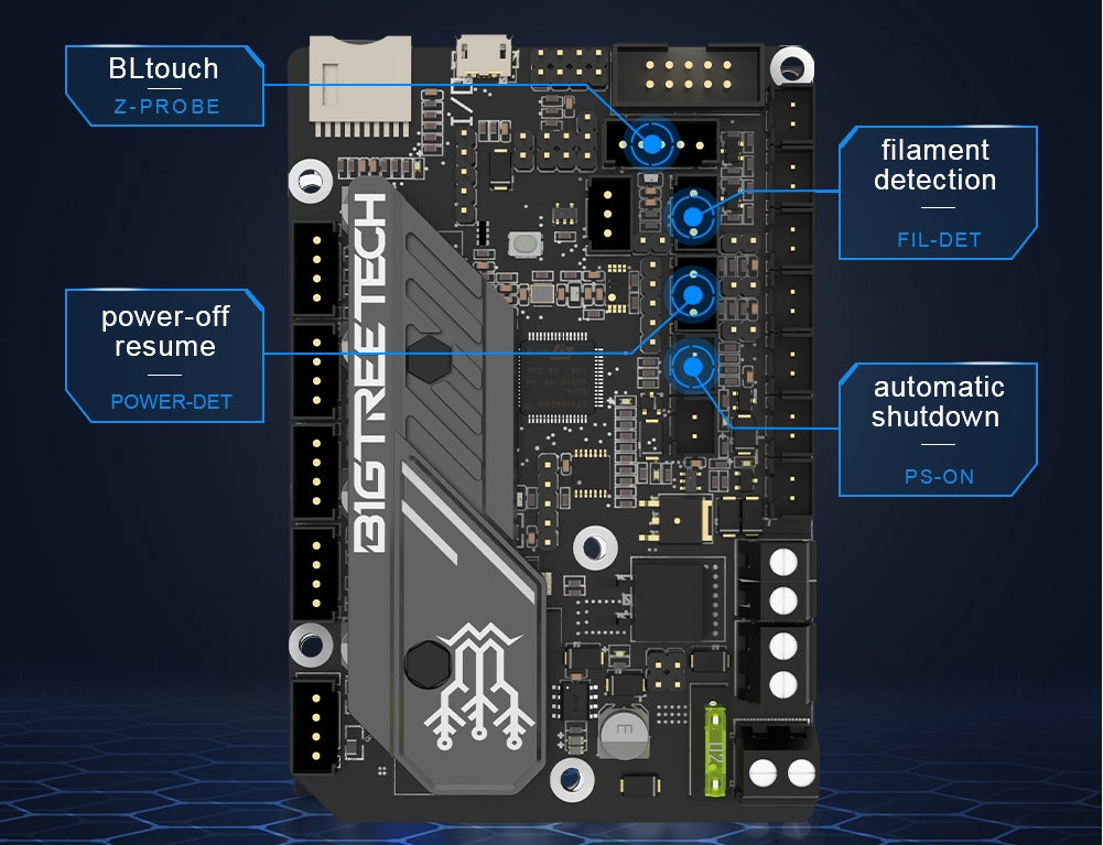

  7. Bonjours je suis actuellement en train de modifier une Ender pro 3, j'ai remplacer la carte mère 1.1.4 par une bigtreetech E3 V3 est je lui ais ajouter un bltouch est un capteur de filament. je suis entrain de modifier le firmware pour paramétrer les diffèrent élément ajouter est a chaque fois que je passe a la compilation j'obtiens l'erreur In file included from Marlin\src\HAL\STM32\MarlinSPI.cpp:27: Marlin\src\HAL\STM32\MarlinSPI.h:99:3: error: 'spi_mode_e' does not name a type 99 | spi_mode_e _dataMode; | ^~~~~~~~~~ Marlin\src\HAL\STM32\MarlinSPI.h: In constructor 'MarlinSPI::MarlinSPI(pin_t, pin_t, pin_t, pin_t)': Marlin\src\HAL\STM32\MarlinSPI.h:64:5: error: '_dataMode' was not declared in this scope; did you mean '_dataSize'? 64 | _dataMode = SPI_MODE_0; | ^~~~~~~~~ | _dataSize Marlin\src\HAL\STM32\MarlinSPI.h:64:17: error: 'SPI_MODE_0' was not declared in this scope; did you mean 'SPI_MODE0'? 64 | _dataMode = SPI_MODE_0; | ^~~~~~~~~~ | SPI_MODE0 Marlin\src\HAL\STM32\MarlinSPI.h: In member function 'void MarlinSPI::setDataMode(uint8_t)': Marlin\src\HAL\STM32\MarlinSPI.h:83:23: error: '_dataMode' was not declared in this scope; did you mean '_dataSize'? 83 | case SPI_MODE0: _dataMode = SPI_MODE_0; break; | ^~~~~~~~~ | _dataSize Marlin\src\HAL\STM32\MarlinSPI.h:83:35: error: 'SPI_MODE_0' was not declared in this scope; did you mean 'SPI_MODE0'? 83 | case SPI_MODE0: _dataMode = SPI_MODE_0; break; | ^~~~~~~~~~ | SPI_MODE0 compilation terminated due to -fmax-errors=5. *** [.pio\build\STM32G0B1RE_btt\src\src\HAL\STM32\MarlinSPI.cpp.o] Error 1 ================================================================== [FAILED] Took 20.16 seconds ================================================================== Environment Status Duration --------------- -------- ------------ STM32G0B1RE_btt FAILED 00:00:20.156 ============================================================= 1 failed, 0 succeeded in 00:00:20.156 ============================================================= * The terminal process "C:\Users\Barto\.platformio\penv\Scripts\platformio.exe 'run', '--environment', 'STM32G0B1RE_btt'" terminated with exit code: 1. * Terminal will be reused by tasks, press any key to close it. est du coup je ne sait plus quoi faire. j'ai changer d'ordinateur pour un ordinateur don je viens de finir de réinstaller le system d'exploitation, j'ai bien fait attention a mètre un nom d'utilisateur sans espace (ceux qui na surment pas d'influence mais c'est pas grave je lais lu dans un forum est dans le doute je lais fait) puit pour le répertoire de marlin2.1.2.1 je lais crée dans la racine du disk ceux qui donne C:\Marlin-2.1.2.1 est sa na pas fonctionner ceux qui est bizzard c'est que avent de changer le configuration.h est configuration_adv.h j'arrivais a buildé est obtenir le .bin est des que je mets les fichier du dossier BigTreeTech SKR Mini E3 3.0 sa ne fonctionne plus. je ne comprend plus rien car avec la creality 4.2.2 j'arrivais a crée le .bin "bon jai quand même changer 3 fois d0ordinateur" si je ne me trompe pas mon je suis sur un STM32G0B1RE ou un STM32G0B0RE mais d'appret ce que j'ai vu sur la cm la deux emme possibilité est la plus propable mon bltouch est mon capteur de filament son connecter comme sur la photo qui suit pouvais vous m'aider a trouver une solution a ce souci ou voir meme si il y a quel q'un qui a une version du firmward qui correspond a ma configuration je suis preneur je vous remerci pour votre aide Édit : j'ai supprimé la mauvaise photo

  9. j'ai enfin réussi a faire fonctionner mon capteur de fin de filament je vais enfin pouvoirs faire les réglages est bien sur suivre les conseille de pommeverte d'ailleurs merci a vous pour m'avoirs aider dans ce projet j'ai plus que a répliquer sa sur le deux emme impriment est pour la 3 emme si je me rappelle bien elle dois être sur une ancienne carte mère donc a voir si je change de cm ou je fait a l'ancienne pour écrire mon firmware il me reste plus que a faire les réglages est encore une fois merci a pommeverte pour les lien si vous avez des astuce ou des solution pour des amélioration je suis preneur merci

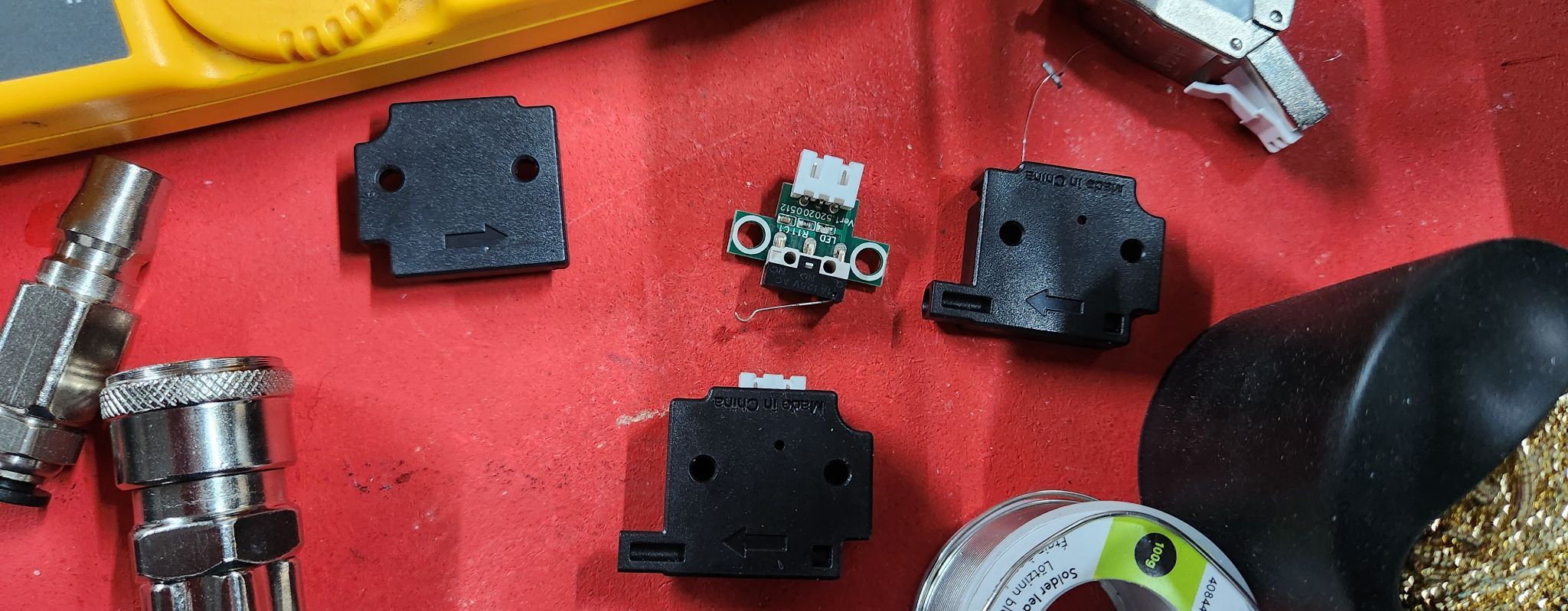

  10. j'ai réussi a faire fonctionner le capteur de filament en exécutant la commande m119 sur pronterface est je me suis dis cool je teste l'impression mais sa na pas fonctionner pour l'impression je refait la commande m119 est il ce passe plus rien j'ai plus de changement d'état pour le capteur de filament, j'ai essayer avec octoprint mais sa na pas fonctionner j'ai peur d'avoirs cramer le gpio de ma pi j'ai même essayer avec le capteur de fin de cours de l'axe z j'ai réussi a le faire fonctionner mais la plus rien bref je désespère J'ai enfin trouver le problème le file rouge de mon capteur de filament été pas bien mis dans la prise du coup quand j'ai brancher la prise a la carte mère il est sorti de la prise est sa fait que j'avais des connexion intermittent est a cause de sa j'avais le capteur qui fonctionnais est des fois pas, jai remarqué sa quand je tapotais l'impriment est que sa fonctionnais puit je bouger le file est sa ne fonctionnais plus com quoi que c'est de petit problème que naisse les plus gros problème maintenant il me reste plus que inverser la commande pour que le capteur fonctionne correctement est la je sait pas comment je dois faire
