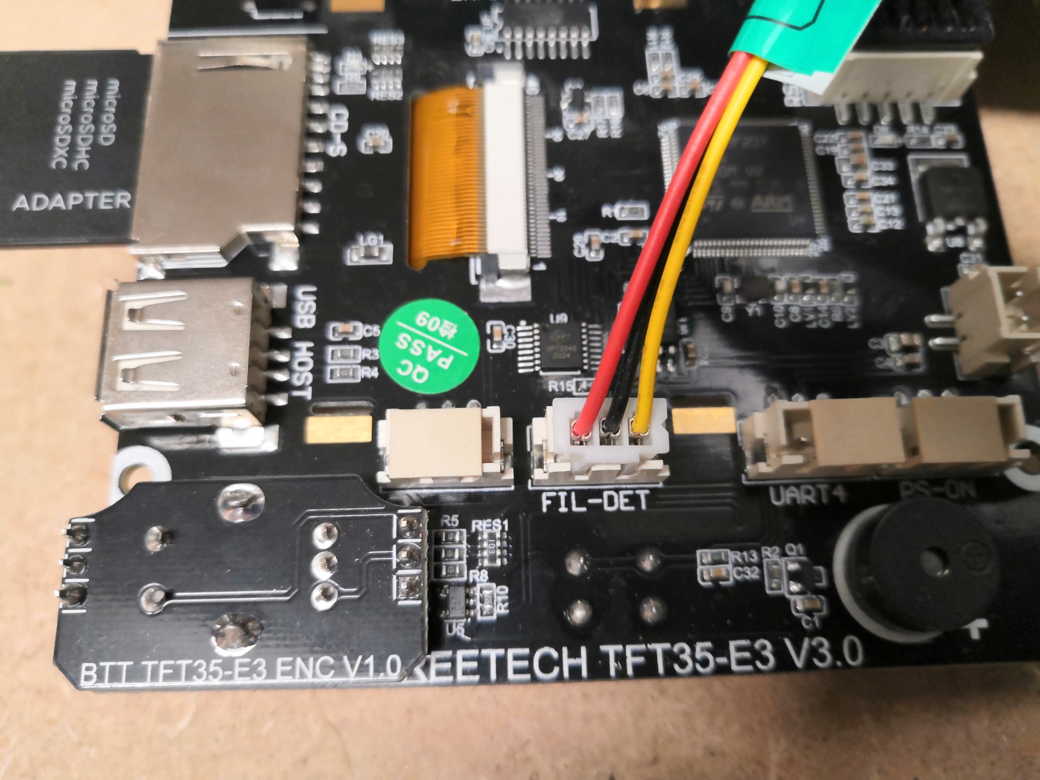

  2. J'ai un TFT35-E3 V.0 et j'ai raccordé le capteur sur la prise FIL-DET. Fais ensuite un essai de simulation en mettant un bout de fil dans le capteur puis le retirer pour contrôler si le capteur annonce une fin de filament.
  3. J'ai résolu le problème en raccordant le détecteur sur mon écran TFT et non sur ma carte. Voici également ma config Marlin #define FILAMENT_RUNOUT_SENSOR #if ENABLED(FILAMENT_RUNOUT_SENSOR) #define FIL_RUNOUT_ENABLED_DEFAULT false // Enable the sensor on startup. Override with M412 followed by M500. #define NUM_RUNOUT_SENSORS 1 // Number of sensors, up to one per extruder. Define a FIL_RUNOUT#_PIN for each. #define FIL_RUNOUT_STATE LOW // Pin state indicating that filament is NOT present. #define FIL_RUNOUT_PULLUP // Use internal pullup for filament runout pins. //#define FIL_RUNOUT_PULLDOWN // Use internal pulldown for filament runout pins. // Override individually if the runout sensors vary //#define FIL_RUNOUT1_STATE LOW //#define FIL_RUNOUT1_PULLUP //#define FIL_RUNOUT1_PULLDOWN //#define FIL_RUNOUT2_STATE LOW //#define FIL_RUNOUT2_PULLUP //#define FIL_RUNOUT2_PULLDOWN //#define FIL_RUNOUT3_STATE LOW //#define FIL_RUNOUT3_PULLUP //#define FIL_RUNOUT3_PULLDOWN //#define FIL_RUNOUT4_STATE LOW //#define FIL_RUNOUT4_PULLUP //#define FIL_RUNOUT4_PULLDOWN //#define FIL_RUNOUT5_STATE LOW //#define FIL_RUNOUT5_PULLUP //#define FIL_RUNOUT5_PULLDOWN //#define FIL_RUNOUT6_STATE LOW //#define FIL_RUNOUT6_PULLUP //#define FIL_RUNOUT6_PULLDOWN //#define FIL_RUNOUT7_STATE LOW //#define FIL_RUNOUT7_PULLUP //#define FIL_RUNOUT7_PULLDOWN //#define FIL_RUNOUT8_STATE LOW //#define FIL_RUNOUT8_PULLUP //#define FIL_RUNOUT8_PULLDOWN // Set one or more commands to execute on filament runout. // (After 'M412 H' Marlin will ask the host to handle the process.) #define FILAMENT_RUNOUT_SCRIPT "M600" // After a runout is detected, continue printing this length of filament // before executing the runout script. Useful for a sensor at the end of // a feed tube. Requires 4 bytes SRAM per sensor, plus 4 bytes overhead. #define FILAMENT_RUNOUT_DISTANCE_MM 5 #ifdef FILAMENT_RUNOUT_DISTANCE_MM // Enable this option to use an encoder disc that toggles the runout pin // as the filament moves. (Be sure to set FILAMENT_RUNOUT_DISTANCE_MM // large enough to avoid false positives.) //#define FILAMENT_MOTION_SENSOR #endif #endif

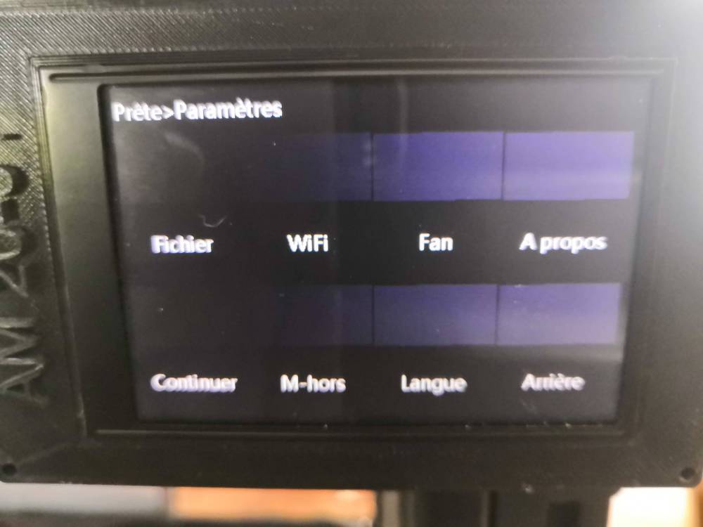

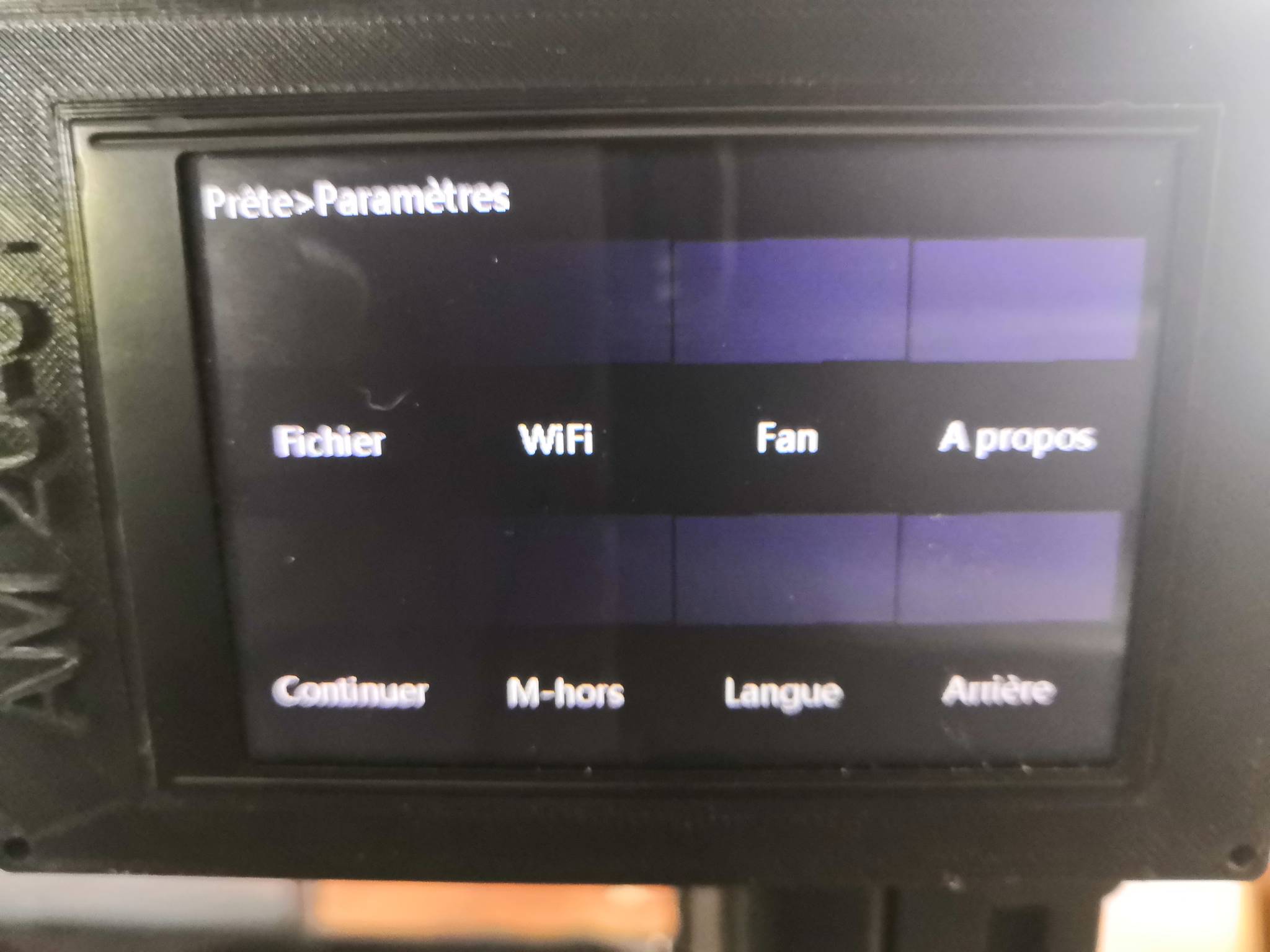

  5. Après de nombreuses recherches, j'ai trouvé une bonne explication de configuration par KAMINO et cela fonctionne correctement maintenant.

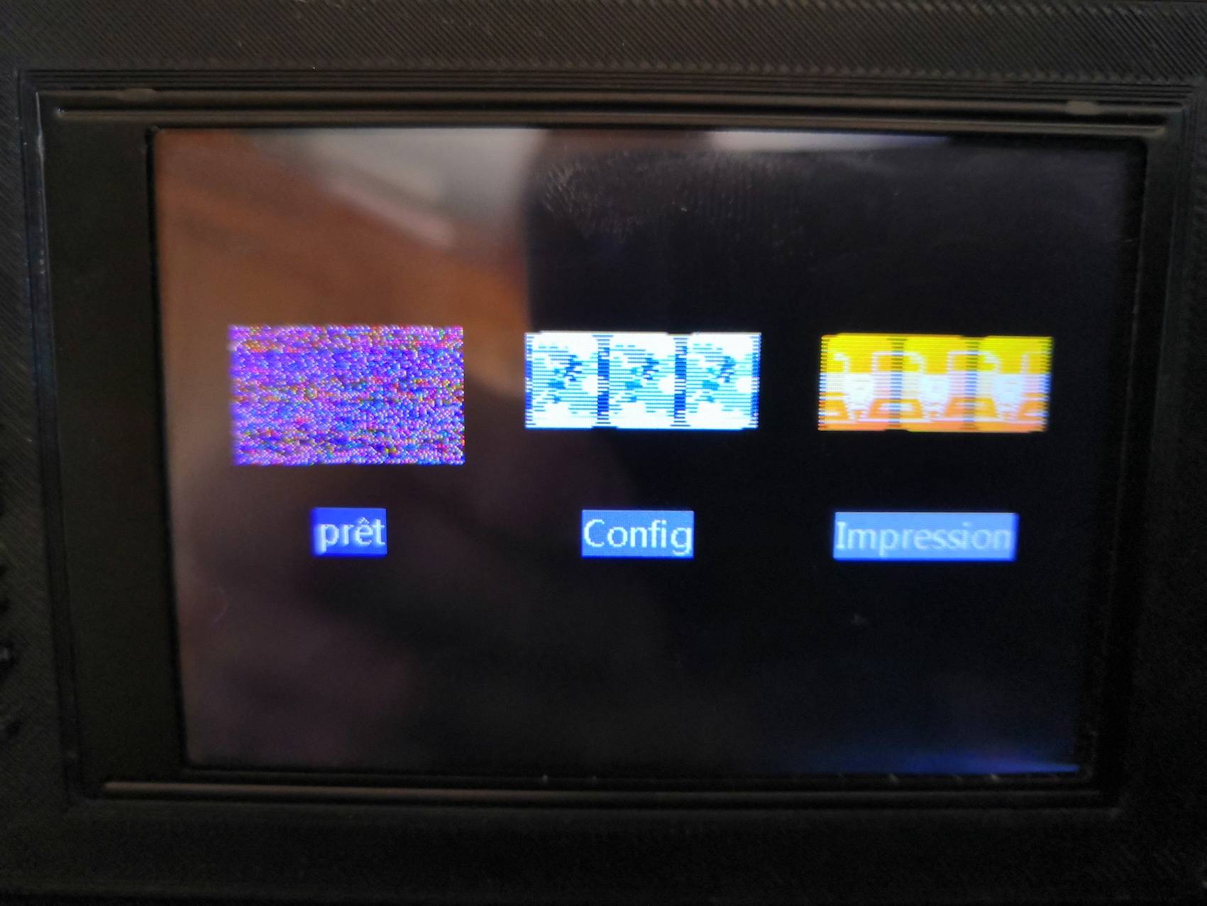

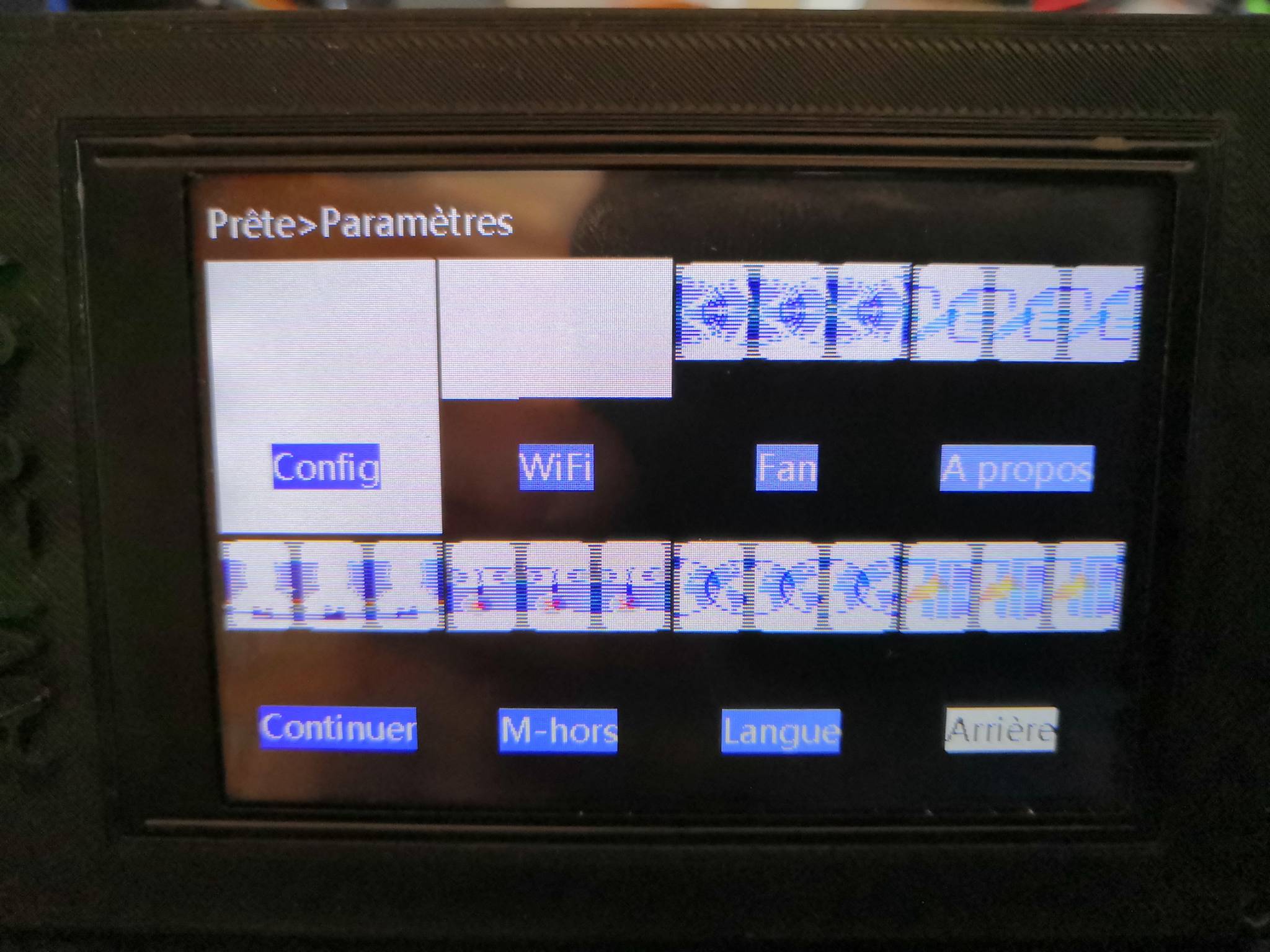

  11. Pas de réponse, donc je me suis résigné à chercher la cause et cela m'a pris quelques soirées à comprendre. Je suis passé du mac à windows et changé ma carte SD, j'ai pris une carte de 8 GB. J'ai vu sur un forum que la carte doit être formatée en FAT 32 et avoir une capacité de 8 GB maxi. Et miracle, j'ai réussi à configurer mon écran TFT
  12. Bonjour à tous, Je suis un nouvel utilisateur d'imprimante 3D depuis peu de temps. J'ai une ender 3 pro et j'ai décidé de construire une core XY plus grande. Concernant les pièces mécaniques, aucun problème , mais j'ai des problèmes de configuration avec mon écran TFT. J'ai une carte SKR V1.3 et un écran TFT35 V1.0. Après montage suite à l'achat de ces pièces, cela fonctionnait bien mais après avoir l bidouillé dans mes fichiers de config, cela me donne des écrans avec des icônes en triple ou sans icône. J'ai parcouru le forum et je n'ai pas trouvé la solution. Qui peu m'aider à solutionner mon problème ?
