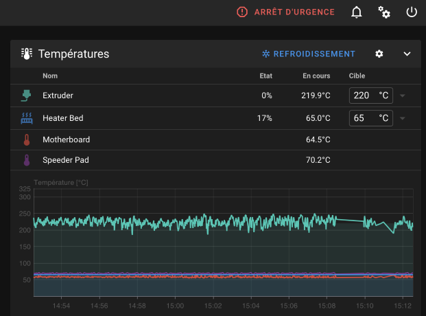

Je persiste, je le rebranche pour test... le pid se fait et a la sauvegarde ca plante .. Voilà le log de klippy :.... on bascule de 143deg à -93deg en 1 ligne de stats.... et encore juste avant on a une chute de température 149,1 148,7 146,4 143,3 et -93 Heater extruder within range of 160.000 Stats 2772.6: gcodein=0 mcu: mcu_awake=0.000 mcu_task_avg=0.000001 mcu_task_stddev=0.000001 bytes_write=3275 bytes_read=15828 bytes_retransmit=9 bytes_invalid=0 send_seq=289 receive_seq=289 retransmit_seq=2 srtt=0.000 rttvar=0.000 rto=0.025 ready_bytes=0 upcoming_bytes=0 freq=400005942 heater_bed: target=30 temp=24.8 pwm=0.927 Speeder_Pad: temp=43.9 Motherboard: temp=31.9 sysload=1.35 cputime=75.838 memavail=808144 print_time=54.524 buffer_time=0.000 print_stall=0 extruder: target=160 temp=147.2 pwm=0.000 Stats 2773.6: gcodein=0 mcu: mcu_awake=0.000 mcu_task_avg=0.000001 mcu_task_stddev=0.000001 bytes_write=3342 bytes_read=16007 bytes_retransmit=9 bytes_invalid=0 send_seq=294 receive_seq=294 retransmit_seq=2 srtt=0.000 rttvar=0.000 rto=0.025 ready_bytes=0 upcoming_bytes=0 freq=400005924 heater_bed: target=30 temp=25.1 pwm=1.000 Speeder_Pad: temp=44.1 Motherboard: temp=31.8 sysload=1.35 cputime=75.870 memavail=808056 print_time=54.524 buffer_time=0.000 print_stall=0 extruder: target=160 temp=150.6 pwm=0.000 Stats 2774.6: gcodein=0 mcu: mcu_awake=0.000 mcu_task_avg=0.000001 mcu_task_stddev=0.000001 bytes_write=3364 bytes_read=16171 bytes_retransmit=9 bytes_invalid=0 send_seq=296 receive_seq=296 retransmit_seq=2 srtt=0.000 rttvar=0.000 rto=0.025 ready_bytes=0 upcoming_bytes=0 freq=400006008 heater_bed: target=30 temp=25.6 pwm=0.840 Speeder_Pad: temp=43.6 Motherboard: temp=31.8 sysload=1.35 cputime=75.904 memavail=808132 print_time=54.524 buffer_time=0.000 print_stall=0 extruder: target=160 temp=151.7 pwm=0.000 Heater heater_bed within range of 30.000 Stats 2775.6: gcodein=0 mcu: mcu_awake=0.000 mcu_task_avg=0.000001 mcu_task_stddev=0.000001 bytes_write=3434 bytes_read=16365 bytes_retransmit=9 bytes_invalid=0 send_seq=301 receive_seq=301 retransmit_seq=2 srtt=0.000 rttvar=0.000 rto=0.025 ready_bytes=0 upcoming_bytes=0 freq=400006009 heater_bed: target=30 temp=26.0 pwm=0.952 Speeder_Pad: temp=43.1 Motherboard: temp=31.8 sysload=1.35 cputime=75.931 memavail=808108 print_time=54.524 buffer_time=0.000 print_stall=0 extruder: target=160 temp=150.5 pwm=1.000 Stats 2776.6: gcodein=0 mcu: mcu_awake=0.000 mcu_task_avg=0.000001 mcu_task_stddev=0.000001 bytes_write=3440 bytes_read=16524 bytes_retransmit=9 bytes_invalid=0 send_seq=302 receive_seq=302 retransmit_seq=2 srtt=0.000 rttvar=0.000 rto=0.025 ready_bytes=0 upcoming_bytes=0 freq=400006020 heater_bed: target=30 temp=26.2 pwm=0.952 Speeder_Pad: temp=43.8 Motherboard: temp=31.5 sysload=1.35 cputime=75.967 memavail=808136 print_time=54.524 buffer_time=0.000 print_stall=0 extruder: target=160 temp=147.3 pwm=1.000 Stats 2777.6: gcodein=0 mcu: mcu_awake=0.000 mcu_task_avg=0.000001 mcu_task_stddev=0.000001 bytes_write=3462 bytes_read=16674 bytes_retransmit=9 bytes_invalid=0 send_seq=304 receive_seq=304 retransmit_seq=2 srtt=0.000 rttvar=0.000 rto=0.025 ready_bytes=0 upcoming_bytes=0 freq=400006000 heater_bed: target=30 temp=26.6 pwm=0.898 Speeder_Pad: temp=43.3 Motherboard: temp=31.7 sysload=1.32 cputime=75.998 memavail=808240 print_time=54.524 buffer_time=0.000 print_stall=0 extruder: target=160 temp=148.0 pwm=1.000 Stats 2778.6: gcodein=0 mcu: mcu_awake=0.000 mcu_task_avg=0.000001 mcu_task_stddev=0.000001 bytes_write=3484 bytes_read=16853 bytes_retransmit=9 bytes_invalid=0 send_seq=306 receive_seq=306 retransmit_seq=2 srtt=0.000 rttvar=0.000 rto=0.025 ready_bytes=0 upcoming_bytes=0 freq=400005978 heater_bed: target=30 temp=26.9 pwm=0.898 Speeder_Pad: temp=43.6 Motherboard: temp=31.6 sysload=1.32 cputime=76.032 memavail=808248 print_time=54.524 buffer_time=0.000 print_stall=0 extruder: target=160 temp=149.1 pwm=0.740 Stats 2779.6: gcodein=0 mcu: mcu_awake=0.000 mcu_task_avg=0.000001 mcu_task_stddev=0.000001 bytes_write=3519 bytes_read=17029 bytes_retransmit=9 bytes_invalid=0 send_seq=309 receive_seq=309 retransmit_seq=2 srtt=0.000 rttvar=0.000 rto=0.025 ready_bytes=0 upcoming_bytes=0 freq=400005986 heater_bed: target=30 temp=27.1 pwm=0.898 Speeder_Pad: temp=43.0 Motherboard: temp=31.7 sysload=1.32 cputime=76.068 memavail=808232 print_time=54.524 buffer_time=0.000 print_stall=0 extruder: target=160 temp=148.7 pwm=1.000 Stats 2780.6: gcodein=0 mcu: mcu_awake=0.000 mcu_task_avg=0.000001 mcu_task_stddev=0.000001 bytes_write=3570 bytes_read=17189 bytes_retransmit=9 bytes_invalid=0 send_seq=313 receive_seq=313 retransmit_seq=2 srtt=0.000 rttvar=0.000 rto=0.025 ready_bytes=0 upcoming_bytes=0 freq=400005981 heater_bed: target=30 temp=27.4 pwm=0.898 Speeder_Pad: temp=43.9 Motherboard: temp=32.0 sysload=1.32 cputime=76.105 memavail=808240 print_time=54.524 buffer_time=0.000 print_stall=0 extruder: target=160 temp=146.4 pwm=1.000 Stats 2781.6: gcodein=0 mcu: mcu_awake=0.000 mcu_task_avg=0.000001 mcu_task_stddev=0.000001 bytes_write=3651 bytes_read=17383 bytes_retransmit=9 bytes_invalid=0 send_seq=318 receive_seq=318 retransmit_seq=2 srtt=0.000 rttvar=0.000 rto=0.025 ready_bytes=0 upcoming_bytes=0 freq=400005973 heater_bed: target=30 temp=27.8 pwm=0.799 Speeder_Pad: temp=43.8 Motherboard: temp=31.7 sysload=1.32 cputime=76.142 memavail=808064 print_time=54.524 buffer_time=0.000 print_stall=0 extruder: target=160 temp=143.3 pwm=1.000 Stats 2782.6: gcodein=0 mcu: mcu_awake=0.000 mcu_task_avg=0.000001 mcu_task_stddev=0.000001 bytes_write=3718 bytes_read=17564 bytes_retransmit=9 bytes_invalid=0 send_seq=323 receive_seq=323 retransmit_seq=2 srtt=0.000 rttvar=0.000 rto=0.025 ready_bytes=0 upcoming_bytes=0 freq=400005961 heater_bed: target=30 temp=28.0 pwm=0.836 Speeder_Pad: temp=43.7 Motherboard: temp=31.1 sysload=1.29 cputime=76.175 memavail=808212 print_time=54.524 buffer_time=0.000 print_stall=0 extruder: target=160 temp=-93.9 pwm=1.000 MCU 'mcu' shutdown: ADC out of range Je refais la connection et je vous tiens au courant , si jamais voici la pince que j'utilise
@Motard Geek En réutilisant le bloc de chauffe d’origine et en changeant les sondes (celles fournies en +) ça refonctionne mais ça frotte … mais c’est vraiment une tannasse cette imprimante…. Plus aucun plaisir à imprimer

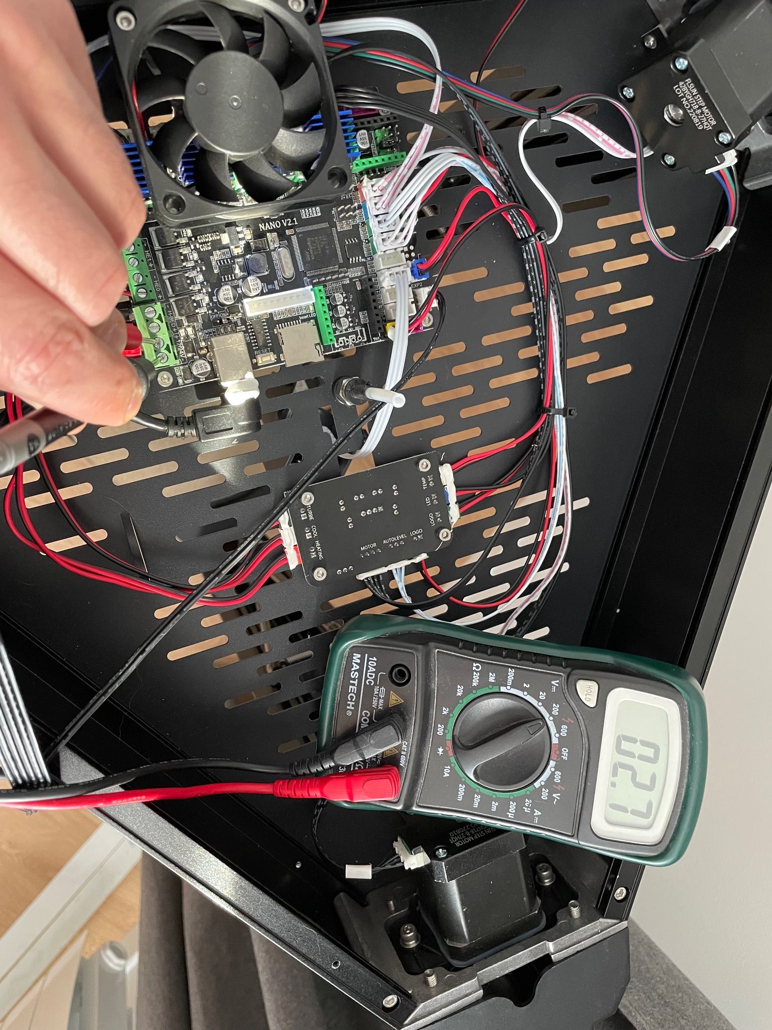

Bonjour, Je poste la demande car j suis à bout avec ma flsun V400. J'ai le fameux message MCU 'mcu' shutdown: ADC out of range This generally occurs when a heater temperature exceeds its configured min_temp or max_temp. Je relance l'imprimante et là le speederpad ne s'allume pas, carte mère non alimentée en 3,5V au lieu de 24V ….. donc je cherche d'où vient le problème. Je met en doute le bed (court-circuit éventuel)... je le débranche ainsi que la sonde du bed... Après une attente de 5min et un rallumage, j'allume l'imprimante, le speederpad s'allume et au bout de quelques secondes le MOSFET fait une belle étincelle et plus rien ne va… Je décide d'un upgrade : - changement du heater/sonde par un trianglelab - changement de la carte mère pour une BTT SKR3 et j'achète également: - un nouveau MOSFET - une protection thermique à remettre sous le bed (et oui je passe le passage de l'arrachage de la protection et du contrôle de la sonde, des fils etc et le nettoyage de la colle) - achat d'une pince à connectique JST XH pour éviter les problèmes de connexion Je réinstalle tout et tout se lance .... lors des calibrations je m'aperçois que j'ai mal vissé le heater .. fuite de PLA... Flemme de nettoyer, je change le heater/thermistance car j'en avait pris 2. Je calibre, je réinstalle selon le modop de @Guilouz (d'ailleurs il semble que beaucoup de monde subi ce problème , c'est pas lié au soft ?) Je lance une impression de 2 jours.... elle se termine bien sauf qu'au bout de quelques heures j'ai la thermistance du hotend qui danse (voir image jointe). Dans le log j'ai : heater_bed: target=0 temp=18.2 pwm=0.000 extruder: target=220 temp=-93.9 pwm=1.000 Mes questions: 1- Pourquoi le pwm est à 0 et la target à 0 pour le bed et la température 18.2 au lieu de 65 ? 2- Pourquoi l'extrudeur est à -93 alors que c'est une thermistance neuve 3- Qui a une Bambu à vendre car j'ne peux plus ça me dégoute @Motard Geek peut-être ? please help !!!!!!!!!!
Hello , Après l’installation d’une nouvelle carte mère BTT … même problème. L’écran ne s’allume pas et même le ventilateur des drivers ne démarre pas…. Même si je débranche tout… drivers compris Entre la carte mère et l’alimentation il y a un MOSFET pour alimenter le plateau chauffant et la sonde du plateau … je débranche ces 2 éléments pour uniquement dédier l’alimentation à ma nouvelle carte mère et même problème . pourtant j’ai bien 24V qui arrivent à la carte mère …. @Guilouz. @Motard Geek Vous pouvez m’aider ? Il est cher le cale porte flsun
Salut tout le monde. Suite à la dernière mise à jour klipper je lance un print et en plein milieu l’imprimante s’arrête…. Je reallume l’imprimante et là le speederpad n’est plus alimenté ni la carte mère (pas de logo allumé, pas de ventilateur ni de led) A l’ouverture du capot, tout semble ok. Je mesure 24V en sortie de l’alimentation, en sortie du MOSFET et 24V en bout de nappe … tant que je ne branche pas la carte mère … si je la branche je tombe à 3V … si je débranche tout les cosses ça change rien, si je retire les 4 drivers la tension monte à 7V et le ventillo tourne faiblement … Je suppose que la Carte mère est foutue…. @Guilouz et @Motard Geek pensez vous que le diagnostic est bon ? Si je change de carte mère je vois que @Guilouz à mis des fichiers pour la configuration d’une bigtreetech Et j’ai quelques questions : @Guilouz précise qu’elle est plus robuste etc dans « Tout sur la FLSUn et poste le schéma « Merci à toi mais je me demande: Faut t’il changer aussi les drivers et pour lesquels ? (Je m’y connais spas là dessus) c’était une Robin Nano 2.1 , je suppose qu’une 3.0 est trop différente ou c’est compatible ? Je ne trouve que des 2 avec un gros délai ou des 3 disponibles de suite Merci pour vos réponses ne pas répondre il y a toutes les réponses et les liens entre le forum et Guithub merci

Salut à tous Je suis aussi passé à ce heater et donc j'ai passé le câble entre les bras du support du sensor. J'ai la buse CHT de côté, pour l'instant je suis encore avec une Zodiac https://www.3dmensionals.de/zodiac-nozzle-crb?number=PACZD0005V.1 celle qui n'est plus dispo sur 3djake. Par contre je trouve que le refroidissement est moins bon... et oui ça tombe plus au même endroit. @Guilouz à créé un https://www.printables.com/fr/model/291550-flsun-v400-improved-fanduct @Motard Geek tu avais gardé les fanduct d'origine ? Suite au montage de cette buse.... je l'ai pas assez vissée sur le heatbreak du coup fuite par le dessus... bravo moi MAIS le cube de Calibration atteignait la perfection. Depuis le remontage c'est pire.... Et tout est réglé, je fais la liste , si vous voyez des ratés dites moi: - PID BED et HEATER c'est fait - END STOP / DELTA CALIBRATION c'est fait - Z-offset / suivi du bed-levelling et security offset c'est ok - extrudeur sort bien 100mm - paroi: débit réglé à 98% c'est mesuré au dixième prêt - input shaper (Fysetc) utilisé pour régler la résonance - pressure advance à 0,035 c'est le plus propre Quelqu'un peu me passer un profil CURA 5.3 ou prusa (ceux du Facebook Amazing speed ne vont pas ) ? histoire de tester car je fatigue, je crois que je vais réunir mes dernières forces pour mettre l'imprimante sur orbite... Je suis fatigué de la V400 je commence à regretter mes précédentes imprimantes -
Tu peux même enlever le point 1 parce que ça n’était pas là source du problème. En démontant toute la tête je me suis aperçu de 2 choses : -le hotend était dévissé d’un côté (merci au mec qui l’a monté) et que j’avais une petite fuite qui a bien encrassé le tout - le bloc noir avec l’extrudeur tient par 3 vis au support métallique en triangle: pour 2 d’entre elles , il y a un « chanfrein » pour que la tête de vis vienne s’y loger et pour la 3em vis ba queudal… du coup la vis est pas assez longue pour aller chercher le pas de vis et elle sert à rien, j’ai du la changer. 4. J’ai imprimé le fameux outils de la vidéo (1 par courroie car c’est pas du solide non plus) mais en mettant la même tension et en vérifiant avec le bedmesh on arrive à un truc bien
J'ai refait une installation complète et dans la procédure de Guillouz il y a les fichiers de configurations pour cette hotend. Du coup recalibration etc mais tout se passe au mieux depuis... je commence l'armure Mandalorian Quelles machines ????
FInalement après avoir changé le hotend et la buse par ceux indiqués par @Motard Geek ben j'ai plus ce frottement. AU fait t'as plus la V400 ? t'es passé à la Bambu ???
