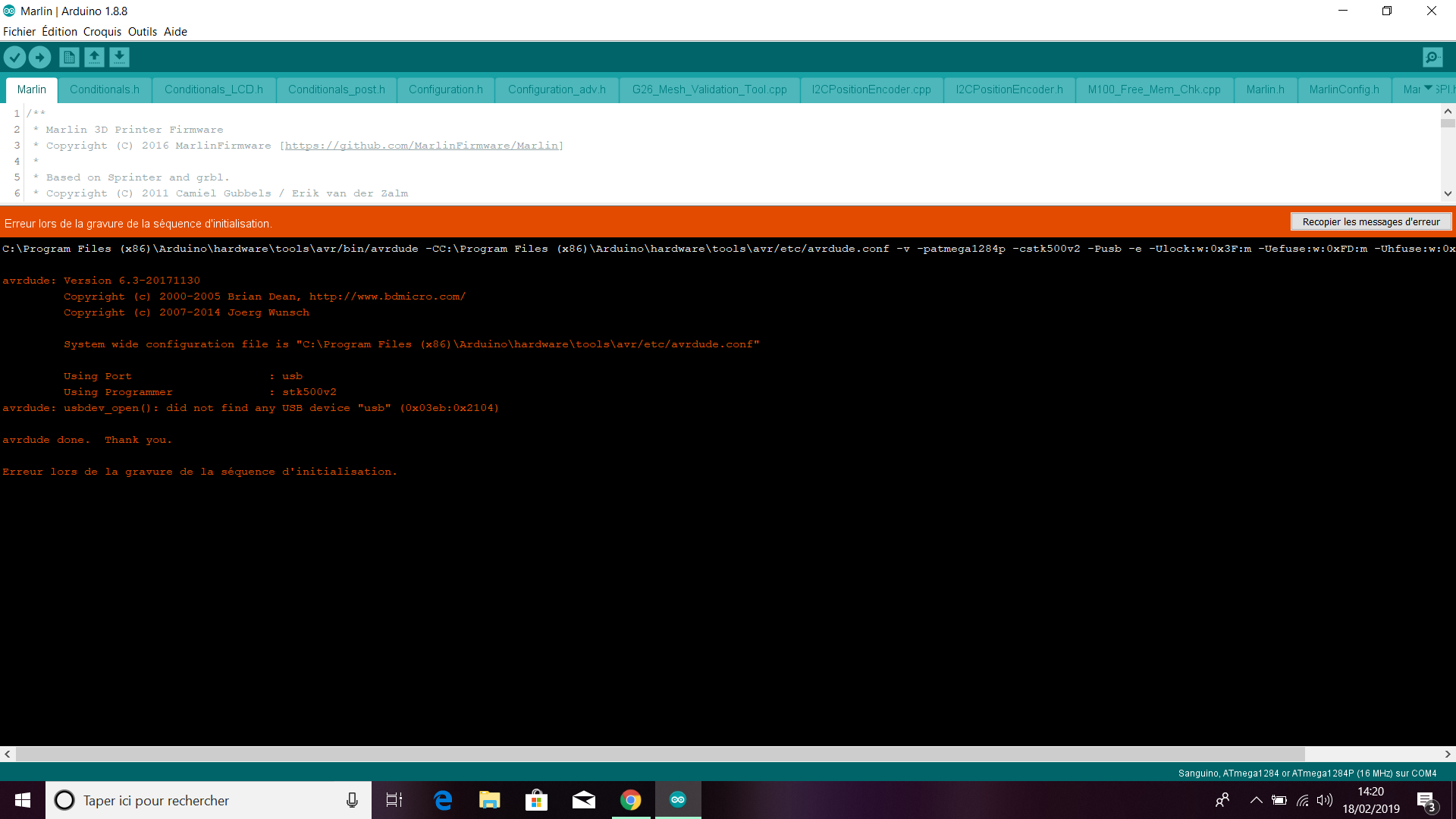

ethan70 Posté(e) Février 13, 2019 Auteur Partager Posté(e) Février 13, 2019 Bonjour jai acheter une carte arduino toujours le mm problème pour téléverser sur la carte mere de la cr10 cordialement J ai essayer plusieurs cable usb different ordi donc voila je vais acheter une nouvelle carte mere je pense merci Lien vers le commentaire Partager sur d’autres sites More sharing options...

thunderace94 Posté(e) Février 13, 2019 Partager Posté(e) Février 13, 2019 J'ai eu le même problème quand j'ai voulu flasher le bootloader sur ma CR10. J'ai utilisé la méthode alternative décrite là : https://www.instructables.com/id/Flashing-a-Bootloader-to-the-CR-10/ et tout est rentré dans l'ordre. Je cite : " IF EVERYTHING DID NOT WORK CORRECTLY, THERE IS AN ALTERNATIVE METHOD THAT YOU CAN USE! So you're sure you did everything right and you tried to burn bootloader yet it didn't work? Here is an Alternative Method using a sketch made by a brilliant man named Nick Gammon. Download Nick Gammon's sketches from here. (Nick Gammon's web page can be found here) Extract the zip somewhere. Documents\Arduino is a good place. Back in the Arduino IDE, click File > Open Find the folder you extracted Gammon's sketches to. Inside that folder, there will be a folder named Atmega_Board_Programmer and inside that folder, a file named Atmega_Board_Programmer.ino. Select that file and open it. Now set your board (Tools > Board) to the Arduino UNO and your port (Tools > Port) to the com port of the Arduino UNO, and your programmer (Tools > Programmer) to the AVRISP mkII Upload the sketch. Wire everything up as previously stated in this guide and connect both boards via USB to your PC. With everything still set up for your Arduino (Board, Port and Programmer), in the Arduino IDE, select Tools > Serial Monitor. Inside the Serial Monitor window, there are two drop down boxes at the bottom right, set the first to "Both NL & CR" and the second to "1152000 baud". Some text should scroll by. If you get a message saying "Failed to enter ICSP programming mode" something is wired incorrectly. If you get the message "Type 'Q' to quit, 'V' to verify, or 'G' to program the chip with the bootloader ...", type G in the text box at the top of the window and click the send button. If preformed correctly, it will flash the bootloader." Lien vers le commentaire Partager sur d’autres sites More sharing options...

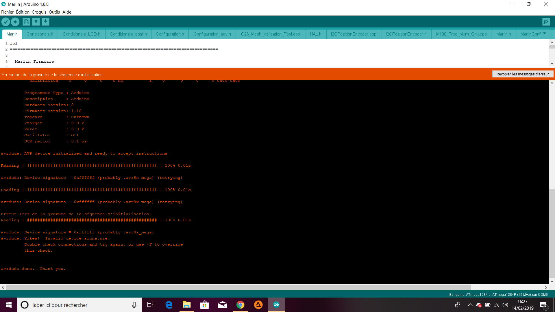

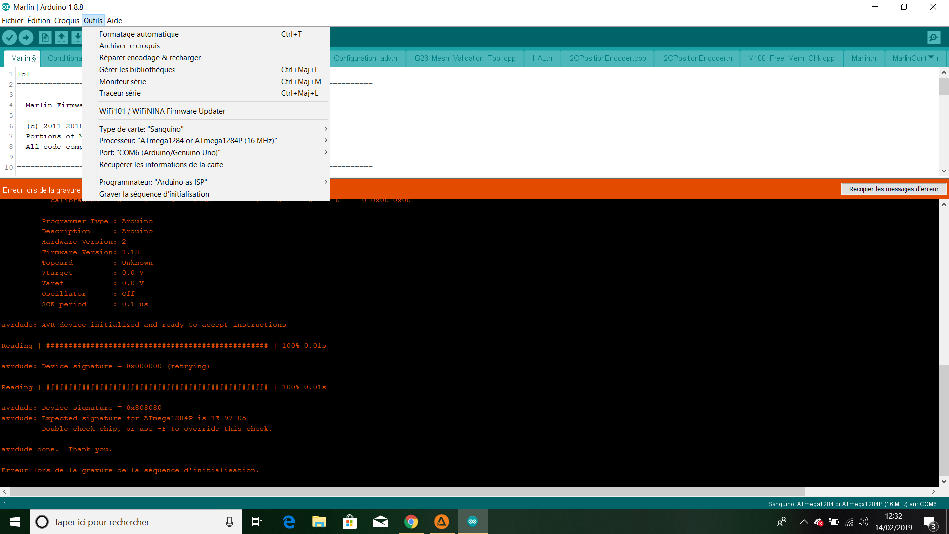

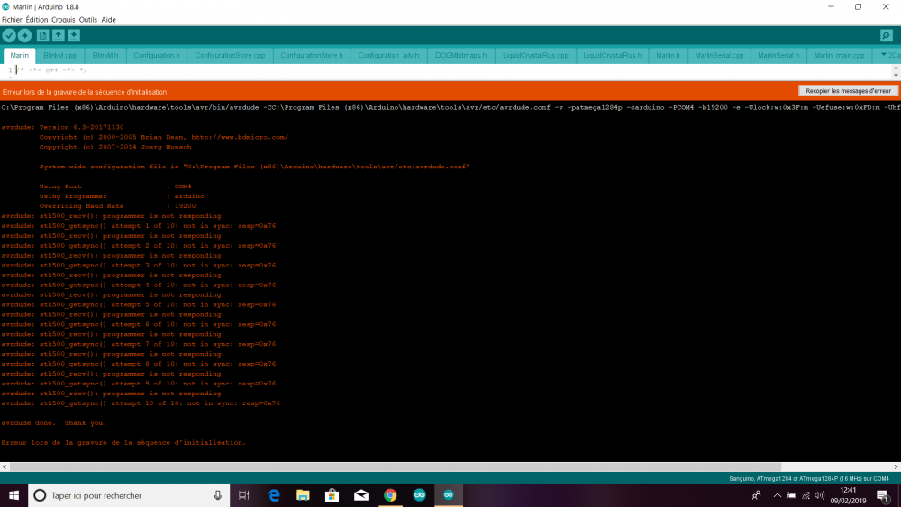

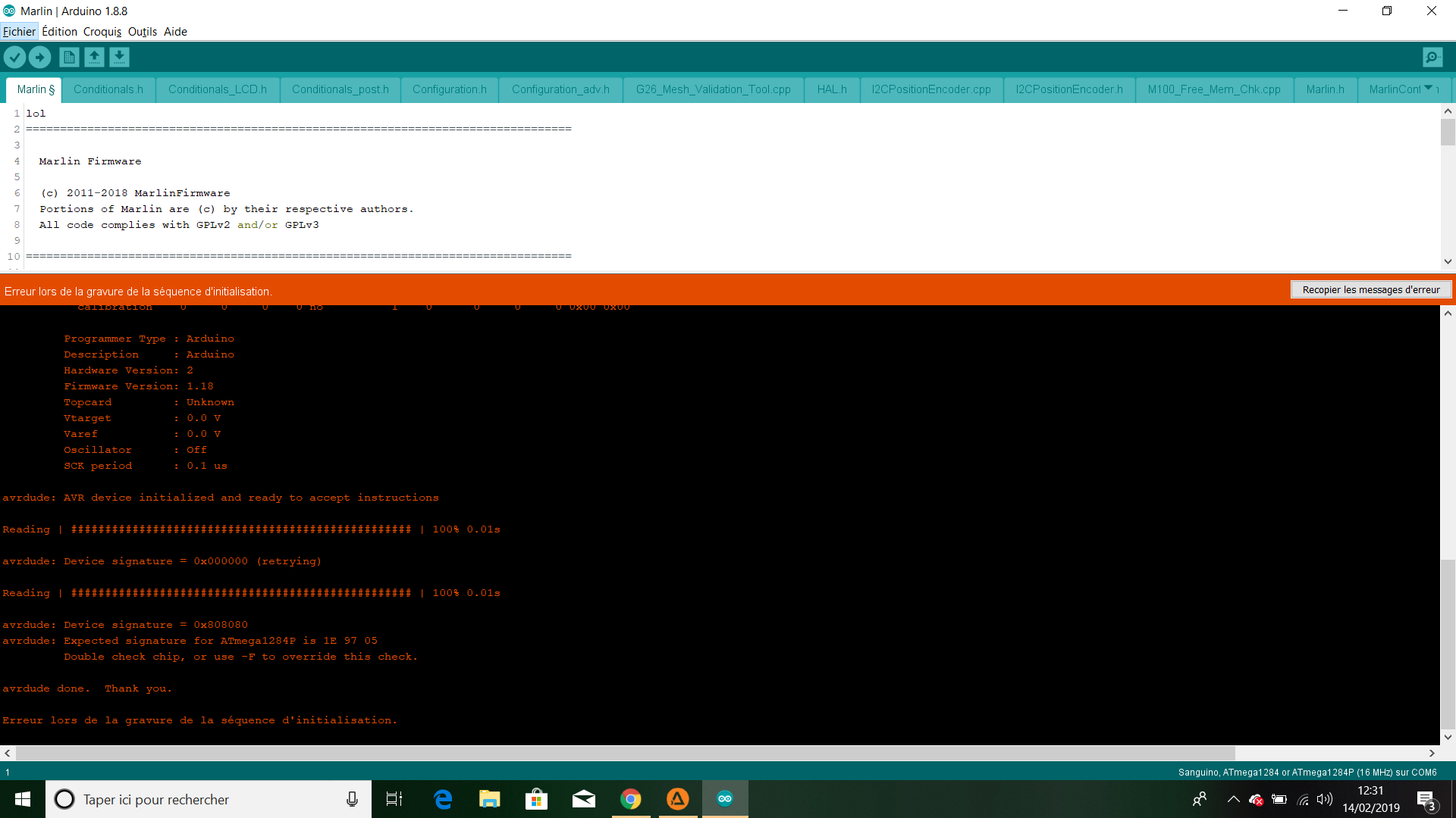

ethan70 Posté(e) Février 14, 2019 Auteur Partager Posté(e) Février 14, 2019 bonjoir voila ce que j'obtiens Lien vers le commentaire Partager sur d’autres sites More sharing options...
ethan70 Posté(e) Février 14, 2019 Auteur Partager Posté(e) Février 14, 2019 voila la config Lien vers le commentaire Partager sur d’autres sites More sharing options...

thunderace94 Posté(e) Février 14, 2019 Partager Posté(e) Février 14, 2019 Les captures d'écran que tu présente il y a 3 heures ne correspondent pas au flashage du bootloader. Tu essaies directement de flasher (téléverser) le Marlin. Reprends depuis le début. Le bootloader d'abord, ensuite le marlin. Lien vers le commentaire Partager sur d’autres sites More sharing options...

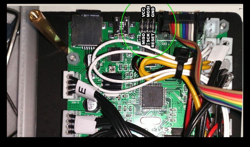

ethan70 Posté(e) Février 14, 2019 Auteur Partager Posté(e) Février 14, 2019 (modifié) je suis a letape ou je verse le bootloader comme derbo le fais vois la derniere capture il me demande cheker les cables je les ai tourner dans tous les sens rien y fais Modifié (le) Février 14, 2019 par ethan70 Lien vers le commentaire Partager sur d’autres sites More sharing options...

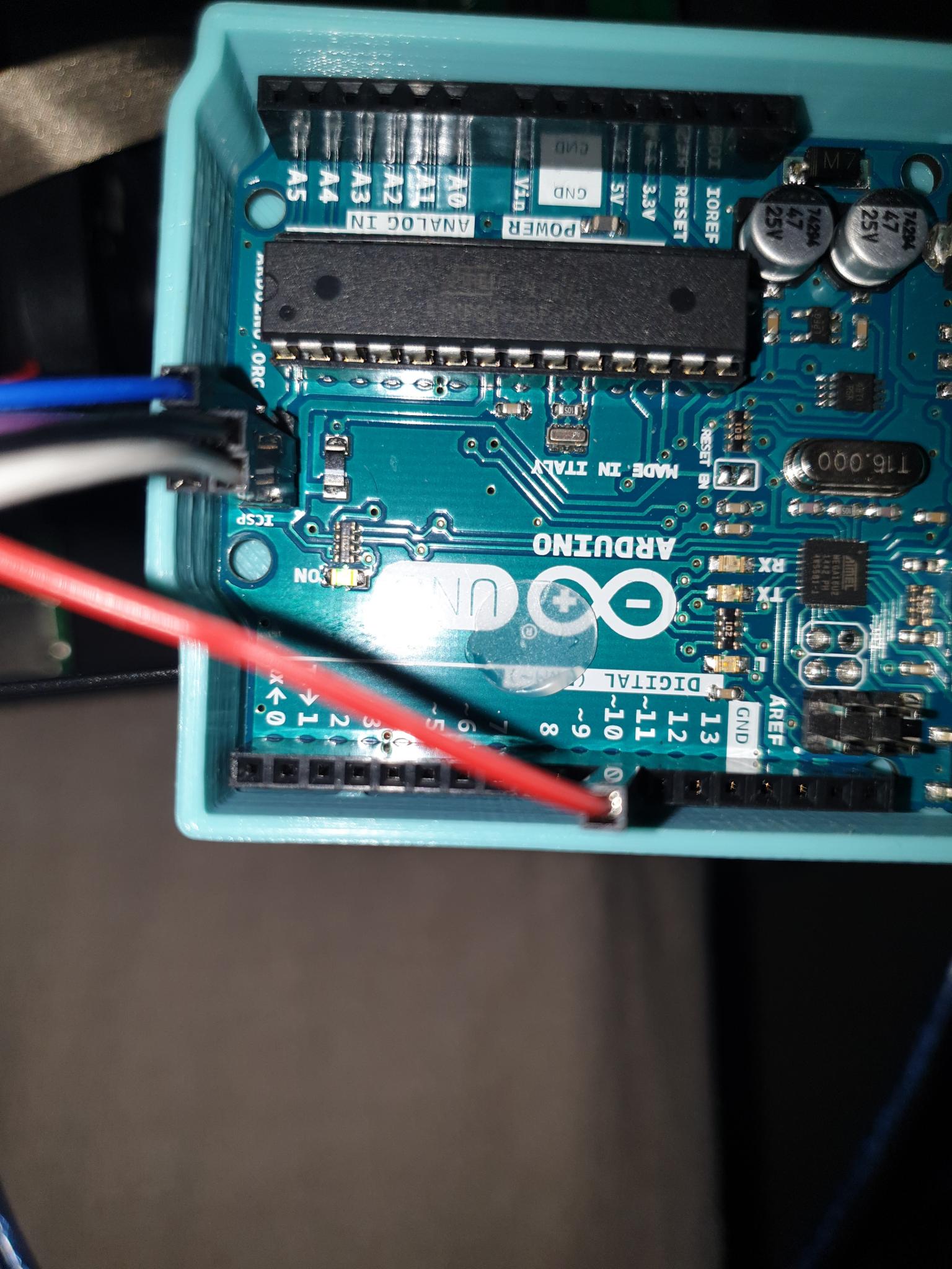

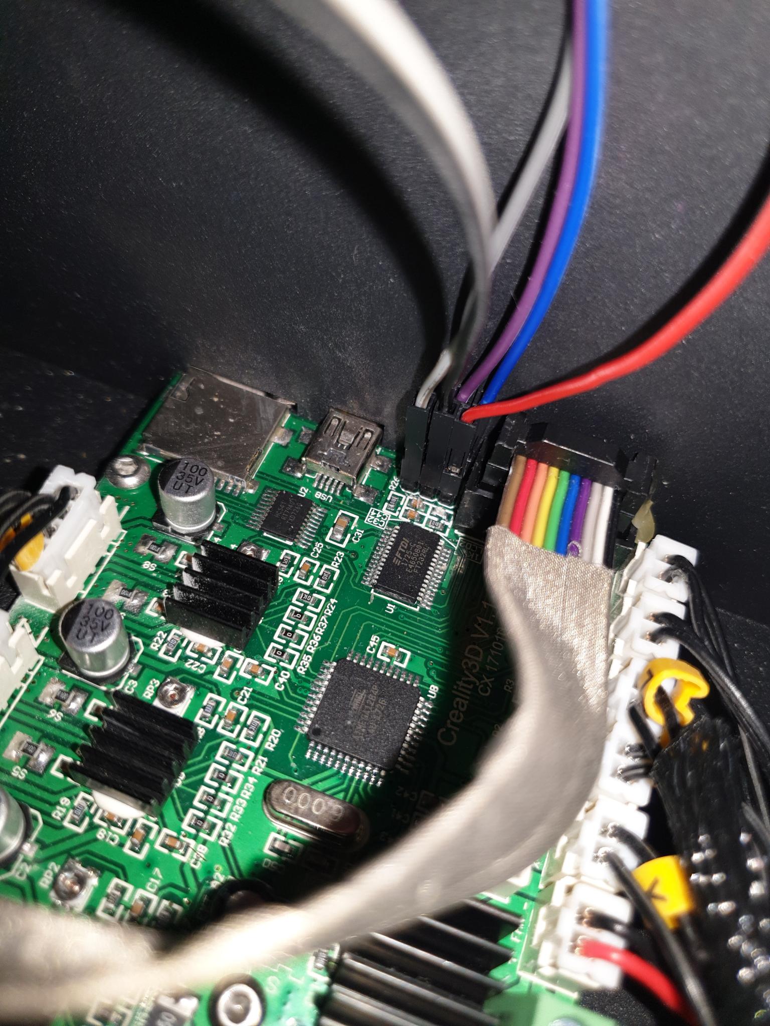

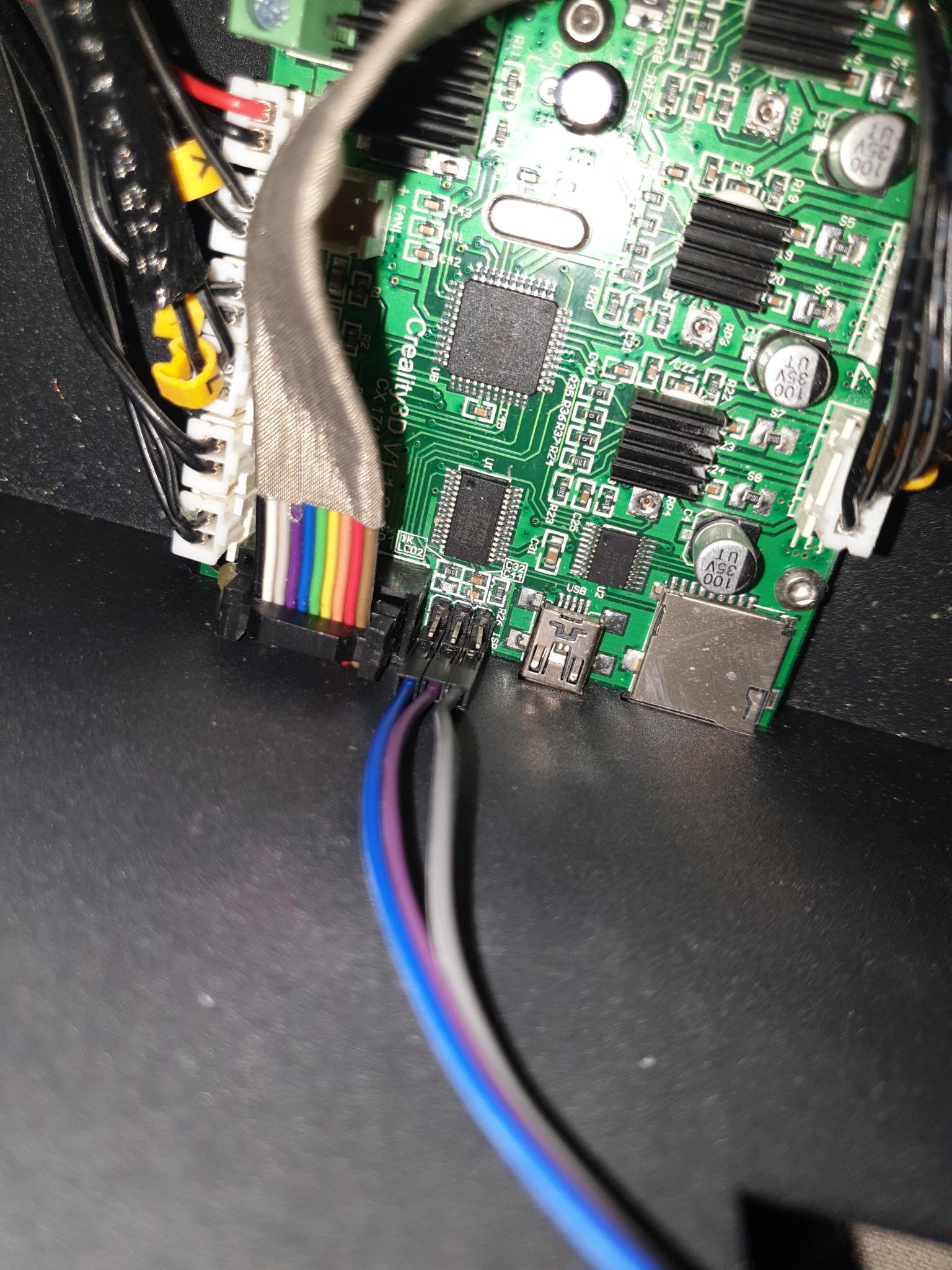

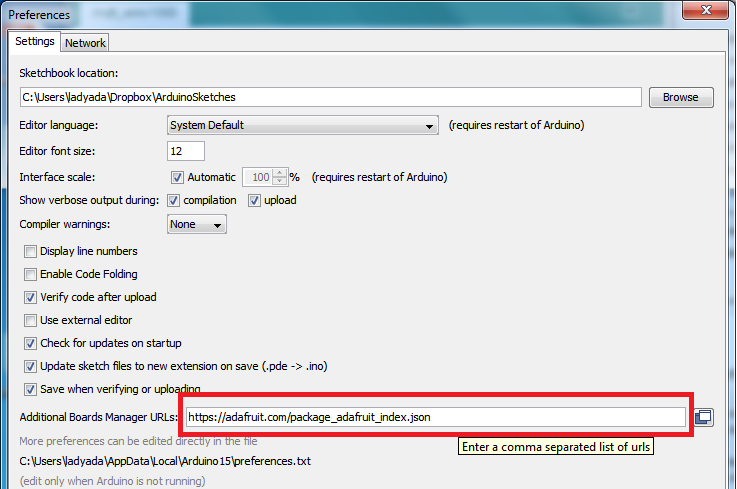

xirox Posté(e) Février 15, 2019 Partager Posté(e) Février 15, 2019 (modifié) Bonjour voila avez vous une photos de votre montage cables et cartes svp ? une ou des images la plus net possible montrant les 2 cartes avec leur pins de brancher Svp colle se liens dans ta source liste de ton ide arduino https://raw.githubusercontent.com/Lauszus/Sanguino/master/package_lauszus_sanguino_index.json puis gestionnaire de carte et installer Sanguino pour avoir les dernier maj pour la carte sur l'ide Modifié (le) Février 15, 2019 par xirox Lien vers le commentaire Partager sur d’autres sites More sharing options...
ethan70 Posté(e) Février 15, 2019 Auteur Partager Posté(e) Février 15, 2019 Lien vers le commentaire Partager sur d’autres sites More sharing options...
ethan70 Posté(e) Février 15, 2019 Auteur Partager Posté(e) Février 15, 2019 (modifié) Il y a 10 heures, xirox a dit : Bonjour voila avez vous une photos de votre montage cables et cartes svp ? une ou des images la plus net possible montrant les 2 cartes avec leur pins de brancher Svp colle se liens dans ta source liste de ton ide arduino https://raw.githubusercontent.com/Lauszus/Sanguino/master/package_lauszus_sanguino_index.json puis gestionnaire de carte et installer Sanguino pour avoir les dernier maj pour la carte sur l'ide Sanguino est déjà installer comme précédemment dis j ai suivi le tuto de derbo sur le marlin 1.1.8 cr10 le téléversement pc arduino se passe très bien suite au changement de carte arduino . c est quand je veut verser le bootloader ça ne fonctionne pas. Je pense avoir brancher correctement la carte, par ailleurs j'ai essayé plusieur branchement sur le spi . erreur que j'ai tentative de 1 a 10 ou check the cable ? Voila ou j en suis et encore merci Modifié (le) Février 15, 2019 par ethan70 Lien vers le commentaire Partager sur d’autres sites More sharing options...
xirox Posté(e) Février 16, 2019 Partager Posté(e) Février 16, 2019 Il y a 19 heures, ethan70 a dit : Sanguino est déjà installer comme précédemment dis j ai suivi le tuto de derbo sur le marlin 1.1.8 cr10 le téléversement pc arduino se passe très bien suite au changement de carte arduino . c est quand je veut verser le bootloader ça ne fonctionne pas. Je pense avoir brancher correctement la carte, par ailleurs j'ai essayé plusieur branchement sur le spi . erreur que j'ai tentative de 1 a 10 ou check the cable ? Voila ou j en suis et encore merci Merci pour les photos. chose toute bête avez vous tester vos câbles ? et et puis avez vous la pin usb to icsp ? sinon il y a un bon tuto sur la procédure a suivre si les branchement son ok pour le vcc et gnd les 2 carte doive s'allumer juste en branchant la carte UNO et il y a du 5v sur la pin vcc doc Attention !!!!! Lien vers le commentaire Partager sur d’autres sites More sharing options...
ethan70 Posté(e) Février 16, 2019 Auteur Partager Posté(e) Février 16, 2019 Bonjour et encore merci Non je n'en ai pas usb jumper sur cette carte et oui les 2 cartes s'allument et sont reconnu dans le gestionnaire de périphériques cordialement Je pense vous avoir poser une colle Lien vers le commentaire Partager sur d’autres sites More sharing options...
