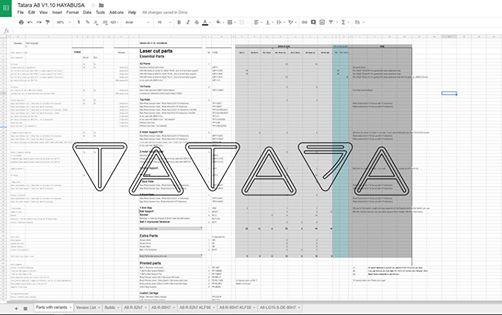

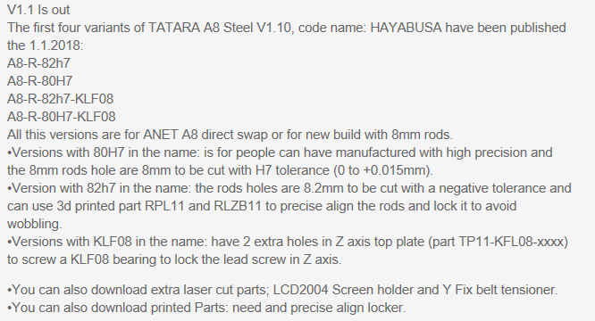

Maeke Posté(e) Juin 10, 2018 Posté(e) Juin 10, 2018 " sorry this is the automatic FB translation] Small memorandum to summarise the current state of the various available variants of the Tatara A8 v1. 1 Hayabusa (14 January 2018) Direct Conversion from Anet A8 (with tolerances of "h7" orH7)A8-R-82h7.zip A8-R-80H7.zip Direct Conversion from Anet A8 with additional holes on top plate for upper klf08 bearings (with tolerances of "h7" orH7) A8-R-82h7-KLF08.zip A8-R-80H7-KLF08.zip Variant for linear guides (with tolerances of "h7" orH7) A8-LG15-S-DE-82h7.zip A8-LG15-S-DE-80H7.zip If you build a TATARA with rods and then you want to be able to update to linear guides you have to use the A8-LG15-S-DE-xxxx plus the pieces TP11-xxxx (2 each) and ZMT11-xxxx (2 each) that Find in the A8-R Version, where xxxx is tolerance. For the number of each piece to cut you always refer to the part list that is present within each .Zip Individual pieces that go both to the right and to the left do not need to specchiarli but just cut them 2 times and ruotarli properly in the real world Parts to be printed in 3 D indispensable are in a separate file: Tatara-Steel-A8-V11-Needed-PP.zip The Printable Flanges for the precise adjustment of the rectified rods are in a separate file: Tatara-Steel-A8-V11-Rods_Precise_Locker.zip You can find it here, and then click on "open in customizer":https://www.thingiverse.com/thing:2746024 Non-Essential Laser cutting parts are in a separate file: Extra-Parts.zip Please, - don't ask us to convert files in. Dxf, it's a very simple operation to do. - do not ask us to do a pre-nesting because it depends on the size of the slabs that the CNC service you are entrusted with can cut and if you want to insert bridging and 99 % will have to do it again according to the specifications of your machines. Tatara team "

Maeke Posté(e) Juin 10, 2018 Posté(e) Juin 10, 2018 (modifié) Ouais, c'est vraiment mal indiqué quand même, bonne idée toutes ces variantes, mais leur système est trop complexe pour savoir quels fichiers utiliser. Modifié (le) Juin 10, 2018 par Maeke
TheSchemer Posté(e) Juin 10, 2018 Auteur Posté(e) Juin 10, 2018 Je pense que je tiens le bout, je vous tiens au courant et éventuellement posterai les fichiers de la bonne version ici

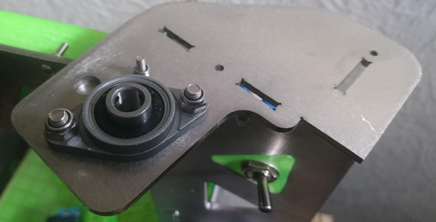

TheSchemer Posté(e) Juillet 4, 2018 Auteur Posté(e) Juillet 4, 2018 Amis du soir bonsoir, voici les news !! J'ai eu le temps de regarder un peu plus précisément l'affaire ! Tout d'abord, petite clarification au niveau des fichiers dispos ici : https://www.thingiverse.com/thing:2736479 Pour résumer : Les versions comprenant 80H7 dans leurs appellations sont celles qui doivent être usinées avec une tolérance H7 soit plus ou moins 0.015 mm Les 82h7 sont quand à elles plus souples au niveau des tolérances...donc tout dépend la machine qui vous fera la découpe ! Ensuite : Les deux dernières comprenant KLF08 sont des versions permettant d'utiliser ce type de dispositif ( @Maeke je te vois grimacer ) Ainsi je ne vais pas tarder pour lancer la découpe de la version A8-R-80H7-KLF08. @Kalemth La suite prochainement...
TheSchemer Posté(e) Juillet 4, 2018 Auteur Posté(e) Juillet 4, 2018 Voici donc les fichiers que je vais utiliser : BS357.dwg BYIT.dwg Parts-list-A8-R-80H7-KLF08.pdf readme.txt RL11.dwg TP11-KFL08-80H7.dwg XYF11.dwg XZF11.dwg YBP11-80H7.dwg YES.dwg YFP11-80H7.dwg YM11B.dwg YZF11-ANET.dwg ZMS11.dwg ZMT11-80H7.dwg

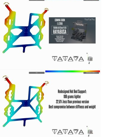

TheSchemer Posté(e) Juillet 5, 2018 Auteur Posté(e) Juillet 5, 2018 Il y a 2 heures, Kalemth a dit : Tu as bien défriché le bazar on dirait, j'attends la suite avec impatience AU niveau du bed, tu es sur quel modèle ? J'ai pu voir que la Tatara avait 2 bed differents, la version 1.1 a un modèle allegé il me semble, c'est l'appelation Hayabusa entre autres il me semble. Les news seront au rdv pas de soucis ! Yes, la dernière version voit son bed allégé, je pars sur ce dernier pour autorisé une plus grande vélocité au niveau du charriot… D'autant plus que ça sera largement assez rigide, découpe dans de l'inox 304l de 3mm. Le voici :

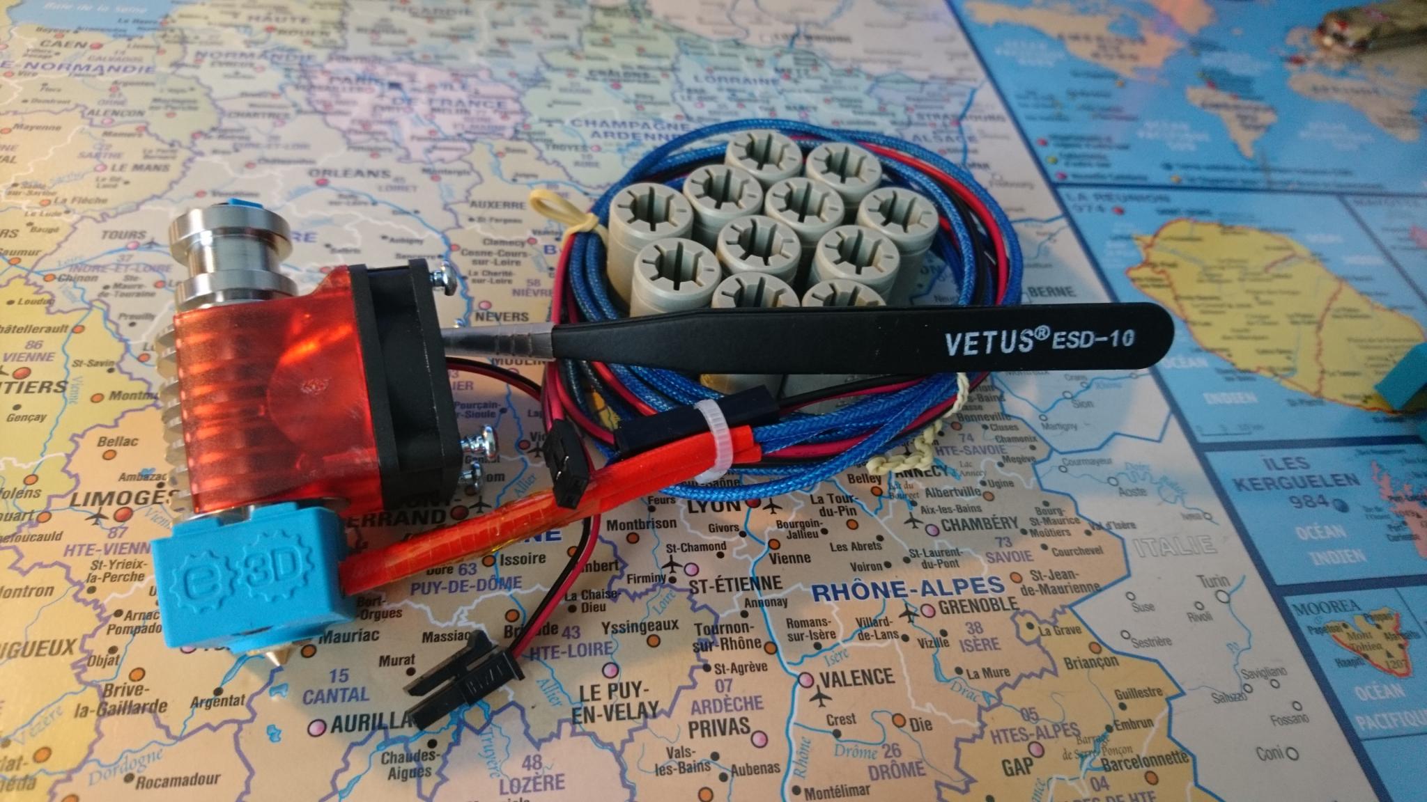

TheSchemer Posté(e) Juillet 5, 2018 Auteur Posté(e) Juillet 5, 2018 Up, réception de la version lite de l'e3dv6 ! Bilan : c'est du costaud et c'est bien usiné, on ne peut pas se tromper sur la qualité des composants ! Je pense avoir fait une bonne affaire puisque acheté à 15euros Les Igus sont également là, ça promet pour la suite !
TheSchemer Posté(e) Juillet 5, 2018 Auteur Posté(e) Juillet 5, 2018 il y a 5 minutes, mikebzh44 a dit : Tu l'as trouvé où à ce prix là ? Je l'ai acheté ici : http://3dmodularsystems.com/fr/electronique/177-tete-chauffante-e3d-lite6-buse-04mm-direct-175mm-12v.html Il y avait de grosses soldes avant-hier, j'avais fait passer le lien dans les bons plans. Et franchement agréablement surpris par la boutique, livraison rapide, emballage soigné...
