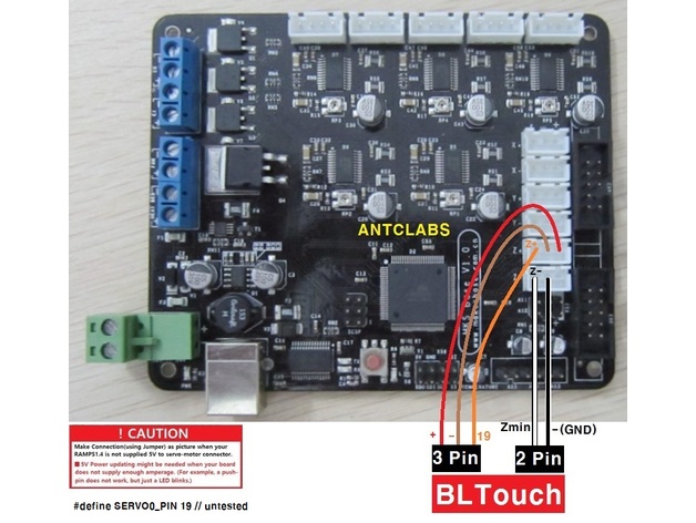

Bon je me suis un peu intéressé au sujet :ph34r: Et je me suis commander  un Bltouch sur alli :ph34r: .
Je suis tomber sur ça : https://www.thingiverse.com/thing:2003264
On a donc un Marlin 1.1.0RC8 d'une cartésienne sur mks base . Parfais  pour  comprendre comment cela marche .
Le but du jeu est de adapter un marlin 1.1.5 sur Dagoma BLtouch Ready .
Les branchement OK :
c0a7b5565b7786425347622a79e6c8f3_preview
La modif dans pins.RAMPS.h
#ifdef IS_RAMPS_13
  #define SERVO0_PIN        19 // RAMPS_13 // Will conflict with BTN_EN2 on LCD_I2C_VIKI
#else
  #define SERVO0_PIN       11
#endif
#define SERVO1_PIN          6
#define SERVO2_PIN          5
#define SERVO3_PIN          4
// Limit Switches
#define X_MIN_PIN           3
#ifndef X_MAX_PIN
  #define X_MAX_PIN         2
#endif
#define Y_MIN_PIN          14
#define Y_MAX_PIN          15
#define Z_MIN_PIN          18
#define Z_MAX_PIN          19
Dans configuration.h apparemment ce ne serais pas bien plus compliqué que de dé-commenter  #define BLTOUCH

Et ensuite suivre la procédure expliqué :
Citation
Run USB cable to printer with slicer ie. Simplify3D, MatterControl, Cura, Repetier etc.
In slicer terminal run:
M280 P0 S10 (to raise BLT pin)
M280 P0 S90 (to drop BLT pin)
M280 P0 S120 enters in test mode (up/down) Perform M402 to stop it.
If BLT enters error mode (blinking red) issue a M280 P0 S160 to shut alarm off.
Do a G28 - should probe center of bed twice, full speed and then slow speed.
Then do G1 Z0 - position won't be good so you need to correct Z-Offset.
Do M851 command, should return Z OFFSET
Move BED Y-25 & X -20 to put the nozzle where the BLTouch just probed.
Get a sheet of paper under nozzle, and do 0.1 steps, and level as you wish going down progressively, note the distance on your LCD screen.
Software Endstop in FW has been deactivated so that the Z can actually have negative values.
Once the nozzle is correct height for you, issue:
M851 Z-xx.xx where xx.xx is the distance you noted
Immediately issue M500 to store in EEPROM
Do a M851 or M501 you should see the value you entered for Z-Offset
Do a G28
Do a G29, it will probe 9 points on your bed.
Now you are ready to print with the BLTouch!

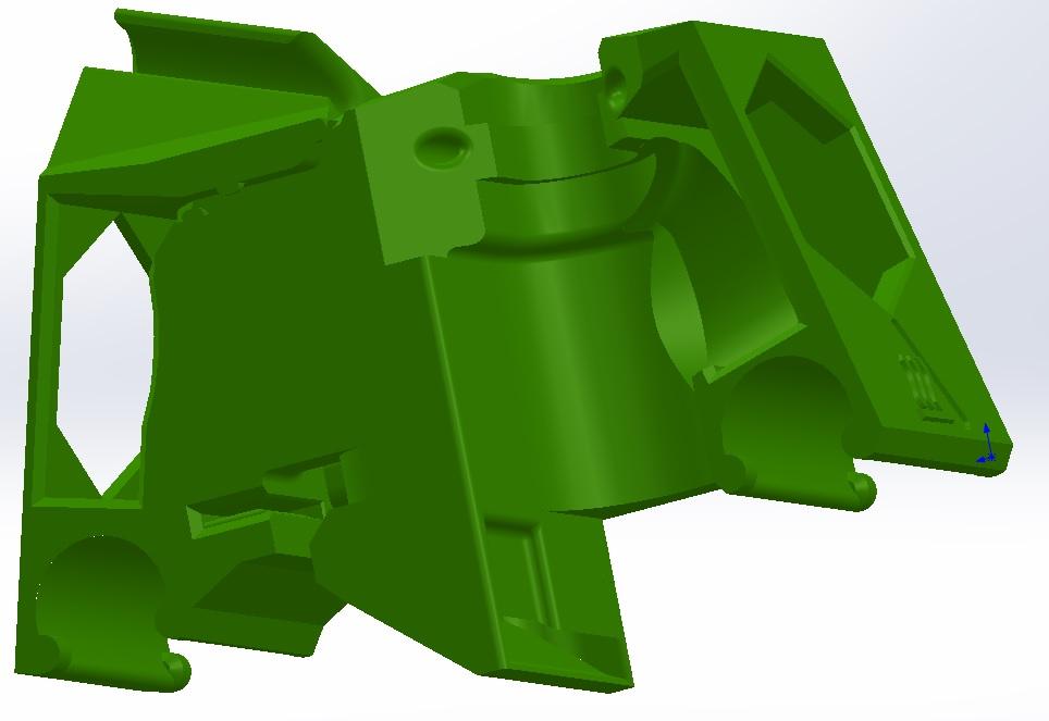

Je suis en train de modifier le .step d'une tête dagoma . Je la transforme en copie de la V3 (bien obliger vu que Dagoma ne veu pas donner les .step ) sans trou pour le palpeur .
Après  je vais crée une pate sur le devant pour le Bltouch . Je devrais avoire fini quand mon BLtouch  arrivera de chine xD
