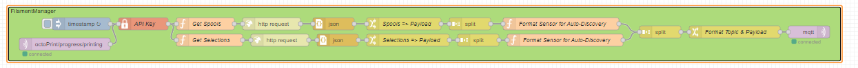

Hello,
Pour information j'ai crée un flow Node-RED (les domoticiens doivent connaitre) pour gérée les filaments et remonter les information dans Home Assistant depuis le plugin FilamentManager d'Octoprint et je balance tt dans MQTT.
Ca permet de récupérer dynamiquement tt les informations sur les filaments et de les afficher dans Home Assistant.
[{"id":"c149e48bea15ff25","type":"group","z":"85c70839c0b6be32","name":"FilamentManager","style":{"stroke":"#000000","fill":"#addb7b","label":true,"color":"#000000"},"nodes":["875a80342ba7f272","3e8386a587337e04","306884563dac1643","67e5ad1a648db995","335c7509a37f1a87","b1c0831515fb907b","b380bf8cb1407279","27dd6084663d4473","9792b0182ed43dc0","9d4cf91fc80217b9","9e84ca11197a4667","56d73242208e035c","cf4b9feca6db9d43","f78bbc85fd3c2a8e","87c36504dd947da8","5743f9277fe69799","1e04c7ea67db3cd3"],"x":34,"y":29,"w":1952,"h":122},{"id":"875a80342ba7f272","type":"inject","z":"85c70839c0b6be32","g":"c149e48bea15ff25","name":"","props":[{"p":"payload"},{"p":"topic","vt":"str"}],"repeat":"300","crontab":"","once":false,"onceDelay":0.1,"topic":"","payloadType":"date","x":150,"y":70,"wires":[["b380bf8cb1407279"]]},{"id":"3e8386a587337e04","type":"function","z":"85c70839c0b6be32","g":"c149e48bea15ff25","name":"Get Spools","func":"msg.url = msg.octoprint_url+'/plugin/filamentmanager/spools'\nmsg.headers = {}\nmsg.headers['X-Api-Key'] = msg.api_key;\nmsg.method = \"GET\"\n    \nreturn msg;","outputs":1,"noerr":0,"initialize":"","finalize":"","libs":[],"x":450,"y":70,"wires":[["306884563dac1643"]]},{"id":"306884563dac1643","type":"http request","z":"85c70839c0b6be32","g":"c149e48bea15ff25","name":"","method":"use","ret":"txt","paytoqs":"ignore","url":"","tls":"","persist":false,"proxy":"","authType":"","senderr":false,"x":610,"y":70,"wires":[["67e5ad1a648db995"]]},{"id":"67e5ad1a648db995","type":"json","z":"85c70839c0b6be32","g":"c149e48bea15ff25","name":"","property":"payload","action":"","pretty":false,"x":760,"y":70,"wires":[["335c7509a37f1a87"]]},{"id":"335c7509a37f1a87","type":"change","z":"85c70839c0b6be32","g":"c149e48bea15ff25","name":"Spools => Payload","rules":[{"t":"set","p":"payload","pt":"msg","to":"payload.spools","tot":"msg"}],"action":"","property":"","from":"","to":"","reg":false,"x":930,"y":70,"wires":[["b1c0831515fb907b"]]},{"id":"b1c0831515fb907b","type":"split","z":"85c70839c0b6be32","g":"c149e48bea15ff25","name":"","splt":"\\n","spltType":"str","arraySplt":1,"arraySpltType":"len","stream":false,"addname":"","x":1090,"y":70,"wires":[["9792b0182ed43dc0"]]},{"id":"b380bf8cb1407279","type":"credentials","z":"85c70839c0b6be32","g":"c149e48bea15ff25","name":"API Key","props":[{"value":"api_key","type":"msg"},{"value":"octoprint_url","type":"msg"},{"value":"ha_prefix","type":"msg"}],"x":300,"y":70,"wires":[["3e8386a587337e04","56d73242208e035c"]]},{"id":"27dd6084663d4473","type":"mqtt out","z":"85c70839c0b6be32","g":"c149e48bea15ff25","name":"","topic":"","qos":"0","retain":"true","respTopic":"","contentType":"","userProps":"","correl":"","expiry":"","broker":"94fffe91.c7ff7","x":1910,"y":90,"wires":[]},{"id":"9792b0182ed43dc0","type":"function","z":"85c70839c0b6be32","g":"c149e48bea15ff25","name":"Format Sensor for Auto-Discovery","func":"var payload = msg.payload\nvar profile = payload.profile\n\nmsg.payload = []\nmsg.payload.push({\n    \"topic\": msg.ha_prefix+\"/sensor/octoprint/filament_\"+payload.id+\"/config\",\n    \"payload\": {\n        \"name\": \"filament_\"+payload.id,\n        \"uniq_id\": \"filament_\"+payload.id,\n        \"stat_t\": msg.ha_prefix+\"/sensor/octoprint/filament_\"+payload.id+\"/state\",\n        \"json_attr_t\": msg.ha_prefix+\"/sensor/octoprint/filament_\"+payload.id+\"/attributes\",\n        \"unit_of_measurement\": \"g\",\n        \"device\": {\n            \"identifiers\": [ \"filament_\"+payload.id ],\n            \"name\": payload.name,\n            \"model\": profile.material,\n            \"manufacturer\": profile.vendor\n        }\n    }\n})\n\n\nname = payload.name.split(\" / \")[0]\ncolor = payload.name.split(\" / \")[1]\nrestant = payload.weight - payload.used\nused_percent = 100 * payload.used / payload.weight\nstate_percent = 100 - used_percent\n\nmsg.payload.push({\n    \"topic\": msg.ha_prefix+\"/sensor/octoprint/filament_\"+payload.id+\"/attributes\",\n    \"payload\": {\n        \"id\": payload.id,\n        \"cost\": payload.cost,\n        \"name\": name,\n        \"color\": color,\n        \"temp_offset\": payload.temp_offset,\n        \"used\": payload.used.toFixed(1),\n        \"used_percent\": used_percent.toFixed(1),\n        \"state_percent\": state_percent.toFixed(1),\n        \"weight\": payload.weight,\n        \"density\": profile.density,\n        \"diameter\": profile.diameter,\n        \"material\": profile.material,\n        \"vendor\": profile.vendor\n    }\n})\n\nmsg.payload.push({\n    \"topic\": msg.ha_prefix+\"/sensor/octoprint/filament_\"+payload.id+\"/state\",\n    \"payload\": restant.toFixed(1)\n})\n   \n    \nreturn msg;","outputs":1,"noerr":0,"initialize":"","finalize":"","libs":[],"x":1310,"y":70,"wires":[["9d4cf91fc80217b9"]]},{"id":"9d4cf91fc80217b9","type":"split","z":"85c70839c0b6be32","g":"c149e48bea15ff25","name":"","splt":"\\n","spltType":"str","arraySplt":1,"arraySpltType":"len","stream":false,"addname":"","x":1550,"y":90,"wires":[["9e84ca11197a4667"]]},{"id":"9e84ca11197a4667","type":"change","z":"85c70839c0b6be32","g":"c149e48bea15ff25","name":"Format Topic & Payload","rules":[{"t":"set","p":"topic","pt":"msg","to":"payload.topic","tot":"msg"},{"t":"set","p":"payload","pt":"msg","to":"payload.payload","tot":"msg"}],"action":"","property":"","from":"","to":"","reg":false,"x":1730,"y":90,"wires":[["27dd6084663d4473"]]},{"id":"56d73242208e035c","type":"function","z":"85c70839c0b6be32","g":"c149e48bea15ff25","name":"Get Selections","func":"msg.url = msg.octoprint_url+'/plugin/filamentmanager/selections'\nmsg.headers = {}\nmsg.headers['X-Api-Key'] = msg.api_key;\nmsg.method = \"GET\"\n    \nreturn msg;","outputs":1,"noerr":0,"initialize":"","finalize":"","libs":[],"x":460,"y":110,"wires":[["cf4b9feca6db9d43"]]},{"id":"cf4b9feca6db9d43","type":"http request","z":"85c70839c0b6be32","g":"c149e48bea15ff25","name":"","method":"use","ret":"txt","paytoqs":"ignore","url":"","tls":"","persist":false,"proxy":"","authType":"","senderr":false,"x":630,"y":110,"wires":[["f78bbc85fd3c2a8e"]]},{"id":"f78bbc85fd3c2a8e","type":"json","z":"85c70839c0b6be32","g":"c149e48bea15ff25","name":"","property":"payload","action":"","pretty":false,"x":770,"y":110,"wires":[["87c36504dd947da8"]]},{"id":"87c36504dd947da8","type":"change","z":"85c70839c0b6be32","g":"c149e48bea15ff25","name":"Selections => Payload","rules":[{"t":"set","p":"payload","pt":"msg","to":"payload.selections","tot":"msg"}],"action":"","property":"","from":"","to":"","reg":false,"x":940,"y":110,"wires":[["5743f9277fe69799"]]},{"id":"5743f9277fe69799","type":"split","z":"85c70839c0b6be32","g":"c149e48bea15ff25","name":"","splt":"\\n","spltType":"str","arraySplt":1,"arraySpltType":"len","stream":false,"addname":"","x":1110,"y":110,"wires":[["1e04c7ea67db3cd3"]]},{"id":"1e04c7ea67db3cd3","type":"function","z":"85c70839c0b6be32","g":"c149e48bea15ff25","name":"Format Sensor for Auto-Discovery","func":"var payload = msg.payload\nvar spool = payload.spool\nvar profile = spool.profile\n\nmsg.payload = []\nmsg.payload.push({\n    \"topic\": msg.ha_prefix+\"/sensor/octoprint/filament_select/config\",\n    \"payload\": {\n        \"name\": \"filament_select\",\n        \"uniq_id\": \"filament_select\",\n        \"stat_t\": msg.ha_prefix+\"/sensor/octoprint/filament_select/state\",\n        \"json_attr_t\": msg.ha_prefix+\"/sensor/octoprint/filament_select/attributes\",\n        // \"unit_of_measurement\": \"g\",\n        \"device\": {\n            \"identifiers\": [ \"filament_select\" ],\n            \"name\": spool.name,\n            \"model\": profile.material,\n            \"manufacturer\": profile.vendor\n        }\n    }\n})\n\n\nname = spool.name.split(\" / \")[0]\ncolor = spool.name.split(\" / \")[1]\nrestant = spool.weight - spool.used\nused_percent = 100 * spool.used / spool.weight\nstate_percent = 100 - used_percent\n\nmsg.payload.push({\n    \"topic\": msg.ha_prefix+\"/sensor/octoprint/filament_select/attributes\",\n    \"payload\": {\n        \"cost\": spool.cost,\n        \"name\": name,\n        \"color\": color,\n        \"temp_offset\": spool.temp_offset,\n        \"used\": spool.used.toFixed(1),\n        \"used_percent\": used_percent.toFixed(1),\n        \"state_percent\": state_percent.toFixed(1),\n        \"weight\": spool.weight,\n        \"density\": profile.density,\n        \"diameter\": profile.diameter,\n        \"material\": profile.material,\n        \"vendor\": profile.vendor\n    }\n})\n\nmsg.payload.push({\n    \"topic\": msg.ha_prefix+\"/sensor/octoprint/filament_select/state\",\n    \"payload\": \"[\"+profile.material+\"] \"+profile.vendor+\" : \"+name\n})\n   \n    \nreturn msg;","outputs":1,"noerr":0,"initialize":"","finalize":"","libs":[],"x":1320,"y":110,"wires":[["9d4cf91fc80217b9"]]},{"id":"94fffe91.c7ff7","type":"mqtt-broker","name":"Mosquitto","broker":"mosquitto.mosquitto","port":"1883","clientid":"","autoConnect":true,"usetls":false,"protocolVersion":"5","keepalive":"60","cleansession":true,"birthTopic":"","birthQos":"0","birthPayload":"","birthMsg":{},"closeTopic":"","closeQos":"0","closePayload":"","closeMsg":{},"willTopic":"","willQos":"0","willPayload":"","willMsg":{},"sessionExpiry":""}]
