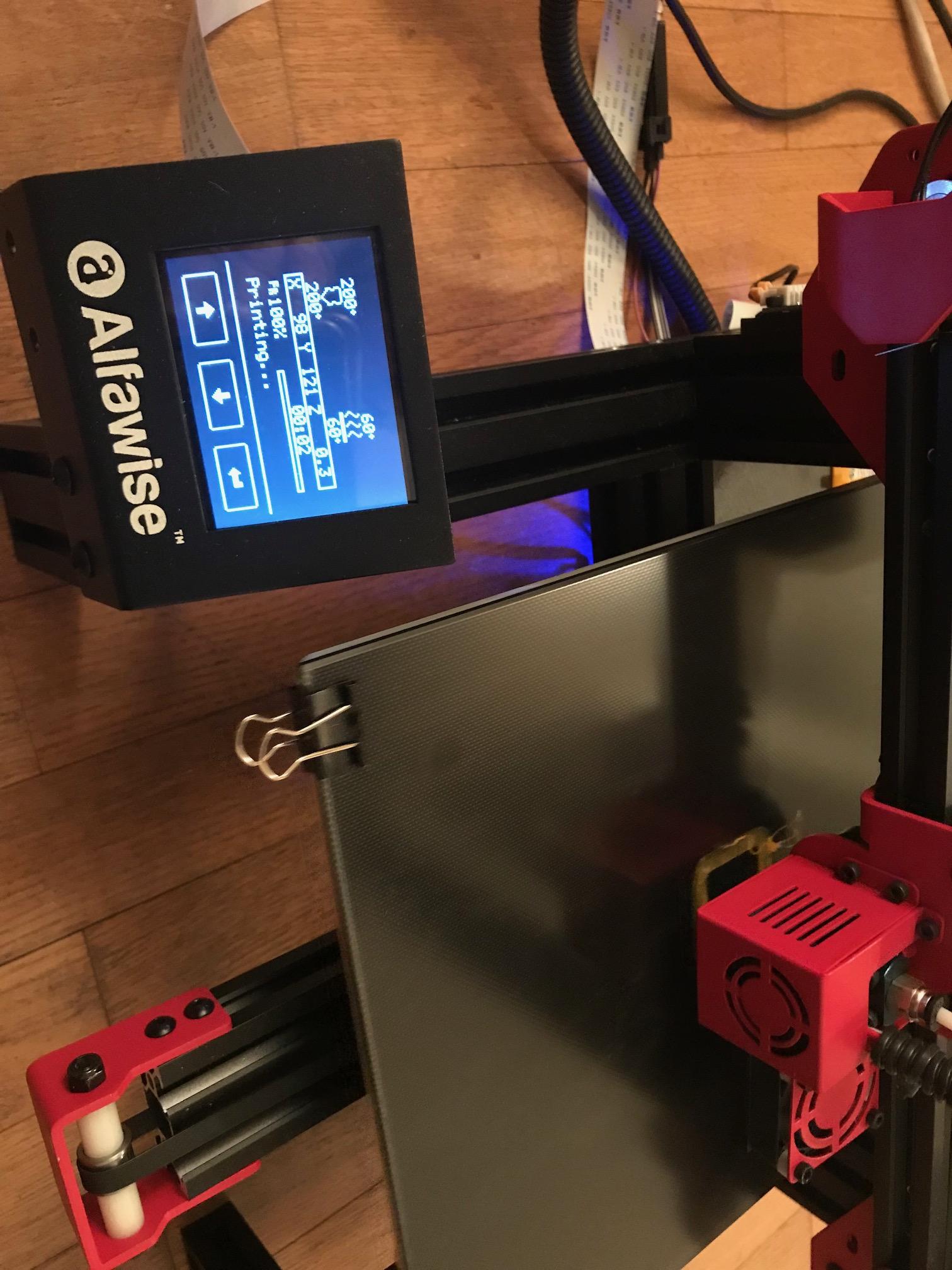

Hobi Posté(e) Avril 10, 2019 Partager Posté(e) Avril 10, 2019 À priori bug du touch fixe ( j avais oublié l initialisation). Reste plus que la broche qui pose problème, mais comme elle commande un des deux transistors mos de chauffe, ça gêne!! Dans tous les cas vous aurez un code demain soir. A+ Lien vers le commentaire Partager sur d’autres sites More sharing options...

Hobi Posté(e) Avril 10, 2019 Partager Posté(e) Avril 10, 2019 tout est configurable au niveau des sondes thermiques! Temperature sensors available: * * -4 : thermocouple with AD8495 * -3 : thermocouple with MAX31855 (only for sensor 0) * -2 : thermocouple with MAX6675 (only for sensor 0) * -1 : thermocouple with AD595 * 0 : not used * 1 : 100k thermistor - best choice for EPCOS 100k (4.7k pullup) * 2 : 200k thermistor - ATC Semitec 204GT-2 (4.7k pullup) * 3 : Mendel-parts thermistor (4.7k pullup) * 4 : 10k thermistor !! do not use it for a hotend. It gives bad resolution at high temp. !! * 5 : 100K thermistor - ATC Semitec 104GT-2/104NT-4-R025H42G (Used in ParCan & J-Head) (4.7k pullup) * 501 : 100K Zonestar (Tronxy X3A) Thermistor * 6 : 100k EPCOS - Not as accurate as table 1 (created using a fluke thermocouple) (4.7k pullup) * 7 : 100k Honeywell thermistor 135-104LAG-J01 (4.7k pullup) * 71 : 100k Honeywell thermistor 135-104LAF-J01 (4.7k pullup) * 8 : 100k 0603 SMD Vishay NTCS0603E3104FXT (4.7k pullup) * 9 : 100k GE Sensing AL03006-58.2K-97-G1 (4.7k pullup) * 10 : 100k RS thermistor 198-961 (4.7k pullup) * 11 : 100k beta 3950 1% thermistor (4.7k pullup) * 12 : 100k 0603 SMD Vishay NTCS0603E3104FXT (4.7k pullup) (calibrated for Makibox hot bed) * 13 : 100k Hisens 3950 1% up to 300°C for hotend "Simple ONE " & "Hotend "All In ONE" * 15 : 100k thermistor calibration for JGAurora A5 hotend * 20 : the PT100 circuit found in the Ultimainboard V2.x * 60 : 100k Maker's Tool Works Kapton Bed Thermistor beta=3950 * 61 : 100k Formbot / Vivedino 3950 350C thermistor 4.7k pullup * 66 : 4.7M High Temperature thermistor from Dyze Design * 70 : the 100K thermistor found in the bq Hephestos 2 * 75 : 100k Generic Silicon Heat Pad with NTC 100K MGB18-104F39050L32 thermistor * * 1k ohm pullup tables - This is atypical, and requires changing out the 4.7k pullup for 1k. * (but gives greater accuracy and more stable PID) * 51 : 100k thermistor - EPCOS (1k pullup) * 52 : 200k thermistor - ATC Semitec 204GT-2 (1k pullup) * 55 : 100k thermistor - ATC Semitec 104GT-2 (Used in ParCan & J-Head) (1k pullup) * * 1047 : Pt1000 with 4k7 pullup * 1010 : Pt1000 with 1k pullup (non standard) * 147 : Pt100 with 4k7 pullup * 110 : Pt100 with 1k pullup (non standard) * 1 Lien vers le commentaire Partager sur d’autres sites More sharing options...
Hobi Posté(e) Avril 10, 2019 Partager Posté(e) Avril 10, 2019 Et la reprise apres coupure de courant est possible mais ca a pas l air aussi bien que le code d'origine. a etudier. 1 Lien vers le commentaire Partager sur d’autres sites More sharing options...

Hobi Posté(e) Avril 11, 2019 Partager Posté(e) Avril 11, 2019 Ah Bhein moteur ok chauffe ok ecran ok Et y a que ce pu@*# de touch qui a marché une fois et qui veut plus rien savoir....grrrrr mais ça imprime avec octoprint. J’ai fait les principaux réglages pour pas tout casser au démarrage mais maintenant il faut sérieusement affiner. La vitesse des moteurs en déplacement hors impression/repiqitionnement est impressionnante . J’ai peut être forcé un peu... maintenant à vous d affiner, tester, régler. Je vais debugger le touch qui pourtant marche bien avec le code de test!!! Lien vers le commentaire Partager sur d’autres sites More sharing options...

Hobi Posté(e) Avril 11, 2019 Partager Posté(e) Avril 11, 2019 Le code de test du LCD et du touch, pour tester si 1- le LCD est reconnu par le SW, et si la sequence d'init est bien presente dans le code ( seulement 3 dispo sur les 6 ecrans... ST7789V, ILI9341 et ILI9328) 2 - tester le touch, et verifier sa calibration. Il faut mettre les doigts sur la croix dans chaque coin > Si c'est pas bon, L'ecran devient temporairement rouge. Une fois le calibrage OK > on peut dessiner avec son ongle, ou bien un stylet pas coupant. Le code exe de ma version de Marlin. Et je vais poster les sources dans un repertoire free, car je merdouille lamentablement avec Github... Le tout est compile sous Platformio.Test_lcd.elf Marlin2.0xAlfawiseUx0.bin Lien vers le commentaire Partager sur d’autres sites More sharing options...
