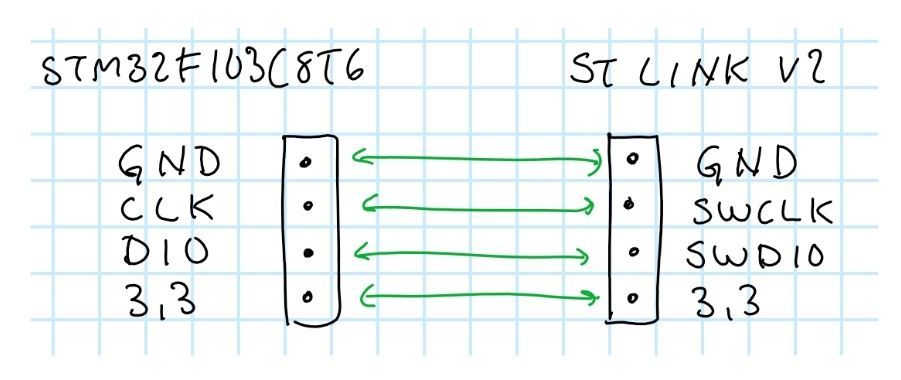

Epsylon3 Posté(e) Avril 17, 2023 Partager Posté(e) Avril 17, 2023 (modifié) Or maybe you flashed a firmware with a stflash and a bad offset at some point ? i dont see other possible reasons of a black screen with the official longer firmware. I mean, the only reason could be a replaced or empty bootloader Modifié (le) Avril 17, 2023 par Epsylon3 Lien vers le commentaire Partager sur d’autres sites More sharing options...
Hobi Posté(e) Avril 17, 2023 Partager Posté(e) Avril 17, 2023 If the bootloader shows a green bar then the lcd cable is fine! Lien vers le commentaire Partager sur d’autres sites More sharing options...
insestito Posté(e) Avril 18, 2023 Partager Posté(e) Avril 18, 2023 Il y a 19 heures, Epsylon3 a dit : Or maybe you flashed a firmware with a stflash and a bad offset at some point ? i dont see other possible reasons of a black screen with the official longer firmware. I mean, the only reason could be a replaced or empty bootloader i tried to compile marlin myself, but i must have done something wrong, because this problem comes from when i installed the marlin i compiled. Maybe at that time the bootloader was replaced with that of a different printer? (maybe I compiled marlin for a different model) Lien vers le commentaire Partager sur d’autres sites More sharing options...
insestito Posté(e) Avril 20, 2023 Partager Posté(e) Avril 20, 2023 Le 17/04/2023 at 12:57, Epsylon3 a dit : Or maybe you flashed a firmware with a stflash and a bad offset at some point ? i dont see other possible reasons of a black screen with the official longer firmware. I mean, the only reason could be a replaced or empty bootloader If I did that, could it be fixed? Lien vers le commentaire Partager sur d’autres sites More sharing options...
Hobi Posté(e) Avril 20, 2023 Partager Posté(e) Avril 20, 2023 As long as putting an sd card in the slot results in the bootloader to display the green bar you can fix easily. Watchout some sd cards seem to generate issues. If the green progress bar moves the bootloader is fine. if you do not get the small progress bar then you have to reflash with stlink, as you probably erased the bootloader but using only the sd card I fail to understand how this can happen 1 Lien vers le commentaire Partager sur d’autres sites More sharing options...

Denethor Posté(e) Juin 23, 2023 Partager Posté(e) Juin 23, 2023 (modifié) Bonjour, ce matin j'ai essayé de mettre à jour Marlin sur mon Alfawise U30. Malheureusement, quelque chose s'est mal passé et la mise à jour n'a pas réussi. Maintenant, l'écran reste noir, la mise à jour du firmware ne démarre pas et le Bootloader sera probablement corrompu. J'ai récupéré plusieurs board de drones STM32 par le passé, je ne sais pas si c'est pareil pour les imprimantes 3d. Quelqu'un peut-il me dire la procédure correcte pour récupérer la carte? J'ai aussi Arduino et UsbAsp disponibles s'ils sont utiles. Merci P.S. Entre-temps j'ai acheté un StLink V2 et j'ai trouvé ce schéma des PIN sur la board... est-ce que tout est correct ? Dois-je faire attention à quelque chose en particulier ? Merci Modifié (le) Juin 23, 2023 par Denethor Lien vers le commentaire Partager sur d’autres sites More sharing options...
Denethor Posté(e) Juin 23, 2023 Partager Posté(e) Juin 23, 2023 Le 20/04/2023 at 09:12, Hobi a dit : As long as putting an sd card in the slot results in the bootloader to display the green bar you can fix easily. Watchout some sd cards seem to generate issues. If the green progress bar moves the bootloader is fine. if you do not get the small progress bar then you have to reflash with stlink, as you probably erased the bootloader but using only the sd card I fail to understand how this can happen je suis dans la situation où après un mauvais flash je ne vois même pas la barre verte sur l'écran... comment puis-je réécrire avec STLink ? y a-t-il un guide ? Le chargeur de démarrage peut-il être obtenu quelque part ? Je vous remercie beaucoup Lien vers le commentaire Partager sur d’autres sites More sharing options...

Denethor Posté(e) Juin 23, 2023 Partager Posté(e) Juin 23, 2023 il y a 8 minutes, pommeverte a dit : Salut, Avec les valeurs de PID du lit que tu as, ce n'est pas étonnant . Après un réglage du PID, tout devrait fonctionner. @pommeverte pouvez-vous m'aider de quelque manière que ce soit ? Avez-vous des conseils utiles pour déverrouiller mon imprimante ? je serais très reconnaissant merci Lien vers le commentaire Partager sur d’autres sites More sharing options...
