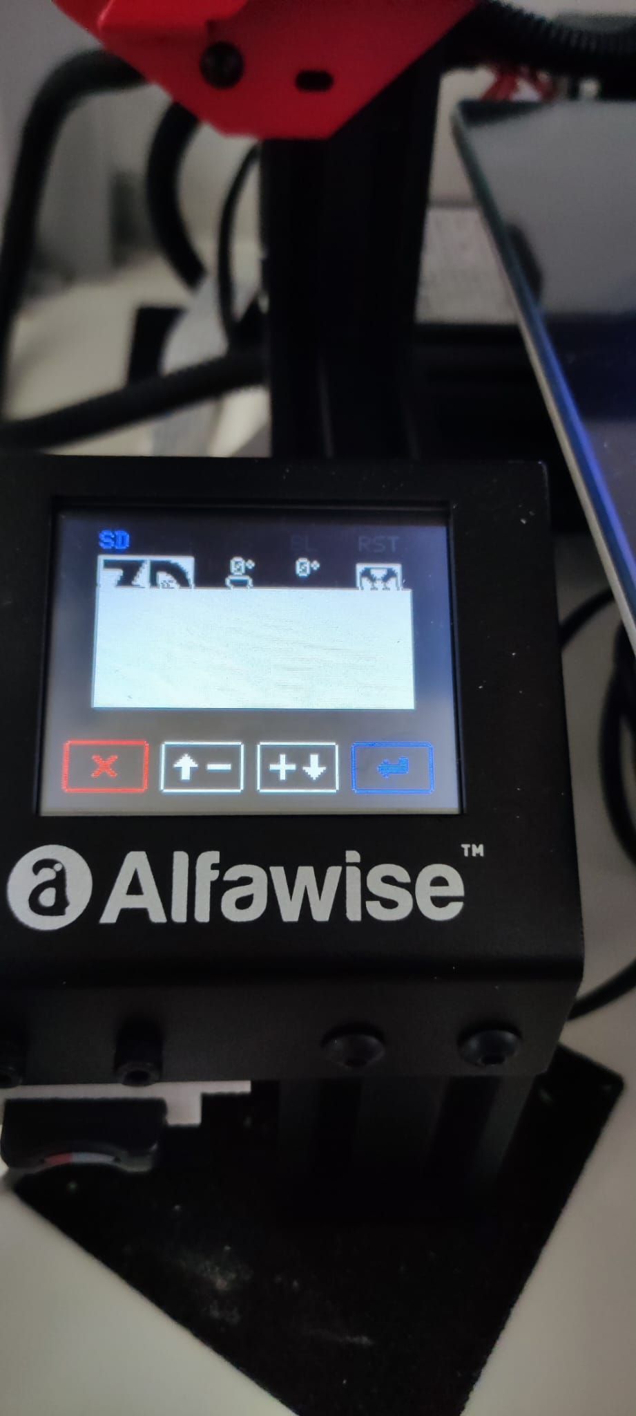

lattamatthias Posté(e) Février 24 Partager Posté(e) Février 24 Hi, i flashed the Marlin tpruvot version on my U30 and configured a bltouch. github.com/tpruvot/Marlin V0G, Touchscreen V19 Almost everthing works fine, but the Display is flickering and the eeprom file wouldnt be saved on the SD card. Printing Gcode from SD card is working, so i think the SD Slot itself isn't the problem. Could you help me with that? config.ini Configuration.h Configuration_adv.h Lien vers le commentaire Partager sur d’autres sites More sharing options...
Epsylon3 Posté(e) Février 24 Partager Posté(e) Février 24 Is that happening when you start the printer without sd card ? Lien vers le commentaire Partager sur d’autres sites More sharing options...
lattamatthias Posté(e) Février 25 Partager Posté(e) Février 25 No, it happens with and without SD Card inserted Lien vers le commentaire Partager sur d’autres sites More sharing options...
Hobi Posté(e) Février 26 Partager Posté(e) Février 26 @lattamatthias Have you nicely folded the ribon cable? If you did, make sure you unpack it/ unfold it, as folding the flat ribbon cable nicely creates impedance issues... There is no real reason for your LCD screen to flicker, beside a poor connectio or too long ribbon cable, or improperly secured flat cable in the cable connectors on the screen / board. Hob. Lien vers le commentaire Partager sur d’autres sites More sharing options...
lattamatthias Posté(e) Février 27 Partager Posté(e) Février 27 you were right, thank you! It was the extension of the ribbon cable But the eeprom is still not saved on the sd card. Do you have any idea? Lien vers le commentaire Partager sur d’autres sites More sharing options...
Hobi Posté(e) Février 28 Partager Posté(e) Février 28 @lattamatthias regarding the eeprom once you have flashed a new code you have to erase/ initialize it. As the screen was not working well you might have missed that step. Put again your sdcard with rom code into the slot and reflash it. Then erase initialize the eeprom . No reason for it to not work Or your sdcard is too big and not properly formatted. Try to find an old sdcard like 1Gb . Lien vers le commentaire Partager sur d’autres sites More sharing options...
Epsylon3 Posté(e) Février 28 Partager Posté(e) Février 28 The most stable now is to store the eeprom on the STM chip itself.. that requires to use the more recent (standard) STM32 framework Lien vers le commentaire Partager sur d’autres sites More sharing options...
