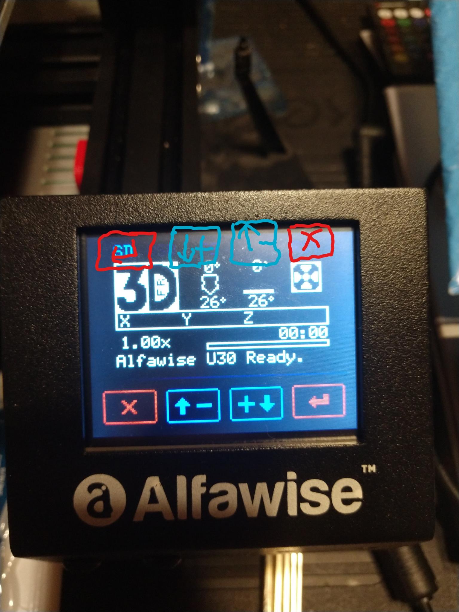

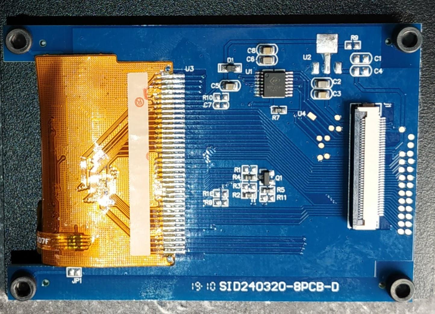

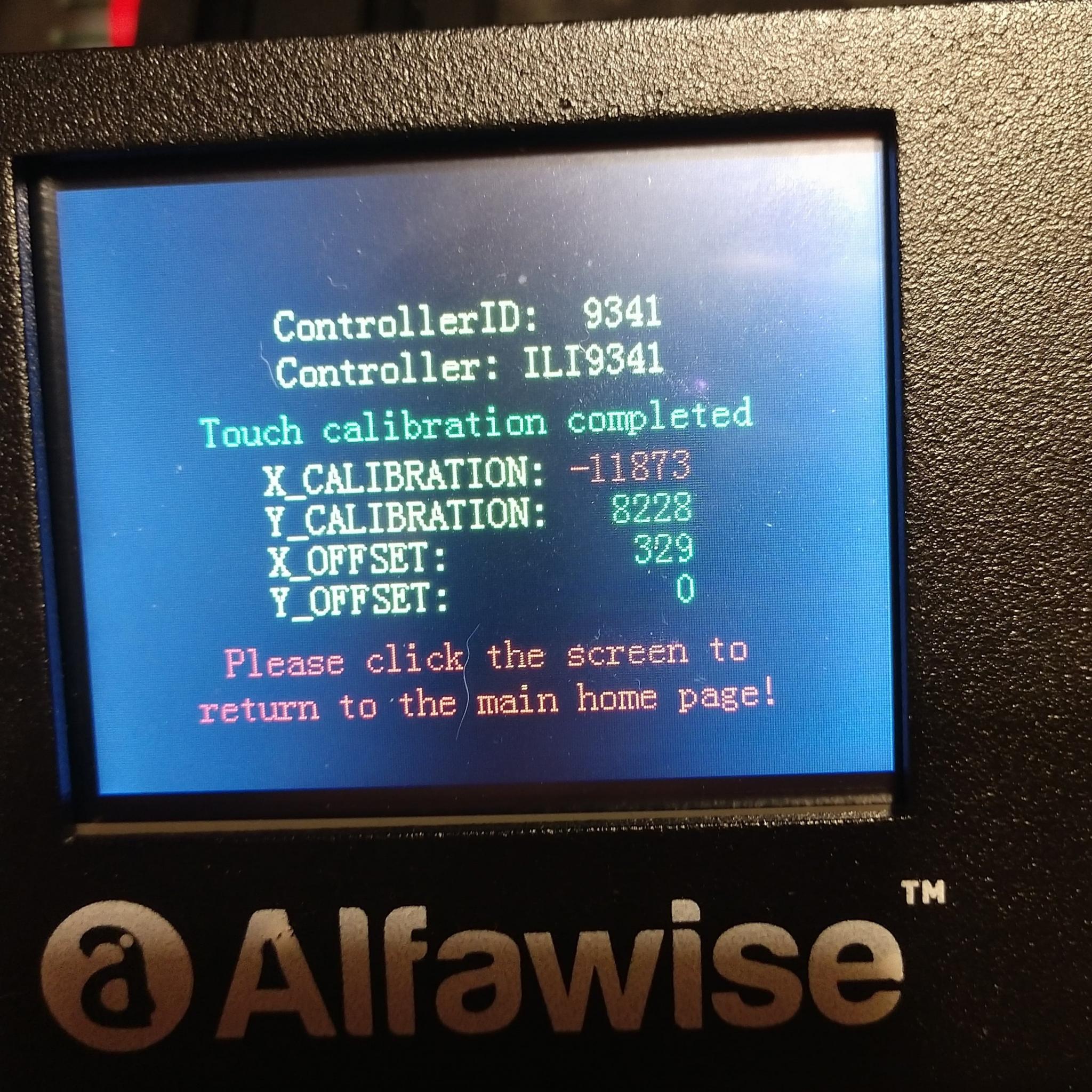

abeywan Posté(e) Octobre 15, 2019 Partager Posté(e) Octobre 15, 2019 Hi, This is my first french post. I have this display on the U30 with xpt2046 chipset. I have set display to V1.2 on configuration.h. I have notice the touchscreen don't work where the buttons are. But the top of the screen is where the invisible buttons at and it is 180 degree turn. so I have went in to the calibration touchscreen and I push the "+" in the correct spot. Then the buttons on the buttons are in correct spots. I also notice on the Longer3d website have new firmware for LK1, LK2, and LK4. In LK4 folder there are marlin 2.0 code which base Hobi, tpruvot. The only difference are the screen is the same layout as 2.16, and you can see the info in the about. You can't put BLTouch setting on configuration.h. Its will fail when you run build task. Lien vers le commentaire Partager sur d’autres sites More sharing options...
Epsylon3 Posté(e) Octobre 15, 2019 Partager Posté(e) Octobre 15, 2019 ok, tx, i will add a new entry as TS_V19 to the git Lien vers le commentaire Partager sur d’autres sites More sharing options...
abeywan Posté(e) Octobre 15, 2019 Partager Posté(e) Octobre 15, 2019 (modifié) 16 hours ago, abeywan said: Hi, This is my first french post. I have this display on the U30 with xpt2046 chipset. I have set display to V1.2 on configuration.h. I have notice the touchscreen do not work where the buttons are. But the top of the screen is where the invisible buttons are. so I went to the calibration touchscreen and I push the "+" in the correct spot. Then the buttons on the buttons are in correct spots. I also have a new firmware for LK1, LK2, and LK4. In LK4 there are marlin 2.0 code which base Hobi, tpruvot. The only difference is the same layout as 2.16, and you can see the info in the about. You can not put BLTouch setting on configuration.h. It will fail when you run build task. I was not proofreading what I wrote. I mean I saw Longer3d website. On LK4 have Marlin firmwarewhich base you guy create the only difference is the same layout as Longer3D Gold Alfawise. Here the link to their Dropbox, https://www.dropbox.com/sh/si2vgtg8era0hf0/AABS8myAKXlad_6ndoDIbs6Fa?dl=0 Modifié (le) Octobre 15, 2019 par abeywan Lien vers le commentaire Partager sur d’autres sites More sharing options...

abeywan Posté(e) Octobre 15, 2019 Partager Posté(e) Octobre 15, 2019 on you printer go to the menu then go to configuration the scroll down til you see touchscreen then you will need a style pen (like Nintendo 3ds pen). Keep trying til you get all four corners and you will able to use it. Lien vers le commentaire Partager sur d’autres sites More sharing options...
jlm66 Posté(e) Octobre 16, 2019 Partager Posté(e) Octobre 16, 2019 thx you mate ! my u20 run perfectly with your help ! Lien vers le commentaire Partager sur d’autres sites More sharing options...
