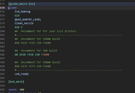

MP3 Posté(e) Mars 12, 2025 Auteur Posté(e) Mars 12, 2025 (modifié) Il y a 1 heure, hyoti a dit : Tout à la fin du printer.cfg, j 'ai ça ... Il y a 1 heure, Savate a dit : fais voir la macro G32 quand je tape G32, la voron fait tout ça ... à lire de bas en haut ... elle fait un Home XYZ, prends le klicky et nivelle le lit, repose le klicky, fit un nettoyage, un Z probe, puis ce place au milieu du plateau en attente. 18:51 probe: TRIGGERED 18:51 probe: TRIGGERED 18:51 Probe already docked 18:51 probe: TRIGGERED 18:51 Homing Z 18:51 probe: TRIGGERED 18:51 Retries: 1/5 Probed points range: 0.008438 tolerance: 0.020000 18:51 Making the following Z adjustments: stepper_z = 0.013980 stepper_z1 = -0.010868 stepper_z2 = 0.002853 stepper_z3 = -0.005964 18:51 Average: 3.993215 18:51 Actuator Positions: z: 3.979235 z1: 4.004083 z2: 3.990362 z3: 3.999179 18:51 Gantry-relative probe points: 0: 3.986768 1: 3.995205 2: 3.993955 3: 3.993955 18:51 probe at 250.000,25.000 is z=6.006670 18:51 probe at 250.000,25.000 is z=6.006045 18:51 probe at 250.000,25.000 is z=6.004170 18:51 probe at 250.000,225.000 is z=6.006357 18:51 probe at 250.000,225.000 is z=6.005732 18:50 probe at 250.000,225.000 is z=6.006045 18:50 probe at 50.000,225.000 is z=6.004795 18:50 probe at 50.000,225.000 is z=6.005420 18:50 probe at 50.000,225.000 is z=6.004795 18:50 probe at 50.000,25.000 is z=6.014170 18:50 probe at 50.000,25.000 is z=6.013232 18:50 probe at 50.000,25.000 is z=6.011045 18:50 Retries: 0/5 Probed points range: 0.259375 tolerance: 0.020000 18:50 Making the following Z adjustments: stepper_z = -0.182295 stepper_z1 = -0.029285 stepper_z2 = 0.360598 stepper_z3 = -0.149018 18:50 Average: 4.004485 18:50 Actuator Positions: z: 4.186780 z1: 4.033770 z2: 3.643887 z3: 4.153503 18:50 Gantry-relative probe points: 0: 4.142563 1: 4.012875 2: 3.883188 3: 4.102250 18:50 probe at 250.000,25.000 is z=5.898062 18:50 probe at 250.000,25.000 is z=5.897750 18:50 probe at 250.000,25.000 is z=5.896500 18:50 probe at 250.000,225.000 is z=6.116812 18:50 probe at 250.000,225.000 is z=6.116812 18:50 probe at 250.000,225.000 is z=6.116500 18:50 probe at 50.000,225.000 is z=5.987125 18:50 probe at 50.000,225.000 is z=5.987437 18:50 probe at 50.000,225.000 is z=5.987125 18:50 probe at 50.000,25.000 is z=5.858062 18:50 probe at 50.000,25.000 is z=5.857437 18:50 probe at 50.000,25.000 is z=5.853375 18:50 probe: open 18:50 Attaching Probe 18:50 probe: TRIGGERED 18:50 QG Level 18:50 probe: TRIGGERED 18:49 probe: TRIGGERED 18:49 probe: open 18:49 Homing Z 18:49 Homing Y 18:49 Homing X 18:49 X or Y not homed, forcing full G28 18:49 moving to a safe Z distance 18:49 No axis homed 18:49 G32 Modifié (le) Mars 12, 2025 par MP3
Savate Posté(e) Mars 12, 2025 Posté(e) Mars 12, 2025 (modifié) il y a 5 minutes, MP3 a dit : quand je tape G32, la voron fait tout ça ... dans le printer.cfg il doit y avoir le détail de la macro G32 (un klippy.log doit convenir aussi, les macros sont dedans) Modifié (le) Mars 12, 2025 par Savate
MP3 Posté(e) Mars 12, 2025 Auteur Posté(e) Mars 12, 2025 il y a 37 minutes, Savate a dit : dans le printer.cfg

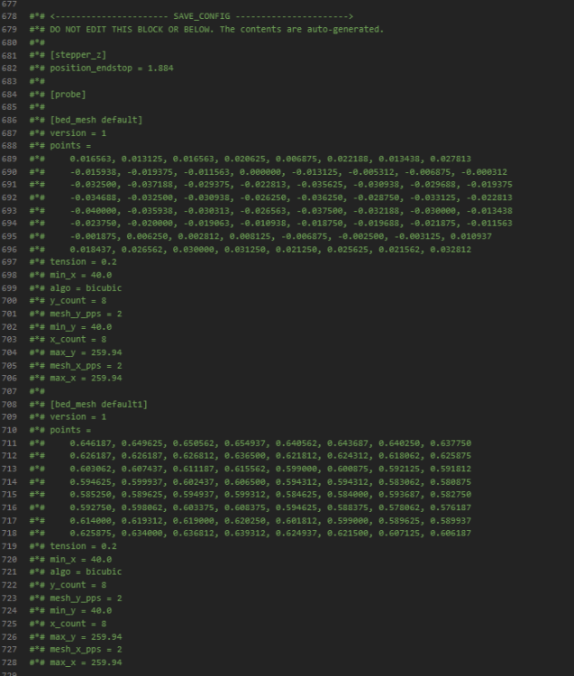

Savate Posté(e) Mars 12, 2025 Posté(e) Mars 12, 2025 il y a 3 minutes, MP3 a dit : dans le printer.cfg après la ligne G28 Z tu peux rajouter BED_MESH_PROFILE LOAD=default pour le forcer a recharger le nivellement (mais normalement c'est le cas) 1
MP3 Posté(e) Mars 12, 2025 Auteur Posté(e) Mars 12, 2025 (modifié) Il y a 1 heure, Savate a dit : BED_MESH_PROFILE LOAD=default on ne dois pas changer le nom "default", car moi j'avais enregistré sous "maillage_110deg", et je voulais faire 2 profils, un vers 110°C et l'autre vers 60°C par exemple. Modifié (le) Mars 12, 2025 par MP3
Savate Posté(e) Mars 13, 2025 Posté(e) Mars 13, 2025 Il y a 9 heures, MP3 a dit : on ne dois pas changer le nom "default", car moi j'avais enregistré sous "maillage_110deg", et je voulais faire 2 profils, un vers 110°C et l'autre vers 60°C par exemple Dans ton printer config il y avait marqué default à la fin d'où la commande avec default. Si tu l'as enregistré sous un autre nom, oui il faut mettre le bon nom

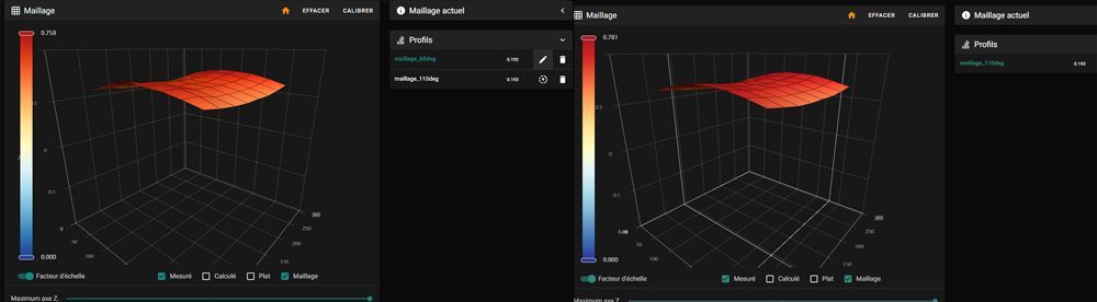

MP3 Posté(e) Mars 13, 2025 Auteur Posté(e) Mars 13, 2025 (modifié) Il y a 7 heures, Savate a dit : Si tu l'as enregistré sous un autre nom, oui il faut mettre le bon nom Arfff !!! je n'avais pas enregistré, maintenant c'est enregistré sous le nom désiré "maillage_110deg" et ça apparait dans le printer.cfg par contre je n'arrive pas à faire mieux, j'ai re-vérifier les vis du bed sur les 2 rails, et les 2 rails sur le cadre, rien n'a changé. La plaque alu doit avoir cette forme !? @hyoti et entre 110°C et 60°C pas de différence notables !!! delta 0.192 et 0.193. Modifié (le) Mars 13, 2025 par MP3
Savate Posté(e) Mars 13, 2025 Posté(e) Mars 13, 2025 il y a une heure, MP3 a dit : par contre je n'arrive pas à faire mieux 0,2 sur un plateau de 300mm c'est compliqué d'avoir mieux quand même Il ne faut pas oublier que la forme est accentuée par le zoom.
MP3 Posté(e) Mars 13, 2025 Auteur Posté(e) Mars 13, 2025 (modifié) il y a 22 minutes, Savate a dit : 0,2 sur un plateau de 300mm c'est compliqué d'avoir mieux quand même Ok, je suis en train de me faire mes échelles de valeurs au fur et à mesure, il ne transpire pas grand chose à ce sujet sur le net. Ok, on va laisser ainsi ! Je cogite sur modifier la tête d'impression, en Stealthburner + CW2 ou Stealthburner + Orbiter V2 ou Dragonburner (j'ai les ventilos) + Orbiter V2 (j'ai l'orbiter V2) reste à imprimer tout cela, mais ce serait quoi le mieux ? Modifié (le) Mars 13, 2025 par MP3
Funboard29 Posté(e) Mars 13, 2025 Posté(e) Mars 13, 2025 il y a une heure, MP3 a dit : et entre 110°C et 60°C pas de différence notables !!! delta 0.192 et 0.193. Cohérent. Je laisse klipper charger le maillage par défaut que j'avais effectué à 108°. Je n'y touche jamais. J'ai 0.14 sur un plateau de 350mm alors que j'ai 0.95 sans la feuille magnétique et la plaque. il y a 2 minutes, MP3 a dit : Stealthburner + Orbiter V2 J'ai ça en je n'en changerais pas.
MP3 Posté(e) Mars 13, 2025 Auteur Posté(e) Mars 13, 2025 (modifié) il y a 33 minutes, Savate a dit : 0,2 sur un plateau de 300mm c'est compliqué d'avoir mieux quand même ca doit générer du décalage de couches sur la hauteur, non ? Ou le première couche compense en nivelant ? Modifié (le) Mars 13, 2025 par MP3
