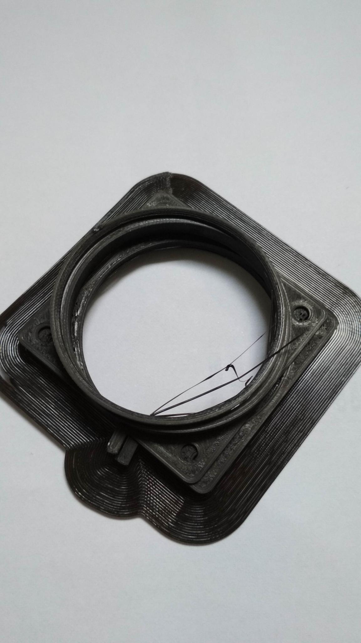

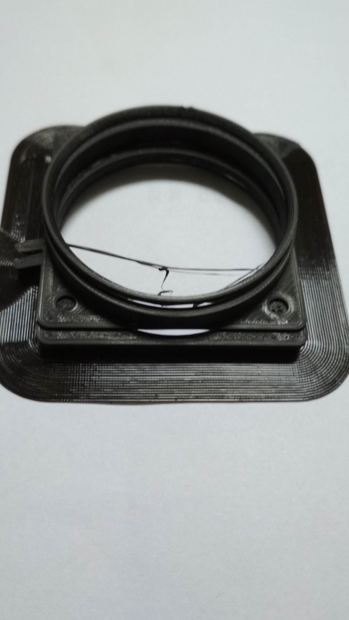

oudini Posté(e) Avril 26, 2019 Posté(e) Avril 26, 2019 @boleofr échec ici pour ta pièce Des décalages en Y malgré des paramètres à ras des pâquerettes! /** * Default Max Feed Rate (mm/s) * Override with M203 * X, Y, Z, E0 [, E1[, E2[, E3[, E4[, E5]]]]] */ #define DEFAULT_MAX_FEEDRATE { 200, 200, 50, 25 } /** * Default Max Acceleration (change/s) change = mm/s * (Maximum start speed for accelerated moves) * Override with M201 * X, Y, Z, E0 [, E1[, E2[, E3[, E4[, E5]]]]] */ #define DEFAULT_MAX_ACCELERATION { 300, 300, 10, 3000 } /** * Default Acceleration (change/s) change = mm/s * Override with M204 * * M204 P Acceleration * M204 R Retract Acceleration * M204 T Travel Acceleration */ #define DEFAULT_ACCELERATION 300 // X, Y, Z and E acceleration for printing moves #define DEFAULT_RETRACT_ACCELERATION 400 // E acceleration for retracts #define DEFAULT_TRAVEL_ACCELERATION 300 // X, Y, Z acceleration for travel (non printing) moves /** * Default Max Feed Rate (mm/s) * Override with M203 * X, Y, Z, E0 [, E1[, E2[, E3[, E4[, E5]]]]] */ #define DEFAULT_MAX_FEEDRATE { 200, 200, 50, 25 } /** * Default Max Acceleration (change/s) change = mm/s * (Maximum start speed for accelerated moves) * Override with M201 * X, Y, Z, E0 [, E1[, E2[, E3[, E4[, E5]]]]] */ #define DEFAULT_MAX_ACCELERATION { 300, 300, 10, 3000 } /** * Default Acceleration (change/s) change = mm/s * Override with M204 * * M204 P Acceleration * M204 R Retract Acceleration * M204 T Travel Acceleration */ #define DEFAULT_ACCELERATION 300 // X, Y, Z and E acceleration for printing moves #define DEFAULT_RETRACT_ACCELERATION 400 // E acceleration for retracts #define DEFAULT_TRAVEL_ACCELERATION 300 // X, Y, Z acceleration for travel (non printing) moves

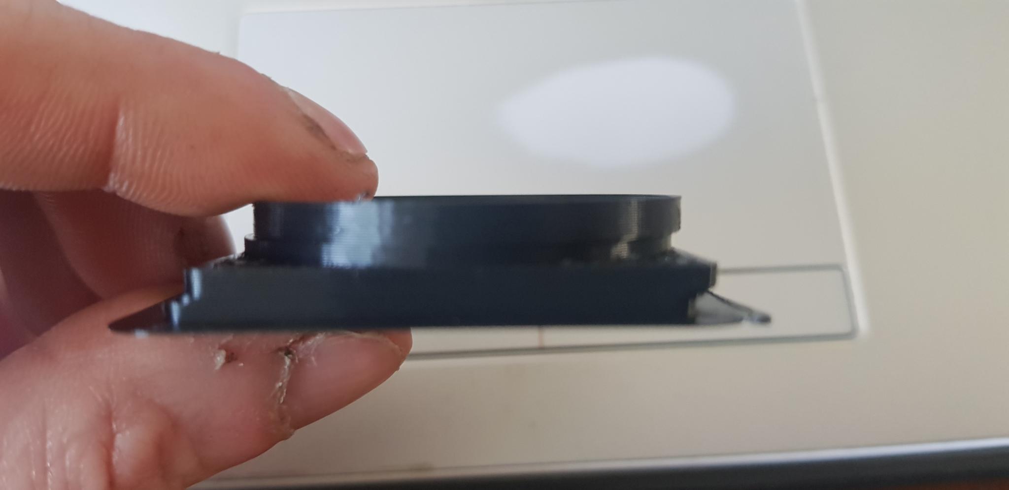

clemb44 Posté(e) Avril 26, 2019 Posté(e) Avril 26, 2019 (modifié) pour la version de @boleofr j'ai sortis le benchy sans decalage Y a 60mm/s le seul vraiment gros truc qui me fait peur ,c'est le déplacement du bed :x il tape a fond dans la fin de courses en Y j'ai inversé le roulement du Z depuis le debut que j'ai l'alfawise l’épaulement du roulement se retrouve au dessus au lieu d'etre bloqué en sandwich entre les 2 supports Modération : Post déplacé dans le bon sujet Modifié (le) Avril 26, 2019 par clemb44

boleofr Posté(e) Avril 26, 2019 Posté(e) Avril 26, 2019 (modifié) @oudini j'ai vu ... mais je en sais pas quoi en déduire, c'est quasi pareil que le bridage précédent et ça fonctionne chez moi... D'où le test ce soir. Niveau défaut, c'est très très similaire on dirait le même endroit Modifié (le) Avril 26, 2019 par boleofr

boleofr Posté(e) Avril 26, 2019 Posté(e) Avril 26, 2019 (modifié) il y a 19 minutes, oudini a dit : oui j'ai utilisé ton G-code direct (il m'a d'ailleurs dégagé une pince au démarrage) Ah merde, désolé j'ai pas pensé à ça... perso pince décalé le long de Y de ce coté là il y a 21 minutes, oudini a dit : J'ai fais le module activateur du touch-mi avec Marlin puis avec Alfawize, j'ai eux un mille-feuilles avec Marlin et une pièce nickel avec Alfawize, ça fout les boules! Aie... Je vais tester aussi (quitte à imprimer autant faire des pièces utiles), tu as le gcode ? Modifié (le) Avril 26, 2019 par boleofr
clemb44 Posté(e) Avril 26, 2019 Posté(e) Avril 26, 2019 (modifié) bon bas moi j'ai pris cura dans mon coin :x 60mm/s du gros claque et deviné lol j'attend la fin de piece pour faire voir les dégâts une impression de claquement de la courroie :x Modifié (le) Avril 26, 2019 par clemb44
