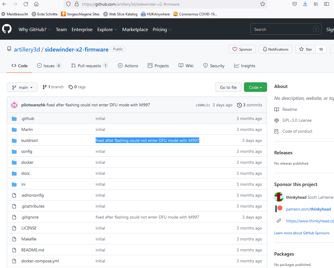

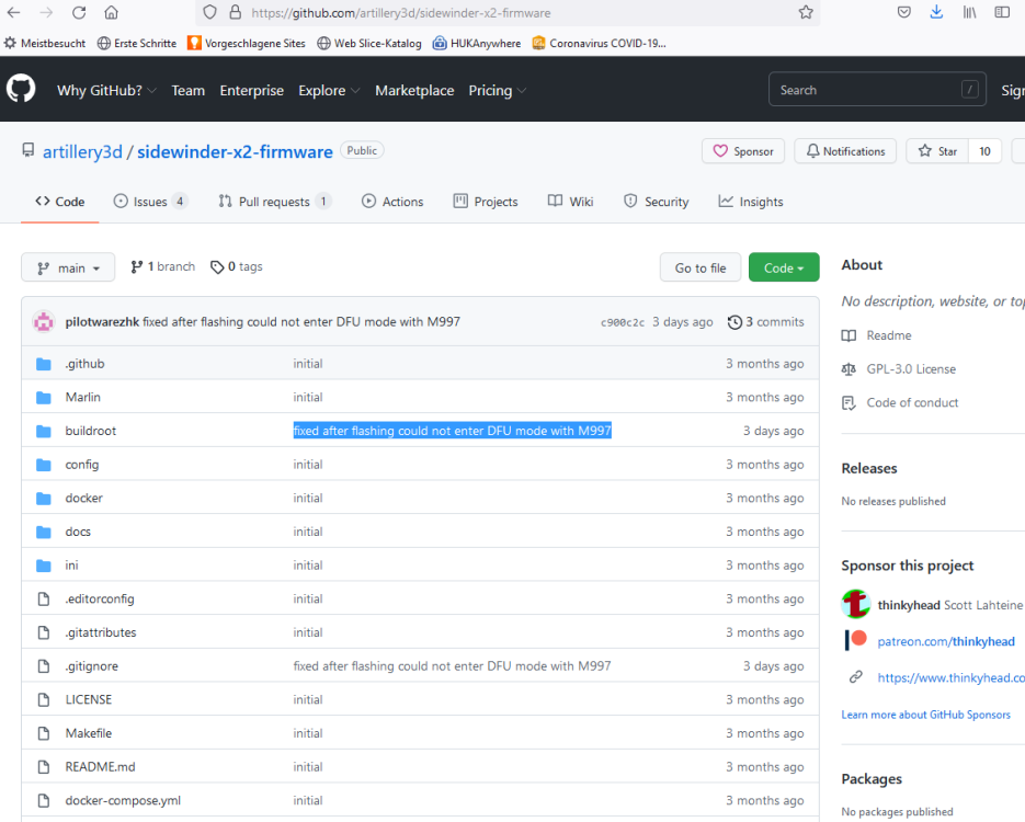

monane Posté(e) Décembre 3, 2021 Posté(e) Décembre 3, 2021 (modifié) Hi Mr. Magounet, sorry for posting not in french. There is a new Artillery Marlin-Firm online for the Sidewinder X2. "Fixed after flashing could not enter DFU mode with M997". https://github.com/artillery3d/sidewinder-x2-firmware https://github.com/artillery3d?tab=repositories And here you find a brand new TFT-Firm with different themes based on Digant-Firm for our X2. https://github.com/Help3D-Padova/LCD-Firmware---Artillery-X1-X2---GENIUS-PRO https://github.com/Help3D-Padova?tab=repositories Best Regards from Germany Modifié (le) Décembre 3, 2021 par monane
MrMagounet Posté(e) Décembre 3, 2021 Auteur Posté(e) Décembre 3, 2021 (modifié) @monane Hi German Firend, Thank you for your information regarding this fix for DFU mode i check this today . For the last BTT firmware TFT i am already working on the new Patch 7 version . Regards from French Friends Modifié (le) Décembre 3, 2021 par MrMagounet 2
