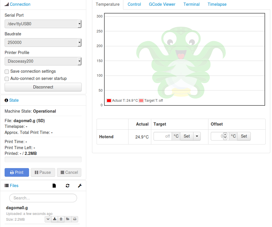

charette.mtb Posté(e) Septembre 17, 2016 Posté(e) Septembre 17, 2016 (modifié) Bonjour, lors de la connexion entre octoprint et une discoEasy200 j'ai des messages de timeout. Pourtant la machine semble bien répondre cf les log ci-dessous: Connecting to: /dev/ttyUSB0 Changing monitoring state from 'Detecting serial port' to 'Opening serial port' Connected to: Serial<id=0xaf7e1bb0, open=True>(port='/dev/ttyUSB0', baudrate=250000, bytesize=8, parity='N', stopbits=1, timeout=10.0, xonxoff=False, rtscts=False, dsrdtr=False), starting monitor Changing monitoring state from 'Opening serial port' to 'Connecting' Recv: start Send: N0 M110 N0*125 Recv: echo:Marlin 1.1.0-RC6 Recv: echo: Last Updated: 2016-04-24 12:00 | Author: Dagoma.Fr Recv: Compiled: Sep 2 2016 Recv: echo: Free Memory: 3545 PlannerBufferBytes: 1232 Recv: echo:V23 stored settings retrieved (396 bytes) Recv: echo:Steps per unit: Recv: echo: M92 X80.00 Y80.00 Z2560.00 E98.00 Recv: echo:Maximum feedrates (mm/s): Recv: echo: M203 X500.00 Y500.00 Z4.00 E25.00 Recv: echo:Maximum Acceleration (mm/s2): Recv: echo: M201 X9000 Y3000 Z100 E10000 Recv: echo:Accelerations: P=printing, R=retract and T=travel Recv: echo: M204 P3000.00 R3000.00 T3000.00 Recv: echo:Advanced variables: S=Min feedrate (mm/s), T=Min travel feedrate (mm/s), B=minimum segment time (ms), X=maximum XY jerk (mm/s), Z=maximum Z jerk (mm/s), E=maximum E jerk (mm/s) Recv: echo: M205 S0.00 T0.00 B20000 X20.00 Z0.40 E5.00 Recv: echo:Home offset (mm): Recv: echo: M206 X0.00 Y0.00 Z0.00 Recv: echo:PID settings: Recv: echo: M301 P65.14 I12.50 D84.84 C100.00 L20 Recv: echo:Filament settings: Disabled Recv: echo: M200 D3.00 Recv: echo: M200 D0 Recv: echo:Z-Probe Offset (mm): Recv: echo: M851 Z-0.60 Recv: echo:SD card ok Recv: OK je ne parviens pas à me connecter, avez-vous une idée? Modifié (le) Septembre 17, 2016 par charette.mtb
#pierrot Posté(e) Septembre 17, 2016 Posté(e) Septembre 17, 2016 As-tu essayé d'allonger le délai de timeout de la connexion ? Ici tu as timeout=10.0 (millisecondes).
charette.mtb Posté(e) Septembre 18, 2016 Posté(e) Septembre 18, 2016 En laissant en automatique le port et la vitesse, la communication s'effectue. Mais lorsque j'essai de lancer l'impression, rien ne se passe cf ma capture d'écran
dusters Posté(e) Septembre 18, 2016 Posté(e) Septembre 18, 2016 Le terminal il dit quoi ? Les contrôles manuel fonctionne ?
charette.mtb Posté(e) Septembre 18, 2016 Posté(e) Septembre 18, 2016 Sortie du terminal : Connecting to: /dev/ttyUSB0 Changing monitoring state from 'Detecting serial port' to 'Opening serial port' Connected to: Serial<id=0xaf7e1bb0, open=True>(port='/dev/ttyUSB0', baudrate=250000, bytesize=8, parity='N', stopbits=1, timeout=10.0, xonxoff=False, rtscts=False, dsrdtr=False), starting monitor Changing monitoring state from 'Opening serial port' to 'Connecting' Recv: start Send: N0 M110 N0*125 Recv: echo:Marlin 1.1.0-RC6 Recv: echo: Last Updated: 2016-04-24 12:00 | Author: Dagoma.Fr Recv: Compiled: Sep 2 2016 Recv: echo: Free Memory: 3545 PlannerBufferBytes: 1232 Recv: echo:V23 stored settings retrieved (396 bytes) Recv: echo:Steps per unit: Recv: echo: M92 X80.00 Y80.00 Z2560.00 E98.00 Recv: echo:Maximum feedrates (mm/s): Recv: echo: M203 X500.00 Y500.00 Z4.00 E25.00 Recv: echo:Maximum Acceleration (mm/s2): Recv: echo: M201 X9000 Y3000 Z100 E10000 Recv: echo:Accelerations: P=printing, R=retract and T=travel Recv: echo: M204 P3000.00 R3000.00 T3000.00 Recv: echo:Advanced variables: S=Min feedrate (mm/s), T=Min travel feedrate (mm/s), B=minimum segment time (ms), X=maximum XY jerk (mm/s), Z=maximum Z jerk (mm/s), E=maximum E jerk (mm/s) Recv: echo: M205 S0.00 T0.00 B20000 X20.00 Z0.40 E5.00 Recv: echo:Home offset (mm): Recv: echo: M206 X0.00 Y0.00 Z0.00 Recv: echo:PID settings: Recv: echo: M301 P65.14 I12.50 D84.84 C100.00 L20 Recv: echo:Filament settings: Disabled Recv: echo: M200 D3.00 Recv: echo: M200 D0 Recv: echo:Z-Probe Offset (mm): Recv: echo: M851 Z-0.60 Recv: echo:SD card ok Recv: OK Les commandes manuelles ne fonctionnent pas non plus
dusters Posté(e) Septembre 18, 2016 Posté(e) Septembre 18, 2016 Tu as bien suivi le tuto de @gisclace ? Si les contrôles manuels ne fonctionnent pas, tu ne pourras jamais imprimer.
charette.mtb Posté(e) Septembre 20, 2016 Posté(e) Septembre 20, 2016 Je viens de réinstaller tel que défini dans le tuto mais rien a faire. Il y a des échange de données (cf mon post précédent) mais octo ne considère pas l'imprimante comme disponible ;( quel mot clé dans la communication est attendu ?
dusters Posté(e) Septembre 20, 2016 Posté(e) Septembre 20, 2016 Si tu l'as branche en USB sur ton PC, tu peux la piloter avec CURA ou autre ?
