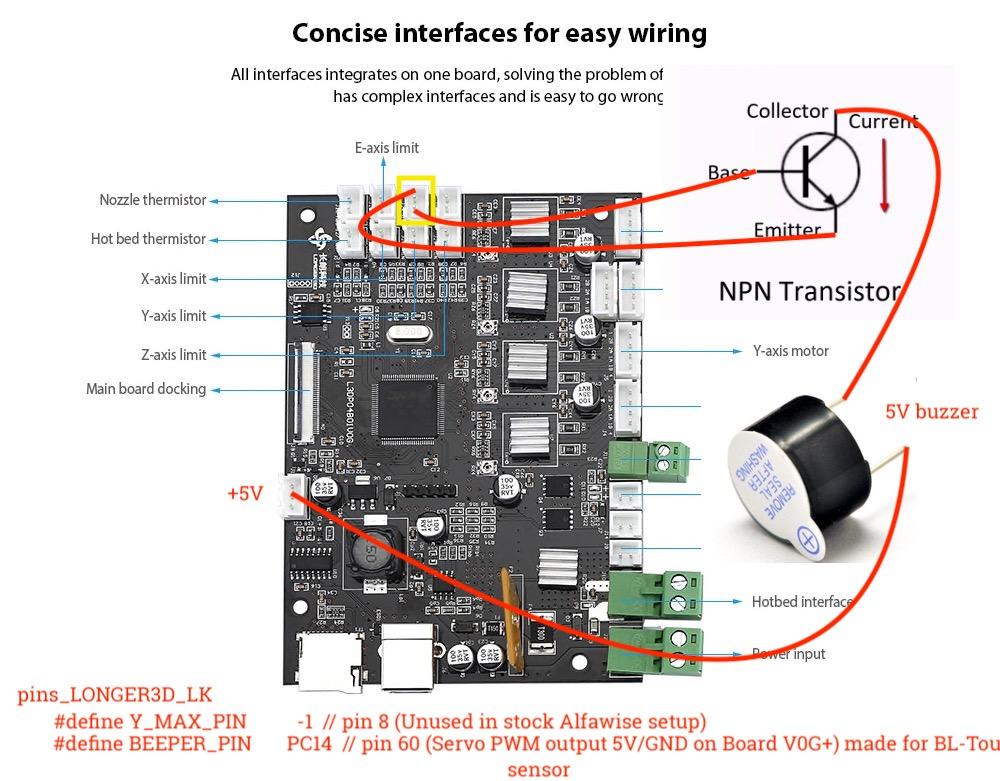

bigvlad Posté(e) Septembre 24, 2019 Posté(e) Septembre 24, 2019 To connect buzzer to rU30 Works great
